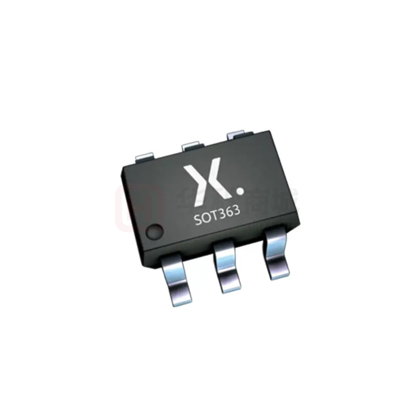

    60 V,双N沟道沟道MOSFET SOT363
NX138BKSF 数据手册
NX138BKS 60 V, dual N-channel Trench MOSFET 15 June 2016 Product data sheet 1. General description Dual N-channel enhancement mode Field-Effect Transistor (FET) in a very small SOT363 (SC-88) Surface-Mounted Device (SMD) plastic package using Trench MOSFET technology. 2. Features and benefits • • • • Low threshold voltage Very fast switching Trench MOSFET technology ElectroStatic Discharge (ESD) protection > 2 kV HBM 3. Applications • • • • Relay driver High-speed line driver Low-side loadswitch Switching circuits 4. Quick reference data Table 1. Quick reference data Symbol Parameter Conditions Min Typ Max Unit VDS drain-source voltage Tj = 25 °C - - 60 V VGS gate-source voltage -20 - 20 V ID drain current - - 210 mA - 2.1 3.5 Ω Per transistor VGS = 10 V; Tamb = 25 °C [1] Static characteristics (per transistor) RDSon [1] drain-source on-state resistance VGS = 10 V; ID = 200 mA; Tj = 25 °C 2 Device mounted on an FR4 Printed-Circuit Board (PCB), single-sided copper, tin-plated and mounting pad for drain 1 cm . NX138BKS Nexperia 60 V, dual N-channel Trench MOSFET 5. Pinning information Table 2. Pinning information Pin Symbol Description 1 S1 source TR1 2 G1 gate TR1 3 D2 drain TR2 4 S2 source TR2 5 G2 gate TR2 6 D1 drain TR1 Simplified outline 6 5 Graphic symbol D2 D1 4 G1 1 2 G2 3 TSSOP6 (SOT363) S1 S2 017aaa256 6. Ordering information Table 3. Ordering information Type number NX138BKS NX138BKS Product data sheet Package Name Description Version TSSOP6 plastic surface-mounted package; 6 leads SOT363 All information provided in this document is subject to legal disclaimers. 15 June 2016 © Nexperia B.V. 2017. All rights reserved 2 / 15 NX138BKS Nexperia 60 V, dual N-channel Trench MOSFET 7. Limiting values Table 4. Limiting values In accordance with the Absolute Maximum Rating System (IEC 60134). Symbol Parameter Conditions Min Max Unit VDS drain-source voltage Tj = 25 °C - 60 V VGS gate-source voltage -20 20 V ID drain current Per transistor VGS = 10 V; Tamb = 25 °C [1] - 210 mA VGS = 10 V; Tamb = 100 °C [1] - 135 mA VGS = 10 V; Tsp = 25 °C - 330 mA - 855 mA [2] - 285 mW [1] - 320 mW - 860 mW IDM peak drain current Tamb = 25 °C; single pulse; tp ≤ 10 µs Ptot total power dissipation Tamb = 25 °C Tsp = 25 °C Per device Tj junction temperature -55 150 °C Tamb ambient temperature -55 150 °C Tstg storage temperature -65 150 °C - 170 mA Source-drain diode IS [1] [2] source current Tamb = 25 °C [1] 2 Device mounted on an FR4 Printed-Circuit Board (PCB), single-sided copper, tin-plated and mounting pad for drain 1 cm . Device mounted on an FR4 PCB, single-sided copper, tin-plated and standard footprint. 017aaa123 120 Pder (%) 017aaa124 120 Ider (%) 80 80 40 40 0 - 75 - 25 25 75 125 Tj (°C) Fig. 1. MOSFET transistor: Normalized total power dissipation as a function of junction temperature NX138BKS Product data sheet 0 - 75 175 - 25 25 75 125 Tj (°C) 175 Fig. 2. MOSFET transistor: Normalized continuous drain current as a function of junction temperature All information provided in this document is subject to legal disclaimers. 15 June 2016 © Nexperia B.V. 2017. All rights reserved 3 / 15 NX138BKS Nexperia 60 V, dual N-channel Trench MOSFET aaa-023329 1 tp = 10 µs ID (A) Limit RDSon = VDS/ID 100 µs 10-1 1 ms 10-2 10-3 10-1 DC; Tsp = 25 °C 10 ms DC; Tamb = 25 °C; drain mounting pad 1 cm2 100 ms 1 10 102 VDS (V) IDM = single pulse Fig. 3. Safe operating area; junction to ambient; continuous and peak drain currents as a function of drain-source voltage 8. Thermal characteristics Table 5. Thermal characteristics Symbol Parameter Conditions thermal resistance from junction to ambient in free air Min Typ Max Unit [1] - 380 440 K/W [2] - 340 390 K/W - 125 145 K/W Per transistor Rth(j-a) Rth(j-sp) [1] [2] thermal resistance from junction to solder point Device mounted on an FR4 PCB, single-sided copper, tin-plated and standard footprint. 2 Device mounted on an FR4 PCB, single-sided copper, tin-plated and mounting pad for drain 1 cm . NX138BKS Product data sheet All information provided in this document is subject to legal disclaimers. 15 June 2016 © Nexperia B.V. 2017. All rights reserved 4 / 15 NX138BKS Nexperia 60 V, dual N-channel Trench MOSFET aaa-023330 103 Zth(j-a) (K/W) duty cycle = 1 0.75 0.50 0.33 102 0.20 0.25 0.10 0.05 0.02 0.01 0 10 10-3 10-2 10-1 1 10 102 tp (s) 103 FR4 PCB, standard footprint Fig. 4. Transient thermal impedance from junction to ambient as a function of pulse duration; typical values aaa-023331 103 Zth(j-a) (K/W) duty cycle = 1 0.75 0.50 102 0.33 0.20 0.25 0.10 0.05 0.02 0.01 0 10 10-3 10-2 10-1 FR4 PCB, mounting pad for drain 1 cm 1 10 102 tp (s) 2 103 Fig. 5. Transient thermal impedance from junction to ambient as a function of pulse duration; typical values NX138BKS Product data sheet All information provided in this document is subject to legal disclaimers. 15 June 2016 © Nexperia B.V. 2017. All rights reserved 5 / 15 NX138BKS Nexperia 60 V, dual N-channel Trench MOSFET 9. Characteristics Table 6. Characteristics Symbol Parameter Conditions Min Typ Max Unit Static characteristics (per transistor) V(BR)DSS drain-source breakdown voltage ID = 250 µA; VGS = 0 V; Tj = 25 °C 60 - - V VGSth gate-source threshold voltage ID = 250 µA; VDS=VGS; Tj = 25 °C 0.5 1 1.5 V IDSS drain leakage current VDS = 60 V; VGS = 0 V; Tj = 25 °C - - 1 µA IGSS gate leakage current VGS = 20 V; VDS = 0 V; Tj = 25 °C - - 10 µA VGS = -20 V; VDS = 0 V; Tj = 25 °C - - -10 µA VGS = 10 V; VDS = 0 V; Tj = 25 °C - - 1 µA VGS = -10 V; VDS = 0 V; Tj = 25 °C - - -1 µA VGS = 5 V; VDS = 0 V; Tj = 25 °C - - 0.3 µA VGS = -5 V; VDS = 0 V; Tj = 25 °C - - -0.3 µA VGS = 10 V; ID = 200 mA; Tj = 25 °C - 2.1 3.5 Ω VGS = 10 V; ID = 200 mA; Tj = 150 °C - 4.3 7.2 Ω VGS = 5 V; ID = 170 mA; Tj = 25 °C - 2.2 3.8 Ω VGS = 2.5 V; ID = 75 mA; Tj = 25 °C - 2.6 5 Ω VDS = 10 V; ID = 200 mA; Tj = 25 °C - 0.7 - S - 0.5 0.7 nC - 0.12 - nC - 0.12 - nC - 20 - pF - 3.1 - pF - 2 - pF - 8 - ns - 8 - ns RDSon gfs drain-source on-state resistance forward transconductance Dynamic characteristics (per transistor) QG(tot) total gate charge VDS = 30 V; ID = 200 mA; VGS = 10 V; Tj = 25 °C QGS gate-source charge QGD gate-drain charge Ciss input capacitance Coss output capacitance Crss reverse transfer capacitance td(on) turn-on delay time tr rise time td(off) turn-off delay time - 13 - ns tf fall time - 5 - ns - 0.9 1.2 V VDS = 30 V; f = 1 MHz; VGS = 0 V; Tj = 25 °C VDS = 30 V; ID = 200 mA; VGS = 10 V; RG(ext) = 6 Ω; Tj = 25 °C Source-drain diode (per transistor) VSD source-drain voltage NX138BKS Product data sheet IS = 200 mA; VGS = 0 V; Tj = 25 °C All information provided in this document is subject to legal disclaimers. 15 June 2016 © Nexperia B.V. 2017. All rights reserved 6 / 15 NX138BKS Nexperia 60 V, dual N-channel Trench MOSFET aaa-023332 0.8 VGS = 10 V ID (A) 2.5 V 4.5 V aaa-023333 10-3 3.5 V ID (A) 0.6 min 10-4 typ max 2.2 V 0.4 2.0 V 0.2 0 10-5 1.8 V 0 1 2 3 4 VDS (V) 10-6 5 Tj = 25 °C RDSon (Ω) 2.0 V 2.2 V 1 1.5 VGS (V) 2 Fig. 7. Sub-threshold drain current as a function of gatesource voltage aaa-023334 1.8 V 0.5 VDS = 5 V Tj = 25 °C Fig. 6. Output characteristics: drain current as a function of drain-source voltage; typical values 8 0 aaa-023335 8 RDSon (Ω) 7 2.5 V 6 6 5 4 Tj = 150 °C 4 3 Tj = 25 °C 2 0 2 3V 4.5 V VGS = 10 V 0 0.2 0.4 0.6 ID (A) 1 0 0.8 Tj = 25 °C Product data sheet 5 VGS (V) 10 ID = 0.2 A Fig. 8. Drain-source on-state resistance as a function of drain current; typical values NX138BKS 0 Fig. 9. Drain-source on-state resistance as a function of gate-source voltage; typical values All information provided in this document is subject to legal disclaimers. 15 June 2016 © Nexperia B.V. 2017. All rights reserved 7 / 15 NX138BKS Nexperia 60 V, dual N-channel Trench MOSFET aaa-023336 0.6 aaa-023337 2.5 a ID (A) 2 0.4 1.5 1 0.2 Tj = 150 °C 0 0 Tj = 25 °C 1 2 0.5 3 VGS (V) 0 -60 4 0 60 120 Tj (°C) 180 VDS > ID x RDSon Fig. 10. Transfer characteristics: drain current as a function of gate-source voltage; typical values Fig. 11. Normalized drain-source on-state resistance as a function of junction temperature; typical values aaa-023338 2 VGS(th) (V) C (pF) max 1.5 aaa-023339 102 Ciss 1 typ 0.5 min 10 Coss Crss 0 -60 0 60 120 Tj (°C) 1 10-1 180 ID = 250 μA; VDS = VGS Product data sheet 10 VDS (V) 102 f = 1 MHz; VGS = 0 V Fig. 12. Gate-source threshold voltage as a function of junction temperature NX138BKS 1 Fig. 13. Input, output and reverse transfer capacitances as a function of drain-source voltage; typical values All information provided in this document is subject to legal disclaimers. 15 June 2016 © Nexperia B.V. 2017. All rights reserved 8 / 15 NX138BKS Nexperia 60 V, dual N-channel Trench MOSFET aaa-023340 10 VDS VGS (V) ID 8 VGS(pl) 6 VGS(th) VGS 4 QGS1 2 0 QGS2 0 0.2 0.4 0.6 QGS QGD QG(tot) 003aaa508 Fig. 15. MOSFET transistor: Gate charge waveform definitions 0.8 1 QG (nC) VDS = 30 V; ID = 0.2 A Fig. 14. Gate-source voltage as a function of gate charge; typical values aaa-023341 0.2 IS (A) 0.1 Tj = 150 ºC 0 0 0.4 Tj = 25 ºC 0.8 VSD (V) 1.2 VGS = 0 V Fig. 16. Source current as a function of source-drain voltage; typical values 10. Test information P t2 duty cycle δ = t1 t2 t1 t 006aaa812 Fig. 17. Duty cycle definition NX138BKS Product data sheet All information provided in this document is subject to legal disclaimers. 15 June 2016 © Nexperia B.V. 2017. All rights reserved 9 / 15 NX138BKS Nexperia 60 V, dual N-channel Trench MOSFET 11. Package outline Plastic surface-mounted package; 6 leads SOT363 D B E y A X HE 6 5 v M A 4 Q pin 1 index A 1 2 e1 A1 3 bp c Lp w M B e detail X 0 1 2 mm scale DIMENSIONS (mm are the original dimensions) UNIT A A1 max bp c D E e e1 HE Lp Q v w y mm 1.1 0.8 0.1 0.30 0.20 0.25 0.10 2.2 1.8 1.35 1.15 1.3 0.65 2.2 2.0 0.45 0.15 0.25 0.15 0.2 0.2 0.1 OUTLINE VERSION REFERENCES IEC JEDEC SOT363 JEITA EUROPEAN PROJECTION ISSUE DATE 04-11-08 06-03-16 SC-88 Fig. 18. Package outline TSSOP6 (SOT363) NX138BKS Product data sheet All information provided in this document is subject to legal disclaimers. 15 June 2016 © Nexperia B.V. 2017. All rights reserved 10 / 15 NX138BKS Nexperia 60 V, dual N-channel Trench MOSFET 12. Soldering 2.65 solder lands 2.35 1.5 0.4 (2×) 0.6 0.5 (4×) (4×) solder resist solder paste 0.5 (4×) 0.6 (2×) occupied area 0.6 (4×) Dimensions in mm 1.8 sot363_fr Fig. 19. Reflow soldering footprint for TSSOP6 (SOT363) 1.5 solder lands 0.3 2.5 4.5 1.5 solder resist occupied area Dimensions in mm 1.3 preferred transport direction during soldering 1.3 2.45 5.3 sot363_fw Fig. 20. Wave soldering footprint for TSSOP6 (SOT363) NX138BKS Product data sheet All information provided in this document is subject to legal disclaimers. 15 June 2016 © Nexperia B.V. 2017. All rights reserved 11 / 15 NX138BKS Nexperia 60 V, dual N-channel Trench MOSFET 13. Revision history Table 7. Revision history Data sheet ID Release date Data sheet status Change notice Supersedes NX138BKS v.1 20160615 Product data sheet - - NX138BKS Product data sheet All information provided in this document is subject to legal disclaimers. 15 June 2016 © Nexperia B.V. 2017. All rights reserved 12 / 15 NX138BKS Nexperia 60 V, dual N-channel Trench MOSFET Notwithstanding any damages that customer might incur for any reason whatsoever, Nexperia’s aggregate and cumulative liability towards customer for the products described herein shall be limited in accordance with the Terms and conditions of commercial sale of Nexperia. 14. Legal information Right to make changes — Nexperia reserves the right to make changes to information published in this document, including without limitation specifications and product descriptions, at any time and without notice. This document supersedes and replaces all information supplied prior to the publication hereof. Data sheet status Document status [1][2] Product status [3] Objective [short] data sheet Development This document contains data from the objective specification for product development. Preliminary [short] data sheet Qualification This document contains data from the preliminary specification. Product [short] data sheet Production This document contains the product specification. [1] [2] [3] Definition Suitability for use — Nexperia products are not designed, authorized or warranted to be suitable for use in life support, life-critical or safety-critical systems or equipment, nor in applications where failure or malfunction of a Nexperia product can reasonably be expected to result in personal injury, death or severe property or environmental damage. Nexperia and its suppliers accept no liability for inclusion and/or use of Nexperia products in such equipment or applications and therefore such inclusion and/or use is at the customer’s own risk. Quick reference data — The Quick reference data is an extract of the product data given in the Limiting values and Characteristics sections of this document, and as such is not complete, exhaustive or legally binding. Please consult the most recently issued document before initiating or completing a design. The term 'short data sheet' is explained in section "Definitions". The product status of device(s) described in this document may have changed since this document was published and may differ in case of multiple devices. The latest product status information is available on the Internet at URL http://www.nexperia.com. Definitions Preview — The document is a preview version only. The document is still subject to formal approval, which may result in modifications or additions. Nexperia does not give any representations or warranties as to the accuracy or completeness of information included herein and shall have no liability for the consequences of use of such information. Draft — The document is a draft version only. The content is still under internal review and subject to formal approval, which may result in modifications or additions. Nexperia does not give any representations or warranties as to the accuracy or completeness of information included herein and shall have no liability for the consequences of use of such information. Short data sheet — A short data sheet is an extract from a full data sheet with the same product type number(s) and title. A short data sheet is intended for quick reference only and should not be relied upon to contain detailed and full information. For detailed and full information see the relevant full data sheet, which is available on request via the local Nexperia sales office. In case of any inconsistency or conflict with the short data sheet, the full data sheet shall prevail. Product specification — The information and data provided in a Product data sheet shall define the specification of the product as agreed between Nexperia and its customer, unless Nexperia and customer have explicitly agreed otherwise in writing. In no event however, shall an agreement be valid in which the Nexperia product is deemed to offer functions and qualities beyond those described in the Product data sheet. Disclaimers Limited warranty and liability — Information in this document is believed to be accurate and reliable. However, Nexperia does not give any representations or warranties, expressed or implied, as to the accuracy or completeness of such information and shall have no liability for the consequences of use of such information. Nexperia takes no responsibility for the content in this document if provided by an information source outside of Nexperia. In no event shall Nexperia be liable for any indirect, incidental, punitive, special or consequential damages (including - without limitation lost profits, lost savings, business interruption, costs related to the removal or replacement of any products or rework charges) whether or not such damages are based on tort (including negligence), warranty, breach of contract or any other legal theory. NX138BKS Product data sheet Applications — Applications that are described herein for any of these products are for illustrative purposes only. Nexperia makes no representation or warranty that such applications will be suitable for the specified use without further testing or modification. Customers are responsible for the design and operation of their applications and products using Nexperia products, and Nexperia accepts no liability for any assistance with applications or customer product design. It is customer’s sole responsibility to determine whether the Nexperia product is suitable and fit for the customer’s applications and products planned, as well as for the planned application and use of customer’s third party customer(s). Customers should provide appropriate design and operating safeguards to minimize the risks associated with their applications and products. Nexperia does not accept any liability related to any default, damage, costs or problem which is based on any weakness or default in the customer’s applications or products, or the application or use by customer’s third party customer(s). Customer is responsible for doing all necessary testing for the customer’s applications and products using Nexperia products in order to avoid a default of the applications and the products or of the application or use by customer’s third party customer(s). Nexperia does not accept any liability in this respect. Limiting values — Stress above one or more limiting values (as defined in the Absolute Maximum Ratings System of IEC 60134) will cause permanent damage to the device. Limiting values are stress ratings only and (proper) operation of the device at these or any other conditions above those given in the Recommended operating conditions section (if present) or the Characteristics sections of this document is not warranted. Constant or repeated exposure to limiting values will permanently and irreversibly affect the quality and reliability of the device. Terms and conditions of commercial sale — Nexperia products are sold subject to the general terms and conditions of commercial sale, as published at http://www.nexperia.com/profile/terms, unless otherwise agreed in a valid written individual agreement. In case an individual agreement is concluded only the terms and conditions of the respective agreement shall apply. Nexperia hereby expressly objects to applying the customer’s general terms and conditions with regard to the purchase of Nexperia products by customer. No offer to sell or license — Nothing in this document may be interpreted or construed as an offer to sell products that is open for acceptance or the grant, conveyance or implication of any license under any copyrights, patents or other industrial or intellectual property rights. Export control — This document as well as the item(s) described herein may be subject to export control regulations. Export might require a prior authorization from competent authorities. Non-automotive qualified products — Unless this data sheet expressly states that this specific Nexperia product is automotive qualified, the product is not suitable for automotive use. It is neither qualified nor tested in accordance with automotive testing or application requirements. Nexperia accepts no liability for inclusion and/or use of nonautomotive qualified products in automotive equipment or applications. All information provided in this document is subject to legal disclaimers. 15 June 2016 © Nexperia B.V. 2017. All rights reserved 13 / 15 NX138BKS Nexperia 60 V, dual N-channel Trench MOSFET In the event that customer uses the product for design-in and use in automotive applications to automotive specifications and standards, customer (a) shall use the product without Nexperia’s warranty of the product for such automotive applications, use and specifications, and (b) whenever customer uses the product for automotive applications beyond Nexperia’s specifications such use shall be solely at customer’s own risk, and (c) customer fully indemnifies Nexperia for any liability, damages or failed product claims resulting from customer design and use of the product for automotive applications beyond Nexperia’s standard warranty and Nexperia’s product specifications. Translations — A non-English (translated) version of a document is for reference only. The English version shall prevail in case of any discrepancy between the translated and English versions. Trademarks Notice: All referenced brands, product names, service names and trademarks are the property of their respective owners. NX138BKS Product data sheet All information provided in this document is subject to legal disclaimers. 15 June 2016 © Nexperia B.V. 2017. All rights reserved 14 / 15 NX138BKS Nexperia 60 V, dual N-channel Trench MOSFET 15. Contents 1. General description......................................................1 2. Features and benefits.................................................. 1 3. Applications.................................................................. 1 4. Quick reference data....................................................1 5. Pinning information......................................................2 6. Ordering information....................................................2 7. Limiting values............................................................. 3 8. Thermal characteristics............................................... 4 9. Characteristics..............................................................6 10. Test information......................................................... 9 11. Package outline........................................................ 10 12. Soldering................................................................... 11 13. Revision history........................................................12 14. Legal information..................................................... 13 © Nexperia B.V. 2017. All rights reserved For more information, please visit: http://www.nexperia.com For sales office addresses, please send an email to: salesaddresses@nexperia.com Date of release: 15 June 2016 NX138BKS Product data sheet All information provided in this document is subject to legal disclaimers. 15 June 2016 © Nexperia B.V. 2017. All rights reserved 15 / 15
