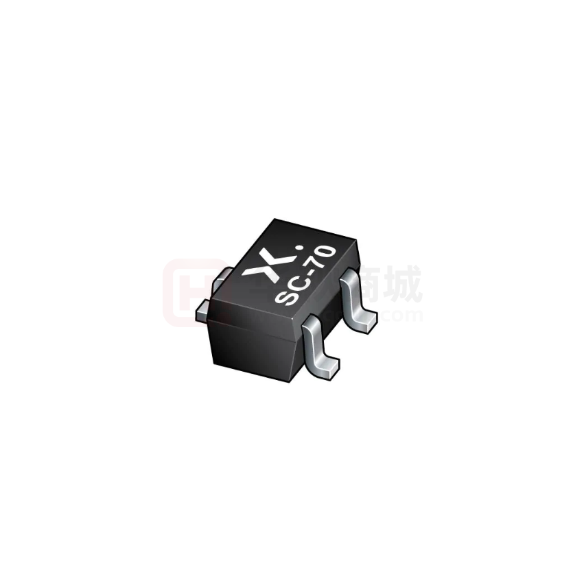

NX138BKW 60 V, N-channel Trench MOSFET 15 June 2016 Product data sheet 1. General description N-channel enhancement mode Field-Effect Transistor (FET) in a very small SOT323 (SC-70) Surface-Mounted Device (SMD) plastic package using Trench MOSFET technology. 2. Features and benefits • • • • Low threshold voltage Very fast switching Trench MOSFET technology ElectroStatic Discharge (ESD) protection > 2 kV HBM 3. Applications • • • • Relay driver High-speed line driver Low-side loadswitch Switching circuits 4. Quick reference data Table 1. Quick reference data Symbol Parameter Conditions Min Typ Max Unit VDS drain-source voltage Tj = 25 °C - - 60 V VGS gate-source voltage -20 - 20 V ID drain current - - 210 mA - 2.1 3.5 Ω VGS = 10 V; Tamb = 25 °C [1] Static characteristics RDSon drain-source on-state resistance [1] VGS = 10 V; ID = 200 mA; Tj = 25 °C Device mounted on an FR4 Printed-Circuit Board (PCB), single-sided copper, tin-plated and mounting pad 2 for drain 1 cm . NX138BKW Nexperia 60 V, N-channel Trench MOSFET 5. Pinning information Table 2. Pinning information Pin Symbol Description 1 G gate 2 S source 3 D drain Simplified outline Graphic symbol 3 D G 1 2 SC-70 (SOT323) S 017aaa255 6. Ordering information Table 3. Ordering information Type number NX138BKW Package Name Description Version SC-70 plastic surface-mounted package; 3 leads SOT323 7. Marking Table 4. Marking codes Type number Marking code [1] NX138BKW B8% [1] NX138BKW Product data sheet % = placeholder for manufacturing site code All information provided in this document is subject to legal disclaimers. 15 June 2016 © Nexperia B.V. 2017. All rights reserved 2 / 15 NX138BKW Nexperia 60 V, N-channel Trench MOSFET 8. Limiting values Table 5. Limiting values In accordance with the Absolute Maximum Rating System (IEC 60134). Symbol Parameter Conditions Min Max Unit VDS drain-source voltage Tj = 25 °C - 60 V VGS gate-source voltage -20 20 V ID drain current VGS = 10 V; Tamb = 25 °C [1] - 210 mA VGS = 10 V; Tamb = 100 °C [1] - 135 mA VGS = 10 V; Tsp = 25 °C - 330 mA - 855 mA [2] - 266 mW [1] - 321 mW - 1.33 W IDM peak drain current Tamb = 25 °C; single pulse; tp ≤ 10 µs Ptot total power dissipation Tamb = 25 °C Tsp = 25 °C Tj junction temperature -55 150 °C Tamb ambient temperature -55 150 °C Tstg storage temperature -65 150 °C - 210 mA Source-drain diode IS source current NX138BKW Product data sheet Tamb = 25 °C [1] [1] Device mounted on an FR4 Printed-Circuit Board (PCB), single-sided copper, tin-plated and mounting pad [2] for drain 1 cm . Device mounted on an FR4 Printed-Circuit Board (PCB), single-sided copper, tin-plated and standard footprint. 2 All information provided in this document is subject to legal disclaimers. 15 June 2016 © Nexperia B.V. 2017. All rights reserved 3 / 15 NX138BKW Nexperia 60 V, N-channel Trench MOSFET 017aaa123 120 Pder (%) Ider (%) 80 80 40 40 0 - 75 Fig. 1. 017aaa124 120 - 25 25 75 125 Tj (°C) 0 - 75 175 Normalized total power dissipation as a function of junction temperature Fig. 2. - 25 25 75 125 Tj (°C) 175 Normalized continuous drain current as a function of junction temperature aaa-023342 1 tp = 10 µs ID (A) 100 µs Limit RDSon = VDS/ID 10-1 1 ms 10-2 10-3 10-1 DC; Tsp = 25 °C 10 ms DC; Tamb = 25 °C; drain mounting pad 1 cm2 100 ms 1 10 102 VDS (V) IDM = single pulse Fig. 3. Safe operating area; junction to ambient; continuous and peak drain currents as a function of drainsource voltage 9. Thermal characteristics Table 6. Thermal characteristics Symbol Parameter Conditions Rth(j-a) thermal resistance from junction to ambient in free air NX138BKW Product data sheet All information provided in this document is subject to legal disclaimers. 15 June 2016 Min Typ Max Unit [1] - 410 470 K/W [2] - 340 390 K/W © Nexperia B.V. 2017. All rights reserved 4 / 15 NX138BKW Nexperia 60 V, N-channel Trench MOSFET Symbol Parameter Rth(j-sp) thermal resistance from junction to solder point [1] [2] Conditions Min Typ Max Unit - 75 85 K/W Device mounted on an FR4 PCB, single-sided copper, tin-plated and standard footprint. 2 Device mounted on an FR4 PCB, single-sided copper, tin-plated and mounting pad for drain 1 cm . aaa-023343 103 duty cycle = 1 Zth(j-a) (K/W) 0.75 0.50 0.33 102 0.20 0.25 0.10 0.05 0.02 0.01 0 10 10-3 10-2 10-1 1 10 102 tp (s) 103 FR4 PCB, standard footprint Fig. 4. Transient thermal impedance from junction to ambient as a function of pulse duration; typical values aaa-023344 103 duty cycle = 1 Zth(j-a) (K/W) 0.75 0.50 102 0.33 0.20 0.25 0.10 0.05 10 10-3 0.02 0.01 0 10-2 10-1 FR4 PCB, mounting pad for drain 1 cm Fig. 5. 1 10 102 tp (s) 103 2 Transient thermal impedance from junction to ambient as a function of pulse duration; typical values NX138BKW Product data sheet All information provided in this document is subject to legal disclaimers. 15 June 2016 © Nexperia B.V. 2017. All rights reserved 5 / 15 NX138BKW Nexperia 60 V, N-channel Trench MOSFET 10. Characteristics Table 7. Characteristics Symbol Parameter Conditions Min Typ Max Unit Static characteristics V(BR)DSS drain-source breakdown voltage ID = 250 µA; VGS = 0 V; Tj = 25 °C 60 - - V VGSth gate-source threshold voltage ID = 250 µA; VDS=VGS; Tj = 25 °C 0.5 1 1.5 V IDSS drain leakage current VDS = 60 V; VGS = 0 V; Tj = 25 °C - - 1 µA IGSS gate leakage current VGS = 20 V; VDS = 0 V; Tj = 25 °C - - 10 µA VGS = -20 V; VDS = 0 V; Tj = 25 °C - - -10 µA VGS = 10 V; VDS = 0 V; Tj = 25 °C - - 1 µA VGS = -10 V; VDS = 0 V; Tj = 25 °C - - -1 µA VGS = 5 V; VDS = 0 V; Tj = 25 °C - - 0.3 µA VGS = -5 V; VDS = 0 V; Tj = 25 °C - - -0.3 µA VGS = 10 V; ID = 200 mA; Tj = 25 °C - 2.1 3.5 Ω VGS = 10 V; ID = 200 mA; Tj = 150 °C - 4.3 7.2 Ω VGS = 5 V; ID = 170 mA; Tj = 25 °C - 2.2 3.8 Ω VGS = 2.5 V; ID = 75 mA; Tj = 25 °C - 2.6 5 Ω VDS = 10 V; ID = 200 mA; Tj = 25 °C - 0.7 - S RDSon gfs drain-source on-state resistance forward transconductance Dynamic characteristics QG(tot) total gate charge VDS = 30 V; ID = 200 mA; VGS = 10 V; - 0.5 0.7 nC QGS gate-source charge Tj = 25 °C - 0.12 - nC QGD gate-drain charge - 0.12 - nC Ciss input capacitance VDS = 30 V; f = 1 MHz; VGS = 0 V; - 20 - pF Coss output capacitance Tj = 25 °C - 3.1 - pF Crss reverse transfer capacitance - 2 - pF td(on) turn-on delay time VDS = 30 V; ID = 200 mA; VGS = 10 V; - 8 12 ns tr rise time RG(ext) = 6 Ω; Tj = 25 °C - 8 - ns td(off) turn-off delay time - 13 20 ns tf fall time - 5 - ns - 0.9 1.2 V Source-drain diode VSD source-drain voltage NX138BKW Product data sheet IS = 200 mA; VGS = 0 V; Tj = 25 °C All information provided in this document is subject to legal disclaimers. 15 June 2016 © Nexperia B.V. 2017. All rights reserved 6 / 15 NX138BKW Nexperia 60 V, N-channel Trench MOSFET aaa-023345 0.8 VGS = 10 V ID (A) 2.5 V 4.5 V aaa-023346 10-3 3.5 V ID (A) 0.6 min 10-4 typ max 2.2 V 0.4 2.0 V 0.2 0 Fig. 6. 10-5 1.8 V 0 1 2 3 4 VDS (V) 10-6 5 0 Tj = 25 °C VDS = 5 V Output characteristics: drain current as a function of drain-source voltage; typical values Fig. 7. Tj = 25 °C aaa-023347 8 1.8 V RDSon (Ω) 2.0 V 2.2 V 0.5 1 1.5 6 aaa-023348 6 5 4 Tj = 150 °C 4 3 2 0 3V 4.5 V VGS = 10 V 0 0.2 0.4 0.6 ID (A) 1 0 0.8 Product data sheet 0 5 VGS (V) 10 ID = 0.2 A Drain-source on-state resistance as a function of drain current; typical values NX138BKW Tj = 25 °C 2 Tj = 25 °C Fig. 8. 2 Sub-threshold drain current as a function of gate-source voltage 8 RDSon (Ω) 7 2.5 V VGS (V) Fig. 9. Drain-source on-state resistance as a function of gate-source voltage; typical values All information provided in this document is subject to legal disclaimers. 15 June 2016 © Nexperia B.V. 2017. All rights reserved 7 / 15 NX138BKW Nexperia 60 V, N-channel Trench MOSFET aaa-023349 0.6 aaa-023350 2.5 a ID (A) 2 0.4 1.5 1 0.2 Tj = 150 °C 0 0 Tj = 25 °C 1 2 0.5 3 VGS (V) 0 -60 4 VDS > ID x RDSon Fig. 10. Transfer characteristics: drain current as a function of gate-source voltage; typical values 120 Tj (°C) 180 aaa-023352 102 VGS(th) (V) C (pF) max 1.5 60 Fig. 11. Normalized drain-source on-state resistance as a function of junction temperature; typical values aaa-023351 2 0 Ciss 1 typ 0.5 min 10 Coss Crss 0 -60 0 60 120 Tj (°C) 1 10-1 180 ID = 250 μA; VDS = VGS Product data sheet 10 VDS (V) 102 f = 1 MHz; VGS = 0 V Fig. 12. Gate-source threshold voltage as a function of junction temperature NX138BKW 1 Fig. 13. Input, output and reverse transfer capacitances as a function of drain-source voltage; typical values All information provided in this document is subject to legal disclaimers. 15 June 2016 © Nexperia B.V. 2017. All rights reserved 8 / 15 NX138BKW Nexperia 60 V, N-channel Trench MOSFET aaa-023353 10 VDS VGS (V) ID 8 VGS(pl) 6 VGS(th) VGS 4 QGS1 2 0 QGS2 0 0.2 0.4 0.6 QGS QGD QG(tot) 003aaa508 Fig. 15. MOSFET transistor: Gate charge waveform definitions 0.8 1 QG (nC) VDS = 30 V; ID = 0.2 A Fig. 14. Gate-source voltage as a function of gate charge; typical values aaa-023354 0.2 IS (A) 0.1 Tj = 150 ºC 0 0 0.4 Tj = 25 ºC 0.8 VSD (V) 1.2 VGS = 0 V Fig. 16. Source current as a function of source-drain voltage; typical values 11. Test information P t2 duty cycle δ = t1 t2 t1 t 006aaa812 Fig. 17. Duty cycle definition NX138BKW Product data sheet All information provided in this document is subject to legal disclaimers. 15 June 2016 © Nexperia B.V. 2017. All rights reserved 9 / 15 NX138BKW Nexperia 60 V, N-channel Trench MOSFET 12. Package outline Plastic surface-mounted package; 3 leads SOT323 D B E A X HE y v M A 3 Q A A1 1 c 2 e1 bp Lp w M B e detail X 0 1 2 mm scale DIMENSIONS (mm are the original dimensions) UNIT A A1 max bp c D E e e1 HE Lp Q v w mm 1.1 0.8 0.1 0.4 0.3 0.25 0.10 2.2 1.8 1.35 1.15 1.3 0.65 2.2 2.0 0.45 0.15 0.23 0.13 0.2 0.2 OUTLINE VERSION REFERENCES IEC JEDEC SOT323 JEITA EUROPEAN PROJECTION ISSUE DATE 04-11-04 06-03-16 SC-70 Fig. 18. Package outline SC-70 (SOT323) NX138BKW Product data sheet All information provided in this document is subject to legal disclaimers. 15 June 2016 © Nexperia B.V. 2017. All rights reserved 10 / 15 NX138BKW Nexperia 60 V, N-channel Trench MOSFET 13. Soldering 2.65 1.85 1.325 solder lands solder resist 2 2.35 0.6 (3×) 3 solder paste 1.3 occupied area 0.5 (3×) 1 Dimensions in mm 0.55 (3×) sot323_fr Fig. 19. Reflow soldering footprint for SC-70 (SOT323) 4.6 2.575 1.425 (3×) solder lands solder resist occupied area 1.8 3.65 2.1 09 (2×) Dimensions in mm preferred transport direction during soldering sot323_fw Fig. 20. Wave soldering footprint for SC-70 (SOT323) NX138BKW Product data sheet All information provided in this document is subject to legal disclaimers. 15 June 2016 © Nexperia B.V. 2017. All rights reserved 11 / 15 NX138BKW Nexperia 60 V, N-channel Trench MOSFET 14. Revision history Table 8. Revision history Data sheet ID Release date Data sheet status Change notice Supersedes NX138BKW v.1 20160615 Product data sheet - - NX138BKW Product data sheet All information provided in this document is subject to legal disclaimers. 15 June 2016 © Nexperia B.V. 2017. All rights reserved 12 / 15 NX138BKW Nexperia 60 V, N-channel Trench MOSFET In no event shall Nexperia be liable for any indirect, incidental, punitive, special or consequential damages (including - without limitation lost profits, lost savings, business interruption, costs related to the removal or replacement of any products or rework charges) whether or not such damages are based on tort (including negligence), warranty, breach of contract or any other legal theory. 15. Legal information 15.1 Data sheet status Notwithstanding any damages that customer might incur for any reason whatsoever, Nexperia’s aggregate and cumulative liability towards customer for the products described herein shall be limited in accordance with the Terms and conditions of commercial sale of Nexperia. Document status [1][2] Product status [3] Objective [short] data sheet Development This document contains data from the objective specification for product development. Preliminary [short] data sheet Qualification This document contains data from the preliminary specification. Product [short] data sheet Production This document contains the product specification. [1] [2] [3] Definition Right to make changes — Nexperia reserves the right to make changes to information published in this document, including without limitation specifications and product descriptions, at any time and without notice. This document supersedes and replaces all information supplied prior to the publication hereof. Please consult the most recently issued document before initiating or completing a design. The term 'short data sheet' is explained in section "Definitions". The product status of device(s) described in this document may have changed since this document was published and may differ in case of multiple devices. The latest product status information is available on the Internet at URL http://www.nexperia.com. 15.2 Definitions Preview — The document is a preview version only. The document is still subject to formal approval, which may result in modifications or additions. Nexperia does not give any representations or warranties as to the accuracy or completeness of information included herein and shall have no liability for the consequences of use of such information. Draft — The document is a draft version only. The content is still under internal review and subject to formal approval, which may result in modifications or additions. Nexperia does not give any representations or warranties as to the accuracy or completeness of information included herein and shall have no liability for the consequences of use of such information. Short data sheet — A short data sheet is an extract from a full data sheet with the same product type number(s) and title. A short data sheet is intended for quick reference only and should not be relied upon to contain detailed and full information. For detailed and full information see the relevant full data sheet, which is available on request via the local Nexperia sales office. In case of any inconsistency or conflict with the short data sheet, the full data sheet shall prevail. Product specification — The information and data provided in a Product data sheet shall define the specification of the product as agreed between Nexperia and its customer, unless Nexperia and customer have explicitly agreed otherwise in writing. In no event however, shall an agreement be valid in which the Nexperia product is deemed to offer functions and qualities beyond those described in the Product data sheet. 15.3 Disclaimers Limited warranty and liability — Information in this document is believed to be accurate and reliable. However, Nexperia does not give any representations or warranties, expressed or implied, as to the accuracy or completeness of such information and shall have no liability for the consequences of use of such information. Nexperia takes no responsibility for the content in this document if provided by an information source outside of Nexperia. NX138BKW Product data sheet Suitability for use — Nexperia products are not designed, authorized or warranted to be suitable for use in life support, life-critical or safety-critical systems or equipment, nor in applications where failure or malfunction of a Nexperia product can reasonably be expected to result in personal injury, death or severe property or environmental damage. Nexperia and its suppliers accept no liability for inclusion and/or use of Nexperia products in such equipment or applications and therefore such inclusion and/or use is at the customer’s own risk. Quick reference data — The Quick reference data is an extract of the product data given in the Limiting values and Characteristics sections of this document, and as such is not complete, exhaustive or legally binding. Applications — Applications that are described herein for any of these products are for illustrative purposes only. Nexperia makes no representation or warranty that such applications will be suitable for the specified use without further testing or modification. Customers are responsible for the design and operation of their applications and products using Nexperia products, and Nexperia accepts no liability for any assistance with applications or customer product design. It is customer’s sole responsibility to determine whether the Nexperia product is suitable and fit for the customer’s applications and products planned, as well as for the planned application and use of customer’s third party customer(s). Customers should provide appropriate design and operating safeguards to minimize the risks associated with their applications and products. Nexperia does not accept any liability related to any default, damage, costs or problem which is based on any weakness or default in the customer’s applications or products, or the application or use by customer’s third party customer(s). Customer is responsible for doing all necessary testing for the customer’s applications and products using Nexperia products in order to avoid a default of the applications and the products or of the application or use by customer’s third party customer(s). Nexperia does not accept any liability in this respect. Limiting values — Stress above one or more limiting values (as defined in the Absolute Maximum Ratings System of IEC 60134) will cause permanent damage to the device. Limiting values are stress ratings only and (proper) operation of the device at these or any other conditions above those given in the Recommended operating conditions section (if present) or the Characteristics sections of this document is not warranted. Constant or repeated exposure to limiting values will permanently and irreversibly affect the quality and reliability of the device. Terms and conditions of commercial sale — Nexperia products are sold subject to the general terms and conditions of commercial sale, as published at http://www.nexperia.com/profile/terms, unless otherwise agreed in a valid written individual agreement. In case an individual agreement is concluded only the terms and conditions of the respective agreement shall apply. Nexperia hereby expressly objects to applying the customer’s general terms and conditions with regard to the purchase of Nexperia products by customer. No offer to sell or license — Nothing in this document may be interpreted or construed as an offer to sell products that is open for acceptance or the All information provided in this document is subject to legal disclaimers. 15 June 2016 © Nexperia B.V. 2017. All rights reserved 13 / 15 NX138BKW Nexperia 60 V, N-channel Trench MOSFET grant, conveyance or implication of any license under any copyrights, patents or other industrial or intellectual property rights. Export control — This document as well as the item(s) described herein may be subject to export control regulations. Export might require a prior authorization from competent authorities. Non-automotive qualified products — Unless this data sheet expressly states that this specific Nexperia product is automotive qualified, the product is not suitable for automotive use. It is neither qualified nor tested in accordance with automotive testing or application requirements. Nexperia accepts no liability for inclusion and/or use of nonautomotive qualified products in automotive equipment or applications. In the event that customer uses the product for design-in and use in automotive applications to automotive specifications and standards, customer (a) shall use the product without Nexperia’s warranty of the product for such automotive applications, use and specifications, and (b) whenever customer uses the product for automotive applications beyond Nexperia’s specifications such use shall be solely at customer’s own risk, and (c) customer fully indemnifies Nexperia for any liability, damages or failed product claims resulting from customer design and use of the product for automotive applications beyond Nexperia’s standard warranty and Nexperia’s product specifications. Translations — A non-English (translated) version of a document is for reference only. The English version shall prevail in case of any discrepancy between the translated and English versions. 15.4 Trademarks Notice: All referenced brands, product names, service names and trademarks are the property of their respective owners. NX138BKW Product data sheet All information provided in this document is subject to legal disclaimers. 15 June 2016 © Nexperia B.V. 2017. All rights reserved 14 / 15 NX138BKW Nexperia 60 V, N-channel Trench MOSFET 16. Contents 1 General description ............................................... 1 2 Features and benefits ............................................1 3 Applications ........................................................... 1 4 Quick reference data ............................................. 1 5 Pinning information ............................................... 2 6 Ordering information ............................................. 2 7 Marking ................................................................... 2 8 Limiting values .......................................................3 9 Thermal characteristics .........................................4 10 Characteristics ....................................................... 6 11 Test information ..................................................... 9 12 Package outline ................................................... 10 13 Soldering .............................................................. 11 14 Revision history ................................................... 12 15 15.1 15.2 15.3 15.4 Legal information .................................................13 Data sheet status ............................................... 13 Definitions ...........................................................13 Disclaimers .........................................................13 Trademarks ........................................................ 14 © Nexperia B.V. 2017. All rights reserved For more information, please visit: http://www.nexperia.com For sales office addresses, please send an email to: salesaddresses@nexperia.com Date of release: 15 June 2016 NX138BKW Product data sheet All information provided in this document is subject to legal disclaimers. 15 June 2016 © Nexperia B.V. 2017. All rights reserved 15 / 15
