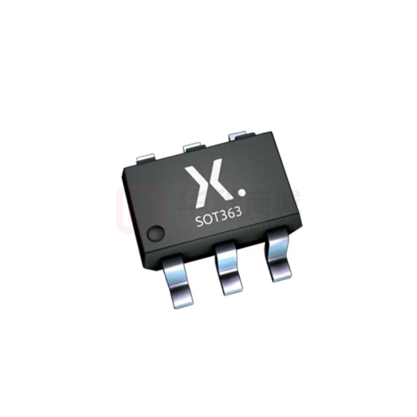

NX6020CAKS 60 V / 50 V, 170 mA / 160 mA N/P-channel Trench MOSFET 18 January 2018 Product data sheet 1. General description Complementary N/P-channel enhancement mode Field-Effect Transistor (FET) in a very small SOT363 (SC-88) Surface-Mounted Device (SMD) plastic package using Trench MOSFET technology. 2. Features and benefits • • • Trench MOSFET technology Very fast switching ElectroStatic Discharge (ESD) protection 3. Applications • • • • Relay driver High-speed line driver Level shifter Power supply converter 4. Quick reference data Table 1. Quick reference data Symbol Parameter Conditions Min Typ Max Unit - - 60 V - - 170 mA VGS = 10 V; ID = 100 mA; Tj = 25 °C - 3 4.5 Ω - - -50 V - - -160 mA - 4.5 7.5 Ω TR1 (N-channel) VDS drain-source voltage Tj = 25 °C ID drain current VGS = 10 V; Tamb = 25 °C [1] TR1 (N-channel), Static characteristics RDSon drain-source on-state resistance TR2 (P-channel) VDS drain-source voltage Tj = 25 °C ID drain current VGS = -10 V; Tamb = 25 °C [1] TR2 (P-channel), Static characteristics RDSon [1] drain-source on-state resistance VGS = -10 V; ID = -100 mA; Tj = 25 °C 2 Device mounted on an FR4 PCB, single-sided copper, tin-plated and mounting pad for drain 1 cm . NX6020CAKS Nexperia 60 V / 50 V, 170 mA / 160 mA N/P-channel Trench MOSFET 5. Pinning information Table 2. Pinning information Pin Symbol Description 1 S1 source TR1 2 G1 gate TR1 3 D2 drain TR2 4 S2 source TR2 5 G2 gate TR2 6 D1 drain TR1 Simplified outline 6 5 Graphic symbol D2 D1 4 G1 1 2 G2 3 TSSOP6 (SOT363) S1 S2 017aaa262 6. Ordering information Table 3. Ordering information Type number NX6020CAKS Package Name Description Version TSSOP6 plastic surface-mounted package; 6 leads SOT363 7. Marking Table 4. Marking codes Type number Marking code[1] NX6020CAKS 2A% [1] % = placeholder for manufacturing site code NX6020CAKS Product data sheet All information provided in this document is subject to legal disclaimers. 18 January 2018 © Nexperia B.V. 2018. All rights reserved 2 / 22 NX6020CAKS Nexperia 60 V / 50 V, 170 mA / 160 mA N/P-channel Trench MOSFET 8. Limiting values Table 5. Limiting values In accordance with the Absolute Maximum Rating System (IEC 60134). Symbol Parameter Conditions Min Max Unit VDS drain-source voltage Tj = 25 °C - 60 V VGS gate-source voltage -20 20 V ID drain current TR1 (N-channel) VGS = 10 V; Tamb = 25 °C [1] - 170 mA VGS = 10 V; Tamb = 100 °C [1] - 100 mA - 680 mA [2] - 220 mW [1] - 255 mW Tsp = 25 °C - 1.06 W Tj = 25 °C - -50 V -20 20 V IDM peak drain current Tamb = 25 °C; single pulse; tp ≤ 10 µs Ptot total power dissipation Tamb = 25 °C TR2 (P-channel) VDS drain-source voltage VGS gate-source voltage ID drain current VGS = -10 V; Tamb = 25 °C [1] - -160 mA VGS = -10 V; Tamb = 100 °C [1] - -100 mA - -640 mA [2] - 280 mW [1] - 320 mW - 990 mW - 330 mW IDM peak drain current Tamb = 25 °C; single pulse; tp ≤ 10 µs Ptot total power dissipation Tamb = 25 °C Tsp = 25 °C Per device Ptot total power dissipation Tamb = 25 °C [2] Tj junction temperature -55 150 °C Tamb ambient temperature -55 150 °C Tstg storage temperature -65 150 °C TR1 (N-channel), Source-drain diode IS source current Tamb = 25 °C [1] - 170 mA Tamb = 25 °C [1] - -160 mA TR2 (P-channel), Source-drain diode IS [1] [2] source current 2 Device mounted on an FR4 PCB, single-sided copper, tin-plated and mounting pad for drain 1 cm . Device mounted on an FR4 Printed-Circuit Board (PCB), single-sided copper; tin-plated and standard footprint. NX6020CAKS Product data sheet All information provided in this document is subject to legal disclaimers. 18 January 2018 © Nexperia B.V. 2018. All rights reserved 3 / 22 NX6020CAKS Nexperia 60 V / 50 V, 170 mA / 160 mA N/P-channel Trench MOSFET 017aaa123 120 017aaa124 120 Pder (%) Ider (%) 80 80 40 40 0 - 75 Fig. 1. - 25 25 75 125 Tj (°C) 0 - 75 175 Fig. 2. Normalized total power dissipation as a function of junction temperature - 25 25 75 125 Tj (°C) 175 Normalized continuous drain current as a function of junction temperature 017aaa479 1 Limit RDSon = VDS/ID ID (A) (1) 10-1 (2) (3) (4) 10-2 (5) (6) 10-3 10-1 1 10 102 VDS (V) IDM = single pulse (1) tp = 100 µs (2) tp = 1 ms (3) tp = 10 ms (4) DC; Tsp = 25 °C (5) tp = 100 ms 2 (6) DC; Tamb = 25 °C; drain mounting pad 1 cm Fig. 3. TR1: Safe operating area; junction to ambient; continuous and peak drain currents as a function of drainsource voltage NX6020CAKS Product data sheet All information provided in this document is subject to legal disclaimers. 18 January 2018 © Nexperia B.V. 2018. All rights reserved 4 / 22 NX6020CAKS Nexperia 60 V / 50 V, 170 mA / 160 mA N/P-channel Trench MOSFET 001aao139 -1 (1) ID (A) (2) -10-1 (3) (4) (5) -10-2 (6) -10-3 -10-1 -1 -10 -102 VDS (V) IDM is single pulse (1) tp = 100 μs (2) tp = 1 ms (3) tp = 10 ms (4) DC; Tsp = 25 °C (5) tp = 100 ms 2 (6) DC; Tamb = 25 °C; drain mounting pad 1 cm Fig. 4. TR2: Safe operating area; junction to ambient; continuous and peak drain currents as a function of drainsource voltage NX6020CAKS Product data sheet All information provided in this document is subject to legal disclaimers. 18 January 2018 © Nexperia B.V. 2018. All rights reserved 5 / 22 NX6020CAKS Nexperia 60 V / 50 V, 170 mA / 160 mA N/P-channel Trench MOSFET 9. Thermal characteristics Table 6. Thermal characteristics Symbol Parameter Conditions Min Typ Max Unit [1] - 500 560 K/W [2] - 450 480 K/W - - 115 K/W [1] - 390 445 K/W [2] - 340 390 K/W - - 130 K/W - - 300 K/W TR1 (N-channel) Rth(j-a) thermal resistance from junction to ambient Rth(j-sp) in free air thermal resistance from junction to solder point TR2 (P-channel) Rth(j-a) thermal resistance from junction to ambient Rth(j-sp) in free air thermal resistance from junction to solder point Per device Rth(j-a) [1] [2] thermal resistance from junction to ambient in free air [1] Device mounted on an FR4 Printed-Circuit Board (PCB), single-sided copper; tin-plated and standard footprint. 2 Device mounted on an FR4 PCB, single-sided copper, tin-plated and mounting pad for drain 1 cm . 017aaa480 103 Zth(j-a) (K/W) 102 duty cycle = 1 0.75 0.33 0.2 0.05 10 0.5 0.25 0.1 0.02 0.01 0 1 10-1 10-5 10-4 10-3 10-2 10-1 1 10 102 tp (s) 103 FR4 PCB, standard footprint Fig. 5. TR1: Transient thermal impedance from junction to ambient as a function of pulse duration; typical values NX6020CAKS Product data sheet All information provided in this document is subject to legal disclaimers. 18 January 2018 © Nexperia B.V. 2018. All rights reserved 6 / 22 NX6020CAKS Nexperia 60 V / 50 V, 170 mA / 160 mA N/P-channel Trench MOSFET 103 Zth(j-a) (K/W) 102 017aaa481 duty cycle = 1 0.75 0.5 0.33 0.2 0.25 0.1 0.05 10 0.02 0.01 0 1 10-1 10-5 10-4 10-3 10-2 FR4 PCB, mounting pad for drain 1 cm Fig. 6. 10-1 1 102 10 2 tp (s) 103 TR1: Transient thermal impedance from junction to ambient as a function of pulse duration; typical values 017aaa034 103 duty cycle = 1 Zth(j-a) (K/W) 0.5 0.25 102 10 0.75 0.33 0.2 0.1 0.05 0 0.02 0.01 1 10- 3 10- 2 10- 1 1 10 102 tp (s) 103 FR4 PCB, standard footprint Fig. 7. TR2: transient thermal impedance from junction to ambient as a function of pulse duration; typical values NX6020CAKS Product data sheet All information provided in this document is subject to legal disclaimers. 18 January 2018 © Nexperia B.V. 2018. All rights reserved 7 / 22 NX6020CAKS Nexperia 60 V / 50 V, 170 mA / 160 mA N/P-channel Trench MOSFET 017aaa035 103 Zth(j-a) (K/W) duty cycle = 1 0.75 0.5 102 0.25 10 0.33 0.2 0.1 0.05 0 0.02 0.01 1 10- 3 10- 2 10- 1 FR4 PCB, mounting pad for drain 1 cm Fig. 8. 1 10 102 tp (s) 2 103 TR2: transient thermal impedance from junction to ambient as a function of pulse duration; typical values NX6020CAKS Product data sheet All information provided in this document is subject to legal disclaimers. 18 January 2018 © Nexperia B.V. 2018. All rights reserved 8 / 22 NX6020CAKS Nexperia 60 V / 50 V, 170 mA / 160 mA N/P-channel Trench MOSFET 10. Characteristics Table 7. Characteristics Symbol Parameter Conditions Min Typ Max Unit TR1 (N-channel), Static characteristics V(BR)DSS drain-source breakdown voltage ID = 250 µA; VGS = 0 V; Tj = 25 °C 60 - - V VGSth gate-source threshold voltage ID = 250 µA; VDS=VGS; Tj = 25 °C 1.1 1.6 2.1 V IDSS drain leakage current VDS = 60 V; VGS = 0 V; Tj = 25 °C - - 1 µA VDS = 60 V; VGS = 0 V; Tj = 150 °C - - 10 µA VGS = 20 V; VDS = 0 V; Tj = 25 °C - - 2 µA VGS = -20 V; VDS = 0 V; Tj = 25 °C - - 2 µA VGS = 10 V; VDS = 0 V; Tj = 25 °C - - 0.5 µA VGS = -10 V; VDS = 0 V; Tj = 25 °C - - 0.5 µA VGS = 5 V; VDS = 0 V; Tj = 25 °C - - 100 nA VGS = -5 V; VDS = 0 V; Tj = 25 °C - - 100 nA VGS = 10 V; ID = 100 mA; Tj = 25 °C - 3 4.5 Ω VGS = 10 V; ID = 100 mA; Tj = 150 °C - 6.2 9.2 Ω VGS = 5 V; ID = 100 mA; Tj = 25 °C - 3.7 5.2 Ω VDS = 10 V; ID = 200 mA; Tj = 25 °C - 230 - mS IGSS RDSon gfs gate leakage current drain-source on-state resistance forward transconductance TR2 (P-channel), Static characteristics V(BR)DSS drain-source breakdown voltage ID = -10 µA; VGS = 0 V; Tj = 25 °C -50 - - V VGSth gate-source threshold voltage ID = -250 µA; VDS=VGS; Tj = 25 °C -1.1 -1.6 -2.1 V IDSS drain leakage current VDS = -50 V; VGS = 0 V; Tj = 25 °C - - -1 µA VDS = -50 V; VGS = 0 V; Tj = 150 °C - - -2 µA VGS = -20 V; VDS = 0 V; Tj = 25 °C - - -10 µA VGS = 20 V; VDS = 0 V; Tj = 25 °C - - -10 µA VGS = -10 V; ID = -100 mA; Tj = 25 °C - 4.5 7.5 Ω VGS = -10 V; ID = -100 mA; Tj = 150 °C - 8 13.5 Ω VGS = -5 V; ID = -100 mA; Tj = 25 °C - 5.7 8.5 Ω VDS = -10 V; ID = -100 mA; Tj = 25 °C - 150 - mS - 0.33 0.43 nC - 0.12 - nC - 0.09 - nC IGSS RDSon gfs gate leakage current drain-source on-state resistance forward transconductance TR1 (N-channel), Dynamic characteristics QG(tot) total gate charge QGS gate-source charge QGD gate-drain charge NX6020CAKS Product data sheet VDS = 30 V; ID = 200 mA; VGS = 4.5 V; Tj = 25 °C All information provided in this document is subject to legal disclaimers. 18 January 2018 © Nexperia B.V. 2018. All rights reserved 9 / 22 NX6020CAKS Nexperia 60 V / 50 V, 170 mA / 160 mA N/P-channel Trench MOSFET Symbol Parameter Conditions Min Typ Max Unit Ciss input capacitance - 11 17 pF Coss output capacitance VDS = 10 V; f = 1 MHz; VGS = 0 V; Tj = 25 °C - 3.4 - pF Crss reverse transfer capacitance - 1.4 - pF td(on) turn-on delay time - 6 12 ns tr rise time - 7 - ns td(off) turn-off delay time - 20 40 ns tf fall time - 14 - ns - 0.26 0.35 nC - 0.12 - nC - 0.09 - nC - 24 36 pF - 4.5 - pF - 1.3 - pF - 13 26 ns - 11 - ns VDS = 40 V; RL = 250 Ω; VGS = 10 V; RG(ext) = 6 Ω; Tj = 25 °C TR2 (P-channel), Dynamic characteristics QG(tot) total gate charge QGS gate-source charge QGD gate-drain charge Ciss input capacitance Coss output capacitance Crss reverse transfer capacitance td(on) turn-on delay time tr rise time td(off) turn-off delay time - 48 96 ns tf fall time - 25 - ns 0.47 0.7 1.2 V -0.48 -0.85 -1.2 V VDS = -25 V; ID = -200 mA; VGS = -5 V; Tj = 25 °C VDS = -25 V; f = 1 MHz; VGS = 0 V; Tj = 25 °C VDS = -30 V; RL = 250 Ω; VGS = -10 V; RG(ext) = 6 Ω; Tj = 25 °C TR1 (N-channel), Source-drain diode characteristics VSD source-drain voltage IS = 115 mA; VGS = 0 V; Tj = 25 °C TR2 (P-channel), Source-drain diode characteristics VSD source-drain voltage NX6020CAKS Product data sheet IS = -115 mA; VGS = 0 V; Tj = 25 °C All information provided in this document is subject to legal disclaimers. 18 January 2018 © Nexperia B.V. 2018. All rights reserved 10 / 22 NX6020CAKS Nexperia 60 V / 50 V, 170 mA / 160 mA N/P-channel Trench MOSFET aaa-027946 0.20 10 V ID (A) VGS = 3 V 3.5 V 017aaa470 10-3 5V ID (A) 0.15 10-4 (1) (2) (3) 0.10 2.5 V 10-5 0.05 2V 0 0 1 2 3 VDS (V) 10-6 4 Tj = 25 °C Fig. 9. 0 1 2 VGS (V) 3 Tj = 25 °C; VDS = 5 V (1) minimum values (2) typical values (3) maximum values TR1: Output characteristics: drain current as a function of drain-source voltage; typical values Fig. 10. TR1: Sub-threshold drain current as a function of gate-source voltage aaa-027947 10 RDSon (Ω) 3.0 V 2.5 V aaa-027948 12 RDSon (Ω) 8 8 6 (1) 3.5 V 4 4 4.0 V 5.0 V 10 V 2 0 0 0.05 0.10 0.15 ID (A) (2) 0 0.20 Tj = 25 °C Fig. 11. TR1: Drain-source on-state resistance as a function of drain current; typical values NX6020CAKS Product data sheet 0 2 4 6 8 10 VGS (V) ID = 0.2 A (1) Tj = 150 °C (2) Tj = 25 °C Fig. 12. TR1: Drain-source on-state resistance as a function of gate-source voltage; typical values All information provided in this document is subject to legal disclaimers. 18 January 2018 © Nexperia B.V. 2018. All rights reserved 11 / 22 NX6020CAKS Nexperia 60 V / 50 V, 170 mA / 160 mA N/P-channel Trench MOSFET aaa-027949 0.20 (1) ID (A) (2) a 0.15 1.5 0.10 1.0 0.05 0.5 (2) 0 0 1 (1) 2 3 4 VGS (V) 0 -60 5 VDS > ID × RDSon (1) Tj = 25 °C (2) Tj = 150 °C Fig. 13. TR1: Transfer characteristics: drain current as a function of gate-source voltage; typical values 017aaa475 2.5 VGS(th) (V) 0 60 120 Tj (°C) 180 Fig. 14. TR1: Normalized drain-source on-state resistance as a function of junction temperature; typical values aaa-027950 102 C (pF) (1) 2.0 017aaa474 2.0 (1) 10 (2) 1.5 (2) (3) 1.0 (3) 1 0.5 0 -60 0 60 120 Tj (°C) 180 10-1 10-1 ID = 0.25 mA; VDS = VGS (1) maximum values (2) typical values (3) minimum values Product data sheet 10 VDS (V) 102 f = 1 MHz; VGS = 0 V (1) Ciss (2) Coss (3) Crss Fig. 15. TR1: Gate-source threshold voltage as a function of junction temperature NX6020CAKS 1 Fig. 16. TR1: Input, output and reverse transfer capacitances as a function of drain-source voltage; typical values All information provided in this document is subject to legal disclaimers. 18 January 2018 © Nexperia B.V. 2018. All rights reserved 12 / 22 NX6020CAKS Nexperia 60 V / 50 V, 170 mA / 160 mA N/P-channel Trench MOSFET 017aaa477 10 VDS VGS (V) ID 8 VGS(pl) 6 VGS(th) VGS 4 QGS1 QGS2 QGS 2 QGD QG(tot) 017aaa137 0 0 0.2 0.4 0.6 QG (nC) Fig. 18. TR1: Gate charge waveform definitions 0.8 ID = 0.2 A; VDS = 30 V; Tamb = 25 °C Fig. 17. TR1: Gate-source voltage as a function of gate charge; typical values 017aaa478 0.20 001aao124 -0.20 VGS = -10 V -4.0 V -3.5 V ID (A) IS (A) 0.15 -0.15 -3.0 V (1) 0.10 (2) -0.10 0.05 0 -2.5 V -0.05 0 0.4 0.8 VSD (V) 0 1.2 Fig. 19. TR1: Source current as a function of sourcedrain voltage; typical values Product data sheet -1 -2 -3 VDS (V) -4 Tj = 25 °C VGS = 0 V (1) Tj = 150 °C (2) Tj = 25 °C NX6020CAKS 0 Fig. 20. TR2: Output characteristics: drain current as a function of drain-source voltage; typical values All information provided in this document is subject to legal disclaimers. 18 January 2018 © Nexperia B.V. 2018. All rights reserved 13 / 22 NX6020CAKS Nexperia 60 V / 50 V, 170 mA / 160 mA N/P-channel Trench MOSFET 001aao125 -10-3 001aao126 12 (1) ID (A) (2) (3) RDSon ( ) (3) (2) (1) -10-4 8 (4) (5) -10-5 -10-6 4 0 -0.5 -1.0 -1.5 0 -2.0 -2.5 VGS (V) Tj = 25 °C; VDS = -5 V (1) minimum values (2) typical values (3) maximum values Fig. 21. TR2: Sub-threshold drain current as a function of gate-source voltage 001aao127 14 0 -0.1 -0.2 -0.3 -0.4 Tj = 25 °C (1) VGS = -3.0 V (2) VGS = -3.5 V (3) VGS = -4.0 V (4) VGS = -5.0 V (5) VGS = -10.0 V Fig. 22. TR2: Drain-source on-state resistance as a function of drain current; typical values 001aao128 -0.20 ID (A) RDSon ( ) ID (A) (1) (2) -0.15 10 (1) -0.10 6 (2) -0.05 (2) (1) 2 0 -2 -4 -6 -8 0 -10 VGS (V) ID = -200 mA (1) Tj = 150 °C (2) Tj = 25 °C Product data sheet -1 -2 -3 VGS (V) -4 VDS > ID x RDSon (1) Tj = 25 °C (2) Tj = 150 °C Fig. 23. TR2: Drain-source on-state resistance as a function of gate-source voltage; typical values NX6020CAKS 0 Fig. 24. TR2: Transfer characteristics: drain current as a function of gate-source voltage; typical values All information provided in this document is subject to legal disclaimers. 18 January 2018 © Nexperia B.V. 2018. All rights reserved 14 / 22 NX6020CAKS Nexperia 60 V / 50 V, 170 mA / 160 mA N/P-channel Trench MOSFET 001aao129 2.0 001aao130 -3 a VGS(th) (V) 1.5 -2 (1) (2) 1.0 -1 (3) 0.5 0 -60 0 60 120 Tj (°C) 0 -60 180 60 120 Tj (°C) 180 ID = -0.25 mA; VDS = VGS (1) maximum values (2) typical values (3) minimum values Fig. 25. TR2: Normalized drain-source on-state resistance as a function of junction temperature; typical values Fig. 26. TR2: Gate-source threshold voltage as a function of junction temperature 001aao131 102 0 001aao132 -10 VGS (V) C (pF) -8 (1) -6 (2) 10 -4 (3) 1 -10-1 -1 -2 -10 VDS (V) 0 -102 f = 1 MHz; VGS = 0 V (1) Ciss (2) Coss (3) Crss 0 0.2 0.4 QG (nC) 0.6 ID = -200 mA; VDS = -25 V; Tamb = 25 °C Fig. 28. TR2: Gate-source voltage as a function of gate charge; typical values Fig. 27. TR2: Input, output and reverse transfer capacitances as a function of drain-source voltage; typical values NX6020CAKS Product data sheet All information provided in this document is subject to legal disclaimers. 18 January 2018 © Nexperia B.V. 2018. All rights reserved 15 / 22 NX6020CAKS Nexperia 60 V / 50 V, 170 mA / 160 mA N/P-channel Trench MOSFET 001aao133 -0.3 VDS IS (A) ID -0.2 VGS(pl) VGS(th) VGS QGS1 -0.1 QGS2 QGS (1) QGD QG(tot) (2) 017aaa137 0 Fig. 29. TR2: Gate charge waveform definitions 0 -0.4 -0.8 VSD (V) -1.2 VGS = 0 V (1) Tj = 150 °C (2) Tj = 25 °C Fig. 30. TR2: Source current as a function of sourcedrain voltage; typical values 11. Test information P t2 duty cycle δ = t1 t2 t1 t 006aaa812 Fig. 31. Duty cycle definition NX6020CAKS Product data sheet All information provided in this document is subject to legal disclaimers. 18 January 2018 © Nexperia B.V. 2018. All rights reserved 16 / 22 NX6020CAKS Nexperia 60 V / 50 V, 170 mA / 160 mA N/P-channel Trench MOSFET 12. Package outline Plastic surface-mounted package; 6 leads SOT363 D B E y A X HE 6 5 v M A 4 Q pin 1 index A 1 2 e1 A1 3 bp c Lp w M B e detail X 0 1 2 mm scale DIMENSIONS (mm are the original dimensions) UNIT A A1 max bp c D E e e1 HE Lp Q v w y mm 1.1 0.8 0.1 0.30 0.20 0.25 0.10 2.2 1.8 1.35 1.15 1.3 0.65 2.2 2.0 0.45 0.15 0.25 0.15 0.2 0.2 0.1 OUTLINE VERSION REFERENCES IEC JEDEC SOT363 JEITA EUROPEAN PROJECTION ISSUE DATE 04-11-08 06-03-16 SC-88 Fig. 32. Package outline TSSOP6 (SOT363) NX6020CAKS Product data sheet All information provided in this document is subject to legal disclaimers. 18 January 2018 © Nexperia B.V. 2018. All rights reserved 17 / 22 NX6020CAKS Nexperia 60 V / 50 V, 170 mA / 160 mA N/P-channel Trench MOSFET 13. Soldering 2.65 solder lands 2.35 1.5 0.4 (2×) 0.6 0.5 (4×) (4×) solder resist solder paste 0.5 (4×) 0.6 (2×) occupied area 0.6 (4×) Dimensions in mm 1.8 sot363_fr Fig. 33. Reflow soldering footprint for TSSOP6 (SOT363) 1.5 solder lands 0.3 2.5 4.5 1.5 solder resist occupied area Dimensions in mm 1.3 preferred transport direction during soldering 1.3 2.45 5.3 sot363_fw Fig. 34. Wave soldering footprint for TSSOP6 (SOT363) NX6020CAKS Product data sheet All information provided in this document is subject to legal disclaimers. 18 January 2018 © Nexperia B.V. 2018. All rights reserved 18 / 22 NX6020CAKS Nexperia 60 V / 50 V, 170 mA / 160 mA N/P-channel Trench MOSFET 14. Revision history Table 8. Revision history Data sheet ID Release date Data sheet status Change notice Supersedes NX6020CAKS v.2 20180118 Product data sheet - NX6020CAKS v.1 Modifications: NX6020CAKS v.1 NX6020CAKS Product data sheet • • Data sheet status changed to Product. Section: Limiting values, ESD maximum rating removed. 20171220 Preliminary data sheet - All information provided in this document is subject to legal disclaimers. 18 January 2018 - © Nexperia B.V. 2018. All rights reserved 19 / 22 NX6020CAKS Nexperia 60 V / 50 V, 170 mA / 160 mA N/P-channel Trench MOSFET for the products described herein shall be limited in accordance with the Terms and conditions of commercial sale of Nexperia. 15. Legal information Right to make changes — Nexperia reserves the right to make changes to information published in this document, including without limitation specifications and product descriptions, at any time and without notice. This document supersedes and replaces all information supplied prior to the publication hereof. Data sheet status Document status [1][2] Product status [3] Objective [short] data sheet Development This document contains data from the objective specification for product development. Preliminary [short] data sheet Qualification This document contains data from the preliminary specification. Product [short] data sheet Production This document contains the product specification. [1] [2] [3] Suitability for use — Nexperia products are not designed, authorized or warranted to be suitable for use in life support, life-critical or safety-critical systems or equipment, nor in applications where failure or malfunction of an Nexperia product can reasonably be expected to result in personal injury, death or severe property or environmental damage. Nexperia and its suppliers accept no liability for inclusion and/or use of Nexperia products in such equipment or applications and therefore such inclusion and/or use is at the customer’s own risk. Definition Quick reference data — The Quick reference data is an extract of the product data given in the Limiting values and Characteristics sections of this document, and as such is not complete, exhaustive or legally binding. Please consult the most recently issued document before initiating or completing a design. The term 'short data sheet' is explained in section "Definitions". The product status of device(s) described in this document may have changed since this document was published and may differ in case of multiple devices. The latest product status information is available on the Internet at URL http://www.nexperia.com. Definitions Preview — The document is a preview version only. The document is still subject to formal approval, which may result in modifications or additions. Nexperia does not give any representations or warranties as to the accuracy or completeness of information included herein and shall have no liability for the consequences of use of such information. Draft — The document is a draft version only. The content is still under internal review and subject to formal approval, which may result in modifications or additions. Nexperia does not give any representations or warranties as to the accuracy or completeness of information included herein and shall have no liability for the consequences of use of such information. Short data sheet — A short data sheet is an extract from a full data sheet with the same product type number(s) and title. A short data sheet is intended for quick reference only and should not be relied upon to contain detailed and full information. For detailed and full information see the relevant full data sheet, which is available on request via the local Nexperia sales office. In case of any inconsistency or conflict with the short data sheet, the full data sheet shall prevail. Product specification — The information and data provided in a Product data sheet shall define the specification of the product as agreed between Nexperia and its customer, unless Nexperia and customer have explicitly agreed otherwise in writing. In no event however, shall an agreement be valid in which the Nexperia product is deemed to offer functions and qualities beyond those described in the Product data sheet. Disclaimers Limited warranty and liability — Information in this document is believed to be accurate and reliable. However, Nexperia does not give any representations or warranties, expressed or implied, as to the accuracy or completeness of such information and shall have no liability for the consequences of use of such information. Nexperia takes no responsibility for the content in this document if provided by an information source outside of Nexperia. In no event shall Nexperia be liable for any indirect, incidental, punitive, special or consequential damages (including - without limitation - lost profits, lost savings, business interruption, costs related to the removal or replacement of any products or rework charges) whether or not such damages are based on tort (including negligence), warranty, breach of contract or any other legal theory. Notwithstanding any damages that customer might incur for any reason whatsoever, Nexperia’ aggregate and cumulative liability towards customer NX6020CAKS Product data sheet Applications — Applications that are described herein for any of these products are for illustrative purposes only. Nexperia makes no representation or warranty that such applications will be suitable for the specified use without further testing or modification. Customers are responsible for the design and operation of their applications and products using Nexperia products, and Nexperia accepts no liability for any assistance with applications or customer product design. It is customer’s sole responsibility to determine whether the Nexperia product is suitable and fit for the customer’s applications and products planned, as well as for the planned application and use of customer’s third party customer(s). Customers should provide appropriate design and operating safeguards to minimize the risks associated with their applications and products. Nexperia does not accept any liability related to any default, damage, costs or problem which is based on any weakness or default in the customer’s applications or products, or the application or use by customer’s third party customer(s). Customer is responsible for doing all necessary testing for the customer’s applications and products using Nexperia products in order to avoid a default of the applications and the products or of the application or use by customer’s third party customer(s). Nexperia does not accept any liability in this respect. Limiting values — Stress above one or more limiting values (as defined in the Absolute Maximum Ratings System of IEC 60134) will cause permanent damage to the device. Limiting values are stress ratings only and (proper) operation of the device at these or any other conditions above those given in the Recommended operating conditions section (if present) or the Characteristics sections of this document is not warranted. Constant or repeated exposure to limiting values will permanently and irreversibly affect the quality and reliability of the device. Terms and conditions of commercial sale — Nexperia products are sold subject to the general terms and conditions of commercial sale, as published at http://www.nexperia.com/profile/terms, unless otherwise agreed in a valid written individual agreement. In case an individual agreement is concluded only the terms and conditions of the respective agreement shall apply. Nexperia hereby expressly objects to applying the customer’s general terms and conditions with regard to the purchase of Nexperia products by customer. No offer to sell or license — Nothing in this document may be interpreted or construed as an offer to sell products that is open for acceptance or the grant, conveyance or implication of any license under any copyrights, patents or other industrial or intellectual property rights. Export control — This document as well as the item(s) described herein may be subject to export control regulations. Export might require a prior authorization from competent authorities. Non-automotive qualified products — Unless this data sheet expressly states that this specific Nexperia product is automotive qualified, the product is not suitable for automotive use. It is neither qualified nor tested in accordance with automotive testing or application requirements. Nexperia accepts no liability for inclusion and/or use of non-automotive qualified products in automotive equipment or applications. In the event that customer uses the product for design-in and use in automotive applications to automotive specifications and standards, customer (a) shall use the product without Nexperia’ warranty of the product for such automotive applications, use and specifications, and (b) whenever All information provided in this document is subject to legal disclaimers. 18 January 2018 © Nexperia B.V. 2018. All rights reserved 20 / 22 NX6020CAKS Nexperia 60 V / 50 V, 170 mA / 160 mA N/P-channel Trench MOSFET customer uses the product for automotive applications beyond Nexperia’ specifications such use shall be solely at customer’s own risk, and (c) customer fully indemnifies Nexperia for any liability, damages or failed product claims resulting from customer design and use of the product for automotive applications beyond Nexperia’ standard warranty and Nexperia’ product specifications. Translations — A non-English (translated) version of a document is for reference only. The English version shall prevail in case of any discrepancy between the translated and English versions. Trademarks Notice: All referenced brands, product names, service names and trademarks are the property of their respective owners. NX6020CAKS Product data sheet All information provided in this document is subject to legal disclaimers. 18 January 2018 © Nexperia B.V. 2018. All rights reserved 21 / 22 NX6020CAKS Nexperia 60 V / 50 V, 170 mA / 160 mA N/P-channel Trench MOSFET 16. Contents 1. General description......................................................1 2. Features and benefits.................................................. 1 3. Applications.................................................................. 1 4. Quick reference data....................................................1 5. Pinning information......................................................2 6. Ordering information....................................................2 7. Marking.......................................................................... 2 8. Limiting values............................................................. 3 9. Thermal characteristics............................................... 6 10. Characteristics............................................................ 9 11. Test information....................................................... 16 12. Package outline........................................................ 17 13. Soldering................................................................... 18 14. Revision history........................................................19 15. Legal information..................................................... 20 © Nexperia B.V. 2018. All rights reserved For more information, please visit: http://www.nexperia.com For sales office addresses, please send an email to: salesaddresses@nexperia.com Date of release: 18 January 2018 NX6020CAKS Product data sheet All information provided in this document is subject to legal disclaimers. 18 January 2018 © Nexperia B.V. 2018. All rights reserved 22 / 22
