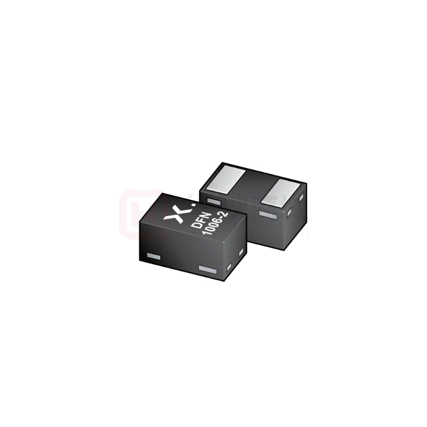

    ESD保护 1通道 VRWM=5 V VBR(Min)=5.5 V VC=3 V IPP=9 A DSN0603-2
PESD5V0C1USF/KYL 数据手册
PESD5V0C1USF Ultra low capacitance unidirectional ESD protection diode 6 May 2015 Product data sheet 1. General description Ultra low capacitance unirectional ElectroStatic Discharge (ESD) protection diode, part of the TrEOS Protection family. This device is housed in a DSN0603-2 (SOD962) leadless ultra small Surface-Mounted Device (SMD) package. The TrEOS Protection family is optimized for safeguarding very sensitive high-speed interfaces against ESD pulses with a high level of robustness. 2. Features and benefits • • • • Unidirectional ESD protection of one line Extremely low diode capacitance Cd = 0.45 pF ESD protection up to ±20 kV according to IEC 61000-4-2 Ultra small SMD package 3. Applications ESD and surge protection for: • • • ultra high-speed datalines very sensitive interface lines generic interface lines in portable electronics, communication, consumer and computing devices. 4. Quick reference data Table 1. Quick reference data Symbol Parameter Conditions Min Typ Max Unit Cd diode capacitance f = 1 MHz; VR = 0 V; Tamb = 25 °C - 0.45 0.5 pF VRWM reverse standoff voltage Tamb = 25 °C - - 5 V PESD5V0C1USF Nexperia Ultra low capacitance unidirectional ESD protection diode 5. Pinning information Table 2. Pinning information Pin Symbol Description 1 K cathode 2 A anode Simplified outline Graphic symbol 1 1 2 2 sym035 Transparent top view DSN0603-2 (SOD962-2) 6. Ordering information Table 3. Ordering information Type number PESD5V0C1USF Package Name Description Version DSN0603-2 Leadless ultra small package; 2 terminals; body 0.6 x 0.3 x 0.3 mm SOD962-2 7. Marking Table 4. Marking codes Type number Marking code PESD5V0C1USF R PESD5V0C1USF Product data sheet All information provided in this document is subject to legal disclaimers. 6 May 2015 © Nexperia B.V. 2017. All rights reserved 2 / 12 PESD5V0C1USF Nexperia Ultra low capacitance unidirectional ESD protection diode 8. Limiting values Table 5. Limiting values In accordance with the Absolute Maximum Rating System (IEC 60134). Symbol Parameter Conditions Min Max Unit IPPM rated peak pulse current tp = 8/20 µs - 9 A Tj junction temperature - 150 °C Tamb ambient temperature -40 125 °C Tstg storage temperature -65 150 °C [1] ESD maximum ratings VESD electrostatic discharge voltage [1] IEC 61000-4-2; contact discharge [1] - 20 kV IEC 61000-4-2; air discharge [1] - 20 kV Device stressed with ten non-repetitive ESD pulses. 001aaa631 001aaa630 120 IPP 100 % 100 % IPP; 8 µs IPP (%) 80 90 % e- t 50 % IPP; 20 µs 40 10 % 0 Fig. 1. 0 10 20 30 t (µs) 8/20 µs pulse waveform according to IEC 61000-4-5 and IEC 61643-321 PESD5V0C1USF Product data sheet t tr = 0.6 ns to 1 ns 40 30 ns 60 ns Fig. 2. ESD pulse waveform according to IEC 61000-4-2 All information provided in this document is subject to legal disclaimers. 6 May 2015 © Nexperia B.V. 2017. All rights reserved 3 / 12 PESD5V0C1USF Nexperia Ultra low capacitance unidirectional ESD protection diode 9. Characteristics Table 6. Characteristics Symbol Parameter Conditions Min Typ Max Unit VRWM reverse standoff voltage Tamb = 25 °C - - 5 V Cd diode capacitance f = 1 MHz; VR = 0 V; Tamb = 25 °C - 0.45 0.5 pF VBR breakdown voltage IR = 1 mA; Tamb = 25 °C 5.5 9 - V VCL clamping voltage Tamb = 25 °C; IPPM = 9 A; tp = 8/20 µs [1] - - 3 V Tamb = 25 °C; IPP = 8 A; tp = TLP [2] - 2.2 - V Tamb = 25 °C; IPP = 16 A; tp = TLP [2] - 3 - V [2] - 0.1 - Ω - 1 50 nA Rdyn dynamic resistance Tamb = 25 °C; IR = 10 A IRM reverse leakage current VRWM = 5 V; Tamb = 25 °C [1] [2] According to IEC 61000-4-5 and IEC 61643-321. Non-repetitive current pulse, Transmission Line Pulse (TLP) tp = 100 ns; square pulse; ANSI / ESD STM5.5.1-2008. I aaa-017822 0.5 Cd (pF) 0.4 0.3 - VCL - VBR - VRWM V - IRM - IR - 0.2 + 0.1 P-N 0.0 - IPP V-I characteristics for unidirectional ESD protection diode PESD5V0C1USF Product data sheet 2 4 6 VR (V) 8 f = 1 MHz; Tamb = 25 °C 006aaa407 Fig. 3. 0 Fig. 4. Diode capacitance as a function of reverse voltage; typical values All information provided in this document is subject to legal disclaimers. 6 May 2015 © Nexperia B.V. 2017. All rights reserved 4 / 12 PESD5V0C1USF Nexperia Ultra low capacitance unidirectional ESD protection diode aaa-017823 0.5 aaa-017824 5 Cd (pF) S21 (dB) 0.4 0 0.3 -5 0.2 -10 0.1 -15 0.0 Fig. 5. 0 2 4 6 f (GHz) -20 10-3 8 Diode capacitance as a function of frequency; typical values Fig. 6. -8 4 -12 0 5 10 15 VCL (V) -16 -20 20 tp = 100 ns; Transmission Line Pulse (TLP) Fig. 7. Dynamic resistance with positive clamping voltage PESD5V0C1USF Product data sheet 102 f (GHz) -4 Rdyn = 0.1 Ω 8 0 10 Rdyn = 0.1 Ω IPP (A) 12 1 aaa-017826 0 IPP (A) 10-1 Insertion loss; typical values aaa-017825 16 10-2 -15 -10 -5 VCL (V) 0 tp = 100 ns; Transmission Line Pulse (TLP) Fig. 8. Dynamic resistance with negative clamping voltage All information provided in this document is subject to legal disclaimers. 6 May 2015 © Nexperia B.V. 2017. All rights reserved 5 / 12 PESD5V0C1USF Nexperia Ultra low capacitance unidirectional ESD protection diode ESD TESTER 4 GHz DIGITAL OSCILLOSCOPE RG 223/U 50 Ω coax Rd 40 dB ATTENUATOR Cs 50 Ω DUT (DEVICE UNDER TEST) IEC 61000-4-2 ed.2 Cs = 150 pF; Rd = 330 Ω 10 2 V (kV) 8 V (kV) 0 6 -2 4 -4 2 -6 0 -8 -2 -10 0 10 20 30 40 50 t (ns) 60 -10 -10 70 unclamped +8 kV ESD pulse waveform (IEC 61000-4-2 network) 0 10 20 30 40 50 t (ns) 60 70 unclamped -8 kV ESD pulse waveform (IEC 61000-4-2 network) aaa-003952 Fig. 9. ESD clamping test setup and waveforms aaa-017827 120 VCL (V) 100 80 -20 60 -40 40 -60 VCL at 30 ns = 2.4 V 20 VCL at 30 ns = 1.9 V -80 0 -20 -10 aaa-017828 20 VCL (V) 0 -100 0 10 20 30 40 50 60 t (ns) -120 -10 70 Fig. 10. Clamped +8 kV pulse waveform (IEC 61000-4-2 network) PESD5V0C1USF Product data sheet 0 10 20 30 40 50 60 t (ns) 70 Fig. 11. Clamped -8 kV pulse waveform (IEC 61000-4-2 network) All information provided in this document is subject to legal disclaimers. 6 May 2015 © Nexperia B.V. 2017. All rights reserved 6 / 12 PESD5V0C1USF Nexperia Ultra low capacitance unidirectional ESD protection diode 10. Application information The device is designed for protection of one unidirectional data or signal line from the damage caused by ESD and surge pulses. The device may be used on lines where the signal polarities are either positive or negative with respect to ground.The device is not designed to be used on lines connected to a DC supply. line to be protected (positive signal polarity) line to be protected (negative signal polarity) ESD protection diode ESD protection diode GND GND unidirectional protection of one line aaa-002440 Fig. 12. Application diagram Circuit board layout and protection device placement Circuit board layout is critical for the suppression of ESD, Electrical Fast Transient (EFT) and surge transients. The following guidelines are recommended: 1. 2. 3. 4. 5. Place the device as close to the input terminal or connector as possible. Minimize the path length between the device and the protected line. Keep parallel signal paths to a minimum. Avoid running protected conductors in parallel with unprotected conductors. Minimize all Printed-Circuit Board (PCB) conductive loops including power and ground loops. 6. Minimize the length of the transient return path to ground. 7. Avoid using shared transient return paths to a common ground point. 8. Use ground planes whenever possible. For multilayer PCBs, use ground vias. PESD5V0C1USF Product data sheet All information provided in this document is subject to legal disclaimers. 6 May 2015 © Nexperia B.V. 2017. All rights reserved 7 / 12 PESD5V0C1USF Nexperia Ultra low capacitance unidirectional ESD protection diode 11. Package outline 0.325 0.275 0.32 0.28 1 0.03 max 0.15 0.13 0.4 0.625 0.575 2 Dimensions in mm 0.25 0.23 14-12-03 Fig. 13. Package outline DSN0603-2 (SOD962-2) 12. Soldering Footprint information for reflow soldering of leadless ultra small package; 2 terminals SOD962-2 0.85 0.4 0.4 R0.025 (8×) 0.24 (2×) 0.14 (2×) 0.2 (2×) solder land solder land plus solder paste solder paste deposit solder resist Dimensions in mm sod962-2_fr Fig. 14. Reflow soldering footprint for DSN0603-2 (SOD962-2) PESD5V0C1USF Product data sheet All information provided in this document is subject to legal disclaimers. 6 May 2015 © Nexperia B.V. 2017. All rights reserved 8 / 12 PESD5V0C1USF Nexperia Ultra low capacitance unidirectional ESD protection diode 13. Revision history Table 7. Revision history Data sheet ID Release date Data sheet status Change notice Supersedes PESD5V0C1USF v.2 20150506 Product data sheet - PESD5V0C1USF v.1 Modifications: • PESD5V0C1USF v.1 20150424 - - PESD5V0C1USF Product data sheet Product status changed Preliminary data sheet All information provided in this document is subject to legal disclaimers. 6 May 2015 © Nexperia B.V. 2017. All rights reserved 9 / 12 PESD5V0C1USF Nexperia Ultra low capacitance unidirectional ESD protection diode In no event shall Nexperia be liable for any indirect, incidental, punitive, special or consequential damages (including - without limitation lost profits, lost savings, business interruption, costs related to the removal or replacement of any products or rework charges) whether or not such damages are based on tort (including negligence), warranty, breach of contract or any other legal theory. 14. Legal information 14.1 Data sheet status Notwithstanding any damages that customer might incur for any reason whatsoever, Nexperia’s aggregate and cumulative liability towards customer for the products described herein shall be limited in accordance with the Terms and conditions of commercial sale of Nexperia. Document status [1][2] Product status [3] Objective [short] data sheet Development This document contains data from the objective specification for product development. Preliminary [short] data sheet Qualification This document contains data from the preliminary specification. Product [short] data sheet Production This document contains the product specification. [1] [2] [3] Definition Right to make changes — Nexperia reserves the right to make changes to information published in this document, including without limitation specifications and product descriptions, at any time and without notice. This document supersedes and replaces all information supplied prior to the publication hereof. Please consult the most recently issued document before initiating or completing a design. The term 'short data sheet' is explained in section "Definitions". The product status of device(s) described in this document may have changed since this document was published and may differ in case of multiple devices. The latest product status information is available on the Internet at URL http://www.nexperia.com. 14.2 Definitions Preview — The document is a preview version only. The document is still subject to formal approval, which may result in modifications or additions. Nexperia does not give any representations or warranties as to the accuracy or completeness of information included herein and shall have no liability for the consequences of use of such information. Draft — The document is a draft version only. The content is still under internal review and subject to formal approval, which may result in modifications or additions. Nexperia does not give any representations or warranties as to the accuracy or completeness of information included herein and shall have no liability for the consequences of use of such information. Short data sheet — A short data sheet is an extract from a full data sheet with the same product type number(s) and title. A short data sheet is intended for quick reference only and should not be relied upon to contain detailed and full information. For detailed and full information see the relevant full data sheet, which is available on request via the local Nexperia sales office. In case of any inconsistency or conflict with the short data sheet, the full data sheet shall prevail. Product specification — The information and data provided in a Product data sheet shall define the specification of the product as agreed between Nexperia and its customer, unless Nexperia and customer have explicitly agreed otherwise in writing. In no event however, shall an agreement be valid in which the Nexperia product is deemed to offer functions and qualities beyond those described in the Product data sheet. 14.3 Disclaimers Limited warranty and liability — Information in this document is believed to be accurate and reliable. However, Nexperia does not give any representations or warranties, expressed or implied, as to the accuracy or completeness of such information and shall have no liability for the consequences of use of such information. Nexperia takes no responsibility for the content in this document if provided by an information source outside of Nexperia. PESD5V0C1USF Product data sheet Suitability for use — Nexperia products are not designed, authorized or warranted to be suitable for use in life support, life-critical or safety-critical systems or equipment, nor in applications where failure or malfunction of a Nexperia product can reasonably be expected to result in personal injury, death or severe property or environmental damage. Nexperia and its suppliers accept no liability for inclusion and/or use of Nexperia products in such equipment or applications and therefore such inclusion and/or use is at the customer’s own risk. Quick reference data — The Quick reference data is an extract of the product data given in the Limiting values and Characteristics sections of this document, and as such is not complete, exhaustive or legally binding. Applications — Applications that are described herein for any of these products are for illustrative purposes only. Nexperia makes no representation or warranty that such applications will be suitable for the specified use without further testing or modification. Customers are responsible for the design and operation of their applications and products using Nexperia products, and Nexperia accepts no liability for any assistance with applications or customer product design. It is customer’s sole responsibility to determine whether the Nexperia product is suitable and fit for the customer’s applications and products planned, as well as for the planned application and use of customer’s third party customer(s). Customers should provide appropriate design and operating safeguards to minimize the risks associated with their applications and products. Nexperia does not accept any liability related to any default, damage, costs or problem which is based on any weakness or default in the customer’s applications or products, or the application or use by customer’s third party customer(s). Customer is responsible for doing all necessary testing for the customer’s applications and products using Nexperia products in order to avoid a default of the applications and the products or of the application or use by customer’s third party customer(s). Nexperia does not accept any liability in this respect. Limiting values — Stress above one or more limiting values (as defined in the Absolute Maximum Ratings System of IEC 60134) will cause permanent damage to the device. Limiting values are stress ratings only and (proper) operation of the device at these or any other conditions above those given in the Recommended operating conditions section (if present) or the Characteristics sections of this document is not warranted. Constant or repeated exposure to limiting values will permanently and irreversibly affect the quality and reliability of the device. Terms and conditions of commercial sale — Nexperia products are sold subject to the general terms and conditions of commercial sale, as published at http://www.nexperia.com/profile/terms, unless otherwise agreed in a valid written individual agreement. In case an individual agreement is concluded only the terms and conditions of the respective agreement shall apply. Nexperia hereby expressly objects to applying the customer’s general terms and conditions with regard to the purchase of Nexperia products by customer. No offer to sell or license — Nothing in this document may be interpreted or construed as an offer to sell products that is open for acceptance or the All information provided in this document is subject to legal disclaimers. 6 May 2015 © Nexperia B.V. 2017. All rights reserved 10 / 12 PESD5V0C1USF Nexperia Ultra low capacitance unidirectional ESD protection diode grant, conveyance or implication of any license under any copyrights, patents or other industrial or intellectual property rights. Export control — This document as well as the item(s) described herein may be subject to export control regulations. Export might require a prior authorization from competent authorities. Non-automotive qualified products — Unless this data sheet expressly states that this specific Nexperia product is automotive qualified, the product is not suitable for automotive use. It is neither qualified nor tested in accordance with automotive testing or application requirements. Nexperia accepts no liability for inclusion and/or use of nonautomotive qualified products in automotive equipment or applications. In the event that customer uses the product for design-in and use in automotive applications to automotive specifications and standards, customer (a) shall use the product without Nexperia’s warranty of the product for such automotive applications, use and specifications, and (b) whenever customer uses the product for automotive applications beyond Nexperia’s specifications such use shall be solely at customer’s own risk, and (c) customer fully indemnifies Nexperia for any liability, damages or failed product claims resulting from customer design and use of the product for automotive applications beyond Nexperia’s standard warranty and Nexperia’s product specifications. Translations — A non-English (translated) version of a document is for reference only. The English version shall prevail in case of any discrepancy between the translated and English versions. 14.4 Trademarks Notice: All referenced brands, product names, service names and trademarks are the property of their respective owners. PESD5V0C1USF Product data sheet All information provided in this document is subject to legal disclaimers. 6 May 2015 © Nexperia B.V. 2017. All rights reserved 11 / 12 PESD5V0C1USF Nexperia Ultra low capacitance unidirectional ESD protection diode 15. Contents 1 General description ............................................... 1 2 Features and benefits ............................................1 3 Applications ........................................................... 1 4 Quick reference data ............................................. 1 5 Pinning information ............................................... 2 6 Ordering information ............................................. 2 7 Marking ................................................................... 2 8 Limiting values .......................................................3 9 Characteristics ....................................................... 4 10 Application information .........................................7 11 Package outline ..................................................... 8 12 Soldering ................................................................ 8 13 Revision history ..................................................... 9 14 14.1 14.2 14.3 14.4 Legal information .................................................10 Data sheet status ............................................... 10 Definitions ...........................................................10 Disclaimers .........................................................10 Trademarks ........................................................ 11 © Nexperia B.V. 2017. All rights reserved For more information, please visit: http://www.nexperia.com For sales office addresses, please send an email to: salesaddresses@nexperia.com Date of release: 06 May 2015 PESD5V0C1USF Product data sheet All information provided in this document is subject to legal disclaimers. 6 May 2015 © Nexperia B.V. 2017. All rights reserved 12 / 12 Mouser Electronics Authorized Distributor Click to View Pricing, Inventory, Delivery & Lifecycle Information: Nexperia: PESD5V0C1USFYL PESD5V0C1USF/KYL
