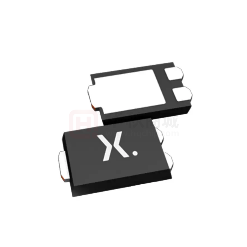

PMEG030V050EPDZ
PMEG030V050EPDZ
    NEXPERIA(安世)
    SOT1289(CFP15)
    直流反向耐压(Vr):30V 平均整流电流(Io):5A 正向压降(Vf):500mV@5A
PMEG030V050EPDZ 数据手册
PMEG030V050EPD 30 V, 5 A low VF MEGA Schottky barrier rectifier 12 August 2016 Product data sheet 1. General description Planar Maximum Efficiency General Application (MEGA) Schottky barrier rectifier with an integrated guard ring for stress protection, encapsulated in a CFP15 (SOT1289) power and flat lead Surface-Mounted Device (SMD) plastic package. 2. Features and benefits • • • • • • Average forward current: IF(AV) ≤ 5 A Reverse voltage: VR ≤ 30 V Extremely low forward voltage High power capability due to clip-bonding technology and heat sink Small and thin SMD power plastic package, typical height 0.78 mm AEC-Q101 qualified 3. Applications • • • • • • Low voltage rectification High efficiency DC-to-DC conversion Switch mode power supply Freewheeling application Reverse polarity protection Low power consumption application 4. Quick reference data Table 1. Quick reference data Symbol Parameter Conditions Min Typ Max Unit IF(AV) average forward current square wave; δ = 0.5 ; f = 20 kHz; Tsp ≤ 163 °C - - 5 A VR reverse voltage Tj = 25 °C - - 30 V VF forward voltage IF = 5 A; tp ≤ 300 µs; δ ≤ 0.02 ; Tj = 25 °C - 440 500 mV IR reverse current VR = 10 V; Tj = 25 °C; pulsed [1] - 9 30 µA VR = 30 V; Tj = 25 °C; pulsed [1] - 45 150 µA [1] Very short test pulse to prevent junction self heating PMEG030V050EPD Nexperia 30 V, 5 A low VF MEGA Schottky barrier rectifier 5. Pinning information Table 2. Pinning information Pin Symbol Description 1 A anode 2 A anode 3 K cathode Simplified outline Graphic symbol A A K 1 3 aaa-009063 2 CFP15 (SOT1289) 6. Ordering information Table 3. Ordering information Type number PMEG030V050EPD Package Name Description Version CFP15 plastic, thermal enhanced ultra thin SMD package; 3 leads; body: 5.8 x 4.3 x 0.78 mm SOT1289 7. Marking Table 4. Marking codes Type number Marking code PMEG030V050EPD 030V U05E PMEG030V050EPD Product data sheet All information provided in this document is subject to legal disclaimers. 12 August 2016 © Nexperia B.V. 2017. All rights reserved 2 / 13 PMEG030V050EPD Nexperia 30 V, 5 A low VF MEGA Schottky barrier rectifier 8. Limiting values Table 5. Limiting values In accordance with the Absolute Maximum Rating System (IEC 60134). Symbol Parameter Conditions Min Max Unit VR reverse voltage Tj = 25 °C - 30 V IF forward current Tsp ≤ 161 °C; δ = 1 - 7 A IF(AV) average forward current square wave; δ = 0.5 ; f = 20 kHz; Tsp ≤ 163 °C - 5 A IFSM non-repetitive peak forward current square wave; tp = 8 ms; Tj(init) = 25 °C - 120 A Ptot total power dissipation Tamb ≤ 25 °C [1] - 1.66 W [2] - 2.15 W Tj junction temperature - 175 °C Tamb ambient temperature -55 175 °C Tstg storage temperature -65 175 °C [1] [2] Device mounted on an FR4 PCB, single-sided copper, tin-plated and standard footprint. 2 Device mounted on an FR4 PCB, single-sided copper, tin-plated, mounting pad for cathode 1 cm . 9. Thermal characteristics Table 6. Thermal characteristics Symbol Parameter Conditions Rth(j-a) thermal resistance from junction to ambient in free air Rth(j-sp) [1] [2] [3] [4] thermal resistance from junction to solder point Min Typ Max Unit [1][2] - - 90 K/W [1][3] - - 70 K/W [4] - - 3 K/W For Schottky barrier diodes thermal runaway has to be considered, as in some applications the reverse power losses PR are a significant part of the total power losses. Device mounted on an FR4 PCB, single-sided copper, tin-plated and standard footprint. 2 Device mounted on an FR4 PCB, single-sided copper, tin-plated, mounting pad for cathode 1 cm . Soldering point of cathode tab. PMEG030V050EPD Product data sheet All information provided in this document is subject to legal disclaimers. 12 August 2016 © Nexperia B.V. 2017. All rights reserved 3 / 13 PMEG030V050EPD Nexperia 30 V, 5 A low VF MEGA Schottky barrier rectifier aaa-022836 102 1 Zth(j-a) (K/W) 0.5 0.25 10 0.75 0.33 0.2 0.1 0.05 0.02 0.01 1 duty cycle = 0 10-1 10-3 10-2 10-1 1 10 102 tp (s) 103 FR4 PCB, standard footprint Fig. 1. Transient thermal impedance from junction to ambient as a function of pulse duration; typical values aaa-022837 102 1 Zth(j-a) (K/W) 0.5 0.25 10 0.75 0.33 0.2 0.1 0.05 0.02 1 0.01 duty cycle = 0 10-1 10-3 10-2 10-1 FR4 PCB, mounting pad for cathode 1 cm Fig. 2. 1 10 102 tp (s) 2 103 Transient thermal impedance from junction to ambient as a function of pulse duration; typical values PMEG030V050EPD Product data sheet All information provided in this document is subject to legal disclaimers. 12 August 2016 © Nexperia B.V. 2017. All rights reserved 4 / 13 PMEG030V050EPD Nexperia 30 V, 5 A low VF MEGA Schottky barrier rectifier 10. Characteristics Table 7. Characteristics Symbol Parameter Conditions V(BR)R reverse breakdown voltage IR = 3 mA; Tj = 25 °C; pulsed VF forward voltage IR reverse current Cd [1] Typ Max Unit 30 - - V IF = 0.1 A; tp ≤ 300 µs; δ ≤ 0.02 ; Tj = 25 °C - 280 320 mV IF = 1 A; tp ≤ 300 µs; δ ≤ 0.02 ; Tj = 25 °C - 350 400 mV IF = 1.5 A; tp ≤ 300 µs; δ ≤ 0.02 ; Tj = 25 °C - 365 420 mV IF = 2 A; tp ≤ 300 µs; δ ≤ 0.02 ; Tj = 25 °C - 380 440 mV IF = 3 A; tp ≤ 300 µs; δ ≤ 0.02 ; Tj = 25 °C - 400 450 mV IF = 5 A; tp ≤ 300 µs; δ ≤ 0.02 ; Tj = 25 °C - 440 500 mV IF = 5 A; tp ≤ 300 µs; δ ≤ 0.02 ; Tj = -40 °C - 500 - mV IF = 5 A; tp ≤ 300 µs; δ ≤ 0.02 ; Tj = 125 °C - 360 - mV [1] VR = 5 V; Tj = 25 °C; pulsed [1] - 6 15 µA VR = 10 V; Tj = 25 °C; pulsed [1] - 9 30 µA VR = 30 V; Tj = 25 °C; pulsed [1] - 45 150 µA VR = 30 V; Tj = 125 °C; pulsed [1] - 22 - mA VR = 1 V; f = 1 MHz; Tj = 25 °C - 495 - pF VR = 4 V; f = 1 MHz; Tj = 25 °C - 265 - pF VR = 10 V; f = 1 MHz; Tj = 25 °C - 165 - pF reverse recovery time step recovery IF = 0.5 A; IR = 0.5 A; IR(meas) = 0.1 A; Tj = 25 °C - 16 - ns reverse recovery time ramp recovery dIF/dt = 200 A/µs; Tj = 25 °C; IF = 6 A; VR = 26 V - 12 - ns diode capacitance trr Min Very short test pulse to prevent junction self heating PMEG030V050EPD Product data sheet All information provided in this document is subject to legal disclaimers. 12 August 2016 © Nexperia B.V. 2017. All rights reserved 5 / 13 PMEG030V050EPD Nexperia 30 V, 5 A low VF MEGA Schottky barrier rectifier aaa-024043 102 IR (A) IF (A) 10 aaa-023999 1 10-1 (1) (2) 10-2 (3) 10-3 1 (4) 10-4 (1) 10-1 (2) (3) (4) (5) (5) 10-5 (6) 10-6 (6) 10-7 10-2 10-8 10-3 0 0.1 0.2 0.3 0.4 0.5 10-9 0.6 0.7 VF (V) pulsed condition (1) Tj = 150 °C (2) Tj = 125 °C (3) Tj = 100 °C (4) Tj = 85 °C (5) Tj = 25 °C (6) Tj = -40 °C Fig. 3. 0 10 20 VR (V) 30 pulsed condition (1) Tj = 150 °C (2) Tj = 125 °C (3) Tj = 100 °C (4) Tj = 85 °C (5) Tj = 25 °C (6) Tj = −40 °C Forward current as a function of forward voltage; typical values Fig. 4. aaa-024000 1000 Reverse current as a function of reverse voltage; typical values aaa-024044 3.5 PF(AV) (W) 3.0 Cd (pF) 800 (5) (4) (3) 2.5 600 (2) 2.0 (1) 1.5 400 1.0 200 0.5 0 0 10 20 VR (V) 0 30 f = 1 MHz; Tamb = 25 °C Fig. 5. Fig. 6. Product data sheet 2 4 6 IF(AV) (A) 8 Tj = 100 °C (1) δ = 0.1 (2) δ = 0.2 (3) δ = 0.5 (4) δ = 0.8 (5) δ = 1 Diode capacitance as a function of reverse voltage; typical values PMEG030V050EPD 0 Average forward power dissipation as a function of average forward current; typical values All information provided in this document is subject to legal disclaimers. 12 August 2016 © Nexperia B.V. 2017. All rights reserved 6 / 13 PMEG030V050EPD Nexperia 30 V, 5 A low VF MEGA Schottky barrier rectifier aaa-024002 0.20 PR(AV) (W) IF(AV) (A) (1) 0.15 aaa-024045 8 (1) 6 (2) (2) (3) 0.10 4 (3) (4) (4) 0.05 2 (5) 0 0 10 20 VR (V) 0 30 Tj = 100 °C (1) δ = 1 (2) δ = 0.9 (3) δ = 0.8 (4) δ = 0.5 (5) δ = 0.2 Fig. 7. Fig. 8. aaa-024046 8 150 200 Tamb (°C) (1) Average forward current as a function of ambient temperature; typical values aaa-024047 (1) IF(AV) (A) 6 (2) (2) 4 4 (3) (3) (4) (4) 2 2 0 50 100 Average forward current as a function of ambient temperature; typical values PMEG030V050EPD Product data sheet 0 150 200 Tamb (°C) 2 FR4 PCB, mounting pad for cathode 1 cm Tj = 175 °C (1) δ = 1; DC (2) δ = 0.5; f = 20 kHz (3) δ = 0.2; f = 20 kHz (4) δ = 0.1; f = 20 kHz Fig. 9. 100 8 6 0 50 FR4 PCB, standard footprint Tj = 175 °C (1) δ = 1; DC (2) δ = 0.5; f = 20 kHz (3) δ = 0.2; f = 20 kHz (4) δ = 0.1; f = 20 kHz Average reverse power dissipation as a function of reverse voltage; typical values IF(AV) (A) 0 0 50 100 150 Tsp (°C) 200 Tj = 175 °C (1) δ = 1; DC (2) δ = 0.5; f = 20 kHz (3) δ = 0.2; f = 20 kHz (4) δ = 0.1; f = 20 kHz Fig. 10. Average forward current as a function of solder point temperature; typical values All information provided in this document is subject to legal disclaimers. 12 August 2016 © Nexperia B.V. 2017. All rights reserved 7 / 13 PMEG030V050EPD Nexperia 30 V, 5 A low VF MEGA Schottky barrier rectifier 11. Test information IF IR(meas) time IR trr 006aad022 Fig. 11. Reverse recovery definition; step recovery IF dlF dt trr time 25 % 100 % Qr IR IRM 003aac562 Fig. 12. Reverse recovery definition; ramp recovery P t2 duty cycle δ = t1 t2 t1 t 006aaa812 Fig. 13. Duty cycle definition The current ratings for the typical waveforms are calculated according to the equations: IF(AV) = IM × δ with IM defined as peak current, IRMS = IF(AV) at DC, and IRMS = IM × √δ with IRMS defined as RMS current. PMEG030V050EPD Product data sheet All information provided in this document is subject to legal disclaimers. 12 August 2016 © Nexperia B.V. 2017. All rights reserved 8 / 13 PMEG030V050EPD Nexperia 30 V, 5 A low VF MEGA Schottky barrier rectifier Quality information This product has been qualified in accordance with the Automotive Electronics Council (AEC) standard Q101 - Stress test qualification for discrete semiconductors, and is suitable for use in automotive applications. 12. Package outline 4.4 4.2 2.13 1.3 1.1 0.45 0.25 2 4.8 4.4 0.82 0.74 1.3 0.9 1 5.9 5.7 4.2 3.8 0.45 0.25 3 2.15 1.95 0.24 0.16 3.5 3.1 Dimensions in mm 6.6 6.4 14-10-13 Fig. 14. Package outline CFP15 (SOT1289) 13. Soldering Footprint information for reflow soldering of CFP15 package SOT1289 4.6 3.73 1.4 (2×) 1.8 (2×) 1.6 (2×) 2.13 1.64 1.44 1.34 0.6 0.4 0.11 1.9 7.5 1.02 5.16 4.96 0.2 1.9 occupied area solder resist solder lands solder paste Issue date 13-08-28 14-03-12 0.2 0.05 0.6 1.7 (4×) 0.2 2.4 3.8 4 Dimensions in mm sot1289_fr Fig. 15. Reflow soldering footprint for CFP15 (SOT1289) PMEG030V050EPD Product data sheet All information provided in this document is subject to legal disclaimers. 12 August 2016 © Nexperia B.V. 2017. All rights reserved 9 / 13 PMEG030V050EPD Nexperia 30 V, 5 A low VF MEGA Schottky barrier rectifier 14. Revision history Table 8. Revision history Data sheet ID Release date Data sheet status Change notice Supersedes PMEG030V050EPD v.1 20160812 Product data sheet - - PMEG030V050EPD Product data sheet All information provided in this document is subject to legal disclaimers. 12 August 2016 © Nexperia B.V. 2017. All rights reserved 10 / 13 PMEG030V050EPD Nexperia 30 V, 5 A low VF MEGA Schottky barrier rectifier Notwithstanding any damages that customer might incur for any reason whatsoever, Nexperia’s aggregate and cumulative liability towards customer for the products described herein shall be limited in accordance with the Terms and conditions of commercial sale of Nexperia. 15. Legal information Right to make changes — Nexperia reserves the right to make changes to information published in this document, including without limitation specifications and product descriptions, at any time and without notice. This document supersedes and replaces all information supplied prior to the publication hereof. Data sheet status Document status [1][2] Product status [3] Objective [short] data sheet Development This document contains data from the objective specification for product development. Preliminary [short] data sheet Qualification This document contains data from the preliminary specification. Product [short] data sheet Production This document contains the product specification. [1] [2] [3] Definition Suitability for use in automotive applications — This Nexperia product has been qualified for use in automotive applications. Unless otherwise agreed in writing, the product is not designed, authorized or warranted to be suitable for use in life support, life-critical or safety-critical systems or equipment, nor in applications where failure or malfunction of a Nexperia product can reasonably be expected to result in personal injury, death or severe property or environmental damage. Nexperia and its suppliers accept no liability for inclusion and/or use of Nexperia products in such equipment or applications and therefore such inclusion and/or use is at the customer's own risk. Please consult the most recently issued document before initiating or completing a design. The term 'short data sheet' is explained in section "Definitions". The product status of device(s) described in this document may have changed since this document was published and may differ in case of multiple devices. The latest product status information is available on the Internet at URL http://www.nexperia.com. Definitions Preview — The document is a preview version only. The document is still subject to formal approval, which may result in modifications or additions. Nexperia does not give any representations or warranties as to the accuracy or completeness of information included herein and shall have no liability for the consequences of use of such information. Draft — The document is a draft version only. The content is still under internal review and subject to formal approval, which may result in modifications or additions. Nexperia does not give any representations or warranties as to the accuracy or completeness of information included herein and shall have no liability for the consequences of use of such information. Short data sheet — A short data sheet is an extract from a full data sheet with the same product type number(s) and title. A short data sheet is intended for quick reference only and should not be relied upon to contain detailed and full information. For detailed and full information see the relevant full data sheet, which is available on request via the local Nexperia sales office. In case of any inconsistency or conflict with the short data sheet, the full data sheet shall prevail. Product specification — The information and data provided in a Product data sheet shall define the specification of the product as agreed between Nexperia and its customer, unless Nexperia and customer have explicitly agreed otherwise in writing. In no event however, shall an agreement be valid in which the Nexperia product is deemed to offer functions and qualities beyond those described in the Product data sheet. Disclaimers Limited warranty and liability — Information in this document is believed to be accurate and reliable. However, Nexperia does not give any representations or warranties, expressed or implied, as to the accuracy or completeness of such information and shall have no liability for the consequences of use of such information. Nexperia takes no responsibility for the content in this document if provided by an information source outside of Nexperia. In no event shall Nexperia be liable for any indirect, incidental, punitive, special or consequential damages (including - without limitation lost profits, lost savings, business interruption, costs related to the removal or replacement of any products or rework charges) whether or not such damages are based on tort (including negligence), warranty, breach of contract or any other legal theory. PMEG030V050EPD Product data sheet Quick reference data — The Quick reference data is an extract of the product data given in the Limiting values and Characteristics sections of this document, and as such is not complete, exhaustive or legally binding. Applications — Applications that are described herein for any of these products are for illustrative purposes only. Nexperia makes no representation or warranty that such applications will be suitable for the specified use without further testing or modification. Customers are responsible for the design and operation of their applications and products using Nexperia products, and Nexperia accepts no liability for any assistance with applications or customer product design. It is customer’s sole responsibility to determine whether the Nexperia product is suitable and fit for the customer’s applications and products planned, as well as for the planned application and use of customer’s third party customer(s). Customers should provide appropriate design and operating safeguards to minimize the risks associated with their applications and products. Nexperia does not accept any liability related to any default, damage, costs or problem which is based on any weakness or default in the customer’s applications or products, or the application or use by customer’s third party customer(s). Customer is responsible for doing all necessary testing for the customer’s applications and products using Nexperia products in order to avoid a default of the applications and the products or of the application or use by customer’s third party customer(s). Nexperia does not accept any liability in this respect. Limiting values — Stress above one or more limiting values (as defined in the Absolute Maximum Ratings System of IEC 60134) will cause permanent damage to the device. Limiting values are stress ratings only and (proper) operation of the device at these or any other conditions above those given in the Recommended operating conditions section (if present) or the Characteristics sections of this document is not warranted. Constant or repeated exposure to limiting values will permanently and irreversibly affect the quality and reliability of the device. Terms and conditions of commercial sale — Nexperia products are sold subject to the general terms and conditions of commercial sale, as published at http://www.nexperia.com/profile/terms, unless otherwise agreed in a valid written individual agreement. In case an individual agreement is concluded only the terms and conditions of the respective agreement shall apply. Nexperia hereby expressly objects to applying the customer’s general terms and conditions with regard to the purchase of Nexperia products by customer. No offer to sell or license — Nothing in this document may be interpreted or construed as an offer to sell products that is open for acceptance or the grant, conveyance or implication of any license under any copyrights, patents or other industrial or intellectual property rights. Export control — This document as well as the item(s) described herein may be subject to export control regulations. Export might require a prior authorization from competent authorities. Translations — A non-English (translated) version of a document is for reference only. The English version shall prevail in case of any discrepancy between the translated and English versions. All information provided in this document is subject to legal disclaimers. 12 August 2016 © Nexperia B.V. 2017. All rights reserved 11 / 13 PMEG030V050EPD Nexperia 30 V, 5 A low VF MEGA Schottky barrier rectifier Trademarks Notice: All referenced brands, product names, service names and trademarks are the property of their respective owners. PMEG030V050EPD Product data sheet All information provided in this document is subject to legal disclaimers. 12 August 2016 © Nexperia B.V. 2017. All rights reserved 12 / 13 PMEG030V050EPD Nexperia 30 V, 5 A low VF MEGA Schottky barrier rectifier 16. Contents 1. General description......................................................1 2. Features and benefits.................................................. 1 3. Applications.................................................................. 1 4. Quick reference data....................................................1 5. Pinning information......................................................2 6. Ordering information....................................................2 7. Marking.......................................................................... 2 8. Limiting values............................................................. 3 9. Thermal characteristics............................................... 3 10. Characteristics............................................................ 5 11. Test information......................................................... 8 12. Package outline.......................................................... 9 13. Soldering..................................................................... 9 14. Revision history........................................................10 15. Legal information..................................................... 11 © Nexperia B.V. 2017. All rights reserved For more information, please visit: http://www.nexperia.com For sales office addresses, please send an email to: salesaddresses@nexperia.com Date of release: 12 August 2016 PMEG030V050EPD Product data sheet All information provided in this document is subject to legal disclaimers. 12 August 2016 © Nexperia B.V. 2017. All rights reserved 13 / 13
