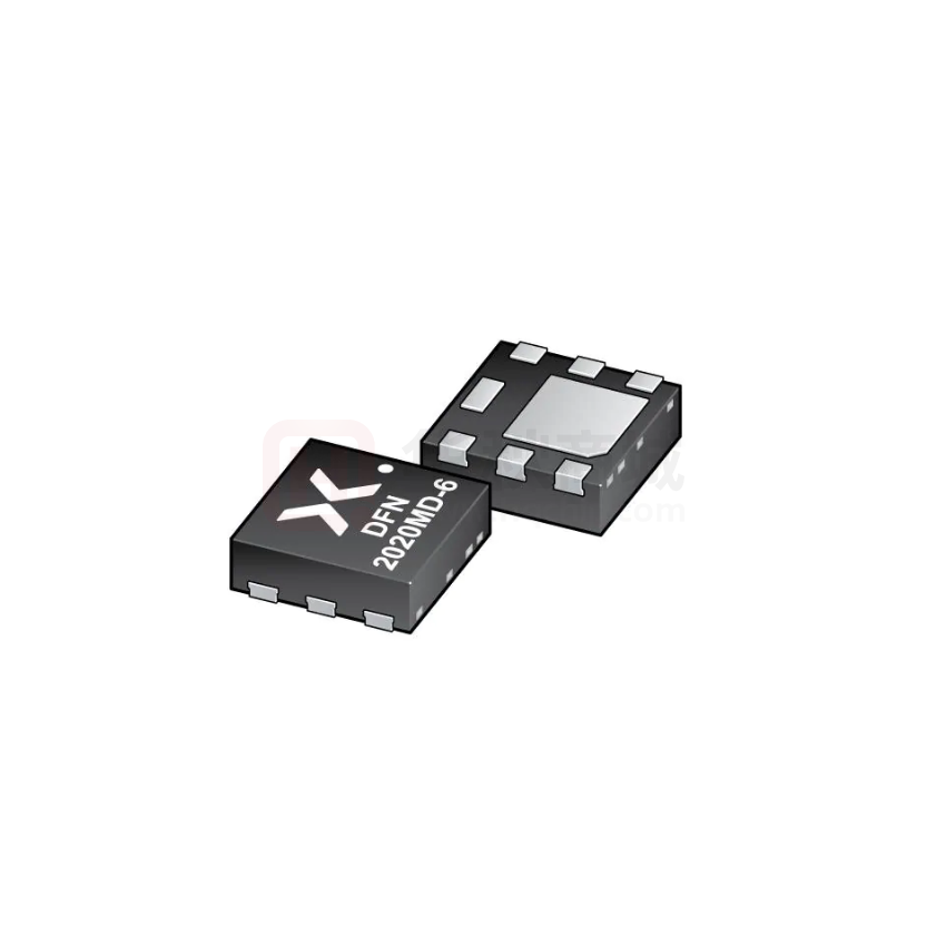

    MOS管 N-channel Id=8A VDS=30V DFN2020MD-6
PMPB13XNEAX 数据手册
PMPB13XNEA 30 V, N-channel Trench MOSFET 10 September 2018 Product data sheet 1. General description N-channel enhancement mode Field-Effect Transistor (FET) in a leadless medium power DFN2020MD-6 (SOT1220) Surface-Mounted Device (SMD) plastic package using Trench MOSFET technology. 2. Features and benefits • • • • • Low threshold voltage Trench MOSFET technology Side wettable flanks for optical solder inspection ElectroStatic Discharge (ESD) protection > 1 kV HBM (class H1C) AEC-Q101 qualified 3. Applications • • • • Relay driver High-speed line driver Low-side load switch Switching circuits 4. Quick reference data Table 1. Quick reference data Symbol Parameter Conditions Min Typ Max Unit VDS drain-source voltage Tj = 25 °C - - 30 V VGS gate-source voltage -8 - 8 V ID drain current - - 8 A - 13 16 mΩ VGS = 4.5 V; Tamb = 25 °C [1] Static characteristics RDSon [1] drain-source on-state resistance VGS = 4.5 V; ID = 8 A; Tj = 25 °C 2 Device mounted on an FR4 PCB, single-sided copper, tin-plated, mounting pad for drain 6 cm . PMPB13XNEA Nexperia 30 V, N-channel Trench MOSFET 5. Pinning information Table 2. Pinning information Pin Symbol Description 1 D drain 2 D drain Simplified outline 1 3 G gate 2 4 S source 3 5 D drain 6 D drain 7 D drain 8 S source Graphic symbol D 6 7 5 G 8 4 Transparent top view DFN2020MD-6 (SOT1220) S 017aaa255 6. Ordering information Table 3. Ordering information Type number Package Name PMPB13XNEA Description Version DFN2020MD-6 DFN2020MD-6: plastic thermal enhanced ultra thin small outline package; no leads; 6 terminals SOT1220 7. Marking Table 4. Marking codes Type number Marking code PMPB13XNEA 4G PMPB13XNEA Product data sheet All information provided in this document is subject to legal disclaimers. 10 September 2018 © Nexperia B.V. 2018. All rights reserved 2 / 14 PMPB13XNEA Nexperia 30 V, N-channel Trench MOSFET 8. Limiting values Table 5. Limiting values In accordance with the Absolute Maximum Rating System (IEC 60134). Symbol Parameter Conditions Min Max Unit VDS drain-source voltage Tj = 25 °C - 30 V VGS gate-source voltage -8 8 V ID drain current VGS = 4.5 V; Tamb = 25 °C [1] - 8 A VGS = 4.5 V; Tamb = 100 °C [1] - 5 A - 32 A - 1.7 W - 12.5 W IDM peak drain current Tamb = 25 °C; single pulse; tp ≤ 10 µs Ptot total power dissipation Tamb = 25 °C [1] Tsp = 25 °C Tj junction temperature -55 150 °C Tamb ambient temperature -55 150 °C Tstg storage temperature -65 150 °C - 2 A - 1000 V - 21.3 mJ Source-drain diode IS source current Tamb = 25 °C [1] ESD maximum rating VESD electrostatic discharge voltage HBM Avalanche ruggedness EDS(AL)S [1] non-repetitive drainTj(init) = 25 °C; ID = 1.35 A; DUT in source avalanche energy avalanche (unclamped) 2 Device mounted on an FR4 PCB, single-sided copper, tin-plated, mounting pad for drain 6 cm . 017aaa123 120 Pder (%) Ider (%) 80 80 40 40 0 - 75 Fig. 1. 017aaa124 120 - 25 25 75 125 Tj (°C) Normalized total power dissipation as a function of junction temperature PMPB13XNEA Product data sheet 0 - 75 175 Fig. 2. - 25 75 125 Tj (°C) 175 Normalized continuous drain current as a function of junction temperature All information provided in this document is subject to legal disclaimers. 10 September 2018 25 © Nexperia B.V. 2018. All rights reserved 3 / 14 PMPB13XNEA Nexperia 30 V, N-channel Trench MOSFET 102 ID (A) 017aaa950 Limit RDSon = VDS/ID tp = 10 µs 10 tp = 100 µs tp = 1 ms 1 tp = 10 ms DC; Tsp = 25 °C 10-1 tp = 100 ms DC; Tamb = 25 °C; drain mounting pad 6 cm2 10-2 10-2 10-1 1 10 VDS (V) 102 IDM = single pulse Fig. 3. Safe operating area; junction to ambient; continuous and peak drain currents as a function of drainsource voltage PMPB13XNEA Product data sheet All information provided in this document is subject to legal disclaimers. 10 September 2018 © Nexperia B.V. 2018. All rights reserved 4 / 14 PMPB13XNEA Nexperia 30 V, N-channel Trench MOSFET 9. Thermal characteristics Table 6. Thermal characteristics Symbol Parameter Rth(j-a) thermal resistance from in free air junction to ambient Rth(j-sp) [1] [2] Conditions Min Typ Max Unit [1] - 235 270 K/W [2] - 67 74 K/W - 5 10 K/W thermal resistance from junction to solder point Device mounted on an FR4 PCB, single-sided copper, tin-plated and standard footprint. 2 Device mounted on an FR4 PCB, single-sided copper, tin-plated, mounting pad for drain 6 cm . 017aaa542 103 Zth(j-a) (K/W) duty cycle = 1 0.75 102 0.33 0.2 0.5 0.25 0.1 0.05 10 0.01 0.02 0 1 10-3 10-2 10-1 1 10 102 tp (s) 103 FR4 PCB, standard footprint Fig. 4. Transient thermal impedance from junction to ambient as a function of pulse duration; typical values 017aaa543 103 Zth(j-a) (K/W) 102 duty cycle = 1 0.75 0.33 10 0.2 0.5 0.25 0.1 0.05 0 1 10-3 0.02 0.01 10-2 10-1 FR4 PCB, mounting pad for drain 6 cm Fig. 5. 1 10 102 tp (s) 2 103 Transient thermal impedance from junction to ambient as a function of pulse duration; typical values PMPB13XNEA Product data sheet All information provided in this document is subject to legal disclaimers. 10 September 2018 © Nexperia B.V. 2018. All rights reserved 5 / 14 PMPB13XNEA Nexperia 30 V, N-channel Trench MOSFET 10. Characteristics Table 7. Characteristics Symbol Parameter Conditions Min Typ Max Unit Static characteristics V(BR)DSS drain-source breakdown voltage ID = 250 µA; VGS = 0 V; Tj = 25 °C 30 - - V VGSth gate-source threshold voltage ID = 250 µA; VDS = VGS; Tj = 25 °C 0.4 0.65 0.9 V IDSS drain leakage current VDS = 30 V; VGS = 0 V; Tj = 25 °C - - 1 µA IGSS gate leakage current VGS = 8 V; VDS = 0 V; Tj = 25 °C - - 10 µA VGS = -8 V; VDS = 0 V; Tj = 25 °C - - -10 µA RDSon drain-source on-state resistance VGS = 4.5 V; ID = 8 A; Tj = 25 °C - 13 16 mΩ VGS = 4.5 V; ID = 8 A; Tj = 150 °C - 21 27 mΩ VGS = 2.5 V; ID = 7.2 A; Tj = 25 °C - 14 20 mΩ VGS = 1.8 V; ID = 3.7 A; Tj = 25 °C - 17 24 mΩ gfs forward transconductance VDS = 10 V; ID = 8 A; Tj = 25 °C - 60 - S RG gate resistance f = 1 MHz; Tj = 25 °C - 2.1 - Ω VDS = 15 V; ID = 6 A; VGS = 4.5 V; Tj = 25 °C - 24 36 nC - 2.4 - nC - 4.6 - nC - 2195 - pF - 155 - pF - 135 - pF - 12 - ns - 30 - ns Dynamic characteristics QG(tot) total gate charge QGS gate-source charge QGD gate-drain charge Ciss input capacitance Coss output capacitance Crss reverse transfer capacitance td(on) turn-on delay time tr rise time td(off) turn-off delay time - 54 - ns tf fall time - 49 - ns VDS = 15 V; f = 1 MHz; VGS = 0 V; Tj = 25 °C VDS = 15 V; ID = 6 A; VGS = 4.5 V; RG(ext) = 6 Ω; Tj = 25 °C Source-drain diode VSD source-drain voltage IS = 2 A; VGS = 0 V; Tj = 25 °C - 0.6 1.2 V trr reverse recovery time - 12 - ns Qr recovered charge IS = 2 A; dIS/dt = -100 A/µs; VGS = 0 V; VDS = 15 V; Tj = 25 °C - 4 - nC PMPB13XNEA Product data sheet All information provided in this document is subject to legal disclaimers. 10 September 2018 © Nexperia B.V. 2018. All rights reserved 6 / 14 PMPB13XNEA Nexperia 30 V, N-channel Trench MOSFET 017aaa951 32 4.5 V ID (A) ID (A) 2.5 V 1.8 V 24 10-3 1.6 V min 1.5 V 16 017aaa952 10-2 1.7 V typ max 10-4 1.4 V 10-5 8 VGS = 1.2 V 0 Fig. 6. 0 1 2 3 VDS (V) 10-6 4 0 0.4 0.8 VGS (V) 1.2 Tj = 25 °C Tj = 25 °C; VDS = 5 V Output characteristics: drain current as a Fig. 7. function of drain-source voltage; typical values Sub-threshold drain current as a function of gate-source voltage 017aaa953 50 1.3 V RDSon (mΩ) 1.5 V 1.7 V 017aaa954 50 1.9 V RDSon (mΩ) 40 40 30 30 Tj = 150 °C 2.5 V 20 VGS = 4.5 V 10 0 20 0 8 16 24 ID (A) 0 32 Tj = 25 °C Fig. 8. Product data sheet 0 1 2 3 4 VGS (V) 5 ID = 8 A Drain-source on-state resistance as a function of drain current; typical values PMPB13XNEA Tj = 25 °C 10 Fig. 9. Drain-source on-state resistance as a function of gate-source voltage; typical values All information provided in this document is subject to legal disclaimers. 10 September 2018 © Nexperia B.V. 2018. All rights reserved 7 / 14 PMPB13XNEA Nexperia 30 V, N-channel Trench MOSFET 017aaa955 32 017aaa956 1.8 ID (A) a 24 1.4 16 1.0 8 Tj = 150 °C 0 0 0.5 1.0 Tj = 25 °C 1.5 VGS (V) 0.6 -60 2.0 0 60 120 Tj (°C) 180 VDS > ID × RDSon Fig. 10. Transfer characteristics: drain current as a function of gate-source voltage; typical values 017aaa914 1.2 Fig. 11. Normalized drain-source on-state resistance as a function of junction temperature; typical values 017aaa957 104 C (pF) VGS(th) (V) Ciss max 103 0.8 typ 0.0 -60 0 60 120 Tj (°C) 10 10-1 180 ID = 0.25 mA; VDS = VGS Product data sheet Crss 1 10 VDS (V) 102 f = 1 MHz; VGS = 0 V Fig. 12. Gate-source threshold voltage as a function of junction temperature PMPB13XNEA Coss 102 min 0.4 Fig. 13. Input, output and reverse transfer capacitances as a function of drain-source voltage; typical values All information provided in this document is subject to legal disclaimers. 10 September 2018 © Nexperia B.V. 2018. All rights reserved 8 / 14 PMPB13XNEA Nexperia 30 V, N-channel Trench MOSFET 017aaa958 4.5 VDS VGS (V) ID 3.0 VGS(pl) VGS(th) VGS 1.5 QGS1 QGS2 QGS QGD QG(tot) 017aaa137 0 0 5 10 15 Fig. 15. MOSFET transistor: Gate charge waveform definitions 20 25 QG (nC) ID = 8 A; VDS = 15 V; Tamb = 25 °C Fig. 14. Gate-source voltage as a function of gate charge; typical values 017aaa959 3 IS (A) 2 Tj = 150 °C 1 0 0 0.2 0.4 Tj = 25 °C 0.6 VSD (V) 0.8 VGS = 0 V Fig. 16. Source current as a function of source-drain voltage; typical values PMPB13XNEA Product data sheet All information provided in this document is subject to legal disclaimers. 10 September 2018 © Nexperia B.V. 2018. All rights reserved 9 / 14 PMPB13XNEA Nexperia 30 V, N-channel Trench MOSFET 11. Test information P t2 duty cycle δ = t1 t2 t1 t 006aaa812 Fig. 17. Duty cycle definition Quality information This product has been qualified in accordance with the Automotive Electronics Council (AEC) standard Q101 - Stress test qualification for discrete semiconductors, and is suitable for use in automotive applications. 12. Package outline 0.51 0.61 0.2 0.3 1.9 2.1 1.0 1.2 0.2 0.3 3 4 2 5 1 6 1.1 1.3 1.9 2.1 Dimensions in mm 0.25 0.35 0.65 12-04-30 Fig. 18. Package outline DFN2020MD-6 (SOT1220) PMPB13XNEA Product data sheet All information provided in this document is subject to legal disclaimers. 10 September 2018 © Nexperia B.V. 2018. All rights reserved 10 / 14 PMPB13XNEA Nexperia 30 V, N-channel Trench MOSFET 13. Soldering Footprint information for reflow soldering of DFN2020MD-6 package 0.33 (6×) SOT1220 0.76 0.43 (6×) 0.66 0.53 (6×) 0.56 0.25 0.35 0.45 0.775 0.65 2.06 0.285 1.25 1.35 0.35 (6×) 1.05 0.25 (6×) 0.65 0.45 (6×) 0.9 1.1 1.2 0.935 0.935 2.5 solder land solder land plus solder paste solder paste deposit solder resist occupied area Dimensions in mm sot1220_fr Fig. 19. Reflow soldering footprint for DFN2020MD-6 (SOT1220) PMPB13XNEA Product data sheet All information provided in this document is subject to legal disclaimers. 10 September 2018 © Nexperia B.V. 2018. All rights reserved 11 / 14 PMPB13XNEA Nexperia 30 V, N-channel Trench MOSFET 14. Revision history Table 8. Revision history Data sheet ID Release date Data sheet status Change notice Supersedes PMPB13XNEA v.1 Product data sheet - - PMPB13XNEA Product data sheet 20180910 All information provided in this document is subject to legal disclaimers. 10 September 2018 © Nexperia B.V. 2018. All rights reserved 12 / 14 PMPB13XNEA Nexperia 30 V, N-channel Trench MOSFET equipment, nor in applications where failure or malfunction of an Nexperia product can reasonably be expected to result in personal injury, death or severe property or environmental damage. Nexperia and its suppliers accept no liability for inclusion and/or use of Nexperia products in such equipment or applications and therefore such inclusion and/or use is at the customer's own risk. 15. Legal information Data sheet status Document status [1][2] Product status [3] Definition Quick reference data — The Quick reference data is an extract of the product data given in the Limiting values and Characteristics sections of this document, and as such is not complete, exhaustive or legally binding. Objective [short] data sheet Development This document contains data from the objective specification for product development. Preliminary [short] data sheet Qualification This document contains data from the preliminary specification. Applications — Applications that are described herein for any of these products are for illustrative purposes only. Nexperia makes no representation or warranty that such applications will be suitable for the specified use without further testing or modification. Product [short] data sheet Production This document contains the product specification. [1] [2] [3] Please consult the most recently issued document before initiating or completing a design. The term 'short data sheet' is explained in section "Definitions". The product status of device(s) described in this document may have changed since this document was published and may differ in case of multiple devices. The latest product status information is available on the internet at https://www.nexperia.com. Definitions Draft — The document is a draft version only. The content is still under internal review and subject to formal approval, which may result in modifications or additions. Nexperia does not give any representations or warranties as to the accuracy or completeness of information included herein and shall have no liability for the consequences of use of such information. Short data sheet — A short data sheet is an extract from a full data sheet with the same product type number(s) and title. A short data sheet is intended for quick reference only and should not be relied upon to contain detailed and full information. For detailed and full information see the relevant full data sheet, which is available on request via the local Nexperia sales office. In case of any inconsistency or conflict with the short data sheet, the full data sheet shall prevail. Product specification — The information and data provided in a Product data sheet shall define the specification of the product as agreed between Nexperia and its customer, unless Nexperia and customer have explicitly agreed otherwise in writing. In no event however, shall an agreement be valid in which the Nexperia product is deemed to offer functions and qualities beyond those described in the Product data sheet. Disclaimers Limited warranty and liability — Information in this document is believed to be accurate and reliable. However, Nexperia does not give any representations or warranties, expressed or implied, as to the accuracy or completeness of such information and shall have no liability for the consequences of use of such information. Nexperia takes no responsibility for the content in this document if provided by an information source outside of Nexperia. In no event shall Nexperia be liable for any indirect, incidental, punitive, special or consequential damages (including - without limitation - lost profits, lost savings, business interruption, costs related to the removal or replacement of any products or rework charges) whether or not such damages are based on tort (including negligence), warranty, breach of contract or any other legal theory. Customers are responsible for the design and operation of their applications and products using Nexperia products, and Nexperia accepts no liability for any assistance with applications or customer product design. It is customer’s sole responsibility to determine whether the Nexperia product is suitable and fit for the customer’s applications and products planned, as well as for the planned application and use of customer’s third party customer(s). Customers should provide appropriate design and operating safeguards to minimize the risks associated with their applications and products. Nexperia does not accept any liability related to any default, damage, costs or problem which is based on any weakness or default in the customer’s applications or products, or the application or use by customer’s third party customer(s). Customer is responsible for doing all necessary testing for the customer’s applications and products using Nexperia products in order to avoid a default of the applications and the products or of the application or use by customer’s third party customer(s). Nexperia does not accept any liability in this respect. Limiting values — Stress above one or more limiting values (as defined in the Absolute Maximum Ratings System of IEC 60134) will cause permanent damage to the device. Limiting values are stress ratings only and (proper) operation of the device at these or any other conditions above those given in the Recommended operating conditions section (if present) or the Characteristics sections of this document is not warranted. Constant or repeated exposure to limiting values will permanently and irreversibly affect the quality and reliability of the device. Terms and conditions of commercial sale — Nexperia products are sold subject to the general terms and conditions of commercial sale, as published at http://www.nexperia.com/profile/terms, unless otherwise agreed in a valid written individual agreement. In case an individual agreement is concluded only the terms and conditions of the respective agreement shall apply. Nexperia hereby expressly objects to applying the customer’s general terms and conditions with regard to the purchase of Nexperia products by customer. No offer to sell or license — Nothing in this document may be interpreted or construed as an offer to sell products that is open for acceptance or the grant, conveyance or implication of any license under any copyrights, patents or other industrial or intellectual property rights. Export control — This document as well as the item(s) described herein may be subject to export control regulations. Export might require a prior authorization from competent authorities. Translations — A non-English (translated) version of a document is for reference only. The English version shall prevail in case of any discrepancy between the translated and English versions. Trademarks Notice: All referenced brands, product names, service names and trademarks are the property of their respective owners. Notwithstanding any damages that customer might incur for any reason whatsoever, Nexperia’s aggregate and cumulative liability towards customer for the products described herein shall be limited in accordance with the Terms and conditions of commercial sale of Nexperia. Right to make changes — Nexperia reserves the right to make changes to information published in this document, including without limitation specifications and product descriptions, at any time and without notice. This document supersedes and replaces all information supplied prior to the publication hereof. Suitability for use in automotive applications — This Nexperia product has been qualified for use in automotive applications. Unless otherwise agreed in writing, the product is not designed, authorized or warranted to be suitable for use in life support, life-critical or safety-critical systems or PMPB13XNEA Product data sheet All information provided in this document is subject to legal disclaimers. 10 September 2018 © Nexperia B.V. 2018. All rights reserved 13 / 14 PMPB13XNEA Nexperia 30 V, N-channel Trench MOSFET Contents 1. General description...................................................... 1 2. Features and benefits.................................................. 1 3. Applications.................................................................. 1 4. Quick reference data....................................................1 5. Pinning information......................................................2 6. Ordering information....................................................2 7. Marking.......................................................................... 2 8. Limiting values............................................................. 3 9. Thermal characteristics............................................... 5 10. Characteristics............................................................ 6 11. Test information........................................................ 10 12. Package outline........................................................ 10 13. Soldering................................................................... 11 14. Revision history........................................................12 15. Legal information......................................................13 © Nexperia B.V. 2018. All rights reserved For more information, please visit: http://www.nexperia.com For sales office addresses, please send an email to: salesaddresses@nexperia.com Date of release: 10 September 2018 PMPB13XNEA Product data sheet All information provided in this document is subject to legal disclaimers. 10 September 2018 © Nexperia B.V. 2018. All rights reserved 14 / 14 Mouser Electronics Authorized Distributor Click to View Pricing, Inventory, Delivery & Lifecycle Information: Nexperia: PMPB13XNEAX
