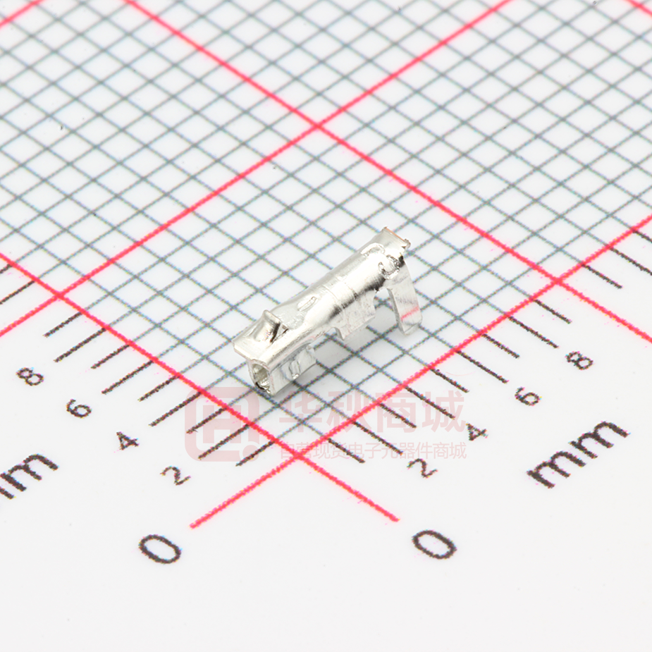

    胶壳端子 24-30AWG
A2001-TP 数据手册
A2001 SERIES 2.00mm pitch wire to board connector Specifications Current rating:2A AC,DC Voltage rating:100V AC,DC Temperature range:-40°C~+105°C Contact resistance:10m Max. Insulation resistance:1000M Min. Withstanding voltage:800V AC/minute *Compliant with RoHS and REACH* *Meet the HF/Halogen Free,need to customize* *Contact CJT for details* Standards E326732 E326732 4.85 2.00 17.00 REF. 1.60 1.60 1.80 8.10 REF. 5.00 8.25 REF. 1.60 8.60 REF. 1.60 1.80 1.80 4.70 4.70 DIP TYPE 5.40 5.60 8.70 REF. 9.70 REF. SMT TYPE CHANGJIANG CONNECTORS TEL:+86-755-29959119 29959129 FAX:+86-755-29959139 Http://www.CJT.cn A-146 A2001 SERIES A2001-T 2.00mm pitch wire to board connector 2.00mm pitch Crimp Terminal Reference Informations: *Used in CJT A2001H-XP series Housing 0.20 0.80 D±0.25 C±0.25 SEC:A-A B 1.32 1.50 1.62 B E±0.25 F±0.25 A 5.60±0.25 A 0.45 2.10 1.00 SEC:B-B 0.71 1.40 Unit:mm Ordering information & Specifications: Part NO. Wire Range A2001-TP AWG#24-#30 Insulation O.D. Material 1.50mm(max) Phosphor Bronze A2001-GP AWG#24-#30 1.50mm(max) Phosphor Bronze A2001-TP-L AWG#28-#32 0.90mm(max) A2001-GP-L AWG#28-#32 0.90mm(max) Finish C D E Qty/reel F Tin over Nickel 2.20 2.50 1.70 1.40 10,000 PCS Gold over Nickel 2.20 2.50 1.70 1.40 10,000 PCS Phosphor Bronze Tin over Nickel 1.55 2.10 1.15 1.15 15,000 PCS Phosphor Bronze Gold over Nickel 1.55 2.10 1.15 1.15 15,000 PCS Optional Gold plating available but MOQ requested A2001M-T 2.00mm pitch Crimp Terminal Reference Informations: *Used in CJT A2001HM-XP series Housing 1.80±0.25 0.20 SEC:A-A 1.30±0.25 1.30±0.25 B 7.30 B 7.70 A 11.20±0.25 A 1.50 1.00 1.85±0.25 0.50 1.50 0.50 1.50 SEC:B-B 0.65 Unit:mm Ordering information & Specifications: Part NO Wire Range Insulation O.D. Material Finish Qty/reel A2001M-TP AWG#24-#30 1.50mm(max) Phosphor Bronze Tin over Nickel 10,000 PCS A2001M-TB AWG#24-#30 1.50mm(max) Brass Tin over Nickel 10,000 PCS A2001M-GP AWG#24-#30 1.50mm(max) Phosphor Bronze Gold over Nickel 10,000 PCS AWG#24-#30 1.50mm(max) Brass Gold over Nickel 10,000 PCS A2001M-GB Optional Gold plating available but MOQ requested CHANGJIANG CONNECTORS TEL:+86-755-29959119 29959129 FAX:+86-755-29959139 Http://www.CJT.cn A-147 A2001 SERIES A2001H-XP 2.00mm pitch wire to board connector 2.00mm pitch Housing Reference Informations: *Material:Nylon 66,UL94V-0 *Suitable CJT A2001-T(-L) series Terminal *Mates with CJT A2001HM-XP series Housing or A2001WV,WR-XP,A2001WV-S,WR-S-XP series Wafer *Color:White Ordering Information: A2001H-XP - *** - ** 1 2 3 1.Part No. 2.Material: (Blank):Nylon 66,UL94V-0 GWT:Nylon 66,UL94V-0,GWT 750 ℃ 3.Color: (Blank):White RD:Red OR:Orange YL:Yellow GY:Gray BL:Blue PK:Pink BK:Black BR:Brown GN:Green VI:Violet TR:Tomato red LY:Lemon yellow LE:Light blue VY:Vivid yellow DPK:Dark pink Circuit 1 2.00±0.10 A±0.20 4.50±0.25 6.85±0.25 B±0.25 3.45±0.25 Ordering Information & Dimensions: PART NO. 2P 3P 4P 5P 6P 7P 8P 9P 10P 11P 12P 13P 14P 15P 16P 17P 18P 19P 20P Dimensions A B 2.00 5.80 4.00 7.80 6.00 9.80 8.00 11.80 10.00 13.80 12.00 15.80 14.00 17.80 16.00 19.80 18.00 21.80 23.80 20.00 22.00 25.80 24.00 27.80 26.00 29.80 28.00 31.80 30.00 33.80 32.00 35.80 34.00 37.80 36.00 39.80 38.00 41.80 Unit: mm 2.00mm pitch Housing Reference Informations: *Material:Nylon 66,UL94V-0 *Suitable CJT A2001M-T series Terminal *Mates with CJT A2001H-XP series Housing *Color:White Circuit 1 2.00±0.10 Circuit 1 A A±0.20 3P~20P 2P 4.80±0.25 C±0.25 2.90 6.00±0.25 B±0.25 Ordering Information: A2001HM-XP - *** - ** 1 2 3 1.Part No. 2.Material: (Blank):Nylon 66,UL94V-0 GWT:Nylon 66,UL94V-0,GWT 750 ℃ 3.Color: (Blank):White Ordering Information & Dimensions: RD:Red OR:Orange YL:Yellow GY:Gray Dimensions BL:Blue PK:Pink PART NO. A B C BK:Black BR:Brown 2.00 6.00 4.60 2P GN:Green VI:Violet 3P 4.00 8.00 6.60 4P 6.00 10.00 8.60 5P 8.00 12.00 10.60 6P 10.00 14.00 12.60 7P 12.00 16.00 14.60 8P 14.00 18.00 16.60 9P 16.00 20.00 18.60 10P 18.00 22.00 20.60 11P 20.00 24.00 22.60 22.00 26.00 24.60 12P 13P 24.00 28.00 26.60 26.00 30.00 28.60 14P 15P 28.00 32.00 30.60 16P 30.00 34.00 32.60 32.00 36.00 34.60 17P 18P 34.00 38.00 36.60 19P 36.00 40.00 38.60 20P 38.00 42.00 40.60 12.70±0.25 A2001HM-XP Unit: mm CHANGJIANG CONNECTORS TEL:+86-755-29959119 29959129 FAX:+86-755-29959139 Http://www.CJT.cn A-148 A2001 SERIES A2001WV-XP 2.00mm pitch 180° Wafer Reference Informations: *Material:Pin:Brass/Tin over Nickel Insulator:Nylon 66,UL94V-0 *Mates with CJT A2001H-XP series Housing *Color:White 2.00±0.10 2.00mm pitch wire to board connector Circuit 1 A±0.20 Ordering Information: A2001WV-XP - * - *** - ** - ** 1 2 3 4 5 1.Part No. 2.Style: (blank) :Type 1 2 :Type 2 3 :Type 3 3.Material: (Blank):Nylon 66,UL94V-0 GWT:Nylon 66,UL94V-0,GWT 750 ℃ 4.Color: (Blank):White RD:Red OR:Orange YL:Yellow GY:Gray BL:Blue PK:Pink BK:Black BR:Brown GN:Green VI:Violet TR:Tomato red LY:Lemon yellow LE:Light blue VY:Vivid yellow 5.Finish: (Blank):Tin over Nickel G:Gold over Nickel 2.00 Ø0.70 P.C.B LAYOUT Ordering Information & Dimensions: PART NO. 2P 3P 4P 5P 6P 7P 8P 9P 10P 11P 12P 13P 14P 15P 16P 17P 18P 19P 20P TYPE 1 4.50±0.25 B±0.25 6.10±0.25 1.80 3.40 TYPE 2 0.80 Pin 0.50 SQ TYPE 3 Dimensions A B 2.00 6.00 4.00 8.00 6.00 10.00 8.00 12.00 10.00 14.00 12.00 16.00 14.00 18.00 16.00 20.00 18.00 22.00 20.00 24.00 22.00 26.00 24.00 28.00 26.00 30.00 28.00 32.00 30.00 34.00 32.00 36.00 34.00 38.00 36.00 40.00 38.00 42.00 Unit: mm A2001WR-XP 2.00mm pitch 90° Wafer Reference Informations: *Material:Pin:Brass/Tin over Nickel Insulator:Nylon 66,UL94V-0 *Mates with CJT A2001H-XP series Housing *Color:White PIN 0.50 SQ 2.00±0.10 Circuit 1 Ordering Information: A2001WR-XP - * - *** - ** - ** 1 2 3 4 5 1.Part No. 2.Style: (blank) :Type 1 2 :Type 2 3.Material: (Blank):Nylon 66,UL94V-0 GWT:Nylon 66,UL94V-0,GWT 750 ℃ 4.Color: (Blank):White RD:Red OR:Orange YL:Yellow GY:Gray BL:Blue PK:Pink BK:Black BR:Brown GN:Green VI:Violet TR:Tomato red LY:Lemon yellow LE:Light blue VY:Vivid yellow 5.Finish: (Blank):Tin over Nickel G:Gold over Nickel 2.00 A±0.20 4.85±0.25 B±0.25 6.25±0.25 3.40±0.20 0.80 7.60±0.25 6.10±0.25 1.80 TYPE 2 TYPE 1 Ø0.70 P.C.B LAYOUT Ordering Information & Dimensions: PART NO. 2P 3P 4P 5P 6P 7P 8P 9P 10P 11P 12P 13P 14P 15P 16P 17P 18P 19P 20P Dimensions A B 2.00 6.00 4.00 8.00 6.00 10.00 8.00 12.00 10.00 14.00 12.00 16.00 14.00 18.00 16.00 20.00 18.00 22.00 20.00 24.00 22.00 26.00 24.00 28.00 26.00 30.00 28.00 32.00 30.00 34.00 32.00 36.00 34.00 38.00 36.00 40.00 38.00 42.00 Unit: mm CHANGJIANG CONNECTORS TEL:+86-755-29959119 29959129 FAX:+86-755-29959139 Http://www.CJT.cn A-149 A2001 SERIES A2001WV-S-XP 2.00mm pitch wire to board connector 2.00mm pitch 180° Wafer-SMT TYPE A Reference Informations: *Material:Pin:Brass/Tin over Nickel Insulator:Nylon 6T,UL94V-0 *Mates with CJT A2001H-XP series Housing *Color:Ivory 5.50 3.00 1.00 Ordering Information: 1.60 A2001WV-S-XP - *** - ** - ** 1 2 3 4 1.Part No. 2.Material: (Blank):Nylon 6T,UL94V-0 GWT:Nylon 6T,UL94V-0,GWT 750 ℃ 3.Color: (Blank):Ivory RD:Red BL:Blue BK:Black GN:Green LY:Lemon yellow DPK:Dark pink 4.Finish: (Blank):Tin over Nickel G:Gold over Nickel A±0.20 2.00 Circuit 1 1.00 2.00 1.60 P.C.B LAYOUT Ordering Information & Dimensions: PART NO. 2P 3P 4P 5P 6P 7P 8P 9P 10P 11P 12P 13P 14P 15P 16P 17P 18P 19P 20P 5.40±0.25 B±0.25 6.42±0.25 2.43 2.00±0.20 PIN 0.50 SQ Dimensions A B 2.00 8.00 4.00 10.00 6.00 12.00 8.00 14.00 10.00 16.00 12.00 18.00 14.00 20.00 16.00 22.00 18.00 24.00 20.00 26.00 22.00 28.00 24.00 30.00 26.00 32.00 28.00 34.00 30.00 36.00 32.00 38.00 34.00 40.00 36.00 42.00 38.00 44.00 Unit: mm A±0.20 1.60 P.C.B LAYOUT 1.00 7.65±0.25 6.00±0.25 2.43 PIN 0.50 SQ Ordering Information & Dimensions: PART NO. 5.50±0.25 B±0.25 1.00 9.20 A 2.00 Ordering Information: A2001WR-S-XP - *** - ** - ** 1 2 3 4 1.Part No. 2.Material: (Blank):Nylon 6T,UL94V-0 GWT:Nylon 6T,UL94V-0,GWT 750 ℃ 3.Color: (Blank):Ivory RD:Red BL:Blue BK:Black GN:Green LY:Lemon yellow DPK:Dark pink 4.Finish: (Blank):Tin over Nickel G:Gold over Nickel Circuit 1 2.00±0.10 1.50 5.70 Reference Informations: *Material:Pin:Brass/Tin over Nickel Insulator:Nylon 6T,UL94V-0 *Mates with CJT A2001H-XP series Housing *Color:Ivory 2.00mm pitch 90° Wafer-SMT TYPE 3.40 A2001WR-S-XP 2P 3P 4P 5P 6P 7P 8P 9P 10P 11P 12P 13P 14P 15P 16P 17P 18P 19P 20P Dimensions A B 2.00 8.00 4.00 10.00 6.00 12.00 8.00 14.00 10.00 16.00 12.00 18.00 14.00 20.00 16.00 22.00 18.00 24.00 20.00 26.00 22.00 28.00 24.00 30.00 26.00 32.00 28.00 34.00 30.00 36.00 32.00 38.00 34.00 40.00 36.00 42.00 38.00 44.00 Unit: mm CHANGJIANG CONNECTORS TEL:+86-755-29959119 29959129 FAX:+86-755-29959139 Http://www.CJT.cn A-150 A2001 SERIES A2001WVR-XP Reference Informations: *Material:Pin:Brass/Tin over Nickel Insulator:Nylon 66,UL94V-0 *Mates with CJT A2001H-XP series Housing *Color:White 2.00±0.10 Circuit 1 A±0.20 2.00mm pitch wire to board connector 2.00mm pitch 90° Wafer Ordering Information: A2001WVR-XP - * - *** - ** - ** 1 2 3 4 5 1.Part No. 2.Style: (blank) :Type 1 2 :Type 2 3.Material: (Blank):Nylon 66,UL94V-0 GWT:Nylon 66,UL94V-0,GWT 750 ℃ 4.Color: (Blank):White RD:Red OR:Orange YL:Yellow GY:Gray BL:Blue PK:Pink BK:Black BR:Brown GN:Green VI:Violet 5.Finish: (Blank):Tin over Nickel G:Gold over Nickel 2.00 Ø0.70 P.C.B LAYOUT Ordering Information & Dimensions: PART NO. 2P 3P 4P 5P 6P 7P 8P 9P 10P 11P 12P 13P 14P 15P 16P 17P 18P 19P 20P 4.70±0.25 B±0.25 3.40±0.20 0.81 Circuit 1 PIN 0.50 SQ 6.60±0.25 6.10±0.25 1.80 TYPE 1 TYPE 2 Dimensions A B 2.00 6.00 4.00 8.00 6.00 10.00 8.00 12.00 10.00 14.00 12.00 16.00 14.00 18.00 16.00 20.00 18.00 22.00 20.00 24.00 22.00 26.00 24.00 28.00 26.00 30.00 28.00 32.00 30.00 34.00 32.00 36.00 34.00 38.00 36.00 40.00 38.00 42.00 Unit: mm 2.00mm pitch 180° Wafer-High box type Reference Informations: *Material:Pin:Brass/Tin over Nickel Insulator:Nylon 6T,UL94V-0 *Mates with CJT A2001H-XP series Housing *Color:White 2.00±0.10 Circuit 1 A±0.20 Ordering Information: A2001WV-F-XP-H - *** - ** - ** 1 2 3 4 1.Part No. 2.Material: (Blank):Nylon 6T,UL94V-0 GWT:Nylon 6T,UL94V-0,GWT 750 ℃ 3.Color: (Blank):White RD:Red YL:Yellow BL:Blue BK:Black BR:Brown GN:Green 4.Finish: (Blank):Tin over Nickel G:Gold over Nickel 4.85±0.25 B±0.25 1.50 Ø0.80 PIN 0.50 SQ 1.40 1.50 6.00±0.25 15.00±0.25 3.60±0.20 1.80 1.40 Ø1.00 2.00 1.50 A2001WV-F-XP-H Ø0.70 P.C.B LAYOUT Ordering Information & Dimensions: PART NO. 2P 3P 4P 5P 6P 7P 8P 9P 10P 11P 12P 13P 14P 15P 16P 17P 18P 19P 20P Dimensions A B 2.00 6.00 4.00 8.00 6.00 10.00 8.00 12.00 10.00 14.00 12.00 16.00 14.00 18.00 16.00 20.00 18.00 22.00 20.00 24.00 22.00 26.00 24.00 28.00 26.00 30.00 28.00 32.00 30.00 34.00 32.00 36.00 34.00 38.00 36.00 40.00 38.00 42.00 Unit: mm CHANGJIANG CONNECTORS TEL:+86-755-29959119 29959129 FAX:+86-755-29959139 Http://www.CJT.cn A-151
A2001-TP
物料型号: - A2001-T:2.00mm间距焊压端子 - A2001M-T:2.00mm间距焊压端子,适用于CJT A2001HM-XP系列外壳 - A2001H-XP:2.00mm间距外壳 - A2001WV-XP/WR-XP:2.00mm间距180°/90°焊片 - A2001WV-S-XP/WR-S-XP:2.00mm间距180°/90°SMT焊片 - A2001WVR-XP:2.00mm间距90°焊片 - A2001WV-F-XP-H:2.00mm间距180°高盒型焊片
器件简介: A2001系列提供2.00mm间距的线对板连接器解决方案,包括焊压端子、外壳、焊片等多种形式,适用于不同的电路连接需求。
引脚分配: - 端子的引脚分配根据型号不同而有所变化,但通常包括多个引脚配置,如2P至20P,表示2至20个引脚的配置。
参数特性: - 电流额定值:2A AC/DC - 电压额定值:100V AC/DC - 工作温度范围:-40°C至+105°C - 接触电阻:最大10mΩ - 绝缘电阻:最小1000MΩ - 耐电压:800V AC/分钟 - 符合RoHS和REACH标准
功能详解: - 提供不同材质和表面处理的端子,如磷青铜镀锡、镀金等。 - 提供不同绝缘外径的端子,以适应不同线径的电线。 - 可选的金镀层,但需满足最小订购量(MOQ)。
应用信息: - 适用于需要高密度连接的场合,如电子设备内部连接。
封装信息: - 提供多种颜色和材料的外壳,以适应不同的设计和环境要求。
