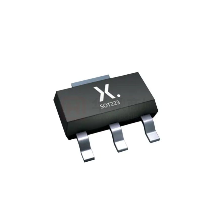

    MOS管 P-channel Id=2.4A VDS=70V SOT223
PMT200EPEX 数据手册
PMT200EPE 70 V, P-channel Trench MOSFET 14 March 2018 Product data sheet 1. General description P-channel enhancement mode Field-Effect Transistor (FET) in a medium power SOT223 (SC-73) Surface-Mounted Device (SMD) plastic package using Trench MOSFET technology. 2. Features and benefits • • • • Logic level compatible Very fast switching Trench MOSFET technology ElectroStatic Discharge (ESD) protection > 2 kV HBM 3. Applications • • • • Relay driver High-speed line driver High-side loadswitch Switching circuits 4. Quick reference data Table 1. Quick reference data Symbol Parameter Conditions Min Typ Max Unit VDS drain-source voltage Tj = 25 °C - - -70 V VGS gate-source voltage -20 - 20 V ID drain current - - -2.4 A - 130 167 mΩ VGS = -10 V; Tamb = 25 °C [1] Static characteristics RDSon [1] drain-source on-state resistance VGS = -10 V; ID = -2.4 A; Tj = 25 °C 2 Device mounted on an FR4 Printed-Circuit Board (PCB), single-sided copper, tin-plated, mounting pad for drain 6 cm . PMT200EPE Nexperia 70 V, P-channel Trench MOSFET 5. Pinning information Table 2. Pinning information Pin Symbol Description 1 G gate 2 D drain 3 S source 4 D Simplified outline Graphic symbol D 4 1 drain 2 3 G SC-73 (SOT223) S 017aaa259 6. Ordering information Table 3. Ordering information Type number PMT200EPE Package Name Description Version SC-73 plastic surface-mounted package with increased heatsink; 4 leads SOT223 7. Marking Table 4. Marking codes Type number Marking code PMT200EPE T2EPE PMT200EPE Product data sheet All information provided in this document is subject to legal disclaimers. 14 March 2018 © Nexperia B.V. 2018. All rights reserved 2 / 15 PMT200EPE Nexperia 70 V, P-channel Trench MOSFET 8. Limiting values Table 5. Limiting values In accordance with the Absolute Maximum Rating System (IEC 60134). Symbol Parameter Conditions Min Max Unit VDS drain-source voltage Tj = 25 °C - -70 V VGS gate-source voltage -20 20 V ID drain current VGS = -10 V; Tamb = 25 °C [1] - -2.4 A VGS = -10 V; Tamb = 100 °C [1] - -1.5 A - -9.7 A [2] - 800 mW [1] - 1.75 W - 8.3 W IDM peak drain current Tamb = 25 °C; single pulse; tp ≤ 10 µs Ptot total power dissipation Tamb = 25 °C Tsp = 25 °C Tj junction temperature -55 150 °C Tamb ambient temperature -55 150 °C Tstg storage temperature -65 150 °C EDS(AL)S non-repetitive drainsource avalanche energy - 19.5 mJ Tj(init) = 25 °C; ID = -1.3 A; DUT in avalanche (unclamped) Source-drain diode IS source current Tamb = 25 °C [1] - -1.8 A HBM [3] - 2000 V ESD maximum rating VESD [1] [2] [3] electrostatic discharge voltage 2 Device mounted on an FR4 Printed-Circuit Board (PCB), single-sided copper, tin-plated, mounting pad for drain 6 cm . Device mounted on an FR4 PCB, single-sided copper, tin-plated and standard footprint. Measured between all pins. PMT200EPE Product data sheet All information provided in this document is subject to legal disclaimers. 14 March 2018 © Nexperia B.V. 2018. All rights reserved 3 / 15 PMT200EPE Nexperia 70 V, P-channel Trench MOSFET 017aaa123 120 017aaa124 120 Pder (%) Ider (%) 80 80 40 40 0 - 75 Fig. 1. - 25 25 75 125 Tj (°C) 0 - 75 175 Fig. 2. Normalized total power dissipation as a function of junction temperature - 25 25 75 125 Tj (°C) 175 Normalized continuous drain current as a function of junction temperature aaa-023945 -102 ID (A) Limit RDSon = VDS/ID -10 tp = 10 µs tp = 100 µs 1 tp = 1 ms tp = 10 ms DC; Tamb = 25 °C; drain mounting pad 6 cm2 -10-1 tp = 100 ms DC; Tsp = 25 °C -10-2 -10-1 -1 -10 -102 VDS (V) -103 IDM = single pulse Fig. 3. Safe operating area; junction to ambient; continuous and peak drain currents as a function of drainsource voltage PMT200EPE Product data sheet All information provided in this document is subject to legal disclaimers. 14 March 2018 © Nexperia B.V. 2018. All rights reserved 4 / 15 PMT200EPE Nexperia 70 V, P-channel Trench MOSFET 9. Thermal characteristics Table 6. Thermal characteristics Symbol Parameter Conditions Rth(j-a) thermal resistance from junction to ambient in free air Rth(j-sp) [1] [2] Min Typ Max Unit [1] - 135 155 K/W [2] - 54 70 K/W - 7 15 K/W thermal resistance from junction to solder point Device mounted on an FR4 PCB, single-sided copper, tin-plated and standard footprint. 2 Device mounted on an FR4 PCB, single-sided copper, tin-plated, mounting pad for drain 6 cm . aaa-023946 103 Zth(j-a) (K/W) duty cycle = 1 102 0.50 0.25 0.75 0.33 0.20 0.10 10 0.05 0.02 0.01 0 1 10-3 10-2 10-1 1 10 102 tp (s) 103 FR4 PCB, standard footprint Fig. 4. Transient thermal impedance from junction to ambient as a function of pulse duration; typical values aaa-023947 102 duty cycle = 1 Zth(j-a) (K/W) 0.75 0.50 0.25 10 0.33 0.20 0.10 0.05 0.02 0.01 0 1 10-3 10-2 10-1 FR4 PCB, mounting pad for drain 6 cm Fig. 5. 1 10 102 tp (s) 2 103 Transient thermal impedance from junction to ambient as a function of pulse duration; typical values PMT200EPE Product data sheet All information provided in this document is subject to legal disclaimers. 14 March 2018 © Nexperia B.V. 2018. All rights reserved 5 / 15 PMT200EPE Nexperia 70 V, P-channel Trench MOSFET 10. Characteristics Table 7. Characteristics Symbol Parameter Conditions Min Typ Max Unit Static characteristics V(BR)DSS drain-source breakdown voltage ID = -250 µA; VGS = 0 V; Tj = 25 °C -70 - - V VGSth gate-source threshold voltage ID = -250 µA; VDS = VGS; Tj = 25 °C -1 -2 -3 V IDSS drain leakage current VDS = -70 V; VGS = 0 V; Tj = 25 °C - - -1 µA IGSS gate leakage current VGS = 20 V; VDS = 0 V; Tj = 25 °C - - 10 µA VGS = -20 V; VDS = 0 V; Tj = 25 °C - - -10 µA VGS = 10 V; VDS = 0 V; Tj = 25 °C - - 2 µA VGS = -10 V; VDS = 0 V; Tj = 25 °C - - -2 µA VGS = -10 V; ID = -2.4 A; Tj = 25 °C - 130 167 mΩ VGS = -10 V; ID = -2.4 A; Tj = 150 °C - 234 250 mΩ VGS = -4.5 V; ID = -2.1 A; Tj = 25 °C - 150 225 mΩ RDSon drain-source on-state resistance gfs forward transconductance VDS = -10 V; ID = -2.4 A; Tj = 25 °C - 13.5 - S RG gate resistance f = 1 MHz - 12 - Ω VDS = -35 V; ID = -2.4 A; VGS = -10 V; Tj = 25 °C - 10.6 15.9 nC - 2.2 - nC - 1.05 - nC - 822 - pF - 47 - pF - 31.5 - pF - 6 - ns - 8 - ns Dynamic characteristics QG(tot) total gate charge QGS gate-source charge QGD gate-drain charge Ciss input capacitance Coss output capacitance Crss reverse transfer capacitance td(on) turn-on delay time tr rise time td(off) turn-off delay time - 42 - ns tf fall time - 20 - ns - -0.8 -1.2 V VDS = -35 V; f = 1 MHz; VGS = 0 V; Tj = 25 °C VDS = -35 V; ID = -2.4 A; VGS = -10 V; RG(ext) = 6 Ω; Tj = 25 °C Source-drain diode VSD source-drain voltage PMT200EPE Product data sheet IS = -2.4 A; VGS = 0 V; Tj = 25 °C All information provided in this document is subject to legal disclaimers. 14 March 2018 © Nexperia B.V. 2018. All rights reserved 6 / 15 PMT200EPE Nexperia 70 V, P-channel Trench MOSFET aaa-023948 -8 VGS = -10 V ID (A) ID (A) -4.5 V -6 aaa-023949 -10-3 -3.5 V min -10-4 -3.0 V typ max -4 -2.8 V -10-5 -2 -2.5 V 0 0 -1 -2 -3 -4 VDS (V) -10-6 -5 Tj = 25 °C Fig. 6. aaa-023950 -2.5 V -2.8 V -1 -2 -3 VGS (V) -4 VDS = -5 V Tj = 25 °C Output characteristics: drain current as a function of drain-source voltage; typical values Fig. 7. 700 RDSon (mΩ) 600 0 Sub-threshold drain current as a function of gate-source voltage aaa-023951 600 -3.0 V RDSon (mΩ) 500 400 400 Tj = 150 °C -3.5 V 300 -4.5 V 200 200 VGS = -10 V 100 0 0 -2 -4 -6 VGS (V) 0 -8 Tj = 25 °C Fig. 8. Tj = 25 °C Product data sheet -5 -10 -15 VGS (V) -20 ID = -4 A Drain-source on-state resistance as a function of drain current; typical values PMT200EPE 0 Fig. 9. Drain-source on-state resistance as a function of gate-source voltage; typical values All information provided in this document is subject to legal disclaimers. 14 March 2018 © Nexperia B.V. 2018. All rights reserved 7 / 15 PMT200EPE Nexperia 70 V, P-channel Trench MOSFET aaa-023953 -8 aaa-023954 2.0 ID (A) a -6 1.5 -4 1.0 Tj = 150 °C -2 0.5 Tj = 25 °C 0 0 -1 -2 -3 VGS (V) 0 -60 -4 0 60 120 Tj (°C) 180 VDS > ID x RDSon Fig. 10. Transfer characteristics: drain current as a function of gate-source voltage; typical values Fig. 11. Normalized drain-source on-state resistance as a function of junction temperature; typical values aaa-023955 -3.5 VGS(th) (V) -3.0 aaa-023956 104 C (pF) -2.5 Ciss 103 -2.0 -1.5 102 -1.0 Coss -0.5 Crss 0 -60 0 60 120 Tj (°C) 10 -10-1 180 ID = - 250 μA; VDS = VGS Product data sheet -10 VDS (V) -102 f = 1 MHz; VGS = 0 V Fig. 12. Gate-source threshold voltage as a function of junction temperature PMT200EPE -1 Fig. 13. Input, output and reverse transfer capacitances as a function of drain-source voltage; typical values All information provided in this document is subject to legal disclaimers. 14 March 2018 © Nexperia B.V. 2018. All rights reserved 8 / 15 PMT200EPE Nexperia 70 V, P-channel Trench MOSFET aaa-023958 -10 VDS VGS (V) ID -8 VGS(pl) -6 VGS(th) VGS -4 QGS1 -2 0 QGS2 0 5 10 QG (nC) QGS QGD QG(tot) 003aaa508 Fig. 15. Gate charge waveform definitions 15 VDS = -35 V; ID = -2 A Fig. 14. Gate-source voltage as a function of gate charge; typical values aaa-023959 -3.5 IS (A) -3.0 -2.5 Tj = 150 °C -2.0 -1.5 -1.0 Tj = 25 °C -0.5 0 0 -0.4 -0.8 VSD (V) -1.2 VGS = 0 V Fig. 16. Source current as a function of source-drain voltage; typical values 11. Test information P t2 duty cycle δ = t1 t2 t1 t 006aaa812 Fig. 17. Duty cycle definition PMT200EPE Product data sheet All information provided in this document is subject to legal disclaimers. 14 March 2018 © Nexperia B.V. 2018. All rights reserved 9 / 15 PMT200EPE Nexperia 70 V, P-channel Trench MOSFET 12. Package outline Plastic surface-mounted package with increased heatsink; 4 leads D SOT223 E B A X c y HE v M A b1 4 Q A A1 1 2 e1 3 Lp bp w M B detail X e 0 2 4 mm scale DIMENSIONS (mm are the original dimensions) UNIT A A1 bp b1 c D E e e1 HE Lp Q v w y mm 1.8 1.5 0.10 0.01 0.80 0.60 3.1 2.9 0.32 0.22 6.7 6.3 3.7 3.3 4.6 2.3 7.3 6.7 1.1 0.7 0.95 0.85 0.2 0.1 0.1 OUTLINE VERSION REFERENCES IEC JEDEC SOT223 JEITA EUROPEAN PROJECTION ISSUE DATE 04-11-10 06-03-16 SC-73 Fig. 18. Package outline SC-73 (SOT223) PMT200EPE Product data sheet All information provided in this document is subject to legal disclaimers. 14 March 2018 © Nexperia B.V. 2018. All rights reserved 10 / 15 PMT200EPE Nexperia 70 V, P-channel Trench MOSFET 13. Soldering 7 3.85 3.6 3.5 0.3 1.3 1.2 (4×) (4×) solder lands 4 solder resist 3.9 6.1 7.65 solder paste occupied area 1 2 3 Dimensions in mm 2.3 2.3 1.2 (3×) 1.3 (3×) 6.15 sot223_fr Fig. 19. Reflow soldering footprint for SC-73 (SOT223) 8.9 6.7 1.9 solder lands 4 solder resist 6.2 1 2 8.7 Dimensions in mm 3 1.9 (3×) 2.7 occupied area preferred transport direction during soldering 2.7 1.1 1.9 (2×) sot223_fw Fig. 20. Wave soldering footprint for SC-73 (SOT223) PMT200EPE Product data sheet All information provided in this document is subject to legal disclaimers. 14 March 2018 © Nexperia B.V. 2018. All rights reserved 11 / 15 PMT200EPE Nexperia 70 V, P-channel Trench MOSFET 14. Revision history Table 8. Revision history Data sheet ID Release date Data sheet status Change notice Supersedes PMT200EPE v.1 20180314 Product data sheet - - PMT200EPE Product data sheet All information provided in this document is subject to legal disclaimers. 14 March 2018 © Nexperia B.V. 2018. All rights reserved 12 / 15 PMT200EPE Nexperia 70 V, P-channel Trench MOSFET for the products described herein shall be limited in accordance with the Terms and conditions of commercial sale of Nexperia. 15. Legal information Right to make changes — Nexperia reserves the right to make changes to information published in this document, including without limitation specifications and product descriptions, at any time and without notice. This document supersedes and replaces all information supplied prior to the publication hereof. Data sheet status Document status [1][2] Product status [3] Objective [short] data sheet Development This document contains data from the objective specification for product development. Preliminary [short] data sheet Qualification This document contains data from the preliminary specification. Product [short] data sheet Production This document contains the product specification. [1] [2] [3] Suitability for use — Nexperia products are not designed, authorized or warranted to be suitable for use in life support, life-critical or safety-critical systems or equipment, nor in applications where failure or malfunction of an Nexperia product can reasonably be expected to result in personal injury, death or severe property or environmental damage. Nexperia and its suppliers accept no liability for inclusion and/or use of Nexperia products in such equipment or applications and therefore such inclusion and/or use is at the customer’s own risk. Definition Quick reference data — The Quick reference data is an extract of the product data given in the Limiting values and Characteristics sections of this document, and as such is not complete, exhaustive or legally binding. Please consult the most recently issued document before initiating or completing a design. The term 'short data sheet' is explained in section "Definitions". The product status of device(s) described in this document may have changed since this document was published and may differ in case of multiple devices. The latest product status information is available on the Internet at URL http://www.nexperia.com. Definitions Preview — The document is a preview version only. The document is still subject to formal approval, which may result in modifications or additions. Nexperia does not give any representations or warranties as to the accuracy or completeness of information included herein and shall have no liability for the consequences of use of such information. Draft — The document is a draft version only. The content is still under internal review and subject to formal approval, which may result in modifications or additions. Nexperia does not give any representations or warranties as to the accuracy or completeness of information included herein and shall have no liability for the consequences of use of such information. Short data sheet — A short data sheet is an extract from a full data sheet with the same product type number(s) and title. A short data sheet is intended for quick reference only and should not be relied upon to contain detailed and full information. For detailed and full information see the relevant full data sheet, which is available on request via the local Nexperia sales office. In case of any inconsistency or conflict with the short data sheet, the full data sheet shall prevail. Product specification — The information and data provided in a Product data sheet shall define the specification of the product as agreed between Nexperia and its customer, unless Nexperia and customer have explicitly agreed otherwise in writing. In no event however, shall an agreement be valid in which the Nexperia product is deemed to offer functions and qualities beyond those described in the Product data sheet. Disclaimers Limited warranty and liability — Information in this document is believed to be accurate and reliable. However, Nexperia does not give any representations or warranties, expressed or implied, as to the accuracy or completeness of such information and shall have no liability for the consequences of use of such information. Nexperia takes no responsibility for the content in this document if provided by an information source outside of Nexperia. In no event shall Nexperia be liable for any indirect, incidental, punitive, special or consequential damages (including - without limitation - lost profits, lost savings, business interruption, costs related to the removal or replacement of any products or rework charges) whether or not such damages are based on tort (including negligence), warranty, breach of contract or any other legal theory. Notwithstanding any damages that customer might incur for any reason whatsoever, Nexperia’ aggregate and cumulative liability towards customer PMT200EPE Product data sheet Applications — Applications that are described herein for any of these products are for illustrative purposes only. Nexperia makes no representation or warranty that such applications will be suitable for the specified use without further testing or modification. Customers are responsible for the design and operation of their applications and products using Nexperia products, and Nexperia accepts no liability for any assistance with applications or customer product design. It is customer’s sole responsibility to determine whether the Nexperia product is suitable and fit for the customer’s applications and products planned, as well as for the planned application and use of customer’s third party customer(s). Customers should provide appropriate design and operating safeguards to minimize the risks associated with their applications and products. Nexperia does not accept any liability related to any default, damage, costs or problem which is based on any weakness or default in the customer’s applications or products, or the application or use by customer’s third party customer(s). Customer is responsible for doing all necessary testing for the customer’s applications and products using Nexperia products in order to avoid a default of the applications and the products or of the application or use by customer’s third party customer(s). Nexperia does not accept any liability in this respect. Limiting values — Stress above one or more limiting values (as defined in the Absolute Maximum Ratings System of IEC 60134) will cause permanent damage to the device. Limiting values are stress ratings only and (proper) operation of the device at these or any other conditions above those given in the Recommended operating conditions section (if present) or the Characteristics sections of this document is not warranted. Constant or repeated exposure to limiting values will permanently and irreversibly affect the quality and reliability of the device. Terms and conditions of commercial sale — Nexperia products are sold subject to the general terms and conditions of commercial sale, as published at http://www.nexperia.com/profile/terms, unless otherwise agreed in a valid written individual agreement. In case an individual agreement is concluded only the terms and conditions of the respective agreement shall apply. Nexperia hereby expressly objects to applying the customer’s general terms and conditions with regard to the purchase of Nexperia products by customer. No offer to sell or license — Nothing in this document may be interpreted or construed as an offer to sell products that is open for acceptance or the grant, conveyance or implication of any license under any copyrights, patents or other industrial or intellectual property rights. Export control — This document as well as the item(s) described herein may be subject to export control regulations. Export might require a prior authorization from competent authorities. Non-automotive qualified products — Unless this data sheet expressly states that this specific Nexperia product is automotive qualified, the product is not suitable for automotive use. It is neither qualified nor tested in accordance with automotive testing or application requirements. Nexperia accepts no liability for inclusion and/or use of non-automotive qualified products in automotive equipment or applications. In the event that customer uses the product for design-in and use in automotive applications to automotive specifications and standards, customer (a) shall use the product without Nexperia’ warranty of the product for such automotive applications, use and specifications, and (b) whenever All information provided in this document is subject to legal disclaimers. 14 March 2018 © Nexperia B.V. 2018. All rights reserved 13 / 15 PMT200EPE Nexperia 70 V, P-channel Trench MOSFET customer uses the product for automotive applications beyond Nexperia’ specifications such use shall be solely at customer’s own risk, and (c) customer fully indemnifies Nexperia for any liability, damages or failed product claims resulting from customer design and use of the product for automotive applications beyond Nexperia’ standard warranty and Nexperia’ product specifications. Translations — A non-English (translated) version of a document is for reference only. The English version shall prevail in case of any discrepancy between the translated and English versions. Trademarks Notice: All referenced brands, product names, service names and trademarks are the property of their respective owners. PMT200EPE Product data sheet All information provided in this document is subject to legal disclaimers. 14 March 2018 © Nexperia B.V. 2018. All rights reserved 14 / 15 PMT200EPE Nexperia 70 V, P-channel Trench MOSFET 16. Contents 1. General description......................................................1 2. Features and benefits.................................................. 1 3. Applications.................................................................. 1 4. Quick reference data....................................................1 5. Pinning information......................................................2 6. Ordering information....................................................2 7. Marking.......................................................................... 2 8. Limiting values............................................................. 3 9. Thermal characteristics............................................... 5 10. Characteristics............................................................ 6 11. Test information..........................................................9 12. Package outline........................................................ 10 13. Soldering................................................................... 11 14. Revision history........................................................12 15. Legal information..................................................... 13 © Nexperia B.V. 2018. All rights reserved For more information, please visit: http://www.nexperia.com For sales office addresses, please send an email to: salesaddresses@nexperia.com Date of release: 14 March 2018 PMT200EPE Product data sheet All information provided in this document is subject to legal disclaimers. 14 March 2018 © Nexperia B.V. 2018. All rights reserved 15 / 15 Mouser Electronics Authorized Distributor Click to View Pricing, Inventory, Delivery & Lifecycle Information: Nexperia: PMT200EPEX
