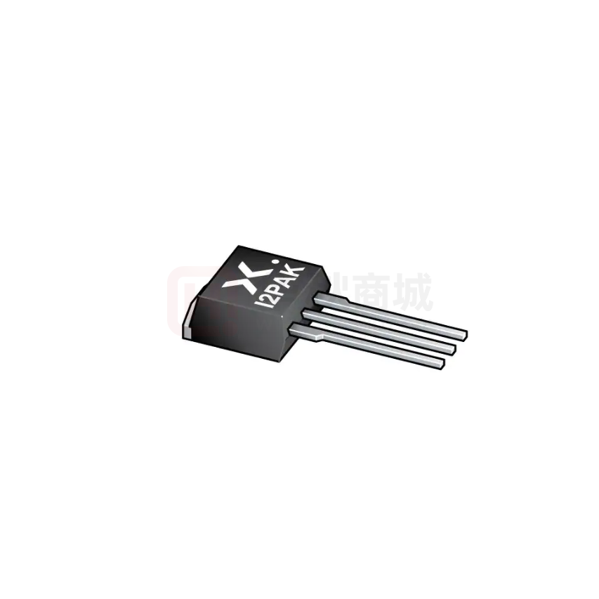

PSMN018-100ESF NextPower 100 V, 18 mΩ N-channel MOSFET in I2PAK package 10 April 2017 Product data sheet 1. General description NextPower 100 V standard level gate drive MOSFET. Qualified to 175 °C and recommended for industrial & consumer applications. 2. Features and benefits • • • • • • Optimised for fast switching, low spiking, high efficiency Low QG x RDSon FOM for high efficiency switching applications Low body diode losses (Qrr) and fast recovery (trr) Strong avalanche energy rating (EAS) Avalanche rated & 100% tested Ha-free & RoHS compliant I2PAK low-height package 3. Applications • • • • • • • Synchronous rectification in AC-to-DC and DC-to-DC applications Brushed & BLDC motor control UPS & solar inverter LED lighting Battery protection Full-bridge & half-bridge applications Flyback & resonant topologies 4. Quick reference data Table 1. Quick reference data Symbol Parameter Conditions Min Typ Max Unit VDS drain-source voltage 25 °C ≤ Tj ≤ 175 °C - - 100 V ID drain current VGS = 10 V; Tmb = 25 °C; Fig. 2 - - 53 A Ptot total power dissipation Tmb = 25 °C; Fig. 1 - - 111 W Tj junction temperature -55 - 175 °C VGS = 10 V; ID = 15 A; Tj = 25 °C; Fig. 10 - 15 18 mΩ VGS = 10 V; ID = 15 A; Tj = 100 °C; Fig. 11 - 22 28 mΩ ID = 15 A; VDS = 50 V; VGS = 10 V; Fig. 12; Fig. 13 - 4.2 - nC - 21.4 - nC [1] Static characteristics RDSon drain-source on-state resistance Dynamic characteristics QGD gate-drain charge QG(tot) total gate charge PSMN018-100ESF Nexperia NextPower 100 V, 18 mΩ N-channel MOSFET in I2PAK package Symbol Parameter Conditions Min Typ Max Unit - - 109 mJ Avalanche ruggedness EDS(AL)S [1] [2] non-repetitive drainsource avalanche energy ID = 20.5 A; Vsup ≤ 100 V; RGS = 50 Ω; VGS = 10 V; Tj(init) = 25 °C; Fig. 4; Unclamped [2] Avalanche current is limited by IAS Protected by 100% test 5. Pinning information Table 2. Pinning information Pin Symbol Description Simplified outline 1 G gate 2 D drain 3 S source mb D mounting base; connected to drain Graphic symbol D mb G mbb076 S 1 2 3 I2PAK (SOT226) 6. Ordering information Table 3. Ordering information Type number PSMN018-100ESF Package Name Description Version I2PAK plastic, single-ended package (I2PAK); 3 terminals; 2.54 mm pitch; 11 mm x 10 mm x 4.3 mm body SOT226 7. Marking Table 4. Marking codes Type number Marking code PSMN018-100PSF PSMN018-100PSF PSMN018-100ESF Product data sheet All information provided in this document is subject to legal disclaimers. 10 April 2017 © Nexperia B.V. 2017. All rights reserved 2 / 13 PSMN018-100ESF Nexperia NextPower 100 V, 18 mΩ N-channel MOSFET in I2PAK package 8. Limiting values Table 5. Limiting values In accordance with the Absolute Maximum Rating System (IEC 60134). Symbol Parameter Conditions Min Max Unit VDS drain-source voltage 25 °C ≤ Tj ≤ 175 °C - 100 V VDGR drain-gate voltage 25 °C ≤ Tj ≤ 175 °C; RGS = 20 kΩ - 100 V VGS gate-source voltage -20 20 V Ptot total power dissipation Tmb = 25 °C; Fig. 1 - 111 W ID drain current VGS = 10 V; Tmb = 25 °C; Fig. 2 - 53 A VGS = 10 V; Tmb = 100 °C; Fig. 2 - 37 A pulsed; tp ≤ 10 µs; Tmb = 25 °C; Fig. 3 - 212 A [1] IDM peak drain current Tstg storage temperature -55 175 °C Tj junction temperature -55 175 °C Tsld(M) peak soldering temperature - 260 °C Source-drain diode IS source current Tmb = 25 °C - 53 A ISM peak source current pulsed; tp ≤ 10 µs; Tmb = 25 °C - 212 A [2] - 109 mJ [2] - 20.5 A Avalanche ruggedness EDS(AL)S non-repetitive drainsource avalanche energy IAS non-repetitive avalanche Vsup ≤ 100 V; VGS = 10 V; Tj(init) = 25 °C; current RGS = 50 Ω [1] [2] ID = 20.5 A; Vsup ≤ 100 V; RGS = 50 Ω; VGS = 10 V; Tj(init) = 25 °C; Fig. 4; Unclamped Avalanche current is limited by IAS Protected by 100% test PSMN018-100ESF Product data sheet All information provided in this document is subject to legal disclaimers. 10 April 2017 © Nexperia B.V. 2017. All rights reserved 3 / 13 PSMN018-100ESF Nexperia NextPower 100 V, 18 mΩ N-channel MOSFET in I2PAK package 03aa16 120 ID (A) Pder (%) aaa-026561 60 50 80 40 30 40 20 10 0 0 50 100 150 Tmb (°C) 0 200 0 25 50 75 100 125 150 175 Tmb (°C) 200 VGS ≥ 10 V Fig. 2. Fig. 1. ID (A) Normalized total power dissipation as a function of mounting base temperature Continuous drain current as a function of mounting base temperature aaa-026208 103 Limit RDSon = VDS / ID 102 tp = 10 µs DC 10 100 µs 1 1 ms 10 ms 100 ms 10-1 10-2 1 102 10 VDS (V) 103 Tmb = 25 °C; IDM is a single pulse Fig. 3. Safe operating area; continuous and peak drain currents as a function of drain-source voltage PSMN018-100ESF Product data sheet All information provided in this document is subject to legal disclaimers. 10 April 2017 © Nexperia B.V. 2017. All rights reserved 4 / 13 PSMN018-100ESF Nexperia NextPower 100 V, 18 mΩ N-channel MOSFET in I2PAK package IAL (A) aaa-026207 102 10 (1) (2) 1 (3) 10-1 10-2 10-3 10-2 10-1 1 tAL (ms) 10 (1) Tj (init) = 25 °C; (2) Tj (init) = 150 °C; (3) Repetitive Avalanche Fig. 4. Avalanche rating; avalanche current as a function of avalanche time 9. Thermal characteristics Table 6. Thermal characteristics Symbol Parameter Conditions Min Typ Max Unit Rth(j-mb) thermal resistance from junction to mounting base Fig. 5 - 1.22 1.35 K/W aaa-026562 10 Zth(j-mb) (K/W) 1 δ = 0.5 0.2 10-1 0.1 0.05 0.02 single shot P δ= 10-2 Fig. 5. 10-5 10-4 10-3 10-2 T t tp 10-3 10-6 tp T 10-1 tp (s) 1 Transient thermal impedance from junction to mounting base as a function of pulse duration PSMN018-100ESF Product data sheet All information provided in this document is subject to legal disclaimers. 10 April 2017 © Nexperia B.V. 2017. All rights reserved 5 / 13 PSMN018-100ESF Nexperia NextPower 100 V, 18 mΩ N-channel MOSFET in I2PAK package 10. Characteristics Table 7. Characteristics Symbol Parameter Conditions Min Typ Max Unit drain-source breakdown voltage ID = 250 µA; VGS = 0 V; Tj = 25 °C 100 - - V ID = 250 µA; VGS = 0 V; Tj = -55 °C 90 - - V gate-source threshold voltage ID = 1 mA; VDS=VGS; Tj = -55 °C - 3.6 - V ID = 1 mA; VDS=VGS; Tj = 175 °C - 2.1 - V ID = 1 mA; VDS=VGS; Tj = 25 °C; Fig. 9 2 3.2 4 V Static characteristics V(BR)DSS VGS(th) ΔVGS(th)/ΔT gate-source threshold voltage variation with temperature 25 °C ≤ Tj ≤ 175 °C - -7.1 - mV/K IDSS drain leakage current VDS = 100 V; VGS = 0 V; Tj = 25 °C - 0.01 1 µA VDS = 100 V; VGS = 0 V; Tj = 125 °C - - 100 µA VGS = -20 V; VDS = 0 V; Tj = 25 °C - 5 100 nA VGS = 20 V; VDS = 0 V; Tj = 25 °C - 5 100 nA VGS = 10 V; ID = 15 A; Tj = 25 °C; Fig. 10 - 15 18 mΩ VGS = 7 V; ID = 15 A; Tj = 25 °C; Fig. 10 - 17.9 27 mΩ VGS = 10 V; ID = 15 A; Tj = 100 °C; Fig. 11 - 22 28 mΩ VGS = 10 V; ID = 15 A; Tj = 175 °C; Fig. 11 - 31 40 mΩ f = 1 MHz - 1.58 - Ω ID = 15 A; VDS = 50 V; VGS = 10 V; Fig. 12; Fig. 13 - 21.4 - nC ID = 0 A; VDS = 0 V; VGS = 10 V - 10.9 - nC ID = 15 A; VDS = 50 V; VGS = 10 V; Fig. 12; Fig. 13 - 7.2 - nC - 4.3 - nC IGSS RDSon RG gate leakage current drain-source on-state resistance gate resistance Dynamic characteristics QG(tot) total gate charge QGS gate-source charge QGS(th) pre-threshold gatesource charge QGS(th-pl) post-threshold gatesource charge - 2.9 - nC QGD gate-drain charge - 4.2 - nC VGS(pl) gate-source plateau voltage ID = 15 A; VDS = 50 V; Fig. 12; Fig. 13 - 4.9 - V Ciss input capacitance - 1482 - pF Coss output capacitance VDS = 50 V; VGS = 0 V; f = 1 MHz; Tj = 25 °C; Fig. 14 - 280 - pF Crss reverse transfer capacitance - 13 - pF td(on) turn-on delay time - 10.2 - ns tr rise time - 14.1 - ns PSMN018-100ESF Product data sheet VDS = 50 V; RL = 3.3 Ω; VGS = 10 V; RG(ext) = 5 Ω; Tj = 25 °C All information provided in this document is subject to legal disclaimers. 10 April 2017 © Nexperia B.V. 2017. All rights reserved 6 / 13 PSMN018-100ESF Nexperia NextPower 100 V, 18 mΩ N-channel MOSFET in I2PAK package Symbol Parameter td(off) tf Conditions Min Typ Max Unit turn-off delay time - 17.3 - ns fall time - 12.6 - ns Source-drain diode VSD source-drain voltage IS = 15 A; VGS = 0 V; Tj = 25 °C; Fig. 15 - 0.9 1.2 V trr reverse recovery time - 40 - ns Qr recovered charge IS = 15 A; dIS/dt = -100 A/µs; VGS = 0 V; VDS = 50 V; Fig. 16 - 46 - nC ID (A) aaa-026210 60 10 V 7V 6.5 V aaa-026211 100 RDSon (mΩ) 6V 48 80 VGS = 5.5 V 36 60 24 40 5V 12 20 4.5 V 0 Fig. 6. ID (A) 0 1 2 3 VDS (V) 0 4 0 4 8 12 16 VGS (V) 20 Tj = 25 °C Tj = 25 °C; ID = 15 A Output characteristics; drain current as a Fig. 7. function of drain-source voltage; typical values Drain-source on-state resistance as a function of gate-source voltage; typical values aaa-026212 80 aaa-011501 10-1 ID (A) 10-2 60 10-3 40 10-4 20 175°C 0 0 2 4 10-5 Tj = 25°C 6 8 VGS (V) 10-6 10 0 1 2 3 4 VGS (V) 5 VDS = 12 V Fig. 8. Transfer characteristics; drain current as a function of gate-source voltage; typical values PSMN018-100ESF Product data sheet Fig. 9. Sub-threshold drain current as a function of gate-source voltage All information provided in this document is subject to legal disclaimers. 10 April 2017 © Nexperia B.V. 2017. All rights reserved 7 / 13 PSMN018-100ESF Nexperia NextPower 100 V, 18 mΩ N-channel MOSFET in I2PAK package aaa-026213 100 RDSon (mΩ) 4.5 V 5V 5.5 V a 6V aaa-011504 2.4 2 80 1.6 60 1.2 40 6.5 V 0.8 7V 20 0.4 VGS = 10 V 0 0 12 24 36 48 ID (A) 0 -60 60 -30 0 30 60 90 120 150 Tj (°C) 180 Tj = 25 °C Fig. 10. Drain-source on-state resistance as a function of drain current; typical values VGS (V) Fig. 11. Normalized drain-source on-state resistance factor as a function of junction temperature aaa-026214 10 VDS 50 V 8 ID VDS = 20 V VGS(pl) 6 VGS(th) 80 V 4 VGS QGS1 2 0 QGS2 0 5 10 15 20 25 QG (nC) 30 QGS QGD QG(tot) 003aaa508 Fig. 13. Gate charge waveform definitions Tj = 25 °C; ID = 15 A Fig. 12. Gate-source voltage as a function of gate charge; typical values PSMN018-100ESF Product data sheet All information provided in this document is subject to legal disclaimers. 10 April 2017 © Nexperia B.V. 2017. All rights reserved 8 / 13 PSMN018-100ESF Nexperia NextPower 100 V, 18 mΩ N-channel MOSFET in I2PAK package aaa-026215 104 C (pF) IS (A) 60 Ciss 103 aaa-026216 80 40 Coss 102 20 175°C 10 10-1 Crss 1 10 VDS (V) 0 102 VGS = 0 V; f = 1 MHz 0 0.3 0.6 Tj = 25°C 0.9 1.2 VSD (V) 1.5 VGS = 0 V Fig. 14. Input, output and reverse transfer capacitances Fig. 15. Source-drain (diode forward) current as a as a function of drain-source voltage; typical function of source-drain (diode forward) values voltage; typical values 003aaf444 ID (A) trr ta tb 0 0.25 IRM tb S= t a IRM t (s) Fig. 16. Reverse recovery timing definition PSMN018-100ESF Product data sheet All information provided in this document is subject to legal disclaimers. 10 April 2017 © Nexperia B.V. 2017. All rights reserved 9 / 13 PSMN018-100ESF Nexperia NextPower 100 V, 18 mΩ N-channel MOSFET in I2PAK package 11. Package outline Plastic single-ended package (I2PAK); low-profile 3-lead TO-262 SOT226 A A1 E D1 mounting base D L1 Q b1 L 1 2 3 b e c e 0 5 10 mm scale DIMENSIONS (mm are the original dimensions) UNIT A A1 b b1 c D max D1 E e L L1 Q mm 4.5 4.1 1.40 1.27 0.85 0.60 1.3 1.0 0.7 0.4 11 1.6 1.2 10.3 9.7 2.54 15.0 13.5 3.30 2.79 2.6 2.2 OUTLINE VERSION SOT226 REFERENCES IEC JEDEC JEITA EUROPEAN PROJECTION ISSUE DATE 06-02-14 09-08-25 TO-262 Fig. 17. Package outline I2PAK (SOT226) PSMN018-100ESF Product data sheet All information provided in this document is subject to legal disclaimers. 10 April 2017 © Nexperia B.V. 2017. All rights reserved 10 / 13 PSMN018-100ESF Nexperia NextPower 100 V, 18 mΩ N-channel MOSFET in I2PAK package for the products described herein shall be limited in accordance with the Terms and conditions of commercial sale of Nexperia. 12. Legal information Right to make changes — Nexperia reserves the right to make changes to information published in this document, including without limitation specifications and product descriptions, at any time and without notice. This document supersedes and replaces all information supplied prior to the publication hereof. Data sheet status Document status [1][2] Product status [3] Objective [short] data sheet Development This document contains data from the objective specification for product development. Preliminary [short] data sheet Qualification This document contains data from the preliminary specification. Product [short] data sheet Production This document contains the product specification. [1] [2] [3] Suitability for use — Nexperia products are not designed, authorized or warranted to be suitable for use in life support, life-critical or safety-critical systems or equipment, nor in applications where failure or malfunction of an Nexperia product can reasonably be expected to result in personal injury, death or severe property or environmental damage. Nexperia and its suppliers accept no liability for inclusion and/or use of Nexperia products in such equipment or applications and therefore such inclusion and/or use is at the customer’s own risk. Definition Quick reference data — The Quick reference data is an extract of the product data given in the Limiting values and Characteristics sections of this document, and as such is not complete, exhaustive or legally binding. Please consult the most recently issued document before initiating or completing a design. The term 'short data sheet' is explained in section "Definitions". The product status of device(s) described in this document may have changed since this document was published and may differ in case of multiple devices. The latest product status information is available on the Internet at URL http://www.nexperia.com. Definitions Preview — The document is a preview version only. The document is still subject to formal approval, which may result in modifications or additions. Nexperia does not give any representations or warranties as to the accuracy or completeness of information included herein and shall have no liability for the consequences of use of such information. Draft — The document is a draft version only. The content is still under internal review and subject to formal approval, which may result in modifications or additions. Nexperia does not give any representations or warranties as to the accuracy or completeness of information included herein and shall have no liability for the consequences of use of such information. Short data sheet — A short data sheet is an extract from a full data sheet with the same product type number(s) and title. A short data sheet is intended for quick reference only and should not be relied upon to contain detailed and full information. For detailed and full information see the relevant full data sheet, which is available on request via the local Nexperia sales office. In case of any inconsistency or conflict with the short data sheet, the full data sheet shall prevail. Product specification — The information and data provided in a Product data sheet shall define the specification of the product as agreed between Nexperia and its customer, unless Nexperia and customer have explicitly agreed otherwise in writing. In no event however, shall an agreement be valid in which the Nexperia product is deemed to offer functions and qualities beyond those described in the Product data sheet. Disclaimers Limited warranty and liability — Information in this document is believed to be accurate and reliable. However, Nexperia does not give any representations or warranties, expressed or implied, as to the accuracy or completeness of such information and shall have no liability for the consequences of use of such information. Nexperia takes no responsibility for the content in this document if provided by an information source outside of Nexperia. In no event shall Nexperia be liable for any indirect, incidental, punitive, special or consequential damages (including - without limitation - lost profits, lost savings, business interruption, costs related to the removal or replacement of any products or rework charges) whether or not such damages are based on tort (including negligence), warranty, breach of contract or any other legal theory. Notwithstanding any damages that customer might incur for any reason whatsoever, Nexperia’ aggregate and cumulative liability towards customer PSMN018-100ESF Product data sheet Applications — Applications that are described herein for any of these products are for illustrative purposes only. Nexperia makes no representation or warranty that such applications will be suitable for the specified use without further testing or modification. Customers are responsible for the design and operation of their applications and products using Nexperia products, and Nexperia accepts no liability for any assistance with applications or customer product design. It is customer’s sole responsibility to determine whether the Nexperia product is suitable and fit for the customer’s applications and products planned, as well as for the planned application and use of customer’s third party customer(s). Customers should provide appropriate design and operating safeguards to minimize the risks associated with their applications and products. Nexperia does not accept any liability related to any default, damage, costs or problem which is based on any weakness or default in the customer’s applications or products, or the application or use by customer’s third party customer(s). Customer is responsible for doing all necessary testing for the customer’s applications and products using Nexperia products in order to avoid a default of the applications and the products or of the application or use by customer’s third party customer(s). Nexperia does not accept any liability in this respect. Limiting values — Stress above one or more limiting values (as defined in the Absolute Maximum Ratings System of IEC 60134) will cause permanent damage to the device. Limiting values are stress ratings only and (proper) operation of the device at these or any other conditions above those given in the Recommended operating conditions section (if present) or the Characteristics sections of this document is not warranted. Constant or repeated exposure to limiting values will permanently and irreversibly affect the quality and reliability of the device. Terms and conditions of commercial sale — Nexperia products are sold subject to the general terms and conditions of commercial sale, as published at http://www.nexperia.com/profile/terms, unless otherwise agreed in a valid written individual agreement. In case an individual agreement is concluded only the terms and conditions of the respective agreement shall apply. Nexperia hereby expressly objects to applying the customer’s general terms and conditions with regard to the purchase of Nexperia products by customer. No offer to sell or license — Nothing in this document may be interpreted or construed as an offer to sell products that is open for acceptance or the grant, conveyance or implication of any license under any copyrights, patents or other industrial or intellectual property rights. Export control — This document as well as the item(s) described herein may be subject to export control regulations. Export might require a prior authorization from competent authorities. Non-automotive qualified products — Unless this data sheet expressly states that this specific Nexperia product is automotive qualified, the product is not suitable for automotive use. It is neither qualified nor tested in accordance with automotive testing or application requirements. Nexperia accepts no liability for inclusion and/or use of non-automotive qualified products in automotive equipment or applications. In the event that customer uses the product for design-in and use in automotive applications to automotive specifications and standards, customer (a) shall use the product without Nexperia’ warranty of the product for such automotive applications, use and specifications, and (b) whenever All information provided in this document is subject to legal disclaimers. 10 April 2017 © Nexperia B.V. 2017. All rights reserved 11 / 13 PSMN018-100ESF Nexperia NextPower 100 V, 18 mΩ N-channel MOSFET in I2PAK package customer uses the product for automotive applications beyond Nexperia’ specifications such use shall be solely at customer’s own risk, and (c) customer fully indemnifies Nexperia for any liability, damages or failed product claims resulting from customer design and use of the product for automotive applications beyond Nexperia’ standard warranty and Nexperia’ product specifications. Translations — A non-English (translated) version of a document is for reference only. The English version shall prevail in case of any discrepancy between the translated and English versions. Trademarks Notice: All referenced brands, product names, service names and trademarks are the property of their respective owners. PSMN018-100ESF Product data sheet All information provided in this document is subject to legal disclaimers. 10 April 2017 © Nexperia B.V. 2017. All rights reserved 12 / 13 PSMN018-100ESF Nexperia NextPower 100 V, 18 mΩ N-channel MOSFET in I2PAK package 13. Contents 1. General description......................................................1 2. Features and benefits.................................................. 1 3. Applications.................................................................. 1 4. Quick reference data....................................................1 5. Pinning information......................................................2 6. Ordering information....................................................2 7. Marking.......................................................................... 2 8. Limiting values............................................................. 3 9. Thermal characteristics............................................... 5 10. Characteristics............................................................ 6 11. Package outline........................................................ 10 12. Legal information..................................................... 11 © Nexperia B.V. 2017. All rights reserved For more information, please visit: http://www.nexperia.com For sales office addresses, please send an email to: salesaddresses@nexperia.com Date of release: 10 April 2017 PSMN018-100ESF Product data sheet All information provided in this document is subject to legal disclaimers. 10 April 2017 © Nexperia B.V. 2017. All rights reserved 13 / 13
