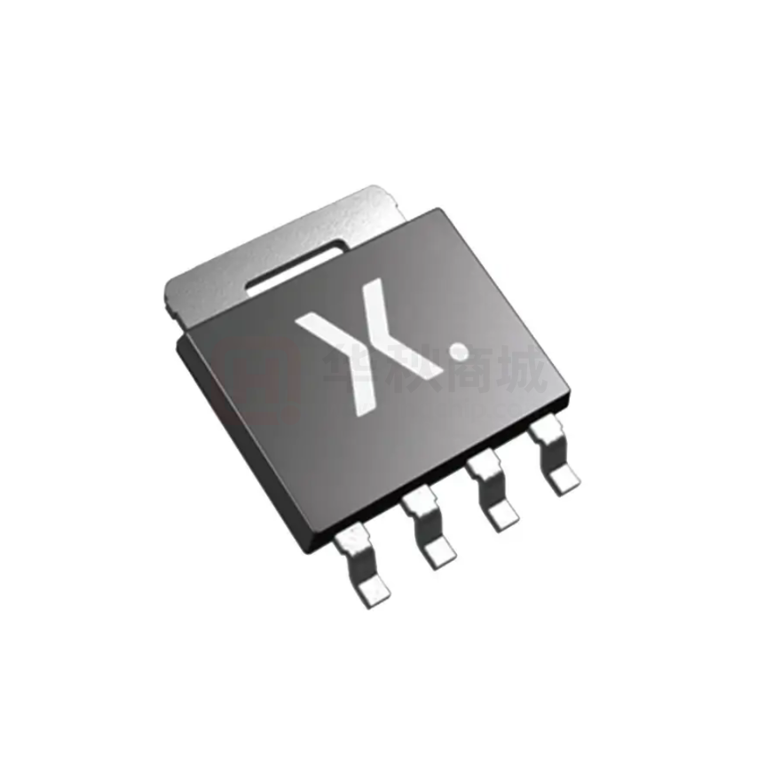

    MOS管 N-channel Id=300A VDS=30V SOT669
PSMNR70-30YLHX 数据手册
PSMNR70-30YLH N-channel 30 V, 0.82 mΩ, 300 A logic level MOSFET in LFPAK56 using NextPowerS3 technology 12 November 2019 Product data sheet 1. General description Logic level gate drive N-channel enhancement mode MOSFET in LFPAK56 package optimized for low RDSon. Low IDSS leakage even when hot, high efficiency and high current rated to 300 A, optimized for DC load switch and hot-swap applications. 2. Features and benefits • • • • • • • • 100% avalanche tested at I(AS) = 190 A Optimized for low RDSon Low leakage < 1 µA at 25 °C Low spiking and ringing for low EMI designs Optimized for 4.5 V gate drive Copper-clip for low parasitic inductance and resistance High reliability LFPAK package, qualified to 175 °C Wave solderable; exposed leads for optimal solder coverage and visual solder inspection 3. Applications • • • • • • • Hot swap e-fuse Power OR-ing DC switch / Load switch Battery protection Brushed and BLDC (brushless) motor control Synchronous rectification in AC-DC and DC-DC applications 4. Quick reference data Table 1. Quick reference data Symbol Parameter Conditions Min Typ Max Unit VDS drain-source voltage 25 °C ≤ Tj ≤ 175 °C - - 30 V ID drain current VGS = 10 V; Tmb = 25 °C; Fig. 2 - - 300 A Ptot total power dissipation Tmb = 25 °C; Fig. 1 - - 268 W Tj junction temperature -55 - 175 °C VGS = 10 V; ID = 25 A; Tj = 25 °C; Fig. 10 - 0.66 0.82 mΩ VGS = 4.5 V; ID = 25 A; Tj = 25 °C; Fig. 10 - 0.86 1.1 mΩ ID = 25 A; VDS = 15 V; VGS = 4.5 V; Fig. 12; Fig. 13 2.9 16 32 nC 21 46 76 nC [1] Static characteristics RDSon drain-source on-state resistance Dynamic characteristics QGD gate-drain charge QG(tot) total gate charge PSMNR70-30YLH Nexperia N-channel 30 V, 0.82 mΩ, 300 A logic level MOSFET in LFPAK56 using NextPowerS3 technology Symbol Parameter Conditions Min Typ Max IS = 25 A; dIS/dt = -100 A/µs; VGS = 0 V; VDS = 15 V; Fig. 16 - 0.96 - Unit Source-drain diode S [1] softness factor 300A continuous current has been successfully demonstrated during application tests. Practically the current will be limited by PCB, thermal design and operating temperature. 5. Pinning information Table 2. Pinning information Pin Symbol Description Simplified outline 1 S source 2 S source 3 S source 4 G gate mb D mounting base; connected to drain Graphic symbol D mb G mbb076 S 1 2 3 4 LFPAK56; PowerSO8 (SOT669) 6. Ordering information Table 3. Ordering information Type number Package PSMNR70-30YLH Name Description Version LFPAK56; Power-SO8 plastic, single-ended surface-mounted package; 4 terminals SOT669 7. Marking Table 4. Marking codes Type number Marking code PSMNR70-30YLH H7030L 8. Limiting values Table 5. Limiting values In accordance with the Absolute Maximum Rating System (IEC 60134). Symbol Parameter Conditions Min Max Unit VDS drain-source voltage 25 °C ≤ Tj ≤ 175 °C - 30 V VDGR drain-gate voltage 25 °C ≤ Tj ≤ 175 °C; RGS = 20 kΩ - 30 V VGS gate-source voltage -20 20 V Ptot total power dissipation Tmb = 25 °C; Fig. 1 - 268 W ID drain current VGS = 10 V; Tmb = 25 °C; Fig. 2 - 300 A VGS = 10 V; Tmb = 100 °C; Fig. 2 - 281 A IDM peak drain current pulsed; tp ≤ 10 µs; Tmb = 25 °C; Fig. 3 - 1589 A Tstg storage temperature -55 175 °C Tj junction temperature -55 175 °C PSMNR70-30YLH Product data sheet All information provided in this document is subject to legal disclaimers. 12 November 2019 [1] © Nexperia B.V. 2019. All rights reserved 2 / 13 PSMNR70-30YLH Nexperia N-channel 30 V, 0.82 mΩ, 300 A logic level MOSFET in LFPAK56 using NextPowerS3 technology Symbol Parameter Conditions Tsld(M) peak soldering temperature Min Max Unit - 260 °C Source-drain diode IS source current Tmb = 25 °C - 268 A ISM peak source current pulsed; tp ≤ 10 µs; Tmb = 25 °C - 1589 A Avalanche ruggedness EDS(AL)S non-repetitive drainID = 25 A; Vsup ≤ 30 V; RGS = 50 Ω; source avalanche energy VGS = 10 V; Tj(init) = 25 °C; unclamped; tp = 4.9 ms [2] - 2.4 J IAS non-repetitive avalanche Vsup ≤ 30 V; VGS = 10 V; Tj(init) = 25 °C; current RGS = 50 Ω [2] - 190 A [1] [2] 300A continuous current has been successfully demonstrated during application tests. Practically the current will be limited by PCB, thermal design and operating temperature. Protected by 100% test 03aa16 120 Pder (%) aaa-028230 400 ID (A) 300 (1) 80 200 40 100 0 Fig. 1. 0 50 100 150 Tmb (°C) 0 200 Fig. 2. Product data sheet 25 50 75 100 125 150 175 Tmb (°C) 200 VGS ≥ 10 V (1) 300A continuous current has been successfully demonstrated during application tests. Practically the current will be limited by PCB, thermal design and operating temperature. Normalized total power dissipation as a function of mounting base temperature PSMNR70-30YLH 0 Continuous drain current as a function of mounting base temperature All information provided in this document is subject to legal disclaimers. 12 November 2019 © Nexperia B.V. 2019. All rights reserved 3 / 13 PSMNR70-30YLH Nexperia N-channel 30 V, 0.82 mΩ, 300 A logic level MOSFET in LFPAK56 using NextPowerS3 technology ID (A) aaa-028245 104 103 Limit RDSon = VDS / ID tp = 10 µs 102 100 µs DC 10 1 ms 10 ms 100 ms 1 10-1 1 10 102 VDS (V) Tmb = 25 °C; IDM is a single pulse Fig. 3. Safe operating area; continuous and peak drain currents as a function of drain-source voltage 9. Thermal characteristics Table 6. Thermal characteristics Symbol Parameter Min Typ Max Unit Rth(j-mb) thermal resistance from Fig. 4 junction to mounting base Conditions - 0.48 0.56 K/W Rth(j-a) thermal resistance from Fig. 5 junction to ambient Fig. 6 - 42 - K/W - 85 - K/W aaa-028246 1 Zth(j-mb) (K/W) δ = 0.5 10-1 0.2 0.1 0.05 10-2 0.02 single shot P δ= Fig. 4. 10-5 10-4 10-3 10-2 T t tp 10-3 10-6 tp T 10-1 tp (s) 1 Transient thermal impedance from junction to mounting base as a function of pulse duration PSMNR70-30YLH Product data sheet All information provided in this document is subject to legal disclaimers. 12 November 2019 © Nexperia B.V. 2019. All rights reserved 4 / 13 PSMNR70-30YLH Nexperia N-channel 30 V, 0.82 mΩ, 300 A logic level MOSFET in LFPAK56 using NextPowerS3 technology aaa-027935 aaa-027933 Copper square 25.4 mm x 25.4 mm; 70 µm thick on FR4 board Fig. 5. PCB layout for thermal resistance from junction to ambient 70 µm thick copper on FR4 board Fig. 6. PCB layout with minimum footprint for thermal resistance from junction to ambient 10. Characteristics Table 7. Characteristics Symbol Parameter Conditions Min Typ Max Unit drain-source breakdown voltage ID = 250 µA; VGS = 0 V; Tj = 25 °C 30 - - V ID = 250 µA; VGS = 0 V; Tj = -55 °C 27 - - V VGS(th) gate-source threshold voltage ID = 2 mA; VDS=VGS; Tj = 25 °C 1.2 1.5 2.2 V ΔVGS(th)/ΔT gate-source threshold voltage variation with temperature 25 °C ≤ Tj ≤ 150 °C - -4.4 - mV/K IDSS drain leakage current VDS = 24 V; VGS = 0 V; Tj = 25 °C - - 1 µA VDS = 24 V; VGS = 0 V; Tj = 125 °C - 6.4 - µA VGS = 16 V; VDS = 0 V; Tj = 25 °C - - 100 nA VGS = -16 V; VDS = 0 V; Tj = 25 °C - - 100 nA VGS = 10 V; ID = 25 A; Tj = 25 °C; Fig. 10 - 0.66 0.82 mΩ VGS = 10 V; ID = 25 A; Tj = 150 °C; Fig. 11 - - 1.5 mΩ VGS = 4.5 V; ID = 25 A; Tj = 25 °C; Fig. 10 - 0.86 1.1 mΩ VGS = 4.5 V; ID = 25 A; Tj = 150 °C; Fig. 11 - - 2 mΩ f = 1 MHz; Tj = 25 °C 0.5 1.3 3.3 Ω ID = 25 A; VDS = 15 V; VGS = 4.5 V; Fig. 12; Fig. 13 21 46 76 nC ID = 25 A; VDS = 15 V; VGS = 10 V; Fig. 12; Fig. 13 43 95 157 nC ID = 0 A; VDS = 0 V; VGS = 10 V - 50 - nC Static characteristics V(BR)DSS IGSS RDSon RG gate leakage current drain-source on-state resistance gate resistance Dynamic characteristics QG(tot) total gate charge PSMNR70-30YLH Product data sheet All information provided in this document is subject to legal disclaimers. 12 November 2019 © Nexperia B.V. 2019. All rights reserved 5 / 13 PSMNR70-30YLH Nexperia N-channel 30 V, 0.82 mΩ, 300 A logic level MOSFET in LFPAK56 using NextPowerS3 technology Symbol Parameter Conditions Min Typ Max Unit QGS gate-source charge 3 11 21 nC QGS(th) pre-threshold gatesource charge ID = 25 A; VDS = 15 V; VGS = 4.5 V; Fig. 12; Fig. 13 2.2 8 15 nC QGS(th-pl) post-threshold gatesource charge 0.86 3.2 6.1 nC QGD gate-drain charge 2.9 16 32 nC VGS(pl) gate-source plateau voltage ID = 25 A; VDS = 15 V; Fig. 12; Fig. 13 - 2.3 - V Ciss input capacitance 3284 5473 8210 pF Coss output capacitance VDS = 15 V; VGS = 0 V; f = 1 MHz; Tj = 25 °C; Fig. 14 1702 2836 4254 pF Crss reverse transfer capacitance 129 478 1147 pF td(on) turn-on delay time - 28 - ns tr rise time - 51 - ns td(off) turn-off delay time - 61 - ns tf fall time Qoss output charge VDS = 15 V; RL = 0.6 Ω; VGS = 4.5 V; RG(ext) = 5 Ω - 45 - ns VGS = 0 V; VDS = 15 V; f = 1 MHz; Tj = 25 °C - 62 - nC Source-drain diode VSD source-drain voltage IS = 25 A; VGS = 0 V; Tj = 25 °C; Fig. 15 - 0.75 1 V trr reverse recovery time 46 - ns recovered charge IS = 25 A; dIS/dt = -100 A/µs; VGS = 0 V; VDS = 15 V; Fig. 16 [1] - Qr - 50 - nC ta reverse recovery rise time - 23.4 - ns tb reverse recovery fall time - 22.5 - ns S softness factor - 0.96 - [1] includes capacitive recovery 360 ID (A) 300 VGS = 3 V 10 V aaa-028247 4.5 V 2.8 V 240 aaa-028248 3 RDSon (mΩ) 2.5 2 180 1.5 2.6 V 120 1 2.4 V 60 0.5 2.2 V 0 Fig. 7. 0 1 2 3 VDS (V) 4 0 0 2 4 6 8 10 12 14 VGS (V) 16 Tj = 25 °C Tj = 25 °C; ID = 25 A Output characteristics; drain current as a Fig. 8. function of drain-source voltage; typical values Drain-source on-state resistance as a function of gate-source voltage; typical values PSMNR70-30YLH Product data sheet All information provided in this document is subject to legal disclaimers. 12 November 2019 © Nexperia B.V. 2019. All rights reserved 6 / 13 PSMNR70-30YLH Nexperia N-channel 30 V, 0.82 mΩ, 300 A logic level MOSFET in LFPAK56 using NextPowerS3 technology aaa-028249 360 ID (A) 300 RDSon (mΩ) aaa-028250 8 2.4 V 2.6 V 2.8 V 3V 6 240 180 4 120 2 150°C 60 0 0 0.5 1 1.5 2 Tj = 25°C 2.5 3 3.5 VGS (V) 4.5 V 0 4 VDS = 12 V Fig. 9. a VGS (V) 180 240 300 ID (A) 360 8 1.6 6 1.3 4 1 2 30 60 90 120 150 Tj (°C) aaa-028251 10 1.9 0 120 Fig. 10. Drain-source on-state resistance as a function of drain current; typical values aaa-028008 2.2 -30 60 Tj = 25 °C Transfer characteristics; drain current as a function of gate-source voltage; typical values 0.7 -60 VGS = 10 V 0 0 180 VDS = 6 V 24 V 15 V 0 20 40 60 80 100 QG (nC) 120 Tj = 25 °C; ID = 25 A Fig. 11. Normalized drain-source on-state resistance factor as a function of junction temperature PSMNR70-30YLH Product data sheet Fig. 12. Gate-source voltage as a function of gate charge; typical values All information provided in this document is subject to legal disclaimers. 12 November 2019 © Nexperia B.V. 2019. All rights reserved 7 / 13 PSMNR70-30YLH Nexperia N-channel 30 V, 0.82 mΩ, 300 A logic level MOSFET in LFPAK56 using NextPowerS3 technology aaa-028252 105 C (pF) VDS ID 104 VGS(pl) Ciss Coss VGS(th) VGS QGS2 QGS1 QGS 103 Crss QGD QG(tot) 003aaa508 102 10-1 Fig. 13. Gate charge waveform definitions 1 10 VDS (V) 102 VGS = 0 V; f = 1 MHz Fig. 14. Input, output and reverse transfer capacitances as a function of drain-source voltage; typical values IS (A) 003aal160 aaa-028253 103 ID (A) trr 102 ta tb 0 10 0.25 IRM 150°C 1 0 0.2 0.4 Tj = 25°C 0.6 0.8 1 VSD (V) IRM t (s) 1.2 Fig. 16. Reverse recovery timing definition VGS = 0 V Fig. 15. Source-drain (diode forward) current as a function of source-drain (diode forward) voltage; typical values PSMNR70-30YLH Product data sheet All information provided in this document is subject to legal disclaimers. 12 November 2019 © Nexperia B.V. 2019. All rights reserved 8 / 13 PSMNR70-30YLH Nexperia N-channel 30 V, 0.82 mΩ, 300 A logic level MOSFET in LFPAK56 using NextPowerS3 technology 11. Package outline Plastic single-ended surface-mounted package (LFPAK56; Power-SO8); 4 leads E A2 A SOT669 C c2 b2 E1 b3 L1 mounting base b4 D1 D H L2 1 2 3 e 4 w b A X c 1/2 e A (A3) A1 C q L detail X 0 y C θ 5 mm 8° scale 0° Dimensions (mm are the original dimensions) Unit(1) mm A A1 A2 A3 b b2 max 1.20 0.15 1.10 0.50 4.41 nom 0.25 min 1.01 0.00 0.95 0.35 3.62 c c2 D(1) D1(1) E(1) E1(1) b3 b4 2.2 0.9 0.25 0.30 4.10 4.20 5.0 3.3 2.0 0.7 0.19 0.24 3.80 4.8 3.1 e 1.27 H L L1 L2 6.2 0.85 1.3 1.3 5.8 0.40 0.8 0.8 Note 1. Plastic or metal protrusions of 0.15 mm maximum per side are not included. Outline version SOT669 References IEC JEDEC JEITA w y 0.25 0.1 sot669_po European projection Issue date 11-03-25 13-02-27 MO-235 Fig. 17. Package outline LFPAK56; Power-SO8 (SOT669) PSMNR70-30YLH Product data sheet All information provided in this document is subject to legal disclaimers. 12 November 2019 © Nexperia B.V. 2019. All rights reserved 9 / 13 PSMNR70-30YLH Nexperia N-channel 30 V, 0.82 mΩ, 300 A logic level MOSFET in LFPAK56 using NextPowerS3 technology 12. Soldering Footprint information for reflow soldering SOT669 4.7 4.2 0.9 (3×) 0.25 (2×) 0.25 (2×) 0.6 (4×) 3.45 0.6 (3×) 2 3.5 2.55 0.25 (2×) SR opening = Cu + 0.075 1.1 2.15 3.3 SP opening = Cu - 0.050 0.7 (4×) 1.27 3.81 solder lands solder paste 125 µm stencil solder resist occupied area Dimensions in mm sot669_fr Fig. 18. Reflow soldering footprint for LFPAK56; Power-SO8 (SOT669) PSMNR70-30YLH Product data sheet All information provided in this document is subject to legal disclaimers. 12 November 2019 © Nexperia B.V. 2019. All rights reserved 10 / 13 PSMNR70-30YLH Nexperia N-channel 30 V, 0.82 mΩ, 300 A logic level MOSFET in LFPAK56 using NextPowerS3 technology Wave soldering footprint information for LFPAK56 package SOT669 4.826 1.78 1.72 2.1 1.4 0.6 (x4) 1.27 0.635 solder lands Dimensions in mm Issue date 15-04-13 15-04-16 sot669_fw Fig. 19. Wave soldering footprint for LFPAK56; Power-SO8 (SOT669) PSMNR70-30YLH Product data sheet All information provided in this document is subject to legal disclaimers. 12 November 2019 © Nexperia B.V. 2019. All rights reserved 11 / 13 PSMNR70-30YLH Nexperia N-channel 30 V, 0.82 mΩ, 300 A logic level MOSFET in LFPAK56 using NextPowerS3 technology 13. Legal information injury, death or severe property or environmental damage. Nexperia and its suppliers accept no liability for inclusion and/or use of Nexperia products in such equipment or applications and therefore such inclusion and/or use is at the customer’s own risk. Data sheet status Quick reference data — The Quick reference data is an extract of the product data given in the Limiting values and Characteristics sections of this document, and as such is not complete, exhaustive or legally binding. Document status [1][2] Product status [3] Definition Objective [short] data sheet Development This document contains data from the objective specification for product development. Preliminary [short] data sheet Qualification This document contains data from the preliminary specification. Product [short] data sheet Production This document contains the product specification. [1] [2] [3] Please consult the most recently issued document before initiating or completing a design. The term 'short data sheet' is explained in section "Definitions". The product status of device(s) described in this document may have changed since this document was published and may differ in case of multiple devices. The latest product status information is available on the internet at https://www.nexperia.com. Definitions Draft — The document is a draft version only. The content is still under internal review and subject to formal approval, which may result in modifications or additions. Nexperia does not give any representations or warranties as to the accuracy or completeness of information included herein and shall have no liability for the consequences of use of such information. Short data sheet — A short data sheet is an extract from a full data sheet with the same product type number(s) and title. A short data sheet is intended for quick reference only and should not be relied upon to contain detailed and full information. For detailed and full information see the relevant full data sheet, which is available on request via the local Nexperia sales office. In case of any inconsistency or conflict with the short data sheet, the full data sheet shall prevail. Product specification — The information and data provided in a Product data sheet shall define the specification of the product as agreed between Nexperia and its customer, unless Nexperia and customer have explicitly agreed otherwise in writing. In no event however, shall an agreement be valid in which the Nexperia product is deemed to offer functions and qualities beyond those described in the Product data sheet. Disclaimers Limited warranty and liability — Information in this document is believed to be accurate and reliable. However, Nexperia does not give any representations or warranties, expressed or implied, as to the accuracy or completeness of such information and shall have no liability for the consequences of use of such information. Nexperia takes no responsibility for the content in this document if provided by an information source outside of Nexperia. In no event shall Nexperia be liable for any indirect, incidental, punitive, special or consequential damages (including - without limitation - lost profits, lost savings, business interruption, costs related to the removal or replacement of any products or rework charges) whether or not such damages are based on tort (including negligence), warranty, breach of contract or any other legal theory. Notwithstanding any damages that customer might incur for any reason whatsoever, Nexperia’s aggregate and cumulative liability towards customer for the products described herein shall be limited in accordance with the Terms and conditions of commercial sale of Nexperia. Right to make changes — Nexperia reserves the right to make changes to information published in this document, including without limitation specifications and product descriptions, at any time and without notice. This document supersedes and replaces all information supplied prior to the publication hereof. Suitability for use — Nexperia products are not designed, authorized or warranted to be suitable for use in life support, life-critical or safety-critical systems or equipment, nor in applications where failure or malfunction of an Nexperia product can reasonably be expected to result in personal PSMNR70-30YLH Product data sheet Applications — Applications that are described herein for any of these products are for illustrative purposes only. Nexperia makes no representation or warranty that such applications will be suitable for the specified use without further testing or modification. Customers are responsible for the design and operation of their applications and products using Nexperia products, and Nexperia accepts no liability for any assistance with applications or customer product design. It is customer’s sole responsibility to determine whether the Nexperia product is suitable and fit for the customer’s applications and products planned, as well as for the planned application and use of customer’s third party customer(s). Customers should provide appropriate design and operating safeguards to minimize the risks associated with their applications and products. Nexperia does not accept any liability related to any default, damage, costs or problem which is based on any weakness or default in the customer’s applications or products, or the application or use by customer’s third party customer(s). Customer is responsible for doing all necessary testing for the customer’s applications and products using Nexperia products in order to avoid a default of the applications and the products or of the application or use by customer’s third party customer(s). Nexperia does not accept any liability in this respect. Limiting values — Stress above one or more limiting values (as defined in the Absolute Maximum Ratings System of IEC 60134) will cause permanent damage to the device. Limiting values are stress ratings only and (proper) operation of the device at these or any other conditions above those given in the Recommended operating conditions section (if present) or the Characteristics sections of this document is not warranted. Constant or repeated exposure to limiting values will permanently and irreversibly affect the quality and reliability of the device. Terms and conditions of commercial sale — Nexperia products are sold subject to the general terms and conditions of commercial sale, as published at http://www.nexperia.com/profile/terms, unless otherwise agreed in a valid written individual agreement. In case an individual agreement is concluded only the terms and conditions of the respective agreement shall apply. Nexperia hereby expressly objects to applying the customer’s general terms and conditions with regard to the purchase of Nexperia products by customer. No offer to sell or license — Nothing in this document may be interpreted or construed as an offer to sell products that is open for acceptance or the grant, conveyance or implication of any license under any copyrights, patents or other industrial or intellectual property rights. Export control — This document as well as the item(s) described herein may be subject to export control regulations. Export might require a prior authorization from competent authorities. Non-automotive qualified products — Unless this data sheet expressly states that this specific Nexperia product is automotive qualified, the product is not suitable for automotive use. It is neither qualified nor tested in accordance with automotive testing or application requirements. Nexperia accepts no liability for inclusion and/or use of non-automotive qualified products in automotive equipment or applications. In the event that customer uses the product for design-in and use in automotive applications to automotive specifications and standards, customer (a) shall use the product without Nexperia’s warranty of the product for such automotive applications, use and specifications, and (b) whenever customer uses the product for automotive applications beyond Nexperia’s specifications such use shall be solely at customer’s own risk, and (c) customer fully indemnifies Nexperia for any liability, damages or failed product claims resulting from customer design and use of the product for automotive applications beyond Nexperia’s standard warranty and Nexperia’s product specifications. Translations — A non-English (translated) version of a document is for reference only. The English version shall prevail in case of any discrepancy between the translated and English versions. Trademarks Notice: All referenced brands, product names, service names and trademarks are the property of their respective owners. All information provided in this document is subject to legal disclaimers. 12 November 2019 © Nexperia B.V. 2019. All rights reserved 12 / 13 PSMNR70-30YLH Nexperia N-channel 30 V, 0.82 mΩ, 300 A logic level MOSFET in LFPAK56 using NextPowerS3 technology Contents 1. General description...................................................... 1 2. Features and benefits.................................................. 1 3. Applications.................................................................. 1 4. Quick reference data....................................................1 5. Pinning information......................................................2 6. Ordering information....................................................2 7. Marking.......................................................................... 2 8. Limiting values............................................................. 2 9. Thermal characteristics............................................... 4 10. Characteristics............................................................ 5 11. Package outline.......................................................... 9 12. Soldering................................................................... 10 13. Legal information......................................................12 © Nexperia B.V. 2019. All rights reserved For more information, please visit: http://www.nexperia.com For sales office addresses, please send an email to: salesaddresses@nexperia.com Date of release: 12 November 2019 PSMNR70-30YLH Product data sheet All information provided in this document is subject to legal disclaimers. 12 November 2019 © Nexperia B.V. 2019. All rights reserved 13 / 13
