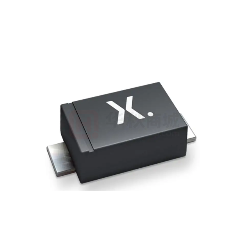

    TVS二极管 VRWM=22 V VBR(Min)=24.4 V VC=35.5V IPP=11.3 A Ppp=400 W SOD123W
PTVS22VS1UR/8X 数据手册
PTVSxS1UR series 400 W Transient Voltage Suppressor Rev. 3 — 10 January 2011 Product data sheet 1. Product profile 1.1 General description 400 W unidirectional Transient Voltage Suppressor (TVS) in a SOD123W small and flat lead low-profile Surface-Mounted Device (SMD) plastic package, designed for transient overvoltage protection. 1.2 Features and benefits „ Rated peak pulse power: PPPM = 400 W (350 W for 3V3) „ Reverse standoff voltage range: VRWM = 3.3 V to 64 V „ Reverse current: IRM = 0.001 μA „ Small plastic package suitable for surface-mounted design „ Very low package height: 1 mm „ AEC-Q101 qualified 1.3 Applications „ „ „ „ Power supply protection Automotive application Industrial application Power management 1.4 Quick reference data Table 1. Quick reference data Symbol Parameter PPPM rated peak pulse power VRWM reverse standoff voltage Conditions [1][2] [1] In accordance with IEC 61643-321 (10/1000 μs current waveform). [2] For PTVS3V3S1UR: PPPM = 350 W Min Typ Max Unit - - 400 W 3.3 - 64 V PTVSxS1UR series Nexperia 400 W Transient Voltage Suppressor 2. Pinning information Table 2. Pinning Pin Description 1 cathode 2 anode Simplified outline Graphic symbol [1] 1 2 2 1 006aaa152 [1] The marking bar indicates the cathode. 3. Ordering information Table 3. Ordering information Type number[1] Package PTVSxS1UR series [1] Name Description Version - plastic surface-mounted package; 2 leads SOD123W The series consists of 35 types with reverse standoff voltages from 3.3 V to 64 V. 4. Marking Table 4. PTVSxS1UR_SER Product data sheet Marking codes Type number Marking code Type number Marking code PTVS3V3S1UR A1 PTVS20VS1UR AL PTVS5V0S1UR A2 PTVS22VS1UR AM PTVS6V0S1UR A3 PTVS24VS1UR AN PTVS6V5S1UR A4 PTVS26VS1UR AP PTVS7V0S1UR A5 PTVS28VS1UR AR PTVS7V5S1UR A6 PTVS30VS1UR AS PTVS8V0S1UR A7 PTVS33VS1UR AT PTVS8V5S1UR A8 PTVS36VS1UR AU PTVS9V0S1UR A9 PTVS40VS1UR AV PTVS10VS1UR AA PTVS43VS1UR AW PTVS11VS1UR AB PTVS45VS1UR AX PTVS12VS1UR AC PTVS48VS1UR AY PTVS13VS1UR AD PTVS51VS1UR AZ PTVS14VS1UR AE PTVS54VS1UR B1 PTVS15VS1UR AF PTVS58VS1UR B2 PTVS16VS1UR AG PTVS60VS1UR B3 PTVS17VS1UR AH PTVS64VS1UR B4 PTVS18VS1UR AK - - All information provided in this document is subject to legal disclaimers. Rev. 3 — 10 January 2011 © Nexperia B.V. 2017. All rights reserved 2 of 12 PTVSxS1UR series Nexperia 400 W Transient Voltage Suppressor 5. Limiting values Table 5. Limiting values In accordance with the Absolute Maximum Rating System (IEC 60134). Symbol PPPM Parameter Conditions rated peak pulse power Min Max Unit [1][2] - 400 W [1] - see Table 9 and 10 - 50 A IPPM rated peak pulse current IFSM Non-repetitive peak forward current Tj junction temperature - 150 °C Tamb ambient temperature −55 +150 °C Tstg storage temperature −65 +150 °C single half-sine wave; tp = 8.3 ms [1] In accordance with IEC 61643-321 (10/1000 μs current waveform). [2] For PTVS3V3S1UR: PPPM = 350 W Table 6. ESD maximum ratings Tamb = 25 °C unless otherwise specified. Symbol Parameter Conditions electrostatic discharge voltage IEC 61000-4-2 (contact discharge) Min Max Unit - 30 kV Per diode VESD [1][2] [1] Device stressed with ten non-repetitive ElectroStatic Discharge (ESD) pulses. [2] Soldering point of cathode tab. Table 7. ESD standards compliance Standard Conditions Per diode PTVSxS1UR_SER Product data sheet IEC 61000-4-2; level 4 (ESD) > 15 kV (air); > 8 kV (contact) MIL-STD-883; class 3 (human body model) > 4 kV All information provided in this document is subject to legal disclaimers. Rev. 3 — 10 January 2011 © Nexperia B.V. 2017. All rights reserved 3 of 12 PTVSxS1UR series Nexperia 400 W Transient Voltage Suppressor 6. Thermal characteristics Table 8. Symbol Rth(j-a) Rth(j-sp) Thermal characteristics Parameter Conditions thermal resistance from junction to ambient in free air thermal resistance from junction to solder point Min Typ Max Unit [1] - - 220 K/W [2] - - 130 K/W [3] - - 70 K/W [4] - - 18 K/W [1] Device mounted on an FR4 Printed-Circuit Board (PCB), single-sided copper, tin-plated and standard footprint. [2] Device mounted on an FR4 PCB, single-sided copper, tin-plated, mounting pad for cathode 1 cm2. [3] Device mounted on a ceramic PCB, Al2O3, standard footprint. [4] Soldering point of cathode tab. 7. Characteristics Table 9. Characteristics per type; PTVS3V3S1UR to PTVS7V0S1UR Tj = 25 °C unless otherwise specified. Type number Reverse standoff voltage Breakdown voltage VBR (V) VRWM (V) Clamping voltage VCL (V) IRM (μA) IR = 10 mA PTVS3V3S1UR Reverse leakage current at VRWM (V) Max Min Typ Max Typ Max Max IPPM (A) 3.3 5.20 5.60 6.00 5 600 8.0 43.8 PTVS5V0S1UR 5.0 6.40 6.70 7.00 5 400 9.2 43.5 PTVS6V0S1UR 6.0 6.67 7.02 7.37 5 400 10.3 38.8 PTVS6V5S1UR 6.5 7.22 7.60 7.98 5 250 11.2 35.7 PTVS7V0S1UR 7.0 7.78 8.20 8.60 3 100 12.0 33.3 Table 10. Characteristics per type; PTVS7V5S1UR to PTVS64VS1UR Tj = 25 °C unless otherwise specified. Type number Reverse standoff voltage Breakdown voltage VBR (V) VRWM (V) Clamping voltage VCL (V) IRM (μA) IR = 1 mA Max Reverse leakage current at VRWM (V) Min Typ Max Typ Max Max IPPM (A) PTVS7V5S1UR 7.5 8.33 8.77 9.21 0.2 50 12.9 31.0 PTVS8V0S1UR 8.0 8.89 9.36 9.83 0.03 25 13.6 29.4 PTVS8V5S1UR 8.5 9.44 9.92 10.40 0.01 10 14.4 27.8 PTVS9V0S1UR 9.0 10.00 10.55 11.10 0.005 5 15.4 26.0 PTVS10VS1UR 10 11.10 11.70 12.30 0.005 2.5 17.0 23.5 PTVS11VS1UR 11 12.20 12.85 13.50 0.005 2.5 18.2 22.0 PTVS12VS1UR 12 13.30 14.00 14.70 0.005 2.5 19.9 20.1 PTVS13VS1UR 13 14.40 15.15 15.90 0.001 0.1 21.5 18.6 PTVSxS1UR_SER Product data sheet All information provided in this document is subject to legal disclaimers. Rev. 3 — 10 January 2011 © Nexperia B.V. 2017. All rights reserved 4 of 12 PTVSxS1UR series Nexperia 400 W Transient Voltage Suppressor Table 10. Characteristics per type; PTVS7V5S1UR to PTVS64VS1UR …continued Tj = 25 °C unless otherwise specified. Type number Reverse standoff voltage Breakdown voltage VBR (V) VRWM (V) Reverse leakage current Clamping voltage VCL (V) IRM (μA) IR = 1 mA at VRWM (V) Max Min Typ Max Typ Max Max IPPM (A) PTVS14VS1UR 14 15.60 16.40 17.20 0.001 0.1 23.2 17.2 PTVS15VS1UR 15 16.70 17.60 18.50 0.001 0.1 24.4 16.4 PTVS16VS1UR 16 17.80 18.75 19.70 0.001 0.1 26.0 15.4 PTVS17VS1UR 17 18.90 19.90 20.90 0.001 0.1 27.6 14.5 PTVS18VS1UR 18 20.00 21.00 22.10 0.001 0.1 29.2 13.7 PTVS20VS1UR 20 22.20 23.35 24.50 0.001 0.1 32.4 12.3 PTVS22VS1UR 22 24.40 25.60 26.90 0.001 0.1 35.5 11.3 PTVS24VS1UR 24 26.70 28.10 29.50 0.001 0.1 38.9 10.3 PTVS26VS1UR 26 28.90 30.40 31.90 0.001 0.1 42.1 9.5 PTVS28VS1UR 28 31.10 32.80 34.40 0.001 0.1 45.4 8.8 PTVS30VS1UR 30 33.30 35.10 36.80 0.001 0.1 48.4 8.3 PTVS33VS1UR 33 36.70 38.70 40.60 0.001 0.1 53.3 7.5 PTVS36VS1UR 36 40.00 42.10 44.20 0.001 0.1 58.1 6.9 PTVS40VS1UR 40 44.40 46.80 49.10 0.001 0.1 64.5 6.2 PTVS43VS1UR 43 47.80 50.30 52.80 0.001 0.1 69.4 5.8 PTVS45VS1UR 45 50.00 52.65 55.30 0.001 0.1 72.7 5.5 PTVS48VS1UR 48 53.30 56.10 58.90 0.001 0.1 77.4 5.2 PTVS51VS1UR 51 56.70 59.70 62.70 0.001 0.1 82.4 4.9 PTVS54VS1UR 54 60.00 63.15 66.30 0.001 0.1 87.1 4.6 PTVS58VS1UR 58 64.40 67.80 71.20 0.001 0.1 93.6 4.3 PTVS60VS1UR 60 66.70 70.20 73.70 0.001 0.1 96.8 4.1 PTVS64VS1UR 64 71.10 74.85 78.60 0.001 0.1 103.0 3.9 PTVSxS1UR_SER Product data sheet All information provided in this document is subject to legal disclaimers. Rev. 3 — 10 January 2011 © Nexperia B.V. 2017. All rights reserved 5 of 12 PTVSxS1UR series Nexperia 400 W Transient Voltage Suppressor 006aab319 150 006aab321 1.2 PPPM IPP (%) PPPM(25°C) 100 % IPP; 10 μs 100 0.8 50 % IPP; 1000 μs 0.4 50 0 0 0 1.0 2.0 3.0 0 4.0 50 100 150 Fig 1. 200 Tj (°C) tp (ms) 10/1000 μs pulse waveform according to IEC 61643-321 Fig 2. Relative variation of rated peak pulse power as a function of junction temperature; typical values 006aab418 105 PPPM (W) 104 (1) (2) 103 102 10−1 1 10 102 103 104 tp (μs) Tamb = 25 °C (1) PTVS5V0S1UR to PTVS64VS1UR (2) PTVS3V3S1UR Fig 3. Rated peak pulse power as a function of pulse duration; typical values PTVSxS1UR_SER Product data sheet All information provided in this document is subject to legal disclaimers. Rev. 3 — 10 January 2011 © Nexperia B.V. 2017. All rights reserved 6 of 12 PTVSxS1UR series Nexperia 400 W Transient Voltage Suppressor I −VCL −VBR −VRWM V −IRM −IR − + P-N −IPP −IPPM Fig 4. 006aab324 V-I characteristics for a unidirectional TVS protection diode 8. Test information 8.1 Quality information This product has been qualified in accordance with the Automotive Electronics Council (AEC) standard Q101 - Stress test qualification for discrete semiconductors, and is suitable for use in automotive applications. 9. Package outline 1.9 1.5 1.1 0.9 1 0.6 0.3 3.7 3.3 2.8 2.4 2 1.05 0.75 Dimensions in mm Fig 5. PTVSxS1UR_SER Product data sheet 0.22 0.10 08-11-06 Package outline SOD123W All information provided in this document is subject to legal disclaimers. Rev. 3 — 10 January 2011 © Nexperia B.V. 2017. All rights reserved 7 of 12 PTVSxS1UR series Nexperia 400 W Transient Voltage Suppressor 10. Packing information Table 11. Packing methods The indicated -xxx are the last three digits of the 12NC ordering code.[1] Type number[2] Package Description Packing quantity 3000 PTVSxS1UR series SOD123W 4 mm pitch, 8 mm tape and reel -115 [1] For further information and the availability of packing methods, see Section 14. [2] The series consists of 35 types with reverse standoff voltages from 3.3 V to 64 V. 11. Soldering 4.4 2.9 2.8 solder lands solder resist 1.1 1.2 (2×) (2×) 2.1 1.6 solder paste occupied area 1.1 (2×) 1.2 (2×) Dimensions in mm sod123w_fr Reflow soldering is the only recommended soldering method. Fig 6. PTVSxS1UR_SER Product data sheet Reflow soldering footprint SOD123W All information provided in this document is subject to legal disclaimers. Rev. 3 — 10 January 2011 © Nexperia B.V. 2017. All rights reserved 8 of 12 PTVSxS1UR series Nexperia 400 W Transient Voltage Suppressor 12. Revision history Table 12. Revision history Document ID Release date Data sheet status Change notice Supersedes PTVSXS1UR_SER v.3 20110110 Product data sheet - PTVSXS1UR_SER v.2 Modifications: • • Table 6 and 7: added. Section 13 “Legal information”: updated. PTVSXS1UR_SER v.2 20090910 Product data sheet - PTVSXS1UR_SER v.1 PTVSXS1UR_SER v.1 20090202 Product data sheet - - PTVSxS1UR_SER Product data sheet All information provided in this document is subject to legal disclaimers. Rev. 3 — 10 January 2011 © Nexperia B.V. 2017. All rights reserved 9 of 12 PTVSxS1UR series Nexperia 400 W Transient Voltage Suppressor 13. Legal information 13.1 Data sheet status Document status[1][2] Product status[3] Definition Objective [short] data sheet Development This document contains data from the objective specification for product development. Preliminary [short] data sheet Qualification This document contains data from the preliminary specification. Product [short] data sheet Production This document contains the product specification. [1] Please consult the most recently issued document before initiating or completing a design. [2] The term ‘short data sheet’ is explained in section “Definitions”. [3] The product status of device(s) described in this document may have changed since this document was published and may differ in case of multiple devices. The latest product status information is available on the Internet at URL http://www.nexperia.com. 13.2 Definitions Draft — The document is a draft version only. The content is still under internal review and subject to formal approval, which may result in modifications or additions. Nexperia does not give any representations or warranties as to the accuracy or completeness of information included herein and shall have no liability for the consequences of use of such information. Short data sheet — A short data sheet is an extract from a full data sheet with the same product type number(s) and title. A short data sheet is intended for quick reference only and should not be relied upon to contain detailed and full information. For detailed and full information see the relevant full data sheet, which is available on request via the local Nexperia sales office. In case of any inconsistency or conflict with the short data sheet, the full data sheet shall prevail. Product specification — The information and data provided in a Product data sheet shall define the specification of the product as agreed between Nexperia and its customer, unless Nexperia and customer have explicitly agreed otherwise in writing. In no event however, shall an agreement be valid in which the Nexperia product is deemed to offer functions and qualities beyond those described in the Product data sheet. 13.3 Disclaimers Limited warranty and liability — Information in this document is believed to be accurate and reliable. However, Nexperia does not give any representations or warranties, expressed or implied, as to the accuracy or completeness of such information and shall have no liability for the consequences of use of such information. In no event shall Nexperia be liable for any indirect, incidental, punitive, special or consequential damages (including - without limitation - lost profits, lost savings, business interruption, costs related to the removal or replacement of any products or rework charges) whether or not such damages are based on tort (including negligence), warranty, breach of contract or any other legal theory. Notwithstanding any damages that customer might incur for any reason whatsoever, Nexperia’s aggregate and cumulative liability towards customer for the products described herein shall be limited in accordance with the Terms and conditions of commercial sale of Nexperia. malfunction of a Nexperia product can reasonably be expected to result in personal injury, death or severe property or environmental damage. Nexperia accepts no liability for inclusion and/or use of Nexperia products in such equipment or applications and therefore such inclusion and/or use is at the customer’s own risk. Applications — Applications that are described herein for any of these products are for illustrative purposes only. Nexperia makes no representation or warranty that such applications will be suitable for the specified use without further testing or modification. Customers are responsible for the design and operation of their applications and products using Nexperia products, and Nexperia accepts no liability for any assistance with applications or customer product design. It is customer’s sole responsibility to determine whether the Nexperia product is suitable and fit for the customer’s applications and products planned, as well as for the planned application and use of customer’s third party customer(s). Customers should provide appropriate design and operating safeguards to minimize the risks associated with their applications and products. Nexperia does not accept any liability related to any default, damage, costs or problem which is based on any weakness or default in the customer’s applications or products, or the application or use by customer’s third party customer(s). Customer is responsible for doing all necessary testing for the customer’s applications and products using Nexperia products in order to avoid a default of the applications and the products or of the application or use by customer’s third party customer(s). Nexperia does not accept any liability in this respect. Limiting values — Stress above one or more limiting values (as defined in the Absolute Maximum Ratings System of IEC 60134) will cause permanent damage to the device. Limiting values are stress ratings only and (proper) operation of the device at these or any other conditions above those given in the Recommended operating conditions section (if present) or the Characteristics sections of this document is not warranted. Constant or repeated exposure to limiting values will permanently and irreversibly affect the quality and reliability of the device. Terms and conditions of commercial sale — Nexperia products are sold subject to the general terms and conditions of commercial sale, as published at http://www.nexperia.com/profile/terms, unless otherwise agreed in a valid written individual agreement. In case an individual agreement is concluded only the terms and conditions of the respective agreement shall apply. Nexperia hereby expressly objects to applying the customer’s general terms and conditions with regard to the purchase of Nexperia products by customer. Right to make changes — Nexperia reserves the right to make changes to information published in this document, including without limitation specifications and product descriptions, at any time and without notice. This document supersedes and replaces all information supplied prior to the publication hereof. No offer to sell or license — Nothing in this document may be interpreted or construed as an offer to sell products that is open for acceptance or the grant, conveyance or implication of any license under any copyrights, patents or other industrial or intellectual property rights. Suitability for use — Nexperia products are not designed, authorized or warranted to be suitable for use in life support, life-critical or safety-critical systems or equipment, nor in applications where failure or Export control — This document as well as the item(s) described herein may be subject to export control regulations. Export might require a prior authorization from national authorities. PTVSxS1UR_SER Product data sheet All information provided in this document is subject to legal disclaimers. Rev. 3 — 10 January 2011 © Nexperia B.V. 2017. All rights reserved 10 of 12 PTVSxS1UR series Nexperia 400 W Transient Voltage Suppressor Quick reference data — The Quick reference data is an extract of the product data given in the Limiting values and Characteristics sections of this document, and as such is not complete, exhaustive or legally binding. 13.4 Trademarks Notice: All referenced brands, product names, service names and trademarks are the property of their respective owners. 14. Contact information For more information, please visit: http://www.nexperia.com For sales office addresses, please send an email to: salesaddresses@nexperia.com PTVSxS1UR_SER Product data sheet All information provided in this document is subject to legal disclaimers. Rev. 3 — 10 January 2011 © Nexperia B.V. 2017. All rights reserved 11 of 12 Nexperia PTVSxS1UR series 400 W Transient Voltage Suppressor 15. Contents 1 1.1 1.2 1.3 1.4 2 3 4 5 6 7 8 8.1 9 10 11 12 13 13.1 13.2 13.3 13.4 14 15 © Product profile . . . . . . . . . . . . . . . . . . . . . . . . . . 1 General description . . . . . . . . . . . . . . . . . . . . . 1 Features and benefits . . . . . . . . . . . . . . . . . . . . 1 Applications . . . . . . . . . . . . . . . . . . . . . . . . . . . 1 Quick reference data . . . . . . . . . . . . . . . . . . . . 1 Pinning information . . . . . . . . . . . . . . . . . . . . . . 2 Ordering information . . . . . . . . . . . . . . . . . . . . . 2 Marking . . . . . . . . . . . . . . . . . . . . . . . . . . . . . . . . 2 Limiting values. . . . . . . . . . . . . . . . . . . . . . . . . . 3 Thermal characteristics . . . . . . . . . . . . . . . . . . 4 Characteristics . . . . . . . . . . . . . . . . . . . . . . . . . . 4 Test information . . . . . . . . . . . . . . . . . . . . . . . . . 7 Quality information . . . . . . . . . . . . . . . . . . . . . . 7 Package outline . . . . . . . . . . . . . . . . . . . . . . . . . 7 Packing information . . . . . . . . . . . . . . . . . . . . . 8 Soldering . . . . . . . . . . . . . . . . . . . . . . . . . . . . . . 8 Revision history . . . . . . . . . . . . . . . . . . . . . . . . . 9 Legal information. . . . . . . . . . . . . . . . . . . . . . . 10 Data sheet status . . . . . . . . . . . . . . . . . . . . . . 10 Definitions . . . . . . . . . . . . . . . . . . . . . . . . . . . . 10 Disclaimers . . . . . . . . . . . . . . . . . . . . . . . . . . . 10 Trademarks. . . . . . . . . . . . . . . . . . . . . . . . . . . 11 Contact information. . . . . . . . . . . . . . . . . . . . . 11 Contents . . . . . . . . . . . . . . . . . . . . . . . . . . . . . . 12 Nexperia B.V. 2017. All rights reserved For more information, please visit: http://www.nexperia.com For sales office addresses, please send an email to: salesaddresses@nexperia.com Date of release: 10 January 2011
