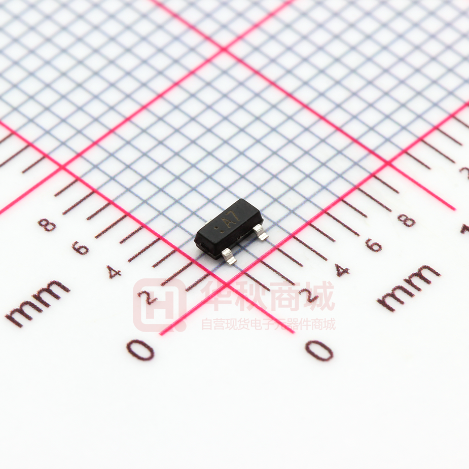

    开关二极管(小信号) VR=70V IF=200mA VF=1.25V IR=2.5uA
BAV99 数据手册
BAW56/BAV70/BAV99 SOT-23 Plastic-Encapsulate Diodes BAW56/BAV70/BAV99 SWITCHING DIODE SOT-23 FEATURES z z z Fast Switching Speed For General Purpose Switching Applications High Conductance BAW56 BAV70 MARKING:A1 MARKING:A4 A1 BAV99 MARKING:A7 A4 A7 Maximum Ratings @Ta=25℃ Parameter Symbol Limit Unit Reverse Voltage VR 70 V Forward Current IF 200 mA IFSM 2.0 A PD 225 mW RθJA 556 ℃/W TJ 150 ℃ TSTG -55~+150 ℃ Non-Repetitive Peak Forward Surge Current @t=8.3ms Power Dissipation Thermal Resistance Junction to Ambient Junction Temperature Storage Temperature range Electrical Characteristics @Ta=25℃ Parameter Reverse breakdown voltage Forward voltage Symbol Test Conditions Min Typ Max Unit VR IR=100μA V VF1 IF=1mA 0.715 V VF2 IF=10mA 0.855 V VF3 IF=50mA 1 V VF4 IF=150mA 1.25 V 70 Reverse current IR VR=70V 2.5 μA Capacitance between terminals CT VR=0,f=1MHz 1.5 pF Reverse recovery time trr 6 ns http://www.microdiode.com IF = IR = 10mA, Irr= 0.1 x IR, RL = 100Ω Rev:2025A3 Page :1 BAW56/BAV70/BAV99 Typical Characteristics Forward Reverse Characteristics Characteristics 1000 300 100 (nA) REVERSE CURRENT IR FORWARD CURRENT 10 Ta=100℃ 100 Ta =2 5℃ Ta =1 00 ℃ 30 IF (mA) 300 3 1 30 10 Ta=25℃ 3 0.3 0.1 0.0 1 0.4 0.8 FORWARD VOLTAGE 1.2 VF 0 1.6 40 20 (V) REVERSE VOLTAGE 60 VR 80 (V) Power Derating Curve Capacitance Characteristics 1.8 300 Ta=25℃ f=1MHz (mW) PD 1.6 POWER DISSIPATION CAPACITANCE BETWEEN TERMINALS CT (pF) 250 1.4 1.2 200 150 100 50 1.0 0 0 5 10 REVERSE VOLTAGE http://www.microdiode.com 15 VR (V) 20 0 25 50 75 AMBIENT TEMPERATURE Rev:2025A3 100 Ta 125 150 (℃) Page :2 BAW56/BAV70/BAV99 Outlitne Drawing SOT-23 Package Outline Dimensions 1 e Suggested Pad Layout 0.037 0.95 0.037 0.95 L L1 E E1 Symbol A A1 b c D E E1 e L L1 θ Dimensions In Millimeters Min Typ Max 0.65 1.40 0.20 0.00 0.30 0.55 0.20 0.08 2.70 3.10 1.15 1.65 2.80 2.10 1.70 2.10 0.15 0.50 0.35 0° 0.70 12° Note: 1. Controlling dimension:in/millimeters. 2. General tolerance: ±0.05mm. 3. The pad layout is for reference purposes only. 0.079 2.0 0.035 0.9 0.031 0.8 http://www.microdiode.com inches mm Rev:2025A3 Page :3 BAW56/BAV70/BAV99 SOT-23 Tape and Reel Packaging Description: SOT-23 parts are shipped in tape. The carrier tape is made from a dissipative (carbon filled) polycarbonate resin. The cover tape is a multilayer film (Heat Activated Adhesive in nature) primarily composed of polyester film,adhesive laye,sealant, and anti-static sprayed agent.These reeled parts In standard option are shipped with 3,000 units per 7" or 17.8cm diameter reel. The reels are clear in color and is made of polystyrene plastic (anti-static coated). 3000 pcs http://www.microdiode.com 7 Inch 45,000 pcs 190*190*190 180,000 pcs 400*400*220 Rev:2025A3 Page :4
