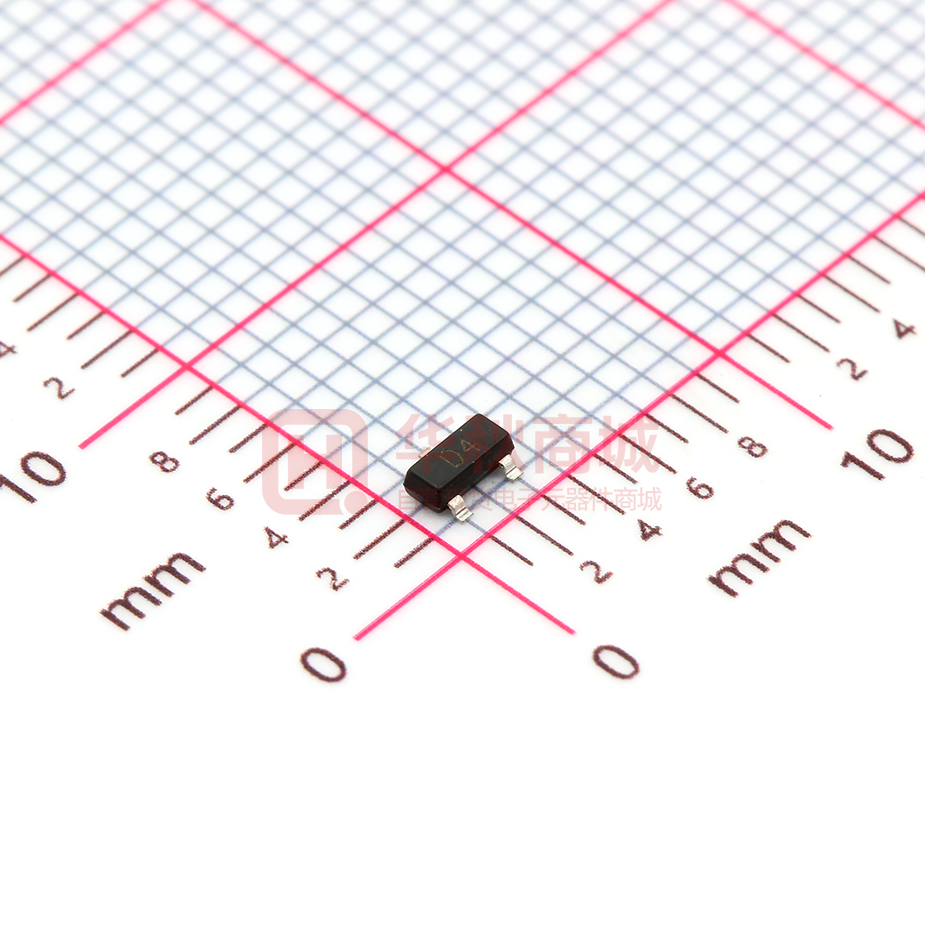

MMBD4148SE
MMBD4148SE
    MDD(辰达半导体)
    SOT-23
    VR=100V IF=0.2A VF=1.0V IR=100uA trr=4nS
MMBD4148SE 数据手册
MMBD4148A/CA/CC/SE SOT-23 Plastic-Encapsulate Diodes MMBD4148A/CA/CC/SE SWITCHING DIODE SOT-23 FEATURES  Fast Switching Speed  For General Purpose Switching Applications  High Conductance Marking: MMBD4148A MMBD4148CC MMBD4148CA MARKING:5H MARKING:D6 5H D6 MMBD4148SE MARKING:D5 MARKING:D4 D5 D4 Solid dot = Green molding compound device, D5 D6 5H if none, the normal device D4 Maximum Ratings and Electrical Characteristics, Single Diode @Ta=25℃ Symbo Parameter Limit Unit Non-Repetitive Peak Reverse Voltage VRM Peak Repetitive Peak Reverse Voltage Working Peak Reverse Voltage DC Blocking Voltage VRRM VRWM VR 100 V VR(RMS) 72 V RMS Reverse Voltage 100 V Forward Continuous Current IFM 300 mA Average Rectified Output Current IO 200 mA Non-Repetitive Peak Forward Surge Current @ 8.3ms IFSM 2.0 A Power Dissipation Pd 350 mW RθJA 357 ℃/W Junction Temperature Tj 150 ℃ Storage Temperature TSTG -55~+150 ℃ Thermal Resistance Junction to Ambient ELECTRICAL CHARACTERISTICS (Ta=25℃ unless otherwise specified) Parameter Reverse breakdown voltage Forward voltage Symbol Min Typ Max Unit Conditions V (BR) 1 100 V IR=100μA V (BR) 2 75 V IR=5μA VF 1 V IF=10mA IR1 5 μA VR=75V IR2 25 nA VR=25V Capacitance between terminals CT 4 pF VR=0V,f=1MHz Reverse recovery time trr 4 ns Reverse current IF=IR=10mA, VR=6V, Irr=0.1XIR,RL=100Ω The above data are for reference only. https://www.microdiode.com Rev:2024A1 Page :1 MMBD4148A/CA/CC/SE Typical Characteristics Forward Characteristics Reverse 1000 300 Characteristics 100 (nA) (mA) 300 REVERSE CURRENT IR FORWARD CURRENT 10 T= a 2 5℃ T= a 1 00 ℃ IF 30 3 1 Ta=100℃ 100 30 10 Ta=25℃ 3 0.3 0.1 0.0 0.4 0.8 FORWARD VOLTAGE 1.2 VF 1 1.6 20 60 40 REVERSE VOLTAGE Capacitance Characteristics 1.4 0 (V) VR 80 (V) Power Derating Curve 400 Ta=25℃ (mW) 300 PD 1.3 POWER DISSIPATION CAPACITANCE BETWEEN TERMINALS CT (pF) f=1MHz 1.2 1.1 1.0 200 100 0 0 5 10 REVERSE VOLTAGE https://www.microdiode.com 15 VR (V) 20 0 25 50 75 AMBIENT TEMPERATURE Rev:2024A1 125 100 Ta 150 (℃ ) Page :2 MMBD4148A/CA/CC/SE Outlitne Drawing SOT-23 Package Outline Dimensions θ A A1 b c D E E1 e L L1 θ L L1 E E1 Symbol 1 e Suggested Pad Layout 0.037 0.95 0.037 0.95 Dimensions In Millimeters Min Typ Max 0.90 1.40 0.10 0.00 0.30 0.50 0.20 0.08 2.80 2.90 3.10 1.20 1.60 2.80 2.25 1.80 1.90 2.00 0.10 0.50 0.55 10° 0.4 0° Note: 1.Controlling dimension:in/millimeters. 2.General tolerance: ±0.05mm. 3.The pad layout is for reference purposes only. 0.079 2.0 0.035 0.9 0.031 0.8 inches mm PACKAGE SPECIFICATIONS Package Reel Size SOT-23 Reel DIA. (mm) Q'TY/Reel (pcs) Box Size (mm) QTY/Box (pcs) Carton Size (mm) Q'TY/Carton (pcs) 330 3000 203×203×195 45000 438×438×220 180000 7' https://www.microdiode.com Rev:2024A1 Page :3
