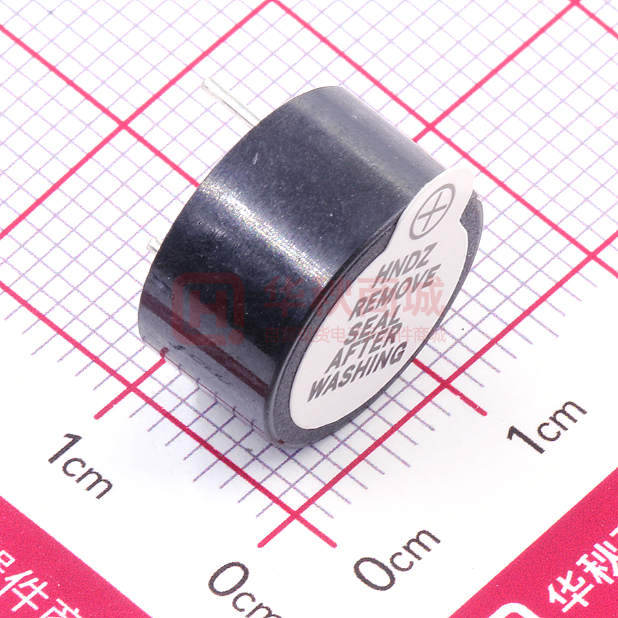

    压电蜂鸣器 14*7mm 3V~7V 4.5KHz 80dB
HND-1407B 数据手册
HND-1407B SPEC V1.0 规格书 Specification HND-1407B 品名 Model name PROPRIETARY Huaneng Electronics co.,Ltd. CONFIDENTIAL Huaneng Electronics co.,Ltd. Version # Spec V1.0 制作日期 Date 2017/06/02 准备 Prepared Yang shu yin Acoustic specialist,R&D Dept. 审核 Approved Zhang chang hua Executive Manager,R&D Dept. 江苏华能电子有限公司 Components Operating Div. Huaneng Electronic co., Ltd. HND-1407B SPEC V1.0 1.适用范围:本规范适用于HND-1407B蜂鸣器。 This specifications apply the HND-1407B buzzer. 2.基本规格/General specification 项目/Item 规格/Spec 条件/Condition 1 额定电压 Rated voltage 5VDC 2 工作电压 Operation voltage 3~7VDC 3 声压 Sound Pressure Level=SPL Min 80dB Typical 80dB 4 平均消费电流 Average consumption current Max 12mA 5 振荡频率 Oscillation frequency 4500±500Hz 6 响应时间 Response time Max 50mS 最低工作电压 Lowest operation voltage 7 工作温度范围 Range of operation temperature -30~+70℃ 声压 ≥80dB SPL ≥80dB 8 保存温度范围 Range of preservation temperature -20~+80℃ 9 端子强度 Terminal strength 10N 拉负荷方向的终端轴 Pull load on the direction of the terminal axis 10 外部尺寸 Externals size Φ14.1x7 参阅附图 Refer to the attached drawing 11 重量 Mass 2g 测试环境:标准状态,标准驱动电路, 额定电压 测试距离:0.1m Standard State,Standard Drive Circuit. Rated voltage,Distance at 0.1m ☆标准状态:常温(15~35℃),湿度(25~85%相对湿度),空气压力(860~1060hpa) 在假设的情况判断,测试是-基本状态下进行。 Standard State:Ordinary Temp(15~35℃),Humidity(25~85%RH),Air pressure(860~1060hPa) In case of doubtful judgment,the test is re-performed under Basic State. ☆基本情况:温度。(20±2℃),湿度(60~70%相对湿度),空气压力(860~1060hpa) Basic State: Temp.(20±2℃),Humidity(60~70%RH),Air pressure(860~1060hPa) / / 3.可靠性规范/Reliability specification HND-1407B SPEC V1.0 项目/Item 试验条件/Test condition 判断标准/Criteria 1 高温保存试验 High temperature Preservation +85℃环境下放置48小时 Exposure to +85℃ for 48 hrs. 2 低温保存试验 Low temperature preservation -40℃环境下放置48小时 Exposure to -40℃ for 48 hrs. 3 耐温试验 Thermal Shock 4 温湿度试验 Thermal,Humidi ty Shock 经过测试,符合规格, 没有任何不合格的外观 和性能,除了是80分贝 或以上(4500±500 Hz) After the test the part shall meet specificati -ons without any degra -dation in appearance And performance except SPL.SPL shall be 80dB More.(at 4500±500 Hz) 5 常温寿命试验 Ordinary Temp.Life 常温(25℃±10℃)电压5VDC连续测试48小时 Driving the sounder at 5VDC for 48hrs in the room temperature(25℃±10℃) 6 高温寿命试验 High Temp.Life 高温(+85℃)电压5VDC连续测试2小时 Driving the sounder at 5VDC for 2hrs in the low temperature(+85℃) 7 低温寿命试验 Low Temp.Life 低温(-40℃)电压5VDC连续测试2小时 Driving the sounder at 5VDC for 2hrs in the low temperature(-40℃) 8 端子拉力试验 Lead strength 10N的拉力在端子上拉10±1秒 Pull load on the direction of the terminal axis for 10±1 sec. 9 振动试验 Vibration 10~55~10Hz正弦波测试1分钟,振幅 1.52mm 最大91m/S² X,Y, Z三个方向每个2小时总计6小时 10~55~10Hz Sinewave,Sweep 1 min,Amplitude 1.52mm Max91m/S² X,Y,Z 3Direction 2hrs each,Total 6hrs 1 0 自由掉落试验 Free drop 70cm高自由掉落到厚40mm的木板上,每个方向一次 Free drop,70cm height, on wood boad (t40mm) X,Y,Z 3Direction 1time each, total 3times. 1 1 波峰焊耐热试验 Wave solderheat resistance test 262±10℃焊接温度。时间5±0.5sec Soldering into solderbath:Solder Temp.262±10℃ Soaking Time:5±0.5sec 1 2 耐洗性试验 Washability 溶剂:去离子水,溶剂温度:55±5℃,时间:5±0.5分钟 Solvent:deionized water,Solvent temp:55±5℃ Soaking time:5±0.5minutes 1 3 端子可焊性试验 Solderability 40℃,相对湿度90~95%RH放置48小时,370±5℃焊接温度。时 间:6±0.5sec。 Pretreatment:40℃,90~95%RH*48hrs Soldering into solderbath:Solder Temp.370±5℃ Soaking Time:6±0.5sec 排除弯曲的针 Exclude bending of Pin 经过测试,符合规格,没有 任何不合格的外观和性能 After the test the part Shall meet specificatio -ns without any degrada -tion in appearance and performance 端子95%必须覆盖着焊料 95% surface of lead pins must be covered with fresh solder and no soldering holes Should be found 引用规格 4 Frequency Response: HND-1407B 江苏华能电子有限公司 HUANENG ELECTRONICS CO.,LTD 产品频率图
