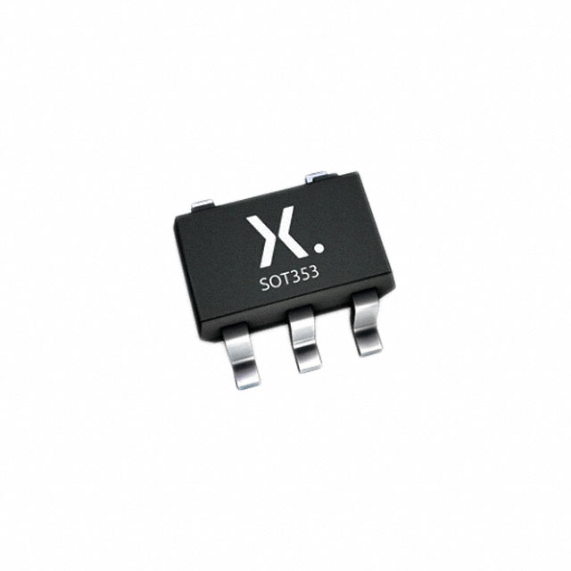

74AHCT1G86GW-Q100,
74AHCT1G86GW-Q100,
    NEXPERIA(安世)
    TSSOP-5_2.05X1.25MM
    IC GATE XOR 1CH 2-INP 5TSSOP
74AHCT1G86GW-Q100, 数据手册
74AHC1G86-Q100; 74AHCT1G86-Q100 2-input EXCLUSIVE-OR gate Rev. 1 — 16 July 2012 Product data sheet 1. General description 74AHC1G86-Q100 and 74AHCT1G86-Q100 are high-speed Si-gate CMOS devices. They provide a 2-input EXCLUSIVE-OR function. The AHC device has CMOS input switching levels and supply voltage range 2 V to 5.5 V. The AHCT device has TTL input switching levels and supply voltage range 4.5 V to 5.5 V. This product has been qualified to the Automotive Electronics Council (AEC) standard Q100 (Grade 1) and is suitable for use in automotive applications. 2. Features and benefits  Automotive product qualification in accordance with AEC-Q100 (Grade 1)  Specified from 40 C to +85 C and from 40 C to +125 C  Symmetrical output impedance  High noise immunity  Low power dissipation  Balanced propagation delays  ESD protection:  MIL-STD-883, method 3015 exceeds 2000 V  HBM JESD22-A114F exceeds 2000 V  MM JESD22-A115-A exceeds 200 V (C = 200 pF, R = 0 )  SOT353-1 and SOT753 package options 3. Ordering information Table 1. Ordering information Type number 74AHC1G86GW-Q100 Package Temperature range Name 40 C to +125 C TSSOP5 plastic thin shrink small outline package; 5 leads; body width 1.25 mm SOT353-1 40 C to +125 C SC-74A SOT753 74AHCT1G86GW-Q100 74AHC1G86GV-Q100 74AHCT1G86GV-Q100 Description plastic surface-mounted package; 5 leads Version 74AHC1G86-Q100; 74AHCT1G86-Q100 Nexperia 2-input EXCLUSIVE-OR gate 4. Marking Table 2. Marking codes Type number Marking code[1] 74AHC1G86GW-Q100 AH 74AHCT1G86GW-Q100 CH 74AHC1G86GV-Q100 A86 74AHCT1G86GV-Q100 C86 [1] The pin 1 indicator is on the lower left corner of the device, below the marking code. 5. Functional diagram 1 2 B A Y 1 4 =1 4 2 mna039 mna038 Fig 1. Logic symbol Fig 2. IEC logic symbol B Y A mna040 Fig 3. Logic diagram 6. Pinning information 6.1 Pinning $+&*4 $+&7*4 %  $  *1'   9&&  < DDD Fig 4. Pin configuration 74AHC_AHCT1G86_Q100 Product data sheet All information provided in this document is subject to legal disclaimers. Rev. 1 — 16 July 2012 © Nexperia B.V. 2017. All rights reserved 2 of 13 74AHC1G86-Q100; 74AHCT1G86-Q100 Nexperia 2-input EXCLUSIVE-OR gate 6.2 Pin description Table 3. Pin description Symbol Pin Description B 1 data input A 2 data input GND 3 ground (0 V) Y 4 data output VCC 5 supply voltage 7. Functional description Table 4. Function table H = HIGH voltage level; L = LOW voltage level Inputs Output A B Y L L L L H H H L H H H L 8. Limiting values Table 5. Limiting values In accordance with the Absolute Maximum Rating System (IEC 60134). Voltages are referenced to GND (ground = 0 V). Symbol Parameter VCC Conditions Min Max Unit supply voltage 0.5 +7.0 V VI input voltage 0.5 +7.0 V 20 - mA - 20 mA - 25 mA IIK input clamping current VI < 0.5 V IOK output clamping current VO < 0.5 V or VO > VCC + 0.5 V IO output current 0.5 V < VO < VCC + 0.5 V ICC supply current - 75 mA IGND ground current 75 - mA Tstg storage temperature 65 +150 C - 250 mW Ptot total power dissipation Tamb = 40 C to +125 C [1] [2] [1] The input and output voltage ratings may be exceeded if the input and output current ratings are observed. [2] For both TSSOP5 and SC-74A packages: above 87.5 C the value of Ptot derates linearly with 4.0 mW/K. 74AHC_AHCT1G86_Q100 Product data sheet All information provided in this document is subject to legal disclaimers. Rev. 1 — 16 July 2012 © Nexperia B.V. 2017. All rights reserved 3 of 13 74AHC1G86-Q100; 74AHCT1G86-Q100 Nexperia 2-input EXCLUSIVE-OR gate 9. Recommended operating conditions Table 6. Recommended operating conditions Voltages are referenced to GND (ground = 0 V). Symbol Parameter Conditions 74AHC1G86-Q100 Min Typ 74AHCT1G86-Q100 Max Min Typ Unit Max VCC supply voltage 2.0 5.0 5.5 4.5 5.0 5.5 V VI input voltage 0 - 5.5 0 - 5.5 V VO output voltage 0 - VCC 0 - VCC V Tamb ambient temperature 40 +25 +125 40 +25 +125 C t/V input transition rise and fall rate VCC = 3.3 V  0.3 V - - 100 - - - ns/V VCC = 5.0 V  0.5 V - - 20 - - 20 ns/V 10. Static characteristics Table 7. Static characteristics Voltages are referenced to GND (ground = 0 V). Symbol Parameter 25 C Conditions 40 C to +85 C 40 C to +125 C Unit Min Typ Max Min Max Min Max VCC = 2.0 V 1.5 - - 1.5 - 1.5 - V VCC = 3.0 V 2.1 - - 2.1 - 2.1 - V VCC = 5.5 V 3.85 - - 3.85 - 3.85 - V VCC = 2.0 V - - 0.5 - 0.5 - 0.5 V VCC = 3.0 V - - 0.9 - 0.9 - 0.9 V VCC = 5.5 V - - 1.65 - 1.65 - 1.65 V HIGH-level VI = VIH or VIL output voltage IO = 50 A; VCC = 2.0 V 1.9 2.0 - 1.9 - 1.9 - V IO = 50 A; VCC = 3.0 V 2.9 3.0 - 2.9 - 2.9 - V IO = 50 A; VCC = 4.5 V 4.4 4.5 - 4.4 - 4.4 - V IO = 4.0 mA; VCC = 3.0 V 2.58 - - 2.48 - 2.40 - V IO = 8.0 mA; VCC = 4.5 V For type 74AHC1G86-Q100 VIH VIL VOH VOL HIGH-level input voltage LOW-level input voltage 3.94 - - 3.8 - 3.70 - V LOW-level VI = VIH or VIL output voltage IO = 50 A; VCC = 2.0 V - 0 0.1 - 0.1 - 0.1 V IO = 50 A; VCC = 3.0 V - 0 0.1 - 0.1 - 0.1 V IO = 50 A; VCC = 4.5 V - 0 0.1 - 0.1 - 0.1 V IO = 4.0 mA; VCC = 3.0 V - - 0.36 - 0.44 - 0.55 V IO = 8.0 mA; VCC = 4.5 V - - 0.36 - 0.44 - 0.55 V - - 0.1 - 1.0 - 2.0 A II input leakage current ICC supply current VI = VCC or GND; IO = 0 A; VCC = 5.5 V - - 1.0 - 10 - 40 A CI input capacitance - 1.5 10 - 10 - 10 pF 74AHC_AHCT1G86_Q100 Product data sheet VI = 5.5 V or GND; VCC = 0 V to 5.5 V All information provided in this document is subject to legal disclaimers. Rev. 1 — 16 July 2012 © Nexperia B.V. 2017. All rights reserved 4 of 13 74AHC1G86-Q100; 74AHCT1G86-Q100 Nexperia 2-input EXCLUSIVE-OR gate Table 7. Static characteristics …continued Voltages are referenced to GND (ground = 0 V). Symbol Parameter 25 C Conditions 40 C to +85 C 40 C to +125 C Unit Min Typ Max Min Max Min Max For type 74AHCT1G86-Q100 VIH HIGH-level input voltage VCC = 4.5 V to 5.5 V 2.0 - - 2.0 - 2.0 - V VIL LOW-level input voltage VCC = 4.5 V to 5.5 V - - 0.8 - 0.8 - 0.8 V VOH HIGH-level VI = VIH or VIL; VCC = 4.5 V output voltage IO = 50 A 4.4 4.5 - 4.4 - 4.4 - V 3.94 - - 3.8 - 3.70 - V IO = 8.0 mA VOL LOW-level VI = VIH or VIL; VCC = 4.5 V output voltage IO = 50 A IO = 8.0 mA VI = 5.5 V or GND; VCC = 0 V to 5.5 V - 0 0.1 - 0.1 - 0.1 V - - 0.36 - 0.44 - 0.55 V - - 0.1 - 1.0 - 2.0 A II input leakage current ICC supply current VI = VCC or GND; IO = 0 A; VCC = 5.5 V - - 1.0 - 10 - 40 A ICC additional per input pin; VI = 3.4 V; supply current other inputs at VCC or GND; IO = 0 A; VCC = 5.5 V - - 1.35 - 1.5 - 1.5 mA CI input capacitance - 1.5 10 - 10 - 10 pF 11. Dynamic characteristics Table 8. Dynamic characteristics GND = 0 V; tr = tf =  3.0 ns. For waveform see Figure 5. For test circuit see Figure 6. Symbol Parameter 25 C Conditions Min Typ CL = 15 pF - CL = 50 pF - 40 C to +85 C 40 C to +125 C Unit Max Min Max Min Max 4.0 11.0 1.0 13.0 1.0 14.0 ns 5.8 14.5 1.0 16.5 1.0 18.5 ns - 3.4 6.8 1.0 8.0 1.0 8.5 ns - 4.9 8.8 1.0 10.0 1.0 11.5 ns - 9 - - - - - pF For type 74AHC1G86-Q100 tpd propagation delay [1] A and B to Y VCC = 3.0 V to 3.6 V VCC = 4.5 V to 5.5 V [2] [3] CL = 15 pF CL = 50 pF CPD power dissipation capacitance 74AHC_AHCT1G86_Q100 Product data sheet per buffer; CL = 50 pF; f = 1 MHz; VI = GND to VCC [4] All information provided in this document is subject to legal disclaimers. Rev. 1 — 16 July 2012 © Nexperia B.V. 2017. All rights reserved 5 of 13 74AHC1G86-Q100; 74AHCT1G86-Q100 Nexperia 2-input EXCLUSIVE-OR gate Table 8. Dynamic characteristics …continued GND = 0 V; tr = tf =  3.0 ns. For waveform see Figure 5. For test circuit see Figure 6. Symbol Parameter 25 C Conditions 40 C to +85 C 40 C to +125 C Unit Min Typ Max Min Max Min Max - 3.5 6.9 1.0 8.0 1.0 9.0 ns - 5.0 7.9 1.0 9.0 1.0 10.5 ns - 11 - - - - - pF For type 74AHCT1G86-Q100 propagation delay tpd [1] A and B to Y VCC = 4.5 V to 5.5 V [3] CL = 15 pF CL = 50 pF power dissipation capacitance CPD per buffer; CL = 50 pF; f = 1 MHz; VI = GND to VCC [1] tpd is the same as tPLH and tPHL. [2] Typical values are measured at VCC = 3.3 V. [4] [3] Typical values are measured at VCC = 5.0 V. [4] CPD is used to determine the dynamic power dissipation PD (W). PD = CPD  VCC2  fi +  (CL  VCC2  fo) where: fi = input frequency in MHz; fo = output frequency in MHz; CL = output load capacitance in pF; VCC = supply voltage in Volts. 12. Waveforms A, B input VM tPHL Y output tPLH VM mna041 Measurement points are given in Table 9. Fig 5. The input (A and B) to output (Y) propagation delays Table 9. Measurement points Type Input Output VI VM VM 74AHC1G86-Q100 GND to VCC 0.5  VCC 0.5  VCC 74AHCT1G86-Q100 GND to 3.0 V 1.5 V 0.5  VCC 74AHC_AHCT1G86_Q100 Product data sheet All information provided in this document is subject to legal disclaimers. Rev. 1 — 16 July 2012 © Nexperia B.V. 2017. All rights reserved 6 of 13 Nexperia 74AHC1G86-Q100; 74AHCT1G86-Q100 2-input EXCLUSIVE-OR gate VCC PULSE GENERATOR VI VO DUT RT CL 50 pF mna034 Test data is given in Table 8. Definitions for test circuit: CL = load capacitance including jig and probe capacitance. RT = termination resistance should be equal to the output impedance Zo of the pulse generator. Fig 6. Load circuitry for switching times 74AHC_AHCT1G86_Q100 Product data sheet All information provided in this document is subject to legal disclaimers. Rev. 1 — 16 July 2012 © Nexperia B.V. 2017. All rights reserved 7 of 13 74AHC1G86-Q100; 74AHCT1G86-Q100 Nexperia 2-input EXCLUSIVE-OR gate 13. Package outline TSSOP5: plastic thin shrink small outline package; 5 leads; body width 1.25 mm E D SOT353-1 A X c y HE v M A Z 5 4 A2 A (A3) A1 θ 1 Lp 3 L e w M bp detail X e1 0 1.5 3 mm scale DIMENSIONS (mm are the original dimensions) UNIT A max. A1 A2 A3 bp c D(1) E(1) e e1 HE L Lp v w y Z(1) θ mm 1.1 0.1 0 1.0 0.8 0.15 0.30 0.15 0.25 0.08 2.25 1.85 1.35 1.15 0.65 1.3 2.25 2.0 0.425 0.46 0.21 0.3 0.1 0.1 0.60 0.15 7° 0° Note 1. Plastic or metal protrusions of 0.15 mm maximum per side are not included. OUTLINE VERSION SOT353-1 REFERENCES IEC JEDEC JEITA MO-203 SC-88A EUROPEAN PROJECTION ISSUE DATE 00-09-01 03-02-19 Fig 7. Package outline SOT353-1 (TSSOP5) 74AHC_AHCT1G86_Q100 Product data sheet All information provided in this document is subject to legal disclaimers. Rev. 1 — 16 July 2012 © Nexperia B.V. 2017. All rights reserved 8 of 13 74AHC1G86-Q100; 74AHCT1G86-Q100 Nexperia 2-input EXCLUSIVE-OR gate Plastic surface-mounted package; 5 leads SOT753 D E B y A X HE 5 v M A 4 Q A A1 c 1 2 3 Lp detail X bp e w M B 0 1 2 mm scale DIMENSIONS (mm are the original dimensions) UNIT A A1 bp c D E e HE Lp Q v w y mm 1.1 0.9 0.100 0.013 0.40 0.25 0.26 0.10 3.1 2.7 1.7 1.3 0.95 3.0 2.5 0.6 0.2 0.33 0.23 0.2 0.2 0.1 OUTLINE VERSION REFERENCES IEC JEDEC SOT753 JEITA EUROPEAN PROJECTION ISSUE DATE 02-04-16 06-03-16 SC-74A Fig 8. Package outline SOT753 (SC-74A) 74AHC_AHCT1G86_Q100 Product data sheet All information provided in this document is subject to legal disclaimers. Rev. 1 — 16 July 2012 © Nexperia B.V. 2017. All rights reserved 9 of 13 74AHC1G86-Q100; 74AHCT1G86-Q100 Nexperia 2-input EXCLUSIVE-OR gate 14. Abbreviations Table 10. Abbreviations Acronym Description CDM Charged Device Model DUT Device Under Test ESD ElectroStatic Discharge HBM Human Body Model MM Machine Model TTL Transistor-Transistor Logic MIL Military 15. Revision history Table 11. Revision history Document ID Release date 74AHC_AHCT1G86_Q100 v.1 20120716 74AHC_AHCT1G86_Q100 Product data sheet Data sheet status Change notice Supersedes Product data sheet - - All information provided in this document is subject to legal disclaimers. Rev. 1 — 16 July 2012 © Nexperia B.V. 2017. All rights reserved 10 of 13 74AHC1G86-Q100; 74AHCT1G86-Q100 Nexperia 2-input EXCLUSIVE-OR gate 16. Legal information 16.1 Data sheet status Document status[1][2] Product status[3] Definition Objective [short] data sheet Development This document contains data from the objective specification for product development. Preliminary [short] data sheet Qualification This document contains data from the preliminary specification. Product [short] data sheet Production This document contains the product specification. [1] Please consult the most recently issued document before initiating or completing a design. [2] The term ‘short data sheet’ is explained in section “Definitions”. [3] The product status of device(s) described in this document may have changed since this document was published and may differ in case of multiple devices. The latest product status information is available on the Internet at URL http://www.nexperia.com. 16.2 Definitions Draft — The document is a draft version only. The content is still under internal review and subject to formal approval, which may result in modifications or additions. Nexperia does not give any representations or warranties as to the accuracy or completeness of information included herein and shall have no liability for the consequences of use of such information. Short data sheet — A short data sheet is an extract from a full data sheet with the same product type number(s) and title. A short data sheet is intended for quick reference only and should not be relied upon to contain detailed and full information. For detailed and full information see the relevant full data sheet, which is available on request via the local Nexperia sales office. In case of any inconsistency or conflict with the short data sheet, the full data sheet shall prevail. Product specification — The information and data provided in a Product data sheet shall define the specification of the product as agreed between Nexperia and its customer, unless Nexperia and customer have explicitly agreed otherwise in writing. In no event however, shall an agreement be valid in which the Nexperia product is deemed to offer functions and qualities beyond those described in the Product data sheet. 16.3 Disclaimers Limited warranty and liability — Information in this document is believed to be accurate and reliable. However, Nexperia does not give any representations or warranties, expressed or implied, as to the accuracy or completeness of such information and shall have no liability for the consequences of use of such information. Nexperia takes no responsibility for the content in this document if provided by an information source outside of Nexperia. In no event shall Nexperia be liable for any indirect, incidental, punitive, special or consequential damages (including - without limitation - lost profits, lost savings, business interruption, costs related to the removal or replacement of any products or rework charges) whether or not such damages are based on tort (including negligence), warranty, breach of contract or any other legal theory. Notwithstanding any damages that customer might incur for any reason whatsoever, Nexperia’s aggregate and cumulative liability towards customer for the products described herein shall be limited in accordance with the Terms and conditions of commercial sale of Nexperia. Right to make changes — Nexperia reserves the right to make changes to information published in this document, including without limitation specifications and product descriptions, at any time and without notice. This document supersedes and replaces all information supplied prior to the publication hereof. 74AHC_AHCT1G86_Q100 Product data sheet Suitability for use in automotive applications — This Nexperia product has been qualified for use in automotive applications. Unless otherwise agreed in writing, the product is not designed, authorized or warranted to be suitable for use in life support, life-critical or safety-critical systems or equipment, nor in applications where failure or malfunction of a Nexperia product can reasonably be expected to result in personal injury, death or severe property or environmental damage. Nexperia and its suppliers accept no liability for inclusion and/or use of Nexperia products in such equipment or applications and therefore such inclusion and/or use is at the customer's own risk. Applications — Applications that are described herein for any of these products are for illustrative purposes only. Nexperia makes no representation or warranty that such applications will be suitable for the specified use without further testing or modification. Customers are responsible for the design and operation of their applications and products using Nexperia products, and Nexperia accepts no liability for any assistance with applications or customer product design. It is customer’s sole responsibility to determine whether the Nexperia product is suitable and fit for the customer’s applications and products planned, as well as for the planned application and use of customer’s third party customer(s). Customers should provide appropriate design and operating safeguards to minimize the risks associated with their applications and products. Nexperia does not accept any liability related to any default, damage, costs or problem which is based on any weakness or default in the customer’s applications or products, or the application or use by customer’s third party customer(s). Customer is responsible for doing all necessary testing for the customer’s applications and products using Nexperia products in order to avoid a default of the applications and the products or of the application or use by customer’s third party customer(s). Nexperia does not accept any liability in this respect. Limiting values — Stress above one or more limiting values (as defined in the Absolute Maximum Ratings System of IEC 60134) will cause permanent damage to the device. Limiting values are stress ratings only and (proper) operation of the device at these or any other conditions above those given in the Recommended operating conditions section (if present) or the Characteristics sections of this document is not warranted. Constant or repeated exposure to limiting values will permanently and irreversibly affect the quality and reliability of the device. Terms and conditions of commercial sale — Nexperia products are sold subject to the general terms and conditions of commercial sale, as published at http://www.nexperia.com/profile/terms, unless otherwise agreed in a valid written individual agreement. In case an individual agreement is concluded only the terms and conditions of the respective agreement shall apply. Nexperia hereby expressly objects to applying the customer’s general terms and conditions with regard to the purchase of Nexperia products by customer. All information provided in this document is subject to legal disclaimers. Rev. 1 — 16 July 2012 © Nexperia B.V. 2017. All rights reserved 11 of 13 Nexperia 74AHC1G86-Q100; 74AHCT1G86-Q100 2-input EXCLUSIVE-OR gate No offer to sell or license — Nothing in this document may be interpreted or construed as an offer to sell products that is open for acceptance or the grant, conveyance or implication of any license under any copyrights, patents or other industrial or intellectual property rights. Translations — A non-English (translated) version of a document is for reference only. The English version shall prevail in case of any discrepancy between the translated and English versions. Export control — This document as well as the item(s) described herein may be subject to export control regulations. Export might require a prior authorization from competent authorities. 16.4 Trademarks Notice: All referenced brands, product names, service names and trademarks are the property of their respective owners. 17. Contact information For more information, please visit: http://www.nexperia.com For sales office addresses, please send an email to: salesaddresses@nexperia.com 74AHC_AHCT1G86_Q100 Product data sheet All information provided in this document is subject to legal disclaimers. Rev. 1 — 16 July 2012 © Nexperia B.V. 2017. All rights reserved 12 of 13 Nexperia 74AHC1G86-Q100; 74AHCT1G86-Q100 2-input EXCLUSIVE-OR gate 18. Contents 1 2 3 4 5 6 6.1 6.2 7 8 9 10 11 12 13 14 15 16 16.1 16.2 16.3 16.4 17 18 © General description . . . . . . . . . . . . . . . . . . . . . . 1 Features and benefits . . . . . . . . . . . . . . . . . . . . 1 Ordering information . . . . . . . . . . . . . . . . . . . . . 1 Marking . . . . . . . . . . . . . . . . . . . . . . . . . . . . . . . . 2 Functional diagram . . . . . . . . . . . . . . . . . . . . . . 2 Pinning information . . . . . . . . . . . . . . . . . . . . . . 2 Pinning . . . . . . . . . . . . . . . . . . . . . . . . . . . . . . . 2 Pin description . . . . . . . . . . . . . . . . . . . . . . . . . 3 Functional description . . . . . . . . . . . . . . . . . . . 3 Limiting values. . . . . . . . . . . . . . . . . . . . . . . . . . 3 Recommended operating conditions. . . . . . . . 4 Static characteristics. . . . . . . . . . . . . . . . . . . . . 4 Dynamic characteristics . . . . . . . . . . . . . . . . . . 5 Waveforms . . . . . . . . . . . . . . . . . . . . . . . . . . . . . 6 Package outline . . . . . . . . . . . . . . . . . . . . . . . . . 8 Abbreviations . . . . . . . . . . . . . . . . . . . . . . . . . . 10 Revision history . . . . . . . . . . . . . . . . . . . . . . . . 10 Legal information. . . . . . . . . . . . . . . . . . . . . . . 11 Data sheet status . . . . . . . . . . . . . . . . . . . . . . 11 Definitions . . . . . . . . . . . . . . . . . . . . . . . . . . . . 11 Disclaimers . . . . . . . . . . . . . . . . . . . . . . . . . . . 11 Trademarks. . . . . . . . . . . . . . . . . . . . . . . . . . . 12 Contact information. . . . . . . . . . . . . . . . . . . . . 12 Contents . . . . . . . . . . . . . . . . . . . . . . . . . . . . . . 13 Nexperia B.V. 2017. All rights reserved For more information, please visit: http://www.nexperia.com For sales office addresses, please send an email to: salesaddresses@nexperia.com Date of release: 16 July 2012 Mouser Electronics Authorized Distributor Click to View Pricing, Inventory, Delivery & Lifecycle Information: Nexperia: 74AHCT1G86GW-Q100, 74AHC1G86GW-Q100,1 74AHCT1G86GV-Q100, 74AHC1G86GV-Q100,1
