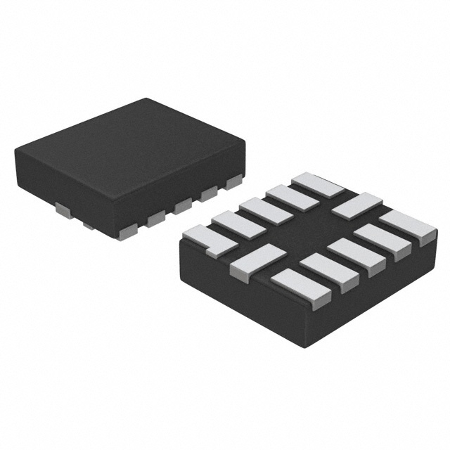

74AHC30GU12X
74AHC30GU12X
    NEXPERIA(安世)
    SOT1174-1
    8输入与非门 XQFN12
74AHC30GU12X 数据手册
74AHC30; 74AHCT30 8-input NAND gate Rev. 4 — 22 July 2015 Product data sheet 1. General description The 74AHC30; 74AHCT30 is a high-speed Si-gate CMOS device and is pin compatible with Low-power Schottky TTL (LSTTL). It is specified in compliance with JEDEC standard No. 7-A. The 74AHC30; 74AHCT30 provides an 8-input NAND function. 2. Features and benefits     Balanced propagation delays All inputs have Schmitt-trigger actions Inputs accept voltages higher than VCC Input levels:  For 74AHC30: CMOS level  For 74AHCT30: TTL level  ESD protection:  HBM JESD22-A114E exceeds 2000 V  MM JESD22-A115-A exceeds 200 V  CDM JESD22-C101C exceeds 1000 V  Multiple package options  Specified from 40 C to +85 C and from 40 C to +125 C 3. Ordering information Table 1. Ordering information Type number 74AHC30D Package Temperature range Name Description Version 40 C to +125 C SO14 plastic small outline package; 14 leads; body width 3.9 mm SOT108-1 40 C to +125 C TSSOP14 plastic thin shrink small outline package; 14 leads; body width 4.4 mm SOT402-1 40 C to +125 C DHVQFN14 plastic dual in-line compatible thermal enhanced very thin quad flat package; no leads; 14 terminals; body 2.5  3  0.85 mm SOT762-1 40 C to +125 C XQFN12 SOT1174-1 74AHCT30D 74AHC30PW 74AHCT30PW 74AHC30BQ 74AHCT30BQ 74AHC30GU12 plastic, extremely thin quad flat package; no leads; 12 terminals; body 1.70  2.00  0.50 mm 74AHC30; 74AHCT30 Nexperia 8-input NAND gate 4. Marking Table 2. Marking codes Type number Marking 74AHC30D 74AHC30D 74AHCT30D 74AHCT30D 74AHC30PW AHC30 74AHCT30PW AHCT30 74AHC30BQ AHC30 74AHCT30BQ AHT30 74AHC30GU12 A3[1] [1] The pin 1 indicator is located on the lower left corner of the device, below the marking code. 5. Functional diagram  $  %  &  '  (  )  *  +     <      PQD PQD Pin numbers are shown for SO14, TSSOP14 and DHVQFN14 packages only Fig 1.  Logic symbol Pin numbers are shown for SO14, TSSOP14 and DHVQFN14 packages only Fig 2. IEC logic symbol $ % & ' < ( PQD ) * + Fig 3. Logic diagram 74AHC_AHCT30 Product data sheet All information provided in this document is subject to legal disclaimers. Rev. 4 — 22 July 2015 © Nexperia B.V. 2017. All rights reserved 2 of 17 74AHC30; 74AHCT30 Nexperia 8-input NAND gate 6. Pinning information 6.1 Pinning  $ WHUPLQDO LQGH[DUHD $+& $+&7  9&& $+& $+&7 %   QF $   9&& &   + %   QF '   * &   +    * ( ' (   QF )  )   QF *1'   < *1'   QF   *1' <  QF DDN 7UDQVSDUHQWWRSYLHZ DDL (1) This is not a supply pin, the substrate is attached to this pad using conductive die attach material. There is no electrical or mechanical requirement to solder this pad, however if it is soldered the solder land should remain floating or be connected to GND Fig 4. Pin configuration SO14 and TSSOP14 Fig 5. Pin configuration DHVQFN14 WHUPLQDO LQGH[DUHD $   9&& $+&  QF  + &   * '   < (   ) *1'  %  DDD 7UDQVSDUHQWWRSYLHZ Fig 6. Pin configuration XQFN12 (SOT1174-1) 74AHC_AHCT30 Product data sheet All information provided in this document is subject to legal disclaimers. Rev. 4 — 22 July 2015 © Nexperia B.V. 2017. All rights reserved 3 of 17 74AHC30; 74AHCT30 Nexperia 8-input NAND gate 6.2 Pin description Table 3. Symbol A Pin description Pin Description SO14, TSSOP14 and DHVQFN14 XQFN12 1 1 data input B 2 2 data input C 3 3 data input D 4 4 data input E 5 5 data input F 6 7 data input GND 7 6 ground (0 V) Y 8 8 data output n.c. 9 - not connected n.c. 10 - not connected G 11 9 data input H 12 10 data input n.c. 13 11 not connected VCC 14 12 supply voltage 7. Functional description Table 4. Function table[1] Input Output A B C D E F G H Y L X X X X X X X H X L X X X X X X H X X L X X X X X H X X X L X X X X H X X X X L X X X H X X X X X L X X H X X X X X X L X H X X X X X X X L H H H H H H H H H L [1] H = HIGH voltage level; L = LOW voltage level; X = don’t care. 74AHC_AHCT30 Product data sheet All information provided in this document is subject to legal disclaimers. Rev. 4 — 22 July 2015 © Nexperia B.V. 2017. All rights reserved 4 of 17 74AHC30; 74AHCT30 Nexperia 8-input NAND gate 8. Limiting values Table 5. Limiting values In accordance with the Absolute Maximum Rating System (IEC 60134). Voltages are referenced to GND (ground = 0 V). Symbol Parameter Conditions Min Max Unit VCC supply voltage 0.5 +7.0 V VI input voltage 0.5 +7.0 V IIK input clamping current VI < 0.5 V [1] 20 - mA IOK output clamping current VO VCC + 0.5 V [1] 20 +20 mA IO output current VO =0.5 V to (VCC + 0.5 V) 25 +25 mA ICC supply current - +75 mA IGND ground current 75 - mA Tstg storage temperature 65 +150 C Ptot total power dissipation - 500 mW - 250 mW Tamb = 40 C to +125 C [2] SO14, TSSOP14 and DHVQFN14 XQFN12 [1] The input and output voltage ratings may be exceeded if the input and output current ratings are observed. [2] For SO14 packages: above 70 C, the value of Ptot derates linearly at 8 mW/K. For TSSOP14 packages: above 60 C, the value of Ptot derates linearly at 5.5 mW/K. For DHVQFN14 packages: above 60 C, the value of Ptot derates linearly at 4.5 mW/K. 9. Recommended operating conditions Table 6. Recommended operating conditions Voltages are referenced to GND (ground = 0 V). Symbol Parameter VCC supply voltage VI input voltage VO output voltage Tamb ambient temperature t/V input transition rise and fall rate 74AHC_AHCT30 Product data sheet Conditions 74AHC30 74AHCT30 Unit Min Typ Max Min Typ Max 2.0 5.0 5.5 4.5 5.0 5.5 V 0 - 5.5 0 - 5.5 V 0 - VCC 0 - VCC V 40 +25 +125 40 +25 +125 C VCC = 3.3 V  0.3 V - - 100 - - - ns/V VCC = 5.0 V  0.5 V - - 20 - - 20 ns/V All information provided in this document is subject to legal disclaimers. Rev. 4 — 22 July 2015 © Nexperia B.V. 2017. All rights reserved 5 of 17 74AHC30; 74AHCT30 Nexperia 8-input NAND gate 10. Static characteristics Table 7. Static characteristics At recommended operating conditions; voltages are referenced to GND (ground = 0 V). Symbol Parameter 25 C Conditions 40 C to +85 C 40 C to +125 C Unit Min Typ Max Min Max Min Max VCC = 2.0 V 1.5 - - 1.5 - 1.5 - V VCC = 3.0 V 2.1 - - 2.1 - 2.1 - V VCC = 5.5 V 3.85 - - 3.85 - 3.85 - V 74AHC30 VIH VIL VOH VOL HIGH-level input voltage LOW-level input voltage VCC = 2.0 V - - 0.5 - 0.5 - 0.5 V VCC = 3.0 V - - 0.9 - 0.9 - 0.9 V VCC = 5.5 V - - 1.65 - 1.65 - 1.65 V HIGH-level VI = VIH or VIL output voltage IO = 50 A; VCC = 2.0 V 1.9 2.0 - 1.9 - 1.9 - V IO = 50 A; VCC = 3.0 V 2.9 3.0 - 2.9 - 2.9 - V IO = 50 A; VCC = 4.5 V 4.4 4.5 - 4.4 - 4.4 - V IO = 4.0 mA; VCC = 3.0 V 2.58 - - 2.48 - 2.40 - V IO = 8.0 mA; VCC = 4.5 V 3.94 - - 3.80 - 3.70 - V LOW-level VI = VIH or VIL output voltage IO = 50 A; VCC = 2.0 V - 0 0.1 - 0.1 - 0.1 V IO = 50 A; VCC = 3.0 V - 0 0.1 - 0.1 - 0.1 V IO = 50 A; VCC = 4.5 V - 0 0.1 - 0.1 - 0.1 V IO = 4.0 mA; VCC = 3.0 V - - 0.36 - 0.44 - 0.55 V IO = 8.0 mA; VCC = 4.5 V - - 0.36 - 0.44 - 0.55 V - - 0.1 - 1.0 - 2.0 A II input leakage current ICC supply current VI = VCC or GND; IO = 0 A; VCC = 5.5 V - - 2.0 - 20 - 40 A CI input capacitance - 3 10 - 10 - 10 pF CO output capacitance - 4 - - - - - pF 74AHC_AHCT30 Product data sheet VI = 5.5 V or GND; VCC = 0 V to 5.5 V VI = VCC or GND All information provided in this document is subject to legal disclaimers. Rev. 4 — 22 July 2015 © Nexperia B.V. 2017. All rights reserved 6 of 17 74AHC30; 74AHCT30 Nexperia 8-input NAND gate Table 7. Static characteristics …continued At recommended operating conditions; voltages are referenced to GND (ground = 0 V). Symbol Parameter 25 C Conditions 40 C to +85 C 40 C to +125 C Unit Min Typ Max Min Max Min Max 74AHCT30 VIH HIGH-level input voltage VCC = 4.5 V to 5.5 V 2.0 - - 2.0 - 2.0 - V VIL LOW-level input voltage VCC = 4.5 V to 5.5 V - - 0.8 - 0.8 - 0.8 V VOH HIGH-level VI = VIH or VIL; VCC = 4.5 V output voltage IO = 50 A 4.4 4.5 - 4.4 - 4.4 - V 3.94 - - 3.80 - 3.70 - V - 0 0.1 - 0.1 - 0.1 V - - 0.36 - 0.44 - 0.55 V - - 0.1 - 1.0 - 2.0 A IO = 8.0 mA VOL LOW-level VI = VIH or VIL; VCC = 4.5 V output voltage IO = 50 A IO = 8.0 mA II input leakage current VI = 5.5 V or GND; VCC = 0 V to 5.5 V ICC supply current VI = VCC or GND; IO = 0 A; VCC = 5.5 V - - 2.0 - 20 - 40 A ICC additional per input pin; supply current VI = VCC  2.1 V; other pins at VCC or GND; IO = 0 A; VCC = 4.5 V to 5.5 V - - 1.35 - 1.5 - 1.5 mA CI input capacitance - 3 10 - 10 - 10 pF CO output capacitance - 4 - - - - - pF VI = VCC or GND 11. Dynamic characteristics Table 8. Dynamic characteristics Voltages are referenced to GND (ground = 0 V); for test circuit see Figure 8. Symbol Parameter 25 C Conditions Min Typ[1] 40 C to +85 C Max 40 C to +125 C Unit Min Max Min Max 74AHC30 tpd propagation delay A, B, C, D, E, F, G, H to Y; see Figure 7 and 8 [2] VCC = 3.0 V to 3.6 V CL = 15 pF - 5.0 9.5 1.0 11.0 1.0 12.0 ns CL = 50 pF - 6.7 12.0 1.0 14.5 1.0 15.5 ns - 3.6 6.5 1.0 7.5 1.0 8.0 ns - 4.9 8.0 1.0 9.5 1.0 10.5 ns - 10 - - - - - pF VCC = 4.5 V to 5.5 V CL = 15 pF CL = 50 pF CPD power fi = 1 MHz; dissipation VI = GND to VCC capacitance 74AHC_AHCT30 Product data sheet [3] All information provided in this document is subject to legal disclaimers. Rev. 4 — 22 July 2015 © Nexperia B.V. 2017. All rights reserved 7 of 17 74AHC30; 74AHCT30 Nexperia 8-input NAND gate Table 8. Dynamic characteristics …continued Voltages are referenced to GND (ground = 0 V); for test circuit see Figure 8. Symbol Parameter 25 C Conditions Min Typ[1] 40 C to +85 C Max 40 C to +125 C Unit Min Max Min Max 74AHCT30; VCC = 4.5 V to 5.5 V propagation delay tpd A, B, C, D, E, F, G, H to Y; see Figure 7 and 8 [2] CL = 15 pF CL = 50 pF [3] power fi = 1 MHz; dissipation VI = GND to VCC capacitance CPD - 3.3 6.5 1.0 7.5 1.0 8.0 ns - 4.7 8.5 1.0 9.5 1.0 10.5 ns - 12 - - - - - pF [1] Typical values are measured at nominal supply voltage (VCC = 3.3 V and VCC = 5.0 V). [2] tpd is the same as tPLH and tPHL. [3] CPD is used to determine the dynamic power dissipation (PD in W). PD = CPD  VCC2  fi  N + (CL  VCC2  fo) where: fi = input frequency in MHz; fo = output frequency in MHz; CL = output load capacitance in pF; VCC = supply voltage in V; N = number of inputs switching; (CL  VCC2  fo) = sum of the outputs. 12. Waveforms 9, $%&' ()*+ LQSXW *1' 90 W3+/ W3/+ 92+ 90
