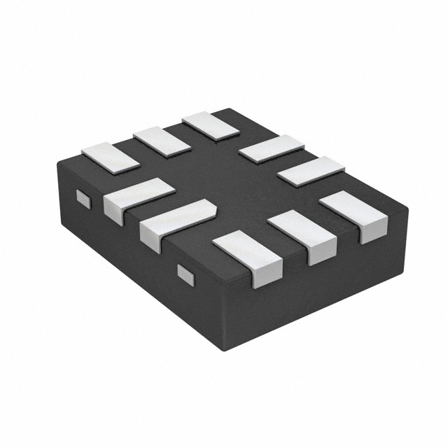

74AUP2G58GUX
74AUP2G58GUX
    NEXPERIA(安世)
    XQFN10_1.4X1.8MM
    可配置多功能 可配置 2 电路 3 输入 XQFN10
74AUP2G58GUX 数据手册
74AUP2G58 Low-power dual PCB configurable multiple function gate Rev. 2 — 2 December 2015 Product data sheet 1. General description The 74AUP2G58 is a dual configurable multiple function gate with Schmitt-trigger inputs. Each gate within the device can be configured as any of the following logic functions AND, OR, NAND, NOR, XOR, inverter and buffer; using the 3-bit input. All inputs can be connected directly to VCC or GND. This device ensures very low static and dynamic power consumption across the entire VCC range from 0.8 V to 3.6 V. This device is fully specified for partial power down applications using IOFF. The IOFF circuitry disables the output, preventing the potentially damaging backflow current through the device when it is powered down. 2. Features and benefits  Wide supply voltage range from 0.8 V to 3.6 V  High noise immunity  ESD protection:  HBM JESD22-A114F exceeds 5000 V  MM JESD22-A115-A exceeds 200 V  CDM JESD22-C101E exceeds 1000 V  Low static power consumption; ICC = 0.9 A (maximum)  Latch-up performance exceeds 100 mA per JESD 78 Class II  Inputs accept voltages up to 3.6 V  Low noise overshoot and undershoot < 10 % of VCC  IOFF circuitry provides partial power-down mode operation  Multiple package options  Specified from 40 C to +85 C and 40 C to +125 C 74AUP2G58 Nexperia Low-power dual PCB configurable multiple function gate 3. Ordering information Table 1. Ordering information Type number Package Temperature range Name Description Version 74AUP2G58DP 40 C to +125 C TSSOP10 plastic thin shrink small outline package; 10 leads; body width 3 mm SOT552-1 74AUP2G58GU 40 C to +125 C XQFN10 plastic, extremely thin quad flat package; no leads; 10 terminals; body 1.40  1.80  0.50 mm SOT1160-1 74AUP2G58GF 40 C to +125 C XSON10 plastic extremely thin small outline package; no leads; SOT1081-2 10 terminals; body 1.0  1.7  0.5 mm 4. Marking Table 2. Marking Type number Marking code[1] 74AUP2G58DP aK 74AUP2G58GU aK 74AUP2G58GF aK [1] The pin 1 indicator is located on the lower left corner of the device, below the marking code. 5. Functional diagram Q$ Q< Q% Q& DDD Fig 1. Logic symbol (one gate) 74AUP2G58 Product data sheet All information provided in this document is subject to legal disclaimers. Rev. 2 — 2 December 2015 © Nexperia B.V. 2017. All rights reserved 2 of 21 74AUP2G58 Nexperia Low-power dual PCB configurable multiple function gate 6. Pinning information 6.1 Pinning $83* $   9&& %   < &   & <   % *1'   $ DDD Fig 2. Pin configuration SOT552-1 (TSSOP10) $83* $ 9&& <   WHUPLQDO LQGH[DUHD  $83* & &   % $ *1' <   9&& %   < &   & <   % *1'   $      % $ 7UDQVSDUHQWWRSYLHZ 7UDQVSDUHQWWRSYLHZ DDD Fig 3. DDD Pin configuration SOT1160-1 (XQFN10) 74AUP2G58 Product data sheet Fig 4. Pin configuration SOT1081-2 (XSON10) All information provided in this document is subject to legal disclaimers. Rev. 2 — 2 December 2015 © Nexperia B.V. 2017. All rights reserved 3 of 21 74AUP2G58 Nexperia Low-power dual PCB configurable multiple function gate 6.2 Pin description Table 3. Pin description Symbol Pin Description SOT552-1 and SOT1081-2 SOT1160-1 1A, 2A 1, 6 10, 5 data input 1B, 2B 2, 7 1, 6 data input 1C, 2C 3, 8 2, 7 data input 1Y, 2Y 9, 4 8, 3 data output GND 5 4 ground (0 V) VCC 10 9 supply voltage 7. Functional description Table 4. Function table[1] Input Output nC nB nA nY L L L L L L H H L H L L L H H H H L L H H L H H H H L L H H H L [1] H = HIGH voltage level; L = LOW voltage level. 7.1 Logic configurations Table 5. Function selection table Logic function Figure 2-input NAND see Figure 5 2-input NAND with both inputs inverted see Figure 8 2-input AND with inverted input see Figure 6 and Figure 7 2-input NOR with inverted input see Figure 6 and Figure 7 2-input OR see Figure 8 2-input OR with both inputs inverted see Figure 5 2-input XOR see Figure 9 Buffer see Figure 10 Inverter see Figure 11 74AUP2G58 Product data sheet All information provided in this document is subject to legal disclaimers. Rev. 2 — 2 December 2015 © Nexperia B.V. 2017. All rights reserved 4 of 21 74AUP2G58 Nexperia Low-power dual PCB configurable multiple function gate 9&& Q% Q& Q< Q%   Q% Q&  Q<  9&& Q% Q& Q&  Q< Q% Q<     Q% Q&  Q<  Q< DDD DDD Pin numbers are not valid for SOT1160-1 package Fig 5. Q&  Pin numbers are not valid for SOT1160-1 package 2-input NAND gate or 2-input OR with both inputs inverted Fig 6. 2-input AND gate with inverted B input or 2-input NOR gate with inverted C input 9&& 9&& Q$ Q& Q<   Q$ Q& Q$ Q<   Q% Q& Q% Q&  Q<     Q<   DDD Pin numbers are not valid for SOT1160-1 package 2-input AND gate with inverted C input or 2-input NOR gate with inverted A input Fig 8. 2-input OR gate or 2-input NAND gate with both inputs inverted 9&& 9&& Q% Q% Q& Q<     Q&  Q$   Q<   Q< Q$    Q< DDD DDD Pin numbers are not valid for SOT1160-1 package Fig 9. Q< DDD Pin numbers are not valid for SOT1160-1 package Fig 7. Q&  Pin numbers are not valid for SOT1160-1 package 2-input XOR gate Fig 10. Buffer 9&& Q% Q% Q<      Q<  DDD Pin numbers are not valid for SOT1160-1 package Fig 11. Inverter 74AUP2G58 Product data sheet All information provided in this document is subject to legal disclaimers. Rev. 2 — 2 December 2015 © Nexperia B.V. 2017. All rights reserved 5 of 21 74AUP2G58 Nexperia Low-power dual PCB configurable multiple function gate 8. Limiting values Table 6. Limiting values In accordance with the Absolute Maximum Rating System (IEC 60134). Voltages are referenced to GND (ground = 0 V). Symbol Parameter VCC supply voltage IIK input clamping current VI input voltage IOK output clamping current Conditions VI < 0 V [1] VO < 0 V [1] Min Max Unit 0.5 +4.6 V 50 - mA 0.5 +4.6 V 50 - mA 0.5 +4.6 V VO output voltage Active mode and Power-down mode IO output current VO = 0 V to VCC - 20 mA ICC supply current - 50 mA IGND ground current 50 - mA Tstg storage temperature 65 +150 C - 250 mW total power dissipation Ptot [1] [2] Tamb = 40 C to +125 C [2] The input and output voltage ratings may be exceeded if the input and output current ratings are observed. For TSSOP10 package: above 125C the value of Ptot derates linearly with 8.33 mW/K. For XQFN10 (SOT1160-1) package: above 128 C the value of Ptot derates linearly with 11.5 mW/K. For XSON10 package: above 45 C the value of Ptot derates linearly with 2.4 mW/K. 9. Recommended operating conditions Table 7. Recommended operating conditions Symbol Parameter VCC supply voltage VI input voltage VO output voltage Tamb Conditions Product data sheet Max Unit 0.8 3.6 V 0 3.6 V Active mode 0 VCC V Power-down mode; VCC = 0 V 0 3.6 V 40 +125 C ambient temperature 74AUP2G58 Min All information provided in this document is subject to legal disclaimers. Rev. 2 — 2 December 2015 © Nexperia B.V. 2017. All rights reserved 6 of 21 74AUP2G58 Nexperia Low-power dual PCB configurable multiple function gate 10. Static characteristics Table 8. Static characteristics At recommended operating conditions; voltages are referenced to GND (ground = 0 V). Symbol Parameter Conditions Min Typ Max Unit IO = 20 A; VCC = 0.8 V to 3.6 V VCC  0.1 - - V IO = 1.1 mA; VCC = 1.1 V 0.75  VCC - - V IO = 1.7 mA; VCC = 1.4 V 1.11 - - V Tamb = 25 C VOH VOL HIGH-level output voltage LOW-level output voltage VI = VT+ or VT IO = 1.9 mA; VCC = 1.65 V 1.32 - - V IO = 2.3 mA; VCC = 2.3 V 2.05 - - V IO = 3.1 mA; VCC = 2.3 V 1.9 - - V IO = 2.7 mA; VCC = 3.0 V 2.72 - - V IO = 4.0 mA; VCC = 3.0 V 2.6 - - V IO = 20 A; VCC = 0.8 V to 3.6 V - - 0.1 V IO = 1.1 mA; VCC = 1.1 V - - 0.3  VCC V IO = 1.7 mA; VCC = 1.4 V - - 0.31 V IO = 1.9 mA; VCC = 1.65 V - - 0.31 V IO = 2.3 mA; VCC = 2.3 V - - 0.31 V IO = 3.1 mA; VCC = 2.3 V - - 0.44 V IO = 2.7 mA; VCC = 3.0 V - - 0.31 V IO = 4.0 mA; VCC = 3.0 V - - 0.44 V VI = VT+ or VT II input leakage current VI = GND to 3.6 V; VCC = 0 V to 3.6 V - - 0.1 A IOFF power-off leakage current VI or VO = 0 V to 3.6 V; VCC = 0 V - - 0.2 A IOFF additional power-off leakage VI or VO = 0 V to 3.6 V; current VCC = 0 V to 0.2 V - - 0.2 A ICC supply current VI = GND or VCC; IO = 0 A; VCC = 0.8 V to 3.6 V - - 0.5 A ICC additional supply current VI = VCC  0.6 V; IO = 0 A; VCC = 3.3 V - - 40 A CI input capacitance VI = GND or VCC; VCC = 0 V to 3.6 V - 1.1 - pF CO output capacitance VO = GND; VCC = 0 V - 1.7 - pF 74AUP2G58 Product data sheet All information provided in this document is subject to legal disclaimers. Rev. 2 — 2 December 2015 © Nexperia B.V. 2017. All rights reserved 7 of 21 74AUP2G58 Nexperia Low-power dual PCB configurable multiple function gate Table 8. Static characteristics …continued At recommended operating conditions; voltages are referenced to GND (ground = 0 V). Symbol Parameter Conditions Min Typ Max Unit Tamb = 40 C to +85 C VOH VOL HIGH-level output voltage LOW-level output voltage VI = VT+ or VT IO = 20 A; VCC = 0.8 V to 3.6 V VCC  0.1 - - V IO = 1.1 mA; VCC = 1.1 V 0.7  VCC - - V IO = 1.7 mA; VCC = 1.4 V 1.03 - - V IO = 1.9 mA; VCC = 1.65 V 1.30 - - V IO = 2.3 mA; VCC = 2.3 V 1.97 - - V IO = 3.1 mA; VCC = 2.3 V 1.85 - - V IO = 2.7 mA; VCC = 3.0 V 2.67 - - V IO = 4.0 mA; VCC = 3.0 V 2.55 - - V IO = 20 A; VCC = 0.8 V to 3.6 V - - 0.1 V IO = 1.1 mA; VCC = 1.1 V - - 0.3  VCC V IO = 1.7 mA; VCC = 1.4 V - - 0.37 V VI = VT+ or VT IO = 1.9 mA; VCC = 1.65 V - - 0.35 V IO = 2.3 mA; VCC = 2.3 V - - 0.33 V IO = 3.1 mA; VCC = 2.3 V - - 0.45 V IO = 2.7 mA; VCC = 3.0 V - - 0.33 V - - 0.45 V II input leakage current VI = GND to 3.6 V; VCC = 0 V to 3.6 V IO = 4.0 mA; VCC = 3.0 V - - 0.5 A IOFF power-off leakage current VI or VO = 0 V to 3.6 V; VCC = 0 V - - 0.5 A IOFF additional power-off leakage VI or VO = 0 V to 3.6 V; current VCC = 0 V to 0.2 V - - 0.6 A ICC supply current VI = GND or VCC; IO = 0 A; VCC = 0.8 V to 3.6 V - - 0.9 A ICC additional supply current VI = VCC  0.6 V; IO = 0 A; VCC = 3.3 V - - 50 A 74AUP2G58 Product data sheet All information provided in this document is subject to legal disclaimers. Rev. 2 — 2 December 2015 © Nexperia B.V. 2017. All rights reserved 8 of 21 74AUP2G58 Nexperia Low-power dual PCB configurable multiple function gate Table 8. Static characteristics …continued At recommended operating conditions; voltages are referenced to GND (ground = 0 V). Symbol Parameter Conditions Min Typ Max Unit Tamb = 40 C to +125 C VOH VOL HIGH-level output voltage LOW-level output voltage VI = VT+ or VT IO = 20 A; VCC = 0.8 V to 3.6 V VCC  0.11 - - V IO = 1.1 mA; VCC = 1.1 V 0.6  VCC - - V IO = 1.7 mA; VCC = 1.4 V 0.93 - - V IO = 1.9 mA; VCC = 1.65 V 1.17 - - V IO = 2.3 mA; VCC = 2.3 V 1.77 - - V IO = 3.1 mA; VCC = 2.3 V 1.67 - - V IO = 2.7 mA; VCC = 3.0 V 2.40 - - V IO = 4.0 mA; VCC = 3.0 V 2.30 - - V IO = 20 A; VCC = 0.8 V to 3.6 V - - 0.11 V IO = 1.1 mA; VCC = 1.1 V - - 0.33  VCC V IO = 1.7 mA; VCC = 1.4 V - - 0.41 VI = VT+ or VT V IO = 1.9 mA; VCC = 1.65 V - - 0.39 V IO = 2.3 mA; VCC = 2.3 V - - 0.36 V IO = 3.1 mA; VCC = 2.3 V - - 0.50 V IO = 2.7 mA; VCC = 3.0 V - - 0.36 V - - 0.50 V II input leakage current VI = GND to 3.6 V; VCC = 0 V to 3.6 V IO = 4.0 mA; VCC = 3.0 V - - 0.75 A IOFF power-off leakage current VI or VO = 0 V to 3.6 V; VCC = 0 V - - 0.75 A IOFF additional power-off leakage VI or VO = 0 V to 3.6 V; current VCC = 0 V to 0.2 V - - 0.75 A ICC supply current VI = GND or VCC; IO = 0 A; VCC = 0.8 V to 3.6 V - - 1.4 A ICC additional supply current VI = VCC  0.6 V; IO = 0 A; VCC = 3.3 V - - 75 A 74AUP2G58 Product data sheet All information provided in this document is subject to legal disclaimers. Rev. 2 — 2 December 2015 © Nexperia B.V. 2017. All rights reserved 9 of 21 74AUP2G58 Nexperia Low-power dual PCB configurable multiple function gate 11. Dynamic characteristics Table 9. Dynamic characteristics Voltages are referenced to GND (ground = 0 V); for test circuit, see Figure 13. Symbol Parameter 25 C Conditions Min Typ[1] 40 C to +125 C Max Min Unit Max Max (85 C) (125 C) CL = 5 pF tpd propagation delay [2] nA, nB and nC to nY; see Figure 12 - 22.8 - - - - ns VCC = 1.1 V to 1.3 V VCC = 0.8 V 2.8 6.6 12.9 2.6 13.1 13.3 ns VCC = 1.4 V to 1.6 V 2.4 4.8 7.6 2.4 8.3 8.6 ns VCC = 1.65 V to 1.95 V 2.1 4.0 6.3 2.0 6.9 7.3 ns VCC = 2.3 V to 2.7 V 2.0 3.2 4.6 1.8 5.1 5.4 ns VCC = 3.0 V to 3.6 V 1.9 2.9 3.9 1.6 4.2 4.4 ns - 26.4 - - - - ns VCC = 1.1 V to 1.3 V 3.2 7.4 14.5 3.0 14.9 15.2 ns VCC = 1.4 V to 1.6 V 2.7 5.4 8.7 2.7 9.4 9.8 ns VCC = 1.65 V to 1.95 V 2.5 4.5 7.1 2.3 7.9 8.3 ns VCC = 2.3 V to 2.7 V 2.4 3.8 5.3 2.2 5.9 6.2 ns VCC = 3.0 V to 3.6 V 2.3 3.5 4.6 1.9 4.9 5.1 ns - 29.9 - - - - ns 3.6 8.3 16.1 3.3 16.7 17.0 ns CL = 10 pF tpd propagation delay [2] nA, nB and nC to nY; see Figure 12 VCC = 0.8 V CL = 15 pF tpd propagation delay [2] nA, nB and nC to nY; see Figure 12 VCC = 0.8 V VCC = 1.1 V to 1.3 V VCC = 1.4 V to 1.6 V 3.0 5.9 9.7 3.0 10.5 11.0 ns VCC = 1.65 V to 1.95 V 2.8 5.0 7.9 2.5 8.7 9.2 ns VCC = 2.3 V to 2.7 V 2.7 4.2 5.9 2.5 6.6 6.9 ns VCC = 3.0 V to 3.6 V 2.5 3.9 5.2 2.2 5.5 5.8 ns - 38.0 - - - - ns VCC = 1.1 V to 1.3 V 4.5 10.5 20.8 4.1 21.9 24.1 ns VCC = 1.4 V to 1.6 V 3.8 7.5 12.2 3.8 13.5 14.1 ns VCC = 1.65 V to 1.95 V 3.4 6.3 10.0 3.1 11.2 11.9 ns VCC = 2.3 V to 2.7 V 3.4 5.3 7.5 3.1 8.4 8.9 ns VCC = 3.0 V to 3.6 V 3.3 5.0 6.6 2.9 7.1 7.4 ns CL = 30 pF tpd propagation delay [2] nA, nB and nC to nY; see Figure 12 VCC = 0.8 V 74AUP2G58 Product data sheet All information provided in this document is subject to legal disclaimers. Rev. 2 — 2 December 2015 © Nexperia B.V. 2017. All rights reserved 10 of 21 74AUP2G58 Nexperia Low-power dual PCB configurable multiple function gate Table 9. Dynamic characteristics …continued Voltages are referenced to GND (ground = 0 V); for test circuit, see Figure 13. Symbol Parameter 25 C Conditions 40 C to +125 C Unit Min Typ[1] Max Min VCC = 0.8 V - 2.7 - - - - pF VCC = 1.1 V to 1.3 V - 2.8 - - - - pF VCC = 1.4 V to 1.6 V - 3.0 - - - - pF VCC = 1.65 V to 1.95 V - 3.2 - - - - pF VCC = 2.3 V to 2.7 V - 3.8 - - - - pF VCC = 3.0 V to 3.6 V - 4.4 - - - - pF Max Max (85 C) (125 C) CL = 5 pF, 10 pF, 15 pF and 30 pF power dissipation capacitance CPD [3][4] fi = 1 MHz; VI = GND to VCC [1] All typical values are measured at nominal VCC. [2] tpd is the same as tPLH and tPHL. [3] All specified values are the average typical values over all stated loads. [4] CPD is used to determine the dynamic power dissipation (PD in W). PD = CPD  VCC2  fi  N + (CL  VCC2  fo) where: fi = input frequency in MHz; fo = output frequency in MHz; CL = load capacitance in pF; VCC = supply voltage in V; N = number of inputs switching; (CL  VCC2  fo) = sum of the outputs. 12. Waveforms 9, Q$Q%Q&LQSXW 90 90 *1' W3+/ W3/+ 92+ 90 Q
