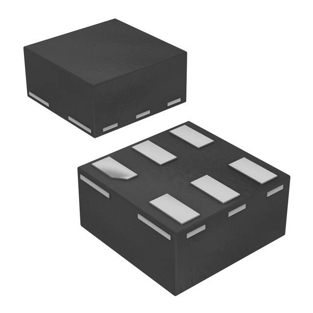

74LVC1G126GN,132
74LVC1G126GN,132
    NEXPERIA(安世)
    XSON6_1X1MM
    总线缓冲器/线路驱动器;3 态
74LVC1G126GN,132 数据手册
74LVC1G126 Bus buffer/line driver; 3-state Rev. 14 — 15 March 2019 Product data sheet 1. General description The 74LVC1G126 provides one non-inverting buffer/line driver with 3-state output. The 3-state output is controlled by the output enable input (OE). A LOW-level at pin OE causes the output to assume a high-impedance OFF-state. The input can be driven from either 3.3 V or 5 V devices. This feature allows the use of this device in a mixed 3.3 V and 5 V environment. This device is fully specified for partial power-down applications using IOFF. The IOFF circuitry disables the output, preventing the damaging backflow current through the device when it is powered down. 2. Features and benefits • • • • • • • • • • • Wide supply voltage range from 1.65 V to 5.5 V High noise immunity Complies with JEDEC standard: • JESD8-7 (1.65 V to 1.95 V) • JESD8-5 (2.3 V to 2.7 V) • JESD8B/JESD36 (2.7 V to 3.6 V) ±24 mA output drive (VCC = 3.0 V) ESD protection: • HBM JESD22-A114F exceeds 2000 V • MM JESD22-A115-A exceeds 200 V CMOS low power consumption Inputs accept voltages up to 5 V Latch-up performance exceeds 250 mA Direct interface with TTL levels Multiple package options Specified from -40 °C to +85 °C and -40 °C to +125 °C 74LVC1G126 Nexperia Bus buffer/line driver; 3-state 3. Ordering information Table 1. Ordering information Type number Package Temperature range Name Description Version 74LVC1G126GW -40 °C to +125 °C TSSOP5 plastic thin shrink small outline package; 5 leads; body width 1.25 mm SOT353-1 74LVC1G126GV -40 °C to +125 °C SC-74A plastic surface-mounted package; 5 leads SOT753 74LVC1G126GM -40 °C to +125 °C XSON6 plastic extremely thin small outline package; no leads; 6 terminals; body 1 x 1.45 x 0.5 mm SOT886 74LVC1G126GF -40 °C to +125 °C XSON6 plastic extremely thin small outline package; no leads; 6 terminals; body 1 x 1 x 0.5 mm SOT891 74LVC1G126GN -40 °C to +125 °C XSON6 extremely thin small outline package; no leads; SOT1115 6 terminals; body 0.9 x 1.0 x 0.35 mm 74LVC1G126GS -40 °C to +125 °C XSON6 extremely thin small outline package; no leads; SOT1202 6 terminals; body 1.0 x 1.0 x 0.35 mm 74LVC1G126GX -40 °C to +125 °C X2SON5 X2SON5: plastic thermal enhanced extremely thin small outline package; no leads; 5 terminals; body 0.8 x 0.8 x 0.35 mm SOT1226 4. Marking Table 2. Marking codes Type number Marking[1] 74LVC1G126GW VN 74LVC1G126GV V26 74LVC1G126GM VN 74LVC1G126GF VN 74LVC1G126GN VN 74LVC1G126GS VN 74LVC1G126GX VN [1] The pin 1 indicator is located on the lower left corner of the device, below the marking code. 5. Functional diagram 2 1 A Y 4 OE 1 Fig. 1. Logic symbol 74LVC1G126 Product data sheet 4 OE mna126 mna125 Fig. 2. Y A 2 IEC logic symbol All information provided in this document is subject to legal disclaimers. Rev. 14 — 15 March 2019 OE Fig. 3. mna127 Logic diagram © Nexperia B.V. 2019. All rights reserved 2 / 19 74LVC1G126 Nexperia Bus buffer/line driver; 3-state 6. Pinning information 6.1. Pinning 74LVC1G126 74LVC1G126 OE 1 A 2 GND 3 5 4 OE 1 6 VCC A 2 5 n.c. GND 3 4 Y VCC Y 001aaf197 001aaf196 Fig. 4. Transparent top view Pin configuration SOT353-1 (TSSOP5) and SOT753 (SC-74A) Fig. 5. Pin configuration SOT886 (XSON6) 74LVC1G126 74LVC1G126 OE 1 6 VCC A 2 5 n.c. GND 3 4 Y OE 1 VCC 4 Y 3 GND 2 A 001aaf401 Transparent top view Fig. 6. 5 aaa-003033 Transparent top view Pin configuration SOT891, SOT1115 and SOT1202 (XSON6) Fig. 7. Pin configuration SOT1226 (X2SON5) 6.2. Pin description Table 3. Pin description Symbol Pin Description TSSOP5, SC-74A and X2SON5 XSON6 OE 1 1 output enable input A 2 2 data input GND 3 3 ground (0 V) Y 4 4 data output n.c. - 5 not connected VCC 5 6 supply voltage 7. Functional description Table 4. Function table H = HIGH voltage level; L = LOW voltage level; X = don’t care; Z = high-impedance OFF-state. Output Input OE A Y H L L H H H L X Z 74LVC1G126 Product data sheet All information provided in this document is subject to legal disclaimers. Rev. 14 — 15 March 2019 © Nexperia B.V. 2019. All rights reserved 3 / 19 74LVC1G126 Nexperia Bus buffer/line driver; 3-state 8. Limiting values Table 5. Limiting values In accordance with the Absolute Maximum Rating System (IEC 60134). Voltages are referenced to GND (ground = 0 V). Symbol Parameter Conditions VCC supply voltage IIK input clamping current VI input voltage IOK output clamping current VO > VCC or VO < 0 V VO output voltage Active mode Power-down mode; VCC = 0 V Min Max Unit -0.5 +6.5 V -50 - -0.5 +6.5 V - ±50 mA [1] -0.5 VCC + 0.5 V [1] -0.5 +6.5 V - ±50 mA VI < 0 V [1] IO output current ICC supply current - 100 mA IGND ground current -100 - mA Ptot total power dissipation - 250 mW Tstg storage temperature -65 +150 °C [1] [2] VO = 0 V to VCC mA Tamb = -40 °C to +125 °C [2] The input and output voltage ratings may be exceeded if the input and output current ratings are observed. For TSSOP5 and SC-74A packages: above 87.5 °C the value of Ptot derates linearly with 4.0 mW/K. For XSON6 and X2SON5 package: above 118 °C the value of Ptot derates linearly with 7.8 mW/K. 9. Recommended operating conditions Table 6. Recommended operating conditions Symbol Parameter Conditions Min Typ Max Unit VCC supply voltage 1.65 - 5.5 V VI input voltage 0 - 5.5 V VO output voltage Active mode 0 - VCC V VCC = 0 V; Power-down mode 0 - 5.5 V -40 - +125 °C VCC = 1.65 V to 2.7 V - - 20 ns/V VCC = 2.7 V to 5.5 V - - 10 ns/V Tamb ambient temperature Δt/ΔV input transition rise and fall rate 74LVC1G126 Product data sheet All information provided in this document is subject to legal disclaimers. Rev. 14 — 15 March 2019 © Nexperia B.V. 2019. All rights reserved 4 / 19 74LVC1G126 Nexperia Bus buffer/line driver; 3-state 10. Static characteristics Table 7. Static characteristics At recommended operating conditions; voltages are referenced to GND (ground = 0 V). Symbol Parameter Min Typ[1] Max 0.65 × VCC - - V VCC = 2.3 V to 2.7 V 1.7 - - V VCC = 2.7 V to 3.6 V 2.0 - - V VCC = 4.5 V to 5.5 V 0.7 × VCC - - V VCC = 1.65 V to 1.95 V - - VCC = 2.3 V to 2.7 V - - VCC = 2.7 V to 3.6 V - - VCC = 4.5 V to 5.5 V - - VCC = 1.65 V to 5.5 V; IO = 100 μA - - 0.1 V VCC = 1.65 V; IO = 4 mA - - 0.45 V VCC = 2.3 V; IO = 8 mA - - 0.3 V VCC = 2.7 V; IO = 12 mA - - 0.4 V VCC = 3.0 V; IO = 24 mA - - 0.55 V VCC = 4.5 V; IO = 32 mA - - 0.55 V Conditions Unit Tamb = -40 °C to +85 °C VIH VIL VOL VOH HIGH-level input voltage LOW-level input voltage LOW-level output voltage VCC = 1.65 V to 1.95 V 0.35 × VCC V 0.7 V 0.8 V 0.3 × VCC V VI = VIH or VIL HIGH-level output voltage VI = VIH or VIL VCC = 1.65 V to 5.5 V; IO = -100 μA VCC - 0.1 - - V VCC = 1.65 V; IO = -4 mA 1.2 - - V VCC = 2.3 V; IO = -8 mA 1.9 - - V VCC = 2.7 V; IO = -12 mA 2.2 - - V VCC = 3.0 V; IO = -24 mA 2.3 - - V VCC = 4.5 V; IO = -32 mA 3.8 - - V II input leakage current VCC = 0 V to 5.5 V; VI = 5.5 V or GND - ±0.1 ±1 μA IOZ OFF-state output current VCC = 3.6 V; VI = VIH or VIL; VO = 5.5 V or GND - ±0.1 ±2 μA IOFF power-off leakage current VCC = 0 V; VI or VO = 5.5 V - ±0.1 ±2 μA ICC supply current VI = 5.5 V or GND; VCC = 1.65 V to 5.5 V; IO = 0 A - 0.1 4 μA ΔICC additional supply current per pin; VCC = 2.3 V to 5.5 V; VI = VCC - 0.6 V; IO = 0 A - 5 500 μA CI input capacitance - 5 - pF 74LVC1G126 Product data sheet All information provided in this document is subject to legal disclaimers. Rev. 14 — 15 March 2019 © Nexperia B.V. 2019. All rights reserved 5 / 19 74LVC1G126 Nexperia Bus buffer/line driver; 3-state Symbol Parameter Min Typ[1] Max 0.65 × VCC - - V VCC = 2.3 V to 2.7 V 1.7 - - V VCC = 2.7 V to 3.6 V 2.0 - - V VCC = 4.5 V to 5.5 V 0.7 × VCC - - V VCC = 1.65 V to 1.95 V - - VCC = 2.3 V to 2.7 V - - VCC = 2.7 V to 3.6 V - - VCC = 4.5 V to 5.5 V - - VCC = 1.65 V to 5.5 V; IO = 100 μA - - 0.1 V VCC = 1.65 V; IO = 4 mA - - 0.70 V VCC = 2.3 V; IO = 8 mA - - 0.45 V VCC = 2.7 V; IO = 12 mA - - 0.60 V VCC = 3.0 V; IO = 24 mA - - 0.80 V VCC = 4.5 V; IO = 32 mA - - 0.80 V Conditions Unit Tamb = -40 °C to +125 °C VIH HIGH-level input voltage VIL LOW-level input voltage VOL LOW-level output voltage VOH VCC = 1.65 V to 1.95 V 0.35 × VCC V 0.7 V 0.8 V 0.3 × VCC V VI = VIH or VIL HIGH-level output voltage VI = VIH or VIL VCC = 1.65 V to 5.5 V; IO = -100 μA VCC - 0.1 - - V VCC = 1.65 V; IO = -4 mA 0.95 - - V VCC = 2.3 V; IO = -8 mA 1.7 - - V VCC = 2.7 V; IO = -12 mA 1.9 - - V VCC = 3.0 V; IO = -24 mA 2.0 - - V VCC = 4.5 V; IO = -32 mA 3.4 - - V II input leakage current VCC = 0 V to 5.5 V; VI = 5.5 V or GND - - ±1 μA IOZ OFF-state output current VCC = 3.6 V; VI = VIH or VIL; VO = 5.5 V or GND - - ±2 μA IOFF power-off leakage current VCC = 0 V; VI or VO = 5.5 V - - ±2 μA ICC supply current VI = 5.5 V or GND; VCC = 1.65 V to 5.5 V; IO = 0 A - - 4 μA ΔICC additional supply current per pin; VCC = 2.3 V to 5.5 V; VI = VCC - 0.6 V; IO = 0 A - - 5 00 μA [1] All typical values are measured at VCC = 3.3 V and Tamb = 25 °C. 74LVC1G126 Product data sheet All information provided in this document is subject to legal disclaimers. Rev. 14 — 15 March 2019 © Nexperia B.V. 2019. All rights reserved 6 / 19 74LVC1G126 Nexperia Bus buffer/line driver; 3-state 11. Dynamic characteristics Table 8. Dynamic characteristics Voltages are referenced to GND (ground = 0 V). For test circuit see Fig. 10. Symbol Parameter Conditions -40 °C to +85 °C Min tpd propagation delay ten enable time A to Y; see Fig. 8 disable time CPD [1] [2] [3] [4] [5] power dissipation capacitance Typ[1] Max Min Max [2] VCC = 1.65 V to 1.95 V 1.0 3 8.0 1.0 10.5 ns VCC = 2.3 V to 2.7 V 0.5 2.1 5.5 0.5 7 ns VCC = 2.7 V 0.5 2.3 5.5 0.5 7 ns VCC = 3.0 V to 3.6 V 0.5 2.0 4.5 0.5 6 ns VCC = 4.5 V to 5.5 V 0.5 1.7 4.0 0.5 5.5 ns VCC = 1.65 V to 1.95 V 1.0 3.2 9.4 1.0 12 ns VCC = 2.3 V to 2.7 V 0.5 2.2 6.6 0.5 8.5 ns VCC = 2.7 V 0.5 2.4 6.6 0.5 8.5 ns VCC = 3.0 V to 3.6 V 0.5 2.1 5.3 0.5 7 ns 0.5 1.6 5.0 0.5 6.5 ns VCC = 1.65 V to 1.95 V 1.0 4.3 9.2 1.0 12 ns VCC = 2.3 V to 2.7 V 0.5 2.7 5.5 0.5 7 ns VCC = 2.7 V 0.5 3.4 5.5 0.5 7 ns VCC = 3.0 V to 3.6 V 0.5 3.0 5.5 0.5 7 ns VCC = 4.5 V to 5.5 V 0.5 2.2 4.2 0.5 5.5 ns output enabled - 25 - - - pF output disabled - 6 - - - pF OE to Y; see Fig. 9 [3] VCC = 4.5 V to 5.5 V tdis -40 °C to +125 °C Unit OE to Y; see Fig. 9 [4] per buffer; VI = GND to VCC [5] Typical values are measured at Tamb = 25 °C and VCC = 1.8 V, 2.5 V, 2.7 V, 3.3 V and 5.0 V respectively. tpd is the same as tPLH and tPHL ten is the same as tPZH and tPZL tdis is the same as tPLZ and tPHZ CPD is used to determine the dynamic power dissipation (PD in μW). 2 2 PD = CPD x VCC x fi x N + ∑(CL x VCC x fo) where: fi = input frequency in MHz; fo = output frequency in MHz; CL = output load capacitance in pF; VCC = supply voltage in V; N = number of inputs switching; 2 ∑(CL x VCC x fo) = sum of outputs. 74LVC1G126 Product data sheet All information provided in this document is subject to legal disclaimers. Rev. 14 — 15 March 2019 © Nexperia B.V. 2019. All rights reserved 7 / 19 74LVC1G126 Nexperia Bus buffer/line driver; 3-state 11.1. Waveforms and test circuit VI VM A input GND t PHL t PLH VOH VM Y output VOL mnb153 Measurement points are given in Table 9. VOL and VOH are typical output voltage levels that occur with the output load. Fig. 8. Input A to output Y propagation delay times VI VM OE input GND tPLZ output LOW-to-OFF OFF-to-LOW tPZL VCC VM VX VOL tPHZ output HIGH-to-OFF OFF-to-HIGH VOH tPZH VY VM GND output enabled output disabled output enabled mna646 Measurement points are given in Table 9. VOL and VOH are typical output voltage levels that occur with the output load. Fig. 9. 3-state enable and disable times Table 9. Measurement points Supply voltage Input Output VCC VM VM VX VY 1.65 V to 1.95 V 0.5VCC 0.5VCC VOL + 0.15 V VOH - 0.15 V 2.3 V to 2.7 V 0.5VCC 0.5VCC VOL + 0.15 V VOH - 0.15 V 2.7 V 1.5 V 1.5 V VOL + 0.3 V VOH - 0.3 V 3.0 V to 3.6 V 1.5 V 1.5 V VOL + 0.3 V VOH - 0.3 V 4.5 V to 5.5 V 0.5VCC 0.5VCC VOL + 0.3 V VOH - 0.3 V 74LVC1G126 Product data sheet All information provided in this document is subject to legal disclaimers. Rev. 14 — 15 March 2019 © Nexperia B.V. 2019. All rights reserved 8 / 19 74LVC1G126 Nexperia Bus buffer/line driver; 3-state VEXT VCC G VI RL VO DUT RT CL RL mna616 Test data is given in Table 10. Definitions for test circuit: RL = Load resistance. CL = Load capacitance including jig and probe capacitance. RT = Termination resistance should be equal to the output impedance Zo of the pulse generator. VEXT = External voltage for measuring switching times. Fig. 10. Test circuit for measuring switching times Table 10. Test data Supply voltage Input Load VEXT VCC VI tr, tf CL RL tPLH, tPHL tPZH, tPHZ tPZL, tPLZ 1.65 V to 1.95 V VCC ≤ 2.0 ns 30 pF 1 kΩ open GND 2VCC 2.3 V to 2.7 V VCC ≤ 2.0 ns 30 pF 500 Ω open GND 2VCC 2.7 V 2.7 V ≤ 2.5 ns 50 pF 500 Ω open GND 6V 3.0 V to 3.6 V 2.7 V ≤ 2.5 ns 50 pF 500 Ω open GND 6V 4.5 V to 5.5 V VCC ≤ 2.5 ns 50 pF 500 Ω open GND 2VCC 74LVC1G126 Product data sheet All information provided in this document is subject to legal disclaimers. Rev. 14 — 15 March 2019 © Nexperia B.V. 2019. All rights reserved 9 / 19 74LVC1G126 Nexperia Bus buffer/line driver; 3-state 12. Package outline TSSOP5: plastic thin shrink small outline package; 5 leads; body width 1.25 mm D E SOT353-1 A X c y HE v M A Z 5 4 A2 A (A3) A1 θ 1 Lp 3 e e1 L w M bp detail X 0 1.5 3 mm scale DIMENSIONS (mm are the original dimensions) UNIT A max. A1 A2 A3 bp c D(1) E(1) e e1 HE L Lp v w y Z(1) θ mm 1.1 0.1 0 1.0 0.8 0.15 0.30 0.15 0.25 0.08 2.25 1.85 1.35 1.15 0.65 1.3 2.25 2.0 0.425 0.46 0.21 0.3 0.1 0.1 0.60 0.15 7° 0° Note 1. Plastic or metal protrusions of 0.15 mm maximum per side are not included. OUTLINE VERSION SOT353-1 REFERENCES IEC JEDEC JEITA MO-203 SC-88A EUROPEAN PROJECTION ISSUE DATE 00-09-01 03-02-19 Fig. 11. Package outline SOT353-1 (TSSOP5) 74LVC1G126 Product data sheet All information provided in this document is subject to legal disclaimers. Rev. 14 — 15 March 2019 © Nexperia B.V. 2019. All rights reserved 10 / 19 74LVC1G126 Nexperia Bus buffer/line driver; 3-state Plastic surface-mounted package; 5 leads SOT753 D B E y A X HE 5 v M A 4 Q A A1 c 1 2 3 Lp detail X bp e w M B 0 1 2 mm scale DIMENSIONS (mm are the original dimensions) UNIT A A1 bp c D E e HE Lp Q v w y mm 1.1 0.9 0.100 0.013 0.40 0.25 0.26 0.10 3.1 2.7 1.7 1.3 0.95 3.0 2.5 0.6 0.2 0.33 0.23 0.2 0.2 0.1 OUTLINE VERSION REFERENCES IEC JEDEC SOT753 JEITA EUROPEAN PROJECTION ISSUE DATE 02-04-16 06-03-16 SC-74A Fig. 12. Package outline SOT753 (SC-74A) 74LVC1G126 Product data sheet All information provided in this document is subject to legal disclaimers. Rev. 14 — 15 March 2019 © Nexperia B.V. 2019. All rights reserved 11 / 19 74LVC1G126 Nexperia Bus buffer/line driver; 3-state SOT886 XSON6: plastic extremely thin small outline package; no leads; 6 terminals; body 1 x 1.45 x 0.5 mm b 1 2 3 4x (2) L L1 e 6 5 e1 4 e1 6x A (2) A1 D E terminal 1 index area 0 1 2 mm scale Dimensions (mm are the original dimensions) Unit mm max nom min A(1) 0.5 A1 b D E 0.04 0.25 1.50 1.05 0.20 1.45 1.00 0.17 1.40 0.95 e e1 0.6 0.5 L L1 0.35 0.40 0.30 0.35 0.27 0.32 Notes 1. Including plating thickness. 2. Can be visible in some manufacturing processes. Outline version SOT886 sot886_po References IEC JEDEC JEITA European projection Issue date 04-07-22 12-01-05 MO-252 Fig. 13. Package outline SOT886 (XSON6) 74LVC1G126 Product data sheet All information provided in this document is subject to legal disclaimers. Rev. 14 — 15 March 2019 © Nexperia B.V. 2019. All rights reserved 12 / 19 74LVC1G126 Nexperia Bus buffer/line driver; 3-state XSON6: plastic extremely thin small outline package; no leads; 6 terminals; body 1 x 1 x 0.5 mm 1 SOT891 b 3 2 4× (1) L L1 e 6 5 4 e1 e1 6× A (1) A1 D E terminal 1 index area 0 1 2 mm scale DIMENSIONS (mm are the original dimensions) UNIT A max A1 max b D E e e1 L L1 mm 0.5 0.04 0.20 0.12 1.05 0.95 1.05 0.95 0.55 0.35 0.35 0.27 0.40 0.32 Note 1. Can be visible in some manufacturing processes. OUTLINE VERSION REFERENCES IEC JEDEC JEITA EUROPEAN PROJECTION ISSUE DATE 05-04-06 07-05-15 SOT891 Fig. 14. Package outline SOT891 (XSON6) 74LVC1G126 Product data sheet All information provided in this document is subject to legal disclaimers. Rev. 14 — 15 March 2019 © Nexperia B.V. 2019. All rights reserved 13 / 19 74LVC1G126 Nexperia Bus buffer/line driver; 3-state XSON6: extremely thin small outline package; no leads; 6 terminals; body 0.9 x 1.0 x 0.35 mm 1 SOT1115 b 3 2 (4×)(2) L L1 e 6 5 4 e1 e1 (6×)(2) A1 A D E terminal 1 index area 0 0.5 Dimensions Unit mm 1 mm scale A(1) A1 b D E e e1 max 0.35 0.04 0.20 0.95 1.05 nom 0.15 0.90 1.00 0.55 min 0.12 0.85 0.95 0.3 L L1 0.35 0.40 0.30 0.35 0.27 0.32 Note 1. Including plating thickness. 2. Visible depending upon used manufacturing technology. Outline version sot1115_po References IEC JEDEC JEITA European projection Issue date 10-04-02 10-04-07 SOT1115 Fig. 15. Package outline SOT1115 (XSON6) 74LVC1G126 Product data sheet All information provided in this document is subject to legal disclaimers. Rev. 14 — 15 March 2019 © Nexperia B.V. 2019. All rights reserved 14 / 19 74LVC1G126 Nexperia Bus buffer/line driver; 3-state XSON6: extremely thin small outline package; no leads; 6 terminals; body 1.0 x 1.0 x 0.35 mm 1 SOT1202 b 3 2 (4×)(2) L L1 e 6 5 4 e1 e1 (6×)(2) A1 A D E terminal 1 index area 0 0.5 Dimensions Unit mm 1 mm scale A(1) A1 b D E e e1 L L1 max 0.35 0.04 0.20 1.05 1.05 0.35 0.40 nom 0.15 1.00 1.00 0.55 0.35 0.30 0.35 min 0.12 0.95 0.95 0.27 0.32 Note 1. Including plating thickness. 2. Visible depending upon used manufacturing technology. Outline version sot1202_po References IEC JEDEC JEITA European projection Issue date 10-04-02 10-04-06 SOT1202 Fig. 16. Package outline SOT1202 (XSON6) 74LVC1G126 Product data sheet All information provided in this document is subject to legal disclaimers. Rev. 14 — 15 March 2019 © Nexperia B.V. 2019. All rights reserved 15 / 19 74LVC1G126 Nexperia Bus buffer/line driver; 3-state X2SON5: plastic thermal enhanced extremely thin small outline package; no leads; 5 terminals; body 0.8 x 0.8 x 0.35 mm D A B SOT1226 X A E A1 A3 detail X terminal 1 index area e v w b 1 2 terminal 1 index area C C A B C y1 C y k D h 3 L 5 4 0 1 mm scale Dimensions Unit mm A(1) A1 A3 D Dh E b e k L max 0.35 0.04 0.128 0.85 0.30 0.85 0.27 0.27 nom 0.80 0.25 0.80 0.22 0.48 0.22 min 0.040 0.75 0.20 0.75 0.17 0.20 0.17 v 0.1 w y y1 0.05 0.05 0.05 Note 1. Dimension A is including plating thickness. 2. Plastic or metal protrusions of 0.075 mm maximum per side are not included. Outline version References IEC JEDEC EIAJ sot1226_po European projection Issue date 12-04-10 12-04-25 SOT1226 Fig. 17. Package outline SOT1226 (X2SON5) 74LVC1G126 Product data sheet All information provided in this document is subject to legal disclaimers. Rev. 14 — 15 March 2019 © Nexperia B.V. 2019. All rights reserved 16 / 19 74LVC1G126 Nexperia Bus buffer/line driver; 3-state 13. Abbreviations Table 11. Abbreviations Acronym Description CMOS Complementary Metal Oxide Semiconductor DUT Device Under Test ESD ElectroStatic Discharge HBM Human Body Model MM Machine Model TTL Transistor-Transistor Logic 14. Revision history Table 12. Revision history Document ID Release date Data sheet status Change notice Supersedes 74LVC1G126 v.14 20190315 Product data sheet - 74LVC1G126 v.13 Modifications: • • The format of this data sheet has been redesigned to comply with the identity guidelines of Nexperia. Legal texts have been adapted to the new company name where appropriate. 74LVC1G126 v.13 20161202 Modifications: • 74LVC1G126 v.12 20120702 Modifications: • • 74LVC1G126 v.11 20111208 Modifications: • 74LVC1G126 v.10 20101229 74LVC1G126 v.9 20100825 74LVC1G126 v.8 Product data sheet - 74LVC1G126 v.12 Table 7: The maximum limits for leakage current and supply current have changed. Product data sheet - 74LVC1G126 v.11 Added type number 74LVC1G126GX (SOT1226) Package outline drawing of SOT886 (Fig. 13) modified. - 74LVC1G126 v.10 Product data sheet - 74LVC1G126 v.9 Product data sheet - 74LVC1G126 v.8 20090409 Product data sheet - 74LVC1G126 v.7 74LVC1G126 v.7 20070830 Product data sheet - 74LVC1G126 v.6 74LVC1G126 v.6 20061009 Product data sheet - 74LVC1G126 v.5 74LVC1G126 v.5 20040921 Product specification - 74LVC1G126 v.4 74LVC1G126 v.4 20021002 Product specification - 74LVC1G126 v.3 74LVC1G126 v.3 20020528 Product specification - 74LVC1G126 v.2 74LVC1G126 v.2 20010406 Preliminary specification - 74LVC1G126 v.1 74LVC1G126 v.1 20001222 Preliminary specification - - 74LVC1G126 Product data sheet Product data sheet Legal pages updated. All information provided in this document is subject to legal disclaimers. Rev. 14 — 15 March 2019 © Nexperia B.V. 2019. All rights reserved 17 / 19 74LVC1G126 Nexperia Bus buffer/line driver; 3-state 15. Legal information injury, death or severe property or environmental damage. Nexperia and its suppliers accept no liability for inclusion and/or use of Nexperia products in such equipment or applications and therefore such inclusion and/or use is at the customer’s own risk. Data sheet status Quick reference data — The Quick reference data is an extract of the product data given in the Limiting values and Characteristics sections of this document, and as such is not complete, exhaustive or legally binding. Document status [1][2] Product status [3] Definition Objective [short] data sheet Development This document contains data from the objective specification for product development. Preliminary [short] data sheet Qualification This document contains data from the preliminary specification. Product [short] data sheet Production This document contains the product specification. [1] [2] [3] Please consult the most recently issued document before initiating or completing a design. The term 'short data sheet' is explained in section "Definitions". The product status of device(s) described in this document may have changed since this document was published and may differ in case of multiple devices. The latest product status information is available on the internet at https://www.nexperia.com. Definitions Draft — The document is a draft version only. The content is still under internal review and subject to formal approval, which may result in modifications or additions. Nexperia does not give any representations or warranties as to the accuracy or completeness of information included herein and shall have no liability for the consequences of use of such information. Short data sheet — A short data sheet is an extract from a full data sheet with the same product type number(s) and title. A short data sheet is intended for quick reference only and should not be relied upon to contain detailed and full information. For detailed and full information see the relevant full data sheet, which is available on request via the local Nexperia sales office. In case of any inconsistency or conflict with the short data sheet, the full data sheet shall prevail. Product specification — The information and data provided in a Product data sheet shall define the specification of the product as agreed between Nexperia and its customer, unless Nexperia and customer have explicitly agreed otherwise in writing. In no event however, shall an agreement be valid in which the Nexperia product is deemed to offer functions and qualities beyond those described in the Product data sheet. Disclaimers Limited warranty and liability — Information in this document is believed to be accurate and reliable. However, Nexperia does not give any representations or warranties, expressed or implied, as to the accuracy or completeness of such information and shall have no liability for the consequences of use of such information. Nexperia takes no responsibility for the content in this document if provided by an information source outside of Nexperia. In no event shall Nexperia be liable for any indirect, incidental, punitive, special or consequential damages (including - without limitation - lost profits, lost savings, business interruption, costs related to the removal or replacement of any products or rework charges) whether or not such damages are based on tort (including negligence), warranty, breach of contract or any other legal theory. Notwithstanding any damages that customer might incur for any reason whatsoever, Nexperia’s aggregate and cumulative liability towards customer for the products described herein shall be limited in accordance with the Terms and conditions of commercial sale of Nexperia. Right to make changes — Nexperia reserves the right to make changes to information published in this document, including without limitation specifications and product descriptions, at any time and without notice. This document supersedes and replaces all information supplied prior to the publication hereof. Suitability for use — Nexperia products are not designed, authorized or warranted to be suitable for use in life support, life-critical or safety-critical systems or equipment, nor in applications where failure or malfunction of an Nexperia product can reasonably be expected to result in personal 74LVC1G126 Product data sheet Applications — Applications that are described herein for any of these products are for illustrative purposes only. Nexperia makes no representation or warranty that such applications will be suitable for the specified use without further testing or modification. Customers are responsible for the design and operation of their applications and products using Nexperia products, and Nexperia accepts no liability for any assistance with applications or customer product design. It is customer’s sole responsibility to determine whether the Nexperia product is suitable and fit for the customer’s applications and products planned, as well as for the planned application and use of customer’s third party customer(s). Customers should provide appropriate design and operating safeguards to minimize the risks associated with their applications and products. Nexperia does not accept any liability related to any default, damage, costs or problem which is based on any weakness or default in the customer’s applications or products, or the application or use by customer’s third party customer(s). Customer is responsible for doing all necessary testing for the customer’s applications and products using Nexperia products in order to avoid a default of the applications and the products or of the application or use by customer’s third party customer(s). Nexperia does not accept any liability in this respect. Limiting values — Stress above one or more limiting values (as defined in the Absolute Maximum Ratings System of IEC 60134) will cause permanent damage to the device. Limiting values are stress ratings only and (proper) operation of the device at these or any other conditions above those given in the Recommended operating conditions section (if present) or the Characteristics sections of this document is not warranted. Constant or repeated exposure to limiting values will permanently and irreversibly affect the quality and reliability of the device. Terms and conditions of commercial sale — Nexperia products are sold subject to the general terms and conditions of commercial sale, as published at http://www.nexperia.com/profile/terms, unless otherwise agreed in a valid written individual agreement. In case an individual agreement is concluded only the terms and conditions of the respective agreement shall apply. Nexperia hereby expressly objects to applying the customer’s general terms and conditions with regard to the purchase of Nexperia products by customer. No offer to sell or license — Nothing in this document may be interpreted or construed as an offer to sell products that is open for acceptance or the grant, conveyance or implication of any license under any copyrights, patents or other industrial or intellectual property rights. Export control — This document as well as the item(s) described herein may be subject to export control regulations. Export might require a prior authorization from competent authorities. Non-automotive qualified products — Unless this data sheet expressly states that this specific Nexperia product is automotive qualified, the product is not suitable for automotive use. It is neither qualified nor tested in accordance with automotive testing or application requirements. Nexperia accepts no liability for inclusion and/or use of non-automotive qualified products in automotive equipment or applications. In the event that customer uses the product for design-in and use in automotive applications to automotive specifications and standards, customer (a) shall use the product without Nexperia’s warranty of the product for such automotive applications, use and specifications, and (b) whenever customer uses the product for automotive applications beyond Nexperia’s specifications such use shall be solely at customer’s own risk, and (c) customer fully indemnifies Nexperia for any liability, damages or failed product claims resulting from customer design and use of the product for automotive applications beyond Nexperia’s standard warranty and Nexperia’s product specifications. Translations — A non-English (translated) version of a document is for reference only. The English version shall prevail in case of any discrepancy between the translated and English versions. Trademarks Notice: All referenced brands, product names, service names and trademarks are the property of their respective owners. All information provided in this document is subject to legal disclaimers. Rev. 14 — 15 March 2019 © Nexperia B.V. 2019. All rights reserved 18 / 19 74LVC1G126 Nexperia Bus buffer/line driver; 3-state Contents 1. General description...................................................... 1 2. Features and benefits.................................................. 1 3. Ordering information....................................................2 4. Marking.......................................................................... 2 5. Functional diagram.......................................................2 6. Pinning information......................................................3 6.1. Pinning.........................................................................3 6.2. Pin description............................................................. 3 7. Functional description................................................. 3 8. Limiting values............................................................. 4 9. Recommended operating conditions..........................4 10. Static characteristics..................................................5 11. Dynamic characteristics.............................................7 11.1. Waveforms and test circuit........................................ 8 12. Package outline........................................................ 10 13. Abbreviations............................................................ 17 14. Revision history........................................................17 15. Legal information......................................................18 © Nexperia B.V. 2019. All rights reserved For more information, please visit: http://www.nexperia.com For sales office addresses, please send an email to: salesaddresses@nexperia.com Date of release: 15 March 2019 74LVC1G126 Product data sheet All information provided in this document is subject to legal disclaimers. Rev. 14 — 15 March 2019 © Nexperia B.V. 2019. All rights reserved 19 / 19 Mouser Electronics Authorized Distributor Click to View Pricing, Inventory, Delivery & Lifecycle Information: Nexperia: 74LVC1G126GV 74LVC1G126GN,132 74LVC1G126GS,132 74LVC1G126GF,132 74LVC1G126GM,115 74LVC1G126GM,132 74LVC1G126GV,125 74LVC1G126GW,125 74LVCH244AD-Q100J
