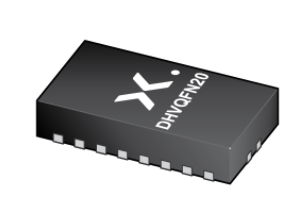

74LVC244ABQ-Q100X
74LVC244ABQ-Q100X
    NEXPERIA(安世)
    DHVQFN-20-EP(2.5x4.5)
    缓冲器/驱动器 DHVQFN-20 Buffer, Non Reverse 1.2~3.6V 3-State
74LVC244ABQ-Q100X 数据手册
74LVC244A-Q100; 74LVCH244A-Q100 Octal buffer/line driver; 3-state Rev. 4 — 22 July 2019 Product data sheet 1. General description The 74LVC244A-Q100; 74LVCH244A-Q100 is an octal non-inverting buffer/line driver with 3-state outputs. The 3-state outputs are controlled by the output enable inputs 1OE and 2OE. A HIGH on nOE causes the outputs to assume a high-impedance OFF-state. Schmitt-trigger action at all inputs makes the circuit highly tolerant for slower input rise and fall times. Inputs can be driven from either 3.3 V or 5.0 V devices. In 3-state operation, outputs can handle 5 V. These features allow the use of these devices as translators in a mixed 3.3 V and 5 V environment. The 74LVCH244A-Q100 bus hold on data inputs eliminates the need for external pull-up resistors to hold unused inputs. This product has been qualified to the Automotive Electronics Council (AEC) standard Q100 (Grade 1) and is suitable for use in automotive applications. 2. Features and benefits • • • • • • • • • • • Automotive product qualification in accordance with AEC-Q100 (Grade 1) • Specified from -40 °C to +85 °C and from -40 °C to +125 °C 5 V tolerant inputs/outputs for interfacing with 5 V logic Wide supply voltage range from 1.2 V to 3.6 V CMOS low-power consumption Direct interface with TTL levels Inputs accept voltages up to 5.5 V High-impedance when VCC = 0 V Bus hold on all data inputs (74LVCH244A-Q100 only) Complies with JEDEC standard: • JESD8-7A (1.65 V to 1.95 V) • JESD8-5A (2.3 V to 2.7 V) • JESD8-C/JESD36 (2.7 V to 3.6 V) ESD protection: • MIL-STD-883, method 3015 exceeds 2000 V • HBM JESD22-A114F exceeds 2000 V • MM JESD22-A115-A exceeds 200 V (C = 200 pF, R = 0 Ω) Multiple package options Nexperia 74LVC244A-Q100; 74LVCH244A-Q100 Octal buffer/line driver; 3-state 3. Ordering information Table 1. Ordering information Type number Package Temperature range Name Description Version -40 °C to +125 °C SO20 plastic small outline package; 20 leads; body width 7.5 mm SOT163-1 74LVCH244ADB-Q100 -40 °C to +125 °C SSOP20 plastic shrink small outline package; 20 leads; body width 5.3 mm SOT339-1 74LVC244APW-Q100 -40 °C to +125 °C TSSOP20 plastic thin shrink small outline package; 20 leads; body width 4.4 mm SOT360-1 -40 °C to +125 °C DHVQFN20 plastic dual in-line compatible thermal enhanced very thin quad flat package; no leads; 20 terminals; body 2.5 × 4.5 × 0.85 mm 74LVC244AD-Q100 74LVCH244AD-Q100 74LVCH244APW-Q100 74LVC244ABQ-Q100 74LVCH244ABQ-Q100 SOT764-1 4. Functional diagram 2 4 6 1 8 EN 2 18 4 16 6 14 8 12 1 17 15 19 EN 13 11 9 13 7 15 5 17 3 11 19 1A0 1Y0 1A1 1Y1 1A2 1Y2 1A3 1Y3 IEC logic diagram 74LVC_LVCH244A_Q100 Product data sheet 16 14 12 1OE 2A0 2Y0 2A1 2Y1 2A2 2Y2 2A3 2Y3 3 5 7 9 2OE mna873 Fig. 1. 18 mna875 Fig. 2. Functional diagram All information provided in this document is subject to legal disclaimers. Rev. 4 — 22 July 2019 © Nexperia B.V. 2019. All rights reserved 2 / 16 Nexperia 74LVC244A-Q100; 74LVCH244A-Q100 Octal buffer/line driver; 3-state 1A0 1A1 1A2 1A3 1OE 2 18 4 16 6 14 8 12 1Y0 2A0 1Y1 2A1 1Y2 2A2 1Y3 2A3 1 2OE 17 3 15 5 13 7 11 9 2Y0 2Y1 2Y2 2Y3 19 mna874 Fig. 3. Logic symbol 5. Pinning information 5.1. Pinning 1 terminal 1 index area 1 20 VCC 1A0 2 19 2OE 2Y0 3 18 1Y0 1A1 4 17 2A0 2Y1 5 16 1Y1 1A2 6 15 2A1 2Y2 7 14 1Y2 1A3 8 13 2A2 2Y3 9 12 1Y3 GND 10 11 2A3 Pin configuration SOT163-1 (SO20), SOT339-1 (SSOP20) and SOT360-1 (TSSOP20) 74LVC_LVCH244A_Q100 Product data sheet 19 2OE 3 18 1Y0 1A1 4 17 2A0 2Y1 5 16 1Y1 1A2 6 15 2A1 2Y2 7 1A3 8 2Y3 9 14 1Y2 GND (1) 13 2A2 12 1Y3 001aad114 Transparent top view (1) This is not a ground pin. There is no electrical or mechanical requirement to solder the pad. In case soldered, the solder land should remain floating or connected to GND. 001aad113 Fig. 4. 2 2Y0 2A3 11 1OE 1A0 GND 10 74LVC244A 74LVCH244A 20 VCC 1OE 74LVC244A 74LVCH244A Fig. 5. Pin configuration SOT764-1 (DHVQFN20) All information provided in this document is subject to legal disclaimers. Rev. 4 — 22 July 2019 © Nexperia B.V. 2019. All rights reserved 3 / 16 Nexperia 74LVC244A-Q100; 74LVCH244A-Q100 Octal buffer/line driver; 3-state 5.2. Pin description Table 2. Pin description Symbol Pin Description 1OE, 2OE 1, 19 output enable input (active low) 1A0, 1A1, 1A2, 1A3 2, 4, 6, 8 data input 2Y0, 2Y1, 2Y2, 2Y3 3, 5, 7, 9 data output GND 10 ground (0 V) 2A0, 2A1, 2A2, 2A3 17, 15, 13, 11 data input 1Y0, 1Y1, 1Y2, 1Y3, 18, 16, 14, 12 data output VCC 20 supply voltage 6. Functional description Table 3. Function table H = HIGH voltage level; L = LOW voltage level; X = don’t care; Z = high-impedance OFF-state. Control Input Output nOE nAn nYn L L L L H H H X Z 7. Limiting values Table 4. Limiting values In accordance with the Absolute Maximum Rating System (IEC 60134). Voltages are referenced to GND (ground = 0 V). Symbol Parameter Conditions VCC supply voltage IIK input clamping current VI input voltage IOK output clamping current VO > VCC or VO < 0 V VO output voltage output HIGH or LOW output 3-state VI < 0 V Min Max Unit -0.5 +6.5 V -50 - -0.5 +6.5 V - ±50 mA [2] -0.5 VCC + 0.5 V [2] -0.5 +6.5 V [1] IO output current - ±50 mA ICC supply current - 100 mA IGND ground current -100 - mA Tstg storage temperature -65 +150 °C Ptot total power dissipation - 500 mW [1] [2] [3] VO = 0 V to VCC mA Tamb = -40 °C to +125 °C [3] The minimum input voltage ratings may be exceeded if the input current ratings are observed. The output voltage ratings may be exceeded if the output current ratings are observed. For SOT163-1 (SO20) packages: Ptot derates linearly with 12.3 mW/K above 109 °C. For SOT339-1 (SSOP20) packages: Ptot derates linearly with 10.0 mW/K above 100 °C. For SOT360-1 (TSSOP20) packages: Ptot derates linearly with 10.0 mW/K above 100 °C. For SOT764-1 (DHVQFN20) packages: Ptot derates linearly with 12.9 mW/K above 111 °C. 74LVC_LVCH244A_Q100 Product data sheet All information provided in this document is subject to legal disclaimers. Rev. 4 — 22 July 2019 © Nexperia B.V. 2019. All rights reserved 4 / 16 Nexperia 74LVC244A-Q100; 74LVCH244A-Q100 Octal buffer/line driver; 3-state 8. Recommended operating conditions Table 5. Recommended operating conditions Symbol Parameter VCC Conditions Min Typ Max Unit 1.65 - 3.6 V 1.2 - 3.6 V 0 - 5.5 V output HIGH or LOW 0 - VCC V output 3-state 0 - 5.5 V -40 - +125 °C supply voltage functional VI input voltage VO output voltage Tamb ambient temperature in free air Δt/ΔV input transition rise and fall rate VCC = 1.2 V to 2.7 V 0 - 20 ns/V VCC = 2.7 V to 3.6 V 0 - 10 ns/V 9. Static characteristics Table 6. Static characteristics At recommended operating conditions. Voltages are referenced to GND (ground = 0 V). Symbol Parameter VIH VIL VOH VOL Conditions -40 °C to +85 °C HIGH-level input VCC = 1.2 V voltage VCC = 1.65 V to 1.95 V LOW-level input voltage HIGH-level output voltage Product data sheet Min Typ [1] Max Min Max 1.08 - - 1.08 - V 0.65VCC - - 0.65VCC - V VCC = 2.3 V to 2.7 V 1.7 - - 1.7 - V VCC = 2.7 V to 3.6 V 2.0 - - 2.0 - V VCC = 1.2 V - - 0.12 - 0.12 V VCC = 1.65 V to 1.95 V - - 0.35VCC - VCC = 2.3 V to 2.7 V - - 0.7 - 0.7 V VCC = 2.7 V to 3.6 V - - 0.8 - 0.8 V VCC - 0.2 - - VCC - 0.3 - V IO = -4 mA; VCC = 1.65 V 1.2 - - 1.05 - V IO = -8 mA; VCC = 2.3 V 1.8 - - 1.65 - V IO = -12 mA; VCC = 2.7 V 2.2 - - 2.05 - V IO = -18 mA; VCC = 3.0 V 2.4 - - 2.25 - V IO = -24 mA; VCC = 3.0 V 2.2 - - 2.0 - V - - 0.2 - 0.3 V IO = 4 mA; VCC = 1.65 V - - 0.45 - 0.65 V IO = 8 mA; VCC = 2.3 V - - 0.6 - 0.8 V IO = 12 mA; VCC = 2.7 V - - 0.4 - 0.6 V IO = 24 mA; VCC = 3.0 V - - 0.55 - 0.8 V 0.35VCC V VI = VIH or VIL IO = -100 μA; VCC = 1.65 V to 3.6 V LOW-level output VI = VIH or VIL voltage IO = 100 μA; VCC = 1.65 V to 3.6 V 74LVC_LVCH244A_Q100 -40 °C to +125 °C Unit All information provided in this document is subject to legal disclaimers. Rev. 4 — 22 July 2019 © Nexperia B.V. 2019. All rights reserved 5 / 16 Nexperia 74LVC244A-Q100; 74LVCH244A-Q100 Octal buffer/line driver; 3-state Symbol Parameter Conditions -40 °C to +85 °C Min Typ [1] Max Min Max [2] - ±0.1 ±5 - ±20 μA [2] - ±0.1 ±5 - ±20 μA II input leakage current IOZ OFF-state output VI = VIH or VIL; current VO = 5.5 V or GND; VCC = 3.6 V IOFF power-off leakage current VI or VO = 5.5 V; VCC = 0.0 V - ±0.1 ±10 - ±20 μA ICC supply current VI = VCC or GND; IO = 0 A; VCC = 3.6 V - 0.1 10 - 40 μA ΔICC additional supply per input pin; VI = VCC - 0.6 V; current IO = 0 A; VCC = 2.7 V to 3.6 V - 5 500 - 5000 μA CI input capacitance - 4.0 - - - pF IBHL bus hold LOW current 10 - - 10 - μA VCC = 2.3 V; VI = 0.7 V 30 - - 25 - μA VCC = 3.0 V; VI = 0.8 V 75 - - 60 - μA -10 - - -10 - μA VCC = 2.3 V; VI = 1.7 V -30 - - -25 - μA VCC = 3.0 V; VI = 2.0 V -75 - - -60 - μA 200 - - 200 - μA 300 - - 300 - μA 500 - - 500 - μA -200 - - -200 - μA -300 - - -300 - μA -500 - - -500 - μA IBHH IBHLO bus hold HIGH current VI = 5.5 V or GND; VCC = 3.6 V -40 °C to +125 °C Unit VCC = 1.65 V; VI = 0.58 V VCC = 1.65 V; VI = 1.07 V VCC = 1.95 V bus hold LOW overdrive current V = 2.7 V CC [3][4] [3][4] [3][5] VCC = 3.6 V IBHHO VCC = 1.95 V bus hold HIGH overdrive current V = 2.7 V CC VCC = 3.6 V [1] [2] [3] [4] [5] [3][5] All typical values are measured at VCC = 3.3 V (unless stated otherwise) and Tamb = 25 °C. The bus hold circuit is switched off when VI > VCC allowing 5.5 V on the input terminal. Valid for data inputs of bus hold parts only (74LVCH244A-Q100). Note that control inputs do not have a bus hold circuit. The specified sustaining current at the data input holds the input below the specified VI level. The specified overdrive current at the data input forces the data input to the opposite input state. 74LVC_LVCH244A_Q100 Product data sheet All information provided in this document is subject to legal disclaimers. Rev. 4 — 22 July 2019 © Nexperia B.V. 2019. All rights reserved 6 / 16 Nexperia 74LVC244A-Q100; 74LVCH244A-Q100 Octal buffer/line driver; 3-state 10. Dynamic characteristics Table 7. Dynamic characteristics Voltages are referenced to GND (ground = 0 V). For test circuit see Fig. 8. Symbol Parameter tpd propagation delay Conditions -40 °C to +85 °C nAn to nYn; see Fig. 6 enable time output skew time CPD power dissipation capacitance [1] [2] [3] [4] Max - 17.0 - - - ns 6.4 13.7 1.5 15.8 ns VCC = 2.3 V to 2.7 V 1.0 3.4 7.1 1.0 8.2 ns VCC = 2.7 V 1.5 3.4 6.9 1.5 9.0 ns VCC = 3.0 V to 3.6 V 1.5 2.9 5.9 1.5 7.5 ns - 24.0 - - - ns VCC = 1.65 V to 1.95 V 1.5 7.0 17.3 1.5 20.0 ns VCC = 2.3 V to 2.7 V 1.5 3.9 9.5 1.5 11.0 ns VCC = 2.7 V 1.5 4.1 8.6 1.5 11.0 ns 1.0 3.2 7.6 1.0 9.5 ns - 9.0 - - - ns VCC = 1.65 V to 1.95 V 2.2 4.5 9.8 2.2 11.3 ns VCC = 2.3 V to 2.7 V 0.5 3.6 5.5 0.5 6.4 ns VCC = 2.7 V 1.5 3.3 6.8 1.5 8.5 ns VCC = 3.0 V to 3.6 V 1.5 3.1 5.8 1.5 7.5 ns - - 1.0 - 1.5 ns VCC = 1.65 V to 1.95 V - 6.4 - - - pF VCC = 2.3 V to 2.7 V - 9.6 - - - pF VCC = 3.0 V to 3.6 V - 12.5 - - - pF nOE to nYn; see Fig. 7 [2] nOE to nYn; see Fig. 7 [2] VCC = 1.2 V tsk(o) Min 1.5 VCC = 3.0 V to 3.6 V disable time Max VCC = 1.65 V to 1.95 V VCC = 1.2 V tdis Typ [1] [2] VCC = 1.2 V ten Min -40 °C to +125 °C Unit [3] per input; VI = GND to VCC [4] Typical values are measured at Tamb = 25 °C and VCC = 1.2 V, 1.8 V, 2.5 V, 2.7 V, and 3.3 V respectively. tpd is the same as tPLH and tPHL. ten is the same as tPZL and tPZH. tdis is the same as tPLZ and tPHZ. Skew between any two outputs of the same package switching in the same direction. This parameter is guaranteed by design. CPD is used to determine the dynamic power dissipation (PD in μW). 2 2 PD = CPD × VCC × fi × N + Σ(CL × VCC × fo) where: fi = input frequency in MHz; fo = output frequency in MHz CL = output load capacitance in pF VCC = supply voltage in Volts N = number of inputs switching 2 Σ(CL × VCC × fo) = sum of the outputs. 74LVC_LVCH244A_Q100 Product data sheet All information provided in this document is subject to legal disclaimers. Rev. 4 — 22 July 2019 © Nexperia B.V. 2019. All rights reserved 7 / 16 Nexperia 74LVC244A-Q100; 74LVCH244A-Q100 Octal buffer/line driver; 3-state 10.1. Waveforms and test circuit VI nAn input VM VM GND tPLH tPHL VOH VM nYn output VM VOL mna171 Measurement points are given in Table 8. Logic levels: VOL and VOH are typical output voltage levels that occur with the output load. Fig. 6. The input (nAn) to output (nYn) propagation delays VI nOE input VM GND tPLZ tPZL VCC output LOW-to-OFF OFF-to-LOW VM VX VOL tPHZ VOH tPZH VY output HIGH-to-OFF OFF-to-HIGH GND VM outputs enabled outputs enabled outputs disabled mna362 Measurement points are given in Table 8. Logic levels: VOL and VOH are typical output voltage levels that occur with the output load. Fig. 7. 3-state enable and disable times Table 8. Measurement points Supply voltage Input Output VCC VI VM VM VX VY 1.2 V VCC 0.5 × VCC 0.5 × VCC VOL + 0.15 V VOH - 0.15 V 1.65 V to 1.95 V VCC 0.5 × VCC 0.5 × VCC VOL + 0.15 V VOH - 0.15 V 2.3 V to 2.7 V VCC 0.5 × VCC 0.5 × VCC VOL + 0.15 V VOH - 0.15 V 2.7 V 2.7 V 1.5 V 1.5 V VOL + 0.3 V VOH - 0.3 V 3.0 V to 3.6 V 2.7 V 1.5 V 1.5 V VOL + 0.3 V VOH - 0.3 V 74LVC_LVCH244A_Q100 Product data sheet All information provided in this document is subject to legal disclaimers. Rev. 4 — 22 July 2019 © Nexperia B.V. 2019. All rights reserved 8 / 16 Nexperia 74LVC244A-Q100; 74LVCH244A-Q100 Octal buffer/line driver; 3-state tW VI 90 % negative pulse VM VM 10 % 0V VI tf tr tr tf 90 % positive pulse VM VM 10 % 0V tW VEXT VCC G VI RL VO DUT RT CL RL 001aae331 Test data is given in Table 9. Definitions for test circuit: RL = Load resistance. CL = Load capacitance including jig and probe capacitance. RT = Termination resistance should be equal to output impedance Zo of the pulse generator. VEXT = External voltage for measuring switching times. Fig. 8. Test circuit for measuring switching times Table 9. Test data Supply voltage Input Load VEXT VI tr, tf CL RL tPLH, tPHL tPLZ, tPZL tPHZ, tPZH 1.2 V VCC ≤ 2 ns 30 pF 1 kΩ open 2 × VCC GND 1.65 V to 1.95 V VCC ≤ 2 ns 30 pF 1 kΩ open 2 × VCC GND 2.3 V to 2.7 V VCC ≤ 2 ns 30 pF 500 Ω open 2 × VCC GND 2.7 V 2.7 V ≤ 2.5 ns 50 pF 500 Ω open 2 × VCC GND 3.0 V to 3.6 V 2.7 V ≤ 2.5 ns 50 pF 500 Ω open 2 × VCC GND 74LVC_LVCH244A_Q100 Product data sheet All information provided in this document is subject to legal disclaimers. Rev. 4 — 22 July 2019 © Nexperia B.V. 2019. All rights reserved 9 / 16 Nexperia 74LVC244A-Q100; 74LVCH244A-Q100 Octal buffer/line driver; 3-state 11. Package outline SO20: plastic small outline package; 20 leads; body width 7.5 mm SOT163-1 D E A X c y HE v M A Z 20 11 Q A2 A (A 3 ) A1 pin 1 index θ Lp L 1 10 e detail X w M bp 0 5 10 mm scale DIMENSIONS (inch dimensions are derived from the original mm dimensions) UNIT A max. A1 A2 A3 bp c D (1) E (1) e HE L Lp Q v w y mm 2.65 0.3 0.1 2.45 2.25 0.25 0.49 0.36 0.32 0.23 13.0 12.6 7.6 7.4 1.27 10.65 10.00 1.4 1.1 0.4 1.1 1.0 0.25 0.25 0.1 0.9 0.4 inches 0.1 0.012 0.096 0.004 0.089 0.01 0.019 0.013 0.014 0.009 0.51 0.49 0.30 0.29 0.05 0.419 0.043 0.055 0.394 0.016 0.043 0.039 0.01 0.01 0.004 0.035 0.016 Z (1) θ o 8 o 0 Note 1. Plastic or metal protrusions of 0.15 mm (0.006 inch) maximum per side are not included. Fig. 9. REFERENCES OUTLINE VERSION IEC JEDEC SOT163-1 075E04 MS-013 JEITA EUROPEAN PROJECTION ISSUE DATE 99-12-27 03-02-19 Package outline SOT163-1 (SO20) 74LVC_LVCH244A_Q100 Product data sheet All information provided in this document is subject to legal disclaimers. Rev. 4 — 22 July 2019 © Nexperia B.V. 2019. All rights reserved 10 / 16 Nexperia 74LVC244A-Q100; 74LVCH244A-Q100 Octal buffer/line driver; 3-state SSOP20: plastic shrink small outline package; 20 leads; body width 5.3 mm D SOT339-1 E A X c HE y v M A Z 20 11 Q A2 pin 1 index A (A 3) A1 θ Lp L 1 10 bp e detail X w M 0 2.5 5 mm scale DIMENSIONS (mm are the original dimensions) UNIT A max. A1 A2 A3 bp c D (1) E (1) e HE L Lp Q v w y Z (1) θ mm 2 0.21 0.05 1.80 1.65 0.25 0.38 0.25 0.20 0.09 7.4 7.0 5.4 5.2 0.65 7.9 7.6 1.25 1.03 0.63 0.9 0.7 0.2 0.13 0.1 0.9 0.5 8o 0o Note 1. Plastic or metal protrusions of 0.2 mm maximum per side are not included. OUTLINE VERSION SOT339-1 REFERENCES IEC JEDEC JEITA EUROPEAN PROJECTION ISSUE DATE 99-12-27 03-02-19 MO-150 Fig. 10. Package outline SOT339-1 (SSOP20) 74LVC_LVCH244A_Q100 Product data sheet All information provided in this document is subject to legal disclaimers. Rev. 4 — 22 July 2019 © Nexperia B.V. 2019. All rights reserved 11 / 16 Nexperia 74LVC244A-Q100; 74LVCH244A-Q100 Octal buffer/line driver; 3-state TSSOP20: plastic thin shrink small outline package; 20 leads; body width 4.4 mm D SOT360-1 E A X c HE y v M A Z 11 20 Q A2 pin 1 index (A 3 ) A1 A θ Lp 1 L 10 detail X w M bp e 0 2.5 5 mm scale DIMENSIONS (mm are the original dimensions) UNIT A max. A1 A2 A3 bp c D (1) E (2) e HE L Lp Q v w y Z (1) θ mm 1.1 0.15 0.05 0.95 0.80 0.25 0.30 0.19 0.2 0.1 6.6 6.4 4.5 4.3 0.65 6.6 6.2 1 0.75 0.50 0.4 0.3 0.2 0.13 0.1 0.5 0.2 8o 0o Notes 1. Plastic or metal protrusions of 0.15 mm maximum per side are not included. 2. Plastic interlead protrusions of 0.25 mm maximum per side are not included. OUTLINE VERSION SOT360-1 REFERENCES IEC JEDEC JEITA EUROPEAN PROJECTION ISSUE DATE 99-12-27 03-02-19 MO-153 Fig. 11. Package outline SOT360-1 (TSSOP20) 74LVC_LVCH244A_Q100 Product data sheet All information provided in this document is subject to legal disclaimers. Rev. 4 — 22 July 2019 © Nexperia B.V. 2019. All rights reserved 12 / 16 Nexperia 74LVC244A-Q100; 74LVCH244A-Q100 Octal buffer/line driver; 3-state DHVQFN20: plastic dual in-line compatible thermal enhanced very thin quad flat package; no leads; 20 terminals; body 2.5 x 4.5 x 0.85 mm B D SOT764-1 A A A1 E c detail X terminal 1 index area terminal 1 index area e1 C e b 2 9 v w C A B C y1 C y L 1 10 Eh e 20 11 19 12 X Dh 0 2.5 5 mm scale Dimensions (mm are the original dimensions) Unit mm A(1) A1 b max 1.00 0.05 0.30 nom 0.90 0.02 0.25 min 0.80 0.00 0.18 c D(1) Dh E(1) Eh e e1 L v 0.2 4.6 4.5 4.4 3.15 3.00 2.85 2.6 2.5 2.4 1.15 1.00 0.85 0.5 3.5 0.5 0.4 0.3 0.1 w y 0.05 0.05 y1 0.1 Note 1. Plastic or metal protrusions of 0.075 mm maximum per side are not included. References Outline version IEC JEDEC JEITA SOT764-1 --- MO-241 --- sot764-1_po European projection Issue date 03-01-27 14-12-12 Fig. 12. Package outline SOT764-1 (DHVQFN20) 74LVC_LVCH244A_Q100 Product data sheet All information provided in this document is subject to legal disclaimers. Rev. 4 — 22 July 2019 © Nexperia B.V. 2019. All rights reserved 13 / 16 Nexperia 74LVC244A-Q100; 74LVCH244A-Q100 Octal buffer/line driver; 3-state 12. Abbreviations Table 10. Abbreviations Acronym Description CMOS Complementary Metal-Oxide Semiconductor DUT Device Under Test ESD ElectroStatic Discharge HBM Human Body Model MIL Military MM Machine Model TTL Transistor-Transistor Logic 13. Revision history Table 11. Revision history Document ID Release date 74LVC_LVCH244A_Q100 v.4 20190722 Modifications: • • • • • • • • • • Product data sheet - 74LVC_LVCH244A_Q100 v.3 Product data sheet - 74LVC_LVCH244A_Q100 v.2 Product data sheet - 74LVC_LVCH244A_Q100 v.1 74LVC244ADB-Q100 and 74LVCH244DB-Q100 added. 74LVC_LVCH244A_Q100 v.1 20120823 74LVC_LVCH244A_Q100 Product data sheet The format of this data sheet has been redesigned to comply with the identity guidelines of Nexperia. Legal texts have been adapted to the new company name where appropriate. Type number 74LVCH244AD-Q100 (SOT163-1) removed. Type numbers 74LVC244ADB-Q100 and 74LVCH244ADB-Q100 (SOT339-1) removed. Type number 74LVCH244ABQ-Q100 (SOT764-1) removed. 74LVC_LVCH244A_Q100 v.2 20130813 Modifications: Change notice Supersedes Type number 74LVCH244AD-Q100 (SOT163-1) added. Type number 74LVCH244ADB-Q100 (SOT339-1) added. Type number 74LVCH244ABQ-Q100 (SOT764-1) added. Table 4: Derating values for Ptot total power dissipation have changed. 74LVC_LVCH244A_Q100 v.3 20180813 Modifications: Data sheet status Product data sheet - All information provided in this document is subject to legal disclaimers. Rev. 4 — 22 July 2019 - © Nexperia B.V. 2019. All rights reserved 14 / 16 Nexperia 74LVC244A-Q100; 74LVCH244A-Q100 Octal buffer/line driver; 3-state equipment, nor in applications where failure or malfunction of an Nexperia product can reasonably be expected to result in personal injury, death or severe property or environmental damage. Nexperia and its suppliers accept no liability for inclusion and/or use of Nexperia products in such equipment or applications and therefore such inclusion and/or use is at the customer's own risk. 14. Legal information Data sheet status Document status [1][2] Product status [3] Definition Quick reference data — The Quick reference data is an extract of the product data given in the Limiting values and Characteristics sections of this document, and as such is not complete, exhaustive or legally binding. Objective [short] data sheet Development This document contains data from the objective specification for product development. Preliminary [short] data sheet Qualification This document contains data from the preliminary specification. Applications — Applications that are described herein for any of these products are for illustrative purposes only. Nexperia makes no representation or warranty that such applications will be suitable for the specified use without further testing or modification. Product [short] data sheet Production This document contains the product specification. [1] [2] [3] Please consult the most recently issued document before initiating or completing a design. The term 'short data sheet' is explained in section "Definitions". The product status of device(s) described in this document may have changed since this document was published and may differ in case of multiple devices. The latest product status information is available on the internet at https://www.nexperia.com. Definitions Draft — The document is a draft version only. The content is still under internal review and subject to formal approval, which may result in modifications or additions. Nexperia does not give any representations or warranties as to the accuracy or completeness of information included herein and shall have no liability for the consequences of use of such information. Short data sheet — A short data sheet is an extract from a full data sheet with the same product type number(s) and title. A short data sheet is intended for quick reference only and should not be relied upon to contain detailed and full information. For detailed and full information see the relevant full data sheet, which is available on request via the local Nexperia sales office. In case of any inconsistency or conflict with the short data sheet, the full data sheet shall prevail. Product specification — The information and data provided in a Product data sheet shall define the specification of the product as agreed between Nexperia and its customer, unless Nexperia and customer have explicitly agreed otherwise in writing. In no event however, shall an agreement be valid in which the Nexperia product is deemed to offer functions and qualities beyond those described in the Product data sheet. Disclaimers Limited warranty and liability — Information in this document is believed to be accurate and reliable. However, Nexperia does not give any representations or warranties, expressed or implied, as to the accuracy or completeness of such information and shall have no liability for the consequences of use of such information. Nexperia takes no responsibility for the content in this document if provided by an information source outside of Nexperia. In no event shall Nexperia be liable for any indirect, incidental, punitive, special or consequential damages (including - without limitation - lost profits, lost savings, business interruption, costs related to the removal or replacement of any products or rework charges) whether or not such damages are based on tort (including negligence), warranty, breach of contract or any other legal theory. Customers are responsible for the design and operation of their applications and products using Nexperia products, and Nexperia accepts no liability for any assistance with applications or customer product design. It is customer’s sole responsibility to determine whether the Nexperia product is suitable and fit for the customer’s applications and products planned, as well as for the planned application and use of customer’s third party customer(s). Customers should provide appropriate design and operating safeguards to minimize the risks associated with their applications and products. Nexperia does not accept any liability related to any default, damage, costs or problem which is based on any weakness or default in the customer’s applications or products, or the application or use by customer’s third party customer(s). Customer is responsible for doing all necessary testing for the customer’s applications and products using Nexperia products in order to avoid a default of the applications and the products or of the application or use by customer’s third party customer(s). Nexperia does not accept any liability in this respect. Limiting values — Stress above one or more limiting values (as defined in the Absolute Maximum Ratings System of IEC 60134) will cause permanent damage to the device. Limiting values are stress ratings only and (proper) operation of the device at these or any other conditions above those given in the Recommended operating conditions section (if present) or the Characteristics sections of this document is not warranted. Constant or repeated exposure to limiting values will permanently and irreversibly affect the quality and reliability of the device. Terms and conditions of commercial sale — Nexperia products are sold subject to the general terms and conditions of commercial sale, as published at http://www.nexperia.com/profile/terms, unless otherwise agreed in a valid written individual agreement. In case an individual agreement is concluded only the terms and conditions of the respective agreement shall apply. Nexperia hereby expressly objects to applying the customer’s general terms and conditions with regard to the purchase of Nexperia products by customer. No offer to sell or license — Nothing in this document may be interpreted or construed as an offer to sell products that is open for acceptance or the grant, conveyance or implication of any license under any copyrights, patents or other industrial or intellectual property rights. Export control — This document as well as the item(s) described herein may be subject to export control regulations. Export might require a prior authorization from competent authorities. Translations — A non-English (translated) version of a document is for reference only. The English version shall prevail in case of any discrepancy between the translated and English versions. Trademarks Notice: All referenced brands, product names, service names and trademarks are the property of their respective owners. Notwithstanding any damages that customer might incur for any reason whatsoever, Nexperia’s aggregate and cumulative liability towards customer for the products described herein shall be limited in accordance with the Terms and conditions of commercial sale of Nexperia. Right to make changes — Nexperia reserves the right to make changes to information published in this document, including without limitation specifications and product descriptions, at any time and without notice. This document supersedes and replaces all information supplied prior to the publication hereof. Suitability for use in automotive applications — This Nexperia product has been qualified for use in automotive applications. Unless otherwise agreed in writing, the product is not designed, authorized or warranted to be suitable for use in life support, life-critical or safety-critical systems or 74LVC_LVCH244A_Q100 Product data sheet All information provided in this document is subject to legal disclaimers. Rev. 4 — 22 July 2019 © Nexperia B.V. 2019. All rights reserved 15 / 16 Nexperia 74LVC244A-Q100; 74LVCH244A-Q100 Octal buffer/line driver; 3-state Contents 1. General description...................................................... 1 2. Features and benefits.................................................. 1 3. Ordering information....................................................2 4. Functional diagram.......................................................2 5. Pinning information......................................................3 5.1. Pinning.........................................................................3 5.2. Pin description............................................................. 4 6. Functional description................................................. 4 7. Limiting values............................................................. 4 8. Recommended operating conditions..........................5 9. Static characteristics....................................................5 10. Dynamic characteristics............................................ 7 10.1. Waveforms and test circuit........................................ 8 11. Package outline........................................................ 10 12. Abbreviations............................................................ 14 13. Revision history........................................................14 14. Legal information......................................................15 © Nexperia B.V. 2019. All rights reserved For more information, please visit: http://www.nexperia.com For sales office addresses, please send an email to: salesaddresses@nexperia.com Date of release: 22 July 2019 74LVC_LVCH244A_Q100 Product data sheet All information provided in this document is subject to legal disclaimers. Rev. 4 — 22 July 2019 © Nexperia B.V. 2019. All rights reserved 16 / 16 Mouser Electronics Authorized Distributor Click to View Pricing, Inventory, Delivery & Lifecycle Information: Nexperia: 74LVC244APW-Q100J 74LVCH244APW-Q100J 74LVC244AD-Q100J 74LVC244ABQ-Q100X 74LVC244ADBQ100J
