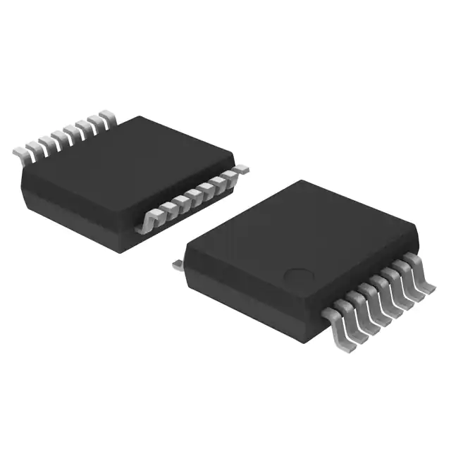

    8级移位和存储总线寄存器 SSOP16_208MIL 4.5~5.5V
74HCT4094DB,118 数据手册
74HC4094; 74HCT4094 8-stage shift-and-store bus register Rev. 8 — 14 November 2018 Product data sheet 1. General description The 74HC4094; 74HCT4094 is an 8-bit serial-in/serial or parallel-out shift register with a storage register and 3-state outputs. Both the shift and storage register have separate clocks. The device features a serial input (D) and two serial outputs (QS1 and QS2) to enable cascading. Data is shifted on the LOW-to-HIGH transitions of the CP input. Data is available at QS1 on the LOW-toHIGH transitions of the CP input to allow cascading when clock edges are fast. The same data is available at QS2 on the next HIGH-to-LOW transition of the CP input to allow cascading when clock edges are slow. The data in the shift register is transferred to the storage register when the STR input is HIGH. Data in the storage register appears at the outputs whenever the output enable input (OE) is HIGH. A LOW on OE causes the outputs to assume a high-impedance OFF-state. Operation of the OE input does not affect the state of the registers. Inputs include clamp diodes. This enables the use of current limiting resistors to interface inputs to voltages in excess of VCC. 2. Features and benefits • • • • • • Complies with JEDEC standard JESD7A Input levels: • For 74HC4094: CMOS level • For 74HCT4094: TTL level Low-power dissipation ESD protection: • HBM JESD22-A114F exceeds 2 000 V • MM JESD22-A115-A exceeds 200 V Specified from -40 °C to +85 °C and from -40 °C to +125 °C 3. Applications • • Serial-to-parallel data conversion Remote control holding register 4. Ordering information Table 1. Ordering information Type number Package 74HC4094D Temperature range Name Description Version -40 °C to +125 °C SO16 plastic small outline package; 16 leads; body width 3.9 mm SOT109-1 -40 °C to +125 °C SSOP16 plastic shrink small outline package; 16 leads; body width 5.3 mm SOT338-1 -40 °C to +125 °C TSSOP16 plastic thin shrink small outline package; 16 leads; body width 4.4 mm SOT403-1 74HCT4094D 74HC4094DB 74HCT4094DB 74HC4094PW 74HC4094; 74HCT4094 Nexperia 8-stage shift-and-store bus register 5. Functional diagram 3 1 CP 2 1 STR D OE QS1 9 QS2 10 QP0 4 QP1 5 QP2 6 QP3 7 QP4 14 QP5 13 QP6 12 QP7 11 EN3 SRG8 3 C1/ 2 1D 2D 4 3 5 6 7 14 13 12 11 9 10 15 Fig. 1. C2 15 001aaf112 001aaf111 Logic symbol Fig. 2. 2 3 1 15 D IEC Logic symbol 8-STAGE SHIFT REGISTER CP QS2 QS1 STR 10 9 8-BIT STORAGE REGISTER OE 3-STATE OUTPUTS QP0 QP1 QP2 QP3 QP4 QP5 QP6 QP7 4 Fig. 3. 5 6 7 14 13 12 11 001aaf119 Functional diagram STAGE 0 D D STAGES 1 TO 6 Q D STAGE 7 Q CP D Q QS1 CP FF 0 CP D FF 7 CP Q QS2 LE LATCH D Q D Q LE LE LATCH 0 LATCH 7 STR OE QP0 Fig. 4. QP1 QP2 QP3 QP4 QP5 QP6 QP7 001aag799 Logic diagram 74HC_HCT4094 Product data sheet All information provided in this document is subject to legal disclaimers. Rev. 8 — 14 November 2018 © Nexperia B.V. 2018. All rights reserved 2 / 19 74HC4094; 74HCT4094 Nexperia 8-stage shift-and-store bus register 6. Pinning information 6.1. Pinning 74HC4094 74HCT4094 STR 1 16 VCC D 2 15 OE CP 3 14 QP4 QP0 4 13 QP5 QP1 QP2 5 12 QP6 6 QP3 7 GND 8 74HC4094 74HCT4094 11 QP7 10 QS2 9 1 D 2 16 VCC 15 OE CP 3 14 QP4 QP0 4 13 QP5 QP1 5 12 QP6 QP2 6 11 QP7 QP3 7 10 QS2 GND 8 9 QS1 QS1 001aan578 001aan577 Fig. 5. STR Fig. 6. Pin configuration SOT109-1 (SO16) Pin configuration SOT338-1 (SSOP16) and SOT403-1 (TSSOP16) 6.2. Pin description Table 2. Pin description Symbol Pin Description STR 1 strobe input D 2 data input CP 3 clock input QP0 to QP7 4, 5, 6, 7, 14, 13, 12, 11 parallel output GND 8 ground supply voltage QS1, QS2 9, 10 serial output OE 15 output enable input VCC 16 supply voltage 74HC_HCT4094 Product data sheet All information provided in this document is subject to legal disclaimers. Rev. 8 — 14 November 2018 © Nexperia B.V. 2018. All rights reserved 3 / 19 74HC4094; 74HCT4094 Nexperia 8-stage shift-and-store bus register 7. Functional description Table 3. Function table H = HIGH voltage level; L = LOW voltage level; X = don’t care; Z = HIGH-impedance OFF-state; NC = no change; ↑ = positive-going transition; ↓ = negative-going transition; Q6S = the data in register stage 6 before the LOW to HIGH clock transition; Q7S = the data in register stage 7 before the HIGH to LOW clock transition. Inputs Parallel outputs Serial outputs CP OE STR D QP0 QPn QS1 QS2 ↑ L X X Z Z Q6S NC ↓ L X X Z Z NC Q7S ↑ H L X NC NC Q6S NC ↑ H H L L QPn -1 Q6S NC ↑ H H H H QPn -1 Q6S NC ↓ H H H NC NC NC Q7S CLOCK INPUT DATA INPUT STROBE INPUT OUTPUT ENABLE INPUT INTERNAL Q0S (FF 0) OUTPUT QP0 Z-state INTERNAL Q6S (FF 6) OUTPUT QP6 Z-state SERIAL OUTPUT QS1 SERIAL OUTPUT QS2 001aaf117 At the positive clock edge, the information in the 7th register stage is transferred to the 8th register stage and the QSn outputs. Fig. 7. Timing diagram 74HC_HCT4094 Product data sheet All information provided in this document is subject to legal disclaimers. Rev. 8 — 14 November 2018 © Nexperia B.V. 2018. All rights reserved 4 / 19 74HC4094; 74HCT4094 Nexperia 8-stage shift-and-store bus register 8. Limiting values Table 4. Limiting values In accordance with the Absolute Maximum Rating System (IEC 60134). Voltages are referenced to GND (ground = 0 V). Symbol Parameter VCC supply voltage IIK input clamping current IOK IO ICC Min Max -0.5 +7 V VI < -0.5 V or VI > VCC + 0.5 V - ±20 mA output clamping current VO < -0.5 V or VO > VCC + 0.5 V - ±20 mA output current VO = -0.5 V to (VCC + 0.5 V) - ±25 mA supply current - +50 mA IGND ground current - -50 mA Tstg storage temperature -65 +150 °C Ptot total power dissipation - 500 mW [1] Conditions SO16, SSOP16 and TSSOP16 packages [1] Unit For SO16: Ptot derates linearly with 8 mW/K above 70 °C. For SSOP16 and TSSOP16 packages: Ptot derates linearly with 5.5 mW/K above 60 °C. 9. Recommended operating conditions Table 5. Recommended operating conditions Voltages are referenced to GND (ground = 0 V) Symbol Parameter VCC supply voltage VI input voltage VO output voltage Tamb ambient temperature Δt/ΔV input transition rise and fall rate 74HC_HCT4094 Product data sheet Conditions 74HC4094 74HCT4094 Unit Min Typ Max Min Typ Max 2.0 5.0 6.0 4.5 5.0 5.5 V 0 - VCC 0 - VCC V 0 - VCC 0 - VCC V -40 +25 +125 -40 +25 +125 °C VCC = 2.0 V - - 625 - - - ns/V VCC = 4.5 V - 1.67 139 - 1.67 139 ns/V VCC = 6.0 V - - 83 - - - ns/V All information provided in this document is subject to legal disclaimers. Rev. 8 — 14 November 2018 © Nexperia B.V. 2018. All rights reserved 5 / 19 74HC4094; 74HCT4094 Nexperia 8-stage shift-and-store bus register 10. Static characteristics Table 6. Static characteristics At recommended operating conditions; voltages are referenced to GND (ground = 0 V). Symbol Parameter Conditions 25 °C -40 °C to +85 °C -40 °C to +125 °C Unit Min Typ Max Min Max Min Max VCC = 2.0 V 1.5 1.2 VCC = 4.5 V 3.15 2.4 - 1.5 - 3.15 - 1.5 - V - 3.15 - V VCC = 6.0 V 4.2 3.2 - 4.2 - 4.2 - V VCC = 2.0 V - 0.8 0.5 - 0.5 - 0.5 V VCC = 4.5 V - 2.1 1.35 - 1.35 - 1.35 V VCC = 6.0 V - 2.8 1.8 - 1.8 - 1.8 V IO = -20 μA; VCC = 2.0 V 1.9 2.0 - 1.9 - 1.9 - V IO = -20 μA; VCC = 4.5 V 4.4 4.5 - 4.4 - 4.4 - V IO = -20 μA; VCC = 6.0 V 5.9 6.0 - 5.9 - 5.9 - V IO = -4.0 mA; VCC = 4.5 V 3.98 4.32 - 3.84 - 3.7 - V IO = -5.2 mA; VCC = 6.0 V 5.48 5.81 - 5.34 - 5.2 - V IO = 20 μA; VCC = 2.0 V - 0 0.1 - 0.1 - 0.1 V IO = 20 μA; VCC = 4.5 V - 0 0.1 - 0.1 - 0.1 V IO = 20 μA; VCC = 6.0 V - 0 0.1 - 0.1 - 0.1 V IO = 4.0 mA; VCC = 4.5 V - 0.15 0.26 - 0.33 - 0.4 V IO = 5.2 mA; VCC = 6.0 V - 0.16 0.26 - 0.33 - 0.4 V 74HC4094 VIH VIL VOH VOL HIGH-level input voltage LOW-level input voltage HIGH-level output voltage LOW-level output voltage VI = VIH or VIL VI = VIH or VIL II input leakage current VI = VCC or GND; VCC = 6.0 V - - ±0.1 - ±1.0 - ±1.0 μA IOZ OFF-state output current VI = VIH or VIL; VO = VCC or GND; VCC = 6.0 V - - ±0.5 - ±5.0 - ±10.0 μA ICC supply current VI = VCC or GND; IO = 0 A; VCC = 6.0 V - - 8.0 - 80 - 160 μA CI input capacitance - 3.5 - - - - - pF 74HC_HCT4094 Product data sheet All information provided in this document is subject to legal disclaimers. Rev. 8 — 14 November 2018 © Nexperia B.V. 2018. All rights reserved 6 / 19 74HC4094; 74HCT4094 Nexperia 8-stage shift-and-store bus register Symbol Parameter Conditions 25 °C -40 °C to +85 °C -40 °C to +125 °C Unit Min Typ Max Min Max Min Max 74HCT4094 VIH HIGH-level input voltage VCC = 4.5 V to 5.5 V 2.0 1.6 - 2.0 - 2.0 - V VIL LOW-level input voltage VCC = 4.5 V to 5.5 V - 1.2 0.8 - 0.8 - 0.8 V VOH HIGH-level output voltage VI = VIH or VIL; VCC = 4.5 V IO = -20 μA 4.4 4.5 - 4.4 - 4.4 - V IO = -4.0 mA 3.98 4.32 - 3.84 - 3.7 - V IO = 20 μA - 0 0.1 - 0.1 - 0.1 V IO = 4.0 mA LOW-level output voltage VI = VIH or VIL; VCC = 4.5 V - 0.15 0.26 - 0.33 - 0.4 V II input leakage current VI = VCC or GND; VCC = 5.5 V - - ±0.1 - ±1.0 - ±1.0 μA IOZ OFF-state output current VI = VIH or VIL; VO = VCC or GND; VCC = 5.5 V - - ±0.5 - ±5.0 - ±10 μA ICC supply current VI = VCC or GND; IO = 0 A; VCC = 5.5 V - - 8.0 - 80 - 160 μA ΔICC additional supply current VI = VCC - 2.1 V; other inputs at VCC or GND; VCC = 4.5 V to 5.5 V; IO = 0 A per input pin; STR input - 100 360 - 450 - 490 μA per input pin; OE input - 150 540 - 675 - 735 μA per input pin; CP input - 150 540 - 675 - 735 μA per input pin; D input - 40 144 - 180 - 196 μA - 3.5 - - - - - pF VOL CI input capacitance 74HC_HCT4094 Product data sheet All information provided in this document is subject to legal disclaimers. Rev. 8 — 14 November 2018 © Nexperia B.V. 2018. All rights reserved 7 / 19 74HC4094; 74HCT4094 Nexperia 8-stage shift-and-store bus register 11. Dynamic characteristics Table 7. Dynamic characteristics Voltages are referenced to GND (ground = 0 V); CL = 50 pF unless otherwise specified; for test circuit see Fig. 12. Symbol Parameter Conditions 25 °C -40 °C to +85 °C -40 °C to +125 °C Unit Min Typ Max Min Max Min Max - 50 150 - 190 - 225 ns VCC = 4.5 V - 18 30 - 38 - 45 ns VCC = 5 V; CL = 15 pF - 15 - - - - - ns VCC = 6.0 V - 14 26 - 33 - 38 ns VCC = 2.0 V - 44 135 - 170 - 205 ns VCC = 4.5 V - 16 27 - 34 - 41 ns VCC = 5 V; CL = 15 pF - 13 - - - - - ns VCC = 6.0 V - 13 23 - 29 - 35 ns VCC = 2.0 V - 63 195 - 245 - 295 ns VCC = 4.5 V - 23 39 - 49 - 59 ns VCC = 5 V; CL = 15 pF - 20 - - - - - ns VCC = 6.0 V - 18 33 - 42 - 50 ns VCC = 2.0 V - 58 180 - 225 - 270 ns VCC = 4.5 V - 21 36 - 45 - 54 ns VCC = 5 V; CL = 15 pF - 18 - - - - - ns VCC = 6.0 V - 17 31 - 38 - 46 ns VCC = 2.0 V - 55 175 - 220 - 265 ns VCC = 4.5 V - 20 35 - 44 - 53 ns VCC = 6.0 V - 16 30 - 37 - 45 ns VCC = 2.0 V - 41 125 - 155 - 190 ns VCC = 4.5 V - 15 25 - 31 - 38 ns VCC = 6.0 V - 12 21 - 26 - 32 ns VCC = 2.0 V - 19 75 - 95 - 110 ns VCC = 4.5 V - 7 15 - 19 - 22 ns VCC = 6.0 V - 6 13 - 16 - 19 ns 74HC4094 tpd propagation CP to QS1; see Fig. 8 delay VCC = 2.0 V [1] CP to QS2; see Fig. 8 [1] CP to QPn; see Fig. 8 [1] STR to QPn; see Fig. 9 ten tdis tt enable time [1] OE to QPn; see Fig. 10 [1] disable time OE to QPn; see Fig. 10 transition time 74HC_HCT4094 Product data sheet [1] QPn and QSn; see Fig. 8 [1] All information provided in this document is subject to legal disclaimers. Rev. 8 — 14 November 2018 © Nexperia B.V. 2018. All rights reserved 8 / 19 74HC4094; 74HCT4094 Nexperia 8-stage shift-and-store bus register Symbol Parameter tW pulse width Conditions 25 °C -40 °C to +85 °C -40 °C to +125 °C Unit Min Typ Max Min Max Min Max VCC = 2.0 V 80 14 - 100 - 120 - ns VCC = 4.5 V 16 5 - 20 - 24 - ns VCC = 6.0 V 14 4 - 17 - 20 - ns VCC = 2.0 V 80 14 - 100 - 120 - ns VCC = 4.5 V 16 5 - 20 - 24 - ns VCC = 6.0 V 14 4 - 17 - 20 - ns VCC = 2.0 V 50 14 - 65 - 75 - ns VCC = 4.5 V 10 5 - 13 - 15 - ns VCC = 6.0 V 9 4 - 11 - 13 - ns VCC = 2.0 V 100 28 - 125 - 150 - ns VCC = 4.5 V 20 10 - 25 - 30 - ns VCC = 6.0 V 17 8 - 21 - 26 - ns VCC = 2.0 V 3 -6 - 3 - 3 - ns VCC = 4.5 V 3 -2 - 3 - 3 - ns VCC = 6.0 V 3 -2 - 3 - 3 - ns VCC = 2.0 V 0 -14 - 0 - 0 - ns VCC = 4.5 V 0 -5 - 0 - 0 - ns VCC = 6.0 V 0 -4 - 0 - 0 - ns VCC = 2.0 V 6.0 28 - 4.8 - 4.0 - MHz VCC = 4.5 V 30 87 - 24 - 20 - MHz - 95 - - - - - MHz 35 103 - 28 - 24 - MHz - 83 - - - - - pF CP HIGH or LOW; see Fig. 8 STR HIGH; see Fig. 9 tsu set-up time D to CP; see Fig. 11 CP to STR; see Fig. 9 th hold time D to CP; see Fig. 11 CP to STR; see Fig. 9 fmax maximum frequency CP; see Fig. 8 VCC = 5 V; CL = 15 pF VCC = 6.0 V CPD power CL = 50 pF; f = 1 MHz; dissipation VI = GND to VCC capacitance 74HC_HCT4094 Product data sheet [2] All information provided in this document is subject to legal disclaimers. Rev. 8 — 14 November 2018 © Nexperia B.V. 2018. All rights reserved 9 / 19 74HC4094; 74HCT4094 Nexperia 8-stage shift-and-store bus register Symbol Parameter Conditions 25 °C -40 °C to +85 °C -40 °C to +125 °C Unit Min Typ Max Min Max Min Max - 23 39 - 49 - 59 ns - 19 - - - - - ns - 21 36 - 45 - 54 ns - 18 - - - - - ns VCC = 4.5 V - 25 43 - 54 - 65 ns VCC = 5 V; CL = 15 pF - 21 - - - - - ns VCC = 4.5 V - 22 39 - 49 - 59 ns VCC = 5 V; CL = 15 pF - 19 - - - - - ns - 20 35 - 44 - 53 ns - 21 35 - 44 - 53 ns - 7 15 - 19 - 22 ns 16 7 - 20 - 24 - ns 16 5 - 20 - 24 - ns 10 4 - 13 - 15 - ns 20 9 - 25 - 30 - ns 4 0 - 4 - 4 - ns 0 -4 - 0 - 0 - ns 30 80 - 24 - 20 - MHz - 86 - - - - - MHz - 92 - - - - - pF 74HCT4094 propagation CP to QS1; see Fig. 8 delay VCC = 4.5 V tpd [1] VCC = 5 V; CL = 15 pF CP to QS2; see Fig. 8 [1] VCC = 4.5 V VCC = 5 V; CL = 15 pF CP to QPn; see Fig. 8 [1] STR to QPn; see Fig. 9 ten enable time [1] OE to QPn; see Fig. 10 [1] VCC = 4.5 V tdis disable time OE to QPn; see Fig. 10 [1] tt transition time QPn and QSn; see Fig. 8 pulse width CP HIGH or LOW; see Fig. 8 VCC = 4.5 V tW [1] VCC = 4.5 V VCC = 4.5 V STR HIGH; see Fig. 9 VCC = 4.5 V tsu set-up time Dn to CP; see Fig. 11 VCC = 4.5 V CP to STR; see Fig. 9 VCC = 4.5 V th hold time Dn to CP; see Fig. 11 VCC = 4.5 V CP to STR; see Fig. 9 VCC = 4.5 V fmax maximum frequency CP; see Fig. 8 VCC = 4.5 V VCC = 5 V; CL = 15 pF CPD [1] [2] power CL = 50 pF; f = 1 MHz; dissipation VI = GND to VCC - 1.5 V capacitance [2] tpd is the same as tPLH and tPHL; ten is the same as tPZH and tPZL; tdis is the same as tPLZ and tPHZ; tt is the same as tTHL and tTLH. CPD is used to determine the dynamic power dissipation (PD in μW). 2 2 PD = CPD x VCC x fi x N + ∑(CL x VCC x fo) where: fi = input frequency in MHz; fo = output frequency in MHz; CL = output load capacitance in pF; 2 VCC = supply voltage in V; N = number of inputs switching; ∑(CL x VCC x fo) = sum of outputs. 74HC_HCT4094 Product data sheet All information provided in this document is subject to legal disclaimers. Rev. 8 — 14 November 2018 © Nexperia B.V. 2018. All rights reserved 10 / 19 74HC4094; 74HCT4094 Nexperia 8-stage shift-and-store bus register 11.1. Waveforms and test circuits 1/fmax VI CP input VM GND tW tPHL tPLH VOH QPn, QS1 output 90 % VM 10 % VOL tTLH tTHL tPHL tPLH VOH QS2 output VM VOL aaa-003132 Measurement points are given in Table 8. VOL and VOH are typical voltage output levels that occur with the output load. Fig. 8. Propagation delay input (CP) to output (QPn, QS1, QS2), output transition time, clock input (CP) pulse width and the maximum frequency (CP) VI CP input VM GND tsu th VI STR input VM GND tW VOH QPn output tPHL tPLH VM VOL 001aaf114 Measurement points are given in Table 8. VOL and VOH are typical voltage output levels that occur with the output load. Fig. 9. Propagation delay strobe input (STR) to output (QPn), strobe input (STR) pulse width and the clock set-up and hold times for strobe input 74HC_HCT4094 Product data sheet All information provided in this document is subject to legal disclaimers. Rev. 8 — 14 November 2018 © Nexperia B.V. 2018. All rights reserved 11 / 19 74HC4094; 74HCT4094 Nexperia 8-stage shift-and-store bus register VI VM OE input GND tPZL tPLZ VCC output LOW-to-OFF OFF-to-LOW VOL VM VX tPHZ tPZH VOH output HIGH-to-OFF OFF-to-HIGH GND VY VM outputs enabled outputs enabled outputs disabled 001aaf116 Measurement points are given in Table 8. VOL and VOH are typical voltage output levels that occur with the output load. Fig. 10. Enable and disable times VI VM CP input GND t su t su th th VI VM D input GND VOH VM QPn, QS1, QS2 output VOL 001aaf115 Measurement points are given in Table 8. VOL and VOH are typical voltage output levels that occur with the output load. Fig. 11. The data input (D) to clock input (CP) set-up times and clock input (CP) to data input (D) hold times Table 8. Measurement points Input Type Output VM VM VX VY 74HC4094 0.5VCC 0.5VCC 0.1VOH 0.9VOH 74HCT4094 1.3 V 1.3 V 0.1VOH 0.9VOH 74HC_HCT4094 Product data sheet All information provided in this document is subject to legal disclaimers. Rev. 8 — 14 November 2018 © Nexperia B.V. 2018. All rights reserved 12 / 19 74HC4094; 74HCT4094 Nexperia 8-stage shift-and-store bus register VI negative pulse tW 90 % VM 0V VI positive pulse 0V VM 10 % tf tr tr tf 90 % VM VM 10 % tW VCC G VI VCC VO DUT RT RL S1 open CL 001aad983 Test data is given in Table 9. Definitions test circuit: RT = Termination resistance should be equal to output impedance Zo of the pulse generator. CL = Load capacitance including jig and probe capacitance. RL = Load resistance. S1 = Test selection switch. Fig. 12. Test circuit for measuring switching times Table 9. Test data Type Input Load S1 position VI tr, tf CL RL tPHL, tPLH tPZH, tPHZ tPZL, tPLZ 74HC4094 VCC 6 ns 15 pF, 50 pF 1 kΩ open GND VCC 74HCT4094 3V 6 ns 15 pF, 50 pF 1 kΩ open GND VCC 74HC_HCT4094 Product data sheet All information provided in this document is subject to legal disclaimers. Rev. 8 — 14 November 2018 © Nexperia B.V. 2018. All rights reserved 13 / 19 74HC4094; 74HCT4094 Nexperia 8-stage shift-and-store bus register 12. Package outline SO16: plastic small outline package; 16 leads; body width 3.9 mm SOT109-1 D E A X c y HE v M A Z 16 9 Q A2 A (A 3) A1 pin 1 index θ Lp 1 L 8 e w M bp 0 2.5 detail X 5 mm scale DIMENSIONS (inch dimensions are derived from the original mm dimensions) UNIT A max. A1 A2 A3 bp c D (1) E (1) e HE L Lp Q v w y Z (1) mm 1.75 0.25 0.10 1.45 1.25 0.25 0.49 0.36 0.25 0.19 10.0 9.8 4.0 3.8 1.27 6.2 5.8 1.05 1.0 0.4 0.7 0.6 0.25 0.25 0.1 0.7 0.3 0.01 0.019 0.0100 0.39 0.014 0.0075 0.38 0.16 0.15 0.039 0.016 0.028 0.020 inches 0.010 0.057 0.069 0.004 0.049 0.05 0.244 0.041 0.228 0.01 0.01 0.028 0.004 0.012 θ o 8 o 0 Note 1. Plastic or metal protrusions of 0.15 mm (0.006 inch) maximum per side are not included. REFERENCES OUTLINE VERSION IEC JEDEC SOT109-1 076E07 MS-012 JEITA EUROPEAN PROJECTION ISSUE DATE 99-12-27 03-02-19 Fig. 13. Package outline SOT109-1 (SO16) 74HC_HCT4094 Product data sheet All information provided in this document is subject to legal disclaimers. Rev. 8 — 14 November 2018 © Nexperia B.V. 2018. All rights reserved 14 / 19 74HC4094; 74HCT4094 Nexperia 8-stage shift-and-store bus register SSOP16: plastic shrink small outline package; 16 leads; body width 5.3 mm D SOT338-1 E A X c y HE v M A Z 9 16 Q A2 A (A 3) A1 pin 1 index θ Lp L 8 1 detail X w M bp e 0 2.5 5 mm scale DIMENSIONS (mm are the original dimensions) UNIT A max. A1 A2 A3 bp c D (1) E (1) e HE L Lp Q v w y Z (1) θ mm 2 0.21 0.05 1.80 1.65 0.25 0.38 0.25 0.20 0.09 6.4 6.0 5.4 5.2 0.65 7.9 7.6 1.25 1.03 0.63 0.9 0.7 0.2 0.13 0.1 1.00 0.55 8o 0o Note 1. Plastic or metal protrusions of 0.25 mm maximum per side are not included. OUTLINE VERSION SOT338-1 REFERENCES IEC JEDEC JEITA EUROPEAN PROJECTION ISSUE DATE 99-12-27 03-02-19 MO-150 Fig. 14. Package outline SOT338-1 (SSOP16) 74HC_HCT4094 Product data sheet All information provided in this document is subject to legal disclaimers. Rev. 8 — 14 November 2018 © Nexperia B.V. 2018. All rights reserved 15 / 19 74HC4094; 74HCT4094 Nexperia 8-stage shift-and-store bus register TSSOP16: plastic thin shrink small outline package; 16 leads; body width 4.4 mm D SOT403-1 E A X c y HE v M A Z 9 16 Q A2 pin 1 index (A 3 ) A1 A θ Lp 1 L 8 detail X w M bp e 0 2.5 5 mm scale DIMENSIONS (mm are the original dimensions) UNIT A max. A1 A2 A3 bp c D (1) E (2) e HE L Lp Q v w y Z (1) θ mm 1.1 0.15 0.05 0.95 0.80 0.25 0.30 0.19 0.2 0.1 5.1 4.9 4.5 4.3 0.65 6.6 6.2 1 0.75 0.50 0.4 0.3 0.2 0.13 0.1 0.40 0.06 8o 0o Notes 1. Plastic or metal protrusions of 0.15 mm maximum per side are not included. 2. Plastic interlead protrusions of 0.25 mm maximum per side are not included. OUTLINE VERSION SOT403-1 REFERENCES IEC JEDEC JEITA EUROPEAN PROJECTION ISSUE DATE 99-12-27 03-02-18 MO-153 Fig. 15. Package outline SOT403-1 (TSSOP16) 74HC_HCT4094 Product data sheet All information provided in this document is subject to legal disclaimers. Rev. 8 — 14 November 2018 © Nexperia B.V. 2018. All rights reserved 16 / 19 74HC4094; 74HCT4094 Nexperia 8-stage shift-and-store bus register 13. Abbreviations Table 10. Abbreviations Acronym Description CMOS Complementary Metal Oxide Semiconductor DUT Device Under Test ESD ElectroStatic Discharge HBM Human Body Model MM Machine Model TTL Transistor-Transistor Logic 14. Revision history Table 11. Revision history Document ID Release date Data sheet status Change notice Supersedes 74HC_HCT4094 v.8 20181114 Product data sheet - 74HC_HCT4094 v.7 Modifications: • • • The format of this data sheet has been redesigned to comply with the identity guidelines of Nexperia. Legal texts have been adapted to the new company name where appropriate. Fig. 7 corrected. 74HC_HCT4094 v.7 20160210 Modifications: • 74HC_HCT4094 v.6 20121231 Modifications: • 74HC_HCT4094 v.5 20120628 Modifications: • 74HC_HCT4094 v.4 20111219 Modifications: • 74HC_HCT4094 v.3 20110214 74HC_HCT4094_CNV v.2 19970901 74HC_HCT4094 Product data sheet Product data sheet - 74HC_HCT4094 v.6 Type numbers 74HC4094N and 74HCT4094N (SOT38-4) removed. Product data sheet - 74HC_HCT4094 v.5 - 74HC_HCT4094 v.4 General description updated. Product data sheet VX and VY measurement points added to Table 8. Product data sheet - 74HC_HCT4094 v.3 Product data sheet - 74HC_HCT4094_CNV v.2 Product specification - - Legal pages updated. All information provided in this document is subject to legal disclaimers. Rev. 8 — 14 November 2018 © Nexperia B.V. 2018. All rights reserved 17 / 19 74HC4094; 74HCT4094 Nexperia 8-stage shift-and-store bus register 15. Legal information injury, death or severe property or environmental damage. Nexperia and its suppliers accept no liability for inclusion and/or use of Nexperia products in such equipment or applications and therefore such inclusion and/or use is at the customer’s own risk. Data sheet status Quick reference data — The Quick reference data is an extract of the product data given in the Limiting values and Characteristics sections of this document, and as such is not complete, exhaustive or legally binding. Document status [1][2] Product status [3] Definition Objective [short] data sheet Development This document contains data from the objective specification for product development. Preliminary [short] data sheet Qualification This document contains data from the preliminary specification. Product [short] data sheet Production This document contains the product specification. [1] [2] [3] Please consult the most recently issued document before initiating or completing a design. The term 'short data sheet' is explained in section "Definitions". The product status of device(s) described in this document may have changed since this document was published and may differ in case of multiple devices. The latest product status information is available on the internet at https://www.nexperia.com. Definitions Draft — The document is a draft version only. The content is still under internal review and subject to formal approval, which may result in modifications or additions. Nexperia does not give any representations or warranties as to the accuracy or completeness of information included herein and shall have no liability for the consequences of use of such information. Short data sheet — A short data sheet is an extract from a full data sheet with the same product type number(s) and title. A short data sheet is intended for quick reference only and should not be relied upon to contain detailed and full information. For detailed and full information see the relevant full data sheet, which is available on request via the local Nexperia sales office. In case of any inconsistency or conflict with the short data sheet, the full data sheet shall prevail. Product specification — The information and data provided in a Product data sheet shall define the specification of the product as agreed between Nexperia and its customer, unless Nexperia and customer have explicitly agreed otherwise in writing. In no event however, shall an agreement be valid in which the Nexperia product is deemed to offer functions and qualities beyond those described in the Product data sheet. Disclaimers Limited warranty and liability — Information in this document is believed to be accurate and reliable. However, Nexperia does not give any representations or warranties, expressed or implied, as to the accuracy or completeness of such information and shall have no liability for the consequences of use of such information. Nexperia takes no responsibility for the content in this document if provided by an information source outside of Nexperia. In no event shall Nexperia be liable for any indirect, incidental, punitive, special or consequential damages (including - without limitation - lost profits, lost savings, business interruption, costs related to the removal or replacement of any products or rework charges) whether or not such damages are based on tort (including negligence), warranty, breach of contract or any other legal theory. Notwithstanding any damages that customer might incur for any reason whatsoever, Nexperia’s aggregate and cumulative liability towards customer for the products described herein shall be limited in accordance with the Terms and conditions of commercial sale of Nexperia. Right to make changes — Nexperia reserves the right to make changes to information published in this document, including without limitation specifications and product descriptions, at any time and without notice. This document supersedes and replaces all information supplied prior to the publication hereof. Suitability for use — Nexperia products are not designed, authorized or warranted to be suitable for use in life support, life-critical or safety-critical systems or equipment, nor in applications where failure or malfunction of an Nexperia product can reasonably be expected to result in personal 74HC_HCT4094 Product data sheet Applications — Applications that are described herein for any of these products are for illustrative purposes only. Nexperia makes no representation or warranty that such applications will be suitable for the specified use without further testing or modification. Customers are responsible for the design and operation of their applications and products using Nexperia products, and Nexperia accepts no liability for any assistance with applications or customer product design. It is customer’s sole responsibility to determine whether the Nexperia product is suitable and fit for the customer’s applications and products planned, as well as for the planned application and use of customer’s third party customer(s). Customers should provide appropriate design and operating safeguards to minimize the risks associated with their applications and products. Nexperia does not accept any liability related to any default, damage, costs or problem which is based on any weakness or default in the customer’s applications or products, or the application or use by customer’s third party customer(s). Customer is responsible for doing all necessary testing for the customer’s applications and products using Nexperia products in order to avoid a default of the applications and the products or of the application or use by customer’s third party customer(s). Nexperia does not accept any liability in this respect. Limiting values — Stress above one or more limiting values (as defined in the Absolute Maximum Ratings System of IEC 60134) will cause permanent damage to the device. Limiting values are stress ratings only and (proper) operation of the device at these or any other conditions above those given in the Recommended operating conditions section (if present) or the Characteristics sections of this document is not warranted. Constant or repeated exposure to limiting values will permanently and irreversibly affect the quality and reliability of the device. Terms and conditions of commercial sale — Nexperia products are sold subject to the general terms and conditions of commercial sale, as published at http://www.nexperia.com/profile/terms, unless otherwise agreed in a valid written individual agreement. In case an individual agreement is concluded only the terms and conditions of the respective agreement shall apply. Nexperia hereby expressly objects to applying the customer’s general terms and conditions with regard to the purchase of Nexperia products by customer. No offer to sell or license — Nothing in this document may be interpreted or construed as an offer to sell products that is open for acceptance or the grant, conveyance or implication of any license under any copyrights, patents or other industrial or intellectual property rights. Export control — This document as well as the item(s) described herein may be subject to export control regulations. Export might require a prior authorization from competent authorities. Non-automotive qualified products — Unless this data sheet expressly states that this specific Nexperia product is automotive qualified, the product is not suitable for automotive use. It is neither qualified nor tested in accordance with automotive testing or application requirements. Nexperia accepts no liability for inclusion and/or use of non-automotive qualified products in automotive equipment or applications. In the event that customer uses the product for design-in and use in automotive applications to automotive specifications and standards, customer (a) shall use the product without Nexperia’s warranty of the product for such automotive applications, use and specifications, and (b) whenever customer uses the product for automotive applications beyond Nexperia’s specifications such use shall be solely at customer’s own risk, and (c) customer fully indemnifies Nexperia for any liability, damages or failed product claims resulting from customer design and use of the product for automotive applications beyond Nexperia’s standard warranty and Nexperia’s product specifications. Translations — A non-English (translated) version of a document is for reference only. The English version shall prevail in case of any discrepancy between the translated and English versions. Trademarks Notice: All referenced brands, product names, service names and trademarks are the property of their respective owners. All information provided in this document is subject to legal disclaimers. Rev. 8 — 14 November 2018 © Nexperia B.V. 2018. All rights reserved 18 / 19 74HC4094; 74HCT4094 Nexperia 8-stage shift-and-store bus register Contents 1. General description...................................................... 1 2. Features and benefits.................................................. 1 3. Applications.................................................................. 1 4. Ordering information....................................................1 5. Functional diagram.......................................................2 6. Pinning information......................................................3 6.1. Pinning.........................................................................3 6.2. Pin description............................................................. 3 7. Functional description................................................. 4 8. Limiting values............................................................. 5 9. Recommended operating conditions..........................5 10. Static characteristics..................................................6 11. Dynamic characteristics.............................................8 11.1. Waveforms and test circuits.....................................11 12. Package outline........................................................ 14 13. Abbreviations............................................................ 17 14. Revision history........................................................17 15. Legal information......................................................18 © Nexperia B.V. 2018. All rights reserved For more information, please visit: http://www.nexperia.com For sales office addresses, please send an email to: salesaddresses@nexperia.com Date of release: 14 November 2018 74HC_HCT4094 Product data sheet All information provided in this document is subject to legal disclaimers. Rev. 8 — 14 November 2018 © Nexperia B.V. 2018. All rights reserved 19 / 19 Mouser Electronics Authorized Distributor Click to View Pricing, Inventory, Delivery & Lifecycle Information: Nexperia: 74HC4094D,652 74HC4094DB,112 74HC4094DB,118 74HC4094D,653 74HC4094PW,112 74HC4094PW,118 74HCT4094D,112 74HCT4094DB,112 74HCT4094DB,118 74HCT4094D,118 74HCT4094N,112 74HC4094D/AUJ
