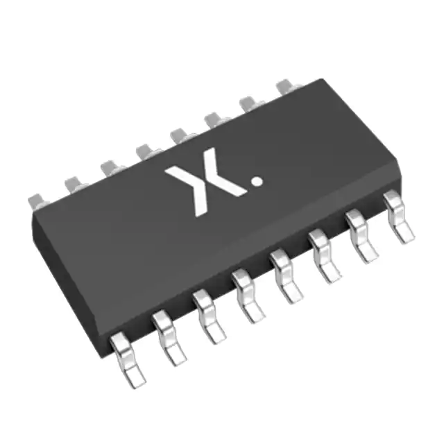

74HC595; 74HCT595 8-bit serial-in, serial or parallel-out shift register with output latches; 3-state Rev. 9 — 28 February 2017 1 Product data sheet General description The 74HC595; 74HCT595 is an 8-bit serial-in/serial or parallel-out shift register with a storage register and 3-state outputs. Both the shift and storage register have separate clocks. The device features a serial input (DS) and a serial output (Q7S) to enable cascading and an asynchronous reset MR input. A LOW on MR will reset the shift register. Data is shifted on the LOW-to-HIGH transitions of the SHCP input. The data in the shift register is transferred to the storage register on a LOW-to-HIGH transition of the STCP input. If both clocks are connected together, the shift register will always be one clock pulse ahead of the storage register. Data in the storage register appears at the output whenever the output enable input (OE) is LOW. A HIGH on OE causes the outputs to assume a high-impedance OFF-state. Operation of the OE input does not affect the state of the registers. Inputs include clamp diodes. This enables the use of current limiting resistors to interface inputs to voltages in excess of VCC. 2 Features and benefits • • • • • • • 8-bit serial input 8-bit serial or parallel output Storage register with 3-state outputs Shift register with direct clear 100 MHz (typical) shift out frequency Complies with JEDEC standard no. 7A Input levels: – For 74HC595: CMOS level – For 74HCT595: TTL level • ESD protection: – HBM JESD22-A114F exceeds 2000 V – MM JESD22-A115-A exceeds 200 V • Multiple package options • Specified from -40 °C to +85 °C and from -40 °C to +125 °C 3 Applications • Serial-to-parallel data conversion • Remote control holding register 74HC595; 74HCT595 Nexperia 8-bit serial-in, serial or parallel-out shift register with output latches; 3-state 4 Ordering information Table 1. Ordering information Type number Package 74HC595D Temperature range Name Description Version -40 °C to +125 °C SO16 plastic small outline package; 16 leads; body width 3.9 mm SOT109-1 -40 °C to +125 °C SSOP16 plastic shrink small outline package; 16 leads; body width 5.3 mm SOT338-1 -40 °C to +125 °C TSSOP16 plastic thin shrink small outline package; 16 leads; body width 4.4 mm SOT403-1 -40 °C to +125 °C DHVQFN16 plastic dual in-line compatible thermal enhanced SOT763-1 very thin quad flat package; no leads; 16 terminals; body 2.5 × 3.5 × 0.85 mm 74HCT595D 74HC595DB 74HCT595DB 74HC595PW 74HCT595PW 74HC595BQ 74HCT595BQ 5 Functional diagram 14 DS 11 SHCP 10 MR 8-STAGE SHIFT REGISTER Q7S 12 STCP 13 OE 9 8-BIT STORAGE REGISTER 3-STATE OUTPUTS Q0 Q1 Q2 Q3 Q4 Q5 Q6 Q7 15 1 2 3 4 5 6 7 mna554 Figure 1. Functional diagram 74HC_HCT595 Product data sheet All information provided in this document is subject to legal disclaimers. Rev. 9 — 28 February 2017 © Nexperia B.V. 2017. All rights reserved. 2 / 22 74HC595; 74HCT595 Nexperia 8-bit serial-in, serial or parallel-out shift register with output latches; 3-state 13 11 12 15 Q0 1D 2D 3 4 5 5 6 Q6 6 7 Q7 7 OE 10 1 3 4 Q5 15 2 3 Q3 Q4 9 13 mna553 mna552 Figure 2. Logic symbol Figure 3. IEC logic symbol STAGE 0 DS C1/ 2 Q2 MR 14 1 Q1 SRG8 R 11 9 Q7S DS C2 10 SHCP STCP 14 EN3 12 D STAGES 1 TO 6 Q D STAGE 7 Q D FF7 FF0 CP Q7S Q CP R R SHCP MR D Q D Q LATCH LATCH CP CP STCP OE Q0 Q1 Q2 Q3 Q4 Q5 Q6 Q7 mna555 Figure 4. Logic diagram 74HC_HCT595 Product data sheet All information provided in this document is subject to legal disclaimers. Rev. 9 — 28 February 2017 © Nexperia B.V. 2017. All rights reserved. 3 / 22 74HC595; 74HCT595 Nexperia 8-bit serial-in, serial or parallel-out shift register with output latches; 3-state 6 Pinning information 6.1 Pinning 1 Q1 terminal 1 index area 2 Q3 3 14 DS Q4 4 13 OE Q5 5 12 STCP Q6 6 11 SHCP Q7 7 10 MR GND 8 9 Q7S 001aao242 Figure 5. Pin configuration for SO16, SSOP16 and TSSOP16 14 DS Q4 4 13 OE Q5 5 12 STCP Q6 6 Q7 7 GND(1) 11 SHCP 10 MR 9 Q2 16 VCC 15 Q0 15 Q0 3 8 1 2 Q3 Q7S Q1 Q2 GND 74HC595 74HCT595 16 VCC 74HC595 74HCT595 001aao243 Transparent top view (1) This is not a supply pin. The substrate is attached to this pad using conductive die attach material. There is no electrical or mechanical requirement to solder this pad. However, if it is soldered, the solder land should remain floating or be connected to GND. Figure 6. Pin configuration for DHVQFN16 6.2 Pin description Table 2. Pin description Symbol Pin Description Q0, Q1, Q2, Q3, Q4, Q5, Q6, Q7 15, 1, 2, 3, 4, 5, 6, 7 parallel data output GND 8 ground (0 V) Q7S 9 serial data output MR 10 master reset (active LOW) SHCP 11 shift register clock input STCP 12 storage register clock input OE 13 output enable input (active LOW) DS 14 serial data input Q0 15 parallel data output 0 VCC 16 supply voltage 74HC_HCT595 Product data sheet All information provided in this document is subject to legal disclaimers. Rev. 9 — 28 February 2017 © Nexperia B.V. 2017. All rights reserved. 4 / 22 74HC595; 74HCT595 Nexperia 8-bit serial-in, serial or parallel-out shift register with output latches; 3-state 7 Functional description Table 3. Function table [1] Input Output Control Function SHCP STCP OE MR DS Q7S Qn X X L L X L NC a LOW-level on MR only affects the shift registers X ↑ L L X L L empty shift register loaded into storage register X X H L X L Z shift register clear; parallel outputs in high-impedance OFF-state ↑ X L H H Q6S NC logic HIGH-level shifted into shift register stage 0. Contents of all shift register stages shifted through, e.g. previous state of stage 6 (internal Q6S) appears on the serial output (Q7S). X ↑ L H X NC QnS contents of shift register stages (internal QnS) are transferred to the storage register and parallel output stages ↑ ↑ L H X Q6S QnS contents of shift register shifted through; previous contents of the shift register is transferred to the storage register and the parallel output stages [1] H = HIGH voltage state; L = LOW voltage state; ↑ = LOW-to-HIGH transition; X = don’t care; NC = no change; Z = high-impedance OFF-state. SHCP DS STCP MR OE Z-state Q0 Z-state Q1 Z-state Q6 Z-state Q7 Q7S mna556 Figure 7. Timing diagram 74HC_HCT595 Product data sheet All information provided in this document is subject to legal disclaimers. Rev. 9 — 28 February 2017 © Nexperia B.V. 2017. All rights reserved. 5 / 22 74HC595; 74HCT595 Nexperia 8-bit serial-in, serial or parallel-out shift register with output latches; 3-state 8 Limiting values Table 4. Limiting values In accordance with the Absolute Maximum Rating System (IEC 60134). Voltages are referenced to GND (ground = 0 V). Symbol Parameter Conditions Min Max Unit -0.5 +7 V VCC supply voltage IIK input clamping current VI < -0.5 V or VI > VCC + 0.5 V - ±20 mA IOK output clamping current VO < -0.5 V or VO > VCC + 0.5 V - ±20 mA IO output current VO = -0.5 V to (VCC + 0.5 V) pin Q7S - ±25 mA pins Qn - ±35 mA ICC supply current - 70 mA IGND ground current -70 - mA Tstg storage temperature Ptot [1] [2] [3] total power dissipation -65 +150 °C SO16 package [1] - 500 mW SSOP16 package [2] - 500 mW TSSOP16 package [2] - 500 mW DHVQFN16 package [3] - 500 mW For SO16 package: Ptot derates linearly with 8 mW/K above 70 °C. For SSOP16 and TSSOP16 packages: Ptot derates linearly with 5.5 mW/K above 60 °C. For DHVQFN16 package: Ptot derates linearly with 4.5 mW/K above 60 °C. 9 Recommended operating conditions Table 5. Recommended operating conditions Symbol Parameter Conditions 74HC595 74HCT595 Unit Min Typ Max Min Typ Max 2.0 5.0 6.0 4.5 5.0 5.5 V VCC supply voltage VI input voltage 0 - VCC 0 - VCC V VO output voltage 0 - VCC 0 - VCC V Δt/ΔV input transition rise and fall rate VCC = 2.0 V - - 625 - - - ns/V VCC = 4.5 V - 1.67 139 - 1.67 139 ns/V VCC = 6.0 V - - 83 - - - ns/V -40 +25 +125 -40 +25 +125 Tamb ambient temperature 74HC_HCT595 Product data sheet All information provided in this document is subject to legal disclaimers. Rev. 9 — 28 February 2017 °C © Nexperia B.V. 2017. All rights reserved. 6 / 22 74HC595; 74HCT595 Nexperia 8-bit serial-in, serial or parallel-out shift register with output latches; 3-state 10 Static characteristics Table 6. Static characteristics At recommended operating conditions; voltages are referenced to GND (ground = 0 V). Symbol Parameter Conditions -40 °C to +85 °C -40 °C to +125 °C Unit Min Typ Max Min Max VCC = 2.0 V 1.5 1.2 - 1.5 - V VCC = 4.5 V 3.15 2.4 - 3.15 - V VCC = 6.0 V 4.2 3.2 - 4.2 - V VCC = 2.0 V - 0.8 0.5 - 0.5 V VCC = 4.5 V - 2.1 1.35 - 1.35 V VCC = 6.0 V - 2.8 1.8 - 1.8 V IO = -20 μA; VCC = 2.0 V 1.9 2.0 - 1.9 - V IO = -20 μA; VCC = 4.5 V 4.4 4.5 - 4.4 - V IO = -20 μA; VCC = 6.0 V 5.9 6.0 - 5.9 - V IO = -4 mA; VCC = 4.5 V 3.84 4.32 - 3.7 - V IO = -5.2 mA; VCC = 6.0 V 5.34 5.81 - 5.2 - V IO = -6 mA; VCC = 4.5 V 3.84 4.32 - 3.7 - V IO = -7.8 mA; VCC = 6.0 V 5.34 5.81 - 5.2 - V IO = 20 μA; VCC = 2.0 V - 0 0.1 - 0.1 V IO = 20 μA; VCC = 4.5 V - 0 0.1 - 0.1 V IO = 20 μA; VCC = 6.0 V - 0 0.1 - 0.1 V IO = 4 mA; VCC = 4.5 V - 0.15 0.33 - 0.4 V IO = 5.2 mA; VCC = 6.0 V - 0.16 0.33 - 0.4 V IO = 6 mA; VCC = 4.5 V - 0.15 0.33 - 0.4 V IO = 7.8 mA; VCC = 6.0 V - 0.16 0.33 - 0.4 V 74HC595 VIH VIL VOH HIGH-level input voltage LOW-level input voltage VI = VIH or VIL HIGH-level output voltage all outputs Q7S output Qn bus driver outputs VOL VI = VIH or VIL LOW-level output voltage all outputs Q7S output Qn bus driver outputs II input leakage current VI = VCC or GND; VCC = 6.0 V - - ±1.0 - ±1.0 μA IOZ OFF-state output current VI = VIH or VIL; VCC = 6.0 V; VO = VCC or GND - - ±5.0 - ±10 μA 74HC_HCT595 Product data sheet All information provided in this document is subject to legal disclaimers. Rev. 9 — 28 February 2017 © Nexperia B.V. 2017. All rights reserved. 7 / 22 74HC595; 74HCT595 Nexperia 8-bit serial-in, serial or parallel-out shift register with output latches; 3-state Symbol Parameter Conditions -40 °C to +85 °C -40 °C to +125 °C Min Typ Max Min Max Unit ICC supply current VI = VCC or GND; IO = 0 A; VCC = 6.0 V - - 80 - 160 μA CI input capacitance - 3.5 - - - pF 74HCT595 VIH HIGH-level input voltage VCC = 4.5 V to 5.5 V 2.0 1.6 - 2.0 - V VIL LOW-level input voltage VCC = 4.5 V to 5.5 V - 1.2 0.8 - 0.8 V VOH VI = VIH or VIL; VCC = 4.5 V HIGH-level output voltage all outputs 4.4 4.5 - 4.4 - V 3.84 4.32 - 3.7 - V 3.7 4.32 - 3.7 - V - 0 0.1 - 0.1 V - 0.15 0.33 - 0.4 V - 0.16 0.33 - 0.4 V IO = -20 μA Q7S output IO = -4 mA Qn bus driver outputs IO = -6 mA VOL VI = VIH or VIL; VCC = 4.5 V LOW-level output voltage all outputs IO = 20 μA Q7S output IO = 4.0 mA Qn bus driver outputs IO = 6.0 mA II input leakage current VI = VCC or GND; VCC = 5.5 V - - ±1.0 - ±1.0 μA IOZ OFF-state output current VI = VIH or VIL; VCC = 5.5 V; VO = VCC or GND - - ±5.0 - ±10 μA ICC supply current VI = VCC or GND; IO = 0 A; VCC = 5.5 V - - 80 - 160 μA ΔICC per input pin; additional supply current other inputs at VCC or GND; IO = 0 A; VI = VCC - 2.1 V; VCC = 4.5 V to 5.5 V pins MR, SHCP, STCP, OE - 150 675 - 735 μA pin DS - 25 113 - 123 μA - 3.5 - - - pF CI input capacitance 74HC_HCT595 Product data sheet All information provided in this document is subject to legal disclaimers. Rev. 9 — 28 February 2017 © Nexperia B.V. 2017. All rights reserved. 8 / 22 74HC595; 74HCT595 Nexperia 8-bit serial-in, serial or parallel-out shift register with output latches; 3-state 11 Dynamic characteristics Table 7. Dynamic characteristics Voltages are referenced to GND (ground = 0 V); for test circuit see Figure 13. Symbol Parameter Conditions 25 °C Min Typ [1] -40 °C to +85 °C -40 °C to +125 °C Max Min Max Min Max Unit 74HC595 tpd propagation SHCP to Q7S; see Figure 8 delay VCC = 2 V [2] - 52 160 - 200 - 240 ns - 19 32 - 40 - 48 ns - 15 27 - 34 - 41 ns VCC = 2 V - 55 175 - 220 - 265 ns VCC = 4.5 V - 20 35 - 44 - 53 ns VCC = 6 V - 16 30 - 37 - 45 ns - 47 175 - 220 - 265 ns - 17 35 - 44 - 53 ns - 14 30 - 37 - 45 ns VCC = 2 V - 47 150 - 190 - 225 ns VCC = 4.5 V - 17 30 - 38 - 45 ns - 14 26 - 33 - 38 ns VCC = 2 V - 41 150 - 190 - 225 ns VCC = 4.5 V - 15 30 - 38 - 45 ns VCC = 6 V - 12 27 - 33 - 38 ns VCC = 2 V 75 17 - 95 - 110 - ns VCC = 4.5 V 15 6 - 19 - 22 - ns VCC = 6 V 13 5 - 16 - 19 - ns VCC = 2 V 75 11 - 95 - 110 - ns VCC = 4.5 V 15 4 - 19 - 22 - ns VCC = 6 V 13 3 - 16 - 19 - ns VCC = 4.5 V VCC = 6 V STCP to Qn; see Figure 9 tPHL [2] MR to Q7S; see Figure 11 HIGH to LOW VCC = 2 V propagation delay VCC = 4.5 V VCC = 6 V ten enable time OE to Qn; see Figure 12 [3] VCC = 6 V tdis tW disable time OE to Qn; see Figure 12 pulse width [4] SHCP HIGH or LOW; see Figure 8 STCP HIGH or LOW; see Figure 9 MR LOW; see Figure 11 74HC_HCT595 Product data sheet All information provided in this document is subject to legal disclaimers. Rev. 9 — 28 February 2017 © Nexperia B.V. 2017. All rights reserved. 9 / 22 74HC595; 74HCT595 Nexperia 8-bit serial-in, serial or parallel-out shift register with output latches; 3-state Symbol Parameter Conditions 25 °C Min tsu set-up time Typ [1] -40 °C to +85 °C -40 °C to +125 °C Max Min Max Min Max Unit VCC = 2 V 75 17 - 95 - 110 - ns VCC = 4.5 V 15 6 - 19 - 22 - ns VCC = 6 V 13 5 - 16 - 19 - ns VCC = 2 V 50 11 - 65 - 75 - ns VCC = 4.5 V 10 4 - 13 - 15 - ns VCC = 6 V 9 3 - 11 - 13 - ns VCC = 2 V 75 22 - 95 - 110 - ns VCC = 4.5 V 15 8 - 19 - 22 - ns VCC = 6 V 13 7 - 16 - 19 - ns VCC = 2 V 3 -6 - 3 - 3 - ns VCC = 4.5 V 3 -2 - 3 - 3 - ns VCC = 6 V 3 -2 - 3 - 3 - ns VCC = 2 V 50 -19 - 65 - 75 - ns VCC = 4.5 V 10 -7 - 13 - 15 - ns VCC = 6 V 9 -6 - 11 - 13 - ns VCC = 2 V 9 30 - 4.8 - 4 - MHz VCC = 4.5 V 30 91 - 24 - 20 - MHz DS to SHCP; see Figure 10 SHCP to STCP; see Figure 10 th trec fmax hold time recovery time maximum frequency DS to SHCP; see Figure 10 MR to SHCP; see Figure 11 SHCP or STCP; see Figure 8 and Figure 9 VCC = 6 V CPD power fi = 1 MHz; VI = GND to VCC dissipation capacitance 35 108 - 28 - 24 - MHz [5] [6] - 115 - - - - - pF [2] - 25 42 - 53 - 63 ns [2] - 24 40 - 50 - 60 ns - 23 40 - 50 - 60 ns 74HCT595; VCC = 4.5 V to 5.5 V tpd propagation SHCP to Q7S; see Figure 8 delay STCP to Qn; see Figure 9 tPHL HIGH MR to Q7S; see Figure 11 to LOW propagation delay ten enable time OE to Qn; see Figure 12 [3] - 21 35 - 44 - 53 ns disable time OE to Qn; see Figure 12 [4] - 18 30 - 38 - 45 ns tdis 74HC_HCT595 Product data sheet All information provided in this document is subject to legal disclaimers. Rev. 9 — 28 February 2017 © Nexperia B.V. 2017. All rights reserved. 10 / 22 74HC595; 74HCT595 Nexperia 8-bit serial-in, serial or parallel-out shift register with output latches; 3-state Symbol Parameter Conditions 25 °C Min tW pulse width tsu set-up time Typ [1] -40 °C to +85 °C -40 °C to +125 °C Max Min Max Min Max Unit SHCP HIGH or LOW; see Figure 8 16 6 - 20 - 24 - ns STCP HIGH or LOW; see Figure 9 16 5 - 20 - 24 - ns MR LOW; see Figure 11 20 8 - 25 - 30 - ns DS to SHCP; see Figure 9 16 5 - 20 - 24 - ns SHCP to STCP; see Figure 9 16 8 - 20 - 24 - ns th hold time DS to SHCP; see Figure 10 3 -2 - 3 - 3 - ns trec recovery time MR to SHCP; see Figure 11 10 -7 - 13 - 15 - ns fmax maximum frequency SHCP and STCP; see Figure 8 and Figure 9 30 52 - 24 - 20 - MHz CPD power fi = 1 MHz; dissipation VI = GND to VCC - 1.5 V capacitance - 130 - - - - - pF [1] [2] [3] [4] [5] [6] [5] [6] Typical values are measured at nominal supply voltage. tpd is the same as tPHL and tPLH. ten is the same as tPZL and tPZH. tdis is the same as tPLZ and tPHZ. CPD is used to determine the dynamic power dissipation (PD in μW). 2 2 PD = CPD × VCC × fi + Σ(CL × VCC × fo) where: fi = input frequency in MHz; fo = output frequency in MHz; 2 Σ(CL × VCC × fo) = sum of outputs; CL = output load capacitance in pF; VCC = supply voltage in V. All 9 outputs switching. 11.1 Waveforms and test circuit 1/fmax VI SHCP input VM GND tW t PHL t PLH VOH VM Q7S output VOL mna557 Measurement points are given in Table 8. VOL and VOH are typical output voltage levels that occur with the output load. Figure 8. Shift clock pulse, maximum frequency and input to output propagation delays 74HC_HCT595 Product data sheet All information provided in this document is subject to legal disclaimers. Rev. 9 — 28 February 2017 © Nexperia B.V. 2017. All rights reserved. 11 / 22 74HC595; 74HCT595 Nexperia 8-bit serial-in, serial or parallel-out shift register with output latches; 3-state VI SHCP input VM GND 1/fmax t su VI STCP input VM GND tW t PHL t PLH VOH VM Qn output VOL mna558 Measurement points are given in Table 8. VOL and VOH are typical output voltage levels that occur with the output load. Figure 9. Storage clock to output propagation delays VI VM SHCP input GND t su t su th th VI VM DS input GND VOH VM Q7S output VOL mna560 Measurement points are given in Table 8. The shaded areas indicate when the input is permitted to change for predictable output performance. VOL and VOH are typical output voltage levels that occur with the output load. Figure 10. Data set-up and hold times 74HC_HCT595 Product data sheet All information provided in this document is subject to legal disclaimers. Rev. 9 — 28 February 2017 © Nexperia B.V. 2017. All rights reserved. 12 / 22 74HC595; 74HCT595 Nexperia 8-bit serial-in, serial or parallel-out shift register with output latches; 3-state VI VM MR input GND tW t rec VI SHCP input VM GND t PHL VOH VM Q7S output VOL mna561 Measurement points are given in Table 8. VOL and VOH are typical output voltage levels that occur with the output load. Figure 11. Master reset to output propagation delays tr tf 90 % VM OE input 10 % tPLZ tPZL Qn output VM LOW-to-OFF OFF-to-LOW 10 % tPHZ tPZH 90 % Qn output VM HIGH-to-OFF OFF-to-HIGH outputs enabled outputs enabled outputs disabled msa697 Measurement points are given in Table 8. VOL and VOH are typical output voltage levels that occur with the output load. Figure 12. Enable and disable times Table 8. Measurement points Input Output VM VM 74HC595 0.5VCC 0.5VCC 74HCT595 1.3 V 1.3 V Type 74HC_HCT595 Product data sheet All information provided in this document is subject to legal disclaimers. Rev. 9 — 28 February 2017 © Nexperia B.V. 2017. All rights reserved. 13 / 22 74HC595; 74HCT595 Nexperia 8-bit serial-in, serial or parallel-out shift register with output latches; 3-state VI negative pulse tW 90 % VM VM 10 % 0V tf tr VI positive pulse 0V tr tf 90 % VM VM 10 % tW VCC G VI VCC VO DUT RT RL S1 open CL 001aad983 Test data is given in Table 9. Definitions for test circuit: CL = load capacitance including jig and probe capacitance. RL = load resistance. RT = termination resistance should be equal to the output impedance Zo of the pulse generator. S1 = test selection switch. Figure 13. Test circuit for measuring switching times Table 9. Test data Type Input Load S1 position VI tr, tf CL RL tPHL, tPLH tPZH, tPHZ tPZL, tPLZ 74HC595 VCC 6 ns 50 pF 1 kΩ open GND VCC 74HCT595 3V 6 ns 50 pF 1 kΩ open GND VCC 74HC_HCT595 Product data sheet All information provided in this document is subject to legal disclaimers. Rev. 9 — 28 February 2017 © Nexperia B.V. 2017. All rights reserved. 14 / 22 74HC595; 74HCT595 Nexperia 8-bit serial-in, serial or parallel-out shift register with output latches; 3-state 12 Package outline SO16: plastic small outline package; 16 leads; body width 3.9 mm SOT109-1 D E A X c y HE v M A Z 16 9 Q A2 A (A 3) A1 pin 1 index θ Lp 1 L 8 e w M bp 0 2.5 detail X 5 mm scale DIMENSIONS (inch dimensions are derived from the original mm dimensions) UNIT A max. A1 A2 A3 bp c D (1) E (1) e HE L Lp Q v w y Z (1) mm 1.75 0.25 0.10 1.45 1.25 0.25 0.49 0.36 0.25 0.19 10.0 9.8 4.0 3.8 1.27 6.2 5.8 1.05 1.0 0.4 0.7 0.6 0.25 0.25 0.1 0.7 0.3 inches 0.069 0.010 0.057 0.004 0.049 0.01 0.019 0.0100 0.39 0.014 0.0075 0.38 0.16 0.15 0.05 0.039 0.016 0.028 0.020 0.01 0.01 0.004 0.028 0.012 0.244 0.041 0.228 θ o 8 o 0 Note 1. Plastic or metal protrusions of 0.15 mm (0.006 inch) maximum per side are not included. REFERENCES OUTLINE VERSION IEC JEDEC SOT109-1 076E07 MS-012 JEITA EUROPEAN PROJECTION ISSUE DATE 99-12-27 03-02-19 Figure 14. Package outline SOT109-1 (SO16) 74HC_HCT595 Product data sheet All information provided in this document is subject to legal disclaimers. Rev. 9 — 28 February 2017 © Nexperia B.V. 2017. All rights reserved. 15 / 22 74HC595; 74HCT595 Nexperia 8-bit serial-in, serial or parallel-out shift register with output latches; 3-state SSOP16: plastic shrink small outline package; 16 leads; body width 5.3 mm D SOT338-1 E A X c y HE v M A Z 9 16 Q A2 A (A 3) A1 pin 1 index θ Lp L 8 1 detail X w M bp e 0 2.5 5 mm scale DIMENSIONS (mm are the original dimensions) UNIT A max. A1 A2 A3 bp c D (1) E (1) e HE L Lp Q v w y Z (1) θ mm 2 0.21 0.05 1.80 1.65 0.25 0.38 0.25 0.20 0.09 6.4 6.0 5.4 5.2 0.65 7.9 7.6 1.25 1.03 0.63 0.9 0.7 0.2 0.13 0.1 1.00 0.55 8o 0o Note 1. Plastic or metal protrusions of 0.25 mm maximum per side are not included. OUTLINE VERSION SOT338-1 REFERENCES IEC JEDEC JEITA EUROPEAN PROJECTION ISSUE DATE 99-12-27 03-02-19 MO-150 Figure 15. Package outline SOT338-1 (SSOP16) 74HC_HCT595 Product data sheet All information provided in this document is subject to legal disclaimers. Rev. 9 — 28 February 2017 © Nexperia B.V. 2017. All rights reserved. 16 / 22 74HC595; 74HCT595 Nexperia 8-bit serial-in, serial or parallel-out shift register with output latches; 3-state TSSOP16: plastic thin shrink small outline package; 16 leads; body width 4.4 mm D SOT403-1 E A X c y HE v M A Z 9 16 Q A2 pin 1 index (A 3 ) A1 A θ Lp 1 L 8 detail X w M bp e 0 2.5 5 mm scale DIMENSIONS (mm are the original dimensions) UNIT A max. A1 A2 A3 bp c D (1) E (2) e HE L Lp Q v w y Z (1) θ mm 1.1 0.15 0.05 0.95 0.80 0.25 0.30 0.19 0.2 0.1 5.1 4.9 4.5 4.3 0.65 6.6 6.2 1 0.75 0.50 0.4 0.3 0.2 0.13 0.1 0.40 0.06 8o 0o Notes 1. Plastic or metal protrusions of 0.15 mm maximum per side are not included. 2. Plastic interlead protrusions of 0.25 mm maximum per side are not included. OUTLINE VERSION SOT403-1 REFERENCES IEC JEDEC JEITA EUROPEAN PROJECTION ISSUE DATE 99-12-27 03-02-18 MO-153 Figure 16. Package outline SOT403-1 (TSSOP16) 74HC_HCT595 Product data sheet All information provided in this document is subject to legal disclaimers. Rev. 9 — 28 February 2017 © Nexperia B.V. 2017. All rights reserved. 17 / 22 74HC595; 74HCT595 Nexperia 8-bit serial-in, serial or parallel-out shift register with output latches; 3-state DHVQFN16: plastic dual in-line compatible thermal enhanced very thin quad flat package; no leads; SOT763-1 16 terminals; body 2.5 x 3.5 x 0.85 mm B D A A E A1 c detail X terminal 1 index area terminal 1 index area C e1 e b 2 y y1 C v M C A B w M C 7 L 1 8 Eh e 16 9 15 10 Dh X 0 2.5 5 mm scale DIMENSIONS (mm are the original dimensions) UNIT A(1) max. A1 b c D (1) Dh E (1) Eh e e1 L v w y y1 mm 1 0.05 0.00 0.30 0.18 0.2 3.6 3.4 2.15 1.85 2.6 2.4 1.15 0.85 0.5 2.5 0.5 0.3 0.1 0.05 0.05 0.1 Note 1. Plastic or metal protrusions of 0.075 mm maximum per side are not included. REFERENCES OUTLINE VERSION IEC JEDEC JEITA SOT763-1 --- MO-241 --- EUROPEAN PROJECTION ISSUE DATE 02-10-17 03-01-27 Figure 17. Package outline SOT763-1 (DHVQFN16) 74HC_HCT595 Product data sheet All information provided in this document is subject to legal disclaimers. Rev. 9 — 28 February 2017 © Nexperia B.V. 2017. All rights reserved. 18 / 22 74HC595; 74HCT595 Nexperia 8-bit serial-in, serial or parallel-out shift register with output latches; 3-state 13 Abbreviations Table 10. Abbreviations Acronym Description CMOS Complementary Metal-Oxide Semiconductor DUT Device Under Test ESD ElectroStatic Discharge HBM Human Body Model MM Machine Model TTL Transistor-Transistor Logic 14 Revision history Table 11. Revision history Document ID Release date Data sheet status Change notice Supersedes 74HC_HCT595 v.9 20170228 Product data sheet - Modifications: • The format of this data sheet has been redesigned to comply with the identity guidelines of Nexperia. • Legal texts have been adapted to the new company name where appropriate. 74HC_HCT595 v.8 20160225 Modifications: • Type numbers 74HC595N and 74HCT595N (SOT38-4) removed. 74HC_HCT595 v.7 20150126 Modifications: • Table 7: Power dissipation capacitance condition for 74HCT595 is corrected. 74HC_HCT595 v.6 20111212 Modifications: • Legal pages updated. 74HC_HCT595 v.5 20110628 74HC_HCT595 v.4 74HC_HCT595_CNV v.3 74HC_HCT595 Product data sheet Product data sheet Product data sheet Product data sheet - 74HC_HCT595 v.8 74HC_HCT595 v.7 74HC_HCT595 v.6 - 74HC_HCT595 v.5 Product data sheet - 74HC_HCT595 v.4 20030604 Product specification - 74HC_HCT595_CNV v.3 19980604 Product specification - - All information provided in this document is subject to legal disclaimers. Rev. 9 — 28 February 2017 © Nexperia B.V. 2017. All rights reserved. 19 / 22 74HC595; 74HCT595 Nexperia 8-bit serial-in, serial or parallel-out shift register with output latches; 3-state 15 Legal information 15.1 Data sheet status Document status [1][2] Product status [3] Definition Objective [short] data sheet Development This document contains data from the objective specification for product development. Preliminary [short] data sheet Qualification This document contains data from the preliminary specification. Product [short] data sheet Production This document contains the product specification. [1] [2] [3] Please consult the most recently issued document before initiating or completing a design. The term 'short data sheet' is explained in section "Definitions". The product status of device(s) described in this document may have changed since this document was published and may differ in case of multiple devices. The latest product status information is available on the Internet at URL http://www.nexperia.com. 15.2 Definitions Draft — The document is a draft version only. The content is still under internal review and subject to formal approval, which may result in modifications or additions. Nexperia does not give any representations or warranties as to the accuracy or completeness of information included herein and shall have no liability for the consequences of use of such information. Short data sheet — A short data sheet is an extract from a full data sheet with the same product type number(s) and title. A short data sheet is intended for quick reference only and should not be relied upon to contain detailed and full information. For detailed and full information see the relevant full data sheet, which is available on request via the local Nexperia sales office. In case of any inconsistency or conflict with the short data sheet, the full data sheet shall prevail. Product specification — The information and data provided in a Product data sheet shall define the specification of the product as agreed between Nexperia and its customer, unless Nexperia and customer have explicitly agreed otherwise in writing. In no event however, shall an agreement be valid in which the Nexperia product is deemed to offer functions and qualities beyond those described in the Product data sheet. 15.3 Disclaimers Limited warranty and liability — Information in this document is believed to be accurate and reliable. However, Nexperia does not give any representations or warranties, expressed or implied, as to the accuracy or completeness of such information and shall have no liability for the consequences of use of such information. Nexperia takes no responsibility for the content in this document if provided by an information source outside of Nexperia. In no event shall Nexperia be liable for any indirect, incidental, punitive, special or consequential damages (including - without limitation lost profits, lost savings, business interruption, costs related to the removal or replacement of any products or rework charges) whether or not such damages are based on tort (including negligence), warranty, breach of contract or any other legal theory. Notwithstanding any damages that customer might incur for any reason whatsoever, Nexperia's aggregate and cumulative liability towards customer for the products described herein shall be limited in accordance with the Terms and conditions of commercial sale of Nexperia. Right to make changes — Nexperia reserves the right to make changes to information published in this document, including without limitation specifications and product descriptions, at any time and without notice. This document supersedes and replaces all information supplied prior to the publication hereof. Suitability for use — Nexperia products are not designed, authorized or warranted to be suitable for use in life support, life-critical or safety-critical 74HC_HCT595 Product data sheet systems or equipment, nor in applications where failure or malfunction of an Nexperia product can reasonably be expected to result in personal injury, death or severe property or environmental damage. Nexperia and its suppliers accept no liability for inclusion and/or use of Nexperia products in such equipment or applications and therefore such inclusion and/or use is at the customer’s own risk. Applications — Applications that are described herein for any of these products are for illustrative purposes only. Nexperia makes no representation or warranty that such applications will be suitable for the specified use without further testing or modification. Customers are responsible for the design and operation of their applications and products using Nexperia products, and Nexperia accepts no liability for any assistance with applications or customer product design. It is customer’s sole responsibility to determine whether the Nexperia product is suitable and fit for the customer’s applications and products planned, as well as for the planned application and use of customer’s third party customer(s). Customers should provide appropriate design and operating safeguards to minimize the risks associated with their applications and products. Nexperia does not accept any liability related to any default, damage, costs or problem which is based on any weakness or default in the customer’s applications or products, or the application or use by customer’s third party customer(s). Customer is responsible for doing all necessary testing for the customer’s applications and products using Nexperia products in order to avoid a default of the applications and the products or of the application or use by customer’s third party customer(s). Nexperia does not accept any liability in this respect. Limiting values — Stress above one or more limiting values (as defined in the Absolute Maximum Ratings System of IEC 60134) will cause permanent damage to the device. Limiting values are stress ratings only and (proper) operation of the device at these or any other conditions above those given in the Recommended operating conditions section (if present) or the Characteristics sections of this document is not warranted. Constant or repeated exposure to limiting values will permanently and irreversibly affect the quality and reliability of the device. Terms and conditions of commercial sale — Nexperia products are sold subject to the general terms and conditions of commercial sale, as published at http://www.nexperia.com/profile/terms, unless otherwise agreed in a valid written individual agreement. In case an individual agreement is concluded only the terms and conditions of the respective agreement shall apply. Nexperia hereby expressly objects to applying the customer’s general terms and conditions with regard to the purchase of Nexperia products by customer. No offer to sell or license — Nothing in this document may be interpreted or construed as an offer to sell products that is open for acceptance or the grant, conveyance or implication of any license under any copyrights, patents or other industrial or intellectual property rights. Export control — This document as well as the item(s) described herein may be subject to export control regulations. Export might require a prior authorization from competent authorities. All information provided in this document is subject to legal disclaimers. Rev. 9 — 28 February 2017 © Nexperia B.V. 2017. All rights reserved. 20 / 22 74HC595; 74HCT595 Nexperia 8-bit serial-in, serial or parallel-out shift register with output latches; 3-state Non-automotive qualified products — Unless this data sheet expressly states that this specific Nexperia product is automotive qualified, the product is not suitable for automotive use. It is neither qualified nor tested in accordance with automotive testing or application requirements. Nexperia accepts no liability for inclusion and/or use of non-automotive qualified products in automotive equipment or applications. In the event that customer uses the product for design-in and use in automotive applications to automotive specifications and standards, customer (a) shall use the product without Nexperia's warranty of the product for such automotive applications, use and specifications, and (b) whenever customer uses the product for automotive applications beyond Nexperia's specifications such use shall be solely at customer’s own risk, and (c) customer fully indemnifies Nexperia for any liability, damages or failed product claims resulting from customer 74HC_HCT595 Product data sheet design and use of the product for automotive applications beyond Nexperia's standard warranty and Nexperia's product specifications. Translations — A non-English (translated) version of a document is for reference only. The English version shall prevail in case of any discrepancy between the translated and English versions. 15.4 Trademarks Notice: All referenced brands, product names, service names and trademarks are the property of their respective owners. All information provided in this document is subject to legal disclaimers. Rev. 9 — 28 February 2017 © Nexperia B.V. 2017. All rights reserved. 21 / 22 Nexperia 74HC595; 74HCT595 8-bit serial-in, serial or parallel-out shift register with output latches; 3-state Contents 1 2 3 4 5 6 6.1 6.2 7 8 9 10 11 11.1 12 13 14 15 General description ............................................ 1 Features and benefits .........................................1 Applications .........................................................1 Ordering information .......................................... 2 Functional diagram ............................................. 2 Pinning information ............................................ 4 Pinning ............................................................... 4 Pin description ................................................... 4 Functional description ........................................5 Limiting values .................................................... 6 Recommended operating conditions ................ 6 Static characteristics .......................................... 7 Dynamic characteristics .....................................9 Waveforms and test circuit .............................. 11 Package outline .................................................15 Abbreviations .................................................... 19 Revision history ................................................ 19 Legal information .............................................. 20 Please be aware that important notices concerning this document and the product(s) described herein, have been included in section 'Legal information'. © Nexperia B.V. 2017. All rights reserved. For more information, please visit: http://www.nexperia.com For sales office addresses, please send an email to: salesaddresses@nexperia.com Date of release: 28 February 2017 Document identifier: 74HC_HCT595 Mouser Electronics Authorized Distributor Click to View Pricing, Inventory, Delivery & Lifecycle Information: Nexperia: 74HC595BQ,115 74HC595D,112 74HC595DB,112 74HC595DB,118 74HC595D,118 74HC595N,112 74HC595PW,112 74HC595PW,118 74HCT595BQ,115 74HCT595D,112 74HCT595DB,112 74HCT595DB,118 74HCT595D,118 74HCT595N,112 74HCT595PW,112 74HCT595PW,118 74HC595PW/AUJ
