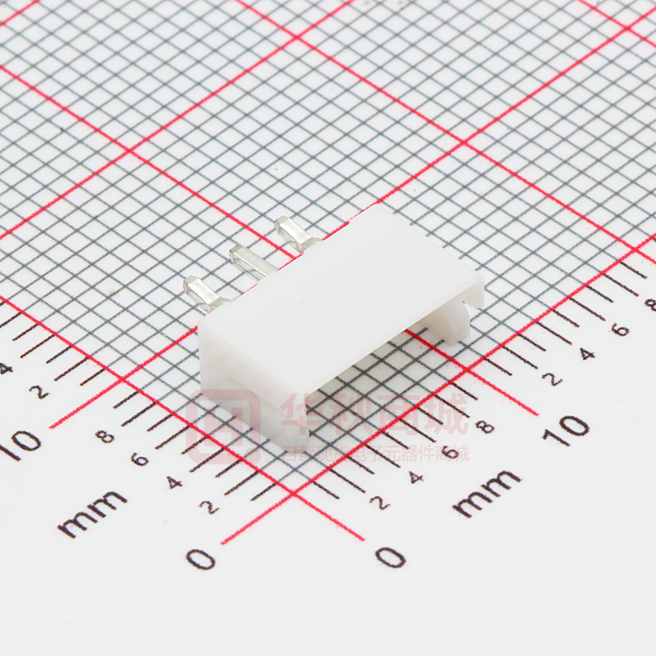

    线对板针座 1x3P 直插 间距:2.5mm
B3B-EH-A(LF)(SN) 数据手册
EH CONNECTOR Radial Tape 2.5 mm pitch/Disconnectable Crimp style connectors 3 4 EH CONNECTOR • Current rating: 3 A AC/DC (AWG #22) • Voltage rating: 250 V AC/DC • Temperature range: -25℃ to +85℃ (including temperature rise in applying electrical current) • Contact resistance: Initial value/ 10 mΩ max. After environmental tests/ 20 mΩ max. • Insulation resistance: 1,000 MΩ min. • Withstanding voltage: 800 VAC/minute エンボス • Applicable wire: AWG #32 to #22 • Applicable PC board thickness: 0.8 to 1.6 mm 5 This, the thinnest, 2.5 mm pitch connector, is 8.1 mm in height after mounting and 3.8 mm in width. It is designed to meet the demand for the high-density connection of internal wires to printed circuit boards. It is compact, highly reliable and low in cost. ● ● ● ● Compact and slim Highly reliable contact Polarizing guides Easy and effective crimping * In using the products,refer to "Handling Precautions for Terminals and Connectors" described on our website (Technical documents of Product information page). * RoHS2 compliance * Dimensional unit: mm * Contact JST for details. Standards  ® ® ® Radial-tape Side entry type 2.5 3.8 2.5 min. 2.2 min. (8.1) +0.1 φ0.9 0 2.5±0.05 2.5 min. 4.4 +0.1 φ0.9 0 (10.3) 4.2 2.5 min. +0.1 φ0.9 0 ±0.05 6.7 min. 2.5 ±0.05 ® ® PC board layout and Assembly layout Top entry type Recognized E60389 Certified LR20812 R50082349 6.5 (8.6) 2 2.2 min. H JST Specifications Note: 1  . The above figure is the figure viewed from soldering side. 2. Tolerances are non-cumulative: ± 0.05 mm for all centers. 3. Hole dimension differ according to the type of PC board and piercing method. If PC boards made of hard material are used, the hole dimensions should be larger. The dimensions above should serve as a guideline. Contact JST for details. Contact Model No. SEH-001T-P0.6 *SEH-001T-P0.6L *SEH-002T-P0.6L *SEH-003T-P0.6L 5.7 2.05 1.1 Insulation O.D. (mm) 0.05 ~0.33 30~22 1.0~1.9 0.13 ~0.33 26~22 0.9~1.9 0.05 ~0.13 30~26 0.9~1.3 0.032~0.08 32~28 0.5~1.1 Q'ty/ reel 9,000 10,000 Material and Finish 2 2.85 Applicable wire AWG # mm2 Phosphor bronze, tin-plated (reflow treatment) 1.6 RoHS2 compliance Note: 1. Contact JST for gold-plated products. 2. SEH-00( )T-P0.6L is low-insertion force type contact, for easier insertion/withdrawal, which would be less resistant to the vibration. The crimp height is different from the standard contact. 3. *Marked products are not TÜV approved. 4. Contact JST for details. Contact Crimping machine Crimp applicator SEH-001T-P0.6 SEH-001T-P0.6L SEH-002T-P0.6L SEH-003T-P0.6L AP-K2N MKS-L Applicator Dies Crimp applicator with dies MK/SEH-001-06 APLMK SEH001-06 MK/SEH-001-06L APLMK SEH001-06L MK/SEH-002-06L APLMK SEH002-06L MKS-L-10 MK/SEH-003-06L APLMK SEH003-06L Note: Contact JST for fully automatic crimping applicator. 1 EH EH CONNECTOR CONNECTOR Housing No. of circuits 2 3 B 4 5 A 0.6 (2.25)(2.5) 3 6 7 8 9 7 10 11 12 6.5 H JST 2 6 3.8 13 14 15 EHR-2 EHR-3 EHR-4 EHR-5 EHR-6 EHR-7 EHR-8 EHR-9 EHR-10 EHR-11 EHR-12 EHR-13 EHR-14 EHR-15 □0.7 Circuit No.1 エンボス エンボス Dimensions (mm) A B Model No. Q'ty/ bag 2.5 7.0 1,000 5.0 9.5 1,000 7.5 12.0 1,000 10.0 14.5 1,000 12.5 17.0 1,000 15.0 19.5 1,000 17.5 22.0 1,000 20.0 24.5 1,000 22.5 27.0 1,000 25.0 29.5 1,000 27.5 32.0 1,000 30.0 34.5 1,000 32.5 37.0 1,000 35.0 39.5 1,000 Material and Finish PA 66, UL94V-0, natural (white) RoHS2 compliance As the color identification, the following alphabet shall be put in the underlined part. For availability, delivery and minimum order quantity, contact JST. ex. EHR-2-oo(blank)...natural (white) K...black R...red TR...tomato red E...blue Y...yellow L...lemon yellow M...green O...orange N...brown PL...purple PK...pink H...gray LE...light blue FY...vivid yellow Shrouded header The shrouded headers are interchangeable with those of the HR crimp style and insulation displacement connectors. Top entry type (2 circuits) 3.3 3.8 3.2 6 B No. of circuits Circuit No.1 (2.5) A □0.64 3.8 5.1 3.3 (3 to 15 circuits) 2 B2B-EH-A 3 B3B-EH-A 4 2.5 B 7.5 1,000 1,000 S3B-EH 5.0 10.0 1,000 1,000 B4B-EH-A S4B-EH 7.5 12.5 1,000 1,000 5 B5B-EH-A S5B-EH 10.0 15.0 1,000 1,000 6 B6B-EH-A S6B-EH 12.5 17.5 1,000 500 7 B7B-EH-A S7B-EH 15.0 20.0 1,000 500 8 B8B-EH-A S8B-EH 17.5 22.5 500 500 9 B9B-EH-A S9B-EH 20.0 25.0 500 500 10 B10B-EH-A S10B-EH 22.5 27.5 500 500 11 B11B-EH-A S11B-EH 25.0 30.0 500 250 12 B12B-EH-A S12B-EH 27.5 32.5 500 250 13 B13B-EH-A S13B-EH 30.0 35.0 250 250 14 B14B-EH-A S14B-EH 32.5 37.5 250 250 15 B15B-EH-A S15B-EH 35.0 40.0 250 250 Material and Finish (1.6) A B Side entry type A Q'ty/box Top entry Side entry type type S2B-EH Post: Brass, copper-undercoated, tin-plated (reflow treatment) Wafer: PA 66, UL94V-0, natural (white) □0.64 Circuit No.1 (2.5) Dimensions (mm) 2.5 3.2 6 (1.6) Model No. Top entry Side entry type type RoHS2 compliance This product displays (LF)(SN) on a label. Note: Also available and identified as model BxxB-EH is a top entry type having a post extension length of 4.0 mm. As the color identification, the following alphabet shall be put in the underlined part. For availability, delivery and minimum order quantity, contact JST. 4.2 6.7 6 2.2 5.2 4 ex. □0.64 2.5 Circuit No.1 (2.5) A B 2 3.2 B2B-EH-A-oo(blank)...natural (white) K...black R...red E...blue Y...yellow M...green ex. S2B-EH-oo(blank)...natural (white) K...black R...red TR...tomato red E...blue Y...yellow L...lemon yellow M...green O...orange N...brown P...purple PK...pink H...gray LE...light blue FY...vivid yellow EH CONNECTOR EH/HRラジアル表1 Shrouded header on radial-tape ● TS type 7.5 2.5 2.2 (1) TS type B2B-EH-TS B3B-EH-TS B4B-EH-TS B5B-EH-TS B6B-EH-TS B7B-EH-TS B8B-EH-TS 2 4 φ 0.64 1.5 Model No. No. of circuits 3 5.4 6.5 (2 circuits) 4.4 5 6 7 8 Dimensions (mm) Q'ty/ box A B TV4 type B3B-EH-TV4 B4B-EH-TV4 B5B-EH-TV4 B6B-EH-TV4 B7B-EH-TV4 B8B-EH-TV4 - - 1,400 5.0 10.0 1,400 7.5 12.5 700 10.0 15.0 700 12.5 17.5 700 15.0 20.0 700 17.5 22.5 700 Material and Finish Pin/Post: Brass, copper-undercoated, tin-plated (reflow treatment) Wafer: PA 66, UL94V-0, natural (white) RoHS2 compliance This product displays (LF)(SN) on a label. (3 to 8 circuits) B A 2.2 5.6 φ0.64 (1) 6.5 2.5 1.5 4.4 2.5 2.8 φ 0.64 As the color identification, the following alphabet shall be put in the underlined part. For availability, delivery and minimum order quantity, contact JST. ex. B2B-EH-TS-oo(blank)...natural (white) K...black R...red E...blue Y...yellow M...green N...brown Taping specifications B A 4.4 2.5 2.2 □0.64 18 5.6 6.5 9 2.5 6 ● TV4 type 20 2 and 3 circuits: 12.7 4 to 8 circuits: 25.4 φ4 2.8 (φ0.7 ) (φ0.7 ) 2 circuits: 5.1 3 to 8 circuits: 3.85 2 circuits: 2.5 3 to 8 circuits: 5 12.7 Note: Conforms to JIC C 0806 of "Tape packaging of components with unidirectional leads on continuous tapes". Packaging specifications Package type Distance between folds Box size D H TERMIN ALS & Distance between the end of the tape and the first connector’s center line (either end) CONN ECTORS Quantity 2, 3 circuits 4~8 circuits Flat pack (zigzag folded) 24 indexing holes per fold (304.8 mm) 316(W)×45(D)×330(H)mm 19.05 mm 1,400 pcs./box 700 pcs./box Note: Products of different packaging specifications are also available. Contact JST for details. W Distance between the end of the tape and the first connector's center line (either end) Tail tape Leader tape 3
