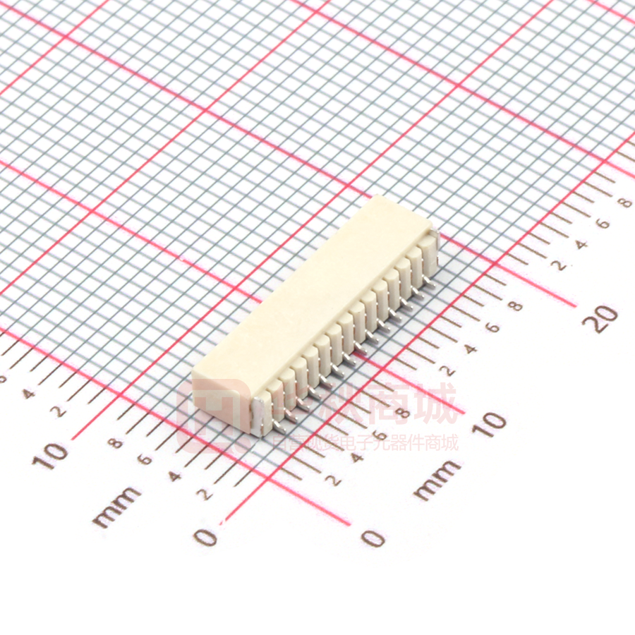

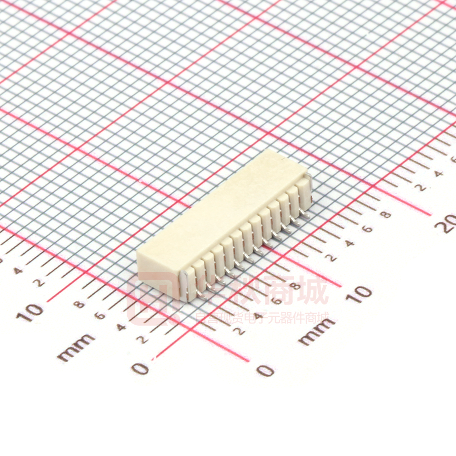

    SMD,P=1mm,卧贴
    线对板连接器 14Pin(1x14) P=1.00mm 卧贴
A1002WR-S-14P 数据手册
A1002 SERIES 1.00mm pitch wire to board connector Specifications Current rating:1A AC,DC Voltage rating:50V AC,DC Temperature range:-40°C~+105°C Contact resistance:20m Max. Insulation resistance:100M Min. Withstanding voltage:500V AC/minute *Compliant with RoHS and REACH* *Meet the HF/Halogen Free,need to customize* *Contact CJT for details* Standards E326732 E326732 2.90 2.95 6.30 REF. 6.25 REF. 5.40 5.45 6.30 REF. 7.05 REF. CHANGJIANG CONNECTORS TEL:+86-755-29959119 29959129 FAX:+86-755-29959139 Http://www.CJT.cn A-10 A1002 SERIES A1002-T 1.00mm pitch wire to board connector 1.00mm pitch Crimp Terminal Reference Informations: *Used in CJT A1002H-XP(-2),A1002H-2xXP series Housing 1.30±0.20 0.12±0.02 0.51±0.15 1.40±0.20 B B 0.30±0.05 0.90±0.20 A 4.00±0.20 A 0.83 SEC:A-A 1.10±0.20 1.30±0.10 SEC:B-B 0.40±0.10 0.75±0.10 Ordering information & Specifications: Unit:mm Wire Range Insulation O.D. Material A1002-TP AWG#28-#32 0.80mm(max) Phosphor Bronze Tin over Nickel 20,000 PCS A1002-GP AWG#28-#32 0.80mm(max) Phosphor Bronze Gold over flash 20,000 PCS Part NO. Qty/reel Finish Optional Gold plating available but MOQ requested A1002A-T 1.40±0.20 1.00mm pitch Crimp Terminal Reference Informations: *Used in CJT A1002HA,HB,HE-XP series Housing 1.30±0.20 0.12 C C 0.90±0.20 SEC:B-B 0.45 MIN 0.76±0.15 0.55±0.10 0.95±0.10 B 1.10±0.20 0.30±0.10 1.40±0.10 B 0.75 A 1.55±0.15 A 4.00±0.20 0.50±0.15 SEC:A-A 0.40±0.10 SEC:C-C Ordering information & Specifications: Unit:mm Part NO. Wire Range Insulation O.D. Material Finish Qty/reel A1002A-TP AWG#28-#32 0.80mm(max) Phosphor Bronze Tin over Nickel 20,000 PCS A1002A-GP AWG#28-#32 0.80mm(max) Phosphor Bronze Gold over flash 20,000 PCS Optional Gold plating available but MOQ requested CHANGJIANG CONNECTORS TEL:+86-755-29959119 29959129 FAX:+86-755-29959139 Http://www.CJT.cn A-11 A1002 SERIES A1002C-T 1.00mm pitch wire to board connector 1.00mm pitch Crimp Terminal 1.10±0.25 0.15 0.55±0.20 1.25±0.25 1.05±0.25 SEC:B-B SEC:A-A A D D 0.75±0.10 0.75±0.10 SEC: C-C SEC: D-D 0.25±0.05 0.70±0.10 0.45±0.10 0.75±0.10 C 0.70±0.10 C 3.60±0.20 0.65±0.10 B 0.30±0.05 2.70±0.20 B 6.30±0.25 0.90 A 0.85±0.25 Reference Informations: *Used in CJT A1002HC,HD-XP series Housing 0.35±0.05 Ordering information & Specifications: Unit:mm Wire Range Insulation O.D. Material A1002C-TP AWG#28-#32 0.80mm(max) Phosphor Bronze Tin over Nickel 20,000 PCS A1002C-GP AWG#28-#32 0.80mm(max) Phosphor Bronze Gold over flash 20,000 PCS Part NO. Qty/reel Finish Optional Gold plating available but MOQ requested A1002D-T 1.00mm pitch Crimp Terminal Reference Informations: *Used in CJT A1002HG,HI-XP series Housing 1.44±0.20 0.12 0.50±0.10 1.30±0.20 A 0.55±0.10 0.80 0.28±0.10 1.02±0.20 1.40 B 1.55±0.20 B 3.93±0.25 A 0.86±0.20 SEC:A-A 0.80±0.10 0.10±0.08 0.95±0.10 SEC:B-B 0.38±0.05 Ordering information & Specifications: Unit:mm Part NO. Wire Range Insulation O.D. Material Finish Qty/reel A1002D-TP AWG#28-#32 0.80mm(max) Phosphor Bronze Tin over Nickel 20,000 PCS A1002D-GP AWG#28-#32 0.80mm(max) Phosphor Bronze Gold over flash 20,000 PCS Optional Gold plating available but MOQ requested CHANGJIANG CONNECTORS TEL:+86-755-29959119 29959129 FAX:+86-755-29959139 Http://www.CJT.cn A-12 A1002 SERIES A1002H-XP 1.00mm pitch wire to board connector 1.00mm pitch Single Row Housing Reference Informations: *Material:PBT,UL94V-0 *Suitable CJT A1002-T series Terminal *Mates with CJT A1002WV-S,WR-S-XP series Single Row Wafer *Color:White Ordering Information: A1002H-XP - *** 1 2 1.Part No. 2.Material: (Blank):PBT,UL94V-0 GWT:PBT,UL94V-0,GWT 750 ℃ Circuit 1 Ordering Information & Dimensions: PART NO. 1.00±0.10 A±0.20 B±0.25 5.00±0.25 2.80±0.25 2.08±0.20 2P 3P 4P 5P 6P 7P 8P 9P 10P 11P 12P 13P 14P 15P 16P 17P 18P 19P 20P Dimensions A B 1.00 5.00 2.00 6.00 3.00 7.00 4.00 8.00 5.00 9.00 6.00 10.00 7.00 11.00 8.00 12.00 9.00 13.00 10.00 14.00 11.00 15.00 12.00 16.00 13.00 17.00 14.00 18.00 15.00 19.00 16.00 20.00 17.00 21.00 18.00 22.00 19.00 23.00 Unit: mm A1002H-XP-2 1.00mm pitch Single Row Housing Reference Informations: *Material:PBT,UL94V-0 *Suitable CJT A1002-T series Terminal *Mates with CJT A1002WV-S,WR-S-XP series Single Row Wafer *Color:White Ordering Information: A1002H-XP-2 - *** 1 2 1.Part No. 2.Material: (Blank):PBT,UL94V-0 GWT:PBT,UL94V-0,GWT 750 ℃ Circuit 1 Ordering Information & Dimensions: PART NO. 1.00±0.10 A±0.20 5.00±0.25 2.80±0.25 B±0.25 2.08±0.20 2P 3P 4P 5P 6P 7P 8P 9P 10P 11P 12P 13P 14P 15P 16P 17P 18P 19P 20P Dimensions A B 1.00 3.00 2.00 4.00 3.00 5.00 4.00 6.00 5.00 7.00 6.00 8.00 7.00 9.00 8.00 10.00 9.00 11.00 10.00 12.00 11.00 13.00 12.00 14.00 13.00 15.00 14.00 16.00 15.00 17.00 16.00 18.00 17.00 19.00 18.00 20.00 19.00 21.00 Unit: mm CHANGJIANG CONNECTORS TEL:+86-755-29959119 29959129 FAX:+86-755-29959139 Http://www.CJT.cn A-13 A1002 SERIES A1002HA-XP 1.00mm pitch wire to board connector 1.00mm pitch Single Row Housing Reference Informations: *Material:PBT,UL94V-0 *Suitable CJT A1002A-T series Terminal *Mates with CJT A1002WRA-S,WRE-S-XP series Single Row Wafer *Color:White C±0.20 Ordering Information: A1002HA-XP - *** 1 2 1.Part No. 2.Material: (Blank):PBT,UL94V-0 GWT :PBT,UL94V-0,GWT 750 ℃ A±0.20 1.00±0.10 Circuit 1 5.01±0.25 1.90±0.20 PART NO. 2P 3P 4P 5P 6P 7P 8P 9P 10P 11P 12P 13P 14P 15P 16P 17P 18P 19P 20P 1.70±0.20 B±0.25 Ordering Information & Dimensions: 2.30±0.25 A 1.00 2.00 3.00 4.00 5.00 6.00 7.00 8.00 9.00 10.00 11.00 12.00 13.00 14.00 15.00 16.00 17.00 18.00 19.00 Dimensions B 3.00 4.00 5.00 6.00 7.00 8.00 9.00 10.00 11.00 12.00 13.00 14.00 15.00 16.00 17.00 18.00 19.00 20.00 21.00 C 2.40 3.40 4.40 5.40 6.40 7.40 8.40 9.40 10.40 11.40 12.40 13.40 14.40 15.40 16.40 17.40 18.40 19.40 20.40 Unit:mm A1002HB-XP 1.00mm pitch Single Row Housing Reference Informations: *Material:Nylon 66,UL94V-0 *Suitable CJT A1002A-T series Terminal *Mates with CJT A1002WVB-S,WRB-S-XP series Wafer *Color:White Circuit 1 2.30±0.20 Ordering Information: A1002HB-XP - *** 1 2 1.Part No. 2.Material: (Blank):Nylon 66,UL94V-0 GWT:Nylon 66,UL94V-0,GWT 750 ℃ 1.00±0.10 A±0.20 C±0.20 3.79±0.25 B±0.25 7.20±0.25 2.90±0.20 6.00±0.25 1.70±0.20 Ordering Information & Dimensions: PART NO. 2P 3P 4P 5P 6P 7P 8P 9P 10P 11P 12P 13P 14P 15P 16P 17P 18P 19P 20P A 1.00 2.00 3.00 4.00 5.00 6.00 7.00 8.00 9.00 10.00 11.00 12.00 13.00 14.00 15.00 16.00 17.00 18.00 19.00 Dimensions B 3.00 4.00 5.00 6.00 7.00 8.00 9.00 10.00 11.00 12.00 13.00 14.00 15.00 16.00 17.00 18.00 19.00 20.00 21.00 C 2.40 3.40 4.40 5.40 6.40 7.40 8.40 9.40 10.40 11.40 12.40 13.40 14.40 15.40 16.40 17.40 18.40 19.40 20.40 Unit:mm CHANGJIANG CONNECTORS TEL:+86-755-29959119 29959129 FAX:+86-755-29959139 Http://www.CJT.cn A-14 A1002 SERIES A1002HC-XP 1.00mm pitch wire to board connector 1.00mm pitch Single Row Housing Reference Informations: *Material:Nylon 46,UL94V-0 *Suitable CJT A1002C-T series Terminal *Color:Ivory 1.45±0.25 A±0.20 Circuit 1 Ordering Information: A1002HC-XP - *** 1 2 1.Part No. 2.Material: (Blank):Nylon 46,UL94V-0 GWT:Nylon 46,UL94V-0,GWT 750 ℃ 1.00±0.10 1.20±0.10 B±0.25 2.80±0.20 7.00±0.25 3.15±0.20 0.30±0.05 Ordering Information & Dimensions: PART NO. 4P 6P C±0.25 A 3.00 5.00 Dimensions B 4.60 6.60 C 6.60 8.60 Unit:mm A1002HD-XP 1.00mm pitch Single Row Housing Reference Informations: *Material:Nylon 46,UL94V-0 *Suitable CJT A1002C-T series Terminal *Color:Ivory 1.45±0.25 Ordering Information: A1002HD-XP - *** 1 2 1.Part No. 2.Material: (Blank):Nylon 46,UL94V-0 GWT :Nylon 46,UL94V-0 GWT 750 ℃ Circuit 1 1.00±0.10 A±0.20 1.20±0.10 B±0.25 2.80±0.20 7.00±0.25 3.15±0.20 0.30±0.05 Ordering Information & Dimensions: PART NO. 3.10±0.25 C±0.25 4P 6P A 3.00 5.00 Dimensions B 4.60 6.60 C 6.60 8.60 Unit:mm CHANGJIANG CONNECTORS TEL:+86-755-29959119 29959129 FAX:+86-755-29959139 Http://www.CJT.cn A-15 A1002 SERIES A1002HE-XP 1.00mm pitch wire to board connector 1.00mm pitch Single Row Housing Reference Informations: *Material:Nylon 66,UL94V-0 *Suitable CJT A1002A-T series Terminal *Mates with CJT A1002WRC-S-XP series Wafer *Color:White 1.00±0.10 1.70±0.10 A±0.10 Ordering Information: A1002HE-XP - *** 1 2 1.Part No. 2.Material: (Blank):Nylon 66,UL94V-0 GWT:Nylon 66,UL94V-0,GWT 750 ℃ Circuit 1 Ordering Information & Dimensions: PART NO. 2.30±0.20 2.20±0.20 6.90±0.25 5.50±0.25 2.40±0.20 C±0.20 B±0.25 2P 3P 4P 5P 6P 7P 8P 9P 10P 11P 12P 13P 14P 15P 16P 17P 18P 19P 20P A 1.00 2.00 3.00 4.00 5.00 6.00 7.00 8.00 9.00 10.00 11.00 12.00 13.00 14.00 15.00 16.00 17.00 18.00 19.00 Dimensions B 3.00 4.00 5.00 6.00 7.00 8.00 9.00 10.00 11.00 12.00 13.00 14.00 15.00 16.00 17.00 18.00 19.00 20.00 21.00 C 2.40 3.40 4.40 5.40 6.40 7.40 8.40 9.40 10.40 11.40 12.40 13.40 14.40 15.40 16.40 17.40 18.40 19.40 20.40 Unit:mm A1002HG-XP 1.00mm pitch 180° Single Row Housing Reference Informations: *Material:Nylon 66,UL94V-0 *Suitable CJT A1002D-T series Terminal *Mates with CJT A1002WRD-S-XP series Wafer *Color:White 1.70±0.20 Circuit 1 1.00±0.10 A±0.20 1.85±0.20 2.13±0.20 6.15±0.25 B±0.20 6.00±0.20 1.35 Ordering Information: A1002HG-XP - *** 1 2 1.Part No. 2.Material: (Blank):Nylon 66,UL94V-0 GWT:Nylon 66,UL94V-0,GWT 750 ℃ 2.50±0.20 0.75 Ordering Information & Dimensions: PART NO. 2P 3P 4P 5P 6P 7P 8P 9P 10P 11P 12P 13P 14P 15P 16P 17P 18P 19P 20P Dimensions A B 1.00 2.30 2.00 3.30 3.00 4.30 4.00 5.30 5.00 6.30 6.00 7.30 7.00 8.30 8.00 9.30 10.30 9.00 10.00 11.30 11.00 12.30 12.00 13.30 13.00 14.30 14.00 15.30 15.00 16.30 16.00 17.30 18.30 17.00 18.00 19.30 19.00 20.30 Unit:mm CHANGJIANG CONNECTORS TEL:+86-755-29959119 29959129 FAX:+86-755-29959139 Http://www.CJT.cn A-16 A1002 SERIES A1002HI-XP 1.00mm pitch wire to board connector 1.00mm pitch 90° Single Row Housing Reference Informations: *Material:Nylon 66,UL94V-0 *Suitable CJT A1002D-T series Terminal *Mates with CJT A1002WRD-S-XP series Wafer *Color:White Circuit 1 1.70±0.20 Ordering Information: A1002HI-XP - *** 1 2 1.Part No. Ordering Information & Dimensions: 2.Material: (Blank):Nylon 66,UL94V-0 Dimensions PART NO. GWT :Nylon 66,UL94V-0 GWT 750 ℃ A B 1.00 2.30 2P 3P 2.00 3.30 4P 3.00 4.30 5P 4.00 5.30 6P 5.00 6.30 1.85±0.10 7P 6.00 7.30 8P 7.00 8.30 9P 8.00 9.30 10P 9.00 10.30 11P 10.00 11.30 12P 11.00 12.30 13P 12.00 13.30 14P 13.00 14.30 15P 14.00 15.30 16P 15.00 16.30 17P 16.00 17.30 18P 17.00 18.30 19P 18.00 19.30 20P 19.00 20.30 2.50±0.20 1.00±0.05 A±0.10 C±0.25 0.75±0.10 6.15±0.20 6.05±0.20 6.00±0.20 B±0.15 0.75 2.13±0.20 Unit:mm A1002HJ-XP 1.00mm pitch Single Row Housing Ordering Information: A1002HI-XP - *** 1 2 1.Part No. 2.Material: (Blank):Nylon 66,UL94V-0 GWT :Nylon 66,UL94V-0,GWT 750 ℃ 1.00 A±0.20 Reference Informations: *Material:Nylon 66,UL94V-0 *Mates with CJT A1002WRJ-F-XP series Wafer *Color:Black Ordering Information & Dimensions: PART NO. The FPC cable into the schematic diagram B±0.25 11.00±0.25 5.15±0.25 10.40±0.25 1.85 3.40±0.20 2.10 4P 5P 6P 7P 8P 9P 10P 11P 12P 13P 14P 15P 16P 17P 18P 19P 20P 30P Dimensions A B 3.00 7.35 4.00 8.35 5.00 9.35 6.00 10.35 7.00 11.35 8.00 12.35 9.00 13.35 14.35 10.00 11.00 15.35 12.00 16.35 13.00 17.35 14.00 18.35 15.00 19.35 16.00 20.35 17.00 21.35 22.35 18.00 19.00 23.35 29.00 33.35 Unit:mm CHANGJIANG CONNECTORS TEL:+86-755-29959119 29959129 FAX:+86-755-29959139 Http://www.CJT.cn A-17 A1002 SERIES A1002H-2xXP 1.00mm pitch wire to board connector 1.00mm pitch Dual Row Housing Reference Informations: *Material:PBT,UL94V-0 *Suitable CJT A1002-T series Terminal *Mates with CJT A1002WV-S,WR-S-2xXP, A1002WV-S-F-2xXP series Dual Row Wafer *Color:White Circuit 2 Ordering Information: A1002HI-2xXP - *** 1 2 1.Part No. 2.Material: (Blank):PBT,UL94V-0 GWT:PBT,UL94V-0,GWT 750 ℃ 1.00±0.10 Circuit 1 A±0.20 5.00±0.25 4.20±0.20 4.90±0.25 B±0.25 Ordering Information & Dimensions: PART NO. 2x6P 2x8P 2x10P 2x15P 2x20P 2x25P Dimensions A B 5.00 9.00 7.00 11.00 9.00 13.00 14.00 18.00 19.00 23.00 24.00 28.00 Unit: mm A1002WV-S-XP 1.00mm pitch 180° Single Row Wafer - SMT TYPE Reference Informations: *Material:Pin:Phosphor Bronze/Tin over Nickel Solder Tabs: Phosphor Bronze/Tin over Nickel Insulator:Nylon 6T,UL94V-0 *Mates with CJT A1002H-XP(-2) series Single Row Housing *Color:Ivory A±0.10 Ordering Information: A1002WV-S-XP - *** - ** 1 2 3 1.Part No. 2.Material: (Blank):Nylon 6T,UL94V-0 GWT:Nylon 6T,UL94V-0,GWT 750 ℃ 3.Finish: (Blank):Tin over Nickel G:Gold over Nickel 1.00±0.05 1.00±0.10 Circuit 1 A±0.20 1.80±0.10 0.60±0.05 1.55 4.20±0.10 0.70±0.10 Circuit 1 1.20±0.10 P.C.B LAYOUT B±0.25 CAP (FOR PICK AND PLACE SYSTEMS) 4.25±0.25 2.90±0.25 0.20 0.70 Ordering Information & Dimensions: PART NO. 2P 3P 4P 5P 6P 7P 8P 9P 10P 11P 12P 13P 14P 15P 16P 17P 18P 19P 20P Dimensions A B 1.00 4.00 2.00 5.00 3.00 6.00 4.00 7.00 5.00 8.00 6.00 9.00 7.00 10.00 8.00 11.00 9.00 12.00 10.00 13.00 11.00 14.00 12.00 15.00 13.00 16.00 14.00 17.00 15.00 18.00 16.00 19.00 17.00 20.00 18.00 21.00 19.00 22.00 Unit: mm CHANGJIANG CONNECTORS TEL:+86-755-29959119 29959129 FAX:+86-755-29959139 Http://www.CJT.cn A-18 A1002 SERIES A1002WR-S-XP 1.00mm pitch wire to board connector 1.00mm pitch 90° Single Row Wafer - SMT TYPE Ordering Information: A1002WR-S-XP - *** - ** 1 2 3 1.Part No. 2.Material: (Blank):Nylon 6T,UL94V-0 GWT:Nylon 6T,UL94V-0,GWT 750 ℃ 3.Finish: (Blank):Tin over Nickel G:Gold over Nickel Reference Informations: *Material:Pin:Phosphor Bronze/Tin over Nickel Solder Tabs: Phosphor Bronze/Tin over Nickel Insulator:Nylon 6T,UL94V-0 *Mates with CJT A1002H-XP(-2) series Single Row Housing *Color:Ivory A±0.10 1.00±0.05 0.60±0.05 0.70±0.10 Ordering Information & Dimensions: Dimensions A B 1.00 4.00 2.00 5.00 3.00 6.00 4.00 7.00 5.00 8.00 6.00 9.00 7.00 10.00 8.00 11.00 9.00 12.00 10.00 13.00 11.00 14.00 12.00 15.00 13.00 16.00 14.00 17.00 15.00 18.00 16.00 19.00 17.00 20.00 18.00 21.00 19.00 22.00 1.80±0.10 Circuit 1 1.00±0.10 1.55±0.10 5.55±0.10 PART NO. Circuit 1 2P 3P 4P 5P 6P 7P 8P 9P 10P 11P 12P 13P 14P 15P 16P 17P 18P 19P 20P A±0.20 1.20±0.10 P.C.B LAYOUT B±0.25 0.70 4.25±0.25 2.90±0.25 0.20 Unit: mm A1002WRA-S-XP 1.00mm pitch 90° Single Row Wafer - SMT TYPE Ordering Information: A1002WRA-S-XP - *** - ** 1 2 3 1.Part No. 2.Material: (Blank):Nylon 6T,UL94V-0 GWT:Nylon 6T,UL94V-0,GWT 750 ℃ 3.Finish: (Blank):Tin over Nickel G:Gold over Nickel Reference Informations: *Material:Pin:Brass/Tin over Nickel Solder Tabs: Brass/Tin over Nickel Insulator:Nylon 6T,UL94V-0 *Mates with CJT A1002HA-XP series Single Row Housing *Color:Ivory A±0.10 1.00±0.05 B±0.25 0.60±0.10 1.10±0.05 0.60±0.10 0.20 P.C.B LAYOUT C±0.20 5.00±0.25 4.25±0.20 2.44 2.38±0.20 1.76 Circuit 1 0.60 1.00±0.10 1.30±0.10 A±0.20 4.70±0.10 3.15±0.10 1.20±0.10 Ordering Information & Dimensions: PART NO. 2P 3P 4P 5P 6P 7P 8P 9P 10P 11P 12P 13P 14P 15P 16P 17P 18P 19P 20P A 1.00 2.00 3.00 4.00 5.00 6.00 7.00 8.00 9.00 10.00 11.00 12.00 13.00 14.00 15.00 16.00 17.00 18.00 19.00 Dimensions B 3.50 4.50 5.50 6.50 7.50 8.50 9.50 10.50 11.50 12.50 13.50 14.50 15.50 16.50 17.50 18.50 19.50 20.50 21.50 C 2.50 3.50 4.50 5.50 6.50 7.50 8.50 9.50 10.50 11.50 12.50 13.50 14.50 15.50 16.50 17.50 18.50 19.50 20.50 Unit: mm CHANGJIANG CONNECTORS TEL:+86-755-29959119 29959129 FAX:+86-755-29959139 Http://www.CJT.cn A-19 A1002 SERIES A1002WVB-S-XP 1.00mm pitch wire to board connector 1.00mm pitch 180° Single Row Wafer - SMT TYPE Ordering Information: A1002WVB-S-2xXP - *** - ** 1 2 3 1.Part No. 2.Material: (Blank):Nylon 9T,UL94V-0 GWT:Nylon 9T,UL94V-0,GWT 750 ℃ 3.Finish: (Blank):Tin over Nickel G:Gold over Nickel Reference Informations: *Material:Pin:Phosphor Bronze/Tin over Nickel Solder Tabs: Phosphor Bronze/Tin over Nickel Insulator:Nylon 9T,UL94V-0 *Mates with CJT A1002HB-XP series Single Row Housing *Color:Ivory A±0.10 1.05 1.00 0.75 1.76±0.20 3.90 3.50 PART NO. 2P 3P 4P 5P 6P 7P 8P 9P 10P 11P 12P 13P 14P 15P 16P 17P 18P 19P 20P 1.00±0.10 0.60 A±0.20 0.55 Circuit 1 P.C.B LAYOUT 3.40±0.20 CAP 4.35±0.25 4.25±0.25 0.50 B±0.25 Circuit 1 2.10 1.15 1.60 Ordering Information & Dimensions: 1.20±0.10 0.20 3.50±0.20 A1002WRB-S-XP Dimensions A B 1.00 3.70 2.00 4.70 3.00 5.70 4.00 6.70 5.00 7.70 6.00 8.70 7.00 9.70 8.00 10.70 9.00 11.70 10.00 12.70 11.00 13.70 12.00 14.70 13.00 15.70 14.00 16.70 15.00 17.70 16.00 18.70 17.00 19.70 18.00 20.70 19.00 21.70 Unit: mm 1.00mm pitch 90° Single Row Wafer - SMT TYPE Ordering Information: A1002WRB-S-2xXP - *** - ** 1 2 3 1.Part No. 2.Material: (Blank):Nylon 9T,UL94V-0 GWT:Nylon 9T,UL94V-0,GWT 750 ℃ 3.Finish: (Blank):Tin over Nickel G:Gold over Nickel Reference Informations: *Material:Pin:Phosphor Bronze/Tin over Nickel Solder Tabs: Phosphor Bronze/Tin over Nickel Insulator:Nylon 9T,UL94V-0 *Mates with CJT A1002HB-XP series Single Row Housing *Color:Ivory A±0.10 1.10±0.05 1.00±0.05 0.60±0.10 Ordering Information & Dimensions: 0.60±0.10 A±0.20 P.C.B LAYOUT 0.20 0.80 5.00±0.25 4.28±0.25 Circuit 1 4.28±0.25 3.40±0.20 B±0.25 1.20±0.10 4.70±0.20 3.15±0.10 1.00±0.10 1.20±0.10 1.76±0.20 PART NO. 2P 3P 4P 5P 6P 7P 8P 9P 10P 11P 12P 13P 14P 15P 16P 17P 18P 19P 20P Dimensions A B 1.00 3.70 2.00 4.70 3.00 5.70 4.00 6.70 5.00 7.70 6.00 8.70 7.00 9.70 8.00 10.70 9.00 11.70 10.00 12.70 11.00 13.70 12.00 14.70 13.00 15.70 14.00 16.70 15.00 17.70 16.00 18.70 17.00 19.70 18.00 20.70 19.00 21.70 Unit: mm CHANGJIANG CONNECTORS TEL:+86-755-29959119 29959129 FAX:+86-755-29959139 Http://www.CJT.cn A-20 A1002 SERIES A1002WRC-S-XP 1.00mm pitch wire to board connector 1.00mm pitch 90° Single Row Wafer - SMT TYPE Ordering Information: A1002WRC-S-2xXP - *** - ** 1 2 3 1.Part No. 2.Material: (Blank):Nylon 9T,UL94V-0 GWT:Nylon 9T,UL94V-0,GWT 750 ℃ 3.Finish: (Blank):Tin over Nickel G:Gold over Nickel Reference Informations: *Material:Pin:Brass/Tin over Nickel Solder Tabs: Brass/Tin over Nickel Insulator:Nylon 9T,UL94V-0 *Mates with CJT A1002HE-XP series Single Row Housing *Color:Ivory 0.70±0.05 1.00±0.05 4.25±0.20 1.70±0.10 0.60 Ordering Information & Dimensions: PART NO. 0.60±0.10 1.60±0.05 B±0.25 1.55±0.10 A±0.10 0.80±0.10 1.00±0.10 P.C.B LAYOUT 1.76±0.20 A±0.15 C±0.20 0.68 2.86±0.20 2.82±0.20 Circuit 1 4.93±0.25 0.20 2P 3P 4P 5P 6P 7P 8P 9P 10P 11P 12P 13P 14P 15P 16P 17P 18P 19P 20P A 1.00 2.00 3.00 4.00 5.00 6.00 7.00 8.00 9.00 10.00 11.00 12.00 13.00 14.00 15.00 16.00 17.00 18.00 19.00 Dimensions B 3.90 4.90 5.90 6.90 7.90 8.90 9.90 10.90 11.90 12.90 13.90 14.90 15.90 16.90 17.90 18.90 19.90 20.90 21.90 C 2.50 3.50 4.50 5.50 6.50 7.50 8.50 9.50 10.50 11.50 12.50 13.50 14.50 15.50 16.50 17.50 18.50 19.50 20.50 Unit:mm A1002WRD-S-XP 1.00mm pitch 90° Single Row Wafer - SMT TYPE Reference Informations: *Material:Pin:Brass/Tin over Nickel Solder Tabs: Brass/Tin over Nickel Insulator:Nylon 9T,UL94V-0 *Mates with CJT A1002HG,HI-XP series Single Row Housing *Color:Ivory 0.70±0.05 1.00±0.05 0.80±0.10 P.C.B LAYOUT C±0.20 5.00±0.25 0.20 2.91±0.20 2.82±0.20 1.76 Circuit 1 0.70 1.60±0.05 0.60±0.10 1.00±0.10 A±0.20 Ordering Information & Dimensions: PART NO. 1.70±0.10 3.63±0.20 4.30±0.25 B±0.25 1.55±0.10 A±0.10 Ordering Information: A1002WRD-S-2xXP - *** - ** 1 2 3 1.Part No. 2.Material: (Blank):Nylon 9T,UL94V-0 GWT:Nylon 9T,UL94V-0,GWT 750 ℃ 3.Finish: (Blank):Tin over Nickel G:Gold over Nickel 2P 3P 4P 5P 6P 7P 8P 9P 10P 11P 12P 13P 14P 15P 16P 17P 18P 19P 20P A 1.00 2.00 3.00 4.00 5.00 6.00 7.00 8.00 9.00 10.00 11.00 12.00 13.00 14.00 15.00 16.00 17.00 18.00 19.00 Dimensions B 3.90 4.90 5.90 6.90 7.90 8.90 9.90 10.90 11.90 12.90 13.90 14.90 15.90 16.90 17.90 18.90 19.90 20.90 21.90 C 2.50 3.50 4.50 5.50 6.50 7.50 8.50 9.50 10.50 11.50 12.50 13.50 14.50 15.50 16.50 17.50 18.50 19.50 20.50 Unit:mm CHANGJIANG CONNECTORS TEL:+86-755-29959119 29959129 FAX:+86-755-29959139 Http://www.CJT.cn A-21 A1002 SERIES A1002WV-S-2xXP 1.00mm pitch wire to board connector 1.00mm pitch 180° Dual Row Wafer - SMT TYPE Ordering Information: A1002WV-S-2xXP - *** - ** 1 2 3 1.Part No. 2.Material: (Blank):Nylon 6T,UL94V-0 GWT:Nylon 6T,UL94V-0,GWT 750 ℃ 3.Finish: (Blank):Tin over Nickel G:Gold over Nickel Reference Informations: *Material:Pin:Phosphor Bronze/Tin over Nickel Solder Tabs: Phosphor Bronze/Tin over Nickel Insulator:Nylon 6T,UL94V-0 *Mates with CJT A1002H-2xXP series Dual Row Housing *Color:Ivory Circuit 2 A±0.20 0.50 1.80±0.10 Circuit 1 1.00±0.10 Circuit 1 7.20±0.10 0.90±0.10 0.85±0.10 4.00±0.10 0.60 1.00±0.10 P.C.B LAYOUT 5.90±0.25 B±0.25 5.40±0.20 4.25±0.20 4.67±0.25 Ordering Information & Dimensions: 0.20 PART NO. 2x6P 2x8P 2x10P 2x15P 2x20P 2x25P 0.71 5.00±0.25 Dimensions A B 5.00 8.30 7.00 10.30 9.00 12.30 14.00 17.30 19.00 22.30 24.00 27.30 Unit: mm A1002WR-S-2xXP 1.00mm pitch 90° Dual Row Wafer - SMT TYPE Ordering Information: A1002WR-S-2xXP - *** - ** 1 2 3 1.Part No. 2.Material: (Blank):Nylon 6T,UL94V-0 GWT:Nylon 6T,UL94V-0,GWT 750 ℃ 3.Finish: (Blank):Tin over Nickel G:Gold over Nickel Circuit 1 0.60 1.00±0.10 1.80±0.10 0.90±0.10 1.00±0.10 0.85±0.10 1.25±0.10 7.30±0.10 Circuit 1 4.10±0.10 Reference Informations: *Material:Pin:Phosphor Bronze/Tin over Nickel Solder Tabs: Phosphor Bronze/Tin over Nickel Insulator:Nylon 6T,UL94V-0 *Mates with CJT A1002H-2xXP series Dual Row Housing *Color:Ivory Circuit 2 P.C.B LAYOUT A±0.20 5.10±0.25 5.40±0.25 Ordering Information & Dimensions: PART NO. 0.70 0.20 B±0.25 2x6P 2x8P 2x10P 2x15P 2x20P 2x25P Dimensions A B 5.00 8.30 7.00 10.30 9.00 12.30 17.30 14.00 19.00 22.30 24.00 27.30 Unit: mm CHANGJIANG CONNECTORS TEL:+86-755-29959119 29959129 FAX:+86-755-29959139 Http://www.CJT.cn A-22 A1002 SERIES 1.00mm pitch 180° Dual Row Wafer - SMT TYPE Ordering Information: A1002WV-S-F-2xXP - *** - ** 1 2 3 1.Part No. 2.Material: (Blank):Nylon 6T,UL94V-0 GWT:Nylon 6T,UL94V-0,GWT 750 ℃ 3.Finish: (Blank):Tin over Nickel G:Gold over Nickel Reference Informations: *Material:Pin:Phosphor Bronze/Tin over Nickel Solder Tabs: Phosphor Bronze/Tin over Nickel Insulator:Nylon 6T,UL94V-0 *Mates with CJT A1002H-2xXP series Dual Row Housing *Color:Ivory Circuit 2 ∅0.55±0.10 7.20±0.10 Circuit 1 1.80 0.50 1.90±0.10 0.90±0.10 0.85±0.10 0.60 1.00±0.10 4.00±0.10 A1002WV-S-F-2xXP 1.00mm pitch wire to board connector 1.00±0.10 Circuit 1 0.85±0.10 A±0.20 P.C.B LAYOUT 5.90±0.25 B±0.25 0.20 0.50 0.85 Ordering Information & Dimensions: 4.67±0.25 4.85±0.25 4.25±0.20 5.40±0.20 0.71 1.90 5.00±0.25 PART NO. 2x6P 2x8P 2x10P 2x15P 2x20P 2x25P Dimensions A B 5.00 8.30 7.00 10.30 9.00 12.30 14.00 17.30 19.00 22.30 24.00 27.30 Unit: mm CHANGJIANG CONNECTORS TEL:+86-755-29959119 29959129 FAX:+86-755-29959139 Http://www.CJT.cn A-23
