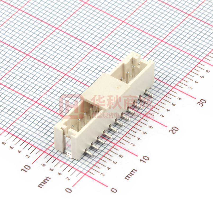

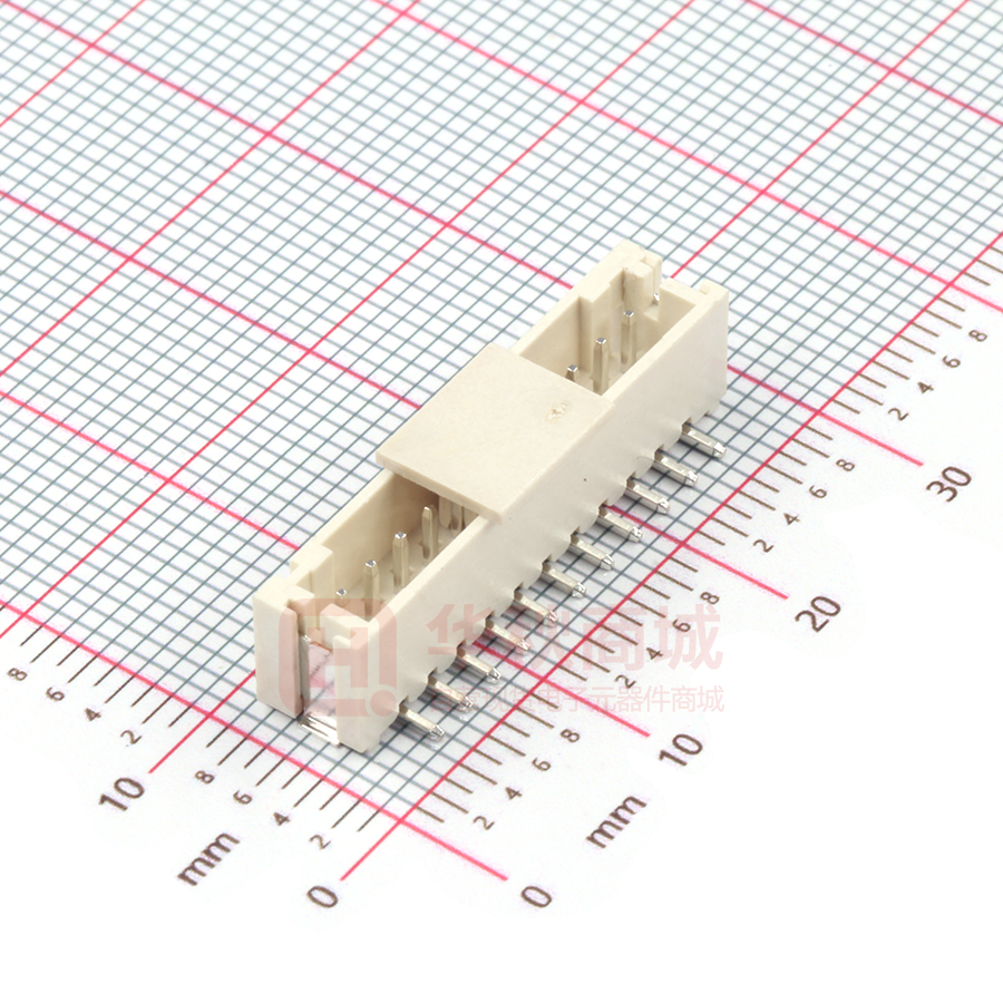

A2001 SERIES 2.00mm pitch wire to board connector Specifications Current rating:2A AC,DC Voltage rating:100V AC,DC Temperature range:-40°C~+105°C Contact resistance:10m Max. Insulation resistance:1000M Min. Withstanding voltage:800V AC/minute *Compliant with RoHS and REACH* *Meet the HF/Halogen Free,need to customize* *Contact CJT for details* Standards E326732 E326732 4.85 2.00 17.00 REF. 1.60 1.60 1.80 8.10 REF. 5.00 8.25 REF. 1.60 8.60 REF. 1.60 1.80 1.80 4.70 4.70 DIP TYPE 5.40 5.60 8.70 REF. 9.70 REF. SMT TYPE CHANGJIANG CONNECTORS TEL:+86-755-29959119 29959129 FAX:+86-755-29959139 Http://www.CJT.cn A-146 A2001 SERIES A2001-T 2.00mm pitch wire to board connector 2.00mm pitch Crimp Terminal Reference Informations: *Used in CJT A2001H-XP series Housing 0.20 0.80 D±0.25 C±0.25 SEC:A-A B 1.32 1.50 1.62 B E±0.25 F±0.25 A 5.60±0.25 A 0.45 2.10 1.00 SEC:B-B 0.71 1.40 Unit:mm Ordering information & Specifications: Part NO. Wire Range A2001-TP AWG#24-#30 Insulation O.D. Material 1.50mm(max) Phosphor Bronze A2001-GP AWG#24-#30 1.50mm(max) Phosphor Bronze A2001-TP-L AWG#28-#32 0.90mm(max) A2001-GP-L AWG#28-#32 0.90mm(max) Finish C D E Qty/reel F Tin over Nickel 2.20 2.50 1.70 1.40 10,000 PCS Gold over Nickel 2.20 2.50 1.70 1.40 10,000 PCS Phosphor Bronze Tin over Nickel 1.55 2.10 1.15 1.15 15,000 PCS Phosphor Bronze Gold over Nickel 1.55 2.10 1.15 1.15 15,000 PCS Optional Gold plating available but MOQ requested A2001M-T 2.00mm pitch Crimp Terminal Reference Informations: *Used in CJT A2001HM-XP series Housing 1.80±0.25 0.20 SEC:A-A 1.30±0.25 1.30±0.25 B 7.30 B 7.70 A 11.20±0.25 A 1.50 1.00 1.85±0.25 0.50 1.50 0.50 1.50 SEC:B-B 0.65 Unit:mm Ordering information & Specifications: Part NO Wire Range Insulation O.D. Material Finish Qty/reel A2001M-TP AWG#24-#30 1.50mm(max) Phosphor Bronze Tin over Nickel 10,000 PCS A2001M-TB AWG#24-#30 1.50mm(max) Brass Tin over Nickel 10,000 PCS A2001M-GP AWG#24-#30 1.50mm(max) Phosphor Bronze Gold over Nickel 10,000 PCS AWG#24-#30 1.50mm(max) Brass Gold over Nickel 10,000 PCS A2001M-GB Optional Gold plating available but MOQ requested CHANGJIANG CONNECTORS TEL:+86-755-29959119 29959129 FAX:+86-755-29959139 Http://www.CJT.cn A-147 A2001 SERIES A2001H-XP 2.00mm pitch wire to board connector 2.00mm pitch Housing Reference Informations: *Material:Nylon 66,UL94V-0 *Suitable CJT A2001-T(-L) series Terminal *Mates with CJT A2001HM-XP series Housing or A2001WV,WR-XP,A2001WV-S,WR-S-XP series Wafer *Color:White Ordering Information: A2001H-XP - *** - ** 1 2 3 1.Part No. 2.Material: (Blank):Nylon 66,UL94V-0 GWT:Nylon 66,UL94V-0,GWT 750 ℃ 3.Color: (Blank):White RD:Red OR:Orange YL:Yellow GY:Gray BL:Blue PK:Pink BK:Black BR:Brown GN:Green VI:Violet TR:Tomato red LY:Lemon yellow LE:Light blue VY:Vivid yellow DPK:Dark pink Circuit 1 2.00±0.10 A±0.20 4.50±0.25 6.85±0.25 B±0.25 3.45±0.25 Ordering Information & Dimensions: PART NO. 2P 3P 4P 5P 6P 7P 8P 9P 10P 11P 12P 13P 14P 15P 16P 17P 18P 19P 20P Dimensions A B 2.00 5.80 4.00 7.80 6.00 9.80 8.00 11.80 10.00 13.80 12.00 15.80 14.00 17.80 16.00 19.80 18.00 21.80 23.80 20.00 22.00 25.80 24.00 27.80 26.00 29.80 28.00 31.80 30.00 33.80 32.00 35.80 34.00 37.80 36.00 39.80 38.00 41.80 Unit: mm 2.00mm pitch Housing Reference Informations: *Material:Nylon 66,UL94V-0 *Suitable CJT A2001M-T series Terminal *Mates with CJT A2001H-XP series Housing *Color:White Circuit 1 2.00±0.10 Circuit 1 A A±0.20 3P~20P 2P 4.80±0.25 C±0.25 2.90 6.00±0.25 B±0.25 Ordering Information: A2001HM-XP - *** - ** 1 2 3 1.Part No. 2.Material: (Blank):Nylon 66,UL94V-0 GWT:Nylon 66,UL94V-0,GWT 750 ℃ 3.Color: (Blank):White Ordering Information & Dimensions: RD:Red OR:Orange YL:Yellow GY:Gray Dimensions BL:Blue PK:Pink PART NO. A B C BK:Black BR:Brown 2.00 6.00 4.60 2P GN:Green VI:Violet 3P 4.00 8.00 6.60 4P 6.00 10.00 8.60 5P 8.00 12.00 10.60 6P 10.00 14.00 12.60 7P 12.00 16.00 14.60 8P 14.00 18.00 16.60 9P 16.00 20.00 18.60 10P 18.00 22.00 20.60 11P 20.00 24.00 22.60 22.00 26.00 24.60 12P 13P 24.00 28.00 26.60 26.00 30.00 28.60 14P 15P 28.00 32.00 30.60 16P 30.00 34.00 32.60 32.00 36.00 34.60 17P 18P 34.00 38.00 36.60 19P 36.00 40.00 38.60 20P 38.00 42.00 40.60 12.70±0.25 A2001HM-XP Unit: mm CHANGJIANG CONNECTORS TEL:+86-755-29959119 29959129 FAX:+86-755-29959139 Http://www.CJT.cn A-148 A2001 SERIES A2001WV-XP 2.00mm pitch 180° Wafer Reference Informations: *Material:Pin:Brass/Tin over Nickel Insulator:Nylon 66,UL94V-0 *Mates with CJT A2001H-XP series Housing *Color:White 2.00±0.10 2.00mm pitch wire to board connector Circuit 1 A±0.20 Ordering Information: A2001WV-XP - * - *** - ** - ** 1 2 3 4 5 1.Part No. 2.Style: (blank) :Type 1 2 :Type 2 3 :Type 3 3.Material: (Blank):Nylon 66,UL94V-0 GWT:Nylon 66,UL94V-0,GWT 750 ℃ 4.Color: (Blank):White RD:Red OR:Orange YL:Yellow GY:Gray BL:Blue PK:Pink BK:Black BR:Brown GN:Green VI:Violet TR:Tomato red LY:Lemon yellow LE:Light blue VY:Vivid yellow 5.Finish: (Blank):Tin over Nickel G:Gold over Nickel 2.00 Ø0.70 P.C.B LAYOUT Ordering Information & Dimensions: PART NO. 2P 3P 4P 5P 6P 7P 8P 9P 10P 11P 12P 13P 14P 15P 16P 17P 18P 19P 20P TYPE 1 4.50±0.25 B±0.25 6.10±0.25 1.80 3.40 TYPE 2 0.80 Pin 0.50 SQ TYPE 3 Dimensions A B 2.00 6.00 4.00 8.00 6.00 10.00 8.00 12.00 10.00 14.00 12.00 16.00 14.00 18.00 16.00 20.00 18.00 22.00 20.00 24.00 22.00 26.00 24.00 28.00 26.00 30.00 28.00 32.00 30.00 34.00 32.00 36.00 34.00 38.00 36.00 40.00 38.00 42.00 Unit: mm A2001WR-XP 2.00mm pitch 90° Wafer Reference Informations: *Material:Pin:Brass/Tin over Nickel Insulator:Nylon 66,UL94V-0 *Mates with CJT A2001H-XP series Housing *Color:White PIN 0.50 SQ 2.00±0.10 Circuit 1 Ordering Information: A2001WR-XP - * - *** - ** - ** 1 2 3 4 5 1.Part No. 2.Style: (blank) :Type 1 2 :Type 2 3.Material: (Blank):Nylon 66,UL94V-0 GWT:Nylon 66,UL94V-0,GWT 750 ℃ 4.Color: (Blank):White RD:Red OR:Orange YL:Yellow GY:Gray BL:Blue PK:Pink BK:Black BR:Brown GN:Green VI:Violet TR:Tomato red LY:Lemon yellow LE:Light blue VY:Vivid yellow 5.Finish: (Blank):Tin over Nickel G:Gold over Nickel 2.00 A±0.20 4.85±0.25 B±0.25 6.25±0.25 3.40±0.20 0.80 7.60±0.25 6.10±0.25 1.80 TYPE 2 TYPE 1 Ø0.70 P.C.B LAYOUT Ordering Information & Dimensions: PART NO. 2P 3P 4P 5P 6P 7P 8P 9P 10P 11P 12P 13P 14P 15P 16P 17P 18P 19P 20P Dimensions A B 2.00 6.00 4.00 8.00 6.00 10.00 8.00 12.00 10.00 14.00 12.00 16.00 14.00 18.00 16.00 20.00 18.00 22.00 20.00 24.00 22.00 26.00 24.00 28.00 26.00 30.00 28.00 32.00 30.00 34.00 32.00 36.00 34.00 38.00 36.00 40.00 38.00 42.00 Unit: mm CHANGJIANG CONNECTORS TEL:+86-755-29959119 29959129 FAX:+86-755-29959139 Http://www.CJT.cn A-149 A2001 SERIES A2001WV-S-XP 2.00mm pitch wire to board connector 2.00mm pitch 180° Wafer-SMT TYPE A Reference Informations: *Material:Pin:Brass/Tin over Nickel Insulator:Nylon 6T,UL94V-0 *Mates with CJT A2001H-XP series Housing *Color:Ivory 5.50 3.00 1.00 Ordering Information: 1.60 A2001WV-S-XP - *** - ** - ** 1 2 3 4 1.Part No. 2.Material: (Blank):Nylon 6T,UL94V-0 GWT:Nylon 6T,UL94V-0,GWT 750 ℃ 3.Color: (Blank):Ivory RD:Red BL:Blue BK:Black GN:Green LY:Lemon yellow DPK:Dark pink 4.Finish: (Blank):Tin over Nickel G:Gold over Nickel A±0.20 2.00 Circuit 1 1.00 2.00 1.60 P.C.B LAYOUT Ordering Information & Dimensions: PART NO. 2P 3P 4P 5P 6P 7P 8P 9P 10P 11P 12P 13P 14P 15P 16P 17P 18P 19P 20P 5.40±0.25 B±0.25 6.42±0.25 2.43 2.00±0.20 PIN 0.50 SQ Dimensions A B 2.00 8.00 4.00 10.00 6.00 12.00 8.00 14.00 10.00 16.00 12.00 18.00 14.00 20.00 16.00 22.00 18.00 24.00 20.00 26.00 22.00 28.00 24.00 30.00 26.00 32.00 28.00 34.00 30.00 36.00 32.00 38.00 34.00 40.00 36.00 42.00 38.00 44.00 Unit: mm A±0.20 1.60 P.C.B LAYOUT 1.00 7.65±0.25 6.00±0.25 2.43 PIN 0.50 SQ Ordering Information & Dimensions: PART NO. 5.50±0.25 B±0.25 1.00 9.20 A 2.00 Ordering Information: A2001WR-S-XP - *** - ** - ** 1 2 3 4 1.Part No. 2.Material: (Blank):Nylon 6T,UL94V-0 GWT:Nylon 6T,UL94V-0,GWT 750 ℃ 3.Color: (Blank):Ivory RD:Red BL:Blue BK:Black GN:Green LY:Lemon yellow DPK:Dark pink 4.Finish: (Blank):Tin over Nickel G:Gold over Nickel Circuit 1 2.00±0.10 1.50 5.70 Reference Informations: *Material:Pin:Brass/Tin over Nickel Insulator:Nylon 6T,UL94V-0 *Mates with CJT A2001H-XP series Housing *Color:Ivory 2.00mm pitch 90° Wafer-SMT TYPE 3.40 A2001WR-S-XP 2P 3P 4P 5P 6P 7P 8P 9P 10P 11P 12P 13P 14P 15P 16P 17P 18P 19P 20P Dimensions A B 2.00 8.00 4.00 10.00 6.00 12.00 8.00 14.00 10.00 16.00 12.00 18.00 14.00 20.00 16.00 22.00 18.00 24.00 20.00 26.00 22.00 28.00 24.00 30.00 26.00 32.00 28.00 34.00 30.00 36.00 32.00 38.00 34.00 40.00 36.00 42.00 38.00 44.00 Unit: mm CHANGJIANG CONNECTORS TEL:+86-755-29959119 29959129 FAX:+86-755-29959139 Http://www.CJT.cn A-150 A2001 SERIES A2001WVR-XP Reference Informations: *Material:Pin:Brass/Tin over Nickel Insulator:Nylon 66,UL94V-0 *Mates with CJT A2001H-XP series Housing *Color:White 2.00±0.10 Circuit 1 A±0.20 2.00mm pitch wire to board connector 2.00mm pitch 90° Wafer Ordering Information: A2001WVR-XP - * - *** - ** - ** 1 2 3 4 5 1.Part No. 2.Style: (blank) :Type 1 2 :Type 2 3.Material: (Blank):Nylon 66,UL94V-0 GWT:Nylon 66,UL94V-0,GWT 750 ℃ 4.Color: (Blank):White RD:Red OR:Orange YL:Yellow GY:Gray BL:Blue PK:Pink BK:Black BR:Brown GN:Green VI:Violet 5.Finish: (Blank):Tin over Nickel G:Gold over Nickel 2.00 Ø0.70 P.C.B LAYOUT Ordering Information & Dimensions: PART NO. 2P 3P 4P 5P 6P 7P 8P 9P 10P 11P 12P 13P 14P 15P 16P 17P 18P 19P 20P 4.70±0.25 B±0.25 3.40±0.20 0.81 Circuit 1 PIN 0.50 SQ 6.60±0.25 6.10±0.25 1.80 TYPE 1 TYPE 2 Dimensions A B 2.00 6.00 4.00 8.00 6.00 10.00 8.00 12.00 10.00 14.00 12.00 16.00 14.00 18.00 16.00 20.00 18.00 22.00 20.00 24.00 22.00 26.00 24.00 28.00 26.00 30.00 28.00 32.00 30.00 34.00 32.00 36.00 34.00 38.00 36.00 40.00 38.00 42.00 Unit: mm 2.00mm pitch 180° Wafer-High box type Reference Informations: *Material:Pin:Brass/Tin over Nickel Insulator:Nylon 6T,UL94V-0 *Mates with CJT A2001H-XP series Housing *Color:White 2.00±0.10 Circuit 1 A±0.20 Ordering Information: A2001WV-F-XP-H - *** - ** - ** 1 2 3 4 1.Part No. 2.Material: (Blank):Nylon 6T,UL94V-0 GWT:Nylon 6T,UL94V-0,GWT 750 ℃ 3.Color: (Blank):White RD:Red YL:Yellow BL:Blue BK:Black BR:Brown GN:Green 4.Finish: (Blank):Tin over Nickel G:Gold over Nickel 4.85±0.25 B±0.25 1.50 Ø0.80 PIN 0.50 SQ 1.40 1.50 6.00±0.25 15.00±0.25 3.60±0.20 1.80 1.40 Ø1.00 2.00 1.50 A2001WV-F-XP-H Ø0.70 P.C.B LAYOUT Ordering Information & Dimensions: PART NO. 2P 3P 4P 5P 6P 7P 8P 9P 10P 11P 12P 13P 14P 15P 16P 17P 18P 19P 20P Dimensions A B 2.00 6.00 4.00 8.00 6.00 10.00 8.00 12.00 10.00 14.00 12.00 16.00 14.00 18.00 16.00 20.00 18.00 22.00 20.00 24.00 22.00 26.00 24.00 28.00 26.00 30.00 28.00 32.00 30.00 34.00 32.00 36.00 34.00 38.00 36.00 40.00 38.00 42.00 Unit: mm CHANGJIANG CONNECTORS TEL:+86-755-29959119 29959129 FAX:+86-755-29959139 Http://www.CJT.cn A-151
