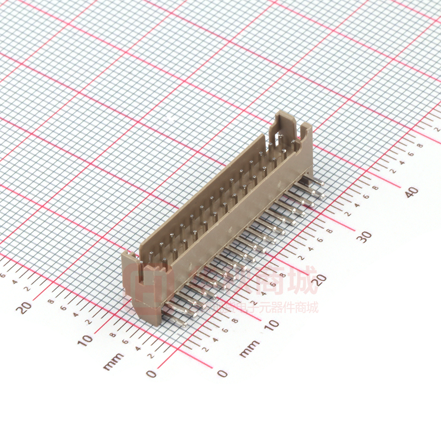

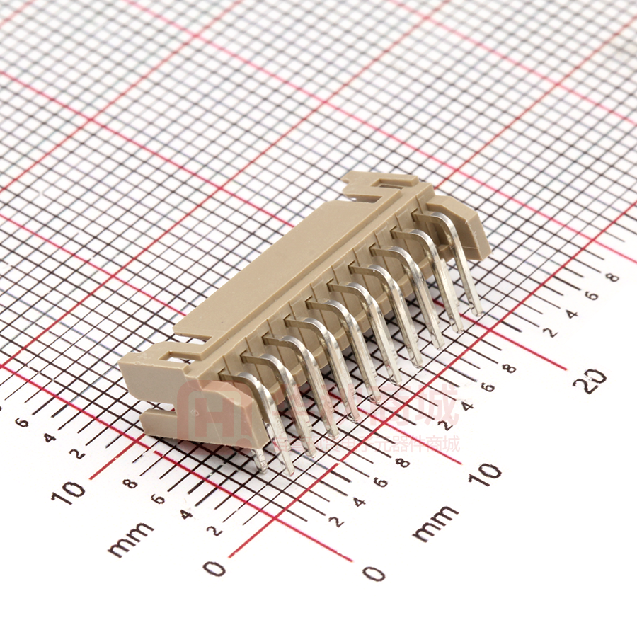

A2006 SERIES 2.00mm pitch wire to board connector Specifications Current rating:3A AC,DC Voltage rating:250V AC,DC Temperature range:-40°C~+105°C Contact resistance:10m Max. Insulation resistance:1000M Min. Withstanding voltage:800V AC/minute *Compliant with RoHS and REACH* *Meet the HF/Halogen Free,need to customize* *Contact CJT for details* Standards E326732 E326732 1.40 1.40 1.60 1.60 5.00 8.90 REF 5.00 11.40 REF CHANGJIANG CONNECTORS TEL:+86-755-29959119 29959129 FAX:+86-755-29959139 Http://www.CJT.cn A-223 A2006 SERIES A2006-T 2.00mm pitch wire to board connector 2.00mm pitch Crimp Terminal Reference Informations: *Used in CJT A2006H,HA-2xXP,A2012H-XP series Housing 0.20 0.80 2.55±0.25 2.00±0.25 SEC:A-A A 3.40±0.25 3.20±0.25 B 1.40±0.25 B 0.43 6.60±0.25 A 1.70±0.25 1.50±0.25 1.35±0.25 0.25 1.20±0.20 SEC:B-B 1.55 1.50 0.60 Ordering information & Specifications: Unit:mm Part NO. Wire Range Insulation O.D. Material Finish Qty/reel A2006-TP AWG#22-#28 1.50mm(max) Phosphor Bronze Tin over Nickel 10,000 PCS AWG#22-#28 1.50mm(max) Phosphor Bronze Gold over flash 10,000 PCS A2006-GP Optional Gold plating available but MOQ requested A2006-T-B 2.00mm pitch Crimp Terminal Reference Informations: *Used in CJT A2006HB-2xXP series Housing 2.00±0.25 A 1.35±0.25 1.50±0.25 1.35±0.10 1.50±0.25 C 0.55 1.70±0.25 3.38±0.20 C 1.20±0.10 B 3.18±0.20 B SEC:A-A 0.52±0.15 6.58±0.35 A 2.55±0.25 0.80±0.10 0.20 1.20±0.10 SEC: C-C SEC:B-B Ordering information & Specifications: Unit:mm Wire Range Insulation O.D. Material Finish Qty/reel A2006-TP-B AWG#22-#28 1.50mm(max) Phosphor Bronze Tin over Nickel 10,000 PCS A2006-GP-B AWG#22-#28 1.50mm(max) Phosphor Bronze Gold over flash 10,000 PCS Part NO. Optional Gold plating available but MOQ requested CHANGJIANG CONNECTORS TEL:+86-755-29959119 29959129 FAX:+86-755-29959139 Http://www.CJT.cn A-224 A2006 SERIES A2006-T-U 2.00mm pitch wire to board connector 2.00mm pitch Crimp Terminal 7.00 2.70±0.25 Reference Informations: *Used in CJT A2006HU-2xXP series Housing 0.15 0.80 2.30±0.25 SEC:A-A 1.50±0.25 0.35 1.90±0.25 1.75 B 1.30 B 4.00±0.25 A 7.50±0.25 A 1.35 SEC:B-B 1.45 0.25 1.65 Ordering information & Specifications: Unit:mm Part NO. Wire Range Insulation O.D. Material Finish Qty/reel A2006-TP-U AWG#22-#28 1.50mm(max) Phosphor Bronze Tin over Nickel 10,000 PCS AWG#22-#28 1.50mm(max) Phosphor Bronze Gold over flash 10,000 PCS A2006-GP-U Optional Gold plating available but MOQ requested A2006H-2xXP 2.00mm pitch Dual Row Housing Reference Informations: *Material:Nylon 66,UL94V-0 *Suitable CJT A2006-T series Terminal *Mates with CJT A2006WV,WR,WV-S,WV-S-F-2xXP series Dual Row Wafer *Color:White Circuit 2 2.00±0.10 Ordering Information: A2006H-2xXP - *** - ** 1 2 3 1.Part No. 2.Material: (Blank):Nylon 66,UL94V-0 GWT:Nylon 66,UL94V-0,GWT 750 ℃ 3.Color: (Blank):White BK:Black RD:Red YL:Yellow BL:Blue 2.00±0.10 Circuit 1 Ordering Information & Dimensions: A±0.20 B±0.25 7.30±0.25 4.20±0.25 5.00±0.25 PART NO. 2x2P 2x3P 2x4P 2x5P 2x6P 2x7P 2x8P 2x9P 2x10P 2x11P 2x12P 2x13P 2x14P 2x15P 2x16P 2x17P 2x18P 2x19P 2x20P 2x21P 2x22P 2x23P 2x24P 2x25P Dimensions A B 2.00 5.90 4.00 7.90 6.00 9.90 8.00 11.90 10.00 13.90 12.00 15.90 14.00 17.90 16.00 19.90 18.00 21.90 20.00 23.90 22.00 25.90 24.00 27.90 26.00 29.90 28.00 31.90 30.00 33.90 32.00 35.90 34.00 37.90 36.00 39.90 38.00 41.90 40.00 43.90 42.00 45.90 44.00 47.90 46.00 49.90 48.00 51.90 Unit: mm CHANGJIANG CONNECTORS TEL:+86-755-29959119 29959129 FAX:+86-755-29959139 Http://www.CJT.cn A-225 A2006 SERIES A2006HA-2xXP 2.00mm pitch wire to board connector 2.00mm pitch Dual Row Housing Reference Informations: *Material:Nylon 66,UL94V-0 *Suitable CJT A2006-T series Terminal *Mates with CJT A2006WVA,WRA-2xXP series Dual Row Wafer *Color:White Ordering Information: A2006HA-2xXP - *** - ** 1 2 3 1.Part No. 2.Material: (Blank):Nylon 66,UL94V-0 GWT:Nylon 66,UL94V-0,GWT 750 ℃ 3.Color: (Blank):White BK:Black RD:Red YL:Yellow BL:Blue Circuit 1 A±0.20 3.60±0.20 2.00±0.10 2.00±0.10 Circuit 2 B±0.25 4.20±0.20 9.35±0.25 7.30±0.20 2.22±0.10 C±0.35 5.00±0.20 Ordering Information & Dimensions: PART NO. 2x3P 2x4P 2x5P 2x6P 2x7P 2x8P 2x9P 2x10P 2x11P 2x12P 2x13P 2x14P 2x15P 2x16P 2x17P 2x18P 2x19P 2x20P A 4.00 6.00 8.00 10.00 12.00 14.00 16.00 18.00 20.00 22.00 24.00 26.00 28.00 30.00 32.00 34.00 36.00 38.00 Dimensions B 6.45 8.45 10.45 12.45 14.45 16.45 18.45 20.45 22.45 24.45 26.45 28.45 30.45 32.45 34.45 36.45 38.45 40.45 C 11.60 13.60 15.60 17.60 19.60 21.60 23.60 25.60 27.60 29.60 31.60 33.60 35.60 37.60 39.60 41.60 43.60 45.60 Unit: mm A2006HB-2xXP 2.00mm pitch Dual Row Housing Reference Informations: *Material:Nylon 66,UL94V-0 *Suitable CJT A2006-T-B series Terminal *Mates with CJT A2006WVB ,WRB-2xXP series Dual Row Wafer *Color:White 2x3P~2x6P A±0.25 2x7P~2x9P 2x10P~2x24P 2.00±0.10 2.00±0.10 Circuit 2 Circuit 1 D±0.25 Ordering Information & Dimensions: Ordering Information: A2006HB-2xXP - *** - ** 1 2 3 1.Part No. 2.Material: (Blank):Nylon 66,UL94V-0 GWT:Nylon 66,UL94V-0,GWT 750 ℃ 3.Color: (Blank):White BK:Black RD:Red YL:Yellow BL:Blue B±0.25 4.20±0.25 7.30±0.25 4.20±0.25 C±0.25 5.45±0.25 7.40±0.25 2x3P~2x19P 2x21P~2x24P 5.45±0.25 7.70±0.25 2x20P PART NO. 2x3P 2x4P 2x5P 2x6P 2x7P 2x8P 2x9P 2x10P 2x11P 2x12P 2x13P 2x14P 2x15P 2x16P 2x17P 2x18P 2x19P 2x20P 2x21P 2x22P 2x23P 2x24P A 4.00 6.00 8.00 10.00 12.00 14.00 16.00 18.00 20.00 22.00 24.00 26.00 28.00 30.00 32.00 34.00 36.00 38.00 40.00 42.00 44.00 46.00 Dimensions B C 7.90 5.25 9.90 7.35 11.90 9.35 13.90 10.00 15.90 10.00 17.90 10.00 19.90 10.00 21.90 10.00 23.90 10.00 25.90 10.00 27.90 10.00 29.90 10.00 31.90 10.00 33.90 10.00 35.90 10.00 37.90 10.00 39.90 10.00 41.90 15.00 43.90 10.00 45.90 10.00 47.90 10.00 49.90 10.00 D ------------12.00 14.00 16.00 18.00 20.00 22.00 24.00 26.00 28.00 30.00 32.00 34.00 36.00 38.00 40.00 42.00 44.00 46.00 Unit: mm CHANGJIANG CONNECTORS TEL:+86-755-29959119 29959129 FAX:+86-755-29959139 Http://www.CJT.cn A-226 A2006 SERIES A2006HU-2xXP 2.00mm pitch wire to board connector 2.00mm pitch Dual Row Housing Ordering Information: A2006HU-2xXP - *** - ** 1 2 3 1.Part No. 2.Material: (Blank):Nylon 66,UL94V-0 GWT:Nylon 66,UL94V-0,GWT 750 ℃ 3.Color: (Blank):Natural BK:Black RD:Red YL:Yellow BL:Blue Reference Informations: *Material:Nylon 66,UL94V-0 *Suitable CJT A2006-T-U series Terminal *Mates with CJT A2006WVU,WRU-2xXP series Dual Row Wafer *Color:Natural Circuit 1 Ordering Information & Dimensions: Circuit 2 2.00±0.10 PART NO. 2x4P~2x7P Without Guide bulge 2x8P~2x20P With Guide bulge A±0.20 2x4P 2x5P 2x6P 2x7P 2x8P 2x9P 2x10P 2x11P 2x12P 2x13P 2x14P 2x15P 2x16P 2x17P 2x18P 2x19P 2x20P 8.80±0.25 8.30±0.25 9.10±0.25 B±0.25 6.50±0.25 Dimensions A B 6.00 10.00 8.00 12.00 10.00 14.00 12.00 16.00 14.00 18.00 16.00 20.00 18.00 22.00 20.00 24.00 22.00 26.00 24.00 28.00 26.00 30.00 28.00 32.00 30.00 34.00 32.00 36.00 34.00 38.00 36.00 40.00 38.00 42.00 Unit: mm A2006WV-2xXP Reference Informations: *Material:Pin:Brass/Tin over Nickel Insulator:Nylon 66,UL94V-0 *Mates with CJT A2006H-2xXP,A2009H-2xXP series Dual Row Housing *Color:Ivory Circuit 2 2.00mm pitch 180° Dual Row Wafer Ordering Information: A2006WV-2xXP - *** - ** - ** 1 2 3 4 1.Part No. 2.Material: (Blank):Nylon 66,UL94V-0 GWT:Nylon 66,UL94V-0,GWT 750 ℃ 3.Color: (Blank):Ivory BK:Black RD:Red YL:Yellow 2.00±0.05 BL:Blue 4.Finish: (Blank):Tin over Nickel G:Gold over Nickel Ordering Information & Dimensions: PART NO. ∅0.80±0.05 A±0.20 P.C.B LAYOUT 5.00±0.25 PIN 0.50 SQ 3.00±0.20 6.50±0.25 B±0.25 2.00±0.20 2.00±0.05 Circuit 1 2.00±0.10 2x2P 2x3P 2x4P 2x5P 2x6P 2x7P 2x8P 2x9P 2x10P 2x11P 2x12P 2x13P 2x14P 2x15P 2x16P 2x17P 2x18P 2x19P 2x20P 2x21P 2x22P 2x23P 2x24P 2x25P Dimensions A B 2.00 5.90 4.00 7.90 6.00 9.90 8.00 11.90 10.00 13.90 12.00 15.90 14.00 17.90 16.00 19.90 18.00 21.90 20.00 23.90 22.00 25.90 24.00 27.90 26.00 29.90 28.00 31.90 30.00 33.90 32.00 35.90 34.00 37.90 36.00 39.90 38.00 41.90 40.00 43.90 42.00 45.90 44.00 47.90 46.00 49.90 48.00 51.90 Unit: mm CHANGJIANG CONNECTORS TEL:+86-755-29959119 29959129 FAX:+86-755-29959139 Http://www.CJT.cn A-227 A2006 SERIES A2006WR-2xXP 2.00mm pitch 90° Dual Row Wafer Circuit 1 ∅0.80±0.05 A±0.20 P.C.B LAYOUT B±0.25 Ordering Information & Dimensions: PART NO. 2.00±0.10 9.50±0.25 6.50±0.25 5.00±0.25 7.00±0.25 3.00±0.20 A2006WVA-2xXP Circuit 2 2.00±0.10 Unit: mm 2.00mm pitch 180° Dual Row Wafer Reference Informations: *Material:Pin:Brass/Tin over Nickel Insulator:Nylon 66,UL94V-0 *Mates with CJT A2006HA-2xXP series Dual Row Housing *Color:Ivory 2.00±0.10 Ordering Information: A2006WVA-2xXP - *** - ** - ** 1 2 3 4 1.Part No. 2.Material: (Blank):Nylon 66,UL94V-0 GWT:Nylon 66,UL94V-0,GWT 750 ℃ 3.Color: (Blank):Ivory BK:Black RD:Red YL:Yellow BL:Blue 4.Finish: (Blank):Tin over Nickel G:Gold over Nickel Circuit 1 A±0.20 B±0.25 3.10±0.20 5.00±0.25 6.55±0.25 PIN 0.50 SQ 2x2P 2x3P 2x4P 2x5P 2x6P 2x7P 2x8P 2x9P 2x10P 2x11P 2x12P 2x13P 2x14P 2x15P 2x16P 2x17P 2x18P 2x19P 2x20P 2x21P 2x22P 2x23P 2x24P 2x25P Dimensions A B 2.00 5.90 4.00 7.90 6.00 9.90 8.00 11.90 10.00 13.90 12.00 15.90 14.00 17.90 16.00 19.90 18.00 21.90 20.00 23.90 22.00 25.90 24.00 27.90 26.00 29.90 28.00 31.90 30.00 33.90 32.00 35.90 34.00 37.90 36.00 39.90 38.00 41.90 40.00 43.90 42.00 45.90 44.00 47.90 46.00 49.90 48.00 51.90 2.00±0.10 2.00±0.05 ∅0.80±0.05 P.C.B LAYOUT 2.00±0.05 2.00±0.10 2.00±0.10 PIN 0.50 SQ Ordering Information: A2006WR-2xXP - *** - ** - ** 1 2 3 4 1.Part No. 2.Material: (Blank):Nylon 66,UL94V-0 GWT:Nylon 66,UL94V-0,GWT 750 ℃ 3.Color: (Blank):Ivory BK:Black RD:Red YL:Yellow BL:Blue 2.00±0.05 4.Finish: (Blank):Tin over Nickel G:Gold over Nickel 2.00±0.05 Reference Informations: *Material:Pin:Brass/Tin over Nickel Insulator:Nylon 66,UL94V-0 *Mates with CJT A2006H-2xXP,A2009H-2xXP series Dual Row Housing *Color:Ivory Circuit 2 2.00mm pitch wire to board connector Ordering Information & Dimensions: PART NO. 2x2P 2x3P 2x4P 2x5P 2x6P 2x7P 2x8P 2x9P 2x10P 2x11P 2x12P 2x13P 2x14P 2x15P 2x16P 2x17P 2x18P 2x19P 2x20P Dimensions A B 2.00 8.00 4.00 10.00 6.00 12.00 8.00 14.00 10.00 16.00 12.00 18.00 14.00 20.00 16.00 22.00 18.00 24.00 20.00 26.00 22.00 28.00 24.00 30.00 26.00 32.00 28.00 34.00 30.00 36.00 32.00 38.00 34.00 40.00 36.00 42.00 38.00 44.00 Unit: mm CHANGJIANG CONNECTORS TEL:+86-755-29959119 29959129 FAX:+86-755-29959139 Http://www.CJT.cn A-228 A2006 SERIES A2006WRA-2xXP 2.00mm pitch 90° Dual Row Wafer PIN 0.50 SQ Circuit 2 2.00±0.10 Ordering Information: A2006WRA-2xXP - *** - ** - ** 1 2 3 4 1.Part No. 2.Material: (Blank):Nylon 66,UL94V-0 GWT:Nylon 66,UL94V-0,GWT 750 ℃ 3.Color: (Blank):Ivory BK:Black RD:Red YL:Yellow BL:Blue 4.Finish: (Blank):Tin over Nickel G:Gold over Nickel Circuit 1 A±0.20 B±0.25 2.00±0.10 9.55±0.25 6.55±0.25 5.00±0.25 3.10±0.20 2.00±0.05 ∅0.80±0.05 P.C.B LAYOUT 2.00±0.05 Reference Informations: *Material:Pin:Brass/Tin over Nickel Insulator:Nylon 66,UL94V-0 *Mates with CJT A2006HA-2xXP series Dual Row Housing *Color:Ivory 2.00±0.10 2.00mm pitch wire to board connector Ordering Information & Dimensions: PART NO. 2x2P 2x3P 2x4P 2x5P 2x6P 2x7P 2x8P 2x9P 2x10P 2x11P 2x12P 2x13P 2x14P 2x15P 2x16P 2x17P 2x18P 2x19P 2x20P Dimensions A B 2.00 8.00 4.00 10.00 6.00 12.00 8.00 14.00 10.00 16.00 12.00 18.00 14.00 20.00 16.00 22.00 18.00 24.00 20.00 26.00 22.00 28.00 24.00 30.00 26.00 32.00 28.00 34.00 30.00 36.00 32.00 38.00 34.00 40.00 36.00 42.00 38.00 44.00 Unit: mm A2006WV-S-2xXP 2.00mm pitch 180° Dual Row Wafer - SMT TYPE Ordering Information: A2006WV-S-2xXP - *** - ** - ** 1 2 3 4 1.Part No. 2.Material: (Blank):Nylon 6T,UL94V-0 GWT:Nylon 6T,UL94V-0,GWT 750 ℃ 3.Color: (Blank):Ivory BK:Black RD:Red YL:Yellow BL:Blue 4.Finish: (Blank):Tin over Nickel G:Gold over Nickel 2.00±0.10 Circuit 1 2.00±0.10 5.10±0.10 Circuit 2 2.00±0.10 Reference Informations: *Material:Pin:Brass/Tin over Nickel Insulator:Nylon 6T,UL94V-0 *Mates with CJT A2006H-2xXP, A2009H-2xXP series Dual Row Housing *Color:Ivory Ordering Information & Dimensions: PART NO. A±0.10 2.00±0.05 1.10±0.10 A±0.20 P.C.B LAYOUT B±0.25 6.50±0.25 5.20±0.25 PIN 0.50 SQ 1.50±0.20 2x2P 2x3P 2x4P 2x5P 2x6P 2x7P 2x8P 2x9P 2x10P 2x11P 2x12P 2x13P 2x14P 2x15P 2x16P 2x17P 2x18P 2x19P 2x20P 2x21P 2x22P 2x23P 2x24P 2x25P Dimensions A B 2.00 6.00 4.00 8.00 6.00 10.00 8.00 12.00 10.00 14.00 12.00 16.00 14.00 18.00 16.00 20.00 18.00 22.00 20.00 24.00 22.00 26.00 24.00 28.00 26.00 30.00 28.00 32.00 30.00 34.00 32.00 36.00 34.00 38.00 36.00 40.00 38.00 42.00 40.00 44.00 42.00 46.00 44.00 48.00 46.00 50.00 48.00 52.00 Unit: mm CHANGJIANG CONNECTORS TEL:+86-755-29959119 29959129 FAX:+86-755-29959139 Http://www.CJT.cn A-229 A2006 SERIES A2006WV-S-F-2xXP 2.00mm pitch 180° Dual Row Wafer - SMT TYPE Ordering Information: A2006WV-S-F-2xXP - *** - ** - ** 1 2 3 4 1.Part No. 2.Material: (Blank):Nylon 6T,UL94V-0 GWT:Nylon 6T,UL94V-0,GWT 750 ℃ 3.Color: Ordering Information & Dimensions: (Blank):Ivory A±0.10 BK:Black Dimensions 2.00±0.05 PART NO. RD:Red A B C YL:Yellow 1.10±0.10 2.00 6.00 4.00 2x2P BL:Blue 2x3P 4.00 8.00 6.00 4.Finish: (Blank):Tin over Nickel 2x4P 6.00 10.00 8.00 G:Gold over Nickel 2x5P 8.00 12.00 10.00 2x6P 10.00 14.00 12.00 2x7P 12.00 16.00 14.00 2x8P 14.00 18.00 16.00 Ø1.10±0.10 2x9P 16.00 20.00 18.00 2x10P 18.00 22.00 20.00 20.00 24.00 22.00 2x11P 2x12P 22.00 26.00 24.00 C±0.10 2x13P 24.00 28.00 26.00 P.C.B LAYOUT 26.00 30.00 28.00 2x14P 2x15P 28.00 32.00 30.00 5.20±0.25 2x16P 30.00 34.00 32.00 2x17P 32.00 36.00 34.00 2x18P 34.00 38.00 36.00 2x19P 36.00 40.00 38.00 2x20P 38.00 42.00 40.00 2x21P 40.00 44.00 42.00 42.00 46.00 44.00 2x22P 2x23P 44.00 48.00 46.00 2x24P 46.00 50.00 48.00 1.50±0.20 2x25P 48.00 52.00 50.00 5.10±0.10 2.00±0.10 Circuit 1 2.00±0.10 Reference Informations: *Material:Pin:Brass/Tin over Nickel Insulator:Nylon 6T,UL94V-0 *Mates with CJT A2006H-2xXP,A2009H-2xXP series Dual Row Housing *Color:Ivory Circuit 2 2.00±0.10 A±0.20 6.50±0.25 1.00±0.15 B±0.25 Ø1.00±0.10 2.00mm pitch wire to board connector PIN 0.50 SQ Unit: mm A2006WVB-2xXP 2.00mm pitch 180° Dual Row Wafer Circuit 1 2.00±0.10 2.00±0.05 Ø0.80±0.05 P.C.B LAYOUT 2.00±0.05 Circuit 2 2.00±0.10 Reference Informations: *Material:Pin:Brass/Tin over Nickel Insulator:Nylon 66,UL94V-0 *Mates with CJT A2006HB-2xXP series Dual Row Housing *Color:White Ordering Information: A2006WVB-2xXP - *** - ** - ** 1 2 3 4 1.Part No. 2.Material: (Blank):Nylon 66,UL94V-0 GWT:Nylon 66,UL94V-0,GWT 750 ℃ 3.Color: (Blank):White BK:Black RD:Red YL:Yellow BL:Blue Ordering Information & Dimensions: 4.Finish: Dimensions (Blank):Tin over Nickel PART NO. G:Gold over Nickel A B A±0.20 5.00±0.25 PIN 0.50 SQ 3.00±0.20 6.50±0.25 B±0.25 2x2~2x4P 2x5~2x20P 2x2P 2x3P 2x4P 2x5P 2x6P 2x7P 2x8P 2x9P 2x10P 2x11P 2x12P 2x13P 2x14P 2x15P 2x16P 2x17P 2x18P 2x19P 2x20P 2.00 4.00 6.00 8.00 10.00 12.00 14.00 16.00 18.00 20.00 22.00 24.00 26.00 28.00 30.00 32.00 34.00 36.00 38.00 6.00 8.00 10.00 12.00 14.00 16.00 18.00 20.00 22.00 24.00 26.00 28.00 30.00 32.00 34.00 36.00 38.00 40.00 42.00 Unit: mm CHANGJIANG CONNECTORS TEL:+86-755-29959119 29959129 FAX:+86-755-29959139 Http://www.CJT.cn A-230 A2006 SERIES A2006WRB-2xXP 2.00mm pitch wire to board connector 2.00mm pitch 90° Dual Row Wafer Ordering Information: A2006WRB-2xXP - *** - ** - ** 1 2 3 4 1.Part No. 2.Material: (Blank):Nylon 66,UL94V-0 GWT:Nylon 66,UL94V-0,GWT 750 ℃ 3.Color: (Blank):White BK:Black RD:Red YL:Yellow BL:Blue Ordering Information & Dimensions: 4.Finish: (Blank):Tin over Nickel Dimensions PART NO. G:Gold over Nickel A B Reference Informations: *Material:Pin:Brass/Tin over Nickel Insulator:Nylon 66,UL94V-0 *Mates with CJT A2006HB-2xXP series Dual Row Housing *Color:White PIN 0.50 SQ Circuit 2 Circuit 1 Ø0.80±0.05 P.C.B LAYOUT A±0.20 B±0.25 2.00±0.05 2.00±0.10 2.00±0.10 2.00±0.05 7.00±0.25 2.00±0.20 9.50±0.25 6.50±0.25 5.00±0.25 3.00±0.20 2x2P 2x3P 2x4P 2x5P 2x6P 2x7P 2x8P 2x9P 2x10P 2x11P 2x12P 2x13P 2x14P 2x15P 2x16P 2x17P 2x18P 2x19P 2x20P 2.00 4.00 6.00 8.00 10.00 12.00 14.00 16.00 18.00 20.00 22.00 24.00 26.00 28.00 30.00 32.00 34.00 36.00 38.00 6.00 8.00 10.00 12.00 14.00 16.00 18.00 20.00 22.00 24.00 26.00 28.00 30.00 32.00 34.00 36.00 38.00 40.00 42.00 Unit: mm A2006WVU-2xXP 2.00mm pitch 180° Dual Row Wafer Reference Informations: *Material:Pin:Brass/Tin over Nickel Insulator:PA4T,UL94V-0 *Mates with CJT A2006HU-2xXP series Dual Row Housing *Color:Natural A±0.10 2.00±0.10 Circuit 2 2.00 A±0.20 2.00 2.00±0.10 Ø0.80 P.C.B LAYOUT 4.50 Ordering Information: A2006WVU-2xXP - *** - ** - ** 1 2 3 4 1.Part No. 2.Material: (blank):PA4T,UL94V-0 GWT:PA4T,UL94V-0,GWT 750 ℃ 3.Color: (Blank):Natural BK:Black RD:Red YL:Yellow BL:Blue 4.Finish: (Blank):Tin over Nickel G:Gold over Nickel Ordering Information & Dimensions: Circuit 1 PART NO. 8.30±0.25 6.60±0.25 9.60±0.25 3.10±0.20 B±0.25 2.00±0.20 PIN 0.50 SQ 2x4P~2x7P Without Guideway 2x8P~2x20P With Guideway 2x4P~2x5P 2x6P~2x9P 2x10P~2x20P 2x4P 2x5P 2x6P 2x7P 2x8P 2x9P 2x10P 2x11P 2x12P 2x13P 2x14P 2x15P 2x16P 2x17P 2x18P 2x19P 2x20P Dimensions A B 6.00 10.00 8.00 12.00 10.00 14.00 12.00 16.00 14.00 18.00 16.00 20.00 18.00 22.00 20.00 24.00 22.00 26.00 24.00 28.00 26.00 30.00 28.00 32.00 30.00 34.00 32.00 36.00 34.00 38.00 36.00 40.00 38.00 42.00 Unit: mm CHANGJIANG CONNECTORS TEL:+86-755-29959119 29959129 FAX:+86-755-29959139 Http://www.CJT.cn A-231 A2006 SERIES A2006WVU-F-2xXP 2.00mm pitch wire to board connector 2.00mm pitch 180° Dual Row Wafer Reference Informations: *Material:Pin:Brass/Tin over Nickel Insulator:PA4T,UL94V-0 *Mates with CJT A2006HU-2xXP series Dual Row Housing *Color:Natural 3.10±0.20 0.80 9.60±0.25 2.00±0.10 3.40 2.00 Ordering Information: A2006WVU-F-2xXP - *** - ** - ** 1 2 3 4 1.Part No. 2.Material: (blank):PA4T,UL94V-0 A±0.10 GWT:PA4T,UL94V-0,GWT 750 ℃ A±0.20 3.Color: 2.00 1.20 (Blank):Natural 2.00±0.10 Circuit 2 BK:Black RD:Red YL:Yellow ∅0.80 BL:Blue 4.Finish: ∅1.60 (Blank):Tin over Nickel Ordering Information & Dimensions: P.C.B LAYOUT G:Gold over Nickel 4.50 Circuit 1 Dimensions PART NO. A B 8.30±0.25 6.00 10.00 2x4P 6.60±0.25 B±0.25 2x5P 8.00 12.00 2x6P 10.00 14.00 2x7P 12.00 16.00 2x8P 14.00 18.00 2x9P 16.00 20.00 2x10P 18.00 22.00 2x11P 20.00 24.00 2x12P 22.00 26.00 1.20 2x13P 24.00 28.00 2.00±0.20 PIN 0.50 SQ 1.20 26.00 30.00 2x14P 2x15P 28.00 32.00 2x16P 30.00 34.00 32.00 36.00 2x17P 2x18P 34.00 38.00 2x19P 36.00 40.00 2x4P~2x7P Without Guideway 2x6P~2x9P 2x4P~2x5P 2x10P~2x20P 2x20P 38.00 42.00 2x8P~2x20P With Guideway Unit: mm A2006WRU-F-2xXP 2.00mm pitch 90° Dual Row Wafer Ordering Information: A2006WRU-F-2xXP - *** - *** - ** - ** 1 2 3 4 5 1.Part No. 2.Size(L): (blank):3.00mm L18:1.80mm 3.Material: (blank):PA4T,UL94V-0 GWT:PA4T,UL94V-0,GWT 750 ℃ 4.Color: (Blank):Natural BK:Black RD:Red YL:Yellow BL:Blue Ordering Information & Dimensions: 5.Finish: (Blank):Tin over Nickel Dimensions PART NO. G:Gold over Nickel A B Reference Informations: *Material:Pin:Brass/Tin over Nickel Insulator:PA4T,UL94V-0 *Mates with CJT A2006HU-2xXP series Dual Row Housing *Color:Natural 0.90 Circuit 1 B±0.25 7.70±0.25 10.90±0.25 8.50±0.25 1.40 P.C.B LAYOUT 2.00±0.20 2.00 A±0.10 12.70±0.25 2.00±0.10 0.80 ∅0.80 10.10±0.25 2.00 ∅1.6+0.1 -0 0.50±0.02 7.70 A±0.20 2.00±0.15 L±0.20 2x4P~2x7P Without Guideway 2x8P~2x20P With Guideway 2x4P~2x5P 2x6P~2x9P 2x10P~2x20P 2x4P 2x5P 2x6P 2x7P 2x8P 2x9P 2x10P 2x11P 2x12P 2x13P 2x14P 2x15P 2x16P 2x17P 2x18P 2x19P 2x20P 6.00 8.00 10.00 12.00 14.00 16.00 18.00 20.00 22.00 24.00 26.00 28.00 30.00 32.00 34.00 36.00 38.00 10.00 12.00 14.00 16.00 18.00 20.00 22.00 24.00 26.00 28.00 30.00 32.00 34.00 36.00 38.00 40.00 42.00 Unit: mm CHANGJIANG CONNECTORS TEL:+86-755-29959119 29959129 FAX:+86-755-29959139 Http://www.CJT.cn A-232 A2006 SERIES A2009H-2xXP 2.00mm pitch wire to board connector 2.00mm pitch Dual Row Housing Reference Informations: *Material:Nylon 66,UL94V-0 *Suitable CJT A2008-T series Terminal *Mates with CJT A2006WV,WR,WV-S,WV-S-F-2xXP series Dual Row Wafer *Color:Black Ordering Information: A2009H-2xXP - *** - *** 1 2 3 1.Part No. 2.Material: (Blank):Nylon 66,UL94V-0 GWT:Nylon 66,UL94V-0,GWT 750 ℃ 3.Color: (Blank):Black GY:Gray WH:White 2.00±0.10 Circuit 2 2.00±0.10 Circuit 1 Ordering Information & Dimensions: PART NO. 2x2P 2x3P 2x4P 2x5P 2x6P 2x7P 2x8P 2x9P 2x10P 2x11P 2x12P 2x13P 2x14P 2x15P 2x16P 2x17P 2x18P 2x19P 2x20P A±0.20 4.46±0.25 B±0.25 7.30±0.25 4.06±0.25 1 4.96±0.25 Dimensions A B 2.00 6.00 4.00 8.00 6.00 10.00 8.00 12.00 10.00 14.00 12.00 16.00 14.00 18.00 16.00 20.00 18.00 22.00 20.00 24.00 22.00 26.00 24.00 28.00 26.00 30.00 28.00 32.00 30.00 34.00 32.00 36.00 34.00 38.00 36.00 40.00 38.00 42.00 Unit: mm A2009WV-S-2xXP 2.00mm pitch 180° Dual Row Wafer-SMT TYPE Reference Informations: *Material:Pin:Brass/Tin over Nickel Insulator:Nylon 9T,UL94V-0 Cap:Nylon 46,UL94V-0(Black) *Mates with CJT A2009H-2xXP series Dual Row Wafer *Color:Beige 3.35 2.00 A±0.10 2.00 1.10 Ordering Information: A2009WV-S-2xXP - *** - ** 1 2 3 1.Part No. 2.Material: (Blank):Nylon 9T,UL94V-0 GWT:Nylon 9T,UL94V-0,GWT 750 ℃ 3.Finish: (Blank):Tin over Nickel G:Gold over Nickel Circuit 1 6.20±0.20 2x2P B±0.25 1.50 1.50 5.50±0.25 2x4P~2x20P CAP 2x3P 7.30±0.25 0.65 P.C.B LAYOUT 1.50 2.00 2.00±0.10 Circuit 2 1.50 A±0.20 2.80 10.30 2.00 Ordering Information & Dimensions: PART NO. 2x2P 2x3P 2x4P 2x5P 2x6P 2x7P 2x8P 2x9P 2x10P 2x11P 2x12P 2x13P 2x14P 2x15P 2x16P 2x17P 2x18P 2x19P 2x20P Dimensions A B 2.00 8.50 4.00 10.50 6.00 12.50 8.00 14.50 10.00 16.50 12.00 18.50 14.00 20.50 16.00 22.50 18.00 24.50 20.00 26.50 22.00 28.50 24.00 30.50 26.00 32.50 28.00 34.50 30.00 36.50 32.00 38.50 34.00 40.50 36.00 42.50 38.00 44.50 Unit: mm CHANGJIANG CONNECTORS TEL:+86-755-29959119 29959129 FAX:+86-755-29959139 Http://www.CJT.cn A-233

物料型号: - A2006-TP:2.00mm间距压接端子,适用于AWG#22-#28线规,绝缘外径最大1.50mm,材质为磷青铜,表面处理为镀锡覆镍。 - A2006-GP:与A2006-TP类似,但表面处理为金闪镀金。 - A2006-T-B、A2006-TP-B、A2006-GP-B:与A2006-T系列相似,但用于A2006HB-2xXP系列外壳。 - A2006-T-U、A2006-TP-U、A2006-GP-U:与A2006-T系列相似,但用于A2006HU-2xXP系列外壳。
器件简介: A2006系列提供2.00mm间距的线对板连接器解决方案,包括压接端子和双排外壳,适用于多种应用场景。
引脚分配: - 端子的引脚分配遵循2.00mm的固定间距,具体引脚数量根据型号不同而有所变化。
参数特性: - 电流额定值:3A AC/DC - 电压额定值:250V AC/DC - 工作温度范围:-40°C至+105°C - 接触电阻:最大10mΩ - 绝缘电阻:最小1000MΩ - 耐电压:800V AC/分钟 - 符合RoHS和REACH标准,可定制无卤/无卤素产品。
功能详解: - 提供直插和贴装类型,包括180°和90°双排端子。 - 适用于不同的PCB布局和设计需求。
应用信息: - 适用于多种电子设备和工业应用,具体应用需根据具体型号和规格选择。
封装信息: - 提供多种材料和颜色选项,包括尼龙66 (UL94V-0) 材料和不同颜色的外壳。 - 提供不同尺寸的外壳以适应不同数量的电路。
