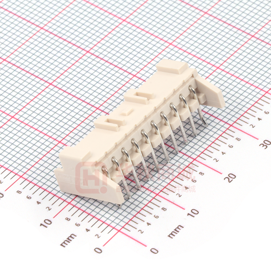

    线对板连接器 10Pin(1x10P) P=2.50mm 弯插
A2508WR-10P 数据手册
A2508 SERIES 2.50mm pitch wire to board and wire to wire connector Specifications Current rating:3A AC,DC Voltage rating:250V AC,DC Temperature range:-40°C~+105°C Contact resistance:10mΩMax. Insulation resistance:1000MΩMin. Withstanding voltage:1000V AC/minute *Compliant with RoHS and REACH* *Meet the HF/Halogen Free,need to customize* *Contact CJT for details* Standards E326732 E326732 6.35 6.90 2.70 1.60 1.60 1.60 8.10 9.93 .REF 18.62 .REF 15.10 .REF 9.20 11.40 13.35 1.60 13.90 .REF 1.60 20.00 .REF CHANGJIANG CONNECTORS TEL:+86-755-29959119 29959129 FAX:+86-755-29959139 Http://www.CJT.cn A-319 A2508 SERIES A2508-T 2.50mm pitch wire to board and wire to wire connector 2.50mm Pitch Crimp Terminal Reference Informations: *Used in CJT A2508H,HA-XP ,A2508H-2xXP series Housing 2.80±0.25 0.85 3.00±0.25 0.20 C 1.50±0.25 2.00±0.25 SEC:B-B 0.40±0.10 1.10 1.05±0.25 2.35±0.25 2.10±0.25 C 1.30±0.20 B 1.30 B 1.40 A 3.00±0.25 A 6.55±0.25 SEC:A-A 0.80 1.80±0.25 SEC:C-C Unit:mm Ordering information & Specifications: Wire Range Insulation O.D. Material Finish Qty/reel A2508-TP AWG#22-#26 1.90mm(max) Phosphor Bronze Tin over Nickel 10,000 PCS A2508-GP AWG#22-#26 1.90mm(max) Phosphor Bronze Gold over Nickel 10,000 PCS Part NO Optional Gold plating available but MOQ requested A2508-T-L 2.50mm Pitch Crimp Terminal Reference Informations: *Used in CJT A2508H,HA-XP ,A2508H-2xXP series Housing 2.80±0.25 0.85 3.00±0.25 0.20 C 1.40±0.25 2.00±0.25 SEC:B-B 0.40±0.10 1.10 1.05±0.25 2.35±0.25 2.10±0.25 C 1.30±0.20 B 1.40 B 1.30 A 3.00±0.25 A 6.55±0.25 SEC:A-A 0.80 1.80±0.25 SEC:C-C Unit:mm Ordering information & Specifications: Part NO Wire Range Insulation O.D. Material Finish Qty/reel A2508-TP-L AWG#22-#28 1.90mm(max) Phosphor Bronze Tin over Nickel 10,000 PCS A2508-GP-L AWG#22-#28 1.90mm(max) Phosphor Bronze Gold over Nickel 10,000 PCS Optional Gold plating available but MOQ requested CHANGJIANG CONNECTORS TEL:+86-755-29959119 29959129 FAX:+86-755-29959139 Http://www.CJT.cn A-320 A2508 SERIES A2508-T-H 2.50mm pitch wire to board and wire to wire connector 2.50mm Pitch Crimp Terminal Reference Informations: *Used in CJT A2508H,HA-XP ,A2508H-2xXP series Housing 2.80±0.25 0.85 3.00±0.25 0.20 C 2.10±0.25 C 2.00±0.25 1.30±0.20 B 1.30 B 2.20±0.25 1.40 A 3.00±0.25 A 6.55±0.25 SEC:A-A SEC:B-B 2.35±0.25 0.40±0.10 1.10 1.05±0.25 0.80 1.80±0.25 SEC:C-C Unit:mm Ordering information & Specifications: Wire Range Insulation O.D. Material Finish Qty/reel A2508-TP-H AWG#20-#24 1.90mm(max) Phosphor Bronze Tin over Nickel 10,000 PCS A2508-GP-H AWG#20-#24 1.90mm(max) Phosphor Bronze Gold over Nickel 10,000 PCS Part NO Optional Gold plating available but MOQ requested A2508M-T 2.50mm Pitch Crimp Terminal Reference Informations: *Used in CJT A2508HMA-XP series Housing 2.80±0.25 0.20 2.80±0.25 A A SEC:A-A B B 1.55±0.25 15.10±0.25 4.80±0.25 2.40±0.20 6.60±0.25 1.70±0.25 1.90±0.20 SEC:B-B 0.64±0.10 0.64±0.10 Ordering information & Specifications: Unit:mm Part NO Wire Range Insulation O.D. Material Finish Qty/reel A2508M-TP AWG#22-#28 1.90mm(max) Phosphor Bronze Tin over Nickel 7,000 PCS A2508M-GP AWG#22-#28 1.90mm(max) Phosphor Bronze Gold over Nickel 7,000 PCS Optional Gold plating available but MOQ requested CHANGJIANG CONNECTORS TEL:+86-755-29959119 29959129 FAX:+86-755-29959139 Http://www.CJT.cn A-321 A2508 SERIES A2508H-XP 2.50mm Pitch Housing Ordering Information: A2508H-XP - *** - ** 1 2 3 1.Part No. 2.Material: (blank):Nylon 66,UL94V-0 GWT:Nylon 66,UL94V-0,GWT 750 ℃ 3.Color: (Blank):White RD:Red OR:Orange YL:Yellow GY:Gray BL:Blue PK:Pink BK:Black BR:Brown GN:Green VI:Violet IV:Ivory LY:Lemon yellow LE:Light blue VY:Vivid yellow Reference Informations: *Material:Nylon 66,UL94V-0 *Suitable CJT A2508-T series Terminal *Mates with CJT A2508WV,WV-F-XP(-H), A2508WR,WR-F-XP,A2508WV-S-XP,A2508WVT-XP(-H), A2508WVT-F-XP(-H) series Wafer *Color:White A±0.20 Circuit 1 2.50mm pitch wire to board and wire to wire connector 2.50±0.10 Ordering Information & Dimensions: PART NO. B±0.25 2P 3P 4P 5P 6P 7P 8P 9P 10P 11P 12P 13P 14P 15P 9.50±0.25 5.00±0.25 5.70±0.25 C±0.25 A 2.50 5.00 7.50 10.00 12.50 15.00 17.50 20.00 22.50 25.00 27.50 30.00 32.50 35.00 Dimensions B 5.64 8.14 10.64 13.14 15.64 18.14 20.64 23.14 25.64 28.14 30.64 33.14 35.64 38.14 C 7.30 9.80 12.30 14.80 17.30 19.80 22.30 24.80 27.30 29.80 32.30 34.80 37.30 39.80 Unit: mm A2508HA-XP 2.50mm Pitch Housing Reference Informations: *Material:Nylon 66,UL94V-0 *Suitable CJT A2508-T series Terminal *Mates with CJT A2508HMA-XP series Housing and A2508SA-XP series Seal and A2508WV,WV-F-XP(-H),A2508WR,WR-F-XP,A2508WV-S-XP, A2508WVT-XP(-H),A2508WVT-F-XP(-H) series Wafer *Color:White A±0.20 2.50±0.10 7.50 5.70±0.25 C±0.25 Ordering Information: A2508HA-XP - *** - ** 1 2 3 1.Part No. 2.Material: (blank):Nylon 66,UL94V-0 GWT:Nylon 66,UL94V-0 ,GWT 750 ℃ 3.Color: (blank) : White BK:Black RD:Red BL:Blue LY:Lemon yellow 5.00 1.75 1.60 6 6P~15P Ordering Information & Dimensions: 2.90 B±0.25 0.80 9.50±0.25 PART NO. 3.90 1.60 7.50 5.00 5P 7.50 1.40 5.00 4P 2.00 2.75 4.40 1.15 3P 2P 2P 3P 4P 5P 6P 7P 8P 9P 10P 11P 12P 13P 14P 15P A 2.50 5.00 7.50 10.00 12.50 15.00 17.50 20.00 22.50 25.00 27.50 30.00 32.50 35.00 Dimensions B 5.70 8.20 10.70 13.20 15.70 18.20 20.70 23.20 25.70 28.20 30.70 33.20 35.70 38.20 C 7.30 9.80 12.30 14.80 17.30 19.80 22.30 24.80 27.30 29.80 32.30 34.80 37.30 39.80 Unit: mm CHANGJIANG CONNECTORS TEL:+86-755-29959119 29959129 FAX:+86-755-29959139 Http://www.CJT.cn A-322 A2508 SERIES A2508HMA-XP 2.50mm Pitch Housing Ordering Information: A2508HMA-XP - *** - ** 1 2 3 1.Part No. 2.Material: (blank):Nylon 66,UL94V-0 GWT:Nylon 66,UL94V-0 ,GWT 750 ℃ 3.Color: (Blank):White RD:Red OR:Orange YL:Yellow GY:Gray BL:Blue PK:Pink BK:Black BR:Brown GN:Green VI:Violet Reference Informations: *Material:Nylon 66,UL94V-0 *Suitable CJT A2508M-T series Terminal *Mates with CJT A2508H,HA-XP series Housing *Color:White A±0.20 2.50±0.10 2.50mm pitch wire to board and wire to wire connector Circuit 1 Ordering Information & Dimensions: 6.60±0.25 B±0.25 21.60±0.25 10.40±0.25 PART NO. 4.10±0.25 2P 3P 4P 5P 6P 7P 8P 9P 10P 11P 12P 13P 14P 15P Dimensions A B 2.50 7.50 5.00 10.00 7.50 12.50 10.00 15.00 12.50 17.50 15.00 20.00 17.50 22.50 20.00 25.00 22.50 27.50 25.00 30.00 27.50 32.50 30.00 35.00 32.50 37.50 35.00 40.00 Unit: mm A2508SA-XP 2.50mm Pitch Seal Reference Informations: *Material:Nylon 66,UL94V-0 *Mates with CJT A2508HA-XP series Housing *Color:Ivory B±0.25 3.20 6.90±0.25 2.30±0.25 1.00 Ordering Information: A2508SA-XP - *** 1 2 1.Part No. 2.Material: (blank):Nylon 66,UL94V-0 GWT:Nylon 66,UL94V-0 ,GWT 750 ℃ Ordering Information & Dimensions: 0.35 2.50±0.10 0.60 A±0.20 2.20 2P~5P 6P~15P PART NO. 2P 3P 4P 5P 6P 7P 8P 9P 10P 11P 12P 13P 14P 15P Dimensions A B 2.50 4.40 5.00 6.90 7.50 9.40 10.00 11.90 12.50 14.40 15.00 16.90 17.50 19.40 20.00 21.90 22.50 24.40 25.00 26.90 27.50 29.40 30.00 31.90 32.50 34.40 35.00 36.90 Unit: mm CHANGJIANG CONNECTORS TEL:+86-755-29959119 29959129 FAX:+86-755-29959139 Http://www.CJT.cn A-323 A2508 SERIES A2508WV-XP 2.50mm pitch wire to board and wire to wire connector 2.50mm Pitch 180° Wafer Ordering Information: A2508WV-XP - *** - ** - ** 1 2 3 4 1.Part No. 2.Material: (blank):Nylon 66,UL94V-0 GWT:Nylon 66,UL94V-0 ,GWT 750 ℃ 3.Color: (Blank):Ivory RD:Red OR:Orange YL:Yellow GY:Gray BL:Blue PK:Pink BK:Black BR:Brown GN:Green VI:Violet WH:White LY:Lemon yellow LE:Light blue VY:Vivid yellow 4.Finish: (blank):Tin over Nickel G:Gold over Nickel Reference Informations: *Material:Pin:Brass/Tin over Nickel Insulator:Nylon 66,UL94V-0 *Mates with CJT A2508H,HA-XP series Housing *Color:Ivory Circuit 1 A 2.50 Ø0.90 P.C.B LAYOUT Ordering Information & Dimensions: 2.50±0.10 ∅0.60 A±0.20 PART NO. 2P 3P 4P 5P 6P 7P 8P 9P 10P 11P 12P 13P 14P 15P 6.50±0.25 3.40±0.20 8.80±0.25 6.40±0.25 3.20 B±0.25 Dimensions A B 2.50 7.50 5.00 10.00 7.50 12.50 10.00 15.00 12.50 17.50 15.00 20.00 17.50 22.50 20.00 25.00 22.50 27.50 25.00 30.00 27.50 32.50 30.00 35.00 32.50 37.50 35.00 40.00 Unit: mm A2508WR-XP 2.50mm Pitch 90° Wafer Reference Informations: *Material:Pin:Brass/Tin over Nickel Insulator:Nylon 66,UL94V-0 *Mates with CJT A2508H,HA-XP series Housing *Color:Ivory A±0.20 ∅0.60 3.20±0.20 2.50±0.10 Ordering Information: A2508WR-XP - *** - ** - ** 1 2 3 4 1.Part No. 2.Material: (blank):Nylon 66,UL94V-0 GWT:Nylon 66,UL94V-0 ,GWT 750 ℃ 3.Color: (Blank):Ivory RD:Red OR:Orange YL:Yellow GY:Gray BL:Blue PK:Pink BK:Black BR:Brown GN:Green VI:Violet WH:White LY:Lemon yellow LE:Light blue VY:Vivid yellow 4.Finish: (blank):Tin over Nickel G:Gold over Nickel 2.50 Ø0.95 P.C.B LAYOUT Ordering Information & Dimensions: PART NO. Circuit 1 12.60±0.25 9.20±0.25 7.60±0.25 B±0.25 2P 3P 4P 5P 6P 7P 8P 9P 10P 11P 12P 13P 14P 15P Dimensions A B 2.50 7.50 5.00 10.00 7.50 12.50 10.00 15.00 12.50 17.50 15.00 20.00 17.50 22.50 20.00 25.00 22.50 27.50 25.00 30.00 27.50 32.50 30.00 35.00 32.50 37.50 35.00 40.00 Unit: mm CHANGJIANG CONNECTORS TEL:+86-755-29959119 29959129 FAX:+86-755-29959139 Http://www.CJT.cn A-324 A2508 SERIES A2508WV-F-XP 2.50mm pitch wire to board and wire to wire connector 2.50mm Pitch 180° Wafer Circuit 1 2.50±0.10 A±0.20 Ø1.20 2.50 Ø0.90 1.60 P.C.B LAYOUT Ordering Information & Dimensions: PART NO. B±0.25 1.50 3.40±0.20 6.50±0.25 8.80±0.25 6.40±0.25 1.00 ∅0.60 1.60 1.60 1.60 Ordering Information: A2508WV-F-XP - *** - ** - ** 1 2 3 4 1.Part No. 2.Material: (blank):Nylon 66,UL94V-0 GWT:Nylon 66,UL94V-0 ,GWT 750 ℃ 3.Color: (Blank):Ivory RD:Red OR:Orange YL:Yellow GY:Gray BL:Blue PK:Pink BK:Black BR:Brown GN:Green VI:Violet WH:White LY:Lemon yellow LE:Light blue VY:Vivid yellow 4.Finish: (blank):Tin over Nickel G:Gold over Nickel Reference Informations: *Material:Pin:Brass/Tin over Nickel Insulator:Nylon 66,UL94V-0 *Mates with CJT A2508H,HA-XP series Housing *Color:Ivory 3.20 2P 3P 4P 5P 6P 7P 8P 9P 10P 11P 12P 13P 14P 15P Dimensions A B 2.50 7.50 5.00 10.00 7.50 12.50 10.00 15.00 12.50 17.50 15.00 20.00 17.50 22.50 20.00 25.00 22.50 27.50 25.00 30.00 27.50 32.50 30.00 35.00 32.50 37.50 35.00 40.00 Unit: mm A2508WR-F-XP 2.50mm Pitch 90° Wafer Ordering Information: A2508WR-F-XP - *** - ** - ** 1 2 3 4 1.Part No. 2.Material: (blank):Nylon 66,UL94V-0 GWT:Nylon 66,UL94V-0 ,GWT 750 ℃ 3.Color: (Blank):Ivory RD:Red OR:Orange YL:Yellow GY:Gray BL:Blue PK:Pink BK:Black BR:Brown GN:Green VI:Violet WH:White LY:Lemon yellow LE:Light blue VY:Vivid yellow 4.Finish: (blank):Tin over Nickel G:Gold over Nickel Reference Informations: *Material:Pin:Brass/Tin over Nickel Insulator:Nylon 66,UL94V-0 *Mates with CJT A2508H,HA-XP series Housing *Color:Ivory A±0.20 2.80 Ø0.95 2.50 6.50 7.60±0.25 2.00 ∅0.60 3.20 2.50±0.10 Ordering Information & Dimensions: PART NO. Circuit 1 P.C.B LAYOUT B±0.25 12.60±0.25 9.20±0.25 2.70 3.50±0.20 2P 3P 4P 5P 6P 7P 8P 9P 10P 11P 12P 13P 14P 15P Dimensions A B 2.50 7.50 5.00 10.00 7.50 12.50 10.00 15.00 12.50 17.50 15.00 20.00 17.50 22.50 20.00 25.00 22.50 27.50 25.00 30.00 27.50 32.50 30.00 35.00 32.50 37.50 35.00 40.00 Unit: mm CHANGJIANG CONNECTORS TEL:+86-755-29959119 29959129 FAX:+86-755-29959139 Http://www.CJT.cn A-325 A2508 SERIES A2508WV-XP-H 2.50mm pitch wire to board and wire to wire connector 2.50mm Pitch 180° Wafer-High box type Reference Informations: *Material:Pin:Brass/Tin over Nickel Insulator:Nylon 66,UL94V-0 *Mates with CJT A2508H,HA-XP series Housing *Color:Ivory Circuit 1 2.50±0.10 Ordering Information: A2508WV-XP-H - *** - ** - ** 1 2 3 4 1.Part No. 2.Material: (blank):Nylon 66,UL94V-0 GWT:Nylon 66,UL94V-0,GWT 750 ℃ 3.Color: (blank):Ivory BK:Black RD:Red 2.50 YL:Yellow GN:Green 4.Finish: (blank):Tin over Nickel Ø0.90 G:Gold over Nickel P.C.B LAYOUT A±0.20 Ordering Information & Dimensions: B±0.25 6.35±0.25 PART NO. 3.40±0.20 17.00±0.25 2P 3P 4P 5P 6P 7P 8P 9P 10P 11P 12P 13P 14P 15P 2.20 PIN 0.60 SQ Dimensions A B 2.50 7.50 5.00 10.00 7.50 12.50 10.00 15.00 12.50 17.50 15.00 20.00 17.50 22.50 20.00 25.00 22.50 27.50 25.00 30.00 27.50 32.50 30.00 35.00 32.50 37.50 35.00 40.00 Unit: mm A2508WV-F-XP-H Reference Informations: *Material:Pin:Brass/Tin over Nickel Insulator:Nylon 66,UL94V-0 *Mates with CJT A2508H,HA-XP series Housing *Color:Ivory Circuit 1 2.50±0.10 Ordering Information: A2508WV-F-XP-H - *** - ** - ** 1 2 3 4 1.Part No. 2.Material: (blank):Nylon 66,UL94V-0 GWT:Nylon 66,UL94V-0,GWT 750 ℃ 3.Color: (blank):Ivory BK:Black 1.60 2.50 RD:Red YL:Yellow GN:Green 4.Finish: (blank):Tin over Nickel Ø1.20 Ø0.90 G:Gold over Nickel 1.60 2.50mm Pitch 180° Wafer-High box type P.C.B LAYOUT A±0.20 B±0.25 Ordering Information & Dimensions: 6.35±0.25 Ø1.00 PIN 0.60 SQ 1.60 2.20 3.80 17.00±0.25 3.40±0.20 1.50 PART NO. 2P 3P 4P 5P 6P 7P 8P 9P 10P 11P 12P 13P 14P 15P Dimensions A B 2.50 7.50 5.00 10.00 7.50 12.50 10.00 15.00 12.50 17.50 15.00 20.00 17.50 22.50 20.00 25.00 22.50 27.50 25.00 30.00 27.50 32.50 30.00 35.00 32.50 37.50 35.00 40.00 Unit: mm CHANGJIANG CONNECTORS TEL:+86-755-29959119 29959129 FAX:+86-755-29959139 Http://www.CJT.cn A-326 A2508 SERIES A2508WV-S-XP 2.50mm Pitch 180° Wafer - SMT TYPE Reference Informations: *Material:Pin:Brass/Tin over Nickel Insulator:Nylon 9T,UL94V-0 *Mates with CJT A2508H,HA-XP series Housing *Color:Ivory Ordering Information: A2508WV-S-XP - *** - ** - ** 1 2 3 4 1.Part No. 2.Material: (blank):Nylon 66,UL94V-0 GWT:Nylon 66,UL94V-0,GWT 750 ℃ 3.Color: (Blank):Ivory RD:Red OR:Orange BL:Blue BK:Black GN:Green LY:Lemon yellow 4.Finish: (blank):Tin over Nickel G:Gold over Nickel A 2.50 A±0.20 Circuit 1 4.65 4.25 3.30 6.20 0.50 2.50±0.10 2.50mm pitch wire to board and wire to wire connector 1.20 2.90 1.30 ∅0.60 2.90 P.C.B LAYOUT Ordering Information & Dimensions: 6P~15P 6.50±0.25 2P 3P 4P 5P 6P 7P 8P 9P 10P 11P 12P 13P 14P 15P 9.45±0.25 7.15±0.25 B±0.25 10.50±0.20 4P~5P 3P A2508H-2xXP D±0.20 2.50±0.10 2P Unit: mm 2.50mm Pitch Dual Row Housing Reference Informations: *Material:Nylon 66,UL94V-0 *Suitable CJT A2508-T series Terminal *Mates with CJT A2508WV,WV-F-2xXP series Wafer *Color:White 0.90 Ordering Information: A2508H-2xXP - *** - ** 1 2 3 1.Part No. 2.Material: 1.50 (blank):Nylon 66,UL94V-0 GWT:Nylon 66,UL94V-0,GWT 750 ℃ 3.Color: (Blank):White BK:Black RD:Red BL:Blue GN:Green PK:Pink LY:Lemon yellow Circuit 1 Ordering Information & Dimensions: PART NO. 2x4P~2x8P 2.50±0.10 A±0.20 8.70±0.20 C±0.20 1.80 3.60 6.80±0.20 12.20±0.25 7.70±0.20 0.90 B±0.25 Dimensions A B 2.50 10.00 5.00 12.50 7.50 15.00 10.00 17.50 12.50 20.00 15.00 22.50 17.50 25.00 20.00 27.50 22.50 30.00 25.00 32.50 27.50 35.00 30.00 37.50 32.50 40.00 35.00 42.50 PART NO. 11.40±0.25 2x9P~2x20P 2x4P 2x5P 2x6P 2x7P 2x8P 2x9P 2x10P 2x11P 2x12P 2x13P 2x14P 2x15P 2x16P 2x17P 2x18P 2x19P 2x20P A 7.50 10.00 12.50 15.00 17.50 20.00 22.50 25.00 27.50 30.00 32.50 35.00 37.50 40.00 42.50 45.00 47.50 Dimensions B C 14.70 9.10 17.20 7.50 19.70 10.00 22.20 12.50 24.70 15.00 27.20 15.00 29.70 17.50 32.20 20.00 34.70 22.50 37.20 25.00 39.70 27.50 42.20 30.00 44.70 32.50 47.20 35.00 49.70 37.50 52.20 40.00 54.70 42.50 D --------------------12.50 15.00 17.50 20.00 22.50 25.00 27.50 30.00 32.50 35.00 37.50 40.00 Unit: mm CHANGJIANG CONNECTORS TEL:+86-755-29959119 29959129 FAX:+86-755-29959139 Http://www.CJT.cn A-327 A2508 SERIES A2508WV(-F)-2xXP 2.50mm Pitch Dual Row 180° Wafer Ordering Information: A2508WV(-F)-2xXP - *** - ** 1 2 3 1.Part No. 2.Material: Reference Informations: *Material:Pin:Brass/Tin over Nickel Insulator:Nylon 66,UL94V-0 *Mates with CJT A2508H-2xXP series Housing *Color:Ivory (blank):Nylon 66,UL94V-0 GWT:Nylon 66,UL94V-0,GWT 750 ℃ 2.50±0.10 D±0.20 1.15 Circuit 1 2.50mm pitch wire to board and wire to wire connector 1.70 3.Color: (Blank):White BK:Black RD:Red BL:Blue GN:Green PK:Pink LY:Lemon yellow Ø1.10±0.10 1.70 Ordering Information & Dimensions: 2.50±0.05 PART NO. C±0.20 2.50±0.05 A±0.25 0.90±0.05 2X4P~2X8P P.C.B LAYOUT B±0.25 1.70 A2508WV-F-2xXP 1.50 3.00±0.20 10.10±0.25 10.10±0.25 2.50±0.10 1.80 1.10 Ø0.90 Ø0.60 2.50±0.10 1.80 2X9P~2X21P Ordering Information: A2508WR-F-2xXP - *** - ** 1 2 3 1.Part No. 2.Material: 7.60±0.05 2.80 2.00 2.50 0.90±0.05 2.50 2.50±0.05 P.C.B LAYOUT B±0.25 2.50 9.90±0.20 16.20±0.25 12.00±0.25 10.30±0.20 A±0.25 PART NO. 2X4P~2X8P 1.10 C±0.20 Ordering Information & Dimensions: 2.70 3.65 3.Color: (Blank):White BK:Black RD:Red BL:Blue GN:Green PK:Pink LY:Lemon yellow 10.10±0.20 2.50±0.10 1.70 (blank):Nylon 66,UL94V-0 GWT:Nylon 66,UL94V-0,GWT 750 ℃ D±0.20 Circuit 1 2.50±0.10 2X9P~2X21P D --------------------12.50 15.00 17.50 20.00 22.50 25.00 27.50 30.00 32.50 35.00 37.50 40.00 2.50mm Pitch Dual Row 90° Wafer Reference Informations: *Material:Pin:Brass/Tin over Nickel Insulator:Nylon 66,UL94V-0 *Mates with CJT A2508H-2xXP series Housing *Color:Ivory 1.15 Dimensions B C 14.70 9.10 17.20 7.50 19.70 10.00 22.20 12.50 24.70 15.00 27.20 15.00 29.70 17.50 32.20 20.00 34.70 22.50 37.20 25.00 39.70 27.50 42.20 30.00 44.70 32.50 47.20 35.00 49.70 37.50 52.20 40.00 54.70 42.50 Unit: mm A2508WR-F-2xXP Ø0.60 2x4P 2x5P 2x6P 2x7P 2x8P 2x9P 2x10P 2x11P 2x12P 2x13P 2x14P 2x15P 2x16P 2x17P 2x18P 2x19P 2x20P A 7.50 10.00 12.50 15.00 17.50 20.00 22.50 25.00 27.50 30.00 32.50 35.00 37.50 40.00 42.50 45.00 47.50 9.90±0.20 A-328 3.40±0.20 2x4P 2x5P 2x6P 2x7P 2x8P 2x9P 2x10P 2x11P 2x12P 2x13P 2x14P 2x15P 2x16P 2x17P 2x18P 2x19P 2x20P A 7.50 10.00 12.50 15.00 17.50 20.00 22.50 25.00 27.50 30.00 32.50 35.00 37.50 40.00 42.50 45.00 47.50 Dimensions B C 14.70 9.10 17.20 7.50 19.70 10.00 22.20 12.50 24.70 15.00 27.20 15.00 29.70 17.50 32.20 20.00 34.70 22.50 37.20 25.00 39.70 27.50 42.20 30.00 44.70 32.50 47.20 35.00 49.70 37.50 52.20 40.00 54.70 42.50 D --------------------12.50 15.00 17.50 20.00 22.50 25.00 27.50 30.00 32.50 35.00 37.50 40.00 Unit: mm A2508 SERIES A2508WVT(-F)-XP A±0.20 2.50±0.10 B±0.25 Ordering Information: A2508WVT(-F)-XP - *** - ** - ** 1 2 3 4 1.Part No. 2.Material: (blank):Nylon 66,UL94V-0 GWT:Nylon 66,UL94V-0,GWT 750 ℃ 3.Color: (blank) : Ivory BK :Black RD : Red BL : Blue YL : Yellow GN : Green 4.Finish: (blank):Tin over Nickel G:Gold over Nickel 6.40±0.20 1.60 2.50±0.05 Ø0.90±0.05 Ø1.20 1.60 2.50mm pitch 180° Wafer ON RADIAL-TAPE Reference Informations: *Material:Pin:Brass/Tin over Nickel Insulator:Nylon 66,UL94V-0 *Mates with CJT A2508H,HA-XP series Housing *Color:Ivory A2508WV-F-XP P.C.B LAYOUT CJTCONN CJTCONN CJTCONN 8.85±0.20 CJTCONN 1.50 2.80±0.20 2.50mm pitch wire to board and wire to wire connector 3P 2P CJTCONN 6P 4P 16.80±0.25 Ø1.00 1.60 CJTCONN CJTCONN A2508WV-F-XP 7P 8P 5P CJTCONN CJTCONN 18.00 19.60 10.60 12.70 5.00 18.00 19.60 CJTCONN 10.60 CJTCONN 2.50 Ø4.00 12.70 Ø4.00 12.70 12.70 2P CJTCONN 10.60 CJTCONN 25.40 19.60 12.70 3P Ordering Information & Dimensions: PART NO. 5.00 18.00 2P 3P 4P 5P 6P 7P 8P 3.85 12.70 12.70 4P~8P Ø4.00 12.70 Dimensions A B 2.50 7.50 5.00 10.00 7.50 12.50 10.00 15.00 12.50 17.50 15.00 20.00 17.50 22.50 Unit: mm CHANGJIANG CONNECTORS TEL:+86-755-29959119 29959129 FAX:+86-755-29959139 Http://www.CJT.cn A-329 A2508 SERIES A2508WVT(-F)-XP-H 2.50mm pitch 180° Wafer ON RADIAL-TAPE A±0.20 2.50±0.10 6.35±0.20 Circuit 1 2.Material: (blank):Nylon 66,UL94V-0 GWT:Nylon 66,UL94V-0,GWT 750 ℃ 3.Color: (blank) : Ivory BK :Black RD : Red BL : Blue YL : Yellow GN : Green 4.Finish: (blank):Tin over Nickel G:Gold over Nickel Ø0.90±0.05 Ø1.20 A2508WV-F-XP-H P.C.B LAYOUT CJT CJTCONN 2P 3P CJTCONN 4P CJTCONN 6P 1.50 17.00±0.20 1.60 2.50±0.05 1.60 Ordering Information: A2508WVT(-F)-XP-H - *** - ** - ** 1 2 3 4 1.Part No. Reference Informations: *Material:Pin:Brass/Tin over Nickel Insulator:Nylon 66,UL94V-0 *Mates with CJT A2508H,HA-XP series Housing *Color:Ivory B±0.25 2.50mm pitch wire to board and wire to wire connector 3.40 CJTCONN 16.80±0.25 Ø1.00 1.60 CJTCONN CJTCONN A2508WV-F-XP-H PIN Ø0.6 8P 7P 5P CJT CJTCONN 18.00 19.60 10.60 12.70 18.00 19.60 CJTCONN 5.00 10.60 CJT 2.50 Ø4.00 12.70 3.85 12.70 12.70 2P CJTCONN Ø4.00 12.70 3P CJTCONN 10.60 Ordering Information & Dimensions: 19.60 25.40 PART NO. 2P 3P 4P 5P 6P 7P 8P 18.00 5.00 3.85 12.70 12.70 Ø4.00 12.70 4P~8P Dimensions A B 2.50 7.50 5.00 10.00 7.50 12.50 10.00 15.00 12.50 17.50 15.00 20.00 17.50 22.50 Unit: mm CHANGJIANG CONNECTORS TEL:+86-755-29959119 29959129 FAX:+86-755-29959139 Http://www.CJT.cn A-330

物料型号:CJT A2508系列,包括多种型号如A2508-T、A2508-T-L、A2508-T-H、A2508M-T、A2508H-XP、A2508HA-XP、A2508HMA-XP、A2508SA-XP、A2508WV-XP、A2508WR-XP、A2508WV-F-XP、A2508WV-XP-H、A2508WV-S-XP、A2508H-2xXP、A2508WV(-F)-2xXP、A2508WR-F-2xXP、A2508WVT(-F)-XP、A2508WVT(-F)-XP-H等。
器件简介:CJT A2508系列是2.50mm间距的线对板和线对线连接器,具有多种型号和配置,适用于不同的应用需求。
引脚分配:文档中提供了详细的引脚分配信息,包括不同型号的连接器的引脚布局和尺寸。
参数特性: - 电流额定值:3A AC/DC - 电压额定值:250V AC/DC - 工作温度范围:-40°C至+105°C - 接触电阻:最大10mΩ - 绝缘电阻:最小1000MΩ - 耐电压:1000V AC/分钟 - 符合RoHS和REACH标准,可定制无卤/无卤素产品
功能详解:A2508系列连接器支持多种安装方式和配置,包括直插式、贴装式和双排配置。它们适用于多种电路布局和设计需求。
应用信息:适用于需要高电流和高电压额定的线对板或线对线连接的应用场景。
封装信息:提供了不同型号的连接器的封装尺寸和材料信息,例如绝缘体材料为Nylon 66, UL94V-0,颜色通常为白色,也有其他颜色可选。
