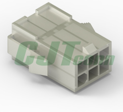

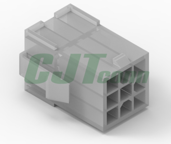

    间距P=4.14mm 胶壳 12(3x4)pin 600V 9A
C4140HM-3x4P 数据手册
C4140 SERIES 4.14mm pitch wire to wire and wire to board connector Specifications Current rating:9A AC,DC max Voltage rating:600V AC,DC Temperature range:-40°C~+105°C Contact resistance:20mΩ Max. Insulation resistance:1000MΩ Min. Withstanding voltage:1500V AC/minute *Compliant with RoHS and REACH* *Meet the HF/Halogen Free,GWT/Glow wire Test (IEC60335-1) request,need to customize* *Contact CJT for details* Standards E326732 16.00 5.35 1.60 3.35 B±0.10 38.10 REF. 14.94 WIRE TO WIRE PART NO. D±0.10 A±0.10 C±0.10 WIRE TO BOARD 3.64 1.60 2.65 1.60 27.10 REF. 38.10 REF. 16.00 14.94 28.66 REF. E326732 C4140HM-2P C4140HM-3P C4140HM-2x2P C4140HM-2x3P C4140HM-2x4P C4140HM-2x5P C4140HM-2x6P C4140HM-2x7P Dimensions A 10.70 10.70 14.90 19.10 23.30 27.50 31.70 35.90 B 6.15 6.15 10.35 14.55 18.75 22.95 27.15 31.35 C 2.50 4.60 2.50 2.50 2.50 2.50 2.50 2.50 D 10.35 14.55 10.35 10.35 10.35 10.35 10.35 10.35 PART NO. C4140HM-2x8P C4140HM-2x9P C4140HM-2x10P C4140HM-2x11P C4140HM-2x12P C4140HM-3x3P C4140HM-3x4P C4140HM-3x5P Dimensions A 40.10 44.30 48.50 52.70 56.90 19.10 23.30 27.50 B 35.55 39.75 43.95 48.15 52.35 14.55 18.75 22.95 C 2.50 2.50 2.50 2.50 2.50 4.60 4.60 4.60 D 10.35 10.35 10.35 10.35 10.35 14.55 14.55 14.55 Unit:mm CHANGJIANG CONNECTORS TEL:+86-755-29959119 29959129 FAX:+86-755-29959139 Http://www.CJT.cn C-113 C4140 SERIES 4.14mm pitch wire to wire and wire to board connector 180° Wafer 2P and 3P Circuit , Single Row 3x3P,3x4P and 3x5P Circuit , Triple Row 2x2P,2x3P,2x4P,2x5P and 2x6P Circuit , Dual Row 2x7P,2x8P,2x9P,2x10P,2x11P and 2x12P Circuit , Dual Row 90° Wafer 2P and 3P Circuit , Single Row 2x2P,2x3P,2x4P,2x5P and 2x6P Circuit , Dual Row 2x7P,2x8P,2x9P,2x10P,2x11P and 2x12P Circuit , Dual Row CHANGJIANG CONNECTORS TEL:+86-755-29959119 29959129 FAX:+86-755-29959139 Http://www.CJT.cn C-114 C4140 SERIES 4.14mm pitch wire to wire and wire to board connector C4140HF-2 2x5P 2x4P 2x8P 2x6P 2x9P 2x11P 2x7P 2x10P 2x12P C4140WV-2 2x8P 2x7P 2x10P 2x9P 2x11P 2x12P 2x8P 2x9P C4140WR-2 2x7P 2x10P 2x11P 2x12P CHANGJIANG CONNECTORS TEL:+86-755-29959119 29959129 FAX:+86-755-29959139 Http://www.CJT.cn C-115 C4140 SERIES C4140F-T 4.14mm pitch wire to wire and wire to board connector 4.14mm pitch Crimp Terminal Reference Informations: *Used in CJT C4140HF series Housing 0.86 3.80±0.25 A 11.25±0.25 3.00±0.25 2.20±0.25 SEC:A-A B 16.74±0.25 B 2.00 A 4.20±0.25 0.20 2.46±0.25 SEC:B-B Unit:mm Ordering information & Specifications: Wire Range Part NO. C4140F-TB C4140F-TP C4140F-GB C4140F-GP AWG#18-#22 AWG#18-#22 AWG#18-#22 AWG#18-#22 Material Brass Phosphor Bronze Insulation O.D. 2.40mm(max) 2.40mm(max) 2.40mm(max) 2.40mm(max) Brass Phosphor Bronze Finish Tin over Nickel Tin over Nickel Gold over Nickel Gold over Nickel Qty/reel 4,000 PCS 4,000 PCS 4,000 PCS 4,000 PCS Optional Gold plating available but MOQ requested C4140F-T-H 4.14mm pitch Crimp Terminal Reference Informations: *Used in CJT C4140HF series Housing 0.20 A B 2.77±0.25 3.00±0.25 11.25±0.25 SEC:A-A 16.74±0.25 B 2.00 A 4.95±0.25 0.86 4.30±0.25 3.18±0.25 SEC:B-B Unit:mm Ordering information & Specifications: Part NO. C4140F-TB-H C4140F-TP-H C4140F-GB-H C4140F-GP-H Wire Range AWG#16-#20 AWG#16-#20 AWG#16-#20 AWG#16-#20 Insulation O.D. 3.20mm(max) 3.20mm(max) 3.20mm(max) 3.20mm(max) Material Brass Phosphor Bronze Brass Phosphor Bronze Finish Tin over Nickel Tin over Nickel Gold over Nickel Gold over Nickel Qty/reel 4,000 PCS 4,000 PCS 4,000 PCS 4,000 PCS Optional Gold plating available but MOQ requested CHANGJIANG CONNECTORS TEL:+86-755-29959119 29959129 FAX:+86-755-29959139 Http://www.CJT.cn C-116 C4140 SERIES C4140F-T-L 4.14mm pitch wire to wire and wire to board connector 4.14mm pitch Crimp Terminal Reference Informations: *Used in CJT C4140HF series Housing A 11.25±0.25 3.00±0.25 1.83±0.25 SEC:A-A B 16.74±0.25 B 2.95±0.25 2.00 A 2.92±0.25 0.86 0.20 2.11±0.25 SEC:B-B Unit:mm Ordering information & Specifications: Wire Range Part NO. C4140F-TB-L C4140F-TP-L C4140F-GB-L C4140F-GP-L AWG#22-#26 AWG#22-#26 AWG#22-#26 AWG#22-#26 Material Brass Phosphor Bronze Insulation O.D. 1.75mm(max) 1.75mm(max) 1.75mm(max) 1.75mm(max) Brass Phosphor Bronze Qty/reel 5,000 PCS 5,000 PCS 5,000 PCS 5,000 PCS Finish Tin over Nickel Tin over Nickel Gold over Nickel Gold over Nickel Optional Gold plating available but MOQ requested C4140F-T-LL 4.14mm pitch Crimp Terminal Reference Informations: *Used in CJT C4140HF series Housing A SEC:A-A 1.37±0.25 3.00±0.25 11.25±0.25 B 16.74±0.25 B 2.67±0.25 2.00 A 1.93±0.25 0.86 0.20 1.57±0.25 SEC:B-B Unit:mm Ordering information & Specifications: Part NO. C4140F-TB-LL C4140F-TP-LL C4140F-GB-LL C4140F-GP-LL Wire Range AWG#26-#30 AWG#26-#30 AWG#26-#30 AWG#26-#30 Insulation O.D. 1.00mm(max) 1.00mm(max) 1.00mm(max) 1.00mm(max) Material Brass Phosphor Bronze Brass Phosphor Bronze Finish Tin over Nickel Tin over Nickel Gold over Nickel Gold over Nickel Qty/reel 4,000 PCS 4,000 PCS 4,000 PCS 4,000 PCS Optional Gold plating available but MOQ requested CHANGJIANG CONNECTORS TEL:+86-755-29959119 29959129 FAX:+86-755-29959139 Http://www.CJT.cn C-117 C4140 SERIES C4140M-T 4.14mm pitch wire to wire and wire to board connector 4.14mm pitch Crimp Terminal Reference Informations: *Used in CJT C4140HM series Housing 0.86 3.80±0.25 A 11.56±0.20 3.08±0.25 2.20±0.25 SEC:A-A B 17.05±0.25 B 2.00 A 4.20±0.25 0.20 2.46±0.25 SEC:B-B 0.99±0.10 Unit:mm Ordering information & Specifications: Wire Range Part NO. C4140M-TB C4140M-TP C4140M-GB C4140M-GP AWG#18-#22 AWG#18-#22 AWG#18-#22 AWG#18-#22 Material Brass Phosphor Bronze Insulation O.D. 2.40mm(max) 2.40mm(max) 2.40mm(max) 2.40mm(max) Brass Phosphor Bronze Finish Tin over Nickel Tin over Nickel Gold over Nickel Gold over Nickel Qty/reel 4,000 PCS 4,000 PCS 4,000 PCS 4,000 PCS Optional Gold plating available but MOQ requested C4140M-T-H 4.14mm pitch Crimp Terminal Reference Informations: *Used in CJT C4140HM series Housing 0.86 4.30±0.25 A B 3.18±0.25 SEC:B-B 0.99±0.10 Unit:mm Ordering information & Specifications: Part NO. C4140M-TB-H C4140M-TP-H C4140M-GB-H C4140M-GP-H Wire Range AWG#16-#20 AWG#16-#20 AWG#16-#20 AWG#16-#20 2.77±0.25 3.08±0.25 11.56±0.20 SEC:A-A 17.05±0.25 B 2.00 A 4.95±0.25 0.20 Insulation O.D. 3.20mm(max) 3.20mm(max) 3.20mm(max) 3.20mm(max) Material Brass Phosphor Bronze Brass Phosphor Bronze Finish Tin over Nickel Tin over Nickel Gold over Nickel Gold over Nickel Qty/reel 4,000 PCS 4,000 PCS 4,000 PCS 4,000 PCS Optional Gold plating available but MOQ requested CHANGJIANG CONNECTORS TEL:+86-755-29959119 29959129 FAX:+86-755-29959139 Http://www.CJT.cn C-118 C4140 SERIES C4140M-T-L 4.14mm pitch wire to wire and wire to board connector 4.14mm pitch Crimp Terminal Reference Informations: *Used in CJT C4140HM series Housing A 11.56±0.20 3.08±0.25 1.83±0.25 SEC:A-A B 17.05±0.25 B 2.95±0.25 2.00 A 2.92±0.25 0.86 0.20 2.11±0.25 SEC:B-B 0.99±0.10 Unit:mm Ordering information & Specifications: Wire Range Part NO. C4140M-TB-L C4140M-TP-L C4140M-GB-L C4140M-GP-L AWG#22-#26 AWG#22-#26 AWG#22-#26 AWG#22-#26 Material Brass Phosphor Bronze Insulation O.D. 1.75mm(max) 1.75mm(max) 1.75mm(max) 1.75mm(max) Brass Phosphor Bronze Qty/reel 4,000 PCS 4,000 PCS 4,000 PCS 4,000 PCS Finish Tin over Nickel Tin over Nickel Gold over Nickel Gold over Nickel Optional Gold plating available but MOQ requested C4140M-T-LL 4.14mm pitch Crimp Terminal Reference Informations: *Used in CJT C4140HM series Housing A SEC:A-A 1.37±0.25 3.08±0.25 11.56±0.20 B 17.05±0.25 B 2.67±0.25 2.00 A 1.93±0.25 0.86 0.20 1.57±0.25 SEC:B-B 0.99±0.10 Unit:mm Ordering information & Specifications: Part NO. C4140M-TB-LL C4140M-TP-LL C4140M-GB-LL C4140M-GP-LL Wire Range AWG#26-#30 AWG#26-#30 AWG#26-#30 AWG#26-#30 Insulation O.D. 1.00mm(max) 1.00mm(max) 1.00mm(max) 1.00mm(max) Material Brass Phosphor Bronze Brass Phosphor Bronze Finish Tin over Nickel Tin over Nickel Gold over Nickel Gold over Nickel Qty/reel 4,000 PCS 4,000 PCS 4,000 PCS 4,000 PCS Optional Gold plating available but MOQ requested CHANGJIANG CONNECTORS TEL:+86-755-29959119 29959129 FAX:+86-755-29959139 Http://www.CJT.cn C-119 C4140 SERIES C4140H 4.14mm pitch wire to wire and wire to board connector 4.20mm Pitch Housing Ordering Information: C4140HF/HM(A)-XP - *** 1 2 1.Part No. 2.Material: (blank):Nylon 66,UL94V-2/Natural V0:Nylon 66,UL94V-0/White GWT:Nylon 66,UL94V-0,GWT 750°C Reference Informations: *Material:Nylon 66,UL94V-2 or UL94V-0 *C4140HM(Suitable Terminal: C4140M-T(-H/-L/-LL) ) *C4140HF(Suitable Terminal: C4140F-T(-H/-L/-LL) ) C4140HM(A) 24.00±0.25 C4140HM-2P 9.30±0.20 23.70±0.25 6.90±0.25 5.60±0.25 5.60±0.25 C4140HF-1P 8.20±0.25 5.60±0.20 C4140HF 5.60±0.20 C4140HM-1P Unit: mm C4140HF-2P 24.00±0.25 Circuit 1 5.60±0.25 Circuit 1 4.20±0.10 9.80±0.25 12.40±0.25 5.60±0.25 18.80±0.20 24.00±0.25 9.30±0.20 4.20±0.10 C4140HMA-2P 10.80±0.25 15.00±0.20 9.80±0.25 4.20±0.10 9.80±0.25 11.80±0.25 Circuit 1 23.70±0.25 5.60±0.20 C4140HM-3P C4140HF-3P 14.00±0.25 16.00±0.25 Circuit 1 C4140HMA-3P 15.00±0.25 24.00±0.25 5.60±0.25 14.00±0.25 15.00±0.20 4.20±0.10 Circuit 1 4.20±0.10 18.70±0.20 23.70±0.25 4.20±0.10 5.60±0.20 14.00±0.25 16.60±0.25 Circuit 1 9.30±0.20 23.70±0.25 5.60±0.20 CHANGJIANG CONNECTORS TEL:+86-755-29959119 29959129 FAX:+86-755-29959139 Http://www.CJT.cn C-120 C4140 SERIES C4140H 4.14mm pitch wire to wire and wire to board connector 4.20mm Pitch Housing Ordering Information: C4140HF/HM(A)-2xXP - *** 1 2 1.Part No. 2.Material: (blank):Nylon 66,UL94V-2/Natural V0:Nylon 66,UL94V-0/White GWT:Nylon 66,UL94V-0,GWT 750°C Reference Informations: *Material:Nylon 66,UL94V-2 or UL94V-0 *C4140HM(Suitable Terminal: C4140M-T(-H/-L/-LL) ) *C4140HF(Suitable Terminal: C4140F-T(-H/-L/-LL) ) *Color:Natural Ordering Information: C4140HF/HM(A)-3xXP - *** 1 2 1.Part No. 2.Material: (blank):Nylon 66,UL94V-2/Natural V0:Nylon 66,UL94V-0/White GWT:Nylon 66,UL94V-0,GWT 750°C Unit: mm C4140HM(A) C4140HF C4140HM-2x2P C4140HF-2x2P 9.80±0.20 Circuit 1 15.00±0.20 24.00±0.25 9.80±0.20 4.20±0.10 11.80±0.25 Circuit 2 4.20±0.10 Circuit 1 Circuit 2 4.20±0.10 Last Circuit 4.20±0.10 11.74±0.25 C4140HMA-2x2P 9.80±0.20 Circuit 1 9.80±0.20 4.20±0.10 11.80±0.25 Circuit 2 24.30±0.25 Circuit 4 14.55±0.20 23.85±0.25 9.74±0.25 4.20±0.10 Last Circuit C4140HM-2x3P C4140HF-2x3P 14.00±0.20 Circuit 2 9.80±0.20 15.00±0.20 4.20±0.10 11.80±0.25 Circuit 1 4.20±0.10 Last Circuit 24.00±0.25 Circuit 1 Circuit 3 11.74±0.25 14.00±0.20 Circuit 2 4.20±0.10 Circuit 1 9.80±0.20 11.80±0.25 4.20±0.10 C4140HMA-2x3P Circuit 6 4.20±0.10 14.55±0.20 23.85±0.25 8.40±0.20 13.88±0.25 23.70±0.25 4.20±0.10 Last Circuit CHANGJIANG CONNECTORS TEL:+86-755-29959119 29959129 FAX:+86-755-29959139 Http://www.CJT.cn C-121 C4140 SERIES C4140H 4.14mm pitch wire to wire and wire to board connector 4.20mm Pitch Housing Unit: mm 8.40±0.20 C4140HF Circuit 2 C4140HF-3x3P Circuit 1 14.00±0.25 4.20±0.10 8.40±0.20 24.00±0.25 8.40±0.20 14.00±0.25 4.20±0.10 23.85±0.25 14.00±0.25 4.20±0.10 14.00±0.20 18.20±0.25 Circuit 2 Circuit 1 Last Circuit C4140HF-3x4P 4.20±0.10 15.00±0.20 12.60±0.20 24.00±0.25 4.20±0.10 8.40±0.20 14.00±0.25 4.20±0.10 Last Circuit Circuit 4 16.00±0.25 Circuit 2 Circuit 1 14.00±0.25 18.20±0.35 16.00±0.25 4.20±0.10 8.40±0.20 Circuit 1 C4140HMA-3x4P 24.20±0.35 14.55±0.20 8.40±0.20 14.00±0.25 C4140HM-3x4P 16.00±0.25 4.20±0.10 Last Circuit 8.40±0.20 24.30±0.25 Circuit 3 Circuit 1 Circuit 2 Circuit 1 16.00±0.25 8.40±0.20 C4140HMA-3x3P 4.20±0.10 14.00±0.25 16.00±0.25 Last Circuit 4.20±0.10 15.00±0.20 14.00±0.25 16.00±0.25 C4140HM-3x3P 4.20±0.10 C4140HM(A) Last Circuit 4.20±0.10 12.60±0.20 14.40±0.30 24.20±0.35 18.50±0.35 4.20±0.10 22.40±0.25 Circuit 2 Circuit 1 C4140HF-3x5P 14.00±0.25 16.00±0.25 C4140HM-3x5P 8.40±0.20 12.60±0.20 4.20±0.10 15.00±0.20 24.00±0.25 Last Circuit 16.80±0.20 Circuit 5 24.20±0.35 Last Circuit 16.00±0.25 14.00±0.25 8.40±0.20 4.20±0.10 4.20±0.10 Circuit 2 Circuit 1 14.00±0.25 4.20±0.10 22.40±0.35 16.00±0.25 C4140HMA-3x5P 8.40±0.20 Circuit 1 Last Circuit 4.20±0.10 14.40±0.30 24.20±0.35 16.80±0.20 22.65±0.35 16.80±0.20 CHANGJIANG CONNECTORS TEL:+86-755-29959119 29959129 FAX:+86-755-29959139 Http://www.CJT.cn C-122 C4140 SERIES C4140WV and WR 4.14mm pitch wire to wire and wire to board connector 4.14mm Pitch Wafer Ordering Information: C4140WV/WR-XP - *** - *** 1 2 3 1.Part No. 2.Material: (blank):Nylon 66,UL94V-0 GWT:Nylon 66,UL94V-0,GWT 750°C 3.Finish: (blank):Tin over Nickel G:Gold-flash G15:15μin (0.38μm) MIN.Select Gold(Mating Area) 100μin (2.54μm) MIN.Select Tin G30:30μin (0.76μm) MIN.Select Gold(Mating Area) 100μin (2.54μm) MIN.Select Tin Reference Informations: *Material:Pin:Brass/Tin over Nickel or Gold over Nickel Insulator:Nylon 66,UL94V-0 *Mates with CJT C4140HF series Housing *Color:White 180° Wafer Unit: mm 90° Wafer A±0.10 4.14 C4140WV-2x3P C4140WR-2x3P 8.28 C4140WV-2x4P C4140WR-2x4P 14.42 C4140WV-2x5P C4140WR-2x5P 16.56 C4140WV-2x6P C4140WR-2x6P 20.70 ∅1.40±0.10 ∅3.18±0.10 4.14±0.10 ∅1.40±0.10 A±0.10 P.C.B LAYOUT C4140WV(2x2P.....2x6P) 4.14±0.10 Dim.A 4.14±0.10 7.34±0.10 4.45±0.10 5.33 PART NO. C4140WV-2x2P C4140WR-2x2P 4.14±0.10 Dimensions: ∅3.86±0.10 P.C.B LAYOUT C4140WR(2x2P.....2x6P) C4140WV C4140WR C4140WR-2P Circuit 1 7.77±0.20 ∅3.18±0.10 ∅1.40±0.05 P.C.B LAYOUT 4.14±0.10 5.33 7.34±0.10 4.14±0.10 4.45±0.10 4.14±0.10 2.07±0.10 5.72±0.20 13.68±0.25 6.35±0.20 C4140WV-2P ∅1.40±0.05 4.14±0.10 ∅3.86±0.05 Circuit 1 P.C.B LAYOUT 5.59±0.25 11.16±0.25 6.00±0.20 12.70±0.25 17.94±0.25 13.49±0.20 9.86±0.20 ∅1.00±0.05 ∅1.00±0.05 9.83±0.25 3.68±0.20 CHANGJIANG CONNECTORS TEL:+86-755-29959119 29959129 FAX:+86-755-29959139 Http://www.CJT.cn C-123 C4140 SERIES C4140WV and WR 4.14mm pitch wire to wire and wire to board connector 4.14mm Pitch Wafer Ordering Information: C4140WV/WR-2xXP - *** - *** 1 2 3 1.Part No. 2.Material: (blank):Nylon 66,UL94V-0 GWT:Nylon 66,UL94V-0,GWT 750°C 3.Finish: (blank):Tin over Nickel G:Gold-flash G15:15μin (0.38μm) MIN.Select Gold(Mating Area) 100μin (2.54μm) MIN.Select Tin G30:30μin (0.76μm) MIN.Select Gold(Mating Area) 100μin (2.54μm) MIN.Select Tin Reference Informations: *Material:Pin:Brass/Tin over Nickel or Gold over Nickel Insulator:Nylon 66,UL94V-0 *Mates with CJT C4140HF series Housing *Color:White C4140WV Unit: mm C4140WR ∅3.18±0.10 ∅1.40 4.45±0.10 4.14±0.10 Circuit 1 P.C.B LAYOUT 8.28±0.20 4.14±0.10 5.33 7.34±0.10 4.14±0.10 7.77±0.20 17.82±0.25 5.72±0.20 C4140WR-3P 6.35±0.20 C4140WV-3P 4.14±0.10 Circuit 1 8.28±0.20 ∅1.40±0.05 ∅3.86±0.05 4.14±0.10 P.C.B LAYOUT 5.59±0.25 13.97±0.25 5.99±0.20 ∅1.00±0.05 12.70±0.25 17.94±0.25 13.49±0.20 15.30±0.25 14.00±0.20 ∅1.00±0.05 3.68±0.20 C4140WR-2x2P Circuit 2 4.14±0.10 Circuit 1 4.14±0.10 9.83±0.25 ∅1.00±0.05 ∅1.00±0.05 14.25±0.25 13.49±0.25 6.00±0.20 12.70±0.25 9.83±0.20 9.83±0.25 4.45±0.20 Circuit 2 18.80±0.25 Circuit 1 Last Circuit 9.80±0.20 11.89±0.25 Last Circuit 11.85±0.25 4.14±0.10 15.01±0.25 4.14±0.10 C4140WV-2x2P 3.68±0.20 CHANGJIANG CONNECTORS TEL:+86-755-29959119 29959129 FAX:+86-755-29959139 Http://www.CJT.cn C-124 C4140 SERIES C4140WV and WR 4.14mm pitch wire to wire and wire to board connector 4.14mm Pitch Wafer Ordering Information: C4140WV/WR-2xXP - *** - *** 1 2 3 1.Part No. 2.Material: (blank):Nylon 66,UL94V-0 GWT:Nylon 66,UL94V-0,GWT 750°C 3.Finish: (blank):Tin over Nickel G:Gold-flash G15:15μin (0.38μm) MIN.Select Gold(Mating Area) 100μin (2.54μm) MIN.Select Tin G30:30μin (0.76μm) MIN.Select Gold(Mating Area) 100μin (2.54μm) MIN.Select Tin Reference Informations: *Material:Pin:Brass/Tin over Nickel or Gold over Nickel Insulator:Nylon 66,UL94V-0 *Mates with CJT C4140HF series Housing *Color:White C4140WV C4140WR C4140WR-2x3P Circuit 1 4.14±0.10 Circuit 2 8.28±0.20 9.83±0.20 11.85±0.25 13.97±0.25 6.00±0.20 18.80±0.25 14.25±0.25 13.49±0.25 4.45±0.20 13.97±0.25 4.14±0.10 8.28±0.20 ∅1.00±0.05 ∅1.00±0.05 Circuit 1 Last Circuit 12.70±0.25 11.89±0.25 Last Circuit 9.80±0.20 4.14±0.10 19.15±0.25 4.14±0.10 C4140WV-2x3P Circuit 2 Unit: mm 3.68±0.20 C4140WV-2x4P C4140WR-2x4P 9.80±0.20 Last Circuit Circuit 1 9.83±0.20 12.42±0.20 18.11±0.25 6.00±0.20 18.80±0.25 14.25±0.25 13.49±0.25 4.45±0.20 18.11±0.25 4.14±0.10 ∅1.00±0.05 ∅1.00±0.05 Circuit 2 12.42±0.20 12.70±0.25 4.14±0.10 Circuit 1 11.85±0.25 4.14±0.10 11.89±0.25 Last Circuit Circuit 2 4.14±0.10 23.27±0.25 3.68±0.20 CHANGJIANG CONNECTORS TEL:+86-755-29959119 29959129 FAX:+86-755-29959139 Http://www.CJT.cn C-125 C4140 SERIES C4140WV and WR 4.14mm pitch wire to wire and wire to board connector 4.14mm Pitch Wafer Ordering Information: C4140WV/WR-2xXP - *** - *** 1 2 3 1.Part No. 2.Material: (blank):Nylon 66,UL94V-0 GWT:Nylon 66,UL94V-0,GWT 750°C 3.Finish: (blank):Tin over Nickel G:Gold-flash G15:15μin (0.38μm) MIN.Select Gold(Mating Area) 100μin (2.54μm) MIN.Select Tin G30:30μin (0.76μm) MIN.Select Gold(Mating Area) 100μin (2.54μm) MIN.Select Tin Reference Informations: *Material:Pin:Brass/Tin over Nickel or Gold over Nickel Insulator:Nylon 66,UL94V-0 *Mates with CJT C4140HF series Housing *Color:White C4140WV C4140WR C4140WR-2x5P 4.14±0.10 27.41±0.25 9.80±0.20 Last Circuit Circuit 1 Circuit 2 4.14±0.10 16.56±0.20 16.56±0.20 22.25±0.25 ∅1.00±0.05 14.25±0.25 13.49±0.25 4.45±0.20 6.00±0.20 12.70±0.25 9.83±0.20 22.25±0.25 18.80±0.25 3.68±0.20 ∅1.00±0.05 C4140WR-2x6P 4.14±0.10 31.55±0.25 Circuit 1 Circuit 2 9.80±0.20 4.14±0.10 20.70±0.20 20.70±0.20 26.39±0.25 9.83±0.20 14.25±0.25 13.49±0.25 4.45±0.20 26.39±0.25 6.00±0.20 12.70±0.25 Circuit 2 4.14±0.10 Last Circuit 18.80±0.25 Circuit 1 4.14±0.10 11.89±0.25 Last Circuit 11.85±0.25 C4140WV-2x6P ∅1.00±0.05 Circuit 2 4.14±0.10 4.14±0.10 11.89±0.25 Last Circuit 11.85±0.25 C4140WV-2x5P Circuit 1 Unit: mm 3.68±0.20 ∅1.00±0.05 CHANGJIANG CONNECTORS TEL:+86-755-29959119 29959129 FAX:+86-755-29959139 Http://www.CJT.cn C-126 C4140 SERIES C4140WV 4.14mm pitch wire to wire and wire to board connector 4.14mm Pitch Wafer Ordering Information: C4140WV/WR-3xXP - *** - *** 1 2 3 1.Part No. 2.Material: (blank):Nylon 66,UL94V-0 GWT:Nylon 66,UL94V-0,GWT 750°C 3.Finish: (blank):Tin over Nickel G:Gold-flash G15:15μin (0.38μm) MIN.Select Gold(Mating Area) 100μin (2.54μm) MIN.Select Tin G30:30μin (0.76μm) MIN.Select Gold(Mating Area) 100μin (2.54μm) MIN.Select Tin Reference Informations: *Material:Pin:Brass/Tin over Nickel or Gold over Nickel Insulator:Nylon 66,UL94V-0 *Mates with CJT C4140HF series Housing *Color:White Unit: mm C4140WV C4140WV-3x3P 4.14±0.10 8.28±0.20 16.06±0.25 4.14±0.10 ∅3.18±0.10 ∅1.40±0.05 4.45±0.10 Circuit 2 Circuit 1 4.14±0.10 4.14±0.10 19.15±0.25 Last Circuit P.C.B LAYOUT 8.28±0.20 14.00±0.25 14.25±0.25 4.45±0.20 13.49±0.25 14.00±0.25 ∅1.00±0.10 C4140WV-3x4P 23.29±0.25 Last Circuit Circuit 2 4.14±0.10 ∅3.18±0.10 4.14±0.10 Circuit 1 4.14±0.10 8.28±0.20 16.06±0.25 4.14±0.10 4.45±0.10 ∅1.40±0.05 P.C.B LAYOUT 12.42±0.20 14.00±0.25 14.25±0.25 4.45±0.20 13.49±0.25 18.14±0.25 ∅1.00±0.10 CHANGJIANG CONNECTORS TEL:+86-755-29959119 29959129 FAX:+86-755-29959139 Http://www.CJT.cn C-127 C4140 SERIES C4140WV 4.14mm pitch wire to wire and wire to board connector 4.14mm Pitch Wafer Unit: mm C4140WV C4140WV-3x5P 27.43±0.25 Last Circuit 4.14±0.10 Circuit 2 Ø3.18±0.10 4.14±0.10 Circuit 1 4.14±0.10 8.28±0.20 16.06±0.25 4.14±0.10 Ø1.40±0.05 4.45±0.10 P.C.B LAYOUT 16.56±0.20 14.00±0.25 14.25±0.25 4.45±0.20 13.49±0.25 22.28±0.25 Ø1.00±0.10 C4140HS-3xXP 4.14mm Pitch Triple Row CAP CABLE CLAMP Reference Informations: *Material:Nylon 66,UL94V-0 *Insulation Dia Range:Ø5.5~Ø7.0 *Screws:Cross-Recessed Head Machine Screws M2.6 L10 *Nuts:Hexagon Nuts M2.6 *Mates with CJT C4140HM-3x3P ,C4140HM-3x5P series Housing *Color:Black 27.50±0.25 15.20±0.25 23.60±0.25 5.20±0.20 28.60±0.25 19.50±0.25 Ø2.60 Ø2.60 3x3P 3x5P 6.10±0.20 9.10±0.25 CHANGJIANG CONNECTORS TEL:+86-755-29959119 29959129 FAX:+86-755-29959139 Http://www.CJT.cn C-128 C4140 SERIES C4140HF-2xXP 4.14mm pitch wire to wire and wire to board connector 4.14mm Pitch Dual Row Housing Reference Informations: *Material:Nylon 66,UL94V-0 *Suitable CJT C4140F-T(-H/-L/-LL) series Terminal *Mates with CJT C4140HM(A)-2xXP series dual row Housing and C4140WV,WR-2xXP series dual row Wafer *Color:White 4.14±0.10 Ordering Information: C4140HF-2xXP - *** 1 2 1.Part No. 2.Material: (blank):Nylon 66,UL94V-0/White GWT:Nylon 66,UL94V-0,GWT 750°C 9.80±0.20 Last Circuit 4.14±0.10 A±0.20 Circuit 1 Circuit 2 B±0.35 Ordering Information & Dimensions: 14.40±0.20 24.00±0.25 PART NO. 11.80±0.25 2x4P 2x5P 2x6P 2x7P 2x8P 2x9P 2x10P 2x11P 2x12P Dimensions A B 18.47 12.42 16.56 22.61 20.70 26.75 24.84 30.89 28.98 35.03 33.12 39.17 37.26 43.31 41.40 47.45 45.54 51.59 Unit: mm C4140HM(A)-2xXP 4.14mm Pitch Dual Row Housing Reference Informations: *Material:Nylon 66,UL94V-0 *Suitable CJT C4140M-T(-H/-L/-LL) series Terminal *Mates with CJT C4140HF-2xXP series dual row Housing *Color:Natural A±0.20 Circiut 2 Circiut 1 4.14±0.10 9.80±0.20 4.14±0.10 Last Circuit Circiut 2 Circiut 1 4.14±0.10 Last Circuit 9.80±0.20 A±0.20 4.14±0.10 Ordering Information: C4140HM(A)-2xXP - *** 1 2 1.Part No. 2.Material: (blank):Nylon 66,UL94V-0/White GWT:Nylon 66,UL94V-0,GWT 750°C B±0.25 Ordering Information & Dimensions: PART NO. 23.70±0.25 15.00±0.20 24.00±0.25 B±0.25 11.80±0.25 C4140HM 11.80±0.25 C4140HMA 2x4P 2x5P 2x6P 2x7P 2x8P 2x9P 2x10P 2x11P 2x12P Dimensions A B 18.20 12.42 16.56 22.40 20.70 26.60 24.84 30.80 28.98 35.00 33.12 39.20 37.26 43.40 41.40 47.60 45.54 51.80 Unit: mm CHANGJIANG CONNECTORS TEL:+86-755-29959119 29959129 FAX:+86-755-29959139 Http://www.CJT.cn C-129 C4140 SERIES C4140WV-2xXP 4.20mm pitch 180° Dual Row Wafer Reference Informations: *Material:Pin:Brass/Tin over Nickel Insulator:Nylon 66,UL94V-0 *Mates with CJT C4140HF-2xXP series dual row Housing *Color:White 4.14±0.10 A±0.20 4.14±0.10 4.14mm pitch wire to wire and wire to board connector Last Circuit Ordering Information: C4140WV-2xXP - *** - *** 1 2 3 1.Part No. 2.Material: (blank):Nylon 66,UL94V-0 GWT:Nylon 66,UL94V-0,GWT 750°C 3.Finish: (blank):Tin over Nickel G:Gold-flash G15:15μin (0.38μm) MIN.Select Gold(Mating Area) 100μin (2.54μm) MIN.Select Tin G30:30μin (0.76μm) MIN.Select Gold(Mating Area) 100μin (2.54μm) MIN.Select Tin 4.45±0.10 ∅1.40±0.10 4.45±0.10 ∅3.18±0.10 P.C.B LAYOUT Ordering Information & Dimensions: 18.00±0.25 18.50±0.25 13.50±0.20 9.75±0.25 B±0.35 4.14±0.10 4.14±0.10 Circuit 2 Circuit 1 A±0.20 Dimensions A B 24.84 30.56 28.98 34.70 33.12 38.84 37.26 42.98 41.40 47.12 45.54 51.26 PART NO. 2x7P 2x8P 2x9P 2x10P 2x11P 2x12P 1.00±0.05 Unit: mm C4140WR-2xXP 4.14mm pitch 90° Dual Row Wafer 9.80±0.20 4.14±0.10 C±0.10 P.C.B LAYOUT 4.14±0.10 6.00±0.20 B±0.35 Ordering Information: C4140WR-2xXP - *** - *** 1 2 3 1.Part No. 2.Material: (blank):Nylon 66,UL94V-0 GWT:Nylon 66,UL94V-0,GWT 750°C 3.Finish: (blank):Tin over Nickel G:Gold-flash G15:15μin (0.38μm) MIN.Select Gold(Mating Area) 100μin (2.54μm) MIN.Select Tin G30:30μin (0.76μm) MIN.Select Gold(Mating Area) 100μin (2.54μm) MIN.Select Tin Ordering Information & Dimensions: 12.70±0.25 18.90±0.25 0.76 PART NO. 1.00±0.05 Circuit 2 Circuit 1 A±0.20 11.85±0.25 4.14±0.10 Last Circuit ∅1.40±0.10 ∅3.86±0.10 5.33 ∅1.00 A±0.20 4.14±0.10 7.34±0.10 Reference Informations: *Material:Pin:Brass/Tin over Nickel Insulator:Nylon 66,UL94V-0 *Mates with CJT C4140HF-2xXP series dual row Housing *Color:White 3.68±0.20 2x7P 2x8P 2x9P 2x10P 2x11P 2x12P A 24.84 28.98 33.12 37.26 41.40 45.54 Dimensions B 30.56 34.70 38.84 42.98 47.12 51.26 C 8.28 10.35 10.35 10.35 10.35 10.35 Unit: mm CHANGJIANG CONNECTORS TEL:+86-755-29959119 29959129 FAX:+86-755-29959139 Http://www.CJT.cn C-130
