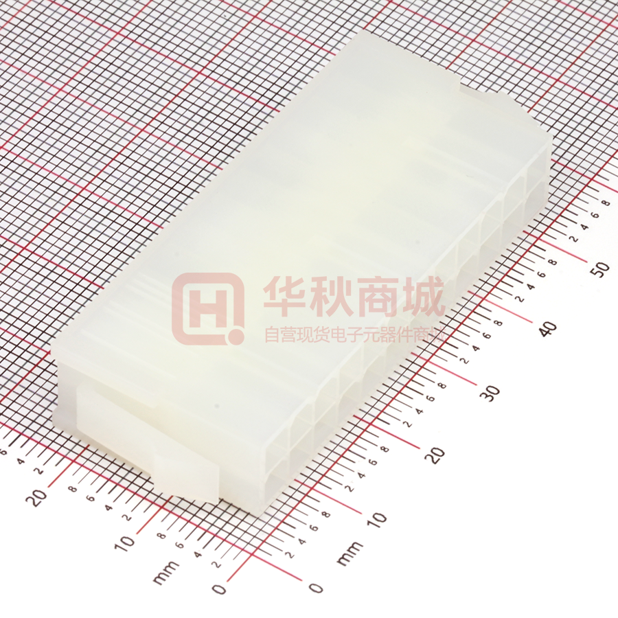

    间距P=4.20mm 胶壳 24(2x12)pin 600V 9A
C4201HM-2x12P 数据手册
C4201 SERIES 4.20mm pitch wire to wire and wire to board connector Specifications Standards Current rating:9A AC,DC Max Voltage rating:600V AC,DC Temperature range:-40°C~+105°C E326732 Contact resistance:10mΩ Max. Insulation resistance:1000MΩ Min. Withstanding voltage:1500V AC/minute *Compliant with RoHS and REACH* *Meet the HF/Halogen Free,GWT/Glow wire Test (IEC60335-1) request,need to customize* *Contact CJT for details* 4.00±0.20 PART NO. DUAL ROW B±0.10 SINGLE ROW RECOMMENDED PANEL CUT-OUT RECOMMENDED PANEL CUT-OUT (DESIGNED FOR 0.80mm TO 2.00mm THICK STAMPED PANEL OR PRINTED CIRCUIT BOARD) (DESIGNED FOR 0.80mm TO 2.00mm THICK STAMPED PANEL OR PRINTED CIRCUIT BOARD) 7.40±0.10 A±0.10 5.80±0.10 3.30±0.10 B±0.10 10.00±0.20 1.60±0.10 5.60±0.10 4.00±0.20 A±0.10 E326732 SINGLE ROW --------------C4201HM-2P C4201HM-3P C4201HM-4P C4201HM-5P C4201HM-6P C4201HM-7P C4201HM-8P C4201HM-9P C4201HM-10P C4201HM-11P C4201HM-12P DUAL ROW C4201HM-2x1P C4201HM-2x2P C4201HM-2x3P C4201HM-2x4P C4201HM-2x5P C4201HM-2x6P C4201HM-2x7P C4201HM-2x8P C4201HM-2x9P C4201HM-2x10P C4201HM-2x11P C4201HM-2x12P Dimensions A 5.80 10.00 14.20 18.40 22.60 26.80 31.00 35.20 39.40 43.60 47.80 52.00 CHANGJIANG CONNECTORS TEL:+86-755-29959119 29959129 FAX:+86-755-29959139 Http://www.CJT.cn C-131 B 10.80 15.00 19.20 23.40 27.60 31.80 36.00 40.20 44.40 48.60 52.80 57.00 Unit:mm C4201 SERIES 4.20mm pitch wire to wire and wire to board connector 7.50 WIRE TO WIRE 7.50 11.70 34.80 REF. 34.70 REF. 34.80 REF. Dual Row Single Row WIRE TO BOARD 7.50 23.95 REF. 7.50 1.60 1.60 1.90 23.50 REF. 2.00 7.50 24.25 REF. 2.00 1.60 23.50 REF. Single Row: 2P,4P,5P-12P 7.50 2.00 1.90 7.50 24.25 REF. 24.25 REF. 1.60 25.05 REF. 2.00 1.60 23.95 REF. 2.00 1.60 25.05 REF. 2.00 1.60 7.50 2.00 7.50 1.60 7.50 Single Row: 3P WIRE TO BOARD 1.60 7.50 25.05 REF. 2.00 1.60 7.50 1.60 11.70 WIRE TO BOARD Dual Row: 2x1P-2x12P 2.00 30.20 REF. 11.70 11.70 1.90 23.60 REF. 1.60 1.90 23.60 REF. 2.00 1.60 2.00 23.60 REF. 1.60 30.20 REF. 1.60 30.20 REF. 11.70 2.00 1.60 11.70 11.70 CHANGJIANG CONNECTORS TEL:+86-755-29959119 29959129 FAX:+86-755-29959139 Http://www.CJT.cn C-132 C4201 SERIES C4201HF 4.20mm pitch wire to wire and wire to board connector C4201HM C4201HF C4201HM C4201HMA 2P 2P 1 2 3P 1 2 3 4P 1 2 3 4 5P 1 2 3 4 5 6P 1 2 3 4 5 3P 4P 5P 6 C4201WV C4201WVA-F C4201WV 6P C4201WR C4201WR-E C4201WVA-F C4201WR 2P 2P 3P 3P 4P 4P 5P 5P 6P 6P C4201WR-E CHANGJIANG CONNECTORS TEL:+86-755-29959119 29959129 FAX:+86-755-29959139 Http://www.CJT.cn C-133 C4201 SERIES 4.20mm pitch wire to wire and wire to board connector C4201HF-2 2x1P 2x2P 2 13 14 15 16 17 18 19 20 21 22 23 24 1 1 2 3 4 5 6 7 8 9 10 11 12 3 4 12 13 14 15 16 17 18 19 20 21 22 1 2 1 2 3 4 5 6 7 8 9 10 11 4 5 6 11 12 13 14 15 16 17 18 19 20 1 2 3 1 2 3 4 5 6 7 8 9 10 5 6 7 8 10 11 12 13 14 15 16 17 18 1 2 3 4 1 2 3 4 5 6 7 8 9 6 7 8 9 10 9 10 11 12 13 14 15 16 1 2 3 4 5 1 2 3 4 5 6 7 8 7 8 9 10 11 12 8 9 10 11 12 13 14 1 2 3 4 5 6 1 2 3 4 5 6 7 2x12P 2x11P C4201HF-2 2x3P 2x4P 2x5P 2x6P 2x10P 2x9P 2x8P 2x7P C4201HM-2 C4201HMA-2 2x1P 2x2P 2x3P 1 1 2 3 4 5 6 7 8 9 10 11 12 2 13 14 15 16 17 18 19 20 21 22 23 24 1 2 1 2 3 4 5 6 7 8 9 10 11 3 4 12 13 14 15 16 17 18 19 20 21 22 1 2 3 1 2 3 4 5 6 7 8 9 10 4 5 6 11 12 13 14 15 16 17 18 19 20 2x12P 2x11P 2x10P C4201HM-2 2x4P 2x5P 2x6P C4201HMA-2 1 2 3 4 1 2 3 4 5 6 7 8 9 5 6 7 8 10 11 12 13 14 15 16 17 18 1 2 3 4 5 1 2 3 4 5 6 7 8 6 7 8 9 10 9 10 11 12 13 14 15 16 1 2 3 4 5 6 1 2 3 4 5 6 7 7 8 9 10 11 12 8 9 10 11 12 13 14 2x9P 2x8P 2x7P CHANGJIANG CONNECTORS TEL:+86-755-29959119 29959129 FAX:+86-755-29959139 Http://www.CJT.cn C-134 C4201 SERIES 4.20mm pitch wire to wire and wire to board connector C4201WV-2 C4201WVA-2 C4201WVA-F-2 2x1P 1 1 2 3 4 5 6 7 8 9 10 11 12 2 13 14 15 16 17 18 19 20 21 22 23 24 2x12P C4201WV-2 2x2P C4201WVA-2 2x3P 2x4P 1 2 1 2 3 4 5 6 7 8 9 10 11 3 4 12 13 14 15 16 17 18 19 20 21 22 1 2 3 1 2 3 4 5 6 7 8 9 10 4 5 6 11 12 13 14 15 16 17 18 19 20 1 2 3 4 1 2 3 4 5 6 7 8 9 5 6 7 8 10 11 12 13 14 15 16 17 18 2x11P 2x10P 2x9P C4201WVA-F-2 2x5P 2x6P 1 2 3 4 5 1 2 3 4 5 6 7 8 6 7 8 9 10 9 10 11 12 13 14 15 16 1 2 3 4 5 6 1 2 3 4 5 6 7 7 8 9 10 11 12 8 9 10 11 12 13 14 2x8P 2x7P C4201WR-2 C4201WR-E-2 C4201WR-F-2 C4201WR-2 2x1P 2x2P C4201WR-E-2 2x3P 2x4P 2x5P C4201WR-F-2 2x6P 1 1 2 3 4 5 6 7 8 9 10 11 12 2 13 14 15 16 17 18 19 20 21 22 23 24 1 2 1 2 3 4 5 6 7 8 9 10 11 3 4 12 13 14 15 16 17 18 19 20 21 22 1 2 3 1 2 3 4 5 6 7 8 9 10 4 5 6 11 12 13 14 15 16 17 18 19 20 1 2 3 4 1 2 3 4 5 6 7 8 9 5 6 7 8 10 11 12 13 14 15 16 17 18 1 2 3 4 5 1 2 3 4 5 6 7 8 6 7 8 9 10 9 10 11 12 13 14 15 16 1 2 3 4 5 6 1 2 3 4 5 6 7 7 8 9 10 11 12 8 9 10 11 12 13 14 2x12P 2x11P 2x10P 2x9P 2x8P 2x7P CHANGJIANG CONNECTORS TEL:+86-755-29959119 29959129 FAX:+86-755-29959139 Http://www.CJT.cn C-135 C4201 SERIES 4.20mm pitch wire to wire and wire to board connector C4201HFA-2 2x18P 2x12P 2x2P 2x11P 2x3P 2x10P 2x4P 2x9P 2x5P 2x8P 2x6P 2x7P C4201HV-2 2x2P 2x18P 2x3P 2x12P 2x4P 2x11P 2x5P 2x10P 2x6P 2x9P 2x7P 2x8P CHANGJIANG CONNECTORS TEL:+86-755-29959119 29959129 FAX:+86-755-29959139 Http://www.CJT.cn C-136 C4201 SERIES 4.20mm pitch wire to wire and wire to board connector C4201HMB-2 2x18P 2x12P 2x2P 2x11P 2x3P 2x10P 2x4P 2x9P 2x5P 2x8P 2x6P 2x7P CHANGJIANG CONNECTORS TEL:+86-755-29959119 29959129 FAX:+86-755-29959139 Http://www.CJT.cn C-137 C4201 SERIES 4.20mm pitch wire to wire and wire to board connector C4201WVA-F1-2 2x18P 2x12P 2x2P 2x11P 2x3P 2x10P 2x4P 2x9P 2x5P 2x8P 2x6P 2x7P CHANGJIANG CONNECTORS TEL:+86-755-29959119 29959129 FAX:+86-755-29959139 Http://www.CJT.cn C-138 C4201 SERIES 4.20mm pitch wire to wire and wire to board connector C4201WR-F1-2 2x18P 2x12P 2x2P 2x11P 2x3P 2x10P 2x4P 2x9P 2x5P 2x8P 2x6P 2x7P CHANGJIANG CONNECTORS TEL:+86-755-29959119 29959129 FAX:+86-755-29959139 Http://www.CJT.cn C-139 C4201 SERIES C4201F-T 4.20mm pitch wire to wire and wire to board connector 4.20mm pitch Crimp Terminal Reference Informations: *Used in CJT C4201HF-XP,C4201HF,HFA,HFC-2xXP, C4201HF-2x3P-A/B,C4201HF-2x4P-A/B series Housing 1.00 2.80±0.25 A 2.00 A 2.60±0.25 0.20 SEC:A-A 2.30±0.20 9.30±0.20 6.80±0.25 3.25±0.25 2.60±0.20 B 14.50±0.25 B 2.00±0.20 C 1.62±0.20 2.15±0.20 1.70±0.20 SEC:B-B C Unit:mm Ordering information & Specifications: Wire Range Part NO. C4201F-TB C4201F-TP C4201F-GB C4201F-GP C4201F-TCA C4201F-GCA AWG#22-#28 AWG#22-#28 AWG#22-#28 AWG#22-#28 AWG#22-#28 AWG#22-#28 Insulation O.D. 1.80mm(max) 1.80mm(max) 1.80mm(max) 1.80mm(max) 1.80mm(max) 1.80mm(max) Material Brass Phosphor Bronze Brass Phosphor Bronze Copper Alloy Copper Alloy Qty/reel 10,000 PCS 10,000 PCS 10,000 PCS 10,000 PCS 10,000 PCS 10,000 PCS Finish Tin over Nickel Tin over Nickel Gold over Nickel Gold over Nickel Tin over Nickel Gold over Nickel Optional Gold plating available but MOQ requested C4201M-T 4.20mm pitch Crimp Terminal Reference Informations: *Used in CJT C4201HM,HMA-XP,C4201HM,HMA,HMB-2xXP,C4201HM-2xXP-A series Housing 2.15±0.25 A 2.00 A 3.40±0.25 1.20 0.20 B 16.70±0.25 1.70±0.10 2.50±0.25 1.75±0.20 2.35±0.20 SEC:A-A 3.20±0.25 11.50±0.25 B SEC:B-B 1.14±0.10 1.80±0.10 1.14±0.10 Ordering information & Specifications: Part NO. C4201M-TB C4201M-TP C4201M-GB C4201M-GP C4201M-TCA C4201M-GCA Wire Range AWG#22-#28 AWG#22-#28 AWG#22-#28 AWG#22-#28 AWG#22-#28 AWG#22-#28 Insulation O.D. 1.80mm(max) 1.80mm(max) 1.80mm(max) 1.80mm(max) 1.80mm(max) 1.80mm(max) Unit:mm Material Brass Phosphor Bronze Brass Phosphor Bronze Copper Alloy Copper Alloy Finish Tin over Nickel Tin over Nickel Gold over Nickel Gold over Nickel Tin over Nickel Gold over Nickel Qty/reel 5,000 PCS 5,000 PCS 5,000 PCS 5,000 PCS 5,000 PCS 5,000 PCS Optional Gold plating available but MOQ requested CHANGJIANG CONNECTORS TEL:+86-755-29959119 29959129 FAX:+86-755-29959139 Http://www.CJT.cn C-140 C4201 SERIES C4201F-T-H 4.20mm pitch wire to wire and wire to board connector 4.20mm pitch Crimp Terminal Reference Informations: *Used in CJT C4201HF-XP,C4201HF,HFA,HFC-2xXP, C4201HF-2x3P-A/B,C4201HF-2x4P-A/B series Housing 0.20 2.60±0.20 9.30±0.20 6.80±0.25 1.90±0.20 2.30±0.20 SEC:A-A B 3.25±0.25 14.50±0.25 B 2.00 A 1.00 A 4.50±0.25 3.60±0.25 C C 1.62±0.20 1.70±0.20 SEC:B-B 2.15±0.20 Unit:mm Ordering information & Specifications: Part NO. C4201F-TB-H C4201F-TP-H C4201F-GB-H C4201F-GP-H Wire Range AWG#18-#24 AWG#18-#24 AWG#18-#24 AWG#18-#24 Insulation O.D. 3.10mm(max) 3.10mm(max) 3.10mm(max) 3.10mm(max) Material Brass Phosphor Bronze Brass Phosphor Bronze Qty/reel 4,500 PCS 4,500 PCS 4,500 PCS 4,500 PCS Finish Tin over Nickel Tin over Nickel Gold over Nickel Gold over Nickel Optional Gold plating available but MOQ requested C4201M-T-H 4.20mm pitch Crimp Terminal Reference Informations: *Used in CJT C4201HM,HMA-XP,C4201HM,HMA,HMB-2xXP,C4201HM-2xXP-A series Housing A 2.08 B 3.20±0.25 1.70±0.10 Wire Range 1.90±0.20 SEC:B-B 1.80±0.10 Ordering information & Specifications: AWG#18-#24 AWG#18-#24 AWG#18-#24 AWG#18-#24 AWG#18-#24 AWG#18-#24 2.50±0.25 1.14±0.10 1.14±0.10 Part NO. C4201M-TB-H C4201M-TP-H C4201M-GB-H C4201M-GP-H C4201M-TCA-H C4201M-GCA-H 11.50±0.25 SEC:A-A 16.70±0.25 B Insulation O.D. 3.10mm(max) 3.10mm(max) 3.10mm(max) 3.10mm(max) 3.10mm(max) 3.10mm(max) 2.30±0.20 A 3.60±0.25 4.50±0.25 1.20 0.20 Unit:mm Material Brass Phosphor Bronze Brass Phosphor Bronze Copper Alloy Copper Alloy Finish Tin over Nickel Tin over Nickel Gold over Nickel Gold over Nickel Tin over Nickel Gold over Nickel Qty/reel 4,000 PCS 4,000 PCS 4,000 PCS 4,000 PCS 4,000 PCS 4,000 PCS Optional Gold plating available but MOQ requested CHANGJIANG CONNECTORS TEL:+86-755-29959119 29959129 FAX:+86-755-29959139 Http://www.CJT.cn C-141 C4201 SERIES C4201F-T-HH 4.20mm pitch wire to wire and wire to board connector 4.20mm pitch Crimp Terminal Reference Informations: *Used in CJT C4201HF-XP,C4201HF,HFA,HFC-2xXP, C4201HF-2x3P-A/B,C4201HF-2x4P-A/B series Housing 0.20 B 2.80±0.20 9.30±0.20 6.80±0.20 3.25±0.25 2.60±0.20 SEC:A-A 14.50±0.25 B 2.00 A 1.00 A 4.50±0.25 3.60±0.25 2.30±0.20 C 1.70±0.20 C 1.62±0.20 SEC:B-B 2.15±0.20 Unit:mm Ordering information & Specifications: Part NO. C4201F-TB-HH C4201F-TP-HH C4201F-GB-HH C4201F-GP-HH Wire Range AWG#16 AWG#16 AWG#16 AWG#16 Material Brass Phosphor Bronze Insulation O.D. 3.10mm(max) 3.10mm(max) 3.10mm(max) 3.10mm(max) Brass Phosphor Bronze Finish Tin over Nickel Tin over Nickel Gold over Nickel Gold over Nickel Qty/reel 4,500 PCS 4,500 PCS 4,500 PCS 4,500 PCS Optional Gold plating available but MOQ requested C4201M-T-HH 4.20mm pitch Crimp Terminal Reference Informations: *Used in CJT C4201HM,HMA-XP,C4201HM,HMA,HMB-2xXP,C4201HM-2xXP-A series Housing 3.60±0.25 A 2.00 SEC:A-A B 3.20±0.25 11.50±0.25 16.70±0.25 B 1.70±0.10 2.50±0.25 2.85±0.20 A 4.50±0.25 1.20 0.20 2.75±0.20 SEC:B-B 1.14±0.10 1.14±0.10 1.80±0.10 Ordering information & Specifications: Part NO. C4201M-TB-HH C4201M-TP-HH C4201M-GB-HH C4201M-GP-HH C4201M-TCA-HH C4201M-GCA-HH Wire Range AWG#16 AWG#16 AWG#16 AWG#16 AWG#16 AWG#16 Insulation O.D. 3.10mm(max) 3.10mm(max) 3.10mm(max) 3.10mm(max) 3.10mm(max) 3.10mm(max) Unit:mm Material Brass Phosphor Bronze Brass Phosphor Bronze Copper Alloy Copper Alloy Finish Tin over Nickel Tin over Nickel Gold over Nickel Gold over Nickel Tin over Nickel Gold over Nickel Qty/reel 4,000 PCS 4,000 PCS 4,000 PCS 4,000 PCS 4,000 PCS 4,000 PCS Optional Gold plating available but MOQ requested CHANGJIANG CONNECTORS TEL:+86-755-29959119 29959129 FAX:+86-755-29959139 Http://www.CJT.cn C-142 C4201 SERIES C4201F-TCA-H 4.20mm pitch wire to wire and wire to board connector 4.20mm pitch Crimp Terminal 2.90±0.20 Reference Informations: *Used in CJT C4201HF-XP,C4201HF,HFA,HFC-2xXP, C4201HF-2x3P-A/B,C4201HF-2x4P-A/B series Housing 3.55±0.20 7.00±0.20 1.50 0.20 A B 6.60±0.20 3.10±0.25 C C SEC:B-B 9.20±0.20 14.75±0.25 B 2.40±0.20 2.10 A 2.40±0.20 SEC:A-A 0.75±0.15 2.10±0.10 1.70±0.10 SEC:C-C Unit:mm Ordering information & Specifications: Wire Range Part NO. C4201F-TCA-H C4201F-GCA-H Material Copper Alloy Copper Alloy Insulation O.D. 2.80mm(max) 2.80mm(max) AWG#20-#22 AWG#20-#22 Finish Tin over Nickel Gold over Nickel Qty/reel 4,000 PCS 4,000 PCS Optional Gold plating available but MOQ requested 4.20mm pitch Crimp Terminal Reference Informations: *Used in CJT C4201HF-XP,C4201HF,HFA,HFC-2xXP, C4201HF-2x3P-A/B,C4201HF-2x4P-A/B series Housing 4.00±0.20 9.80 4.40±0.20 C4201F-TCA-HH SEC:A-A A C 9.20±0.20 6.60±0.20 3.10±0.25 C 2.50±0.20 B 14.75±0.25 B 2.10 A 3.50±0.20 1.50 0.20 2.10±0.10 1.70±0.10 SEC:B-B 0.75±0.15 SEC:C-C Unit:mm Ordering information & Specifications: Part NO. C4201F-TCA-HH C4201F-GCA-HH Wire Range AWG#16 AWG#16 Insulation O.D. 3.10mm(max) 3.10mm(max) Material Copper Alloy Copper Alloy Finish Tin over Nickel Gold over Nickel Qty/reel 5,000 PCS 5,000 PCS Optional Gold plating available but MOQ requested CHANGJIANG CONNECTORS TEL:+86-755-29959119 29959129 FAX:+86-755-29959139 Http://www.CJT.cn C-143 C4201 SERIES C4201HF-XP 4.20mm pitch wire to wire and wire to board connector 4.20mm Pitch Single Row Housing Ordering Information: C4201HF-XP - *** 1 2 1.Part No. 2.Material: (blank):Nylon 66,UL94V-2/Natural V0:Nylon 66,UL94V-0/White GWT:Nylon 66,UL94V-0,GWT 750°C 5.40±0.25 4.20 4.20±0.10 A±0.20 Circuit 1 4.20±0.10 A±0.20 A±0.20 Ordering Information & Dimensions: B±0.25 PART NO. C4201HF-2P,4P~12P 2P 3P 4P 5P 6P 7P 8P 9P 10P 11P 12P 19.70±0.25 20.60±0.25 B±0.25 19.70±0.25 B±0.25 5.40±0.25 Circuit 1 19.70±0.25 Circuit 1 5.40±0.25 Reference Informations: *Material:Nylon 66,UL94V-2 or UL94V-0 *Suitable CJT C4201F-T(-H/-HH),C4201F-TCA-H(HH) series Terminal *Mates with CJT C4201HM,HMA-XP series Housing or C4201WV,WR-XP,C4201WVA-XP,C4201WVA-F-XP, C4201WR-E,WV-E1-XP,C4201WR-F,WV-F1-XP series Wafer *Color:Natural 7.50±0.25 C4201HF-3P C4201HF-3P-A Dimensions A B 4.20 9.60 8.40 13.80 12.60 18.00 16.80 22.20 21.00 26.40 25.20 30.60 29.40 34.80 33.60 39.00 37.80 43.20 42.00 47.40 46.20 51.60 Unit: mm C4201HM-XP 4.20mm Pitch Single Row Housing Reference Informations: *Material:Nylon 66,UL94V-2 or UL94V-0 *Suitable CJT C4201M-T(-H/-HH) series Terminal *Mates with CJT C4201HF-XP series Housing *Color:Natural Circuit 1 4.20±0.10 Ordering Information: C4201HM-XP - *** 1 2 1.Part No. 2.Material: (blank):Nylon 66,UL94V-2/Natural V0:Nylon 66,UL94V-0/White GWT:Nylon 66,UL94V-0,GWT 750°C A±0.20 5.40±0.25 B±0.25 Ordering Information & Dimensions: 24.00±0.25 PART NO. 7.50±0.25 2P 3P 4P 5P 6P 7P 8P 9P 10P 11P 12P Dimensions A B 4.20 9.60 8.40 13.80 12.60 18.00 16.80 22.20 21.00 26.40 25.20 30.60 29.40 34.80 33.60 39.00 37.80 43.20 42.00 47.40 46.20 51.60 Unit: mm CHANGJIANG CONNECTORS TEL:+86-755-29959119 29959129 FAX:+86-755-29959139 Http://www.CJT.cn C-144 C4201 SERIES C4201HMA-XP 4.20mm pitch wire to wire and wire to board connector 4.20mm Pitch Single Row Housing - Without Mounting Ears Reference Informations: *Material:Nylon 66,UL94V-2 or UL94V-0 *Suitable CJT C4201M-T(-H/-HH) series Terminal *Mates with CJT C4201HF-XP series Housing *Color:Natural Ordering Information: C4201HMA-XP - *** 1 2 1.Part No. 2.Material: (blank):Nylon 66,UL94V-2/Natural V0:Nylon 66,UL94V-0/White GWT:Nylon 66,UL94V-0,GWT 750°C Circuit 1 4.20±0.10 A±0.20 B±0.25 5.40±0.25 Ordering Information & Dimensions: 23.90±0.25 PART NO. 2P 3P 4P 5P 6P 7P 8P 9P 10P 11P 12P 7.50±0.25 Dimensions A B 4.20 9.60 8.40 13.80 12.60 18.00 16.80 22.20 21.00 26.40 25.20 30.60 29.40 34.80 33.60 39.00 37.80 43.20 42.00 47.40 46.20 51.60 Unit: mm C4201HF-2xXP 4.20mm pitch Dual Row Housing Ordering Information: C4201HF-2xXP - *** 1 2 1.Part No. 2.Material: (blank):Nylon 66,UL94V-2/Natural V0:Nylon 66,UL94V-0/White GWT:Nylon 66,UL94V-0,GWT 750°C Circuit 1 Circuit 1 4.20±0.10 3.75 Circuit 2 Last Circuit 4.20±0.10 Reference Informations: *Material:Nylon 66,UL94V-2 or UL94V-0 *Suitable CJT C4201F-T(-H/-HH),C4201F-TCA-H(HH) series Terminal *Mates with CJT C4201HM,HMA-2xXP,C4201HM-2xXP-A series Housing or C4201WV,WR-2xXP,C4201WVA,WVD-2xXP,C4201WVA-F,WVD-F-2xXP, C4201WR-E-2xXP,C4201WR-F-2xXP,C4201WV-S-2xXP series Wafer *Color:Natural 4.20±0.10 Ordering Information & Dimensions: A±0.20 B±0.25 PART NO. 10.80±0.20 9.60±0.20 10.65±0.20 2x1P 11.70±0.20 2x2P~2x12P 19.70±0.25 9.60±0.20 B±0.25 2x1P 2x2P 2x3P 2x4P 2x5P 2x6P 2x7P 2x8P 2x9P 2x10P 2x11P 2x12P Dimensions A B 5.40 ---4.20 9.60 8.40 13.80 12.60 18.00 16.80 22.20 21.00 26.40 25.20 30.60 29.40 34.80 33.60 39.00 37.80 43.20 42.00 47.40 46.20 51.60 Unit: mm CHANGJIANG CONNECTORS TEL:+86-755-29959119 29959129 FAX:+86-755-29959139 Http://www.CJT.cn C-145 C4201 SERIES C4201HFC-2xXP 4.20mm pitch wire to wire and wire to board connector 4.20mm Pitch Dual Row Housing Reference Informations: *Material:Nylon 66,UL94V-2 or UL94V-0 *Suitable CJT C4201F-T(-H/-HH),C4201F-TCA-H(HH) series Terminal *Mates with CJT C4201HM,HMA-2xXP,C4201HM-2xXP-A series Housing or C4201WV,WR-2xXP,C4201WVA,WVD-2xXP,C4201WVA-F,WVD-F-2xXP, C4201WR-E-2xXP,C4201WR-F-2xXP,C4201WV-S-2xXP series Wafer *Color:Natural Ordering Information: C4201HFC-2xXP - *** - ** 1 2 3 1.Part No. 2.Material: (Blank):Nylon 66,UL94V-2 V0:Nylon 66,UL94V-0 GWT:Nylon 66,UL94V-0,GWT 750°C 3.Color: (Blank):Natural WH:White BK:Black 4.20±0.10 Circuit 1 Last Circuit B±0.25 10.70±0.20 B±0.25 19.60±0.25 4.20±0.10 9.60±0.25 10.60±0.25 4.20±0.10 9.60±0.25 Circuit 2 11.60±0.25 Circuit 1 Ordering Information & Dimensions: PART NO. 7.40±0.20 11.60±0.20 11.60±0.20 2x1P 2x1P 2x2P 2x2P C4201HM-2xXP Dimensions A B ---5.40 4.20 9.60 Unit: mm 4.20mm pitch Dual Row Housing Circuit 1 Circuit 2 4.20±0.10 Reference Informations: *Material:Nylon 66,UL94V-2 or UL94V-0 *Suitable CJT C4201M-T(-H/-HH) series Terminal *Mates with CJT C4201HF,HFC-2xXP series Housing *Color:Natural Ordering Information: C4201HM-2xXP - *** 1 2 1.Part No. 2.Material: (blank):Nylon 66,UL94V-2/Natural V0:Nylon 66,UL94V-0/White GWT:Nylon 66,UL94V-0,GWT 750°C Last Circuit 4.20±0.10 A±0.20 Ordering Information & Dimensions: B±0.25 9.60±0.25 12.00±0.25 24.00±0.25 PART NO. 11.70±0.25 2x1P 2x2P 2x3P 2x4P 2x5P 2x6P 2x7P 2x8P 2x9P 2x10P 2x11P 2x12P Dimensions A B ---5.40 4.20 9.60 8.40 13.80 12.60 18.00 16.80 22.20 21.00 26.40 25.20 30.60 29.40 34.80 33.60 39.00 37.80 43.20 42.00 47.40 46.20 51.60 Unit: mm CHANGJIANG CONNECTORS TEL:+86-755-29959119 29959129 FAX:+86-755-29959139 Http://www.CJT.cn C-146 C4201 SERIES C4201HM-2xXP-A 4.20mm pitch wire to wire and wire to board connector 4.20mm pitch Dual Row Housing - Without Mounting Ears 4.20±0.10 Reference Informations: *Material:Nylon 66,UL94V-2 or UL94V-0 *Suitable CJT C4201M-T(-H/-HH) series Terminal *Mates with CJT C4201HF,HFC-2xXP series Housing *Color:Natural Circuit 2 Circuit 1 Ordering Information: C4201HM-2xXP-A - *** 1 2 1.Part No. 2.Material: (blank):Nylon 66,UL94V-2/Natural V0:Nylon 66,UL94V-0/White GWT:Nylon 66,UL94V-0,GWT 750°C Last Circuit 4.20±0.10 A±0.20 Ordering Information & Dimensions: B±0.25 9.60±0.25 PART NO. 12.00±0.25 24.00±0.25 2x1P 2x2P 2x3P 2x4P 2x5P 2x6P 2x7P 2x8P 2x9P 2x10P 2x11P 2x12P 11.70±0.25 Dimensions A B 5.40 ---4.20 9.60 8.40 13.80 12.60 18.00 16.80 22.20 21.00 26.40 25.20 30.60 29.40 34.80 33.60 39.00 37.80 43.20 42.00 47.40 46.20 51.60 Unit: mm C4201HMA-2xXP 4.20mm pitch Dual Row Housing - Without Mounting Ears Circuit 1 Circuit 1 Circuit 2 4.20±0.10 Circuit 1 Circuit 2 4.20±0.10 4.20±0.10 Reference Informations: *Material:Nylon 66,UL94V-2 or UL94V-0 *Suitable CJT C4201M-T(-H/-HH) series Terminal *Mates with CJT C4201HF,HFC-2xXP series Housing *Color:Natural Ordering Information: C4201HMA-2xXP - *** 1 2 1.Part No. 2.Material: (blank):Nylon 66,UL94V-2/Natural V0:Nylon 66,UL94V-0/White GWT:Nylon 66,UL94V-0,GWT 750°C Last Circuit 4.20±0.10 4.20±0.10 Last Circuit A±0.20 5.40 9.60±0.25 9.60±0.25 B±0.25 Ordering Information & Dimensions: 9.60±0.25 24.00±0.25 24.00±0.25 PART NO. 11.70±0.25 2x1P 11.70±0.25 2x2P 2x3P~2X12P 2x1P 2x2P 2x3P 2x4P 2x5P 2x6P 2x7P 2x8P 2x9P 2x10P 2x11P 2x12P Dimensions A B 5.40 ---4.20 9.60 8.40 13.80 12.60 18.00 16.80 22.20 21.00 26.40 25.20 30.60 29.40 34.80 33.60 39.00 37.80 43.20 42.00 47.40 46.20 51.60 Unit: mm CHANGJIANG CONNECTORS TEL:+86-755-29959119 29959129 FAX:+86-755-29959139 Http://www.CJT.cn C-147 C4201 SERIES C4201WV-XP 4.20mm pitch wire to wire and wire to board connector 4.20mm pitch 180° Single Row Wafer - Without Drain Holes Reference Informations: *Material:Pin:Brass/Tin over Nickel Insulator:Nylon 66,UL94V-2 or UL94V-0 *Mates with CJT C4201HF-XP series Housing *Color:Natural Circuit 1 4.20±0.10 4.20±0.10 Ø1.80±0.05 A±0.20 P.C.B LAYOUT Ordering Information: C4201WV-XP - *** - *** 1 2 3 1.Part No. 2.Material: (blank):Nylon 66,UL94V-2/Natural V0:Nylon 66,UL94V-0/White GWT:Nylon 66,UL94V-0,GWT 750°C 3.Pin Material and Finish: (blank):Brass/Tin over Nickel G:Brass/Gold-flash G15:Brass/15μin (0.38μm) MIN.Select Gold(Mating Area) 100μin (2.54μm) MIN.Select Tin G30:Brass/30μin (0.76μm) MIN.Select Gold(Mating Area) 100μin (2.54μm) MIN.Select Tin TCA:Copper Alloy/Tin over Nickel GCA:Copper Alloy/Gold-flash GCA-G15:Copper Alloy/15μin (0.38μm) MIN.Select Gold(Mating Area) 100μin (2.54μm) MIN.Select Tin GCA-G30:Copper Alloy/30μin (0.76μm) MIN.Select Gold(Mating Area) 100μin (2.54μm) MIN.Select Tin Ordering Information & Dimensions: B±0.25 3.60±0.20 12.80±0.25 5.40±0.25 PIN 1.14 SQ PART NO. 2P 3P 4P 5P 6P 7P 8P 9P 10P 11P 12P Dimensions A B 4.20 9.60 8.40 13.80 12.60 18.00 16.80 22.20 21.00 26.40 25.20 30.60 29.40 34.80 33.60 39.00 37.80 43.20 42.00 47.40 46.20 51.60 Unit: mm C4201WVA(D)-XP 4.20mm pitch 180° Single Row Wafer - With Drain Holes Reference Informations: *Material:Pin:Brass/Tin over Nickel Insulator:Nylon 66,UL94V-2 or UL94V-0 *Mates with CJT C4201HF-XP series Housing *Color:Natural Without Drain Holes P/N:C4201WVD-XP 4.20±0.05 Circuit 1 Ø1.40±0.05 4.20±0.10 P.C.B LAYOUT Ordering Information: C4201WVA-XP - *** - *** 1 2 3 1.Part No. 2.Material: (blank):Nylon 66,UL94V-2/Natural V0:Nylon 66,UL94V-0/White GWT:Nylon 66,UL94V-0,GWT 750°C 3.Pin Material and Finish: (blank):Brass/Tin over Nickel G:Brass/Gold-flash G15:Brass/15μin (0.38μm) MIN.Select Gold(Mating Area) 100μin (2.54μm) MIN.Select Tin G30:Brass/30μin (0.76μm) MIN.Select Gold(Mating Area) 100μin (2.54μm) MIN.Select Tin TCA:Copper Alloy/Tin over Nickel GCA:Copper Alloy/Gold-flash GCA-G15:Copper Alloy/15μin (0.38μm) MIN.Select Gold(Mating Area) 100μin (2.54μm) MIN.Select Tin GCA-G30:Copper Alloy/30μin (0.76μm) MIN.Select Gold(Mating Area) 100μin (2.54μm) MIN.Select Tin Ordering Information & Dimensions: A±0.20 PART NO. 5.40±0.25 12.80±0.25 3.50±0.20 B±0.25 1.85 2P 3P 4P 5P 6P 7P 8P 9P 10P 11P 12P Dimensions A B 4.20 9.60 13.80 8.40 12.60 18.00 16.80 22.20 21.00 26.40 25.20 30.60 29.40 34.80 33.60 39.00 37.80 43.20 42.00 47.40 46.20 51.60 Unit: mm CHANGJIANG CONNECTORS TEL:+86-755-29959119 29959129 FAX:+86-755-29959139 Http://www.CJT.cn C-148 C4201 SERIES C4201WVA(D)-F-XP 4.20mm pitch 180° Single Row Wafer With Pegs - With Drain Holes 3.85±0.05 Reference Informations: *Material:Pin:Brass/Tin over Nickel Insulator:Nylon 66,UL94V-2 or UL94V-0 *Mates with CJT C4201HF-XP series Housing *Color:Natural Without Drain Holes P/N:C4201WVD-F-XP 4.20±0.05 9.40±0.25 9.40±0.08 Circuit 1 A±0.20 Ordering Information: C4201WVA-F-XP - *** - *** 1 2 3 1.Part No. 2.Material: (blank):Nylon 66,UL94V-2/Natural V0:Nylon 66,UL94V-0/White GWT:Nylon 66,UL94V-0,GWT 750°C 3.Pin Material and Finish: (blank):Brass/Tin over Nickel G:Brass/Gold-flash G15:Brass/15μin (0.38μm) MIN.Select Gold(Mating Area) 100μin (2.54μm) MIN.Select Tin G30:Brass/30μin (0.76μm) MIN.Select Gold(Mating Area) 100μin (2.54μm) MIN.Select Tin TCA:Copper Alloy/Tin over Nickel Circuit 1 GCA:Copper Alloy/Gold-flash GCA-G15:Copper Alloy/15μin (0.38μm) MIN.Select Gold(Mating Area) 100μin (2.54μm) MIN.Select Tin Ø1.40±0.05 GCA-G30:Copper Alloy/30μin (0.76μm) MIN.Select Gold(Mating Area) 100μin (2.54μm) MIN.Select Tin 2.10±0.05 Ø3.00±0.05 4.20±0.10 Ordering Information & Dimensions: P.C.B LAYOUT PART NO. 5.40±0.25 2P 3P 4P 5P 6P 7P 8P 9P 10P 11P 12P 12.80±0.25 B±0.25 3.50±0.20 4.20mm pitch wire to wire and wire to board connector 1.85 Dimensions A B 4.20 9.60 8.40 13.80 12.60 18.00 16.80 22.20 21.00 26.40 25.20 30.60 29.40 34.80 33.60 39.00 37.80 43.20 42.00 47.40 46.20 51.60 Unit: mm C4201WR-XP 4.20mm pitch 90° Single Row Wafer - Without Drain Holes Ordering Information: C4201WR-XP - *** - *** 1 2 3 1.Part No. 2.Material: (blank):Nylon 66,UL94V-2/Natural V0:Nylon 66,UL94V-0/White GWT:Nylon 66,UL94V-0,GWT 750°C 3.Pin Material and Finish: (blank):Brass/Tin over Nickel G:Brass/Gold-flash G15:Brass/15μin (0.38μm) MIN.Select Gold(Mating Area) 100μin (2.54μm) MIN.Select Tin G30:Brass/30μin (0.76μm) MIN.Select Gold(Mating Area) 100μin (2.54μm) MIN.Select Tin TCA:Copper Alloy/Tin over Nickel GCA:Copper Alloy/Gold-flash GCA-G15:Copper Alloy/15μin (0.38μm) MIN.Select Gold(Mating Area) 100μin (2.54μm) MIN.Select Tin GCA-G30:Copper Alloy/30μin (0.76μm) MIN.Select Gold(Mating Area) 100μin (2.54μm) MIN.Select Tin Reference Informations: *Material:Pin:Brass/Tin over Nickel Insulator:Nylon 66,UL94V-2 or UL94V-0 *Mates with CJT C4201HF-XP series Housing *Color:Natural 5.40 Circuit 1 4.20±0.10 4.20±0.10 Ø1.80±0.05 A±0.20 P.C.B LAYOUT Ordering Information & Dimensions: B±0.25 5.40±0.25 1.10±0.20 12.80±0.25 PART NO. PIN 1.14 SQ 3.60±0.20 2P 3P 4P 5P 6P 7P 8P 9P 10P 11P 12P Dimensions A B 4.20 9.60 13.80 8.40 12.60 18.00 16.80 22.20 21.00 26.40 25.20 30.60 29.40 34.80 33.60 39.00 37.80 43.20 42.00 47.40 46.20 51.60 Unit: mm CHANGJIANG CONNECTORS TEL:+86-755-29959119 29959129 FAX:+86-755-29959139 Http://www.CJT.cn C-149 C4201 SERIES C4201WR-E-XP 4.20mm pitch wire to wire and wire to board connector 4.20mm pitch 90° Single Row Wafer With Ear - Without Drain Holes Ordering Information: C4201WR-E-XP - *** - *** 1 2 3 1.Part No. 2.Material: (blank):Nylon 66,UL94V-2/Natural V0:Nylon 66,UL94V-0/White GWT:Nylon 66,UL94V-0,GWT 750°C 3.Pin Material and Finish: (blank):Brass/Tin over Nickel G:Brass/Gold-flash G15:Brass/15μin (0.38μm) MIN.Select Gold(Mating Area) 100μin (2.54μm) MIN.Select Tin G30:Brass/30μin (0.76μm) MIN.Select Gold(Mating Area) 100μin (2.54μm) MIN.Select Tin TCA:Copper Alloy/Tin over Nickel GCA:Copper Alloy/Gold-flash GCA-G15:Copper Alloy/15μin (0.38μm) MIN.Select Gold(Mating Area) 100μin (2.54μm) MIN.Select Tin GCA-G30:Copper Alloy/30μin (0.76μm) MIN.Select Gold(Mating Area) 100μin (2.54μm) MIN.Select Tin Reference Informations: *Material:Pin:Brass/Tin over Nickel Insulator:Nylon 66,UL94V-2 or UL94V-0 *Mates with CJT C4201HF-XP series Housing *Color:Natural 4.20±0.08 Circuit 1 4.50±0.08 4.20±0.10 Ø1.80±0.05 4.20±0.10 A±0.20 Ø3.20±0.05 P.C.B LAYOUT Ordering Information & Dimensions: 5.40±0.20 B±0.25 5.00 0.40 PART NO. Ø2.40±0.10 PIN 1.14 SQ 1.10±0.20 3.10 6.20 12.80±0.25 TAPPING SCREW(M3) P.C.BOARD 3.60±0.20 RECOMMENDED INSTALLATION 2P 3P 4P 5P 6P 7P 8P 9P 10P 11P 12P Dimensions A B 4.20 9.60 8.40 13.80 12.60 18.00 16.80 22.20 21.00 26.40 25.20 30.60 29.40 34.80 33.60 39.00 37.80 43.20 42.00 47.40 46.20 51.60 Unit: mm 4.20mm pitch 90° Single Row Wafer With Foot - Without Drain Holes 4.20±0.10 4.20±0.10 Ø1.80±0.05 Ø3.00±0.05 Ø3.00±0.05 2P Circuit 1 4.20±0.10 B±0.25 B±0.25 2P Ordering Information & Dimensions: 5.40±0.20 PART NO. 0.40 1.10±0.20 7.30±0.20 7.30±0.25 A±0.20 3P P.C.B LAYOUT Ordering Information: C4201WR-F-XP - *** - *** 1 2 3 1.Part No. 2.Material: (blank):Nylon 66,UL94V-2/Natural V0:Nylon 66,UL94V-0/White GWT:Nylon 66,UL94V-0,GWT 750°C 3.Pin Material and Finish: (blank):Brass/Tin over Nickel G:Brass/Gold-flash G15:Brass/15μin (0.38μm) MIN.Select Gold(Mating Area) 100μin (2.54μm) MIN.Select Tin G30:Brass/30μin (0.76μm) MIN.Select Gold(Mating Area) 100μin (2.54μm) MIN.Select Tin TCA:Copper Alloy/Tin over Nickel GCA:Copper Alloy/Gold-flash GCA-G15:Copper Alloy/15μin (0.38μm) MIN.Select Gold(Mating Area) 100μin (2.54μm) MIN.Select Tin GCA-G30:Copper Alloy/30μin (0.76μm) MIN.Select Gold(Mating Area) 100μin (2.54μm) MIN.Select Tin 4.20±0.10 A±0.20 PIN 1.14 SQ 3P~12P 12.80±0.25 Circuit 1 7.30±0.08 Reference Informations: *Material:Pin:Brass/Tin over Nickel Insulator:Nylon 66,UL94V-2 or UL94V-0 *Mates with CJT C4201HF-XP series Housing Ø1.80±0.05 *Color:Natural 7.30±0.08 C4201WR-F-XP 3.60±0.20 PIN 1.14 SQ 4P~12P 2P 3P 4P 5P 6P 7P 8P 9P 10P 11P 12P Dimensions A B 4.20 9.60 8.40 13.80 12.60 18.00 16.80 22.20 21.00 26.40 25.20 30.60 29.40 34.80 33.60 39.00 37.80 43.20 42.00 47.40 46.20 51.60 Unit: mm CHANGJIANG CONNECTORS TEL:+86-755-29959119 29959129 FAX:+86-755-29959139 Http://www.CJT.cn C-150 C4201 SERIES C4201WV-E1-XP 4.20mm pitch wire to wire and wire to board connector 4.20mm pitch 180° Single Row Wafer With Ear - Without Drain Holes Reference Informations: *Material:Pin:Brass/Tin over Nickel Insulator:Nylon 66,UL94V-2 or UL94V-0 *Mates with CJT C4201HF-XP series Housing *Color:Natural Circuit 1 4.20±0.10 4.20±0.10 Ø1.80±0.05 P.C.B LAYOUT A±0.20 B±0.25 Ordering Information: C4201WV-E1-XP - *** - *** 1 2 3 1.Part No. 2.Material: (blank):Nylon 66,UL94V-2/Natural V0:Nylon 66,UL94V-0/White GWT:Nylon 66,UL94V-0,GWT 750°C 3.Pin Material and Finish: (blank):Brass/Tin over Nickel G:Brass/Gold-flash G15:Brass/15μin (0.38μm) MIN.Select Gold(Mating Area) 100μin (2.54μm) MIN.Select Tin G30:Brass/30μin (0.76μm) MIN.Select Gold(Mating Area) 100μin (2.54μm) MIN.Select Tin TCA:Copper Alloy/Tin over Nickel GCA:Copper Alloy/Gold-flash GCA-G15:Copper Alloy/15μin (0.38μm) MIN.Select Gold(Mating Area) 100μin (2.54μm) MIN.Select Tin GCA-G30:Copper Alloy/30μin (0.76μm) MIN.Select Gold(Mating Area) 100μin (2.54μm) MIN.Select Tin Ordering Information & Dimensions: 5.40±0.20 5.00 PART NO. 0.40 3.10 3.60±0.20 6.20 12.80±0.25 TAPPING SCREW(M3) Ø2.40±0.10 P.C.BOARD RECOMMENDED INSTALLATION PIN 1.14 SQ 3P 4P 5P 6P 7P 8P 9P 10P 11P 12P Dimensions A B 8.40 13.80 12.60 18.00 16.80 22.20 21.00 26.40 25.20 30.60 29.40 34.80 33.60 39.00 37.80 43.20 42.00 47.40 46.20 51.60 Unit: mm C4201WV-F1-XP 4.20mm pitch 180° Single Row Wafer With Foot - Without Drain Holes Reference Informations: *Material:Pin:Brass/Tin over Nickel Insulator:Nylon 66,UL94V-2 or UL94V-0 *Mates with CJT C4201HF-XP series Housing *Color:Natural Circuit 1 Circuit 1 4.20±0.10 A±0.20 B±0.25 4.20±0.10 A±0.20 B±0.25 Ordering Information: C4201WV-F1-XP - *** - *** 4.20±0.10 1 2 3 1.Part No. 2.Material: (blank):Nylon 66,UL94V-2/Natural V0:Nylon 66,UL94V-0/White Ø1.80±0.05 GWT:Nylon 66,UL94V-0,GWT 750°C 3.Pin Material and Finish: P.C.B LAYOUT (blank):Brass/Tin over Nickel G:Brass/Gold-flash G15:Brass/15μin (0.38μm) MIN.Select Gold(Mating Area) 100μin (2.54μm) MIN.Select Tin G30:Brass/30μin (0.76μm) MIN.Select Gold(Mating Area) 100μin (2.54μm) MIN.Select Tin TCA:Copper Alloy/Tin over Nickel GCA:Copper Alloy/Gold-flash GCA-G15:Copper Alloy/15μin (0.38μm) MIN.Select Gold(Mating Area) 100μin (2.54μm) MIN.Select Tin GCA-G30:Copper Alloy/30μin (0.76μm) MIN.Select Gold(Mating Area) 100μin (2.54μm) MIN.Select Tin 5.40±0.20 Ordering Information & Dimensions: 0.40 PIN 1.14 SQ 3P PIN 1.14 SQ 4P~12P 12.80±0.25 3.60±0.20 PART NO. 3P 4P 5P 6P 7P 8P 9P 10P 11P 12P Dimensions A B 8.40 13.80 12.60 18.00 16.80 22.20 21.00 26.40 30.60 25.20 29.40 34.80 33.60 39.00 37.80 43.20 42.00 47.40 46.20 51.60 Unit: mm CHANGJIANG CONNECTORS TEL:+86-755-29959119 29959129 FAX:+86-755-29959139 Http://www.CJT.cn C-151 C4201 SERIES C4201WV-2xXP 4.20mm pitch wire to wire and wire to board connector 4.20mm pitch 180° Dual Row Wafer - Without Drain Holes 9.60±0.20 Last Circuit 4.20±0.10 4.20±0.10 Reference Informations: *Material:Pin:Brass/Tin over Nickel Insulator:Nylon 66,UL94V-2 or UL94V-0 *Mates with CJT C4201HF,HFC-2xXP series Housing *Color:Natural 4.20±0.10 Circuit 1 4.20±0.10 Circuit 2 A±0.20 Ordering Information: C4201WV-2xXP - *** - *** 1 2 3 1.Part No. 2.Material: (blank):Nylon 66,UL94V-2/Natural V0:Nylon 66,UL94V-0/White GWT:Nylon 66,UL94V-0,GWT 750°C 3.Pin Material and Finish: (blank):Brass/Tin over Nickel G:Brass/Gold-flash G15:Brass/15μin (0.38μm) MIN.Select Gold(Mating Area) 100μin (2.54μm) MIN.Select Tin G30:Brass/30μin (0.76μm) MIN.Select Gold(Mating Area) 100μin (2.54μm) MIN.Select Tin TCA:Copper Alloy/Tin over Nickel GCA:Copper Alloy/Gold-flash GCA-G15:Copper Alloy/15μin (0.38μm) MIN.Select Gold(Mating Area) 100μin (2.54μm) MIN.Select Tin GCA-G30:Copper Alloy/30μin (0.76μm) MIN.Select Gold(Mating Area) 100μin (2.54μm) MIN.Select Tin Ø1.80±0.05 Ordering Information & Dimensions: P.C.B LAYOUT PART NO. B±0.25 10.00±0.20 3.60±0.20 12.80±0.25 2x1P 2x2P 2x3P 2x4P 2x5P 2x6P 2x7P 2x8P 2x9P 2x10P 2x11P 2x12P PIN 1.14 SQ Dimensions A B ---5.40 4.20 9.60 8.40 13.80 12.60 18.00 16.80 22.20 21.00 26.40 25.20 30.60 29.40 34.80 33.60 39.00 37.80 43.20 42.00 47.40 46.20 51.60 Unit: mm C4201WVA(D)-2xXP 4.20mm pitch 180° Dual Row Wafer - With Drain Holes 4.20±0.10 A±0.20 Circuit 1 Circuit 2 Without Drain Holes P/N:C4201WVD-2xXP 5.50±0.10 Last Circuit 4.20±0.10 Reference Informations: *Material:Pin:Brass/Tin over Nickel Insulator:Nylon 66,UL94V-2 or UL94V-0 *Mates with CJT C4201HF,HFC-2xXP series Housing *Color:Natural 4.20±0.10 Ordering Information: C4201WVA(D)-2xXP - *** - *** 1 2 3 1.Part No. 2.Material: (blank):Nylon 66,UL94V-2/Natural V0:Nylon 66,UL94V-0/White GWT:Nylon 66,UL94V-0,GWT 750°C 3.Pin Material and Finish: (blank):Brass/Tin over Nickel G:Brass/Gold-flash G15:Brass/15μin (0.38μm) MIN.Select Gold(Mating Area) 100μin (2.54μm) MIN.Select Tin G30:Brass/30μin (0.76μm) MIN.Select Gold(Mating Area) 100μin (2.54μm) MIN.Select Tin TCA:Copper Alloy/Tin over Nickel GCA:Copper Alloy/Gold-flash GCA-G15:Copper Alloy/15μin (0.38μm) MIN.Select Gold(Mating Area) 100μin (2.54μm) MIN.Select Tin GCA-G30:Copper Alloy/30μin (0.76μm) MIN.Select Gold(Mating Area) 100μin (2.54μm) MIN.Select Tin With Drain Holes Ordering Information & Dimensions: Ø1.40±0.05 PART NO. P.C.B LAYOUT B±0.25 3.50±0.20 12.80±0.25 9.60±0.25 5.50±0.20 2x1P 2x2P 2x3P 2x4P 2x5P 2x6P 2x7P 2x8P 2x9P 2x10P 2x11P 2x12P Dimensions A B 5.40 ---4.20 9.60 8.40 13.80 12.60 18.00 16.80 22.20 21.00 26.40 25.20 30.60 29.40 34.80 33.60 39.00 37.80 43.20 42.00 47.40 46.20 51.60 Unit: mm CHANGJIANG CONNECTORS TEL:+86-755-29959119 29959129 FAX:+86-755-29959139 Http://www.CJT.cn C-152 C4201 SERIES C4201WVA(D)-F-2xXP 4.20mm pitch 180° Dual Row Wafer With Foot - With Drain Holes 4.20±0.10 Reference Informations: *Material:Pin:Brass/Tin over Nickel Insulator:Nylon 66,UL94V-2 or UL94V-0 *Mates with CJT C4201HF,HFC-2xXP series Housing *Color:Natural A±0.20 Ø3.00±0.05 4.20±0.10 Circuit 1 0.46±0.08 4.20±0.10 Without Drain Holes P/N:C4201WVD-F-2xXP 5.50±0.10 Last Circuit 4.20mm pitch wire to wire and wire to board connector Circuit 2 Ø1.40±0.05 With Drain Holes Ordering Information: C4201WVA(D)-F-2xXP - *** - *** 1 2 3 1.Part No. 2.Material: (blank):Nylon 66,UL94V-2/Natural V0:Nylon 66,UL94V-0/White GWT:Nylon 66,UL94V-0,GWT 750°C 3.Pin Material and Finish: (blank):Brass/Tin over Nickel G:Brass/Gold-flash G15:Brass/15μin (0.38μm) MIN.Select Gold(Mating Area) 100μin (2.54μm) MIN.Select Tin G30:Brass/30μin (0.76μm) MIN.Select Gold(Mating Area) 100μin (2.54μm) MIN.Select Tin TCA:Copper Alloy/Tin over Nickel GCA:Copper Alloy/Gold-flash GCA-G15:Copper Alloy/15μin (0.38μm) MIN.Select Gold(Mating Area) 100μin (2.54μm) MIN.Select Tin GCA-G30:Copper Alloy/30μin (0.76μm) MIN.Select Gold(Mating Area) 100μin (2.54μm) MIN.Select Tin Ordering Information & Dimensions: 4.70±0.08 PART NO. P.C.B LAYOUT B±0.25 2x1P 2x2P 2x3P 2x4P 2x5P 2x6P 2x7P 2x8P 2x9P 2x10P 2x11P 2x12P 3.50±0.20 12.80±0.25 9.60±0.25 5.50±0.20 Dimensions A B ---5.40 4.20 9.60 8.40 13.80 12.60 18.00 16.80 22.20 21.00 26.40 25.20 30.60 29.40 34.80 33.60 39.00 37.80 43.20 42.00 47.40 46.20 51.60 Unit: mm C4201WR-2xXP 4.20mm pitch 90° Dual Row Wafer - Without Drain Holes Ordering Information: C4201WR-2xXP - *** - *** 1 2 3 1.Part No. 2.Material: (blank):Nylon 66,UL94V-2/Natural V0:Nylon 66,UL94V-0/White GWT:Nylon 66,UL94V-0,GWT 750°C 3.Pin Material and Finish: (blank):Brass/Tin over Nickel G:Brass/Gold-flash G15:Brass/15μin (0.38μm) MIN.Select Gold(Mating Area) 100μin (2.54μm) MIN.Select Tin G30:Brass/30μin (0.76μm) MIN.Select Gold(Mating Area) 100μin (2.54μm) MIN.Select Tin TCA:Copper Alloy/Tin over Nickel GCA:Copper Alloy/Gold-flash GCA-G15:Copper Alloy/15μin (0.38μm) MIN.Select Gold(Mating Area) 100μin (2.54μm) MIN.Select Tin GCA-G30:Copper Alloy/30μin (0.76μm) MIN.Select Gold(Mating Area) 100μin (2.54μm) MIN.Select Tin 5.50±0.10 9.60±0.20 Last Circuit 4.20±0.10 Reference Informations: *Material:Pin:Brass/Tin over Nickel Insulator:Nylon 66,UL94V-2 or UL94V-0 *Mates with CJT C4201HF,HFC-2xXP series Housing *Color:Natural 4.20±0.10 Circuit 1 4.20±0.10 Circuit 2 Ø1.80±0.05 A±0.20 Ordering Information & Dimensions: P.C.B LAYOUT PART NO. PIN 1.14 SQ 1.10±0.20 5.50±0.20 B±0.25 12.80±0.25 10.00±0.20 3.60±0.20 2x1P 2x2P 2x3P 2x4P 2x5P 2x6P 2x7P 2x8P 2x9P 2x10P 2x11P 2x12P Dimensions A B 5.40 ---4.20 9.60 8.40 13.80 12.60 18.00 16.80 22.20 21.00 26.40 25.20 30.60 29.40 34.80 33.60 39.00 37.80 43.20 42.00 47.40 46.20 51.60 Unit: mm CHANGJIANG CONNECTORS TEL:+86-755-29959119 29959129 FAX:+86-755-29959139 Http://www.CJT.cn C-153 C4201 SERIES C4201WR-E-2xXP 4.20mm pitch wire to wire and wire to board connector 4.20mm pitch 90° Dual Row Wafer With Ear - Without Drain Holes 4.50 4.20±0.10 9.60±0.20 Last Circuit 5.50±0.10 4.20±0.10 Reference Informations: *Material:Pin:Brass/Tin over Nickel Insulator:Nylon 66,UL94V-2 or UL94V-0 *Mates with CJT C4201HF,HFC-2xXP series Housing *Color:Natural Ø1.80±0.05 4.20±0.10 4.20±0.10 Circuit 1 Circuit 2 A±0.20 Ø3.20±0.10 Ordering Information: C4201WR-E-2xXP - *** - *** 1 2 3 1.Part No. 2.Material: (blank):Nylon 66,UL94V-2/Natural V0:Nylon 66,UL94V-0/White GWT:Nylon 66,UL94V-0,GWT 750°C 3.Pin Material and Finish: (blank):Brass/Tin over Nickel G:Brass/Gold-flash G15:Brass/15μin (0.38μm) MIN.Select Gold(Mating Area) 100μin (2.54μm) MIN.Select Tin G30:Brass/30μin (0.76μm) MIN.Select Gold(Mating Area) 100μin (2.54μm) MIN.Select Tin TCA:Copper Alloy/Tin over Nickel GCA:Copper Alloy/Gold-flash GCA-G15:Copper Alloy/15μin (0.38μm) MIN.Select Gold(Mating Area) 100μin (2.54μm) MIN.Select Tin GCA-G30:Copper Alloy/30μin (0.76μm) MIN.Select Gold(Mating Area) 100μin (2.54μm) MIN.Select Tin P.C.B LAYOUT Ordering Information & Dimensions: B±0.25 10.00±0.20 PART NO. 12.80±0.25 1.10±0.20 3.10 6.20 5.50±0.20 TAPPING SCREW(M3) Ø2.40±0.10 P.C.BOARD PIN 1.14 SQ 3.60±0.20 RECOMMENDED INSTALLATION C4201WR-F-2xXP 4.20±0.10 Ø3.00±0.05 2x3P~2x12P P.C.B LAYOUT Circuit 2 B±0.25 Ordering Information: C4201WR-F-2xXP - *** - *** 1 2 3 1.Part No. 2.Material: (blank):Nylon 66,UL94V-2/Natural V0:Nylon 66,UL94V-0/White GWT:Nylon 66,UL94V-0,GWT 750°C 3.Pin Material and Finish: (blank):Brass/Tin over Nickel G:Brass/Gold-flash G15:Brass/15μin (0.38μm) MIN.Select Gold(Mating Area) 100μin (2.54μm) MIN.Select Tin G30:Brass/30μin (0.76μm) MIN.Select Gold(Mating Area) 100μin (2.54μm) MIN.Select Tin TCA:Copper Alloy/Tin over Nickel GCA:Copper Alloy/Gold-flash GCA-G15:Copper Alloy/15μin (0.38μm) MIN.Select Gold(Mating Area) 100μin (2.54μm) MIN.Select Tin GCA-G30:Copper Alloy/30μin (0.76μm) MIN.Select Gold(Mating Area) 100μin (2.54μm) MIN.Select Tin Ø1.80±0.05 Ordering Information & Dimensions: Ø3.00±0.05 PART NO. 2x2P 1.10±0.20 12.80±0.25 10.00±0.25 5.50±0.20 PIN 1.14 SQ 7.30±0.08 2x1P 5.50±0.10 5.50±0.10 7.30±0.08 9.60±0.25 4.20±0.10 Ø3.00±0.05 Circuit 1 A±0.20 7.30±0.08 5.50±0.10 4.20±0.10 Ø1.80±0.05 Ø1.80±0.05 4.20±0.10 Unit: mm 4.20mm pitch 90° Dual Row Wafer With Foot - Without Drain Holes Reference Informations: *Material:Pin:Brass/Tin over Nickel Insulator:Nylon 66,UL94V-2 or UL94V-0 *Mates with CJT C4201HF,HFC-2xXP series Housing *Color:Natural Last Circuit 2x1P 2x2P 2x3P 2x4P 2x5P 2x6P 2x7P 2x8P 2x9P 2x10P 2x11P 2x12P Dimensions A B 5.40 ---4.20 9.60 8.40 13.80 12.60 18.00 16.80 22.20 21.00 26.40 25.20 30.60 29.40 34.80 33.60 39.00 37.80 43.20 42.00 47.40 46.20 51.60 3.60±0.20 2x1P 2x3P~2x12P 2x2P 2x1P 2x2P 2x3P 2x4P 2x5P 2x6P 2x7P 2x8P 2x9P 2x10P 2x11P 2x12P Dimensions A B 5.40 ---4.20 9.60 8.40 13.80 12.60 18.00 16.80 22.20 21.00 26.40 25.20 30.60 29.40 34.80 33.60 39.00 37.80 43.20 42.00 47.40 46.20 51.60 Unit: mm CHANGJIANG CONNECTORS TEL:+86-755-29959119 29959129 FAX:+86-755-29959139 Http://www.CJT.cn C-154 C4201 SERIES C4201HF-2x3P-A/B 4.20mm pitch wire to wire and wire to board connector 4.20mm pitch Dual Row Housing - Special Type Reference Informations: *Material:Nylon 66,UL94V-2 or UL94V-0 *Suitable CJT C4201F-T(-H/-HH),C4201F-TCA-H(HH) series Terminal *Mates with CJT C4201HM or C4201WV special type series dual row Housing or Wafer *Color:Black Ordering Information: C4201HF-2x3P - * - *** 1 2 3 1.Part No. 2.Style: A:TYPE A B:TYPE B 3.Material: (blank):Nylon 66,UL94V-2 V0:Nylon 66,UL94V-0 GWT:Nylon 66,UL94V-0,GWT 750°C Circuit 1 Circuit 1 Last Circuit 4.20±0.10 4.20±0.10 4.20±0.10 9.60±0.20 Circuit 2 9.60±0.20 Circuit 2 Last Circuit 4.20±0.10 19.70±0.25 8.40±0.20 13.80±0.25 19.70±0.25 8.40±0.20 13.80±0.25 10.85±0.25 11.70±0.25 C4201HF-2x3P-A C4201HF-2x3P-B C4201HF-2x4P-A/B 4.20mm pitch Dual Row Housing - Special Type Reference Informations: *Material:Nylon 66,UL94V-2 or UL94V-0 *Suitable CJT C4201F-T(-H/-HH),C4201F-TCA-H(HH) series Terminal *Mates with CJT C4201HM or C4201WV special type series dual row Housing or Wafer *Color:Black Ordering Information: C4201HF-2x4P - * - *** 1 2 3 1.Part No. 2.Style: A:TYPE A B:TYPE B 3.Material: (blank):Nylon 66,UL94V-2 V0:Nylon 66,UL94V-0 GWT:Nylon 66,UL94V-0,GWT 750°C Circuit 1 Circuit 1 9.60±0.25 Circuit 2 12.60±0.20 Last Circuit 4.20±0.10 4.20±0.10 Last Circuit 4.20±0.10 12.60±0.20 19.70±0.25 18.00±0.25 19.70±0.25 18.00±0.25 4.20±0.10 9.60±0.25 Circuit 2 Unit: mm 11.70±0.25 11.70±0.25 C4201HF-2x4P-A C4201HF-2x4P-B Unit: mm CHANGJIANG CONNECTORS TEL:+86-755-29959119 29959129 FAX:+86-755-29959139 Http://www.CJT.cn C-155 C4201 SERIES C4201WV-2x3P-B/C 4.20mm pitch Dual Row Wafer - Special Type - Without Drain Holes Circuit 1 4.20±0.10 8.40±0.20 9.60±0.25 9.60±0.25 Last Circuit Ordering Information: C4201WV-2x3P - * - *** - *** 1 2 3 4 1.Part No. 2.Style: B:TYPE B C:TYPE C 3.Material: (blank):Nylon 66,UL94V-2 V0:Nylon 66,UL94V-0 GWT:Nylon 66,UL94V-0,GWT 750°C 4.Pin Material and Finish: (blank):Brass/Tin over Nickel G:Brass/Gold-flash G15:Brass/15μin (0.38μm) MIN.Select Gold(Mating Area) 100μin (2.54μm) MIN.Select Tin G30:Brass/30μin (0.76μm) MIN.Select Gold(Mating Area) 100μin (2.54μm) MIN.Select Tin TCA:Copper Alloy/Tin over Nickel GCA:Copper Alloy/Gold-flash GCA-G15:Copper Alloy/15μin (0.38μm) MIN.Select Gold(Mating Area) 100μin (2.54μm) MIN.Select Tin GCA-G30:Copper Alloy/30μin (0.76μm) MIN.Select Gold(Mating Area) 100μin (2.54μm) MIN.Select Tin 4.20±0.10 4.20±0.10 Reference Informations: *Material:Pin:Brass/Tin over Nickel Insulator:Nylon 66,UL94V-2 or UL94V-0 *Mates with CJT C4201HF-2x3P-A/B special type series dual row Housing *Color:Black Last Circuit 4.20mm pitch wire to wire and wire to board connector Circuit 1 4.20±0.10 Circuit 2 Circuit 2 8.40±0.20 10.00±0.25 13.80±0.25 13.80±0.25 ∅1.80±0.05 P.C.B LAYOUT PIN 1.14 SQ C4201WV-2x3P-C PIN 1.14 SQ C4201WV-2x3P-B C4201WV-2x4P-A/B Unit: mm 4.20mm pitch Dual Row Wafer - Special Type - Without Drain Holes Ordering Information: C4201WV-2x4P - * - *** - *** 1 2 3 4 1.Part No. 2.Style: A:TYPE A B:TYPE B 3.Material: (blank):Nylon 66,UL94V-2 V0:Nylon 66,UL94V-0 GWT:Nylon 66,UL94V-0,GWT 750°C 4.Pin Material and Finish: (blank):Brass/Tin over Nickel G:Brass/Gold-flash G15:Brass/15μin (0.38μm) MIN.Select Gold(Mating Area) 100μin (2.54μm) MIN.Select Tin G30:Brass/30μin (0.76μm) MIN.Select Gold(Mating Area) 100μin (2.54μm) MIN.Select Tin TCA:Copper Alloy/Tin over Nickel GCA:Copper Alloy/Gold-flash GCA-G15:Copper Alloy/15μin (0.38μm) MIN.Select Gold(Mating Area) 100μin (2.54μm) MIN.Select Tin GCA-G30:Copper Alloy/30μin (0.76μm) MIN.Select Gold(Mating Area) 100μin (2.54μm) MIN.Select Tin 4.20±0.10 12.60±0.20 18.20±0.25 Circuit 1 Circuit 2 Last Circuit 4.20±0.10 12.60±0.20 4.20±0.10 4.20±0.10 Reference Informations: *Material:Pin:Brass/Tin over Nickel Insulator:Nylon 66,UL94V-2 or UL94V-0 *Mates with CJT C4201HF-2x4P-A/B special type series dual row Housing *Color:Black Last Circuit 4.20±0.20 3.60±0.20 12.80±0.25 4.20±0.10 Circuit 1 Circuit 2 18.20±0.25 10.00±0.25 ∅1.80±0.05 4.20 12.80±0.25 3.60±0.20 4.20±0.10 P.C.B LAYOUT PIN 1.14 SQ C4201WV-2x4P-A PIN 1.14 SQ C4201WV-2x4P-B Unit: mm CHANGJIANG CONNECTORS TEL:+86-755-29959119 29959129 FAX:+86-755-29959139 Http://www.CJT.cn C-156 C4201 SERIES C4201WR-F-2x3P-A 4.20mm pitch wire to wire and wire to board connector 4.20mm pitch 90° Dual Row Wafer With Foot - Special TYPE - Without Drain Holes 7.30±0.08 4.20±0.10 9.60±0.25 Last Circuit 4.20±0.10 4.20±0.10 Reference Informations: *Material:Pin:Brass/Tin over Nickel Insulator:Nylon 66,UL94V-2 or UL94V-0 *Mates with CJT C4201HF-2x3P-B special type series dual row Housing *Color:Black ∅1.80±0.05 Circuit 1 Circuit 2 ∅3.00±0.05 4.20±0.10 P.C.B LAYOUT 8.40±0.20 10.00±0.25 4.20±0.20 12.80±0.25 13.80±0.25 Ordering Information: C4201WR-F-2x3P-A - *** - *** 1 2 3 1.Part No. 2.Material: (blank):Nylon 66,UL94V-2 V0:Nylon 66,UL94V-0 GWT:Nylon 66,UL94V-0,GWT 750°C 3.Pin Material and Finish: (blank):Brass/Tin over Nickel G:Brass/Gold-flash G15:Brass/15μin (0.38μm) MIN.Select Gold(Mating Area) 100μin (2.54μm) MIN.Select Tin G30:Brass/30μin (0.76μm) MIN.Select Gold(Mating Area) 100μin (2.54μm) MIN.Select Tin TCA:Copper Alloy/Tin over Nickel GCA:Copper Alloy/Gold-flash GCA-G15:Copper Alloy/15μin (0.38μm) MIN.Select Gold(Mating Area) 100μin (2.54μm) MIN.Select Tin GCA-G30:Copper Alloy/30μin (0.76μm) MIN.Select Gold(Mating Area) 100μin (2.54μm) MIN.Select Tin 3.60±0.20 PIN 1.14 SQ Unit: mm C4201HFA-2xXP 4.20mm Pitch Dual Row With Panel Mount Ears Housing Reference Informations: *Material:Nylon 66,UL94V-2 or UL94V-0 *Suitable CJT C4201F-T(-H/-HH) series Terminal *Mates with CJT C4201HMB-2xXP series Housing or C4201WVA-F1,WR-F1-2xXP,C4201WVB,WRB-2xXP, C4201WRB-F-2xXP series Wafer *Color:Natural Ordering Information: C4201HFA-2xXP - *** 1 2 1.Part No. 2.Material: (blank):Nylon 66,UL94V-2/Natural V0:Nylon 66,UL94V-0/White GWT:Nylon 66,UL94V-0,GWT 750°C B±0.25 Last Circuit 6.60 4.20±0.10 13.20±0.10 C±0.10 D±0.10 E±0.10 A±0.20 ∅7.11±0.10 18.80±0.25 9.75±0.25 17.25±0.25 0.80 3.70±0.20 16.80±0.20 Circuit 2 4.20±0.10 Circuit 1 Ordering Information & Dimensions: P.C.B CUTOUT PANET THICKNESS 1.27 PART NO. 2x1P 2x2P 2x3P 2x4P 2x5P 2x6P 2x7P 2x8P 2x9P 2x10P 2x11P 2x12P 2x18P A ---4.20 8.40 12.60 16.80 21.00 25.20 29.40 33.60 37.80 42.00 46.20 71.40 Dimensions B C D 36.00 25.00 13.40 40.20 29.20 17.60 44.40 33.40 21.80 48.60 37.60 26.00 52.80 41.80 30.20 57.00 46.00 34.40 61.20 50.20 38.60 65.40 54.40 42.80 69.60 58.60 47.00 73.80 62.80 51.20 78.00 67.00 55.40 82.20 71.20 59.60 107.40 96.40 81.50 E 8.70 12.90 17.10 21.30 25.50 29.70 33.90 38.10 42.30 46.50 50.70 54.90 76.78 Unit: mm CHANGJIANG CONNECTORS TEL:+86-755-29959119 29959129 FAX:+86-755-29959139 Http://www.CJT.cn C-157 C4201 SERIES C4201HV-2xXP B±0.25 A±0.20 2.90 4.20±0.10 0.56 1.60 Ø1.40 P.C.B LAYOUT:Component Side Recommended PCB Thickness 1.78MAX 4.20±0.10 3.50±0.20 14.84±0.25 2x1P 2x2P 2x3P 2x4P 2x5P 2x6P 2x7P 2x8P 2x9P 2x10P 2x11P 2x12P 2x18P A ---4.20 8.40 12.60 16.80 21.00 25.20 29.40 33.60 37.80 42.00 46.20 71.40 Dimensions B 5.40 9.60 13.80 18.00 22.20 26.40 30.60 34.80 39.00 43.20 47.40 51.60 76.80 C 9.40 13.60 17.80 22.00 26.20 30.40 34.60 38.80 43.00 47.20 51.40 55.60 80.80 Unit: mm 4.20mm Pitch Dual Row Housing With Panel Mount Ears 1.30 Ordering Information: C4201HMB-2xXP - *** 1 2 1.Part No. 2.Material: (blank):Nylon 66,UL94V-2/Natural V0:Nylon 66,UL94V-0/White GWT:Nylon 66,UL94V-0,GWT 750°C Reference Informations: *Material:Nylon 66,UL94V-2 or UL94V-0 *Suitable CJT C4201M-T(-H/-HH) series Terminal *Mates with CJT C4201HFA-2xXP series Housing or C4201HV-2xXP series Header *Color:Natural 11.50±0.10 A±0.20 1.70 4.70±0.10 PART NO. 9.60±0.25 C4201HMB-2xXP ∅3.00±0.05 Ordering Information & Dimensions: 14.64±0.25 Circuit 2 8.90±0.20 Circuit 1 Last Circuit C±0.10 2.92 Ordering Information: C4201HV-2xXP - *** - *** 1 2 3 1.Part No. 2.Material: (blank):Nylon 66,UL94V-2/Natural V0:Nylon 66,UL94V-0/White GWT:Nylon 66,UL94V-0,GWT 750°C 3.Pin Material and Finish: (blank):Brass/Tin over Nickel G:Brass/Gold-flash G15:Brass/15μin (0.38μm) MIN.Select Gold(Mating Area) 100μin (2.54μm) MIN.Select Tin G30:Brass/30μin (0.76μm) MIN.Select Gold(Mating Area) 100μin (2.54μm) MIN.Select Tin TCA:Copper Alloy/Tin over Nickel GCA:Copper Alloy/Gold-flash GCA-G15:Copper Alloy/15μin (0.38μm) MIN.Select Gold(Mating Area) 100μin (2.54μm) MIN.Select Tin GCA-G30:Copper Alloy/30μin (0.76μm) MIN.Select Gold(Mating Area) 100μin (2.54μm) MIN.Select Tin 5.50±0.10 4.20mm Pitch Vertical Dual Row Receptacle Header Reference Informations: *Material:Pin:Phosphor Bronze/Tin over Nickel Insulator:Nylon 66,UL94V-2 or UL94V-0 *Mates with CJT C4201HMB-2xXP series Housing or C4201WVA-F1,WR-F1-2xXP,C4201WVB,WRB-2xXP, C4201WRB-F-2xXP series Wafer *Color:Natural 4.20±0.10 4.20mm pitch wire to wire and wire to board connector 4.20±0.10 16.30±0.10 5.90±0.10 Circuit 2 Circuit 1 4.20±0.10 Last Circuit D±0.10 Ordering Information & Dimensions: C±0.20 RECOMMENDED P.C.B CUTOUT PANET THICKNESS 1.60 14.50±0.20 15.80±0.25 25.60±0.25 B±0.25 9.60±0.20 PART NO. 2x1P 2x2P 2x3P 2x4P 2x5P 2x6P 2x7P 2x8P 2x9P 2x10P 2x11P 2x12P 2x18P A ---4.20 8.40 12.60 16.80 21.00 25.20 29.40 33.60 37.80 42.00 46.20 71.40 Dimensions B C 11.60 15.60 15.80 19.80 20.00 24.00 24.20 28.20 28.40 32.40 32.60 36.60 36.80 40.80 41.00 45.00 45.20 49.20 49.40 53.40 53.60 57.60 57.80 61.80 83.00 87.00 D 12.10 16.30 20.50 24.70 28.90 33.10 37.30 41.50 45.70 49.90 54.10 58.30 83.50 Unit: mm CHANGJIANG CONNECTORS TEL:+86-755-29959119 29959129 FAX:+86-755-29959139 Http://www.CJT.cn C-158 C4201 SERIES C4201WVA(D)-F1-2xXP 4.20mm pitch 180° Dual Row Wafer With Foot - With Drain Holes 5.50±0.10 A±0.20 4.20±0.10 15.00±0.25 4.20±0.10 C±0.10 A±0.10 0.50 Ordering Information: C4201WVA(D)-F1-2xXP - *** - *** 1 2 3 1.Part No. 2.Material: (blank):Nylon 66,UL94V-2/Natural V0:Nylon 66,UL94V-0/White GWT:Nylon 66,UL94V-0,GWT 750°C 3.Pin Material and Finish: (blank):Brass/Tin over Nickel G:Brass/Gold-flash G15:Brass/15μin (0.38μm) MIN.Select Gold(Mating Area) 100μin (2.54μm) MIN.Select Tin G30:Brass/30μin (0.76μm) MIN.Select Gold(Mating Area) 100μin (2.54μm) MIN.Select Tin TCA:Copper Alloy/Tin over Nickel GCA:Copper Alloy/Gold-flash GCA-G15:Copper Alloy/15μin (0.38μm) MIN.Select Gold(Mating Area) 100μin (2.54μm) MIN.Select Tin GCA-G30:Copper Alloy/30μin (0.76μm) MIN.Select Gold(Mating Area) 100μin (2.54μm) MIN.Select Tin Reference Informations: *Material:Pin:Brass/Tin over Nickel Insulator:Nylon 66,UL94V-2 or UL94V-0 *Mates with CJT C4201HFA-2xXP series Housing or C4201HV-2xXP series Header *Color:Natural Last Circuit 4.20mm pitch wire to wire and wire to board connector Ø3.00±0.10 Ø1.40 4.20±0.10 Circuit 1 P.C.B LAYOUT:Component Side Recommended PCB Thickness 1.78MAX Without Drain Holes Circuit 1 Circuit 2 Ordering Information & Dimensions: PART NO. With Drain Holes B±0.25 2x1P 2x2P 2x3P 2x4P 2x5P 2x6P 2x7P 2x8P 2x9P 2x10P 2x11P 2x12P 2x18P 3.50±0.20 14.10±0.25 P/N:C4201WVD-F1-2xXP 9.60±0.20 A ---4.20 8.40 12.60 16.80 21.00 25.20 29.40 33.60 37.80 42.00 46.20 71.40 Dimensions B 13.20 17.40 21.60 25.80 30.00 34.20 38.40 42.60 46.80 51.00 55.20 59.40 84.60 C 9.40 13.60 17.80 22.00 26.20 30.40 34.60 38.80 43.00 47.20 51.40 55.60 80.80 Unit: mm C4201WR-F1-2xXP 4.20mm pitch 90° Dual Row Wafer With Foot Reference Informations: *Material:Pin:Brass/Tin over Nickel Insulator:Nylon 66,UL94V-2 or UL94V-0 *Mates with CJT C4201HFA-2xXP series Housing or C4201HV-2xXP series Header *Color:Natural 5.50±0.10 4.20±0.10 7.30±0.10 Last Circuit Ø1.80±0.10 4.20±0.10 A±0.20 A±0.10 4.20±0.10 Ø3.00±0.10 Circuit 1 Ordering Information: C4201WR-F1-2xXP - *** - *** 1 2 3 1.Part No. 2.Material: (blank):Nylon 66,UL94V-2/Natural V0:Nylon 66,UL94V-0/White GWT:Nylon 66,UL94V-0,GWT 750°C 3.Finish: (blank):Tin over Nickel G:Gold-flash G15:15μin (0.38μm) MIN.Select Gold(Mating Area) 100μin (2.54μm) MIN.Select Tin G30:30μin (0.76μm) MIN.Select Gold(Mating Area) 100μin (2.54μm) MIN.Select Tin P.C.B LAYOUT:Component Side Recommended PCB Thickness 1.78MAX PART NO. Circuit 2 B±0.25 1.10±0.20 5.50±0.20 15.00±0.25 14.10±0.20 Ordering Information & Dimensions: PIN 1.14 SQ 3.30±0.20 2x1P 2x2P 2x3P 2x4P 2x5P 2x6P 2x7P 2x8P 2x9P 2x10P 2x11P 2x12P 2x18P Dimensions A B ---10.80 4.20 15.00 8.40 19.20 12.60 23.40 16.80 27.60 21.00 31.80 25.20 36.00 29.40 40.20 33.60 44.40 37.80 48.60 42.00 52.80 46.20 57.00 71.40 82.20 Unit: mm CHANGJIANG CONNECTORS TEL:+86-755-29959119 29959129 FAX:+86-755-29959139 Http://www.CJT.cn C-159 C4201 SERIES C4201WVB-2xXP 4.20mm pitch 180° Dual Row Wafer With Foot Ordering Information: C4201WVB-2xXP - *** - *** 1 2 3 1.Part No. 2.Material: (blank):Nylon 66,UL94V-0 GWT:Nylon 66,UL94V-0,GWT 750°C 3.Finish: (blank):Tin over Nickel G:Gold-flash G15:15μin (0.38μm) MIN.Select Gold(Mating Area) 100μin (2.54μm) MIN.Select Tin G30:30μin (0.76μm) MIN.Select Gold(Mating Area) 100μin (2.54μm) MIN.Select Tin Reference Informations: *Material:Pin:Phosphor Bronze/Tin over Nickel Insulator:Nylon 66,UL94V-0 *Mates with CJT C4201HFA-2xXP series Housing or C4201HV-2xXP series Header *Color:Black A±0.20 4.20±0.10 4.20±0.10 Circuit 2 1.984±0.05 1.83±0.05 4.20±0.10 2.24 Circuit 1 4.20mm pitch wire to wire and wire to board connector 0.05±0.05 0.0076 Min TIN THTICKNESS 8.65±0.20 Last Circuit Z Z 4.20±0.10 COPPER THTICKNESS P.C.B LAYOUT B±0.25 15.00±0.25 SEC:Z-Z Ordering Information & Dimensions: 14.80±0.25 6.30±0.20 14.20±0.20 13.00±0.20 PART NO. 2.05±0.10 1.14±0.05 C4201WRB-2xXP 10.00±0.20 4.20±0.10 P.C.B LAYOUT Circuit 1 Circuit 2 15.00±0.25 PIN 1.14 SQ 5.50±0.20 14.90±0.25 B±0.25 4.50(CONTACT AREA) ∅1.80±0.05 3.12±0.20 2.25(POINT OF MEASUREMENT FORPLATING THICKNESS) 5.50±0.10 4.20±0.10 4.20±0.10 Last Circuit Unit: mm 4.20mm pitch 90° Dual Row Wafer Reference Informations: *Material:Pin:Brass Pin Finish: See The ① Insulator:Nylon 66,UL94V-0 *Mates with CJT C4201HFA-2xXP series Housing or C4201HV-2xXP series Header A±0.20 *Color:Black A±0.20 2x2P 2x3P 2x4P 2x5P 2x6P 2x7P 2x8P 2x9P 2x10P 2x11P 2x12P Dimensions A B 4.20 19.00 8.40 23.20 12.60 27.40 16.80 31.60 21.00 35.80 25.20 40.00 29.40 44.20 33.60 48.40 37.80 52.60 42.00 56.80 46.20 61.00 ① Ordering Information: C4201WRB-2xXP - *** - *** 1 2 3 1.Part No. 2.Material: (blank):Nylon 66,UL94V-0 GWT:Nylon 66,UL94V-0,GWT 750°C 3.Finish: (blank):Tin over Nickel G:Gold-flash G15:15μin (0.38μm) MIN.Select Gold(Mating Area) 100μin (2.54μm) MIN.Select Tin G30:30μin (0.76μm) MIN.Select Gold(Mating Area) 100μin (2.54μm) MIN.Select Tin Ordering Information & Dimensions: PART NO. 2x2P 2x3P 2x4P 2x5P 2x6P 2x7P 2x8P 2x9P 2x10P 2x11P 2x12P Dimensions A B 4.20 18.81 8.40 23.01 12.60 27.21 16.80 31.41 21.00 35.61 25.20 39.81 29.40 44.01 33.60 48.21 37.80 52.41 42.00 56.61 46.20 60.81 Unit: mm CHANGJIANG CONNECTORS TEL:+86-755-29959119 29959129 FAX:+86-755-29959139 Http://www.CJT.cn C-160 C4201 SERIES C4201WRB-F-2xXP 4.20mm pitch wire to wire and wire to board connector Reference Informations: *Material:Pin:Brass Pin Finish: See The ① Insulator:Nylon 66,UL94V-0 *Mates with CJT C4201HFA-2xXP series Housing or C4201HV-2xXP series Header *Color:Black 5.50±0.10 A±0.20 4.20±0.10 6.20±0.10 A±0.20 4.20±0.10 4.20±0.10 Last Circuit 7.76±0.10 4.20mm pitch 90° Dual Row Wafer With Foot Ø1.80±0.05 ① Ordering Information: C4201WRB-F-2xXP - *** - *** 1 2 3 1.Part No. 2.Material: (blank):Nylon 66,UL94V-0 GWT:Nylon 66,UL94V-0,GWT 750°C 3.Finish: (blank):Tin over Nickel G:Gold-flash G15:15μin (0.38μm) MIN.Select Gold(Mating Area) 100μin (2.54μm) MIN.Select Tin G30:30μin (0.76μm) MIN.Select Gold(Mating Area) 100μin (2.54μm) MIN.Select Tin 2.25(POINT OF MEASUREMENT FORPLATING THICKNESS) Ø3.00±0.05 4.50(CONTACT AREA) P.C.B LAYOUT Circuit 1 Circuit 2 3.65 15.00±0.25 5.50±0.20 7.76 14.90±0.25 7.43 B±0.25 PIN 1.14 SQ 3.12±0.20 Ordering Information & Dimensions: PART NO. 2x2P 2x3P 2x4P 2x5P 2x6P 2x7P 2x8P 2x9P 2x10P 2x11P 2x12P Dimensions A B 4.20 18.81 8.40 23.01 12.60 27.21 16.80 31.41 21.00 35.61 25.20 39.81 29.40 44.01 33.60 48.21 37.80 52.41 42.00 56.61 46.20 60.81 Unit: mm C4201WVC-2xXP 4.20mm pitch 180° Dual Row Wafer Reference Informations: *Material:Pin:Brass/Tin over Nickel Insulator:Nylon 66,UL94V-2 or UL94V-0 *Mates with CJT C4201HFA-2xXP series Housing or C4201HV-2xXP series Header *Color:Natural 4.20±0.10 A±0.10 4.20±0.10 Last Circuit 4.20±0.10 4.20±0.10 A±0.20 Ordering Information: C4201WVC-2xXP - *** - *** 1 2 3 1.Part No. 2.Material: (blank):Nylon 66,UL94V-2/Natural V0:Nylon 66,UL94V-0/White GWT:Nylon 66,UL94V-0,GWT 750°C 3.Finish: (blank):Tin over Nickel G:Gold-flash G15:15μin (0.38μm) MIN.Select Gold(Mating Area) 100μin (2.54μm) MIN.Select Tin G30:30μin (0.76μm) MIN.Select Gold(Mating Area) 100μin (2.54μm) MIN.Select Tin Ø1.80±0.10 P.C.B LAYOUT Circuit 1 Circuit 2 PART NO. B±0.25 3.60±0.20 15.00±0.25 14.10±0.20 Ordering Information & Dimensions: PIN 1.14 SQ 2x1P 2x2P 2x3P 2x4P 2x5P 2x6P 2x7P 2x8P 2x9P 2x10P 2x11P 2x12P 2x18P Dimensions A B ---10.80 4.20 15.00 8.40 19.20 12.60 23.40 16.80 27.60 21.00 31.80 25.20 36.00 29.40 40.20 33.60 44.40 37.80 48.60 42.00 52.80 46.20 57.00 71.40 82.20 Unit: mm CHANGJIANG CONNECTORS TEL:+86-755-29959119 29959129 FAX:+86-755-29959139 Http://www.CJT.cn C-161 C4201 SERIES C4201WV-S-2xXP 4.20mm pitch wire to wire and wire to board connector 4.20mm pitch 180° Dual Row Wafer - SMT TYPE - Without Drain Holes 4.20±0.10 Reference Informations: *Material:Pin:Brass/Tin over Nickel Insulator:Nylon 6T,UL94V-0 *Mates with CJT C4201HF,HFC-2xXP series Housing *Color:Natural A 1.80 4.20 18.30 2.50 9.60±0.20 Last Circuit Circuit 1 Circuit 2 4.20±0.10 Ordering Information: C4201WV-S-2xXP - *** - *** 1 2 3 1.Part No. 2.Material: (blank):Nylon 6T,UL94V-0/Natural LCP:LCP,UL94V-0/White GWT:Nylon 6T,UL94V-0,GWT 750°C 3.Pin Material and Finish: (blank):Brass/Tin over Nickel G:Brass/Gold-flash G15:Brass/15μin (0.38μm) MIN.Select Gold(Mating Area) 100μin (2.54μm) MIN.Select Tin G30:Brass/30μin (0.76μm) MIN.Select Gold(Mating Area) 100μin (2.54μm) MIN.Select Tin TCA:Copper Alloy/Tin over Nickel GCA:Copper Alloy/Gold-flash GCA-G15:Copper Alloy/15μin (0.38μm) MIN.Select Gold(Mating Area) 100μin (2.54μm) MIN.Select Tin GCA-G30:Copper Alloy/30μin (0.76μm) MIN.Select Gold(Mating Area) 100μin (2.54μm) MIN.Select Tin A±0.20 Ordering Information & Dimensions: P.C.B LAYOUT PART NO. 10.00±0.20 PIN 1.14 SQ 2x1P 2x2P 2x3P 2x4P 2x5P 2x6P 2x7P 2x8P 2x9P 2x10P 2x11P 2x12P 12.80±0.25 1.00 B±0.25 17.30±0.20 Dimensions A B 5.60 ---4.20 9.80 8.40 14.00 12.60 18.20 16.80 22.40 21.00 26.60 25.20 30.80 29.40 35.00 33.60 39.20 37.80 43.40 42.00 47.60 46.20 51.80 Unit: mm C4201WVF-2xXP 4.20mm pitch 180° Dual Row Wafer 4.20±0.10 Reference Informations: *Material:Pin:Brass/Tin over Nickel Insulator:Nylon 9T,UL94V-0 *Color:Black 9.60±0.20 4.20±0.10 Ø1.80±0.05 P.C.B LAYOUT B±0.25 A±0.20 4.20±0.10 3.50±0.20 2.50±0.20 11.50±0.25 4.20±0.10 PIN 1.14 SQ PART NO. 2x1P 2x2P 2x3P 2x4P 2x5P 2x6P 2x7P 2x8P 2x9P 2x10P 2x11P 2x12P Dimensions A B 4.20 ---4.20 8.40 8.40 12.60 12.60 16.80 16.80 21.00 21.00 25.20 25.20 29.40 29.40 33.60 33.60 37.80 37.80 42.00 42.00 46.20 46.20 50.40 Unit: mm CHANGJIANG CONNECTORS TEL:+86-755-29959119 29959129 FAX:+86-755-29959139 Http://www.CJT.cn C-162 C4201 SERIES C4201FS-T 4.19mm pitch wire to board connector 4.19mm pitch Crimp Terminal 1.30±0.20 2.84±0.25 2.08±0.25 SEC:B-B SEC:A-A D 2.10±0.20 2.03±0.20 0.58±0.10 SEC:C-C 0.58 2.70±0.20 6.00±0.20 C 1.40±0.20 C 2.03±0.20 8.50±0.20 B 15.80±0.25 B SEC:D-D D Unit:mm Ordering information & Specifications: Wire Range Insulation O.D. Material Finish Qty/reel C4201FS-TP AWG#20-#24 1.75mm(max) Phosphor Bronze Tin over Nickel 10,000 PCS C4201FS-GP AWG#20-#24 1.75mm(max) Phosphor Bronze Gold over Nickel 10,000 PCS Part NO. 2.55±0.20 A 2.05 A 1.98±0.25 0.28 ∅1.50 5.40 2.64±0.25 Reference Informations: *Used in CJT C4201HFS,HFSB-XP,C4201HFS,HFSB-2xXP series Housing Optional Gold plating available but MOQ requested C4201FS-T-H 4.19mm pitch Crimp Terminal 4.67±0.25 0.28 1.30±0.20 4.27±0.25 ∅1.50 5.40 2.78±0.25 SEC:B-B SEC:A-A D 2.70±0.20 6.00±0.20 SEC:C-C 0.58 SEC:D-D D Unit:mm Ordering information & Specifications: Part NO. Wire Range Insulation O.D. Material Finish Qty/reel C4201FS-TP-H AWG#16-#20 3.12mm(max) Phosphor Bronze Tin over Nickel 10,000 PCS C4201FS-GP-H AWG#16-#20 3.12mm(max) Phosphor Bronze Gold over Nickel 10,000 PCS Optional Gold plating available but MOQ requested CHANGJIANG CONNECTORS TEL:+86-755-29959119 29959129 FAX:+86-755-29959139 Http://www.CJT.cn C-163 2.55±0.20 2.03±0.20 0.58±0.10 1.40±0.20 C 2.03±0.20 8.50±0.20 C B 15.80±0.25 B 2.10±0.20 A 2.05 A 2.92±0.25 Reference Informations: *Used in CJT C4201HFS,HFSB-XP,C4201HFS,HFSB-2xXP series Housing C4201 SERIES C4201FS-T-L 4.19mm pitch wire to board connector 4.19mm pitch Crimp Terminal Reference Informations: *Used in CJT C4201HFS,HFSB-XP,C4201HFS,HFSB-2xXP series Housing 2.03±0.25 2.08±0.25 SEC:B-B SEC:A-A 2.10±0.20 B D 2.03±0.20 6.00±0.20 SEC:C-C 2.70±0.20 0.58±0.10 1.40±0.20 C 2.03±0.20 8.50±0.20 C 15.80±0.25 B 0.58 SEC:D-D D Unit:mm Ordering information & Specifications: Wire Range Insulation O.D. Material Finish Qty/reel C4201FS-TP-L AWG#24-#26 1.50mm(max) Phosphor Bronze Tin over Nickel 10,000 PCS C4201FS-GP-L AWG#24-#26 1.50mm(max) Phosphor Bronze Gold over Nickel 10,000 PCS Part NO 2.55±0.20 A 2.05 A 1.98±0.25 1.30±0.20 1.70±0.25 0.28 ∅1.50 5.40 Optional Gold plating available but MOQ requested C4201HFS-XP 4.19mm Pitch Single Row Housing Reference Informations: *Material:Nylon 66,UL94V-0 *Suitable CJT C4201FS-T(-H/-L) series Terminal *Mates with CJT C4201WVS,WRS-XP, C4201WVS-S-XP series Wafer *Color:Natural Ordering Information: C4201HFS-XP - *** 1 2 1.Part No. 2.Material: (blank):Nylon 66,UL94V-0 GWT:Nylon 66,UL94V-0,GWT 750°C A±0.20 4.19±0.10 Circuit 1 Ordering Information & Dimensions: PART NO. 5.41±0.20 7.95±0.25 1.52 13.33±0.20 19.63±0.25 12.32±0.20 B±0.30 2P 3P 4P 5P 6P 7P 8P 9P 10P 11P 12P 13P 14P 15P Dimensions A B 4.19 9.40 8.38 13.59 12.57 17.78 16.76 21.97 20.95 26.16 25.14 30.35 29.33 34.54 33.52 38.73 37.71 42.92 41.90 47.11 46.09 51.30 50.28 55.49 54.47 59.68 58.66 63.87 Unit: mm CHANGJIANG CONNECTORS TEL:+86-755-29959119 29959129 FAX:+86-755-29959139 Http://www.CJT.cn C-164 C4201 SERIES C4201HFSB-XP 4.19mm pitch wire to board connector 4.19mm Pitch Single Row Housing Ordering Information: C4201HFSB-XP - *** 1 2 1.Part No. 2.Material: (blank):Nylon 66,UL94V-0 GWT:Nylon 66,UL94V-0,GWT 750°C Reference Informations: *Material:Nylon 66,UL94V-0 *Suitable CJT C4201FS-T(-H/-L) series Terminal *Mates with CJT C4201WVSB,WRSB-XP, C4201WVSB-S-XP series Wafer *Color:Natural A±0.20 4.19±0.10 Circuit 1 Ordering Information & Dimensions: B±0.30 2P 3P 4P 5P 6P 7P 8P 9P 10P 11P 12P 13P 14P 15P 1.52 13.33±0.20 19.63±0.25 12.32±0.20 PART NO. 5.41±0.20 7.95±0.25 Dimensions A B 4.19 9.40 8.38 13.59 12.57 17.78 16.76 21.97 20.95 26.16 25.14 30.35 29.33 34.54 33.52 38.73 37.71 42.92 41.90 47.11 46.09 51.30 50.28 55.49 54.47 59.68 58.66 63.87 Unit: mm C4201HFS-2xXP 4.19mm Pitch Dual Row Housing Ordering Information: C4201HFS-2xXP - *** 1 2 1.Part No. 2.Material: (blank):Nylon 66,UL94V-0 GWT:Nylon 66,UL94V-0,GWT 750°C Reference Informations: *Material:Nylon 66,UL94V-0 *Suitable CJT C4201FS-T(-H/-L) series Terminal *Mates with CJT C4201WVS,WRS-2xXP, C4201WVS-S-2xXP series Wafer *Color:Natural A±0.20 Circuit 2 Circuit 1 Circuit 2 4.19±0.10 4.19±0.10 Circuit 1 Last Circuit Last Circuit PART NO. 9.60±0.20 2x3P~2x15P 12.14±0.25 1.52 13.33±0.20 12.32±0.20 5.08±0.20 19.63±0.25 B±0.25 12.45±0.25 2x2P Ordering Information & Dimensions: 2x2P 2x3P 2x4P 2x5P 2x6P 2x7P 2x8P 2x9P 2x10P 2x11P 2x12P 2x13P 2x14P 2x15P Dimensions A B 4.19 12.45 8.38 13.59 12.57 17.78 16.76 21.97 20.95 26.16 25.14 30.35 29.33 34.54 33.52 38.73 37.71 42.92 41.90 47.11 46.09 51.30 50.28 55.49 54.47 59.68 58.66 63.87 Unit: mm CHANGJIANG CONNECTORS TEL:+86-755-29959119 29959129 FAX:+86-755-29959139 Http://www.CJT.cn C-165 C4201 SERIES C4201HFSB-2xXP 4.19mm pitch wire to board connector 4.19mm Pitch Dual Row Housing Reference Informations: *Material:Nylon 66,UL94V-0 *Suitable CJT C4201FS-T(-H/-L) series Terminal *Mates with CJT C4201WVSB,WRSB-2xXP, C4201WVSB-S-2xXP series Wafer *Color:Natural Ordering Information: C4201HFSB-2xXP - *** 1 2 1.Part No. 2.Material: (blank):Nylon 66,UL94V-0 GWT:Nylon 66,UL94V-0,GWT 750°C A±0.20 4.19±0.10 Circuit 2 Circuit 1 4.19±0.10 Circuit 1 Last Circuit Last Circuit Ordering Information & Dimensions: PART NO. 1.52 12.32±0.20 5.08±0.20 2x2P 13.33±0.20 B±0.25 12.45±0.25 19.63±0.25 Circuit 2 9.60±0.20 2x3P~2x15P 12.14±0.25 2x2P 2x3P 2x4P 2x5P 2x6P 2x7P 2x8P 2x9P 2x10P 2x11P 2x12P 2x13P 2x14P 2x15P Dimensions A B 4.19 12.45 8.38 13.59 12.57 17.78 16.76 21.97 20.95 26.16 25.14 30.35 29.33 34.54 33.52 38.73 37.71 42.92 41.90 47.11 46.09 51.30 50.28 55.49 54.47 59.68 58.66 63.87 Unit: mm C4201WVS-XP 4.19mm pitch 180° Single Row Wafer Reference Informations: *Material:Pin:Brass/Tin over Nickel Insulator:LCP,UL94V-0 *Mates with CJT C4201HFS-XP series Housing *Color:Black A±0.20 4.19±0.10 Ordering Information: C4201WVS-XP - *** - *** 1 2 3 1.Part No. 2.Material: (blank):LCP,UL94V-0 GWT:LCP,UL94V-0,GWT 750°C 3.Finish: (blank):Tin over Nickel G:Gold-flash G15:15μin (0.38μm) MIN.Select Gold(Mating Area) 100μin (2.54μm) MIN.Select Tin G30:30μin (0.76μm) MIN.Select Gold(Mating Area) 100μin (2.54μm) MIN.Select Tin 4.19±0.10 ∅1.80±0.10 P.C.B LAYOUT Ordering Information & Dimensions: PART NO. Circuit 1 B±0.25 0.63 3.30±0.20 10.28±0.20 6.58±0.25 Pin 1.14 SQ 2P 3P 4P 5P 6P 7P 8P 9P 10P 11P 12P 13P 14P 15P Dimensions A B 4.19 9.40 8.38 13.59 12.57 17.78 16.76 21.97 20.95 26.16 25.14 30.35 29.33 34.54 33.52 38.73 37.71 42.92 41.90 47.11 46.09 51.30 50.28 55.49 54.47 59.68 58.66 63.87 Unit: mm CHANGJIANG CONNECTORS TEL:+86-755-29959119 29959129 FAX:+86-755-29959139 Http://www.CJT.cn C-166 C4201 SERIES C4201WVSB-XP 4.19mm pitch wire to board connector 4.19mm pitch 180° Single Row Wafer Reference Informations: *Material:Pin:Brass/Tin over Nickel Insulator:LCP,UL94V-0 *Mates with CJT C4201HFSB-XP series Housing *Color:Black Ordering Information: C4201WVSB-XP - *** - *** 1 2 3 1.Part No. 2.Material: (blank):LCP,UL94V-0 GWT:LCP,UL94V-0,GWT 750°C 3.Finish: (blank):Tin over Nickel G:Gold-flash G15:15μin (0.38μm) MIN.Select Gold(Mating Area) 100μin (2.54μm) MIN.Select Tin G30:30μin (0.76μm) MIN.Select Gold(Mating Area) 100μin (2.54μm) MIN.Select Tin A±0.20 4.19±0.10 4.19±0.10 ∅1.80±0.10 P.C.B LAYOUT Ordering Information & Dimensions: PART NO. Circuit 1 2P 3P 4P 5P 6P 7P 8P 9P 10P 11P 12P 13P 14P 15P B±0.25 0.63 3.30±0.20 10.28±0.20 6.58±0.25 Pin 1.14 SQ Dimensions A B 4.19 9.40 8.38 13.59 12.57 17.78 16.76 21.97 20.95 26.16 25.14 30.35 29.33 34.54 33.52 38.73 37.71 42.92 41.90 47.11 46.09 51.30 50.28 55.49 54.47 59.68 58.66 63.87 Unit: mm C4201WVS-S-XP 4.19mm Pitch 180° Single Row Wafer - SMT TYPE A±0.20 4.19±0.10 1.78 Circuit 1 7.37 Ordering Information: C4201WVS-S-XP - *** - *** 1 2 3 1.Part No. 2.Material: (blank):LCP,UL94V-0 GWT:LCP,UL94V-0,GWT 750°C 3.Finish: (blank):Tin over Nickel G:Gold-flash G15:15μin (0.38μm) MIN.Select Gold(Mating Area) 100μin (2.54μm) MIN.Select Tin G30:30μin (0.76μm) MIN.Select Gold(Mating Area) 100μin (2.54μm) MIN.Select Tin 12.95 Reference Informations: *Material:Pin:Brass/Tin over Nickel Insulator:LCP,UL94V-0 *Mates with CJT C4201HFS-XP series Housing *Color:Black 4.19 P.C.B LAYOUT Ordering Information & Dimensions: PART NO. Circuit 1 B±0.25 Pin 1.14 SQ 11.60±0.20 0.63 11.43±0.25 10.28±0.20 6.58±0.25 2P 3P 4P 5P 6P 7P 8P 9P 10P 11P 12P 13P 14P 15P Dimensions A B 4.19 9.40 8.38 13.59 12.57 17.78 16.76 21.97 20.95 26.16 25.14 30.35 29.33 34.54 33.52 38.73 37.71 42.92 41.90 47.11 46.09 51.30 50.28 55.49 54.47 59.68 58.66 63.87 Unit: mm CHANGJIANG CONNECTORS TEL:+86-755-29959119 29959129 FAX:+86-755-29959139 Http://www.CJT.cn C-167 C4201 SERIES C4201WVSB-S-XP 4.19mm pitch wire to board connector 4.19mm Pitch 180° Single Row Wafer - SMT TYPE Reference Informations: *Material:Pin:Brass/Tin over Nickel Insulator:LCP,UL94V-0 *Mates with CJT C4201HFSB-XP series Housing *Color:Black Circuit 1 12.95 7.37 1.78 Ordering Information: C4201WVSB-S-XP - *** - *** 1 2 3 1.Part No. 2.Material: (blank):LCP,UL94V-0 GWT:LCP,UL94V-0,GWT 750°C 3.Finish: (blank):Tin over Nickel 4.19 G:Gold-flash G15:15μin (0.38μm) MIN.Select Gold(Mating Area) 100μin (2.54μm) MIN.Select Tin G30:30μin (0.76μm) MIN.Select Gold(Mating Area) 100μin (2.54μm) MIN.Select Tin A±0.20 4.19±0.10 P.C.B LAYOUT Ordering Information & Dimensions: PART NO. 2P 3P 4P 5P 6P 7P 8P 9P 10P 11P 12P 13P 14P 15P Circuit 1 B±0.25 Pin 1.14 SQ 11.60±0.20 0.63 11.43±0.25 10.28±0.20 6.58±0.25 Dimensions A B 4.19 9.40 8.38 13.59 12.57 17.78 16.76 21.97 20.95 26.16 25.14 30.35 29.33 34.54 33.52 38.73 37.71 42.92 41.90 47.11 46.09 51.30 50.28 55.49 54.47 59.68 58.66 63.87 Unit: mm C4201WRS-XP 4.19mm pitch 90° Single Row Wafer Reference Informations: *Material:Pin:Brass/Tin over Nickel Insulator:LCP,UL94V-0 *Mates with CJT C4201HFS-XP series Housing *Color:Black A±0.20 4.19±0.10 Ordering Information: C4201WRS-XP - *** - *** 1 2 3 1.Part No. 2.Material: (blank):LCP,UL94V-0 GWT:LCP,UL94V-0,GWT 750°C 3.Finish: (blank):Tin over Nickel G:Gold-flash G15:15μin (0.38μm) MIN.Select Gold(Mating Area) 100μin (2.54μm) MIN.Select Tin G30:30μin (0.76μm) MIN.Select Gold(Mating Area) 100μin (2.54μm) MIN.Select Tin 4.19±0.10 ∅1.80±0.10 P.C.B LAYOUT Ordering Information & Dimensions: PART NO. Circuit 1 B±0.25 Pin 1.14 SQ 1.52 0.63 10.28±0.20 6.58±0.25 3.73±0.20 2P 3P 4P 5P 6P 7P 8P 9P 10P 11P 12P 13P 14P 15P Dimensions A B 4.19 9.40 8.38 13.59 12.57 17.78 16.76 21.97 20.95 26.16 25.14 30.35 29.33 34.54 33.52 38.73 37.71 42.92 41.90 47.11 46.09 51.30 50.28 55.49 54.47 59.68 58.66 63.87 Unit: mm CHANGJIANG CONNECTORS TEL:+86-755-29959119 29959129 FAX:+86-755-29959139 Http://www.CJT.cn C-168 C4201 SERIES C4201WRSB-XP 4.19mm pitch wire to board connector 4.19mm Pitch 90° Single Row Wafer Ordering Information: C4201WRSB-XP - *** - *** 1 2 3 1.Part No. 2.Material: (blank):LCP,UL94V-0 GWT:LCP,UL94V-0,GWT 750°C 3.Finish: (blank):Tin over Nickel G:Gold-flash G15:15μin (0.38μm) MIN.Select Gold(Mating Area) 100μin (2.54μm) MIN.Select Tin G30:30μin (0.76μm) MIN.Select Gold(Mating Area) 100μin (2.54μm) MIN.Select Tin Reference Informations: *Material:Pin:Brass/Tin over Nickel Insulator:LCP,UL94V-0 *Mates with CJT C4201HFSB-XP series Housing *Color:Black A±0.20 4.19±0.10 4.19±0.10 ∅1.80±0.10 P.C.B LAYOUT Ordering Information & Dimensions: PART NO. Circuit 1 2P 3P 4P 5P 6P 7P 8P 9P 10P 11P 12P 13P 14P 15P B±0.25 1.52 0.63 10.28±0.20 6.58±0.25 3.73±0.20 Pin 1.14 SQ Dimensions A B 4.19 9.40 8.38 13.59 12.57 17.78 16.76 21.97 20.95 26.16 25.14 30.35 29.33 34.54 33.52 38.73 37.71 42.92 41.90 47.11 46.09 51.30 50.28 55.49 54.47 59.68 58.66 63.87 Unit: mm C4201WVS-2xXP Reference Informations: *Material:Pin:Brass/Tin over Nickel Insulator:LCP,UL94V-0 *Mates with CJT C4201HFS-2xXP series Housing *Color:Black 4.19±0.10 4.19mm pitch 180° Dual Row Wafer Ordering Information: C4201WVS-2xXP - *** - *** 1 2 3 1.Part No. 2.Material: (blank):LCP,UL94V-0 GWT:LCP,UL94V-0,GWT 750°C 3.Finish: (blank):Tin over Nickel G:Gold-flash G15:15μin (0.38μm) MIN.Select Gold(Mating Area) 100μin (2.54μm) MIN.Select Tin G30:30μin (0.76μm) MIN.Select Gold(Mating Area) 100μin (2.54μm) MIN.Select Tin 4.19±0.10 Circuit 1 4.19±0.10 ∅1.80±0.10 Circuit 2 P.C.B LAYOUT Circuit 1 Circuit 2 4.19±0.10 Last Circuit Ordering Information & Dimensions: A±0.20 PART NO. 2x3P~2x15P 2x2P B±0.25 Last Circuit 0.63 3.30±0.20 10.28±0.20 10.77±0.25 Pin 1.14 SQ 2x2P 2x3P 2x4P 2x5P 2x6P 2x7P 2x8P 2x9P 2x10P 2x11P 2x12P 2x13P 2x14P 2x15P Dimensions A B 4.19 9.40 8.38 13.59 12.57 17.78 16.76 21.97 20.95 26.16 25.14 30.35 29.33 34.54 33.52 38.73 37.71 42.92 41.90 47.11 46.09 51.30 50.28 55.49 54.47 59.68 58.66 63.87 Unit: mm CHANGJIANG CONNECTORS TEL:+86-755-29959119 29959129 FAX:+86-755-29959139 Http://www.CJT.cn C-169 C4201 SERIES C4201WVSB-2xXP 4.19mm pitch wire to board connector 4.19mm pitch 180° Dual Row Wafer 4.19±0.10 Reference Informations: *Material:Pin:Brass/Tin over Nickel Insulator:LCP,UL94V-0 *Mates with CJT C4201HFSB-2xXP series Housing *Color:Black Ordering Information: C4201WVSB-2xXP - *** - *** 1 2 3 1.Part No. 2.Material: (blank):LCP,UL94V-0 GWT:LCP,UL94V-0,GWT 750°C 3.Finish: (blank):Tin over Nickel G:Gold-flash G15:15μin (0.38μm) MIN.Select Gold(Mating Area) 100μin (2.54μm) MIN.Select Tin G30:30μin (0.76μm) MIN.Select Gold(Mating Area) 100μin (2.54μm) MIN.Select Tin 4.19±0.10 ∅1.80±0.10 A±0.20 Circuit 1 4.19±0.10 P.C.B LAYOUT 4.19±0.10 Circuit 2 Ordering Information & Dimensions: PART NO. Last Circuit B±0.25 2x2P 2x3P 2x4P 2x5P 2x6P 2x7P 2x8P 2x9P 2x10P 2x11P 2x12P 2x13P 2x14P 2x15P 0.63 3.30±0.20 10.28±0.20 10.77±0.25 Pin 1.14 SQ Dimensions A B 4.19 9.40 8.38 13.59 12.57 17.78 16.76 21.97 20.95 26.16 25.14 30.35 29.33 34.54 33.52 38.73 37.71 42.92 41.90 47.11 46.09 51.30 50.28 55.49 54.47 59.68 58.66 63.87 Unit: mm C4201WVS-S-2xXP A±0.20 Circuit 1 Circuit 2 4.19±0.10 Ordering Information: C4201WVS-S-2xXP - *** - *** 1 2 3 1.Part No. 2.Material: (blank):LCP,UL94V-0 GWT:LCP,UL94V-0,GWT 750°C 3.Finish: (blank):Tin over Nickel G:Gold-flash G15:15μin (0.38μm) MIN.Select Gold(Mating Area) 100μin (2.54μm) MIN.Select Tin G30:30μin (0.76μm) MIN.Select Gold(Mating Area) 100μin (2.54μm) MIN.Select Tin 17.15 Reference Informations: *Material:Pin:Brass/Tin over Nickel Insulator:LCP,UL94V-0 *Mates with CJT C4201HFS-2xXP series Housing *Color:Black 7.37 4.19mm Pitch 180° Dual Row Wafer - SMT TYPE 4.19±0.10 1.78 P.C.B LAYOUT Circuit 1 Circuit 2 Last Circuit PART NO. 2x2P B±0.25 Last Circuit 10.77±0.25 Pin 1.14 SQ 15.79±0.20 0.63 11.43±0.20 10.28±0.20 2x3P~2x15P 4.19±0.10 Ordering Information & Dimensions: 2x2P 2x3P 2x4P 2x5P 2x6P 2x7P 2x8P 2x9P 2x10P 2x11P 2x12P 2x13P 2x14P 2x15P Dimensions A B 4.19 9.40 8.38 13.59 12.57 17.78 16.76 21.97 20.95 26.16 25.14 30.35 29.33 34.54 33.52 38.73 37.71 42.92 41.90 47.11 46.09 51.30 50.28 55.49 54.47 59.68 58.66 63.87 Unit: mm CHANGJIANG CONNECTORS TEL:+86-755-29959119 29959129 FAX:+86-755-29959139 Http://www.CJT.cn C-170 C4201 SERIES C4201WVSB-S-2xXP 4.19mm Pitch 180° Dual Row Wafer - SMT TYPE 4.19±0.10 7.37 Ordering Information: C4201WVSB-S-2xXP - *** - *** 1 2 3 1.Part No. 2.Material: (blank):LCP,UL94V-0 GWT:LCP,UL94V-0,GWT 750°C 3.Finish: (blank):Tin over Nickel G:Gold-flash G15:15μin (0.38μm) MIN.Select Gold(Mating Area) 100μin (2.54μm) MIN.Select Tin G30:30μin (0.76μm) MIN.Select Gold(Mating Area) 100μin (2.54μm) MIN.Select Tin 1.78 17.15 Reference Informations: *Material:Pin:Brass/Tin over Nickel Insulator:LCP,UL94V-0 *Mates with CJT C4201HFSB-2xXP series Housing *Color:Black A±0.20 Circuit 1 Circuit 2 4.19mm pitch wire to board connector 4.19±0.10 4.19±0.10 P.C.B LAYOUT Ordering Information & Dimensions: PART NO. Last Circuit B±0.25 Pin 1.14 SQ 0.63 11.43±0.20 10.28±0.20 10.77±0.25 15.79±0.20 2x2P 2x3P 2x4P 2x5P 2x6P 2x7P 2x8P 2x9P 2x10P 2x11P 2x12P 2x13P 2x14P 2x15P Dimensions A B 4.19 9.40 8.38 13.59 12.57 17.78 16.76 21.97 20.95 26.16 25.14 30.35 29.33 34.54 33.52 38.73 37.71 42.92 41.90 47.11 46.09 51.30 50.28 55.49 54.47 59.68 58.66 63.87 Unit: mm C4201WRS-2xXP Reference Informations: *Material:Pin:Brass/Tin over Nickel Insulator:LCP,UL94V-0 *Mates with CJT C4201HFS-2xXP series Housing *Color:Black 5.51±0.10 4.19mm pitch 90° Dual Row Wafer 4.19±0.10 ∅1.80±0.10 Circuit 2 P.C.B LAYOUT Circuit 2 4.19±0.10 A±0.20 4.19±0.10 Circuit 1 Ordering Information & Dimensions: Last Circuit Last Circuit 2x3P~2x15P B±0.25 2x2P 0.63 1.52 10.28±0.20 10.77±0.25 3.73±0.20 Pin 1.14 SQ 5.51±0.20 Circuit 1 Ordering Information: C4201WRS-2xXP - *** - *** 1 2 3 1.Part No. 2.Material: (blank):LCP,UL94V-0 GWT:LCP,UL94V-0,GWT 750°C 3.Finish: (blank):Tin over Nickel G:Gold-flash G15:15μin (0.38μm) MIN.Select Gold(Mating Area) 100μin (2.54μm) MIN.Select Tin G30:30μin (0.76μm) MIN.Select Gold(Mating Area) 100μin (2.54μm) MIN.Select Tin PART NO. 2x2P 2x3P 2x4P 2x5P 2x6P 2x7P 2x8P 2x9P 2x10P 2x11P 2x12P 2x13P 2x14P 2x15P Dimensions A B 4.19 9.40 8.38 13.59 12.57 17.78 16.76 21.97 20.95 26.16 25.14 30.35 29.33 34.54 33.52 38.73 37.71 42.92 41.90 47.11 46.09 51.30 50.28 55.49 54.47 59.68 58.66 63.87 Unit: mm CHANGJIANG CONNECTORS TEL:+86-755-29959119 29959129 FAX:+86-755-29959139 Http://www.CJT.cn C-171 C4201 SERIES C4201WRSB-2xXP 4.19mm Pitch 90° Dual Row Wafer 5.51±0.10 Reference Informations: *Material:Pin:Brass/Tin over Nickel Insulator:LCP, UL94V-0 *Mates with CJT C4201HFSB-2xXP series Housing *Color:Black Circuit 2 4.19±0.10 Circuit 1 4.19mm pitch wire to board connector 4.19±0.10 Ordering Information: C4201WRSB-2xXP - *** - *** 1 2 3 1.Part No. 2.Material: (blank):LCP,UL94V-0 GWT:LCP,UL94V-0,GWT 750°C 3.Finish: (blank):Tin over Nickel G:Gold-flash G15:15μin (0.38μm) MIN.Select Gold(Mating Area) 100μin (2.54μm) MIN.Select Tin G30:30μin (0.76μm) MIN.Select Gold(Mating Area) 100μin (2.54μm) MIN.Select Tin Last Circuit PART NO. 0.63 3.73±0.20 5.51±0.20 1.52 10.28±0.20 10.77±0.25 Pin 1.14 SQ ∅1.80±0.10 P.C.B LAYOUT Ordering Information & Dimensions: A±0.20 B±0.25 4.19±0.10 2x2P 2x3P 2x4P 2x5P 2x6P 2x7P 2x8P 2x9P 2x10P 2x11P 2x12P 2x13P 2x14P 2x15P Dimensions A B 4.19 9.40 8.38 13.59 12.57 17.78 16.76 21.97 20.95 26.16 25.14 30.35 29.33 34.54 33.52 38.73 37.71 42.92 41.90 47.11 46.09 51.30 50.28 55.49 54.47 59.68 58.66 63.87 Unit: mm CHANGJIANG CONNECTORS TEL:+86-755-29959119 29959129 FAX:+86-755-29959139 Http://www.CJT.cn C-172
