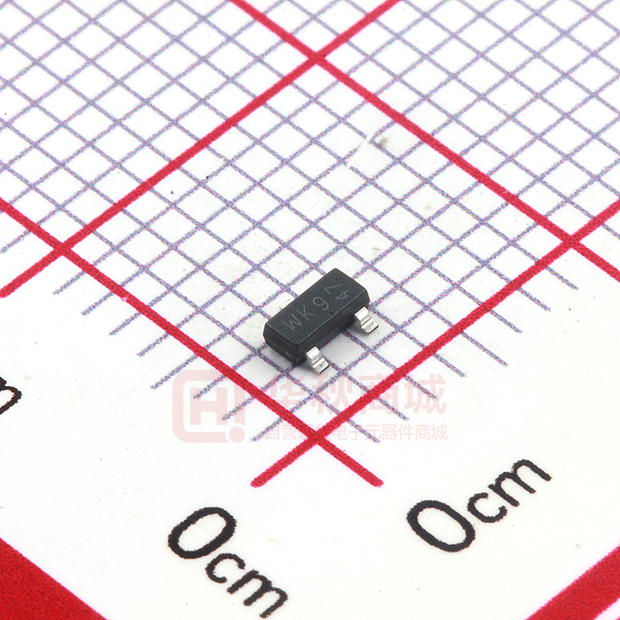

PMV45EN2 30 V, N-channel Trench MOSFET 10 January 2017 Product data sheet 1. General description N-channel enhancement mode Field-Effect Transistor (FET) in a small SOT23 (TO-236AB) Surface-Mounted Device (SMD) plastic package using Trench MOSFET technology. 2. Features and benefits • • • • Logic level compatible Very fast switching Trench MOSFET technology Enhanced power dissipation capability of 1115 mW 3. Applications • • • • Relay driver High-speed line driver Low-side load switch Switching circuits 4. Quick reference data Table 1. Quick reference data Symbol Parameter Conditions Min Typ Max Unit VDS drain-source voltage Tj = 25 °C - - 30 V VGS gate-source voltage -20 - 20 V - - 5.1 A - 35 42 mΩ ID drain current VGS = 10 V; Tamb = 25 °C; t ≤ 5 s [1] Static characteristics RDSon [1] drain-source on-state resistance VGS = 10 V; ID = 4.1 A; Tj = 25 °C 2 Device mounted on an FR4 Printed-Circuit Board (PCB), single-sided copper, tin-plated, mounting pad for drain 6 cm . PMV45EN2 Nexperia 30 V, N-channel Trench MOSFET 5. Pinning information Table 2. Pinning information Pin Symbol Description 1 G gate 2 S source 3 D drain Simplified outline Graphic symbol 3 D G S 1 2 017aaa253 TO-236AB (SOT23) 6. Ordering information Table 3. Ordering information Type number PMV45EN2 Package Name Description Version TO-236AB plastic surface-mounted package; 3 leads SOT23 7. Marking Table 4. Marking codes [1] Type number Marking code PMV45EN2 %K9 [1] % = placeholder for manufacturing site code PMV45EN2 Product data sheet All information provided in this document is subject to legal disclaimers. 10 January 2017 © Nexperia B.V. 2017. All rights reserved 2 / 15 PMV45EN2 Nexperia 30 V, N-channel Trench MOSFET 8. Limiting values Table 5. Limiting values In accordance with the Absolute Maximum Rating System (IEC 60134). Symbol Parameter Conditions Min Max Unit VDS drain-source voltage Tj = 25 °C - 30 V VGS gate-source voltage ID drain current IDM peak drain current Ptot -20 20 V VGS = 10 V; Tamb = 25 °C; t ≤ 5 s [1] - 5.1 A VGS = 10 V; Tamb = 25 °C [1] - 4.1 A VGS = 10 V; Tamb = 100 °C [1] - 2.6 A Tamb = 25 °C; single pulse; tp ≤ 10 µs total power dissipation Tamb = 25 °C - 16 A [2] - 510 mW [1] - 1115 mW - 5000 mW Tsp = 25 °C Tj junction temperature -55 150 °C Tamb ambient temperature -55 150 °C Tstg storage temperature -65 150 °C - 1 A Source-drain diode IS [1] [2] source current [1] Tamb = 25 °C 2 Device mounted on an FR4 Printed-Circuit Board (PCB), single-sided copper, tin-plated, mounting pad for drain 6 cm . Device mounted on an FR4 Printed Circuit Board (PCB), single-sided copper, tin-plated and standard footprint. 017aaa123 120 Pder (%) Ider (%) 80 80 40 40 0 - 75 Fig. 1. 017aaa124 120 - 25 25 75 125 Tj (°C) Normalized total power dissipation as a function of junction temperature PMV45EN2 Product data sheet 0 - 75 175 Fig. 2. - 25 75 125 Tj (°C) 175 Normalized continuous drain current as a function of junction temperature All information provided in this document is subject to legal disclaimers. 10 January 2017 25 © Nexperia B.V. 2017. All rights reserved 3 / 15 PMV45EN2 Nexperia 30 V, N-channel Trench MOSFET aaa-013361 102 lD (A) tp = 10 µs 10 tp = 100 µs 1 tp = 1 ms DC; Tamb = 25 °C; 6 cm2 tp = 10 ms DC; Tsp = 25 °C 10-1 10-2 10-1 1 tp = 100 ms 10 102 VDS (V) IDM = single pulse Fig. 3. Safe operating area; junction to ambient; continuous and peak drain currents as a function of drainsource voltage 9. Thermal characteristics Table 6. Thermal characteristics Symbol Rth(j-a) Rth(j-sp) [1] [2] Parameter thermal resistance from junction to ambient Conditions in free air in free air; t ≤ 5 s thermal resistance from junction to solder point Min Typ Max Unit [1] - 209 246 K/W [2] - 95 112 K/W [2] - 62 73 K/W - 20 25 K/W Device mounted on an FR4 Printed-Circuit Board (PCB), single-sided copper, tin-plated and standard footprint. 2 Device mounted on an FR4 PCB, single-sided copper, tin-plated, mounting pad for drain 6 cm . PMV45EN2 Product data sheet All information provided in this document is subject to legal disclaimers. 10 January 2017 © Nexperia B.V. 2017. All rights reserved 4 / 15 PMV45EN2 Nexperia 30 V, N-channel Trench MOSFET aaa-013362 103 Zth(j-a) (K/W) duty cycle = 1 0.75 102 0.50 0.33 0.20 0.25 0.10 0.05 10 0.02 0 0.01 1 10-3 10-2 10-1 1 10 102 tp (s) 103 FR4 PCB, standard footprint Fig. 4. Transient thermal impedance from junction to ambient as a function of pulse duration; typical values aaa-013363 103 duty cycle = 1 0.75 0.50 0.33 Zth(j-a) (K/W) 102 10 0.02 0.01 0 1 10-3 0.25 0.20 0.10 0.05 10-2 10-1 FR4 PCB, mounting pad for drain 6 cm Fig. 5. 1 10 102 tp (s) 2 103 Transient thermal impedance from junction to ambient as a function of pulse duration; typical values PMV45EN2 Product data sheet All information provided in this document is subject to legal disclaimers. 10 January 2017 © Nexperia B.V. 2017. All rights reserved 5 / 15 PMV45EN2 Nexperia 30 V, N-channel Trench MOSFET 10. Characteristics Table 7. Characteristics Symbol Parameter Conditions Min Typ Max Unit Static characteristics V(BR)DSS drain-source breakdown voltage ID = 250 µA; VGS = 0 V; Tj = 25 °C 30 - - V VGSth gate-source threshold voltage ID = 250 µA; VDS=VGS; Tj = 25 °C 1 1.5 2 V IDSS drain leakage current VDS = 30 V; VGS = 0 V; Tj = 25 °C - - 1 µA IGSS gate leakage current VGS = 20 V; VDS = 0 V; Tj = 25 °C - - 100 nA VGS = -20 V; VDS = 0 V; Tj = 25 °C - - -100 nA VGS = 10 V; ID = 4.1 A; Tj = 25 °C - 35 42 mΩ VGS = 10 V; ID = 4.1 A; Tj = 150 °C - 55 66 mΩ VGS = 4.5 V; ID = 3.6 A; Tj = 25 °C - 43 54 mΩ RDSon drain-source on-state resistance gfs forward transconductance VDS = 10 V; ID = 2 A; Tj = 25 °C - 13 - S RG gate resistance Tj = 25 °C; f = 1 MHz - 2.3 - Ω VDS = 15 V; ID = 3.2 A; VGS = 10 V; Tj = 25 °C - 3.6 6.3 nC - 0.5 - nC - 0.4 - nC - 209 - pF - 50 - pF - 17 - pF - 3 - ns - 12 - ns Dynamic characteristics QG(tot) total gate charge QGS gate-source charge QGD gate-drain charge Ciss input capacitance Coss output capacitance Crss reverse transfer capacitance td(on) turn-on delay time tr rise time td(off) turn-off delay time - 11 - ns tf fall time - 2 - ns - 0.8 1.2 V VDS = 15 V; f = 1 MHz; VGS = 0 V; Tj = 25 °C VDS = 15 V; ID = 3.2 A; VGS = 10 V; RG(ext) = 6 Ω; Tj = 25 °C Source-drain diode VSD source-drain voltage PMV45EN2 Product data sheet IS = 1 A; VGS = 0 V; Tj = 25 °C All information provided in this document is subject to legal disclaimers. 10 January 2017 © Nexperia B.V. 2017. All rights reserved 6 / 15 PMV45EN2 Nexperia 30 V, N-channel Trench MOSFET aaa-013364 16 3.8 V ID (A) ID (A) 4.5 V 12 aaa-013365 10-3 min typ max 3.2 V 10 V 10-4 3.0 V 8 2.8 V 10-5 4 2.5 V VGS = 2.2 V 0 Fig. 6. 0 1 2 3 VDS (V) 10-6 4 0 0.5 1.0 1.5 2.0 2.5 VGS (V) Tj = 25 °C Tj = 25 °C; VDS = 5 V Output characteristics: drain current as a Fig. 7. function of drain-source voltage; typical values Sub-threshold drain current as a function of gate-source voltage aaa-013366 300 2.5 V RDSon (mΩ) aaa-013367 300 2.2 V RDSon (mΩ) 2.8 V 200 200 3.2 V 100 100 Tj = 150 °C 0 VGS = 10 V 0 4 4.5 V 8 Tj = 25 °C 3.8 V 12 ID (A) 0 16 Tj = 25 °C Fig. 8. Product data sheet 2 4 6 8 10 VGS (V) ID = 3.8 A Drain-source on-state resistance as a function of drain current; typical values PMV45EN2 0 Fig. 9. Drain-source on-state resistance as a function of gate-source voltage; typical values All information provided in this document is subject to legal disclaimers. 10 January 2017 © Nexperia B.V. 2017. All rights reserved 7 / 15 PMV45EN2 Nexperia 30 V, N-channel Trench MOSFET aaa-013368 16 aaa-009047 1.8 ID (A) a 12 1.5 8 1.2 Tj = 150 °C 4 0.9 Tj = 25 °C 0 0 1 2 3 4 VGS (V) 0.6 -60 5 0 60 120 Tj (°C) 180 VDS > ID × RDSon Fig. 10. Transfer characteristics: drain current as a function of gate-source voltage; typical values Fig. 11. Normalized drain-source on-state resistance as a function of junction temperature; typical values aaa-009048 3 aaa-009049 103 C (pF) VGS(th) (V) max 2 Ciss 102 Coss typ Crss min 1 0 -60 0 60 10 120 Tj (°C) 1 180 Fig. 12. Gate-source threshold voltage as a function of junction temperature Product data sheet 1 10 VDS (V) 102 f = 1 MHz; VGS = 0 V ID = 0.25 mA; VDS = VGS PMV45EN2 10-1 Fig. 13. Input, output and reverse transfer capacitances as a function of drain-source voltage; typical values All information provided in this document is subject to legal disclaimers. 10 January 2017 © Nexperia B.V. 2017. All rights reserved 8 / 15 PMV45EN2 Nexperia 30 V, N-channel Trench MOSFET aaa-009050 10 VDS VGS (V) ID 8 VGS(pl) 6 VGS(th) VGS 4 QGS1 2 0 QGS2 0 1 2 3 QG (nC) QGS QGD QG(tot) 003aaa508 Fig. 15. MOSFET transistor: Gate charge waveform definitions 4 ID = 3.2 A; VDS = 15 V; Tamb = 25 °C Fig. 14. Gate-source voltage as a function of gate charge; typical values aaa-009052 4 IS (A) 3 Tj = 150 °C 2 Tj = 25 °C 1 0 0 0.4 0.8 VSD (V) 1.2 VGS = 0 V Fig. 16. Source current as a function of source-drain voltage; typical values 11. Test information P t2 duty cycle δ = t1 t2 t1 t 006aaa812 Fig. 17. Duty cycle definition PMV45EN2 Product data sheet All information provided in this document is subject to legal disclaimers. 10 January 2017 © Nexperia B.V. 2017. All rights reserved 9 / 15 PMV45EN2 Nexperia 30 V, N-channel Trench MOSFET 12. Package outline Plastic surface-mounted package; 3 leads SOT23 B D A E X HE v A 3 Q A A1 1 c 2 e1 bp w B Lp e detail X 0 1 2 mm scale Dimensions (mm are the original dimensions) Unit mm max nom min A A1 1.1 0.1 0.9 D E 0.48 0.15 bp c 3.0 1.4 0.38 0.09 2.8 1.2 e e1 1.9 0.95 HE Lp Q 2.5 0.45 0.55 2.1 0.15 0.45 v w 0.2 0.1 sot023_po Outline version SOT23 References IEC JEDEC JEITA European projection Issue date 14-06-19 14-09-22 TO-236AB Fig. 18. Package outline TO-236AB (SOT23) PMV45EN2 Product data sheet All information provided in this document is subject to legal disclaimers. 10 January 2017 © Nexperia B.V. 2017. All rights reserved 10 / 15 PMV45EN2 Nexperia 30 V, N-channel Trench MOSFET 13. Soldering 3.3 2.9 1.9 solder lands 3 solder resist 2 1.7 solder paste occupied area 0.6 (3×) 0.7 (3×) Dimensions in mm 0.5 (3×) 0.6 (3×) 1 sot023_fr Fig. 19. Reflow soldering footprint for TO-236AB (SOT23) 2.2 1.2 (2×) 1.4 (2×) solder lands 4.6 solder resist 2.6 occupied area Dimensions in mm 1.4 preferred transport direction during soldering 2.8 4.5 sot023_fw Fig. 20. Wave soldering footprint for TO-236AB (SOT23) PMV45EN2 Product data sheet All information provided in this document is subject to legal disclaimers. 10 January 2017 © Nexperia B.V. 2017. All rights reserved 11 / 15 PMV45EN2 Nexperia 30 V, N-channel Trench MOSFET 14. Revision history Table 8. Revision history Data sheet ID Release date Data sheet status Change notice Supersedes PMV45EN2 v.2 20170110 Product data sheet - PMV45EN2 v.1 Modifications: PMV45EN2 v.1 PMV45EN2 Product data sheet • Section 10. Characteristics: values for forward transconductance and gate resistance changed 20140603 Product data sheet - All information provided in this document is subject to legal disclaimers. 10 January 2017 - © Nexperia B.V. 2017. All rights reserved 12 / 15 PMV45EN2 Nexperia 30 V, N-channel Trench MOSFET Notwithstanding any damages that customer might incur for any reason whatsoever, Nexperia’s aggregate and cumulative liability towards customer for the products described herein shall be limited in accordance with the Terms and conditions of commercial sale of Nexperia. 15. Legal information Right to make changes — Nexperia reserves the right to make changes to information published in this document, including without limitation specifications and product descriptions, at any time and without notice. This document supersedes and replaces all information supplied prior to the publication hereof. Data sheet status Document [1] [2] status Product [3] status Objective [short] data sheet Development This document contains data from the objective specification for product development. Preliminary [short] data sheet Qualification This document contains data from the preliminary specification. Product [short] data sheet Production This document contains the product specification. [1] [2] [3] Definition Suitability for use — Nexperia products are not designed, authorized or warranted to be suitable for use in life support, life-critical or safety-critical systems or equipment, nor in applications where failure or malfunction of a Nexperia product can reasonably be expected to result in personal injury, death or severe property or environmental damage. Nexperia and its suppliers accept no liability for inclusion and/or use of Nexperia products in such equipment or applications and therefore such inclusion and/or use is at the customer’s own risk. Quick reference data — The Quick reference data is an extract of the product data given in the Limiting values and Characteristics sections of this document, and as such is not complete, exhaustive or legally binding. Please consult the most recently issued document before initiating or completing a design. The term 'short data sheet' is explained in section "Definitions". The product status of device(s) described in this document may have changed since this document was published and may differ in case of multiple devices. The latest product status information is available on the Internet at URL http://www.nexperia.com. Definitions Preview — The document is a preview version only. The document is still subject to formal approval, which may result in modifications or additions. Nexperia does not give any representations or warranties as to the accuracy or completeness of information included herein and shall have no liability for the consequences of use of such information. Draft — The document is a draft version only. The content is still under internal review and subject to formal approval, which may result in modifications or additions. Nexperia does not give any representations or warranties as to the accuracy or completeness of information included herein and shall have no liability for the consequences of use of such information. Short data sheet — A short data sheet is an extract from a full data sheet with the same product type number(s) and title. A short data sheet is intended for quick reference only and should not be relied upon to contain detailed and full information. For detailed and full information see the relevant full data sheet, which is available on request via the local Nexperia sales office. In case of any inconsistency or conflict with the short data sheet, the full data sheet shall prevail. Product specification — The information and data provided in a Product data sheet shall define the specification of the product as agreed between Nexperia and its customer, unless Nexperia and customer have explicitly agreed otherwise in writing. In no event however, shall an agreement be valid in which the Nexperia product is deemed to offer functions and qualities beyond those described in the Product data sheet. Disclaimers Limited warranty and liability — Information in this document is believed to be accurate and reliable. However, Nexperia does not give any representations or warranties, expressed or implied, as to the accuracy or completeness of such information and shall have no liability for the consequences of use of such information. Nexperia takes no responsibility for the content in this document if provided by an information source outside of Nexperia. In no event shall Nexperia be liable for any indirect, incidental, punitive, special or consequential damages (including - without limitation lost profits, lost savings, business interruption, costs related to the removal or replacement of any products or rework charges) whether or not such damages are based on tort (including negligence), warranty, breach of contract or any other legal theory. PMV45EN2 Product data sheet Applications — Applications that are described herein for any of these products are for illustrative purposes only. Nexperia makes no representation or warranty that such applications will be suitable for the specified use without further testing or modification. Customers are responsible for the design and operation of their applications and products using Nexperia products, and Nexperia accepts no liability for any assistance with applications or customer product design. It is customer’s sole responsibility to determine whether the Nexperia product is suitable and fit for the customer’s applications and products planned, as well as for the planned application and use of customer’s third party customer(s). Customers should provide appropriate design and operating safeguards to minimize the risks associated with their applications and products. Nexperia does not accept any liability related to any default, damage, costs or problem which is based on any weakness or default in the customer’s applications or products, or the application or use by customer’s third party customer(s). Customer is responsible for doing all necessary testing for the customer’s applications and products using Nexperia products in order to avoid a default of the applications and the products or of the application or use by customer’s third party customer(s). Nexperia does not accept any liability in this respect. Limiting values — Stress above one or more limiting values (as defined in the Absolute Maximum Ratings System of IEC 60134) will cause permanent damage to the device. Limiting values are stress ratings only and (proper) operation of the device at these or any other conditions above those given in the Recommended operating conditions section (if present) or the Characteristics sections of this document is not warranted. Constant or repeated exposure to limiting values will permanently and irreversibly affect the quality and reliability of the device. Terms and conditions of commercial sale — Nexperia products are sold subject to the general terms and conditions of commercial sale, as published at http://www.nexperia.com/profile/terms, unless otherwise agreed in a valid written individual agreement. In case an individual agreement is concluded only the terms and conditions of the respective agreement shall apply. Nexperia hereby expressly objects to applying the customer’s general terms and conditions with regard to the purchase of Nexperia products by customer. No offer to sell or license — Nothing in this document may be interpreted or construed as an offer to sell products that is open for acceptance or the grant, conveyance or implication of any license under any copyrights, patents or other industrial or intellectual property rights. Export control — This document as well as the item(s) described herein may be subject to export control regulations. Export might require a prior authorization from competent authorities. Non-automotive qualified products — Unless this data sheet expressly states that this specific Nexperia product is automotive qualified, the product is not suitable for automotive use. It is neither qualified nor tested in accordance with automotive testing or application requirements. Nexperia accepts no liability for inclusion and/or use of nonautomotive qualified products in automotive equipment or applications. All information provided in this document is subject to legal disclaimers. 10 January 2017 © Nexperia B.V. 2017. All rights reserved 13 / 15 PMV45EN2 Nexperia 30 V, N-channel Trench MOSFET In the event that customer uses the product for design-in and use in automotive applications to automotive specifications and standards, customer (a) shall use the product without Nexperia’s warranty of the product for such automotive applications, use and specifications, and (b) whenever customer uses the product for automotive applications beyond Nexperia’s specifications such use shall be solely at customer’s own risk, and (c) customer fully indemnifies Nexperia for any liability, damages or failed product claims resulting from customer design and use of the product for automotive applications beyond Nexperia’s standard warranty and Nexperia’s product specifications. Translations — A non-English (translated) version of a document is for reference only. The English version shall prevail in case of any discrepancy between the translated and English versions. Trademarks Notice: All referenced brands, product names, service names and trademarks are the property of their respective owners. PMV45EN2 Product data sheet All information provided in this document is subject to legal disclaimers. 10 January 2017 © Nexperia B.V. 2017. All rights reserved 14 / 15 PMV45EN2 Nexperia 30 V, N-channel Trench MOSFET 16. Contents 1. General description......................................................1 2. Features and benefits.................................................. 1 3. Applications.................................................................. 1 4. Quick reference data....................................................1 5. Pinning information......................................................2 6. Ordering information....................................................2 7. Marking.......................................................................... 2 8. Limiting values............................................................. 3 9. Thermal characteristics............................................... 4 10. Characteristics............................................................ 6 11. Test information......................................................... 9 12. Package outline........................................................ 10 13. Soldering................................................................... 11 14. Revision history........................................................12 15. Legal information..................................................... 13 © Nexperia B.V. 2017. All rights reserved For more information, please visit: http://www.nexperia.com For sales office addresses, please send an email to: salesaddresses@nexperia.com Date of release: 10 January 2017 PMV45EN2 Product data sheet All information provided in this document is subject to legal disclaimers. 10 January 2017 © Nexperia B.V. 2017. All rights reserved 15 / 15
