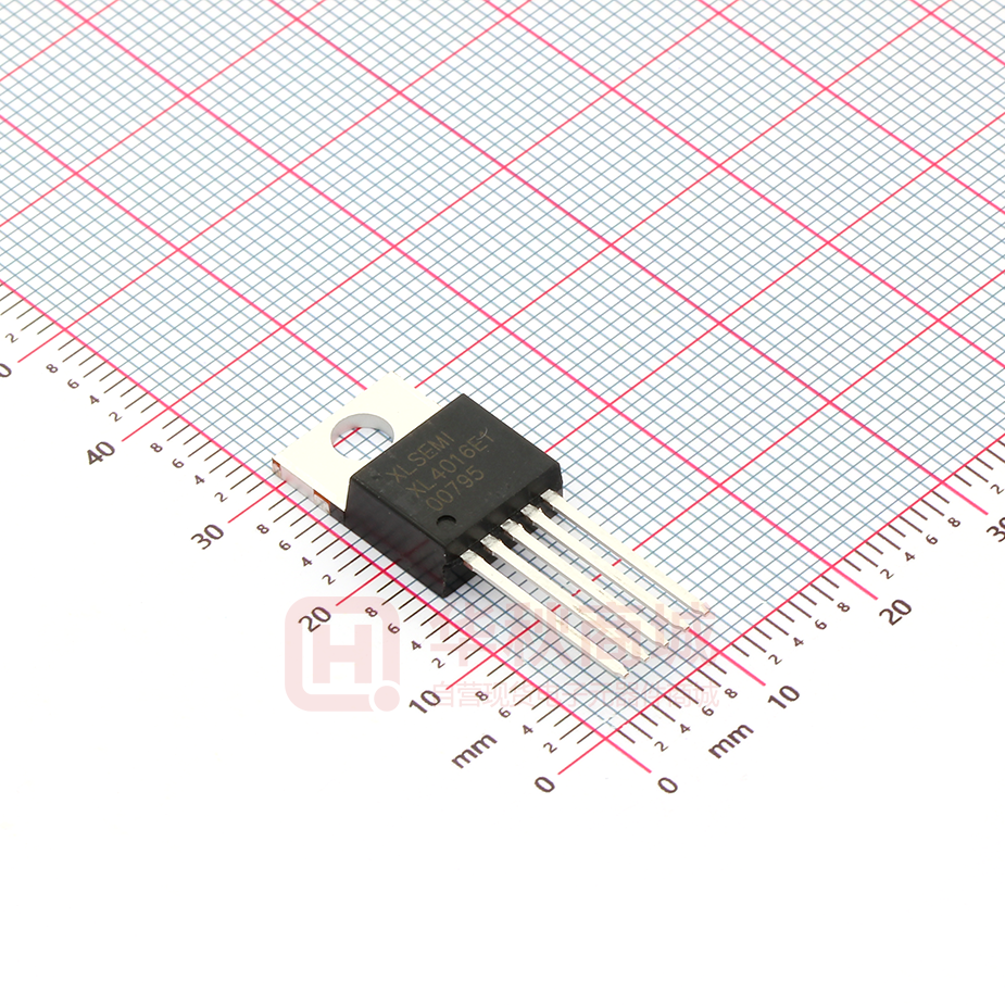

Figure1. Package Type of XL4016

Pin Configurations
Figure2. Pin Configuration of XL4016 (Top View)
Table 1 Pin Description
Pin Number
Pin Name
1
GND
2
FB
3
SW
4
VC
5
VIN
Description
Ground Pin. Care must be taken in layout. This pin should be
placed outside of the Schottky Diode to output capacitor
ground path to prevent switching current spikes from inducing
voltage noise into XL4016.
Feedback Pin (FB). Through an external resistor divider
network, FB senses the output voltage and regulates it. The
feedback threshold voltage is 1.25V.
Power Switch Output Pin (SW). SW is the switch node that
supplies power to the output.
Internal Voltage Regulator Bypass Capacity. In typical system
application, The VC pin connect a 1uf capacity to VIN.
Supply Voltage Input Pin. XL4016 operates from a 8V to 40V
DC voltage. Bypass Vin to GND with a suitably large
capacitor to eliminate noise on the input.

Ordering Information
Order Information
XL4016E1
Marking ID
XL4016E1
Package Type
TO220-5L
Packing Type Supplied As
Tube
XLSEMI Pb-free products, as designated with “E1” suffix in the par number, are RoHS compliant.
