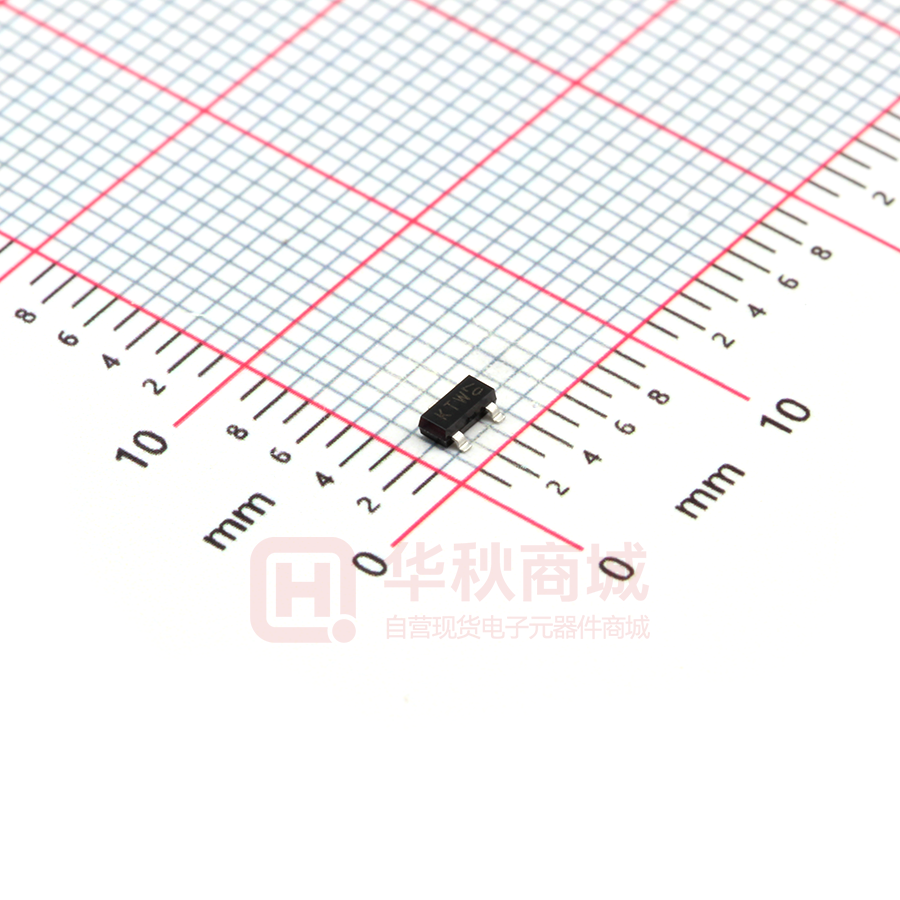

    MOS管 P-Channel VDS=30V VGS=±8V ID=230mA RDS(ON)=4.1Ω@4.5V SOT23
NX3008PBK,215 数据手册
NX3008PBK 30 V, 230 mA P-channel Trench MOSFET Rev. 1 — 1 August 2011 Product data sheet 1. Product profile 1.1 General description P-channel enhancement mode Field-Effect Transistor (FET) in a small SOT23 (TO-236AB) Surface-Mounted Device (SMD) plastic package using Trench MOSFET technology. 1.2 Features and benefits  Very fast switching  ESD protection up to 2 kV  Low threshold voltage  AEC-Q101 qualified  Trench MOSFET technology 1.3 Applications  Relay driver  High-side loadswitch  High-speed line driver  Switching circuits 1.4 Quick reference data Table 1. Quick reference data Symbol Parameter Conditions Min Typ Max Unit VDS drain-source voltage Tj = 25 °C - - -30 V VGS gate-source voltage -8 - 8 V - - -230 mA - 2.8 4.1 Ω drain current ID VGS = -4.5 V; Tamb = 25 °C [1] Static characteristics RDSon [1] drain-source on-state resistance VGS = -4.5 V; ID = -200 mA; Tj = 25 °C Device mounted on an FR4 PCB, single-sided copper, tin-plated, mounting pad for drain 1 cm2. NX3008PBK Nexperia 30 V, 230 mA P-channel Trench MOSFET 2. Pinning information Table 2. Pinning information Pin Symbol Description 1 G gate 2 S source 3 D drain Simplified outline Graphic symbol D 3 1 2 G SOT23 (TO-236AB) S 017aaa259 3. Ordering information Table 3. Ordering information Type number NX3008PBK Package Name Description Version TO-236AB plastic surface-mounted package; 3 leads SOT23 4. Marking Table 4. Marking codes Type number Marking code[1] NX3008PBK KT% [1] % = placeholder for manufacturing site code. NX3008PBK Product data sheet All information provided in this document is subject to legal disclaimers. Rev. 1 — 1 August 2011 © Nexperia B.V. 2017. All rights reserved 2 of 16 NX3008PBK Nexperia 30 V, 230 mA P-channel Trench MOSFET 5. Limiting values Table 5. Limiting values In accordance with the Absolute Maximum Rating System (IEC 60134). Symbol Parameter Conditions Min Max Unit VDS drain-source voltage Tj = 25 °C - -30 V VGS gate-source voltage drain current ID total power dissipation Ptot 8 V VGS = -4.5 V; Tamb = 25 °C - -230 mA VGS = -4.5 V; Tamb = 100 °C [1] - -145 mA Tamb = 25 °C; single pulse; tp ≤ 10 µs peak drain current IDM -8 [1] Tamb = 25 °C - -1 A [2] - 350 mW [1] - 420 mW - 1140 mW Tsp = 25 °C Tj junction temperature -55 150 °C Tamb ambient temperature -55 150 °C Tstg storage temperature -65 150 °C Source-drain diode source current IS Tamb = 25 °C [1] - -230 mA HBM [3] - 2000 V ESD maximum rating VESD electrostatic discharge voltage [1] Device mounted on an FR4 PCB, single-sided copper, tin-plated, mounting pad for drain 1 cm2. [2] Device mounted on an FR4 Printed-Circuit Board (PCB), single-sided copper, tin-plated and standard footprint. [3] Measured between all pins. NX3008PBK Product data sheet All information provided in this document is subject to legal disclaimers. Rev. 1 — 1 August 2011 © Nexperia B.V. 2017. All rights reserved 3 of 16 NX3008PBK Nexperia 30 V, 230 mA P-channel Trench MOSFET 001aao121 120 Pder (%) Ider (%) 80 80 40 40 0 -75 Fig 1. 001aao122 120 -25 25 75 125 Tj (°C) 0 -75 175 Normalized total power dissipation as a function of junction temperature Fig 2. -25 25 75 125 Tj (°C) 175 Normalized continuous drain current as a function of junction temperature 001aao255 -10 lD (A) -1 (1) -10-1 (2) (3) (4) -10-2 -10-1 (5) -1 -10 VDS (V) -102 IDM is a single pulse (1) tp = 1 ms (2) tp = 10 ms (3) tp = 100 ms (4) DC; Tsp = 25 °C (5) DC; Tamb = 25 °C; 1 cm2 drain mounting pad Fig 3. Safe operating area; junction to ambient; continuous and peak drain currents as a function of drain-source voltage NX3008PBK Product data sheet All information provided in this document is subject to legal disclaimers. Rev. 1 — 1 August 2011 © Nexperia B.V. 2017. All rights reserved 4 of 16 NX3008PBK Nexperia 30 V, 230 mA P-channel Trench MOSFET 6. Thermal characteristics Table 6. Thermal characteristics Symbol Parameter Conditions thermal resistance from junction to ambient Rth(j-a) in free air Min Typ Max Unit [1] - 310 370 K/W [2] - 260 300 K/W - - 115 K/W thermal resistance from junction to solder point Rth(j-sp) [1] Device mounted on an FR4 PCB, single-sided copper, tin-plated and standard footprint. [2] Device mounted on an FR4 PCB, single-sided copper, tin-plated, mounting pad for drain 1 cm2. 017aaa015 103 duty cycle = 1 Zth(j-a) (K/W) 0.75 0.5 0.33 102 0.25 0.1 0.2 0.05 0.02 0.01 10 0 1 10−3 10−2 10−1 1 10 102 103 tp (s) FR4 PCB, standard footprint Fig 4. Transient thermal impedance from junction to ambient as a function of pulse duration; typical values 017aaa016 103 Zth(j-a) (K/W) duty cycle = 1 0.75 0.5 102 0.33 0.25 10 0.2 0.1 0.05 0 0.02 0.01 1 10−3 10−2 10−1 1 10 102 103 tp (s) FR4 PCB, mounting pad for drain 1 cm2 Fig 5. Transient thermal impedance from junction to ambient as a function of pulse duration; typical values NX3008PBK Product data sheet All information provided in this document is subject to legal disclaimers. Rev. 1 — 1 August 2011 © Nexperia B.V. 2017. All rights reserved 5 of 16 NX3008PBK Nexperia 30 V, 230 mA P-channel Trench MOSFET 7. Characteristics Table 7. Characteristics Symbol Parameter Conditions Min Typ Max Unit Static characteristics V(BR)DSS drain-source breakdown voltage ID = -250 µA; VGS = 0 V; Tj = 25 °C -30 - - V VGSth gate-source threshold voltage ID = -250 µA; VDS = VGS; Tj = 25 °C -0.6 -0.9 -1.1 V IDSS drain leakage current VDS = -30 V; VGS = 0 V; Tj = 150 °C - - -10 µA VDS = -30 V; VGS = 0 V; Tj = 25 °C - - -1 µA IGSS gate leakage current VGS = 8 V; VDS = 0 V; Tj = 25 °C - -0.2 -1 µA VGS = -8 V; VDS = 0 V; Tj = 25 °C - -0.2 -1 µA VGS = 4.5 V; VDS = 0 V; Tj = 25 °C - -10 - nA RDSon gfs drain-source on-state resistance forward transconductance VGS = -4.5 V; VDS = 0 V; Tj = 25 °C - -10 - nA VGS = 2.5 V; VDS = 0 V; Tj = 25 °C - -1 - nA VGS = -2.5 V; VDS = 0 V; Tj = 25 °C - -1 - nA VGS = -4.5 V; ID = -200 mA; Tj = 25 °C - 2.8 4.1 Ω VGS = -4.5 V; ID = -200 mA; Tj = 150 °C - 5.3 7.8 Ω VGS = -2.5 V; ID = -10 mA; Tj = 25 °C - 5.3 6.5 Ω VDS = -10 V; ID = -200 mA; Tj = 25 °C - 160 - mS VDS = -15 V; ID = -200 mA; VGS = -4.5 V; Tj = 25 °C - 0.55 0.72 nC - 0.23 - nC - 0.09 - nC Dynamic characteristics QG(tot) total gate charge QGS gate-source charge QGD gate-drain charge Ciss input capacitance Coss output capacitance Crss reverse transfer capacitance td(on) turn-on delay time tr rise time td(off) tf VDS = -15 V; f = 1 MHz; VGS = 0 V; Tj = 25 °C VDS = -20 V; RL = 250 Ω; VGS = -4.5 V; RG(ext) = 6 Ω; Tj = 25 °C - 31 46 pF - 6.5 - pF - 2.3 - pF - 19 38 ns - 30 - ns turn-off delay time - 65 130 ns fall time - 38 - ns -0.47 -0.88 -1.2 V Source-drain diode VSD source-drain voltage NX3008PBK Product data sheet IS = -200 mA; VGS = 0 V; Tj = 25 °C All information provided in this document is subject to legal disclaimers. Rev. 1 — 1 August 2011 © Nexperia B.V. 2017. All rights reserved 6 of 16 NX3008PBK Nexperia 30 V, 230 mA P-channel Trench MOSFET 001aao256 -0.25 -4.5 V ID (A) 001aao257 -10-3 -3 V -0.20 ID (A) -2.5 V (1) (3) (2) -10-4 -0.15 -0.10 -2 V -10-5 -0.05 VGS = -1.5 V 0.00 0 -1 -2 -3 VDS (V) -4 -10-6 0.0 Tj = 25 °C -0.5 -1.0 VGS (V) -1.5 Tj = 25 °C; VDS = -5 V (1) minimum values (2) typical values (3) maximum values Fig 6. Output characteristics: drain current as a function of drain-source voltage; typical values 001aao258 14 RDS (on) (Ω) 12 (1) (2) (3) Fig 7. Sub-threshold drain current as a function of gate-source voltage 001aao259 14 RDS (on) (Ω) 12 (4) 10 10 8 8 6 6 (1) (5) 4 4 (6) (2) 2 0 2 0 -0.05 -0.10 -0.15 0 -0.20 -0.25 ID (A) 0 -1 Tj = 25 °C ID = -200 mA (1) VGS = -1.75 V (1) Tj = 150 °C (2) VGS = -2.0 V (2) Tj = 25 °C -2 -3 -4 VGS (A) -5 (3) VGS = -2.25 V (4) VGS = -2.5 V (5) VGS = -3.0 V (6) VGS = -4.5 V Fig 8. Drain-source on-state resistance as a function of drain current; typical values NX3008PBK Product data sheet Fig 9. Drain-source on-state resistance as a function of gate-source voltage; typical values All information provided in this document is subject to legal disclaimers. Rev. 1 — 1 August 2011 © Nexperia B.V. 2017. All rights reserved 7 of 16 NX3008PBK Nexperia 30 V, 230 mA P-channel Trench MOSFET 001aao260 -0.25 ID (A) 001aao261 2.0 a -0.20 1.5 (1) (2) -0.15 1.0 -0.10 0.5 -0.05 0.00 0 -1 -2 VGS (V) -3 0.0 -60 0 60 120 Tj (˚C) 180 VDS > ID x RDSon (1) Tj = 25 °C (2) Tj = 150 °C Fig 10. Transfer characteristics: drain current as a function of gate-source voltage; typical values 001aao262 -1.5 VGS(th) (V) Fig 11. Normalized drain-source on-state resistance as a function of junction temperature; typical values 001aao263 102 C (pF) (1) (1) -1.0 (2) 10 (2) (3) -0.5 (3) 0.0 -60 0 60 120 Tj (˚C) 180 1 -10-1 -1 ID = -0.25 mA; VDS = VGS f = 1 MHz; VGS = 0 V (1) maximum values (1)Ciss (2) typical values (2)Coss (3) minimum values (3)Crss Fig 12. Gate-source threshold voltage as a function of junction temperature NX3008PBK Product data sheet -10 VDS (V) -102 Fig 13. Input, output and reverse transfer capacitances as a function of drain-source voltage; typical values All information provided in this document is subject to legal disclaimers. Rev. 1 — 1 August 2011 © Nexperia B.V. 2017. All rights reserved 8 of 16 NX3008PBK Nexperia 30 V, 230 mA P-channel Trench MOSFET 001aao264 -5 VGS (V) VDS -4 ID -3 VGS(pl) -2 VGS(th) VGS -1 QGS1 QGS2 QGS 0 0.0 0.1 0.2 0.3 0.4 0.5 QGD QG(tot) 0.6 0.7 QG (nC) 003aaa508 ID = -200 mA; VDS = -15 V; Tamb = 25 °C Fig 14. Gate-source voltage as a function of gate charge; typical values Fig 15. Gate charge waveform definitions 001aao265 -0.25 IS (A) -0.20 -0.15 (1) (2) -0.10 -0.05 0.00 0.0 -0.4 -0.8 VSD (V) -1.2 VGS = 0 V (1) Tj = 150 °C (2) Tj = 25 °C Fig 16. Source current as a function of source-drain voltage; typical values NX3008PBK Product data sheet All information provided in this document is subject to legal disclaimers. Rev. 1 — 1 August 2011 © Nexperia B.V. 2017. All rights reserved 9 of 16 NX3008PBK Nexperia 30 V, 230 mA P-channel Trench MOSFET 8. Test information P t2 duty cycle δ = t1 t2 t1 t 006aaa812 Fig 17. Duty cycle definition 8.1 Quality information This product has been qualified in accordance with the Automotive Electronics Council (AEC) standard Q101 - Stress test qualification for discrete semiconductors, and is suitable for use in automotive applications. NX3008PBK Product data sheet All information provided in this document is subject to legal disclaimers. Rev. 1 — 1 August 2011 © Nexperia B.V. 2017. All rights reserved 10 of 16 NX3008PBK Nexperia 30 V, 230 mA P-channel Trench MOSFET 9. Package outline Plastic surface-mounted package; 3 leads SOT23 D E B A X HE v M A 3 Q A A1 1 2 e1 bp c w M B Lp e detail X 0 1 2 mm scale DIMENSIONS (mm are the original dimensions) UNIT A A1 max. bp c D E e e1 HE Lp Q v w mm 1.1 0.9 0.1 0.48 0.38 0.15 0.09 3.0 2.8 1.4 1.2 1.9 0.95 2.5 2.1 0.45 0.15 0.55 0.45 0.2 0.1 OUTLINE VERSION SOT23 REFERENCES IEC JEDEC JEITA EUROPEAN PROJECTION ISSUE DATE 04-11-04 06-03-16 TO-236AB Fig 18. Package outline SOT23 (TO-236AB) NX3008PBK Product data sheet All information provided in this document is subject to legal disclaimers. Rev. 1 — 1 August 2011 © Nexperia B.V. 2017. All rights reserved 11 of 16 NX3008PBK Nexperia 30 V, 230 mA P-channel Trench MOSFET 10. Soldering 3.3 2.9 1.9 solder lands solder resist 3 2 1.7 solder paste occupied area 0.6 (3×) 0.7 (3×) Dimensions in mm 0.5 (3×) 0.6 (3×) 1 sot023_fr Fig 19. Reflow soldering footprint for SOT23 (TO-236AB) 2.2 1.2 (2×) 1.4 (2×) solder lands 4.6 solder resist 2.6 occupied area Dimensions in mm 1.4 preferred transport direction during soldering 2.8 4.5 sot023_fw Fig 20. Wave soldering footprint for SOT23 (TO-236AB) NX3008PBK Product data sheet All information provided in this document is subject to legal disclaimers. Rev. 1 — 1 August 2011 © Nexperia B.V. 2017. All rights reserved 12 of 16 NX3008PBK Nexperia 30 V, 230 mA P-channel Trench MOSFET 11. Revision history Table 8. Revision history Document ID Release date Data sheet status Change notice Supersedes NX3008PBK v.1 20110801 Product data sheet - - NX3008PBK Product data sheet All information provided in this document is subject to legal disclaimers. Rev. 1 — 1 August 2011 © Nexperia B.V. 2017. All rights reserved 13 of 16 NX3008PBK Nexperia 30 V, 230 mA P-channel Trench MOSFET 12. Legal information 12.1 Data sheet status Document status [1] [2] Product status [3] Definition Objective [short] data sheet Development This document contains data from the objective specification for product development. Preliminary [short] data sheet Qualification This document contains data from the preliminary specification. Product [short] data sheet Production This document contains the product specification. [1] Please consult the most recently issued document before initiating or completing a design. [2] The term 'short data sheet' is explained in section "Definitions". [3] The product status of device(s) described in this document may have changed since this document was published and may differ in case of multiple devices. The latest product status information is available on the Internet at URL http://www.nexperia.com. 12.2 Definitions Preview — The document is a preview version only. The document is still subject to formal approval, which may result in modifications or additions. Nexperia does not give any representations or warranties as to the accuracy or completeness of information included herein and shall have no liability for the consequences of use of such information. Draft — The document is a draft version only. The content is still under internal review and subject to formal approval, which may result in modifications or additions. Nexperia does not give any representations or warranties as to the accuracy or completeness of information included herein and shall have no liability for the consequences of use of such information. Short data sheet — A short data sheet is an extract from a full data sheet with the same product type number(s) and title. A short data sheet is intended for quick reference only and should not be relied upon to contain detailed and full information. For detailed and full information see the relevant full data sheet, which is available on request via the local Nexperia sales office. In case of any inconsistency or conflict with the short data sheet, the full data sheet shall prevail. Product specification — The information and data provided in a Product data sheet shall define the specification of the product as agreed between Nexperia and its customer, unless Nexperia and customer have explicitly agreed otherwise in writing. In no event however, shall an agreement be valid in which the Nexperia product is deemed to offer functions and qualities beyond those described in the Product data sheet. 12.3 Disclaimers Limited warranty and liability — Information in this document is believed to be accurate and reliable. However, Nexperia does not give any representations or warranties, expressed or implied, as to the accuracy or completeness of such information and shall have no liability for the consequences of use of such information. In no event shall Nexperia be liable for any indirect, incidental, punitive, special or consequential damages (including - without limitation - lost profits, lost savings, business interruption, costs related to the removal or replacement of any products or rework charges) whether or not such damages are based on tort (including negligence), warranty, breach of contract or any other legal theory. Notwithstanding any damages that customer might incur for any reason whatsoever, Nexperia’s aggregate and cumulative liability towards customer for the products described herein shall be limited in accordance with the Terms and conditions of commercial sale of Nexperia. NX3008PBK Product data sheet Right to make changes — Nexperia reserves the right to make changes to information published in this document, including without limitation specifications and product descriptions, at any time and without notice. This document supersedes and replaces all information supplied prior to the publication hereof. Suitability for use — Nexperia products are not designed, authorized or warranted to be suitable for use in life support, life-critical or safety-critical systems or equipment, nor in applications where failure or malfunction of a Nexperia product can reasonably be expected to result in personal injury, death or severe property or environmental damage. Nexperia accepts no liability for inclusion and/or use of Nexperia products in such equipment or applications and therefore such inclusion and/or use is at the customer’s own risk. Quick reference data — The Quick reference data is an extract of the product data given in the Limiting values and Characteristics sections of this document, and as such is not complete, exhaustive or legally binding. Applications — Applications that are described herein for any of these products are for illustrative purposes only. Nexperia makes no representation or warranty that such applications will be suitable for the specified use without further testing or modification. Customers are responsible for the design and operation of their applications and products using Nexperia products, and Nexperia accepts no liability for any assistance with applications or customer product design. It is customer’s sole responsibility to determine whether the Nexperia product is suitable and fit for the customer’s applications and products planned, as well as for the planned application and use of customer’s third party customer(s). Customers should provide appropriate design and operating safeguards to minimize the risks associated with their applications and products. Nexperia does not accept any liability related to any default, damage, costs or problem which is based on any weakness or default in the customer’s applications or products, or the application or use by customer’s third party customer(s). Customer is responsible for doing all necessary testing for the customer’s applications and products using Nexperia products in order to avoid a default of the applications and the products or of the application or use by customer’s third party customer(s). Nexperia does not accept any liability in this respect. Limiting values — Stress above one or more limiting values (as defined in the Absolute Maximum Ratings System of IEC 60134) will cause permanent damage to the device. Limiting values are stress ratings only and (proper) operation of the device at these or any other conditions above those given in the Recommended operating conditions section (if present) or the Characteristics sections of this document is not warranted. Constant or repeated exposure to limiting values will permanently and irreversibly affect the quality and reliability of the device. All information provided in this document is subject to legal disclaimers. Rev. 1 — 1 August 2011 © Nexperia B.V. 2017. All rights reserved 14 of 16 NX3008PBK Nexperia 30 V, 230 mA P-channel Trench MOSFET Terms and conditions of commercial sale — Nexperia products are sold subject to the general terms and conditions of commercial sale, as published at http://www.nexperia.com/profile/terms, unless otherwise agreed in a valid written individual agreement. In case an individual agreement is concluded only the terms and conditions of the respective agreement shall apply. Nexperia hereby expressly objects to applying the customer’s general terms and conditions with regard to the purchase of Nexperia products by customer. 12.4 Trademarks Notice: All referenced brands, product names, service names and trademarks are the property of their respective owners. No offer to sell or license — Nothing in this document may be interpreted or construed as an offer to sell products that is open for acceptance or the grant, conveyance or implication of any license under any copyrights, patents or other industrial or intellectual property rights. Export control — This document as well as the item(s) described herein may be subject to export control regulations. Export might require a prior authorization from national authorities. 13. Contact information For more information, please visit: http://www.nexperia.com For sales office addresses, please send an email to: salesaddresses@nexperia.com NX3008PBK Product data sheet All information provided in this document is subject to legal disclaimers. Rev. 1 — 1 August 2011 © Nexperia B.V. 2017. All rights reserved 15 of 16 Nexperia NX3008PBK 30 V, 230 mA P-channel Trench MOSFET 14. Contents 1 1.1 1.2 1.3 1.4 2 3 4 5 6 7 8 8.1 9 10 11 12 12.1 12.2 12.3 12.4 13 © Product profile . . . . . . . . . . . . . . . . . . . . . . . . . . .1 General description . . . . . . . . . . . . . . . . . . . . . .1 Features and benefits . . . . . . . . . . . . . . . . . . . . .1 Applications . . . . . . . . . . . . . . . . . . . . . . . . . . . .1 Quick reference data . . . . . . . . . . . . . . . . . . . . .1 Pinning information . . . . . . . . . . . . . . . . . . . . . . .2 Ordering information . . . . . . . . . . . . . . . . . . . . . .2 Marking . . . . . . . . . . . . . . . . . . . . . . . . . . . . . . . . .2 Limiting values. . . . . . . . . . . . . . . . . . . . . . . . . . .3 Thermal characteristics . . . . . . . . . . . . . . . . . . .5 Characteristics . . . . . . . . . . . . . . . . . . . . . . . . . . .6 Test information . . . . . . . . . . . . . . . . . . . . . . . . .10 Quality information . . . . . . . . . . . . . . . . . . . . . .10 Package outline . . . . . . . . . . . . . . . . . . . . . . . . . 11 Soldering . . . . . . . . . . . . . . . . . . . . . . . . . . . . . .12 Revision history . . . . . . . . . . . . . . . . . . . . . . . . .13 Legal information. . . . . . . . . . . . . . . . . . . . . . . .14 Data sheet status . . . . . . . . . . . . . . . . . . . . . . .14 Definitions . . . . . . . . . . . . . . . . . . . . . . . . . . . . .14 Disclaimers . . . . . . . . . . . . . . . . . . . . . . . . . . . .14 Trademarks. . . . . . . . . . . . . . . . . . . . . . . . . . . .15 Contact information. . . . . . . . . . . . . . . . . . . . . .15 Nexperia B.V. 2017. All rights reserved For more information, please visit: http://www.nexperia.com For sales office addresses, please send an email to: salesaddresses@nexperia.com Date of release: 01 August 2011
