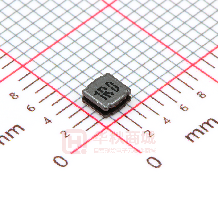

    SMD,3x3mm
    功率电感 1µH ±20% 30mΩ IND_3X3MM_SM
YNR3015-1R0M 数据手册
SMD Power Inductors -YNR3015 Series ■ Features ● Low profile construction and miniature size. ● Magnetic shielded construction. ● High current saturation. ● Operating temperature:-40℃ ~ +125℃. ● RoHS compliant ■ Applications ● For small DC/DC converter(HDD,DVC,DSC,PDA,LCD display etc.). ● Car navigation systems,telecom base stations. ● VR,AR,LED lighting. ■ Product Identification ⑴ :Type ⑵ :Dimensions ⑶ :Inductance value ⑷ :Inductance Tolerance;N=±30%,M=±20%,K=±10% ■ Shapes and Dimensions (Unit:mm) TYPE A B C Max. D E Ref. F Ref. G Ref. YNR3015 3.0±0.2 3.0±0.2 1.50 0.75±0.2 2.70 0.80 1.50 深圳市益嘉源电子有限公司 http://www.yjycoin.com Tel:0755-27803896 Fax:0755-27803897 -1- SMD Power Inductors -YNR3015 Series ■ YNR3015 Series Part Number Inductance DC Resistance (Ω) Heat Rating Saturation (uH) @100KHz Typ. Max. Current (A) Current (A) YNR3015-R22□ 0.22 0.018 0.023 3.25 5.50 YNR3015-R50□ 0.50 0.030 0.039 2.60 3.90 YNR3015-R68□ 0.68 0.030 0.039 2.40 2.30 YNR3015-R82□ 0.82 0.036 0.047 2.35 3.40 YNR3015-1R0□ 1.00 0.030 0.039 2.35 2.32 YNR3015-1R2□ 1.20 0.040 0.052 1.95 2.21 YNR3015-1R5□ 1.50 0.050 0.065 1.70 2.30 YNR3015-1R8□ 1.80 0.050 0.065 1.70 2.20 YNR3015-2R2□ 2.20 0.060 0.078 1.60 1.60 YNR3015-2R7□ 2.70 0.075 0.098 1.43 1.52 YNR3015-3R3□ 3.30 0.080 0.104 1.36 1.32 YNR3015-3R6□ 3.60 0.105 0.137 1.20 1.28 YNR3015-3R9□ 3.90 0.105 0.137 1.20 1.20 YNR3015-4R3□ 4.30 0.115 0.150 1.14 1.20 YNR3015-4R7□ 4.70 0.125 0.163 1.09 1.10 YNR3015-5R1□ 5.10 0.133 0.173 1.05 1.00 YNR3015-6R2□ 6.20 0.195 0.254 0.86 1.00 YNR3015-6R8□ 6.80 0.200 0.260 0.85 0.85 YNR3015-8R2□ 8.20 0.240 0.312 0.80 0.80 YNR3015-100□ 10.0 0.250 0.325 0.77 0.72 YNR3015-120□ 12.0 0.320 0.416 0.68 0.70 YNR3015-150□ 15.0 0.350 0.455 0.65 0.66 YNR3015-180□ 18.0 0.430 0.559 0.59 0.56 深圳市益嘉源电子有限公司 http://www.yjycoin.com Tel:0755-27803896 Fax:0755-27803897 -2- SMD Power Inductors -YNR3015 Series ■ YNR3015 Series Part Number Inductance DC Resistance (Ω) Heat Rating Saturation (uH) @100KHz Typ. Max. Current (A) Current (A) YNR3015-220□ 22.0 0.460 0.598 0.57 0.52 YNR3015-270□ 27.0 0.730 0.949 0.45 0.48 YNR3015-330□ 33.0 0.820 1.066 0.43 0.44 YNR3015-390□ 39.0 0.995 1.294 0.39 0.41 YNR3015-430□ 43.0 1.060 1.378 0.37 0.37 YNR3015-470□ 47.0 1.250 1.625 0.35 0.35 YNR3015-510□ 51.0 1.735 2.256 0.50 0.44 YNR3015-560□ 56.0 1.280 1.664 0.34 0.33 YNR3015-620□ 62.0 1.610 2.093 0.30 0.30 YNR3015-680□ 68.0 2.700 3.510 0.23 0.28 YNR3015-750□ 75.0 2.800 3.640 0.45 0.35 YNR3015-820□ 82.0 2.700 3.510 0.27 0.24 YNR3015-101□ 100 3.110 4.043 0.21 0.23 YNR3015-121□ 120 3.360 4.368 0.23 0.22 YNR3015-151□ 150 3.800 4.940 0.19 0.18 YNR3015-221□ 220 4.470 5.811 0.35 0.16 ※ The saturation current value is the DC current value having inductance decrease down to 30%.(at 20℃) ※ The temperature rise current value is the DC current value having temperature increase up to 40℃. (at 20℃) ※ The rated current is the DC current value that satisfies both of current value saturation current value and temperature rise current value. 深圳市益嘉源电子有限公司 http://www.yjycoin.com Tel:0755-27803896 Fax:0755-27803897 -3- SMD Power Inductors -YNR3015 Series ■ Taping Dimensions(Unit:mm) TYPE Chip Thickness W A B D P K Max T Max MPQ YNR3015 1.50 8.00 3.30 3.30 3.50 4.00 1.90 0.25 2000 ■ Reel Dimensions(Unit:mm) TYPE W W1 A B C D YNR3015 178±2.0 8.40±1.50 4.3±0.20 5.0±0.10 3.0±0.10 58±2.0 深圳市益嘉源电子有限公司 http://www.yjycoin.com Tel:0755-27803896 Fax:0755-27803897 -4- SMD Power Inductors -YNR3015 Series ■ Direction of rolling ■ Cover tape peel off condition Cover tape peel force shall be 0.1N to 1.3N. Reference peel speed 300±10mm/min. 深圳市益嘉源电子有限公司 http://www.yjycoin.com Tel:0755-27803896 Fax:0755-27803897 -5-
