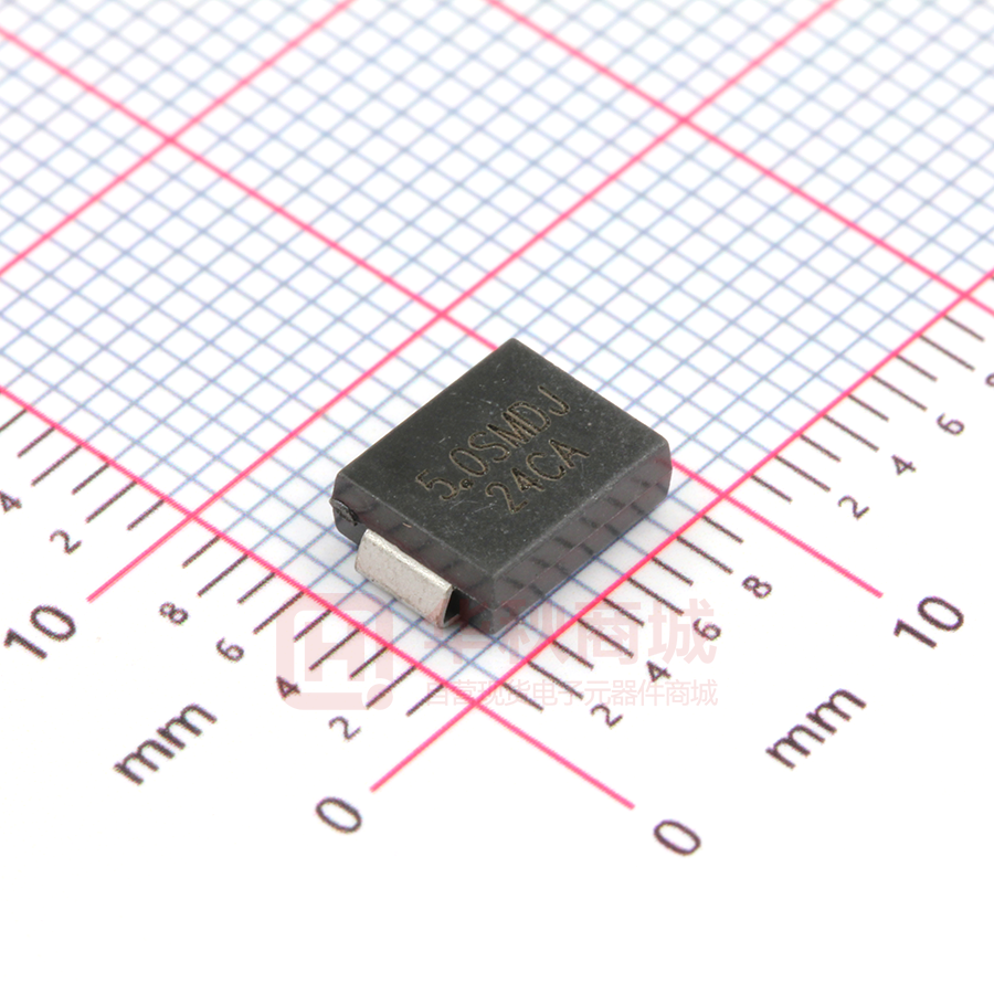

    ESD 双向 Vrwm:24V 击穿电压(最小值):26.7V Ipp:131.1A 最大钳位电压:38.9V
5.0SMDJ24CA 数据手册
TVS Surface Mount – 5000W > 5.0SMDJ Series Description The 5.0SMDJ series is designed specifically to protect sensitive electronic equipment from voltage transients induced by lightning and other transient voltage events. Features ◆ 5000W peak pulsepower capability at 10 x 1000μs waveform, repetition rate (duty cycle): 0.01% ◆ Glass Passivated chip junction ◆ For surface mounted applications to optimize board space ◆ Low profile package ◆ Built-in strain relief ◆ Low incremental surge resistance ◆ Excellent clamping capability ◆ Plastic package has UL flammability classification 94V-O ◆ Fast response time: typically less than 1.0ps from 0 Volts to BV min ◆ Typical IR less than 5uA above 22V ◆ High temperature soldering: 260°C/40 seconds at terminals ◆ IEC-61000-4-2 ESD 15KV(Air),8KV(Contact) ◆ ESD protection of data lines in accordance with IEC 61000-4-2(IEC801-2) ◆ EFT protection of data lines in accordance with IEC61000-4-4(IEC801-4) ◆ AEC - Q101 qualified. Applications TVS devices are ideal for the protection of I/O Interfaces, VCC bus and other vulnerable circuits used in Telecom, Computer, Industrial and Consumer electronic applications. Rev : 01.06.2014 1 /8 www.leiditech.com Maximum Ratings and Electrical Characteristics (TA=25℃ unless otherwise noted) Parameter Symbol Value Unit PPPM 5000 W Power Dissipation on infinite heat sink at TA=50℃ PD 6.5 W Peak Forward Surge Current, 8.3ms Single Half Sine Wave Unidirectional only(Note 3) IFSM 300 A Maximum Instantaneous Forward Voltage at 100A for Unidirectional only VF 3.5V/5.0 V TJ, TSTG -55 to + 150 ℃ Typical Thermal Resistance Junction to Lead RuJL 15 ℃/W Typical Thermal Resistance Junction to Ambient RuJA 75 ℃/W Peak Pulse Power Dissipation at TA=25℃ by 10x1000μs waveform (Fig.2)(Note 1) (Note 2) Operating Junction Temperature Range and Storage Notes: 1. Non-repetitive current pulse, per Fig.3and derated above TA=25℃ per Fig. 2. 2. Mounted on copper pad area of 0.31x0.31” (8.0 x 8.0mm) to each terminal. 3. Measured on 8.3ms single half sine wave or equivalent square wave for unidirectional device only, duty cycle=4 per minute maximum. Rev : 01.06.2014 2 /8 www.leiditech.com BI- POLAR UNI-POLAR VRWM VBR VBR IT IR Ipp Vc (V) MIN(V) MAX(V) (mA) (µA) (A) (v) 5.0SMDJ5.0CA 5.0SMDJ5.0A 5.0 6.4 7.25 50 5000 554.3 9.2 5.0SMDJ6.0CA 5.0SMDJ6.0A 6.0 6.67 7.67 50 5000 495.1 10.3 5.0SMDJ 6.5CA 5.0SMDJ 6.5A 6.5 7.22 8.30 50 2000 455.4 11.2 5.0SMDJ7.0 CA 5.0SMDJ7.0 A 7.0 7.78 8.95 50 1000 425.0 12.0 5.0SMDJ 7.5CA 5.0SMDJ 7.5A 7.5 8.33 9.58 5 250 395.3 12.9 5.0SMDJ 8.0CA 5.0SMDJ 8.0A 8.0 8.89 10.23 5 150 357.0 13.6 5.0SMDJ8.5 CA 5.0SMDJ8.5 A 8.5 9.44 10.82 5 50 354.2 14.4 5.0SMDJ9.0 CA 5.0SMDJ9.0 A 9.0 10.00 11.50 5 20 331.2 15.4 5.0SMDJ10CA 5.0SMDJ10A 10.0 11.1 12.30 5 15 300.0 17.0 5.0SMDJ11CA 5.0SMDJ11A 11.0 12.20 14.00 5 2 280.2 18.2 5.0SMDJ12CA 5.0SMDJ12A 12.0 13.30 14.70 5 2 256.3 19.9 5.0SMDJ13CA 5.0SMDJ13A 13.0 14.40 16.50 5 2 237.2 21.5 5.0SMDJ14CA 5.0SMDJ14A 14.0 15.60 17.20 5 2 219.8 23.2 5.0SMDJ15CA 5.0SMDJ15A 15.0 16.70 19.20 5 2 209.0 24.4 5.0SMDJ16CA 5.0SMDJ16A 16.0 17.80 19.70 5 2 196.2 26.0 5.0SMDJ17CA 5.0SMDJ17A 17.0 18.90 21.70 5 2 184.8 27.6 5.0SMDJ18CA 5.0SMDJ18A 18.0 20.00 23.30 5 2 174.7 29.2 5.0SMDJ20CA 5.0SMDJ20A 20.0 22.20 25.50 5 2 157.4 32.4 5.0SMDJ22CA 5.0SMDJ22A 22.0 24.40 28.00 5 2 143.7 35.5 5.0SMDJ24CA 5.0SMDJ24A 24.0 26.70 30.70 5 2 131.1 38.9 5.0SMDJ26CA 5.0SMDJ26A 26.0 28.90 33.20 5 2 121.1 42.1 5.0SMDJ28CA 5.0SMDJ28A 28.0 31.10 35.80 5 2 112.3 45.4 5.0SMDJ30CA 5.0SMDJ30A 30.0 33.30 38.30 5 2 105.4 48.4 5.0SMDJ33CA 5.0SMDJ33A 33.0 36.70 40.60 5 2 95.7 53.3 Rev : 01.06.2014 3 /8 @Ipp VOLTAGE CLAMPING MAXIMUM CURRENT PEAK PULSE @VRWM LEAKAGE REVERSE CURRENT TEST T VBR(V)MAX.@I VOLTAGE BREAKDOWN VOLTAGE STAND-OFF PART NUMBER REVERSE Electrical Characteristics www.leiditech.com Electrical Characteristics MIN(V) MAX(V) (mA) (µA) (A) Vc (v) 5.0SMDJ36CA 5.0SMDJ36A 36.0 40.00 46.00 5 2 87.8 58.1 5.0SMDJ40CA 5.0SMDJ40A 40.0 44.40 51.10 5 2 79.1 64.5 5.0SMDJ43CA 5.0SMDJ43A 43.0 47.8 52.8 5 2 73.5 69.4 5.0SMDJ45CA 5.0SMDJ45A 45.0 50.00 57.50 5 2 70.2 72.7 5.0SMDJ48CA 5.0SMDJ48A 48.0 53.30 58.90 5 2 65.9 77.4 5.0SMDJ51CA 5.0SMDJ51A 51.0 56.70 65.20 5 2 61.9 82.4 5.0SMDJ54CA 5.0SMDJ54A 54.0 60.00 69.00 5 2 58.6 87.1 5.0SMDJ58CA 5.0SMDJ58A 58.0 64.4 71.2 5 2 54.5 93.6 5.0SMDJ60CA 5.0SMDJ60A 60.0 66.7 73.7 5 2 52.7 96.8 5.0SMDJ64CA 5.0SMDJ64A 64.0 71.10 81.80 5 2 49.5 103.0 5.0SMDJ70CA 5.0SMDJ70A 70.0 77.8 95.1 5 2 45.1 113.0 5.0SMDJ75CA 5.0SMDJ75A 75.0 83.3 92.1 5 2 42.1 121.0 5.0SMDJ78CA 5.0SMDJ78A 78.0 86.70 99.70 5 2 40.5 126.0 5.0SMDJ85CA 5.0SMDJ85A 85.0 94.40 108.20 5 2 37.2 137.0 5.0SMDJ90CA 5.0SMDJ90A 90.0 100.0 111.0 5 2 34.9 146.0 5.0SMDJ100CA 5.0SMDJ100A 100.0 111.0 123.00 5 2 31.5 162.0 5.0SMDJ110CA 5.0SMDJ110A 110.0 122.0 135.00 5 2 28.8 177.0 5.0SMDJ120CA 5.0SMDJ120A 133.0 147.00 5 2 26.4 193.0 5.0SMDJ130CA 5.0SMDJ130A 130.0 144.0 159.00 5 2 24.4 209.0 5.0SMDJ150CA 5.0SMDJ150A 150.0 167.0 185.00 5 2 21.0 243.0 5.0SMDJ160CA 5.0SMDJ160A 160.0 178.0 197.00 5 2 19.7 259.0 5.0SMDJ170CA 5.0SMDJ170A 170.0 189.0 209.00 5 2 18.5 275.0 5.0SMDJ180CA 5.0SMDJ180A 180.0 201.0 222.0 5 2 17.5 292.0 5.0SMDJ190CA 5.0SMDJ190A 190.0 211.0 233.00 5 2 16.5 308.0 Rev : 01.06.2014 120.0 4 /8 @Ipp (V) Ipp VOLTAGE IR MAXIMUM IT CLAMPING VBR CURRENT VBR PULSE VRWM PEAK @VRWM LEAKAGE REVERSE CURRENT TEST @IT VBR(V)MAX. N VOLTAGE VOLTAGE BREAKDOW UNI-POLAR STAND-OFF BI- POLAR REVERSE PART NUMBER www.leiditech.com (mA) (µA) (A) VOLTAGE VOLTAGE @Ipp MAX(V) CLAMPING MIN(V) Ipp MAXIMUM (V) CURRENT IR PEAK PULSE IT REVERSE VBR VOLTAGE VBR BREAKDOWN VRWM STAND-OFF TEST CURRENT UNI-POLAR VBR(V)MAX.@IT BI- POLAR REVERSE PART NUMBER LEAKAGE @VRWM Electrical Characteristics Vc (v) 5.0SMDJ200CA 5.0SMDJ200A 200.0 224.0 247.00 5 2 15.5 324.0 5.0SMDJ210CA 5.0SMDJ220A 210.0 237.00 263.00 5 2 14.6 356.0 5.0SMDJ220CA 5.0SMDJ220A 5 2 13.7 356.0 5.0SMDJ250CA 5.0SMDJ250A 250.0 279.00 309.00 5 2 12.0 405.0 5.0SMDJ300CA 5.0SMDJ300A 300.0 335.0 371.00 5 2 9.1 486.0 5.0SMDJ350CA 5.0SMDJ350A 350.0 391.00 432.00 5 2 7.7 567.0 5.0SMDJ400CA 5.0SMDJ400A 400.0 447.00 494.00 5 2 6.72 648.0 5.0SMDJ440CA 5.0SMDJ440A 440.0 492.00 5 2 6.16 713.0 220.0 246.00 272.00 543.00 Notes: For bidirectional type having VRWM of 20 volts and less, the IR limit is double. For parts without A (VBR is ± 10% and VC is 5% higher than A parts I-V Curve Characteristics Rev : 01.06.2014 5 /8 www.leiditech.com Ratings and Characteristic Curves Figure 1 - Peak Pulse Power Rating Curve Figu re 3 - Pulse Waveform Rev : 01.06.2014 (TA=25°C unless otherwise noted) Figure 2 - Pulse Derating Curve Figure 4 - Typical Junction Capacitance 6 /8 www.leiditech.com Ratings and Characteristic Curves (TA=25°C unless otherwise noted) Figure 6 - Maximum Non-Repetitive Figure 5 - Steady State Power Dissipation Derating Curve Forward Surge Current Uni-Directional Only Part 5.0SMDJ (1) (1) (2) (3) (4) Numbering XXX (2) System C A (3) (4) SERIES. VR VOLTAGE. BI-DIRECTIONAL. 5% VOLTAGE TOLERANCE. Rev : 01.06.2014 7 /8 www.leiditech.com Product Dimensions Inches Dime-n Millimeters sion MIN MAX MIN MAX A 0.220 0.245 5.59 6.22 B 0.305 0.320 7.75 8.13 C 0.114 0.126 2.90 3.20 D 0.260 0.280 6.60 7.11 E 0.030 0.060 0.76 1.52 F 0.077 0.094 1.95 2.40 G - 0.008 - 0.203 H 0.79 0.103 2.06 2.62 J 0.030 0.060 0.76 1.52 K 0.008 0.014 0.20 0.35 L 0.039 0.049 0.99 1.24 B D C A H E J K F L G .165 (4.4) 0.129 (3.3) .094 (2.4) Summary of Packing Options Package Type Packaging Option Packing Quantity Industry Standard Tape&Reel-16mm/13” tape 2500PCS EIA STD RS-481 DO-214AB(SMC) Shanghai Leiditech Electronic Co.,Ltd Email: sale1@leiditech.com Tel : +86- 021 50828806 Fax : +86- 021 50477059 Rev : 01.06.2014 8 /8 www.leiditech.com
