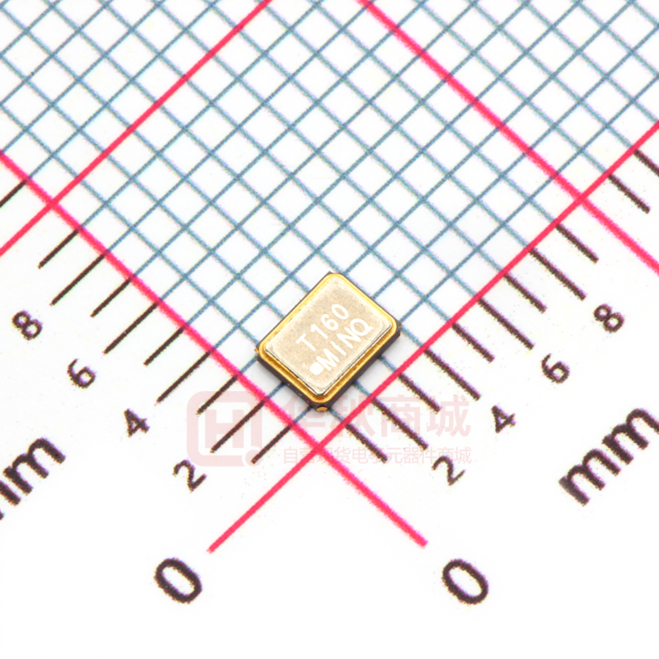

    无源晶振 16MHz 9pF ±20ppm 60Ω -40℃~+125℃ SMD3225_4P
AM16000301 数据手册
TXC CORPORATION www.txccorp.com SPECIFICATION FOR APPROVAL CN: CUSTOMER : PRODUCT TYPE : SMD SEAM SEALING X'TAL 3.2×2.5 NOMINAL FREQ. : 16.000000MHz TXC P/N : AM16000301 REVISION : A1 CUSTOMER P/N : PM / SALES : DATE : CUSTOMER CONFIRMATION : 0 (Singnature) (Date) (1) TXC requires one copy returned with signature and title of authorized individual that signifies acceptance of the attached specifications. (2) Orders received and accepted by TXC after return of signed copy of specification will be produced per these specifications. (3) Any changes to these specifications must be agreed upon by both parties and new revision of the Product Specification Sheet will be issued. (4) Any issuance of purchase order prior to consigning back the Approval page of "Specification Sheets" from customers will be regarded as the agreement on the contents of these specifications. MSL:Level 1 RoHS Compliant (for glass crystal only:Pb used with sealing glass material is exempt from EU directive) FMT-DOC015 VER.C TXC confidential and proprietary document TXC CORPORATION www.txccorp.com PRODUCT SPECIFICATION SHEET CN: PRODUCT TYPE : SMD SEAM SEALING X'TAL 3.2×2.5 NOMINAL FREQ. : 16.000000MHz TXC P/N : AM16000301 REVISION : A1 PE/RD QA MFG Wen yuan Chang ZhongLin Wu Zhi jun Wu 4-Sep-17 4-Sep-17 4-Sep-17 NOTE: (1) TXC green product standard is based on the international standards. Relevant information is posted on the TXC website and updated regularly. The documentation is subject to the latest green product quality system. (2) Revision "Sx" is for engineering samples only. PE/RD's approval required. (3) Revision "Ax" is production ready. PE, QA and MFG's approval required. MSL:Level 1 RoHS Compliant (for glass crystal only:Pb used with sealing glass material is exempt from EU directive) FMT-DOC015 VER.C TXC confidential and proprietary document TXC CORPORATION Rev Revise page S1 N/A A1 N/A FMT-DOC015 VER.C TXC P/N: Revise contents AM16000301 REVISION: A1 PAGE: 1 Date Ref.No. Reviser Initial released 19-Apr-16 N/A Xiaoyan Jiang S Turn A 4-Sep-17 N/A Xiaohua Zhang TXC confidential and proprietary document TXC CORPORATION TXC P/N: AM16000301 REVISION: A1 PAGE: 2 Spec Sheet Contents No. Content Page 1 ELECTRICAL SPECIFICATIONS P.3 2 DIMENSIONS P.4 3 MARKING P.4 4 FACTORY LOCATION P.4 5 SUGGESTED REFLOW PROFILE & MANUAL SOLDER CONDITION P.4 6 STRUCTURE ILLUSTRATION P.5 7 EMBOSS CARRIER TAPE & REEL P.6 8 PACKING P.7 9 RELIABILITY SPECIFICATIONS P.8 FMT-DOC015 VER.C TXC confidential and proprietary document TXC CORPORATION AM16000301 TXC P/N: REVISION: A1 PAGE: 3 ■ ELECTRICAL SPECIFICATIONS Standard conditions Ambient temperature : 25±5℃ Relative humidity 40%~70% : In addition to special specifications, are measured in the standard environment. Ambient temperature : 25±3℃ Relative humidity 40%~70% : If there is any doubt about the result, it is necessary to make measurements in the standard environment. Measure equipment Electrical characteristics measured by S&A 250B or equivalent. Crystal cutting type The crystal is using AT CUT (thickness shear mode). Unit Weight: 0.018±0.001 g/pcs Electrical Spec. Parameters SYM. Notes MIN TYPE MAX UNITS FL 16.000000 MHz - - Fundamental - - CL 9 pF - 4 Frequency Tolerance - ±20 ppm at 25 ℃ ± 3 ℃ 5 Frequency Stability - ±20 ppm Over Operating Temp. Range (Reference 25℃) 6 Operating Temperature - 7 Aging - 1 Nominal Frequency 2 Oscillation Mode 3 Load Capacitance -40 ~ 85 ±3 ℃ ppm 1st Year at 25 ℃ ± 3 ℃ 8 Drive Level DL - 100 - μW - 9 Effective Resistance Rr Rr - - 60 Ω - 10 Shunt Capacitance C0 C0 - - 3 pF - 11 Insulation Resistance - 500 - - MΩ 12 Storage Temperature Range - -40 ~ 105 ℃ FMT-DOC015 VER.C TXC confidential and proprietary document at DC 100V - TXC CORPORATION AM16000301 TXC P/N: REVISION: A1 ■ DIMENSIONS PAGE: 4 Unit:mm (Unit:mm) 0.70 ± 0.10 3.20 ± 0.10 GND 3 3 4 2.50 ±0.10 4 1 GND 2 1 2 0.90±0.10 Internal View Connection 1.20±0.10 1.00±0.10 4 3 1.40 0.80 1.40 0.70±0.10 1.20 0.50 1.20 1 2 Bottom View Suggested Layout ■ MARKING   T□□□ TXC Logo ■ Frequency Code ex: 16.000000 MHz = 160 □□□□ Lot Code Date Code Production Control Code Month Code: MONTH YEAR JAN FEB MAR APR MAY JUN JUL AUG SEP OCT NOV DEC 2005 2009 2013 2017 2021 A B C D E F G H J K L 2006 2010 2014 2018 2022 N P Q R S T U V W X Y Z 2007 2011 2015 2019 2023 a b c d e f g h j k l m 2008 2012 2016 2020 2024 n p q r s t u v w x y z *This month code will be cycled every four years Production location: Taiwan & China (NGB) (℃) ■ SUGGESTED REFLOW PROFILE 10 sec 260 Peak Temperature : 260±5℃, 10 sec. Max. Solder melting point : 220±10 ℃, 60 sec. Min. 220 180 ■ SUGGESTED MANUAL SOLDER CONDITION 150 Temperature: 350 ± 10 ℃ Time: 3 sec. Re-solder times: twice Time (sec) 120 sec 60 sec NOTE: After manual welding, the product shall be measured down to room temperature. FMT-DOC015 VER.C TXC confidential and proprietary document M TXC CORPORATION TXC P/N: AM16000301 REVISION: A1 PAGE: 5 ■ STRUCTURE ILLUSTRATION A-A' sectional drawing B-B' sectional drawing NO COMPONENTS C-C' sectional drawing MATERIALS FINISH/SPECIFICATIONS 1 Lid Kovar (Fe/Co/Ni) - 2 Base(Package) Ceramic (AI2O3) + Kovar (Fe/Co/Ni)+ Ag/Cu Color black 3 PAD Au Tungsten metalize + Ni plating + Au plating 4 Crystal blank SiO2 - 5 Conductive adhesive Ag Silicon resin 6 Electrode - FMT-DOC015 VER.C Noble Metal TXC confidential and proprietary document TXC CORPORATION AM16000301 TXC P/N: REVISION: A1 PAGE: 6 ■ PACKING F G B E H INDEX MARK A DIMENSIONS REMARK : C Feeding D A B C D E F G H 1.65 3.40 2.70 4.00 8.00 4.00 1.50 1.75 160mm min (UNIT : mm) 160mm min T T T T Empty Sealed 3000pcs Products Trailer 400mm min Leader User Direction of Feeding W W1 2.0 L1 DIMENSIONS FMT-DOC015 VER.C L L L1 W W1 pcs / Reel (UNIT : mm) 178.0 13.0 11.5 8.0 Standard Reel Quantity is 3,000 pcs per reel TXC confidential and proprietary document TXC CORPORATION TXC P/N: AM16000301 REVISION: A1 PAGE: 7 ■PACKING Box Item: 1. Reel X 6 2. Reel X 12 3. Reel X 25 4. Reel X 50 5. Reel X 100 (L200 X W200 X H140mm) (L200 X W200 X H250mm) (L400 X W400 X H280mm) (L400 X W400 X H280mm) (L399 X W346 X H360mm) Note: 1. For the maximum reel of loads for each type box. 2. The number of reels is slightly adjusted according to each Label factory. Tape Tape shipping mark Customer Information Label : [STORAGE] 1.Do not get wet by the rain. 2.The storage environment shall be 5℃ ~40℃ and 30% ~ 75%RH humidity and avoid exposure to sunlight. 3.If customers have special requirements, we can coordinate. FMT-DOC015 VER.C TXC confidential and proprietary document TXC CORPORATION TXC P/N: AM16000301 REVISION: A1 PAGE: 8 ■ RELIABILITY SPECIFICATIONS (AEC-Q200 Compliant) 1.Mechanical Endurance No. Test Item 1.1 Drop Test Test Methods 120 cm height, 10 times on Stainless Plate . 1.2 Mechanical Shock 1.3 Vibration Device are shocked to half sine wave ( 3000 G ) three mutually perpendicular axes each 3 times. 0.3m sec. duration time Frequency range 10 ~ 2000 Hz~10 Hz Amplitude 1.52 mm/10G Sweep time 20 minute Perpendicular axes each test time 4 Hrs REF.DOC JIS C 6701 MIL-STD-202 Method 213 MIL-STD-202 Method 204 (Total test time 12 Hrs) 1.4 Solderability Temperature 245 ℃ ± 5℃ Immersing depth 1.25 mm Immersion time 5 ± 1 seconds Flux Rosin resin methyl alcohol J-STD-002 solvent ( 1 : 4 ) 1.5 Terminal Strength Mount on PCB board and shear strength 1.8kg for 60 sec. AEC-Q200-006 1.6 Board Flex Duration Time: 60 sec, Deviation: 3mm AEC-Q200-005 2.Environmental Endurance No. Test Item 2.1 Resistance To Soldering Heat Test Methods Pre-heat temperature 125 ℃ Pre-heat time 60 ~ 120 sec. Test temperature 260 ± 5 ℃ Test time 10 ± 1 sec. REF. DOC MIL-STD 202 Method 210 2.2 High Temp. Storage + 85 ℃ ± 3 ℃ for all 1000 Hrs. MIL-STD-202 Method 108 2.3 Low Temp. Storage - 40 ℃ ± 3 ℃ for all 1000 Hrs. JIS C 6701 Total 1000 cycles of the following Thermal Shock : 1 cycle 105 ± 3℃ 2.4 Thermal Shock -55 ± 3℃ 2.5 Temperature Cycle MIL-STD-202 Method 107 25℃ 5 min. 5 min. 20 sec. max. Total 1000 cycles of the following temperature cycle : - 40℃ ± 3 to 85℃ ± 3 , Dwell time:15min. 2.6 Biased Humidity 2.7 Moisture Resistance 2.8 Operational Life FMT-DOC015 VER.C JESD 22 Method JA-104 + 85℃ ± 3℃ , RH 85% , 1000 Hrs. MIL-STD-202 Method 103 20 cycles ( +25℃~65℃ , 80%~100% RH) , 24hrs/cycle. MIL-STD 202 Method 106 + 85 ℃ ± 3 ℃ for 1000 Hrs. MIL-STD-202 Method 108 TXC confidential and proprietary document
AM16000301
1. 物料型号:TXC P/N: AM16000301 2. 器件简介:SMD SEAM SEALING X'TAL 3.2×2.5,标称频率为16.000000MHz。 3. 引脚分配:内部视图显示了GND和连接点的尺寸。 4. 参数特性:包括标称频率、振荡模式、负载电容、频率容差、频率稳定性、工作温度范围、老化率、驱动电平、有效电阻、并联电容和绝缘电阻等。 5. 功能详解:提供了电气规格的详细描述,例如在标准条件下的测量环境、测量设备、晶体切割类型和单位重量。 6. 应用信息:建议的回流焊接曲线、手动焊接条件、产品结构图和包装信息。 7. 封装信息:详细列出了尺寸和标记信息,生产位置为台湾和中国(NGB)。 8. 可靠性规格:符合AEC-Q200标准,包括机械耐久性测试和环境耐久性测试。
