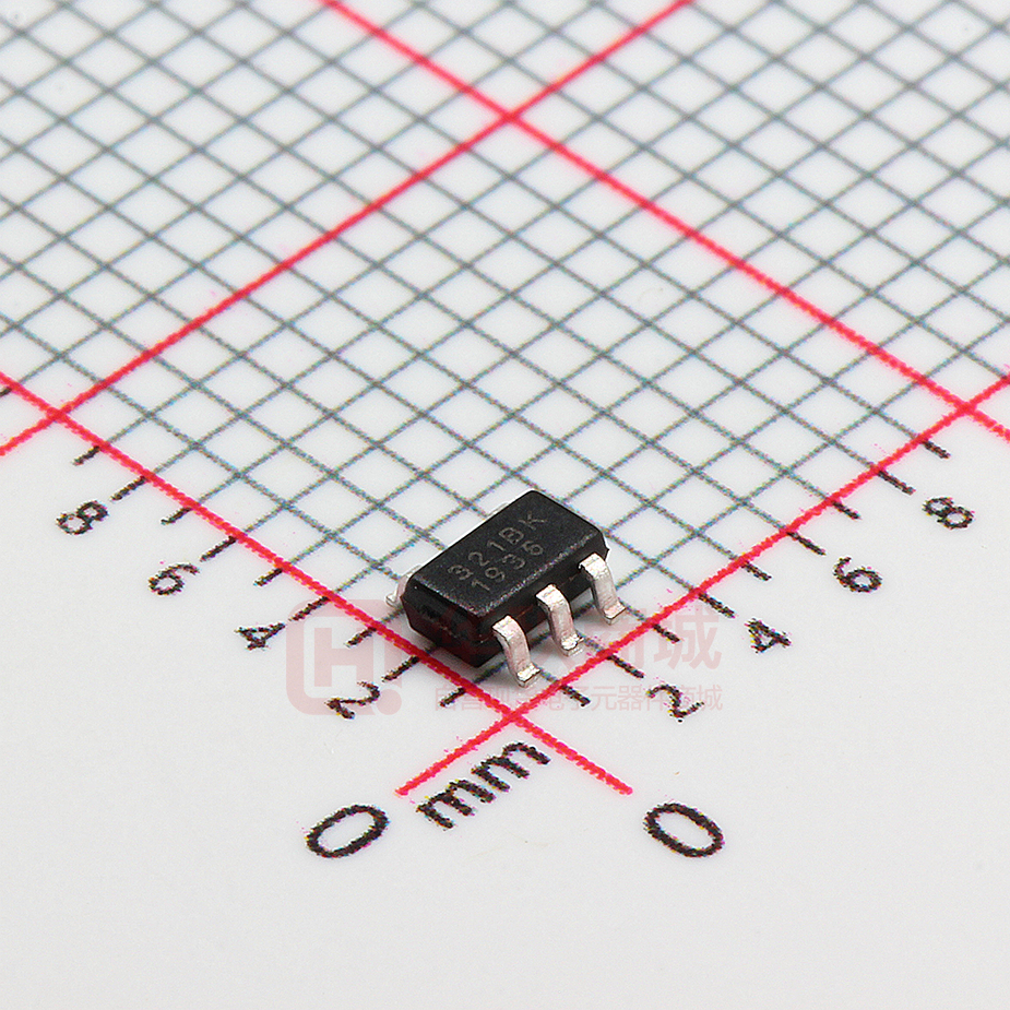

RS321K, RS358K, RS324K 1MHz, Precision, Rail-to-Rail I/O CMOS Operational Amplifier FEATURES DESCRIPTION • HIGH GAIN BANDWIDTH:1MHz • RAIL-TO-RAIL INPUT AND OUTPUT ±4.5mV Max Vos • INPUT VOLTAGE RANGE: -0.1V to +5.6V with Vs = 5.5V • SUPPLY RANGE: +2.5V to +5.5V • SPECIFIED UP TO +125°C • Micro SIZE The RS321K, RS358K, RS324K families of products offer low voltage operation and rail-to-rail input and output, as well as excellent speed/power consumption ratio, providing an excellent bandwidth (1MHz) and slew rate of 0.45V/us. The op-amps are unity gain stable and feature an ultra-low input bias current. The RS321K, RS358K and RS324K has lower offset, which is guaranteed not upper than ±4.5mV at 25°C with Vs = 5V, VCM= Vs/2. The devices are ideal for sensor interfaces, active filters and portable applications. The RS321K, RS358K, RS324K families of operational amplifiers are specified at the full temperature range of −40°C to +125°C. PACKAGES: SOT23-5, SOT353/SC70-5 APPLICATIONS • SENSORS • PHOTODIODE AMPLIFICATION • ACTIVE FILTERS • TEST EQUIPMENT • DRIVING A/D CONVERTERS PIN CONFIGURATIONS V- 2 5 V+ + IN 1 V- 2 5 V+ NC +IN + 3 - -IN 2 OUT +IN 3 4 -IN - IN V- 4 - 3 4 SOT23-5, SOT353(SC70-5) SOT23-5, SOT353(SC70-5) -IN A OUT A 1 OUTB -IN A 2 6 -IN B +IN A 5 +IN B V+ 8 2 7 3 V- 4 + 7 V+ 6 OUT 5 NC RS324K 1 +IN A NC SOIC-8(SOP8),MSOP-8 RS358K OUT A 8 + 1 RS321K 1 + OUT RS321BK - RS321K A B+ V+ 14 OUT D 13 -IN D 3 12 +IN D 4 11 V- +IN B 5 10 +IN C -IN B 6 9 -IN C OUT B 7 8 OUT C SOIC-8(SOP8),MSOP-8,TDFN-8,TSSOP-8 Note: NC indicates no internal connection A - + - + B D + - + C SOIC-14(SOP14),TSSOP-14 REV A.3 1 www.run-ic.com RS321K, RS358K, RS324K ABSOLUTE MAXIMUM RATINGS (1) Supply Voltage, V+ to V-...............................................7.0V Input Terminals, Voltage (2) …………... – 0.5 to (V+) + 0.5V Current (2)………………....…..... ±10mA Storage Temperature ……….…………… −65°C to +150°C Operating Temperature ……….………… −40°C to +125°C Junction Temperature................................................150°C Package Thermal Resistance @ TA = +25°C SOT23-5, SOT23-6………………….………………200°C/W MSOP-10, SOIC-8, TSSOP-8.……….…………... 150°C/W SOIC-14, TSSOP-14………….……….……………100°C/W Lead Temperature (Soldering, 10s) ……………........260°C ESD Susceptibility HBM …......................................................................3000V MM ……………………….........………………...……….200V ESD SENSITIVITY CAUTION ESD damage can range from subtle performance degradation to complete device failure. Precision integrated circuits may be more susceptible to damage because very small parametric changes could cause the device not to meet its published specifications. (1) Stresses above these ratings may cause permanent damage. Exposure to absolute maximum conditions for extended periods may degrade device reliability. These are stress ratings only, and functional operation of the device at these or any other conditions beyond those specified is not implied. (2) Input terminals are diode-clamped to the power-supply rails. Input signals that can swing more than 0.5V beyond the supply rails should be current-limited to 10mA or less. PACKAGE/ORDERING INFORMATION PRODUCT ORDERING NUMBER TEMPERATURE RANGE PACKAGE LEAD PACKAGE MARKING PACKAGE OPTION RS321KXK -40°C ~125°C SOIC-8(SOP8) RS321K Tape and Reel,2500 RS321KXF -40°C ~125°C SOT23-5 321K Tape and Reel,3000 RS321BKXF -40°C ~125°C SOT23-5 321BK Tape and Reel,3000 RS321KXM -40°C ~125°C MSOP-8 RS321K Tape and Reel,3000 RS321KXC5 -40°C ~125°C SOT353(SC70-5) 321K Tape and Reel,3000 RS321BKXC5 -40°C ~125°C SOT353(SC70-5) 321BK Tape and Reel,3000 RS358KXK -40°C ~125°C SOIC-8(SOP8) RS358K Tape and Reel,2500 RS358KXM -40°C ~125°C MSOP-8 RS358K Tape and Reel,3000 RS358KXTDC8 -40°C ~125°C TDFN3x3-8 RS358K Tape and Reel,3000 RS358KXQ -40°C ~125°C TSSOP-8 RS358K Tape and Reel,3000 RS324KXP -40°C ~125°C SOIC-14(SOP14) RS324K Tape and Reel,2500 RS324KXQ -40°C ~125°C TSSOP-14 RS324K Tape and Reel,3000 RS321K RS358K RS324K 2 www.run-ic.com RS321K, RS358K, RS324K ELECTRICAL CHARACTERISTICS (At TA = +25C, Vs=5V, RL = 10kΩ connected to VS/2, and VOUT = VS/2, unless otherwise noted.) PARAMETER CONDITIONS TJ RS321K, RS358K, RS324K MIN TYP MAX UNITS POWER SUPPLY Vs Operating Voltage Range 25C IQ Quiescent Current/Amplifier 25C PSRR 2.5 85 Power-Supply Rejection Ratio Vs=2.5V to 5.5V, VCM=(V-)+0.5V 25C -40C to 125C 70 64 75 Input Offset Voltage VCM=0V to 3.5V 25C -4.5 0.8 Input Offset Voltage Average Drift -40C to 125C 5.5 V 140 uA dB INPUT Vos Vos TC 4.5 mV 2 uV/C IB Input Bias Current 25C 10 pA Ios Input Offset Current 25C 10 pA VCM Common-Mode Voltage Range CMRR Common-Mode Rejection Ratio Vs= 5.5V Vs= 5.5V, VCM =-0.1V to 4V Vs= 5.5V, VCM =-0.1V to 5.6V 25C -0.1 5.6 25C -40C to 125C 25C -40C to 125C 65 62 58 56 85 25C -40C to 125C 25C -40C to 125C 85 75 88 80 95 80 V dB OUTPUT AOL Open-Loop Voltage Gain RL=10KΩ, Vo= 0.05V to 4.95V RL=2KΩ RL=10KΩ 100 dB 25C 25 8 mV 25C 120 mA Slew Rate 25C 0.45 V/us Gain-Bandwidth Product 25C 1 MHz Phase Margin 25C 64 ° 1.3 us 2.3 us Output Swing From Rail Iout RL=2KΩ, Vo= 0.15V to 4.85V Output Current Source FREQUENCY RESPONSE SR GBP PM ts Setting Time,0.1% Overload Recovery Time VIN·Gain≥VS NOISE en f = 1KHz 25C 22 nV/√Hz f = 10KHz 25C 20 nV/√Hz Input Voltage Noise Density 3 www.run-ic.com RS321K, RS358K, RS324K TYPICAL CHARACTERISTICS At TA = +25C, Vs=5V, RL = 10kΩ connected to VS/2, VOUT = VS/2, unless otherwise noted. Gain Phase 100 80 120 90 100 70 60 50 40 30 20 -20 10 1000 100 1K 10K 100K 1M COMMON−MODE REJECTION RATIO vs FREQUENCY 80 60 40 10 0 Voltage Noise(nV/√Hz) 110 CMRR(dB) Open-Loop Gain(dB) 120 Phase Margin (°) OPEN-LOOP GAIN AND PHASE vs FREQUENCY 20 -10 10M 1 10 1K 10K Frequency(Hz) Frequency(KHz) Vs=5V INPUT VOLTAGE NOISE SPECTRAL DENSITY vs FREQUENCY POWER−SUPPLY REJECTION RATIO vs FREQUENCY 120 | 100 PSRR(dB) 100 10 80 60 40 1 20 10 100 1K 10K 100K 1 10 Frequency(Hz) 100 100 1K 10K Frequency(KHz) Vs=5V QUIESCENT CURRENT vs TEMPERATURE 100 95 Quiescent Current(uA) Quiescent Current(uA) 100 90 85 80 75 70 65 60 QUIESCENT CURRENT vs TEMPERATURE 95 90 85 80 75 70 65 60 -40 -20 0 20 40 60 80 100 120 140 -40 -20 Temperature(℃) Vs=2.7V 0 20 40 60 80 100 120 140 Temperature(℃) Vs=2.7V 4 www.run-ic.com RS321K, RS358K, RS324K TYPICAL CHARACTERISTICS At TA = +25C, Vs=5V, RL = 10kΩ connected to VS/2, VOUT = VS/2, unless otherwise noted. SINK CURRENT vs TEMPERATURE SOURCE CURRENT vs TEMPERATURE 145 Source Current(mA) Sink Current(mA) 140 135 130 125 120 115 110 105 100 -40 -20 0 150 145 140 135 130 125 120 115 110 105 100 -40 -20 20 40 60 80 100 120 140 0 20 40 60 80 100 120 140 Temperature(℃) Temperature(℃) SMALL-SIGNAL STEP RESPONSE 1V/div 50mV/div LARGE−SIGNAL STEP RESPONSE 4us/div 200ns/div NEGATIVE OVERVOLTAGE RECOVERY 0V VOUT 0V 0V VS=±2.5V G=-100 VOUT 500ns/div 200mV/div VIN 1V/div 0V 1V/div VIN 200mV/div POSITIVE OVERVOLTAGE RECOVERY VS=±2.5V G=-100 500ns/div 5 www.run-ic.com RS321K, RS358K, RS324K APPLICATION NOTES The RS321K, RS358K, RS324K are high precision, rail-to-rail operational amplifiers that can be run from a single-supply voltage 2.5V to 5.5V (±1.25V to ±2.75V). Supply voltages higher than 7V (absolute maximum) can permanently damage the amplifier. INSTRUMENTATION AMPLIFIER In the three-op amp, instrumentation amplifier configuration shown in Figure2, Rail-to-rail input and output swing significantly increases dynamic range, especially in low-supply applications. V1 RS324K Good layout practice mandates use of a 0.1uF capacitor place closely across the supply pins. RS324K VOUT LAYOUT GUIDELINS Attention to good layout practices is always recommended. Keep traces short. When possible, use a PCB ground plane with surface-mount components placed as close to the device pins as possible. Place a 0.1uF capacitor closely across the supply pins. These guidelines should be applied throughout the analog circuit to improve performance and provide benefits such as reducing the EMI susceptibility. V2 RS324K Figure2. Amplifier instrumentation amplifier +Vs 10uF 0.1uF Vin Vip Vout RS321K 10uF 0.1uF -Vs Figure1. Amplifier with Bypass Capacitors 6 www.run-ic.com RS321K, RS358K, RS324K PACKAGE OUTLINE DIMENSIONS SOT23-5 D 1.90 b 2.59 E1 E 0.99 0.95 0.69 e e1 RECOMMENDED LAND PATTERN (Unit: mm) 0.2 A A2 L A1 Symbol c θ Dimensions In Millimeters Dimensions In Inches Min Max Min Max A 1.050 1.250 0.041 0.049 A1 0.000 0.100 0.000 0.004 A2 1.050 1.150 0.041 0.045 b 0.300 0.500 0.012 0.020 c 0.100 0.200 0.004 0.008 D 2.820 3.020 0.111 0.119 E 1.500 1.700 0.059 0.067 E1 2.650 2.950 0.104 0.116 e 0.950(BSC) 0.037(BSC) e1 1.800 2.000 0.071 0.079 L 0.300 0.600 0.012 0.024 θ 0° 8° 0° 8° 7 www.run-ic.com RS321K, RS358K, RS324K SOT353(SC70-5) D 1.30 b 1.9 E E1 0.75 Pin1 Index Area 0.65 0.4 e e1 RECOMMENDED LAND PATTERN (Unit: mm) 0.2 A A2 c θ L A1 Symbol Dimensions In Millimeters L1 Dimensions In Inches Min Max Min Max A 0.900 1.100 0.035 0.043 A1 0.000 0.100 0.000 0.004 A2 0.900 1.000 0.035 0.039 b 0.150 0.350 0.006 0.014 c 0.080 0.150 0.003 0.006 D 2.000 2.200 0.079 0.087 E 1.150 1.350 0.045 0.053 E1 2.150 2.450 0.085 0.096 e 0.650(BSC) 0.026(BSC) e1 1.300(BSC) 0.051(BSC) L 0.260 L1 θ 0.460 0.010 0.525 0° 0.018 0.021 8° 8 0° 8° www.run-ic.com RS321K, RS358K, RS324K MSOP-8 b e E E1 4.8 1.02 D 0.65 0.41 RECOMMENDED LAND PATTERN (Unit: mm) A2 c A A1 L Symbol Dimensions In Millimeters θ Dimensions In Inches Min Max Min Max A 0.820 1.100 0.032 0.043 A1 0.020 0.150 0.001 0.006 A2 0.750 0.950 0.030 0.037 b 0.250 0.380 0.010 0.015 c 0.090 0.230 0.004 0.009 D 2.900 3.100 0.114 0.122 e 0.650(BSC) 0.026(BSC) E 2.900 3.100 0.114 0.122 E1 4.750 5.050 0.187 0.199 L 0.400 0.800 0.016 0.031 θ 0° 6° 0° 6° 9 www.run-ic.com RS321K, RS358K, RS324K TSSOP-8 e b 5.6 E1 E 1.78 D 0.65 0.42 RECOMMENDED LAND PATTERN (Unit: mm) A2 A1 Symbol H C A θ L Dimensions In Millimeters Min Max A Dimensions In Inches Min Max 1.200 0.047 A1 0.050 0.150 0.002 0.006 A2 0.800 1.050 0.031 0.041 b 0.190 0.300 0.007 0.012 c 0.090 0.200 0.004 0.008 D 2.900 3.100 0.114 0.122 E 4.300 4.500 0.169 0.177 E1 6.250 6.550 0.246 0.258 e L 0.650(BSC) 0.500 H θ 0.026(BSC) 0.700 0.020 0.25(TYP) 1° 0.028 0.01(TYP) 7° 10 1° 7° www.run-ic.com RS321K, RS358K, RS324K TSSOP-14 e b 5.6 E1 E 1.78 D 0.65 0.42 RECOMMENDED LAND PATTERN (Unit: mm) A2 A A1 Symbol H C θ L Dimensions In Millimeters Min Max A Dimensions In Inches Min Max 1.200 0.047 A1 0.050 0.150 0.002 0.006 A2 0.800 1.050 0.031 0.041 b 0.190 0.300 0.007 0.012 c 0.090 0.200 0.004 0.008 D 4.860 5.100 0.191 0.201 E 4.300 4.500 0.169 0.177 E1 6.250 6.550 0.246 0.258 e L 0.650(BSC) 0.500 H θ 0.026(BSC) 0.700 0.020 0.25(TYP) 1° 0.028 0.01(TYP) 7° 11 1° 7° www.run-ic.com RS321K, RS358K, RS324K SOIC-8(SOP8) b e 5.2 E E1 2.2 D 1.27 0.6 RECOMMENDED LAND PATTERN (Unit: mm) A2 c A A1 L Symbol Dimensions In Millimeters θ Dimensions In Inches Min Max Min Max A 1.350 1.750 0.053 0.069 A1 0.100 0.250 0.004 0.010 A2 1.350 1.550 0.053 0.061 b 0.330 0.510 0.013 0.020 c 0.170 0.250 0.007 0.010 D 4.800 5.000 0.189 0.197 e 1.270(BSC) 0.050(BSC) E 5.800 6.200 0.228 0.244 E1 3.800 4.000 0.150 0.157 L 0.400 1.270 0.016 0.050 θ 0° 8° 0° 8° 12 www.run-ic.com RS321K, RS358K, RS324K SOIC-14(SOP14) e b 5.2 1.27 E E1 0.6 D 1.27 RECOMMENDED LAND PATTERN (Unit: mm) A2 A1 A c θ L Symbol Dimensions In Millimeters Dimensions In Inches Min Max Min Max A 1.350 1.750 0.053 0.069 A1 0.100 0.250 0.004 0.010 A2 1.350 1.550 0.053 0.061 b 0.310 0.510 0.012 0.020 c 0.100 0.250 0.004 0.010 D 8.450 8.850 0.333 0.348 e 1.270(BSC) 0.050(BSC) E 5.800 6.200 0.228 0.244 E1 3.800 4.000 0.150 0.157 L 0.400 1.270 0.016 0.050 θ 0° 8° 0° 8° 13 www.run-ic.com RS321K, RS358K, RS324K TDFN-3x3-8L E e D E1 L b D1 TOP VIEW A1 A2 A BOTTOM VIEW SIDE VIEW Symbol Dimensions In Millimeters Dimensions In Inches Min Max Min Max A 0.700 0.800 0.028 0.031 A1 0.000 0.050 0.000 0.002 A2 0.203 0.008 b 0.300 0.400 0.012 0.016 D 2.900 3.100 0.114 0.122 D1 2.510 2.610 0.099 0.103 E 2.900 3.100 0.114 0.122 E1 1.550 1.650 0.061 0.065 e L 0.650 TYP 0.350 0.026 TYP 0.450 14 0.014 0.018 www.run-ic.com
