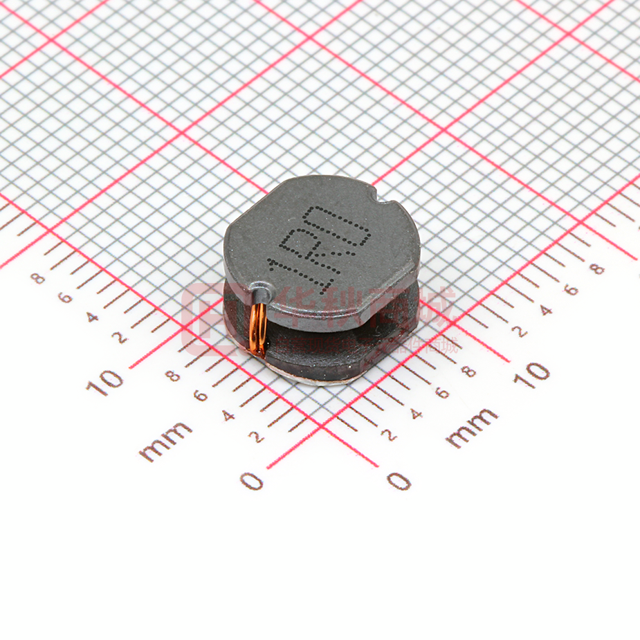

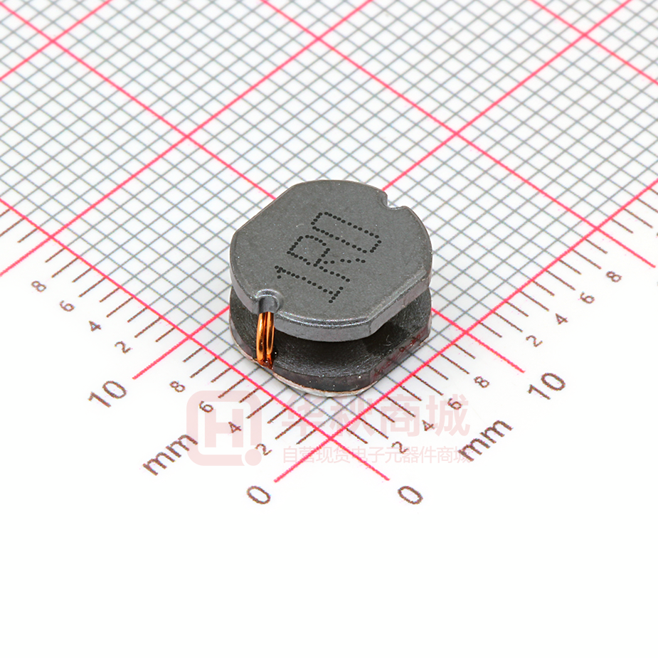

YP1005-1R0M 数据手册
SMD Power Inductors -YP1005 Series ■ Features ● High current Type. ● Ferrite bobbin core and compact size. ● Low core loss for high frequency power application. ● Large terminal surface for good PCB bonding. ● Operating temperature:-40℃ ~ +125℃. ■ Applications ● Portable communication equipment. ● Notebook PC,digital carmera,LCD television set. ● Power supply for VTR,OA equipment. ● DC/DC converters. ■ Product Identification ⑴ :Type ⑵ :Dimensions ⑶ :Inductance value ⑷:Inductance Tolerance:N=±30%,M=±20%,L=±15%,K=±10% ■ Shapes and Dimensions (Unit:mm) TYPE A B C D1 Ref. D2 Ref. E Ref. F Ref. YP1005 10.0±0.3 9.0±0.3 5.4±0.3 2.9 2.5 10.0 9.5 深圳市益嘉源电子有限公司 http://www.yjycoin.com Tel:0755-27803896 Fax:0755-27803897 -1- SMD Power Inductors -YP1005 Series ■ YP1005 Series Part Number Inductance (uH) L Test Frequency Max.DC Resistance Max.Rated Current (KHz) (Ω) (A) YP1005-1R0□ 1.00 100 0.008 10.50 YP1005-1R5□ 1.50 100 0.010 9.50 YP1005-2R2□ 2.20 100 0.013 8.50 YP1005-3R3□ 3.30 100 0.030 5.84 YP1005-4R7□ 4.70 100 0.035 4.50 YP1005-5R6□ 5.60 100 0.040 3.88 YP1005-6R8□ 6.80 100 0.050 3.64 YP1005-8R2□ 8.20 100 0.050 3.50 YP1005-100□ 10.0 100 0.060 2.60 YP1005-120□ 12.0 100 0.070 2.45 YP1005-150□ 15.0 100 0.080 2.27 YP1005-180□ 18.0 100 0.090 2.15 YP1005-220□ 22.0 100 0.100 1.95 YP1005-270□ 27.0 100 0.110 1.76 YP1005-330□ 33.0 100 0.120 1.50 YP1005-390□ 39.0 100 0.140 1.37 YP1005-470□ 47.0 100 0.170 1.28 YP1005-560□ 56.0 100 0.190 1.17 YP1005-680□ 68.0 100 0.220 1.11 YP1005-820□ 82.0 100 0.250 1.00 YP1005-101□ 100 100 0.350 0.97 YP1005-121□ 120 100 0.400 0.89 YP1005-151□ 150 100 0.470 0.78 深圳市益嘉源电子有限公司 http://www.yjycoin.com Tel:0755-27803896 Fax:0755-27803897 -2- SMD Power Inductors -YP1005 Series ■ YP1005 Series Part Number Inductance (uH) L Test Frequency Max.DC Resistance Max.Rated Current (KHz) (Ω) (A) YP1005-181□ 180 100 0.630 0.72 YP1005-221□ 220 100 0.730 0.66 YP1005-271□ 270 100 0.970 0.57 YP1005-331□ 330 100 1.150 0.52 YP1005-391□ 390 100 1.300 0.48 YP1005-471□ 470 100 1.480 0.42 YP1005-561□ 560 100 1.900 0.33 YP1005-681□ 680 100 2.250 0.28 YP1005-821□ 820 100 2.550 0.24 YP1005-102□ 1000 100 2.700 0.20 YP1005-222□ 2200 100 5.220 0.17 YP1005-472□ 4700 100 10.400 0.15 ※ The saturation current value is the DC current value having inductance decrease down to 30%.(at 20℃) ※ The temperature rise current value is the DC current value having temperature increase up to 40℃. (at 20℃) ※ The rated current is the DC current value that satisfies both of current value saturation current value and temperature rise current value. 深圳市益嘉源电子有限公司 http://www.yjycoin.com Tel:0755-27803896 Fax:0755-27803897 -3- SMD Power Inductors -YP1005 Series ■ Taping Dimensions(Unit:mm) TYPE W A B C D E P K Ref T MPQ YP1005 24±0.3 9.20±0.1 10.20±0.1 10.75 11.5±0.1 5.60±0.1 16.0±0.1 5.80 0.40±0.05 1000 ■ Reel Dimensions(Unit:mm) TYPE W W1 W2 W3 A B C D YP1005 330±2.0 24.4±1.50 30.4MAX 23.9 Min 13.0±0.50 21.0±0.80 2.0±0.50 100 Min 深圳市益嘉源电子有限公司 http://www.yjycoin.com Tel:0755-27803896 Fax:0755-27803897 -4- SMD Power Inductors -YP1005 Series ■ Direction of rolling ■ Cover tape peel off condition Cover tape peel force shall be 0.1N to 1.3N. Reference peel speed 300±10mm/min. 深圳市益嘉源电子有限公司 http://www.yjycoin.com Tel:0755-27803896 Fax:0755-27803897 -5-

物料型号:YP1005系列
器件简介:YP1005系列是高电流型SMD功率电感器,采用铁氧体骨架和紧凑尺寸设计,适用于高频电源应用,具有低核心损耗和大端面,便于PCB粘接。
引脚分配:文档中提供了详细的尺寸和引脚布局,例如YP1005型号的尺寸参数A、B、C、D1、D2、E、F等。
参数特性:列出了不同型号的电感值、测试频率、最大直流电阻和最大额定电流。
功能详解:文档中提到了电感器的应用领域,包括便携式通信设备、笔记本电脑、数码相机、液晶电视、VTR电源和OA设备、DC/DC转换器等。
应用信息:YP1005系列适用于多种便携式设备和电源转换应用,工作温度范围为-40℃至+125℃。
封装信息:提供了胶带尺寸和卷轴尺寸的详细信息,以及电感器的安装和取向指导。
