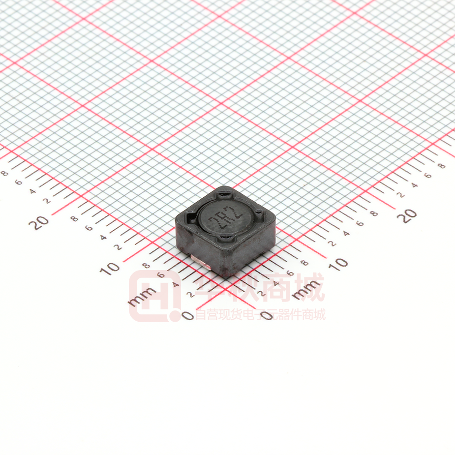

    功率电感 2.2µH ±20% 28mΩ IND_7.3X7.3MM_SM
YPRH0704-2R2M 数据手册
SMD Power Inductors -YPRH0704 Series ■ Features ● High current type. ● Ferrite bobbin core and compact size. ● Low core loss for high frequency power application. ● Large terminal surface for good PCB bonding. ● Operating temperature:-40℃ ~ +125℃. ■ Applications ● Portable communication equipment. ● Notebook PC,digital camera,LCD television set. ● Power supply for VTR,OA equipment. ● DC/DC converters. ■ Product Identification ⑴ :Type ⑵ :Dimensions ⑶ :Inductance value ⑷ :Inductance Tolerance;N=±30%,M=±20%,K=±10% ■ Shapes and Dimensions (Unit:mm) TYPE A B C max D E F Ref. G Ref. H Ref. YPRH0704 7.30±0.5 7.30±0.5 4.5 5.40±0.2 1.8 1.6 4.8 2.2 深圳市益嘉源电子有限公司 http://www.yjysmd.com.cn Tel:0755-27803896 Fax:0755-27803897 -1- SMD Power Inductors -YPRH0704 Series ■ YPRH0704 Series Part Number Inductance (uH) L Test Frequency Max.DC Resistance MAX.Rated Current (KHz) (Ω) (A) YPRH0704-1R0□ 1.00 100 0.015 9.00 YPRH0704-1R5□ 1.50 100 0.018 7.00 YPRH0704-2R2□ 2.20 100 0.028 6.00 YPRH0704-2R7□ 2.70 100 0.020 4.56 YPRH0704-3R3□ 3.30 100 0.025 4.20 YPRH0704-3R9□ 3.90 100 0.030 3.90 YPRH0704-4R7□ 4.70 100 0.038 3.70 YPRH0704-6R8□ 6.80 100 0.045 3.00 YPRH0704-100□ 10.0 100 0.049 1.84 YPRH0704-120□ 12.0 100 0.058 1.71 YPRH0704-150□ 15.0 100 0.081 1.47 YPRH0704-180□ 18.0 100 0.091 1.31 YPRH0704-220□ 22.0 100 0.110 1.23 YPRH0704-270□ 27.0 100 0.150 1.12 YPRH0704-330□ 33.0 100 0.170 0.96 YPRH0704-390□ 39.0 100 0.230 0.91 YPRH0704-470□ 47.0 100 0.260 0.88 YPRH0704-560□ 56.0 100 0.350 0.75 YPRH0704-680□ 68.0 100 0.380 0.69 YPRH0704-820□ 82.0 100 0.430 0.61 YPRH0704-101□ 100 100 0.610 0.60 YPRH0704-121□ 120 100 0.660 0.52 YPRH0704-151□ 150 100 0.880 0.46 YPRH0704-181□ 180 100 0.980 0.42 YPRH0704-221□ 220 100 1.170 0.36 YPRH0704-271□ 270 100 1.640 0.34 深圳市益嘉源电子有限公司 http://www.yjysmd.com.cn Tel:0755-27803896 Fax:0755-27803897 -2- SMD Power Inductors -YPRH0704 Series ■ YPRH0704 Series Part Number Inductance (uH) L Test Frequency Max.DC Resistance MAX.Rated Current (KHz) (Ω) (A) YPRH0704-331□ 330 100 1.860 0.32 YPRH0704-391□ 390 100 2.850 0.29 YPRH0704-471□ 470 100 3.010 0.26 YPRH0704-561□ 560 100 3.620 0.23 YPRH0704-681□ 680 100 4.630 0.22 YPRH0704-821□ 820 100 5.200 0.20 YPRH0704-102□ 1000 100 6.000 0.18 ※ The saturation current value is the DC current value having inductance decrease down to 30%.(at 20℃) ※ The temperature rise current value is the DC current value having temperature increase up to 40℃. (at 20℃) ※ The rated current is the DC current value that satisfies both of current value saturation current value and temperature rise current value. 深圳市益嘉源电子有限公司 http://www.yjysmd.com.cn Tel:0755-27803896 Fax:0755-27803897 -3- SMD Power Inductors -YPRH0704 Series ■ Taping Dimensions(Unit:mm) TYPE MPQ W A B C D E YPRH0704 1000 16±0.3 7.8±0.1 7.8±0.1 6.75 7.5±0.1 4.8±0.1 P K 12±0.1 T 5.1 Ref 0.35±0.05 ■ Reel Dimensions(Unit:mm) TYPE W W1 W2 W3 A B C D YPRH0704 330±2.00 16.4±1.50 22.40 Max 15.90 Min 13.0±0.50 21.0±0.80 2.0±0.50 100 Min 深圳市益嘉源电子有限公司 http://www.yjysmd.com.cn Tel:0755-27803896 Fax:0755-27803897 -4- SMD Power Inductors -YPRH0704 Series ■ Direction of rolling ■ Cover tape peel off condition Cover tape peel force shall be 0.1N to 1.3N. Reference peel speed 300±10mm/min. 深圳市益嘉源电子有限公司 http://www.yjysmd.com.cn Tel:0755-27803896 Fax:0755-27803897 -5-
