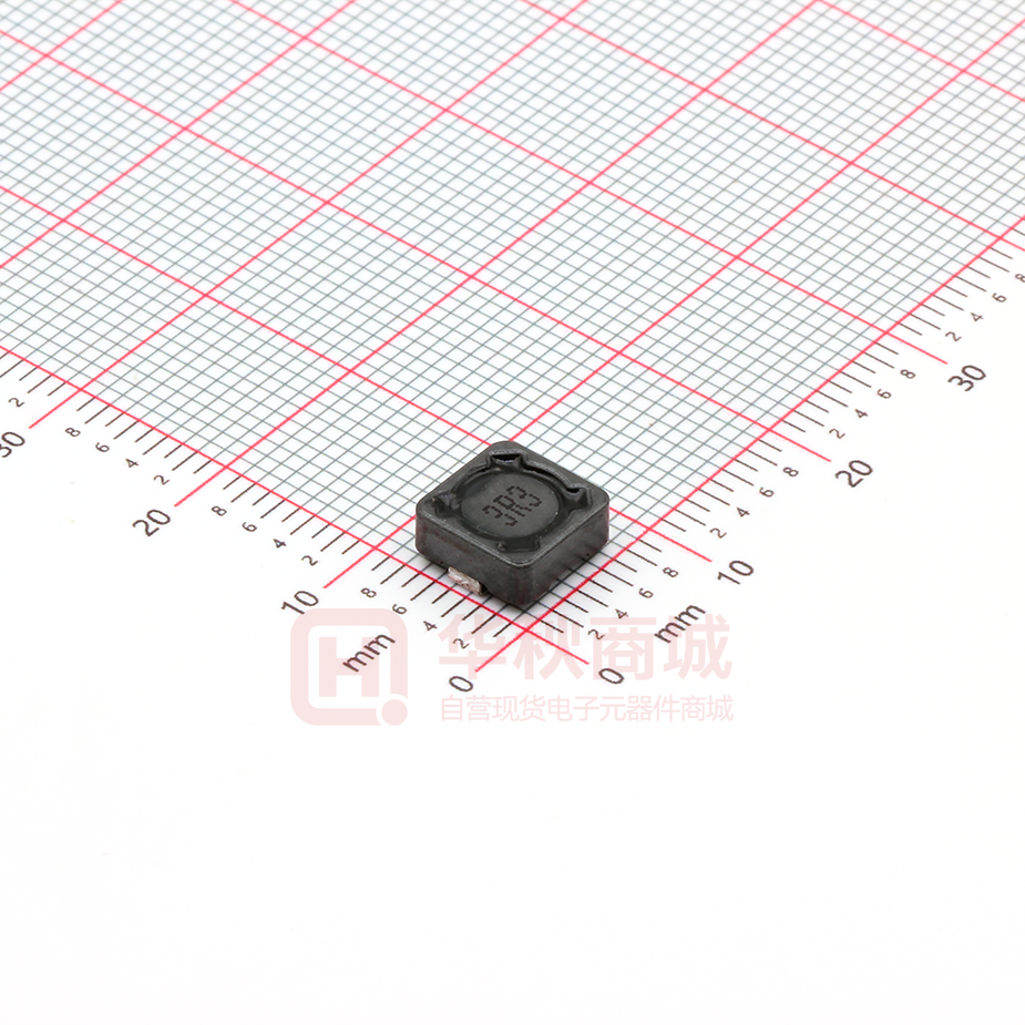

    功率电感 3.3µH ±20% 25mΩ IND_7.3X7.3MM_SM
YPRH0704-3R3M 数据手册
SMD Power Inductors -YPRH0704 Series ■ Features ● High current type. ● Ferrite bobbin core and compact size. ● Low core loss for high frequency power application. ● Large terminal surface for good PCB bonding. ● Operating temperature:-40℃ ~ +125℃. ■ Applications ● Portable communication equipment. ● Notebook PC,digital camera,LCD television set. ● Power supply for VTR,OA equipment. ● DC/DC converters. ■ Product Identification ⑴ :Type ⑵ :Dimensions ⑶ :Inductance value ⑷ :Inductance Tolerance;N=±30%,M=±20%,K=±10% ■ Shapes and Dimensions (Unit:mm) TYPE A B C max D E F Ref. G Ref. H Ref. YPRH0704 7.30±0.5 7.30±0.5 4.5 5.40±0.2 1.8 1.6 4.8 2.2 深圳市益嘉源电子有限公司 http://www.yjysmd.com.cn Tel:0755-27803896 Fax:0755-27803897 -1- SMD Power Inductors -YPRH0704 Series ■ YPRH0704 Series Part Number Inductance (uH) L Test Frequency Max.DC Resistance MAX.Rated Current (KHz) (Ω) (A) YPRH0704-1R0□ 1.00 100 0.015 9.00 YPRH0704-1R5□ 1.50 100 0.018 7.00 YPRH0704-2R2□ 2.20 100 0.028 6.00 YPRH0704-2R7□ 2.70 100 0.020 4.56 YPRH0704-3R3□ 3.30 100 0.025 4.20 YPRH0704-3R9□ 3.90 100 0.030 3.90 YPRH0704-4R7□ 4.70 100 0.038 3.70 YPRH0704-6R8□ 6.80 100 0.045 3.00 YPRH0704-100□ 10.0 100 0.049 1.84 YPRH0704-120□ 12.0 100 0.058 1.71 YPRH0704-150□ 15.0 100 0.081 1.47 YPRH0704-180□ 18.0 100 0.091 1.31 YPRH0704-220□ 22.0 100 0.110 1.23 YPRH0704-270□ 27.0 100 0.150 1.12 YPRH0704-330□ 33.0 100 0.170 0.96 YPRH0704-390□ 39.0 100 0.230 0.91 YPRH0704-470□ 47.0 100 0.260 0.88 YPRH0704-560□ 56.0 100 0.350 0.75 YPRH0704-680□ 68.0 100 0.380 0.69 YPRH0704-820□ 82.0 100 0.430 0.61 YPRH0704-101□ 100 100 0.610 0.60 YPRH0704-121□ 120 100 0.660 0.52 YPRH0704-151□ 150 100 0.880 0.46 YPRH0704-181□ 180 100 0.980 0.42 YPRH0704-221□ 220 100 1.170 0.36 YPRH0704-271□ 270 100 1.640 0.34 深圳市益嘉源电子有限公司 http://www.yjysmd.com.cn Tel:0755-27803896 Fax:0755-27803897 -2- SMD Power Inductors -YPRH0704 Series ■ YPRH0704 Series Part Number Inductance (uH) L Test Frequency Max.DC Resistance MAX.Rated Current (KHz) (Ω) (A) YPRH0704-331□ 330 100 1.860 0.32 YPRH0704-391□ 390 100 2.850 0.29 YPRH0704-471□ 470 100 3.010 0.26 YPRH0704-561□ 560 100 3.620 0.23 YPRH0704-681□ 680 100 4.630 0.22 YPRH0704-821□ 820 100 5.200 0.20 YPRH0704-102□ 1000 100 6.000 0.18 ※ The saturation current value is the DC current value having inductance decrease down to 30%.(at 20℃) ※ The temperature rise current value is the DC current value having temperature increase up to 40℃. (at 20℃) ※ The rated current is the DC current value that satisfies both of current value saturation current value and temperature rise current value. 深圳市益嘉源电子有限公司 http://www.yjysmd.com.cn Tel:0755-27803896 Fax:0755-27803897 -3- SMD Power Inductors -YPRH0704 Series ■ Taping Dimensions(Unit:mm) TYPE MPQ W A B C D E YPRH0704 1000 16±0.3 7.8±0.1 7.8±0.1 6.75 7.5±0.1 4.8±0.1 P K 12±0.1 T 5.1 Ref 0.35±0.05 ■ Reel Dimensions(Unit:mm) TYPE W W1 W2 W3 A B C D YPRH0704 330±2.00 16.4±1.50 22.40 Max 15.90 Min 13.0±0.50 21.0±0.80 2.0±0.50 100 Min 深圳市益嘉源电子有限公司 http://www.yjysmd.com.cn Tel:0755-27803896 Fax:0755-27803897 -4- SMD Power Inductors -YPRH0704 Series ■ Direction of rolling ■ Cover tape peel off condition Cover tape peel force shall be 0.1N to 1.3N. Reference peel speed 300±10mm/min. 深圳市益嘉源电子有限公司 http://www.yjysmd.com.cn Tel:0755-27803896 Fax:0755-27803897 -5-

物料型号:YPRH0704系列
器件简介: - 高电流型 - 采用铁氧体骨架和紧凑尺寸 - 低核心损耗,适用于高频电源应用 - 大端面,便于PCB粘接 - 工作温度范围:-40℃至+125℃
应用信息: - 便携式通信设备 - 笔记本电脑、数码相机、液晶电视 - VTR、办公自动化设备的电源 - DC/DC转换器
产品识别: - 型号:YPRH0704 - 尺寸:7.30±0.5mm x 7.30±0.5mm - 电感值:1.00uH至1000uH - 电感公差:N=±30%, M=±20%, K=±10%
参数特性: - 电感值测试频率:100KHz - 最大直流电阻:0.015Ω至6.000Ω - 最大额定电流:0.18A至9.00A
封装信息: - 封装类型:MPQ - 封装尺寸:16±0.3mm x 7.8±0.1mm - 卷带尺寸:330±2.00mm x 16.4±1.50mm - 卷带间距:4.0+0.1mm
引脚分配:文档中未明确提供引脚分配信息,但通常SMD电感器会有标识引脚的图形。
功能详解: - 饱和电流值:在20℃时,电感值下降到30%的直流电流值 - 温升电流值:在20℃时,温度上升40℃的直流电流值 - 额定电流:满足饱和电流值和温升电流值的直流电流值
