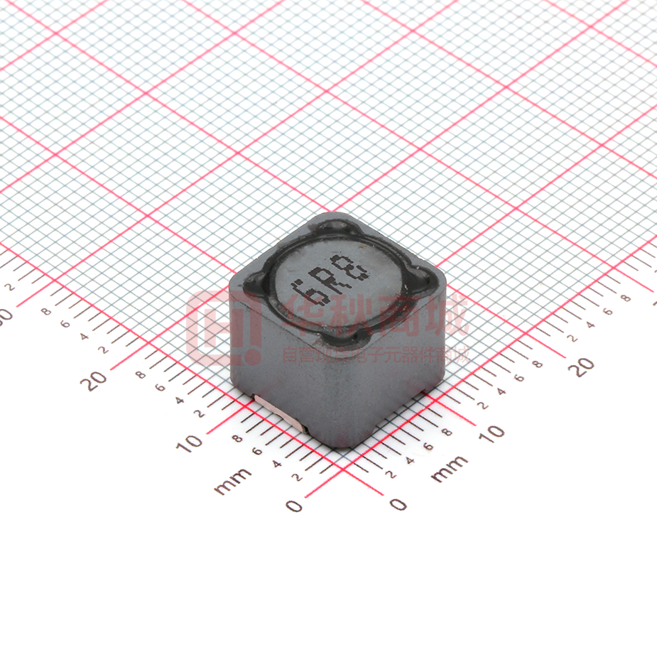

SMD Power Inductors -YPRH1209 Series ■ Features ● High current type. ● Ferrite bobbin core and compact size. ● Low core loss for high frequency power application. ● Large terminal surface for good PCB bonding. ● Operating temperature:-40℃ ~ +125℃. ■ Applications ● Portable communication equipment. ● Notebook PC,digital camera,LCD television set. ● Power supply for VTR,OA equipment. ● DC/DC converters. ■ Product Identification ⑴ :Type ⑵ :Dimensions ⑶ :Inductance value ⑷ :Inductance Tolerance;N=±30%,M=±20%,K=±10% 深圳市益嘉源电子有限公司 http://www.yjycoin.com Tel:0755-27803896 Fax:0755-27803897 -1- SMD Power Inductors -YPRH1209 Series ■ Shapes and Dimensions (Unit:mm) TYPE A B C max D E F Ref. G Ref. H Ref. YPRH1209 12.0±0.5 12.0±0.5 10.0 7.60±0.2 5.0 2.8 7.0 5.4 ■ YPRH1209 Series Part Number Inductance (uH) L Test Frequency Max.DC Resistance MAX.Rated Current (KHz) (Ω) (A) YPRH1209-1R0□ 1.00 100 0.006 19.90 YPRH1209-1R8□ 1.80 100 0.007 13.40 YPRH1209-2R5□ 2.50 100 0.008 12.16 YPRH1209-3R5□ 3.50 100 0.010 12.00 YPRH1209-4R7□ 4.70 100 0.011 10.08 YPRH1209-6R8□ 6.80 100 0.013 8.56 YPRH1209-7R5□ 7.50 100 0.014 8.48 YPRH1209-100□ 10.0 100 0.018 7.12 YPRH1209-120□ 12.0 100 0.019 7.04 YPRH1209-150□ 15.0 100 0.026 5.84 YPRH1209-180□ 18.0 100 0.028 5.48 YPRH1209-220□ 22.0 100 0.029 5.12 YPRH1209-270□ 27.0 100 0.042 4.68 YPRH1209-330□ 33.0 100 0.053 4.25 YPRH1209-390□ 39.0 100 0.058 3.92 深圳市益嘉源电子有限公司 http://www.yjycoin.com Tel:0755-27803896 Fax:0755-27803897 -2- SMD Power Inductors -YPRH1209 Series Part Number Inductance (uH) L Test Frequency Max.DC Resistance MAX.Rated Current (KHz) (Ω) (A) YPRH1209-470□ 47.0 100 0.063 3.60 YPRH1209-560□ 56.0 100 0.068 2.85 YPRH1209-680□ 68.0 100 0.093 2.76 YPRH1209-820□ 82.0 100 0.099 2.62 YPRH1209-101□ 100 100 0.126 2.31 YPRH1209-121□ 120 100 0.154 2.05 YPRH1209-151□ 150 100 0.174 1.80 YPRH1209-181□ 180 100 0.191 1.66 YPRH1209-221□ 220 100 0.246 1.64 YPRH1209-271□ 270 100 0.314 1.46 YPRH1209-331□ 330 100 0.386 1.28 YPRH1209-391□ 390 100 0.428 1.17 YPRH1209-471□ 470 100 0.471 1.06 YPRH1209-561□ 560 100 0.650 1.01 YPRH1209-681□ 680 100 0.730 0.83 YPRH1209-821□ 820 100 0.824 0.81 YPRH1209-102□ 1000 100 1.220 0.70 YPRH1209-122□ 1200 100 1.330 0.64 YPRH1209-152□ 1500 100 1.990 0.56 YPRH1209-182□ 1800 100 2.180 0.48 YPRH1209-222□ 2200 100 2.580 0.43 ※ The saturation current value is the DC current value having inductance decrease down to 30%.(at 20℃) ※ The temperature rise current value is the DC current value having temperature increase up to 40℃. (at 20℃) ※ The rated current is the DC current value that satisfies both of current value saturation current value and temperature rise current value. 深圳市益嘉源电子有限公司 http://www.yjycoin.com Tel:0755-27803896 Fax:0755-27803897 -3- SMD Power Inductors -YPRH1209 Series ■ Taping Dimensions(Unit:mm) TYPE MPQ W A B C D E P K YPRH1209 400 24±0.3 12.6±0.1 12.6±0.1 10.75 11.5±0.1 8.2±0.1 20±0.1 10 Ref T 0.4±0.05 ■ Reel Dimensions(Unit:mm) TYPE W W1 W2 W3 A B C D YPRH1209 330±2.00 24.4±1.50 30.40 Max 23.90 Min 13.0±0.50 21.0±0.80 2.0±0.50 100 Min 深圳市益嘉源电子有限公司 http://www.yjycoin.com Tel:0755-27803896 Fax:0755-27803897 -4- SMD Power Inductors -YPRH1209 Series ■ Direction of rolling ■ Cover tape peel off condition Cover tape peel force shall be 0.1N to 1.3N. Reference peel speed 300±10mm/min. 深圳市益嘉源电子有限公司 http://www.yjycoin.com Tel:0755-27803896 Fax:0755-27803897 -5-
YPRH1209-6R8M
物料型号:YPRH1209系列
器件简介:该系列电感器是高电流型,采用铁氧体骨架和紧凑尺寸设计,适用于高频电源应用,具有低核心损耗和大端面,便于PCB粘接,工作温度范围为-40℃至+125℃。
引脚分配:文档中未明确提供引脚分配信息,但通常SMD电感器的端面较大,便于焊接。
参数特性:包括电感值、测试频率、最大直流电阻和额定电流等。例如,YPRH1209-1R0型号的电感值为1.00微亨,最大直流电阻为0.006欧姆,额定电流为19.90安培。
功能详解:文档中未提供详细的功能解释,但电感器通常用于储能、滤波和抑制电磁干扰。
应用信息:适用于便携式通信设备、笔记本电脑、数码相机、液晶电视、录像机、办公自动化设备和DC/DC转换器等。
封装信息:提供了详细的尺寸信息,包括类型、最大A、B、C、D、E、F、G、H尺寸,以及胶带尺寸和卷轴尺寸。
制造商信息:深圳市益嘉源电子有限公司,提供了联系电话和传真号码,以及公司网址。
