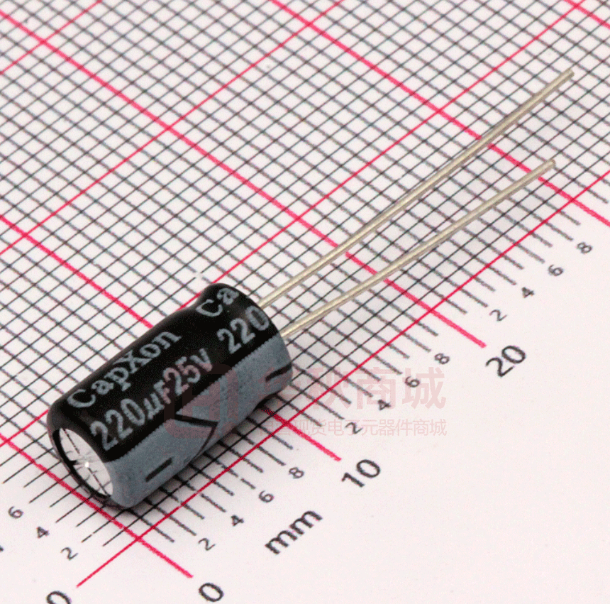

    直插铝电解电容 插件,D6.3xL11mm 220µF ±20% Ф6.30 x 11.00mm 25V 2000Hrs@105℃
KM221M025E110A 数据手册
KM Series KM Series Standard 105℃ Features ◆ Used in communication equipments, switching power supply, etc. ◆ Safety vent construction design. ◆ For detail specifications, please refer to Engineering Bulletin No. E102 ◆ RoHS Compliant Specifications Item Performance Characteristics Operating Temperature Range Rated Voltage Range Capacitance Range Capacitance Tolerance Leakage Current (+20℃,max.) Dissipation Factor (tanδ,at 20℃,120Hz) -40 to +105℃ 6.3 to 100 VDC 0.1 to 22000 μF -25 to +105℃ 160 to 450 VDC 0.47 to 470 μF ±20% (120Hz, +20℃) I≦0.01 CV or 3 (μA) I≦0.03 CV (μA) After 1 minute whichever is greater measured with rated working voltage applied. Working Voltage(VDC) D.F. (%)max. 6.3 22 10 17 16 15 25 14 After 1 minute with rated working voltage applied. 35 12 50 10 63 9 100 8 63 2 3 100 2 3 Working Voltage(VDC) 160 200 250 350 400 450 D.F. (%)max. 12 12 12 15 15 17 For capacitance >1000φF, add 2% per another 1000μF. Low Temperature Characteristics (at 120Hz) Working Voltage(VDC) Z-25℃ Z+20℃ Z-40℃ Z+20℃ 6.3 4 8 10 3 6 16 2 4 25 2 3 35 2 3 50 2 3 Working Voltage(VDC) Z-25℃ Z+20℃ 160 200 250 350 400 450 2 2 3 5 6 6 Radial Impedance ratio max For Capacitance >1000 μF, add 0.5 per another 1000 μF for -25℃ +20℃ add 1 per another 1000 μF for -40℃ +20℃ Load Life Test conditions Duration time :2000Hrs Ambient temperature :+105℃ Applied voltage :Rated DC working voltage After test requirement at +20℃ Capacitance change :≦ ±20% of the initial measured value Dissipation factor :≦ 200% of the initial specified value Leakage current :≦ The initial specified value Shelf Life Test conditions Duration time :1000Hrs Ambient temperature :+105℃ Applied voltage :None After test requirement at +20℃:Same limits as Load life. Pre-treatment for measurements shall be conducted after application of DC working voltage for 30 minutes. Multiplier for Ripple Current vs. Frequency CAP(μF) Frequency(Hz) 50(60) 120 CAP≦10 0.8 1 10<CAP≦100 0.8 1 100<CAP≦1000 0.8 1 1000<CAP 0.8 1 400 1.30 1.23 1.16 1.11 1K 1.45 1.36 1.25 1.17 10K 50K-100K 1.65 1.70 1.48 1.53 1.35 1.38 1.25 1.28 Diagram of Dimensions:(unit:mm) Dφ F dφ α 5 2.0 6.3 2.5 0.5 D<18 1.5 109 8 3.5 L<20 0.5 L≧20 0.6 10 5.0 D=18 L<35.5 L≧35.5 1.5 2.0 13 5.0 0.6 D>18 2.0 16 7.5 18 7.5 0.8 22 10 KM Series Case Size φDxL(mm) WV (SV) Cap(μF) 4.7 6.8 10 22 33 47 68 100 120 150 180 220 330 470 560 680 820 1000 1200 1500 1800 2200 2700 3300 3900 4700 5600 6800 8200 10000 12000 15000 18000 22000 6.3 (8) Size 10 (13) 16 (20) Ripple Size Ripple 5X11 5X11 5X11 5X11 54 65 75 96 5X11 5X11 5X11 5X11 5X11 45 60 70 80 105 5X11 110 5X11 6.3X11 6.3X11 120 130 140 5X11 6.3X11 5X11 6.3X11 6.3X11 110 120 120 145 160 6.3X11 160 6.3X11 6.3X11 195 6.3X11 8X11.5 8X11.5 220 270 310 8X11.5 360 8X11.5 10X12.5 25 (32) Size Ripple 5X11 5X11 5X11 5X11 5X11 5X11 6.3X11 6.3X11 35 54 64 100 105 115 130 155 6.3X11 170 6.3X11 175 390 430 6.3X11 8X11.5 6.3X11 8X11.5 8X11.5 10X12.5 8X11.5 8X16 10X12.5 10X12.5 205 255 235 290 330 340 365 410 480 520 10X12.5 550 10X16 630 10X16 625 10X16 10X16 10X20 10X20 710 750 775 850 8X20 10X16 10X20 10X20 13X20 13X20 13X20 13X25 13X25 16X25 16X25 16X31.5 16X35.5 18X31.5 18X41 960 1000 1150 1300 1480 1520 1680 1750 2075 2150 2300 10X25 13X20 13X20 13X20 13X25 16X25 16X25 16X31.5 16X35.5 16X35.5 18X35.5 18X35.5 35 (44) Size 5X11 5X11 5X11 5X11 5X11 5X11 6.3X11 6.3X11 Ripple 26 32 38 58 69 105 120 145 6.3X11 175 190 6.3X11 8X11.5 8X11.5 180 200 210 6.3X11 215 8X11.5 235 6.3X11 8X11.5 8X11.5 8X16 225 265 370 400 10X12.5 8X16 10X12.5 10X16 10X12.5 10X16 10X20 410 470 480 550 540 600 700 8X11.5 10X12.5 8X11.5 10X12.5 10X16 310 335 410 440 460 10X16 10X20 10X20 520 640 710 13X20 810 715 770 820 860 10X20 820 13X20 900 13X20 13X20 920 1000 13X25 13X25 1050 1200 880 920 1100 1280 1350 1490 1670 1840 1900 2050 2180 2205 13X20 1080 16X25 1320 13X25 16X25 16X25 16X31.5 16X31.5 16X35.5 18X35.5 18X35.5 1200 1490 1600 1720 1900 2020 2060 2150 16X25 16X31.5 16X35.5 16X35.5 18X35.5 18X35.5 1460 1670 1780 1890 2050 2090 Size 5X11 5X11 5X11 5X11 5X11 5X11 6.3X11 6.3X11 8X11.5 8X11.5 Ripple 28 36 46 61 75 110 140 160 175 185 8X11.5 215 8X11.5 10X12.5 8X11.5 10X12.5 10X12.5 225 265 255 300 400 10X16 520 10X20 540 10X20 13X20 13X20 13X20 560 650 760 830 13X20 13X25 13X25 900 930 960 16X25 16X25 16X31.5 16X31.5 1150 1290 1350 1480 16X35.5 18X31.5 18X35.5 18X35.5 1650 1820 1900 2000 Ripple Current ( mA, rms ) at 105℃ 120Hz 110 KM Series φDxL(mm) Cap(μF) 0.1 0.22 0.33 0.47 1 2.2 3.3 4.7 6.8 10 22 33 47 68 100 120 150 180 220 330 470 560 680 820 1000 1200 1500 1800 2200 2700 3300 50 (63) 63 (79) 100 (125) 160 (200) Size 5X11 5X11 5X11 5X11 5X11 Ripple 1.3 2.9 4 7 13 Size 5X11 5X11 5X11 5X11 5X11 Ripple 1.3 2.9 4.5 7 13 Size 5X11 5X11 5X11 5X11 5X11 Ripple 1.9 3.4 5 10 15 5X11 5X11 20 26 5X11 5X11 20 28 5X11 5X11 21 30 5X11 32 5X11 32 5X11 35 5X11 40 5X11 40 6.3X11 47 5X11 48 5X11 60 5X11 6.3X11 6.3X11 42 48 82 6.3X11 8X11.5 6.3X11 56 60 75 6.3X11 5X11 70 75 6.3X11 100 8X11.5 8X11.5 90 140 6.3X11 6.3X11 90 115 6.3X11 8X11.5 8X11.5 130 155 200 6.3X11 8X11.5 8X11.5 10X12.5 10X12.5 125 140 155 185 230 10X12.5 8X16 10X12.5 10X16 155 165 170 240 10X20 280 8X16 10X12.5 10X12.5 220 225 245 10X16 255 10X20 295 10X16 270 10X12.5 10X16 10X12.5 10X16 10X16 10X20 10X20 13X20 13X20 13X20 13X25 13X25 13X25 16X25 16X25 16X31.5 16X35.5 16X35.5 18X35.5 18X35.5 260 280 345 360 450 470 600 650 660 700 770 850 890 1000 1150 1300 1480 1530 1590 1750 10X16 310 10X16 10X20 13X20 375 400 580 13X20 13X25 13X20 13X25 13X25 340 360 410 480 520 16X25 690 13X20 690 13X25 16X25 770 880 16X25 16X31.5 920 1185 16X25 16X31.5 16X35.5 16X35.5 18X31.5 18X35.5 18X41 820 860 900 920 950 1020 1200 16X35.5 18X31.5 1200 1350 200 (250) Size Ripple Size Ripple 5X11 5X11 6.3X11 6.3X11 6.3X11 11 17 19 25 32 5X11 6.3X11 12 17 6.3X11 8X11.5 8X11.5 38 42 56 8X11.5 10X12.5 10X12.5 10X16 10X20 10X16 63 75 95 105 120 155 6.3X11 6.3X11 8X11.5 6.3X11 8X11.5 8X11.5 10X12.5 8X11.5 10X12.5 10X16 25 33 35 42 50 60 63 78 85 125 10X20 10X20 13X20 13X20 13X25 13X25 16X25 13X25 16X25 16X25 170 180 210 260 280 310 330 320 350 470 10X20 10X16 10X20 13X20 13X20 130 160 180 190 220 16X25 550 16X31.5 16X35.5 18X31.5 18X35.5 18X35.5 18X41 560 580 660 700 810 860 13X20 13X25 13X25 16X25 16X25 16X31.5 16X25 16X31.5 16X31.5 16X35.5 16X35.5 18X31.5 18X35.5 18X41 18X41 22X41 18X51 270 300 320 345 360 390 440 480 550 560 670 690 750 810 840 925 940 Ripple Current ( mA, rms ) at 105℃ 120Hz 111 Radial WV (SV) KM Series φDxL(mm) WV (SV) Cap(μF) 0.47 1 250 (300) 350 (400) Size 6.3X11 6.3X11 8X11.5 Ripple 13 16 31 8X11.5 34 46 10X12.5 8X11.5 38 47 10X12.5 50 10X12.5 52 8X11.5 10X12.5 60 70 10X12.5 79 8X11.5 10X12.5 10X16 10X20 13X20 13X20 68 80 110 125 150 190 10X16 10X20 13X20 47 13X20 13X25 230 240 56 13X20 13X25 2.2 3.3 4.7 6.8 10 22 33 68 82 100 120 150 180 220 330 Size 5X11 6.3X11 6.3X11 8X11.5 8X11.5 Ripple 8 16 20 25 33 8X11.5 400 (450) 420 (470) Size 6.3X11 6.3X11 6.3X15 8X11.5 6.3X15 8X11.5 10X12.5 8X11.5 10X12.5 10X16 Ripple 14 17 34 35 35 36 41 48 55 65 87 92 160 8X14 8X16 10X16 10X16 10X20 13X20 13X25 13X20 13X25 16X25 16X31.5 170 180 200 245 260 255 280 16X25 13X25 310 16X25 16X25 355 370 16X25 16X31.5 16X31.5 16X35.5 16X35.5 18X31.5 18X31.5 18X35.5 18X35.5 18X41 18X45 22X41 450 (500) Size 6.3X11 8X11.5 8X11.5 Ripple 14 20 35 Size 6.3X11 8X11.5 10X12.5 Ripple 14 20 35 10X12.5 42 10X12.5 58 8X11.5 10X12.5 10X16 8X16 32 38 42 44 10X16 61 75 80 90 110 125 170 10X16 84 10X12.5 10X16 10X16 10X20 45 50 65 72 10X20 10X20 96 112 10X20 13X20 13X20 92 98 165 13X25 13X20 13X25 16X25 16X31.5 190 235 260 300 360 13X25 185 16X25 16X31.5 230 310 13X25 16X25 180 210 330 16X25 16X31.5 360 400 16X35.5 390 16X31.5 370 470 385 18X35.5 500 375 395 420 18X31.5 390 18X35.5 555 16X41 400 430 460 460 465 470 650 700 720 780 18X35.5 18X41 400 420 18X41 18X41 630 660 340 380 350 370 400 370 450 460 470 465 480 525 560 580 650 18X45 690 18X41 430 440 480 500 470 520 530 550 550 580 580 610 650 700 18X31.5 16X35.5 18X25 16X35.5 18X31.5 18X25 18X31.5 18X31.5 18X35.5 18X31.5 18X35.5 18X35.5 18X35.5 18X41 18X45 16X31.5 16X35.5 18X25 16X31.5 16X35.5 18X25 16X35.5 18X31.5 18X35.5 18X31.5 18X35.5 18X35.5 18X41 18X41 22X41 18X45 680 22X41 500 Ripple Current ( mA, rms ) at 105℃ 120Hz 112

物料型号:CapXon KM系列
器件简介:KM系列电容器适用于通信设备、开关电源等,具有安全泄压结构设计,符合RoHS标准。
引脚分配:文档中未提供具体的引脚分配信息。
参数特性: - 工作温度范围:-40至+105°C - 额定电压范围:6.3至100VDC或160至450VDC - 电容范围:0.1至22000μF或0.47至470μF - 电容公差:±20%(120Hz,+20°C) - 漏电流(+20°C,最大值)和损耗角正切(tanδ)在不同工作电压下有具体数值。
功能详解: - KM系列电容器设计用于高温环境下,具有优异的电气性能和可靠性。 - 提供详细的损耗角正切、低温特性、负载寿命和储存寿命测试条件和结果。
应用信息:适用于高温、高可靠性要求的场合,如通信设备和开关电源。
封装信息:提供了详细的尺寸图表和安全装置设计,以及不同电容值对应的封装尺寸(φDxL毫米)。
