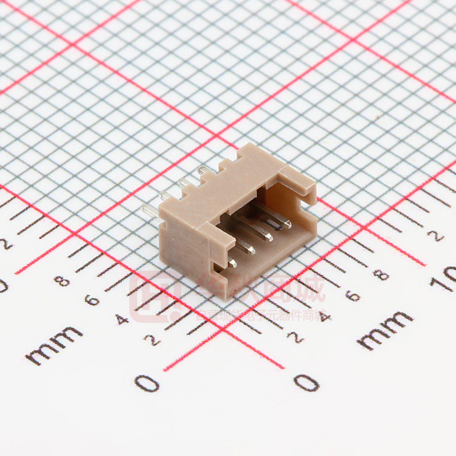

A1252 SERIES 1.25mm pitch wire to board connector Specifications Current rating:1A AC,DC Voltage rating:150V AC,DC Temperature range:-40°C~+105°C Contact resistance:30m Max. Insulation resistance:500M Min. Withstanding voltage:500V AC/minute *Compliant with RoHS and REACH* *Meet the HF/Halogen Free,need to customize* *Contact CJT for details* Standards E326732 E326732 1.50 0.80 5.50 REF 0.80 3.60 5.30 REF 3.40 DIP TYPE 3.40 6.10 5.90 REF 3.65 5.90 REF 6.00 REF SMT TYPE CHANGJIANG CONNECTORS TEL:+86-755-29959119 29959129 FAX:+86-755-29959139 Http://www.CJT.cn A-50 A1252 SERIES A1252-T 1.25mm pitch wire to board connector 1.25mm pitch Crimp Terminal Reference Informations: *Used in CJT A1252H-XP, A1252HA-XP series Housing 0.15 1.35±0.25 0.75±0.20 0.30±0.10 1.45±0.20 SEC:B-B 0.34±0.10 1.20±0.25 B 0.80 B 1.20±0.10 A 0.92 A 3.90±0.25 SEC:A-A 1.70±0.25 0.50±0.20 1.55±0.25 0.85±0.10 Unit:mm Ordering information & Specifications: Part NO. Wire Range Insulation O.D. Material Finish Qty/reel A1252-TP AWG#26-#30 1.00mm(max) Phosphor Bronze Tin over Nickel 10,000 PCS AWG#26-#30 1.00mm(max) Phosphor Bronze Gold over Nickel 10,000 PCS A1252-GP Optional Gold plating available but MOQ requested A1252H-XP 1.25mm pitch Single Row Housing Reference Informations: *Material:Nylon 66,UL94V-0 *Suitable CJT A1252-T series Terminal *Mates with CJT A1252WV,WR,WV-S,WV-S-F,WR-S,WR-S-F-XP series Single Row Wafer *Color:Gray Ordering Information: A1252H-XP - *** 1 2 1.Part No. 2.Material: (Blank):Nylon 66,UL94V-0 GWT :Nylon 66,UL94V-0 GWT 750 ℃ 1.25±0.10 Ordering Information & Dimensions: A±0.20 PART NO. B±0.25 4.00±0.25 2.30±0.25 Circuit 1 3.20±0.25 2P 3P 4P 5P 6P 7P 8P 9P 10P 11P 12P 13P 14P 15P Dimensions A B 1.25 4.15 2.50 5.40 3.75 6.65 5.00 7.90 6.25 9.15 7.50 10.40 8.75 11.65 10.00 12.90 11.25 14.15 12.50 15.40 13.75 16.65 15.00 17.90 16.25 19.15 17.50 20.40 Unit: mm CHANGJIANG CONNECTORS TEL:+86-755-29959119 29959129 FAX:+86-755-29959139 Http://www.CJT.cn A-51 A1252 SERIES A1252HA-XP 1.25mm pitch wire to board connector 1.25mm pitch Single Row Housing Reference Informations: *Material:Nylon 66,UL94V-0 *Suitable CJT A1252-T series Terminal *Color:White Ordering Information: A1252HA-XP - *** 1 2 1.Part No. 2.Material: (Blank):Nylon 66,UL94V-0 GWT :Nylon 66,UL94V-0 GWT 750 ℃ 1.25±0.10 A±0.20 Ordering Information & Dimensions: 2.30±0.25 PART NO. 1.45±0.20 0.80 5.75±0.25 4.00±0.25 B±0.20 Circuit 1 1.50 C±0.25 1.50 3.20±0.25 2P 3P 4P 5P 6P 7P 8P 9P 10P 11P 12P 13P 14P 15P A 1.25 2.50 3.75 5.00 6.25 7.50 8.75 10.00 11.25 12.50 13.75 15.00 16.25 17.50 Dimensions B 2.90 4.15 5.40 6.65 7.90 9.15 10.40 11.65 12.90 14.15 15.40 16.65 17.90 19.15 C 4.15 5.40 6.65 7.90 9.15 10.40 11.65 12.90 14.15 15.40 16.65 17.90 19.15 20.40 Unit: mm A1252H-2xXP 1.25mm pitch Dual Row Housing Reference Informations: *Material:Nylon 66,UL94V-0 *Suitable CJT A1252-T series Terminal *Mates with CJT A1252WV-S,WV-S-F-2xXP series Dual Row Wafer *Color:Gray Ordering Information: A1252H-2xXP - *** 1 2 1.Part No. 2.Material: (Blank):Nylon 66,UL94V-0 GWT :Nylon 66,UL94V-0 GWT 750 ℃ Circuit 1 1.25±0.10 Circuit 2 1.25±0.10 A±0.20 B±0.25 4.30±0.25 4.05±0.25 Ordering Information & Dimensions: PART NO. 5.20±0.25 2x5P 2x7P 2x10P 2x15P 2x20P Dimensions A B 5.00 10.40 7.50 12.90 11.25 16.65 17.50 22.90 23.75 29.15 Unit: mm CHANGJIANG CONNECTORS TEL:+86-755-29959119 29959129 FAX:+86-755-29959139 Http://www.CJT.cn A-52 A1252 SERIES A1252WV-XP 1.25mm pitch wire to board connector 1.25mm pitch 180° Single Row Wafer Ordering Information: A1252WV-XP - *** - ** 1 2 3 1.Part No. 2.Material: (Blank):Nylon 66,UL94V-0 GWT:Nylon 66,UL94V-0,GWT 750 ℃ 3.Finish: (Blank):Tin over Nickel G:Gold over Nickel Reference Informations: *Material:Pin:Brass/Tin over Nickel Insulator:Nylon 66,UL94V-0 *Mates with CJT A1252H-XP series Single Row Housing *Color:Gray Circuit 1 1.25±0.10 Ø0.60±0.05 1.25±0.10 P.C.B LAYOUT A±0.20 Ordering Information & Dimensions: PART NO. B±0.25 2.30±0.20 4.30±0.25 3.40±0.25 PIN 0.35 SQ 2P 3P 4P 5P 6P 7P 8P 9P 10P 11P 12P 13P 14P 15P Dimensions A B 1.25 3.75 2.50 5.00 3.75 6.25 5.00 7.50 6.25 8.75 7.50 10.00 8.75 11.25 10.00 12.50 11.25 13.75 12.50 15.00 13.75 16.25 15.00 17.50 16.25 18.75 17.50 20.00 Unit: mm A1252WR-XP 1.25mm pitch 90° Single Row Wafer Ordering Information: A1252WR-XP - *** - ** 1 2 3 1.Part No. 2.Material: (Blank):Nylon 66,UL94V-0 GWT:Nylon 66,UL94V-0 GWT 750 ℃ 3.Finish: (Blank):Tin over Nickel G:Gold over Nickel Reference Informations: *Material:Pin:Brass/Tin over Nickel Insulator:Nylon 66,UL94V-0 *Mates with CJT A1252H-XP series Single Row Housing *Color:Gray Circuit 1 1.25±0.10 Ø0.60±0.05 P.C.B LAYOUT Ordering Information & Dimensions: 1.25±0.10 PIN 0.35 SQ PART NO. A±0.20 3.60±0.25 4.50±0.25 5.40±0.25 B±0.25 2.30±0.20 2P 3P 4P 5P 6P 7P 8P 9P 10P 11P 12P 13P 14P 15P Dimensions A B 1.25 3.75 2.50 5.00 3.75 6.25 5.00 7.50 6.25 8.75 7.50 10.00 8.75 11.25 10.00 12.50 11.25 13.75 12.50 15.00 13.75 16.25 15.00 17.50 16.25 18.75 17.50 20.00 Unit: mm CHANGJIANG CONNECTORS TEL:+86-755-29959119 29959129 FAX:+86-755-29959139 Http://www.CJT.cn A-53 A1252 SERIES A1252WV-S-XP 1.25mm pitch wire to board connector Circuit 1 Ordering Information: A1252WV-S-XP - *** - ** 1 2 3 1.Part No. 2.Material: (Blank):Nylon 6T,UL94V-0 GWT:Nylon 6T,UL94V-0,GWT 750 ℃ 3.Finish: 1.25±0.05 (Blank):Tin over Nickel 0.70±0.10 G:Gold over Nickel 1.60±0.10 A±0.10 2.20±0.10 Reference Informations: *Material:Pin:Brass/Tin over Nickel Insulator:Nylon 6T,UL94V-0 Cap:Nylon 6T,UL94V-0 *Mates with CJT A1252H-XP series Single Row Housing *Color:Ivory 1.80±0.10 1.25mm pitch 180° Single Row Wafer-SMT TYPE B±0.10 P.C.B LAYOUT Ordering Information & Dimensions: 1.25±0.10 PART NO. A±0.20 PIN 0.35 SQ CAP (FOR PICK AND PLACE SYSTEMS) C±0.25 3.40±0.25 4.80±0.25 B±0.25 1.50±0.20 2P 3P 4P 5P 6P 7P 8P 9P 10P 11P 12P 13P 14P 15P A 1.25 2.50 3.75 5.00 6.25 7.50 8.75 10.00 11.25 12.50 13.75 15.00 16.25 17.50 Dimensions B 4.15 5.40 6.65 7.90 9.15 10.40 11.65 12.90 14.15 15.40 16.65 17.90 19.15 20.40 C 6.25 7.50 8.75 10.00 11.25 12.50 13.75 15.00 16.25 17.50 18.75 20.00 21.25 22.50 Unit: mm A±0.10 1.25±0.05 1.05 0.70±0.10 1.60±0.10 Ø0.90+0.05 -0.00 B±0.10 1.30±0.10 Ordering Information: A1252WV-S-F-XP - *** - ** 1 2 3 1.Part No. 2.Material: (Blank):Nylon 6T,UL94V-0 GWT:Nylon 6T,UL94V-0,GWT 750 ℃ 3.Finish: (Blank):Tin over Nickel G:Gold over Nickel 3.10±0.10 Reference Informations: *Material:Pin:Brass/Tin over Nickel Solder Tabs:Phosphor Bronze/Tin over Nickel Insulator:Nylon 6T,UL94V-0 Cap:Nylon 6T,UL94V-0 *Mates with CJT A1252H-XP series Single Row Housing *Color:Ivory P.C.B LAYOUT Circuit 1 PIN 0.35 SQ A±0.20 C±0.25 PART NO. CAP (FOR PICK AND PLACE SYSTEMS) 3.40±0.25 4.80±0.20 B±0.25 Ordering Information & Dimensions: Ø0.80 1.50±0.20 0.80 1.25±0.10 1.80±0.10 1.25mm pitch 180° Single Row Wafer-SMT TYPE 2.20±0.10 A1252WV-S-F-XP 2P 3P 4P 5P 6P 7P 8P 9P 10P 11P 12P 13P 14P 15P A 1.25 2.50 3.75 5.00 6.25 7.50 8.75 10.00 11.25 12.50 13.75 15.00 16.25 17.50 Dimensions B 4.15 5.40 6.65 7.90 9.15 10.40 11.65 12.90 14.15 15.40 16.65 17.90 19.15 20.40 C 6.25 7.50 8.75 10.00 11.25 12.50 13.75 15.00 16.25 17.50 18.75 20.00 21.25 22.50 Unit: mm CHANGJIANG CONNECTORS TEL:+86-755-29959119 29959129 FAX:+86-755-29959139 Http://www.CJT.cn A-54 A1252 SERIES 1.25mm pitch 90° Single Row Wafer-SMT TYPE Ordering Information: A1252WR-S-XP - *** - ** 1 2 3 1.Part No. 2.Material: (Blank):Nylon 6T,UL94V-0 GWT:Nylon 6T,UL94V-0 GWT 750 ℃ 3.Finish: (Blank):Tin over Nickel G:Gold over Nickel Circuit 1 1.60 B±0.10 2.40 1.80 Reference Informations: *Material:Pin:Brass/Tin over Nickel Solder Tabs:Phosphor Bronze/Tin over Nickel Insulator:Nylon 6T,UL94V-0 *Mates with CJT A1252H-XP series Single Row Housing *Color:Ivory 2.20 A1252WR-S-XP 1.25mm pitch wire to board connector 0.70 1.25 A±0.10 P.C.B LAYOUT 1.25±0.10 Ordering Information & Dimensions: A±0.20 PART NO. 2P 3P 4P 5P 6P 7P 8P 9P 10P 11P 12P 13P 14P 15P C±0.25 3.60±0.25 1.50±0.20 5.00±0.25 B±0.25 A 1.25 2.50 3.75 5.00 6.25 7.50 8.75 10.00 11.25 12.50 13.75 15.00 16.25 17.50 Dimensions B 4.15 5.40 6.65 7.90 9.15 10.40 11.65 12.90 14.15 15.40 16.65 17.90 19.15 20.40 PIN 0.35 SQ Unit: mm 1.25mm pitch 90° Single Row Wafer-SMT TYPE Circuit 1 1.60 B±0.10 2.20 1.90 ∅0.90+0.05 -0.00 0.50 Ordering Information: A1252WR-S-XP - *** - ** 1 2 3 1.Part No. 2.Material: (Blank):Nylon 6T,UL94V-0 GWT:Nylon 6T,UL94V-0 GWT 750 ℃ 3.Finish: (Blank):Tin over Nickel G:Gold over Nickel Reference Informations: *Material:Pin:Brass/Tin over Nickel Solder Tabs:Phosphor Bronze/Tin over Nickel Insulator:Nylon 6T,UL94V-0 *Mates with CJT A1252H-XP series Single Row Housing *Color:Ivory 1.80 A1252WR-S-F-XP C 6.25 7.50 8.75 10.00 11.25 12.50 13.75 15.00 16.25 17.50 18.75 20.00 21.25 22.50 0.70 1.05 1.25 A±0.10 P.C.B LAYOUT 1.25±0.10 Ordering Information & Dimensions: A±0.20 PART NO. C±0.25 3.60±0.25 B±0.25 1.50±0.20 5.00±0.25 0.80 2P 3P 4P 5P 6P 7P 8P 9P 10P 11P 12P 13P 14P 15P A 1.25 2.50 3.75 5.00 6.25 7.50 8.75 10.00 11.25 12.50 13.75 15.00 16.25 17.50 Dimensions B 4.15 5.40 6.65 7.90 9.15 10.40 11.65 12.90 14.15 15.40 16.65 17.90 19.15 20.40 C 6.25 7.50 8.75 10.00 11.25 12.50 13.75 15.00 16.25 17.50 18.75 20.00 21.25 22.50 Unit: mm PIN 0.35 SQ CHANGJIANG CONNECTORS TEL:+86-755-29959119 29959129 FAX:+86-755-29959139 Http://www.CJT.cn A-55 A1252 SERIES A1252WV-S-2xXP 1.25mm pitch wire to board connector 1.25mm pitch 180° Dual Row Wafer-SMT TYPE Reference Informations: *Material:Pin:Brass/Tin over Nickel Solder Tabs:Phosphor Bronze/Tin over Nickel Insulator:Nylon 6T,UL94V-0 Cap:Nylon 6T,UL94V-0 *Mates with CJT A1252H-2xXP series Dual Row Housing *Color:Ivory 1.25±0.10 1.85±0.10 1.25±0.05 0.35 1.25±0.10 A±0.10 Circuit 1 A±0.20 1.70±0.10 0.70±0.05 2.20±0.10 2.00±0.10 Ordering Information: A1252WV-S-2xXP - *** - ** 1 2 3 1.Part No. 2.Material: (Blank):Nylon 6T,UL94V-0 GWT:Nylon 6T,UL94V-0,GWT 750 ℃ 3.Finish: (Blank):Tin over Nickel G:Gold over Nickel 4.30±0.10 6.10±0.25 Circuit 2 P.C.B LAYOUT B±0.25 7.25±0.25 4.80±0.25 Ordering Information & Dimensions: PART NO. 2x5P 2x7P 2x10P 2x15P 2x20P 6.95±0.25 Dimensions A B 5.00 12.50 7.50 15.00 11.25 18.75 17.50 25.00 23.75 31.25 Unit: mm A1252WV-S-F-2xXP 1.25mm pitch 180° Dual Row Wafer-SMT TYPE 1.85±0.10 1.25±0.10 1.25±0.10 0.35 0.70±0.05 1.25±0.05 A±0.20 A±0.10 1.70±0.10 1.25±0.10 2.00±0.10 Circuit 1 4.30±0.10 ∅1.00+0.10 -0.00 2.20±0.10 6.10±0.25 Circuit 2 2.00±0.10 Reference Informations: *Material:Pin:Brass/Tin over Nickel Solder Tabs:Phosphor Bronze/Tin over Nickel Insulator:Nylon 6T,UL94V-0 Cap:Nylon 6T,UL94V-0 *Mates with CJT A1252H-2xXP series Dual Row Housing *Color:Ivory Ordering Information: A1252WV-S-F-2xXP - *** - ** 1 2 3 1.Part No. 2.Material: (Blank):Nylon 6T,UL94V-0 GWT:Nylon 6T,UL94V-0,GWT 750 ℃ 3.Finish: (Blank):Tin over Nickel G:Gold over Nickel P.C.B LAYOUT B±0.25 7.25±0.25 ∅0.80 0.60 4.80±0.25 Ordering Information & Dimensions: PART NO. 6.95±0.25 2x5P 2x7P 2x10P 2x15P 2x20P Dimensions A B 5.00 12.50 7.50 15.00 11.25 18.75 17.50 25.00 23.75 31.25 Unit: mm CHANGJIANG CONNECTORS TEL:+86-755-29959119 29959129 FAX:+86-755-29959139 Http://www.CJT.cn A-56

物料型号:A1252系列
器件简介: - 1.25mm间距线对板连接器,有多种类型,包括直插式(DIP)和表面贴装式(SMT)。
引脚分配: - 提供了多种引脚数量的选项,从2P到15P不等,具体引脚间距和尺寸在文档中有详细说明。
参数特性: - 电流额定值:1A AC/DC - 电压额定值:150V AC/DC - 工作温度范围:-40°C至+105°C - 接触电阻:最大30mΩ - 绝缘电阻:最小500MΩ - 耐电压:500V AC/分钟 - 符合RoHS和REACH标准
功能详解: - 连接器适用于多种应用,包括与CJT A1252H-XP、A1252HA-XP系列外壳配合使用。 - 提供了多种材料和表面处理选项,如磷青铜镀锡、镀金等。
应用信息: - 适用于需要小间距连接器的应用场合。
封装信息: - 提供了详细的组装布局和尺寸信息,以及订购信息,包括部件编号、尺寸、材料、完成类型和每卷数量。
其他: - 文档还提到了可选的金镀层,但需要最小订单量。 - 提供了制造商长江连接器的联系信息和网址。
