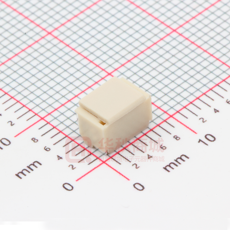

A1257WV-S-3P
A1257WV-S-3P
    CJT(长江连接器)
    SMD,P=1.25mm
    线对板针座 1x3P 立贴 间距:1.25mm
A1257WV-S-3P 数据手册
A1257 SERIES 1.25mm pitch wire to board connector Specifications Current rating:1A AC,DC Voltage rating:50V AC,DC Temperature range:-40°C~+105°C Contact resistance:30m Max. Insulation resistance:100M Min. Withstanding voltage:500V AC/minute *Compliant with RoHS and REACH* *Meet the HF/Halogen Free,need to customize* *Contact CJT for details* Standards E326732 E326732 4.59 0.80 0.80 4.59 7.20 REF. 7.10 REF. CHANGJIANG CONNECTORS TEL:+86-755-29959119 29959129 FAX:+86-755-29959139 Http://www.CJT.cn A-74 A1257 SERIES A1257-T 1.25mm pitch wire to board connector 1.25mm pitch Crimp Terminal Reference Informations: *Used in CJT A1257H-XP,A1257HA-XP series Housing 1.42±0.25 1.40±0.25 0.12 0.40±0.20 0.90±0.25 SEC: A-A A 1.00±0.25 A SEC: B-B 0.80-0.15 0.55±0.10 2.20±0.10 C 1.56±0.20 C +0.05 2.35±0.20 B 0.80±0.20 B 4.75±0.25 0.25±0.10 0.55±0.10 0.40±0.10 SEC:C-C Ordering information & Specifications: Unit:mm Part NO Wire Range Insulation O.D. Material Finish Qty/reel A1257-TP AWG#28-#32 1.00mm(max) Phosphor Bronze Tin over Nickel 20,000 PCS AWG#28-#32 1.00mm(max) Phosphor Bronze Gold over Nickel 20,000 PCS A1257-GP Optional Gold plating available but MOQ requested A1257H-XP 1.25mm pitch Housing Reference Informations: *Material:Nylon 66,UL94V-0 *Suitable CJT A1257-T series Terminal *Mates with CJT A1257WV-S,WR-S-XP series Wafer *Color:White A±0.20 Circuit 1 3.55±0.25 2.80±0.20 1.25±0.10 Ordering Information: A1257H-XP - *** - *** 1 2 3 1.Part No. 2.Material: (Blank):Nylon 66,UL94V-0 GWT:Nylon 66,UL94V-0,GWT 750 ℃ 3.Color: (Blank):White BK:Black BL:Blue OR:Orange LE:Light blue TR:Tomato red LY:Lemon yellow MG:Moss green DPK:Dark pink Ordering Information & Dimensions: PART NO. 4.20±0.25 5.75±0.25 B±0.25 2.00±0.20 2P 3P 4P 5P 6P 7P 8P 9P 10P 11P 12P 13P 14P 15P Dimensions A B 1.25 3.75 2.50 5.00 3.75 6.25 5.00 7.50 6.25 8.75 7.50 10.00 8.75 11.25 10.00 12.50 11.25 13.75 12.50 15.00 13.75 16.25 15.00 17.50 16.25 18.75 17.50 20.00 Unit: mm CHANGJIANG CONNECTORS TEL:+86-755-29959119 29959129 FAX:+86-755-29959139 Http://www.CJT.cn A-75 A1257 SERIES A1257HA-XP 1.25mm pitch wire to board connector 1.25mm pitch Housing Reference Informations: *Material:PBT,UL94V-0 *Suitable CJT A1257-T series Terminal *Color:White A±0.20 Circuit 1 6.70±0.25 6.00±0.20 4.15±0.25 Ordering Information: A1257HA-XP - *** 1 2 1.Part No. 2.Material: (Blank):PBT,UL94V-0 GWT:PBT,UL94V-0,GWT 750 ℃ 3.30±0.20 3.70±0.20 1.25±0.10 Ordering Information & Dimensions: PART NO. 4P 5P 7P 8P 10P B±0.25 Dimensions A B 3.75 6.05 5.00 7.30 7.50 9.80 8.75 11.05 11.25 13.56 Unit: mm A1257WV-S-XP 1.25mm pitch 180° Wafer-SMT TYPE Reference Informations: *Material:Pin:Brass/Tin over Nickel Insulator:Nylon 9T,UL94V-0 *Mates with CJT A1257H-XP series Housing *Color:Ivory 0.60±0.05 2.80±0.10 1.25±0.05 1.35±0.10 3.90±0.10 Circuit 1 5.60±0.10 1.25±0.05 A±0.10 1.00±0.10 P.C.B LAYOUT B±0.20 4.25±0.20 4.05±0.20 0.20±0.05 Ordering Information: A1257WV-S-XP - *** - *** - * 1 2 3 4 1.Part No. 2.Material: (Blank):Nylon 9T,UL94V-0 GWT:Nylon 9T,UL94V-0,GWT 750 ℃ 3.Color: (Blank):Ivory BK:Black BL:Blue OR:Orange LE:Light blue TR:Tomato red LY:Lemon yellow MG:Moss green DPK:Dark pink 4.Finish: (Blank):Tin over Nickel G:Gold over Nickel 4.95±0.20 Ordering Information & Dimensions: PART NO. 2P 3P 4P 5P 6P 7P 8P 9P 10P 11P 12P 13P 14P 15P Dimensions A B 1.25 5.75 2.50 7.00 3.75 8.25 5.00 9.50 6.25 10.75 7.50 12.00 8.75 13.25 10.00 14.50 11.25 15.75 12.50 17.00 13.75 18.25 15.00 19.50 16.25 20.75 17.50 22.00 Unit: mm CHANGJIANG CONNECTORS TEL:+86-755-29959119 29959129 FAX:+86-755-29959139 Http://www.CJT.cn A-76 A1257 SERIES A1257WR-S-XP 1.25mm pitch wire to board connector 1.25mm pitch 90° Wafer-SMT TYPE Reference Informations: *Material:Pin:Brass/Tin over Nickel Insulator:Nylon 9T,UL94V-0 *Mates with CJT A1257H-XP series Housing *Color:Ivory A±0.10 2.70±0.10 1.25±0.05 Circuit 1 1.00±0.10 P.C.B LAYOUT B±0.20 4.90±0.20 4.25±0.20 4.05±0.20 0.20±0.05 0.60±0.05 1.35±0.10 3.70±0.10 5.40±0.10 1.25±0.05 Ordering Information: A1257WR-S-XP - *** - *** - * 1 2 3 4 1.Part No. 2.Material: (Blank):Nylon 9T,UL94V-0 GWT:Nylon 9T,UL94V-0,GWT 750 ℃ 3.Color: (Blank):Ivory BK:Black BL:Blue OR:Orange LE:Light blue TR:Tomato red LY:Lemon yellow MG:Moss green DPK:Dark pink 4.Finish: (Blank):Tin over Nickel G:Gold over Nickel 4.35±0.20 Ordering Information & Dimensions: PART NO. 2P 3P 4P 5P 6P 7P 8P 9P 10P 11P 12P 13P 14P 15P Dimensions A B 1.25 5.75 2.50 7.00 3.75 8.25 5.00 9.50 6.25 10.75 7.50 12.00 8.75 13.25 10.00 14.50 11.25 15.75 12.50 17.00 13.75 18.25 15.00 19.50 16.25 20.75 17.50 22.00 Unit: mm CHANGJIANG CONNECTORS TEL:+86-755-29959119 29959129 FAX:+86-755-29959139 Http://www.CJT.cn A-77
