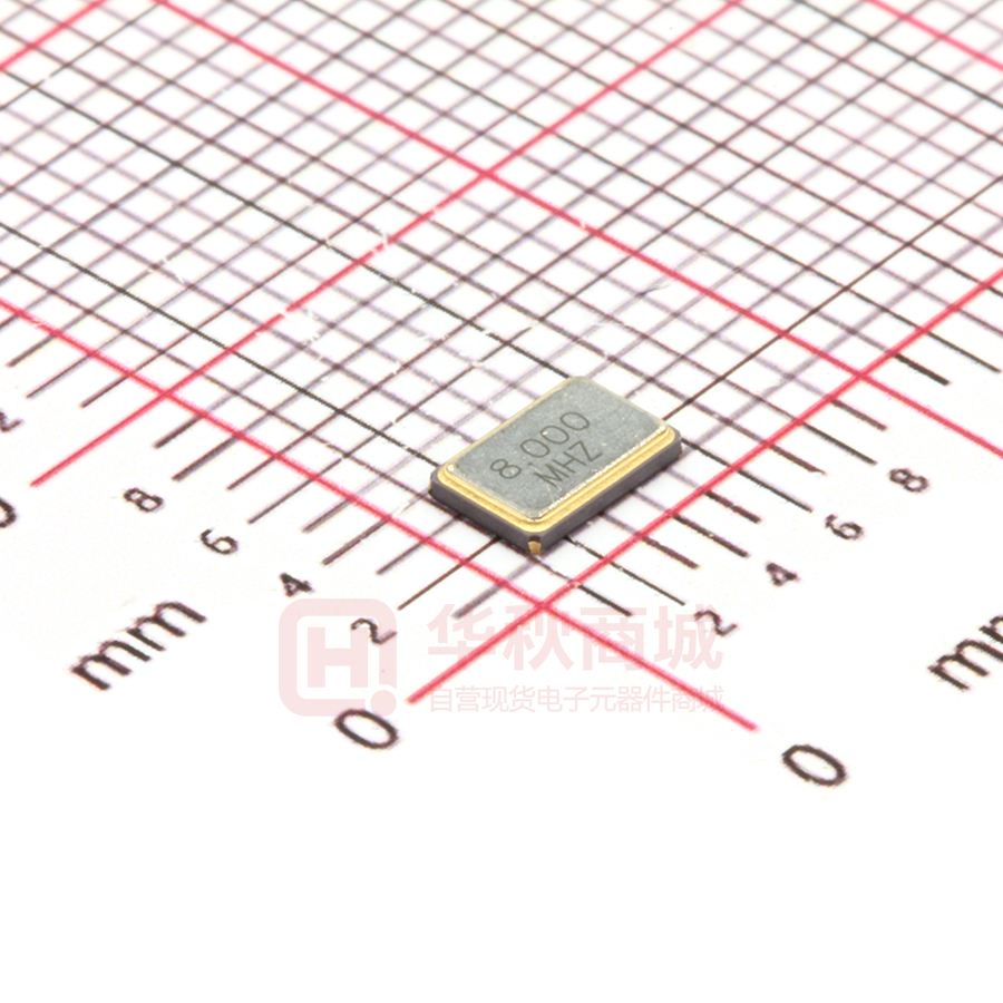

    无源晶振 8MHz 9pF ±20ppm 60Ω -40℃~+85℃ SMD5032_4P
TXM8.000M4503CDCE-O00T 数据手册
序号Serial No.2019010965 TAE雅晶 致TO: 日期Date:2019-01-09 深圳华强聚丰电子科技有限公司 QUARTZ CRYSTAL UNITS 产品ITEM: 石英晶体谐振器 型号TYPE: SMD-5032_4PIN_SEAM (TXM8.000M4503CDCE-O00T) 标称频率NOMINAL FREQUENCY: 8.000MHz /9PF +/-20PPM 请收到我们的规格书后,签字回传。 Please confirm you received this specification,sign and fax it to us. 接收确认RECEIVING CONFIRMATION 日期DATA 接收RECEIVED 浙江雅晶电子有限公司 ZheJiang ABEL Electron Co.,Ltd. 浙江省台州经济开发区经一路655号 655 JingYi RD. Economic Developing Zone TaiZhou,ZheJiang,China 电话/Tel:0086-576-89025257/89025258/18305768201 传真/Fax:0086-576-88501859 Post Code:318000 URL:www.taecn.com Email: market@taecn.com tae@taecn.com 拟制Prepared by: 应金会 批准Confirmed by: 王琴飞 ABEL ELECTRON SURFACE MOUNTABLE CRYSTAL UNITS(SMD Package) 表面贴装石英晶體諧振器 浙江雅晶電子有限公司 T-5032 RoHS Compliant Standard Features 特性 Nominal Frequency 标称频率:8.000MHz Suited for portable devices with low current consumption 適合於低功耗的便攜設備 For a clock source in electronic equipments 適用於电子設備的時鐘源 Item Model T5032 Frequency Range 标称频率 8.000MHz Frequency Tolerance 調整頻差 ±20ppm Max ±30ppm Max –40~+85℃ –40~+85℃ 60Ω Max 9PF 7.0pF Max 100μw Max ±3ppm/year Max 500Mohm/Min Freq. Tol. Over Temp. 溫度頻差 Operating Temp. Range 工作溫度範圍 Storage Temp. Range 保存溫度範圍 Series Resistance 諧振電阻 Load Capacitance 負載電容 Shunt Capacitance 靜態電容 Drive Level 激勵電平 Aging 老化率 Insulation Resistance 絕緣阻抗 Conditions at 25℃ –40~+85℃ DC100V±15V OUTLINE DIMENSIONS (unit:mm) Recommended land pattern MARKING #2 and #4 are connected to the cover.(please connect to ground) http://www.taecn.com ABEL ELECTRON 可靠性Reliability(Mechanical and Environmental Endurance) 序号 项目 NO ITEM 1 2 3 4 5 6 7 跌落 Drop 浙江雅晶电子有限公司 条件 CONDITIONS 合格标准 BASIS OF VERDICT 100cm高处自由跌落到3cm厚硬木板上,3次 △FL≤±5ppm High:100cm;Thickness:3cm;3 times △RS≤5Ωor±15% (whichever is larger) 频率 Frequency: 10~2000Hz;加速度幅度 Acceleration: 100 m/s2 振 △FL≤±5ppm 振动 Vibration 动方向 Direction: X, Y, Z △RS≤5Ωor±15% (Whichever is Larger) 振动时间 Duration: 每个方向30分钟 30 min/direction. 循环次数 Times: 12次 -55℃~+125℃,1000个循环 最大转换时间:5分钟;停留时间:5分钟 热冲击 △FL≤±10ppm Thermal shock -55℃~+125℃,For 1000 cycles △RS≤5Ωor±20% Maximum conversion time: 5 minutes;Remain time:5 minutes (Whichever is Larger) 湿热 温度:85℃;湿度:85%;时间:1000小时 △FL≤±10ppm Humidity Temp:85℃;Humidity:85%;Times:1000h △RS≤5Ωor±20% (Whichever is Larger) 低温 Cold resistance 温度:-40℃;时间:1000小时 △FL≤±10ppm Temp:-40℃;Times:1000h 高温:65℃(10小时,含升温),低温:25℃(2小时,含降 温),湿度90%,循环10次,每循环24小时 High-Temperature: 65℃±2℃ (10 hours, including 湿度抗性 Humidity heating), resistance Low-Temperature: 25℃±2℃ (2 hours, including cooling), Humidity: 90%, for 10 cycles (24 hours/cycle) 峰值 Peak: 100g's 持续时间 Duration: 6ms 机械冲击 Mechanical 波形 Waveform: 半正弦波 Half-sine 变化速度 Velocity Change: 12.3 ft / sec shock 振动方向 Direction: +X, -X, +Y, -Y, +Z, -Z 每个方向各3次 3 times/direction △RS≤5Ωor±20% (Whichever is Larger) △FL≤±10ppm △RS≤5Ωor±20% (Whichever is Larger) △FL≤±5ppm △RS≤5Ωor±15% (Whichever is Larger) ABEL ELECTRON 可靠性Reliability(Mechanical and Environmental Endurance) 序号 项目 NO ITEM 条件 CONDITIONS 浙江雅晶电子有限公司 合格标准 BASIS OF VERDICT △FL≤±5ppm 8 回流焊 Reflow △RS≤5Ωor±15% (Whichever is Larger) No Rusty 9 引脚拉力(SMD型) Pin pull 按照要求分别提供1.8kg的切向推力(60秒)以及1.8kg的垂直拉 力(60秒) In 电极不断裂 accordance with the requirements,offering 1.8kg tangential thrust (60 seconds), and 1.8kg vertical pull No Rupture Observed (60 seconds)respectively. 10 老化 温度:85℃;时间:1000小时 △FL≤±10ppm Aging Temp:85℃;Times:1000h △RS≤5Ωor±10% (Whichever is Larger) 可焊性 solderability 温度:235℃±5℃;时间:2秒 Temperature: 235℃±5℃; Time: 2sec 浸锡率≥95% Solder Coverage≥95% 11 备注 可靠性项目中的4、5、6、10,需在试验结束后24±2小时进行测试。
