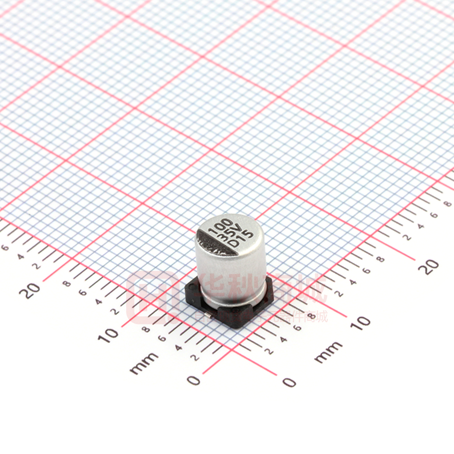

    贴片铝电解电容 SMD,D6.3xL7.7mm 100μF ±20% 35V 2000Hrs@105℃ 300mA
DV101M035E077ETR 数据手册
DV Series Chip type Features ZV ◆ Chip type ,Low impedance ◆ Chip type with load life of 2000 hours at +105℃ ◆ Designed for surface mounting on high density PC board ◆ Applicable to automatic mounting machine using carrier tape ◆ Complied to the RoHS directive ◆ For detail specifications, please refer to Engineering Bulletin NO. E173 DV Low Impedance SMD DV Series Specifications Item Operating Temperature Range Rated Voltage Range Capacitance Range Capacitance Tolerance Leakage Current (+20℃,max.) Performance Characteristics -55~ +105℃ 6.3~50 VDC 1 to 1500μF ±20%(120Hz,+20℃) I≦0.01 CV or 3 (μA)After 2 minutes whichever is greater measured with rated working voltage applied. Dissipation Factor (tanδ,at 20℃,120Hz) Working voltage(VDC) D.F. (%) max. 6.3 24 10 19 16 16 25 14 35 14 50 12 6.3 2 8 10 2 6 16 2 4 25 2 4 35 2 3 50 2 3 Impedance ratio max Low Temperature Characteristics (at 120Hz) Load Life Shelf Life Working voltage(VDC) Z-25℃ Z+20℃ Z-55℃ Z+20℃ Test conditions Duration time Ambient temperature Applied voltage :2000 Hrs :+105℃ :Rated DC working voltage After test requirement at +20℃ : Capacitance change :Within ±30% of initial value Dissipation factor :Less than 300% of specified value Leakage current :Less than specified value Test conditions Duration time :1000 Hrs Ambient temperature :+105℃ Applied voltage :None After test requirement at +20℃ : Same limits as Load life. Pre-treatment for measurements shall be conducted after application of DC working voltage for 30 minutes. The following specifications shall be satisfied when the capacitors are restored to20℃ after exposing them at 250℃ for 30 seconds. Resistance to soldering heat Leakage current Less than specified value Capacitance change Within ±10% of initial value tanδ Less than specified value Multiplier for Ripple Current vs. Frequency CAP(μF) Frequency(Hz) 60(50) 120 0.47 0.59 CAP≦10 0.52 0.65 10<CAP≦100 400 0.76 0.80 1K 0.85 0.89 10K 50K-100K 0.97 1.0 0.97 1.0 Diagram of Dimensions:(unit:mm) φD 4 5 6.3 6.3 8 8 10 71 L A B C 5.5 4.3 4.3 4.9 5.5 5.3 5.3 5.9 5.5 6.6 6.6 7.2 7.7 6.6 6.6 7.2 6.5 8.3 8.3 9.0 10.5 8.3 8.3 9.0 10.5 10.3 10.3 11.0 W 0.5~0.8 0.5~0.8 0.5~0.8 0.5~0.8 0.5~0.8 0.7~1.1 0.7~1.1 P 1.0 1.4 2.2 2.2 2.3 3.1 4.5 DV Series Case Size φDxL(mm) WV 6.3 (8) (SV) Cap (µF) Size 10 (13) Ripple Impedance Size 16 (20) Ripple Impedance Size 25 (32) Ripple Impedance 1.0 2.2 3.3 4.7 6.8 Size 35 (44) Ripple Impedance 4X5.5 70 2.8 Size 50 (63) Ripple Impedance Size Ripple Impedance 4X5.5 4X5.5 4X5.5 4X5.5 5X5.5 5X5.5 6.3X5.5 6.3X5.5 55 55 55 55 75 95 130 140 4.5 4.5 4.5 4.5 3.8 2.8 2.2 1.6 4X5.5 4X5.5 4X5.5 4X5.5 5X5.5 5X5.5 5X5.5 6.3X5.5 6.3X5.5 6.3X5.5 8X6.5 6.3X5.5 8X6.5 6.3X7.7 80 85 88 90 125 140 155 170 210 230 260 240 250 250 2.8 2.3 2.2 2.0 1.4 1.2 1.1 1.05 0.6 0.54 0.51 0.53 0.49 0.49 6.3X5.5 150 1.3 6.3X7.7 6.3X7.7 8X6.5 6.3X7.7 8X6.5 8X10.5 180 190 200 230 240 300 1.2 0.71 0.7 0.7 0.69 0.52 6.3X7.7 265 0.4 8X10.5 320 0.5 6.3X7.7 8X10.5 300 420 0.38 0.28 8X10.5 350 0.46 10 4X5.5 80 2.2 4X5.5 85 2.1 15 4X5.5 4X5.5 5X5.5 5X5.5 85 90 140 170 2.0 1.98 1.2 0.74 6.3X5.5 185 0.6 5X5.5 6.3X5.5 6.3X5.5 6.3X5.5 8X6.5 195 210 220 230 240 1.05 0.58 0.56 0.54 0.50 5X5.5 5X5.5 6.3X5.5 6.3X5.5 5X5.5 6.3X5.5 6.3X5.5 6.3X7.7 6.3X5.5 6.3X5.5 8X6.5 6.3X7.7 8X6.5 125 145 160 200 160 220 220 230 230 240 260 290 300 1.9 1.2 1.15 0.62 1.05 0.58 0.56 0.54 0.54 0.48 0.45 0.38 0.36 8X10.5 480 0.25 8X10.5 510 0.24 10X10.5 600 0.25 8X10.5 530 0.22 8X10.5 570 0.21 10X10.5 650 0.23 10X10.5 650 0.15 22 27 4X5.5 4X5.5 4X5.5 33 5X5.5 4X5.5 47 5X5.5 56 5X5.5 5X5.5 68 6.3X5.5 5X5.5 100 6.3X5.5 6.3X5.5 150 8X6.5 6.3X5.5 220 6.3X7.7 6.3X7.7 330 8X6.5 470 8X10.5 680 8X10.5 8X10.5 1000 10X10.5 1200 10X10.5 1500 10X10.5 75 2.2 4X5.5 80 2.2 79 82 130 86 150 150 160 220 170 230 235 250 240 260 275 290 450 500 530 570 600 650 1.98 1.9 1.3 1.88 1.1 1.10 0.9 0.55 0.8 0.53 0.51 0.48 0.48 0.45 0.36 0.34 0.28 0.25 0.20 0.17 0.16 0.13 5X5.5 4X5.5 5X5.5 5X5.5 6.3X5.5 6.3X5.5 125 90 150 165 180 210 1.9 1.85 1.2 1.1 0.59 0.57 6.3X5.5 220 0.55 6.3X5.5 240 0.53 6.3X5.5 255 0.52 6.3X5.5 8X6.5 6.3X7.7 8X6.5 250 260 270 285 0.49 0.47 0.44 0.40 6.3X7.7 8X6.5 6.3X7.7 8X6.5 265 270 275 285 0.45 0.44 0.43 0.41 8X10.5 500 0.25 8X10.5 550 0.25 8X10.5 570 0.2 8X10.5 10X10.5 550 680 0.25 0.2 8X10.5 10X10.5 590 720 0.22 0.16 10X10.5 650 0.15 10X10.5 740 0.15 Ripple Current ( mA, rms ) at 105℃ 100KHz Max Impedance (Ω) at 20℃ 100 KHz 72
