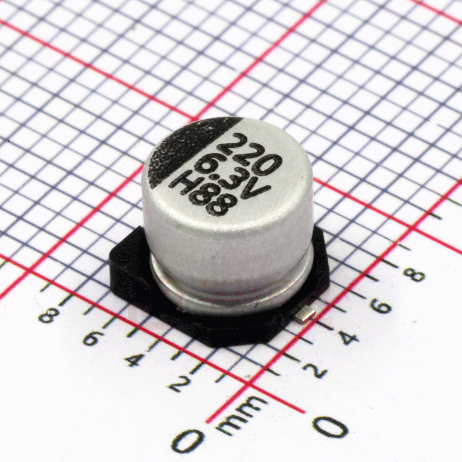

    贴片铝电解电容 SMD,D6.3xL5.5mm 220µF ±20% 6.3V 2000Hrs@105℃
HV221M6R3E055ETR 数据手册
HV series HV Series Features SMD ◆ Long life of 2000 hrs at 105℃ ◆ Reflow soldering is available ◆ Available for high density mounting ◆ For detail specifications, please refer to Engineering Bulletin No. E131 ◆ RoHS Compliant Specifications Item Operating Temperature Range Rated Voltage Range Capacitance Range Capacitance Tolerance Performance Characteristics -55 +105℃ 6.3~50 VDC 0.1 to 1500μF ±20%(120Hz,+20℃) I≦0.01 CV or 3 (μA) After 2 minutes, whichever is greater measured with rated working voltage applied Leakage Current (+20℃,max.) Dissipation Factor (tanδ,at 20℃,120Hz) Working voltage(VDC) 6.3 10 16 25 35 50 φ4~6.3 30 24 20 16 14 14 φ8~10 35 26 24 18 14 14 D.F.(%)max Impedance ratio max Rated voltage(VDC) Z-25℃ Z+20℃ Z-40℃ Z+20℃ Low Temperature Characteristics (at 120Hz) Load Life Shelf Life 6.3 6 12 10 4 10 16 4 8 25 3 6 35 2 4 50 2 4 Test conditions Duration time :2000 Hrs Ambient temperature :+105℃ Applied voltage :Rated DC working voltage After test requirement at +20℃: Capacitance change :Within ±30% of the initial value Dissipation factor :Not more than 300% of specified value Leakage current :Not more than the specified value Test conditions Duration time :1000 Hrs Ambient temperature :+105℃ Applied voltage :None After test requirement at +20℃ : Same limits as Load life. Pre-treatment for measurements shall be conducted after application of DC working voltage for 30 minutes. The capacitors shall be kept on the hot plate maintained at 250℃for 30 seconds. After removing form the hot plate and restored at room temperature, they meet the characteristic requirements listed under. Resistance to soldering heat Leakage current Capacitance change Less than specified value Within ±10% of initial value tanδ Less than specified value Multiplier for Ripple Current vs. Frequency CAP(μF) Frequency(Hz) 0.1≦CAP≦100μF 100<CAP≦1500μF 60(50) 0.8 0.8 120 1.0 1.0 500 1.20 1.10 1K 1.30 1.15 ≧10K 1.50 1.20 Diagram of Dimensions:(unit:mm) φD 4 5 6.3 6.3 8 8 10 Cathode 59 L A B C 5.5 4.3 4.3 4.9 5.5 5.3 5.3 5.9 5.5 6.6 6.6 7.2 7.7 6.6 6.6 7.2 6.5 8.3 8.3 9.0 10.5 8.3 8.3 9.0 10.5 10.3 10.3 11.0 W 0.5~0.8 0.5~0.8 0.5~0.8 0.5~0.8 0.5~0.8 0.7~1.1 0.7~1.1 P 1.0 1.4 2.2 2.2 2.3 3.1 4.5 HV Series Case Size φDxL(mm) WV (SV) Cap(μF) 0.1 0.22 0.33 0.47 1 2.2 3.3 4.7 10 Size 6.3 (8) Ripple Size 10 (13) Ripple Size 16 (20) Ripple 22 4X5.5 23 4X5.5 25 33 4X5.5 28 4X5.5 34 4X5.5 5X5.5 5X5.5 6.3X5.5 6.3X5.5 8X6.5 6.3X7.7 8X6.5 6.3X7.7 8X10.5 37 42 46 57 70 90 90 130 140 170 5X5.5 40 6.3X5.5 8X6.5 6.3X5.5 8X6.5 6.3X7.7 8X6.5 55 60 90 110 140 160 4X5.5 4X5.5 5X5.5 5X5.5 6.3X5.5 5X5.5 6.3X5.5 6.3X7.7 8X6.5 6.3X7.7 8X6.5 6.3X7.7 8X10.5 8X10.5 195 8X10.5 250 470 8X10.5 210 560 680 1000 1200 1500 8X10.5 10X10.5 10X10.5 10X10.5 10X10.5 310 370 480 500 520 8X10.5 10X10.5 10X10.5 10X10.5 10X10.5 350 420 450 480 530 8X10.5 10X10.5 10X10.5 10X10.5 370 420 480 540 47 100 150 220 330 Size 25 (32) 35 (44) Ripple Size Ripple 4X5.5 4X5.5 12 22 5X5.5 38 6.3X5.5 48 6.3X7.7 8X6.5 6.3X7.7 8X10.5 56 60 110 160 4X5.5 4X5.5 5X5.5 6.3X5.5 6.3X7.7 8X6.5 6.3X7.7 8X6.5 6.3X7.7 8X10.5 14 24 40 46 47 50 60 65 130 180 50 (63) Size 4X5.5 4X5.5 4X5.5 4X5.5 4X5.5 4X5.5 4X5.5 4X5.5 6.3X5.5 6.3X7.7 8X6.5 6.3X7.7 8X10.5 6.3X7.7 8X10.5 Ripple 1.0 2.0 3.0 4.0 8.4 11 13 18 28 50 55 95 135 115 155 10X10.5 315 20 31 35 36 40 45 56 58 62 125 140 170 185 8X10.5 175 8X10.5 190 10X10.5 330 8X10.5 10X10.5 180 190 8X10.5 10X10.5 250 280 10X10.5 350 8X10.5 290 10X10.5 360 10X10.5 440 Ripple Current ( mA, rms ) at 105℃ 60

物料型号:CapXon HV Series
器件简介:该系列电容器具有长寿命(在105℃下可达2000小时),可进行回流焊接,适用于高密度安装。
引脚分配:文档中未提供具体的引脚分配信息。
参数特性: - 工作温度范围:-55℃至+105℃ - 额定电压范围:6.3~50 VDC - 电容范围:0.1到1500μF - 电容公差:±20%(在120Hz和+20°C下) - 漏电流:在+20°C下,最大值为0.01 C或3μA,取两者中的较大值,测量时施加额定工作电压 - 耗散因子(在20°C和120Hz下):随工作电压不同而变化,6.3VDC时为最大4%,50VDC时为最大14%
功能详解: - 低温特性:在120Hz下,额定电压不同,阻抗比最大值也不同,例如6.3VDC时为6,50VDC时为2 - 负载寿命:在+105°C环境温度和额定直流工作电压下,持续时间为2000小时,电容变化在初始值的30%以内,耗散因子不超过规定值的300%,漏电流不超过规定值 - 储存寿命:在+105°C环境温度下,无施加电压,持续时间为1000小时,测试要求与负载寿命相同 - 耐焊热性:电容器在250°C的热板上保持30秒后,恢复至室温,满足特性要求
应用信息:文档中未提供具体的应用信息
封装信息:提供了尺寸图和不同电容值对应的封装尺寸,例如4X5.5、5X5.5等,以及对应的尺寸参数(D、L、A、B、C、W、P)。
