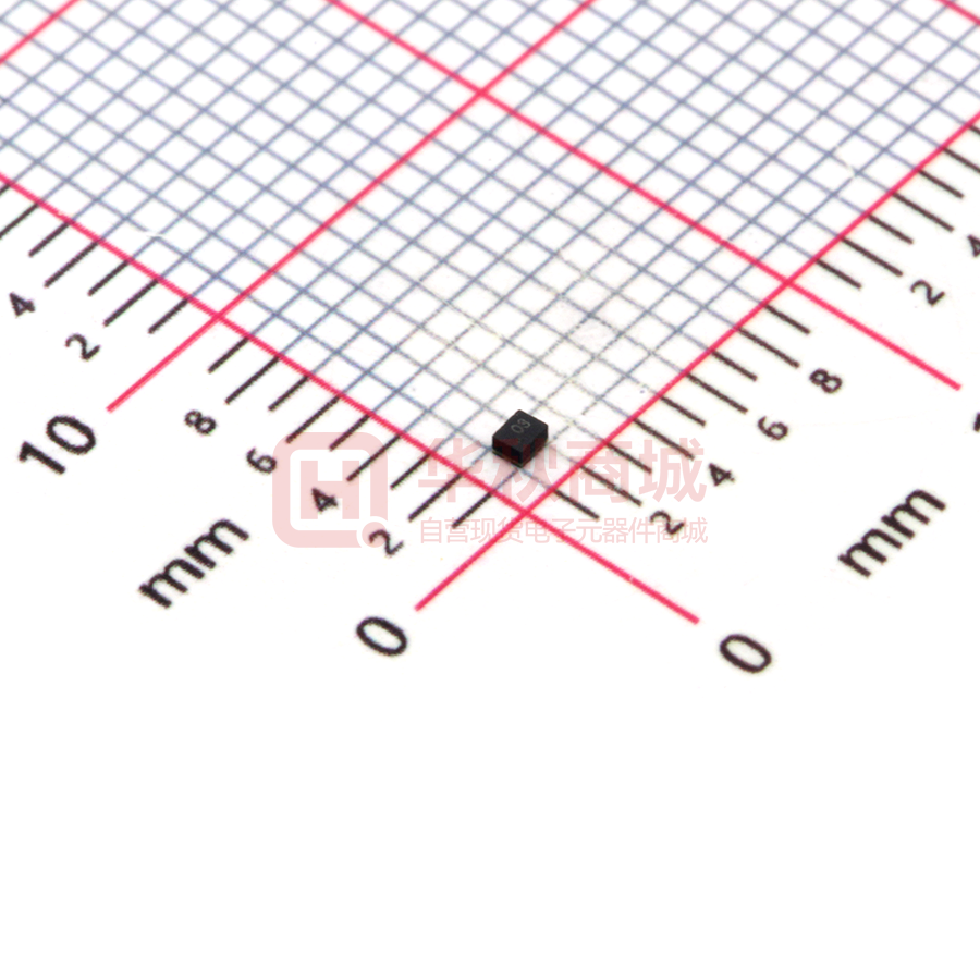

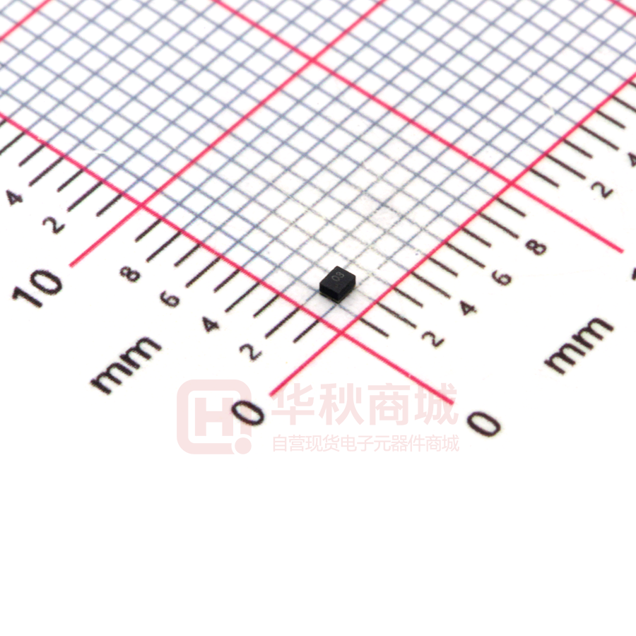

YTLP2313E LTE Band 40 Filter (2300~2400MHz) Description YTLP2313E is a high-performance, miniature filter designed for mobile equipment with LTE B40 band. It is designed with Film Bulk Acoustic Resonator (FBAR) technology, which can provide low insertion loss and steep skirt. So that this product enables coexistence of Wi-Fi signals within the same device or in close proximity to one another. For general performance, the YTLP2313E typical insertion loss in the pass band is less than 1.0dB, and max insertion loss is within 2.0dB over -20~+85°C, while the typical rejection at the Wi-Fi and LTE41 band are more than 35dB. For the chip package, the YTLP2313E uses advanced module packing techniques to achieve the industry standard 1.1x0.9x0.6mm footprint, include bumping and flip chip. Functional Block Diagram Features ● ● ● ● ● ● ● ● Pin Connection For Wi-Fi - LTE coexistence application Plastic Chip Scale Package(CSP) Miniature Size: 1.1mm x 0.9 mm x 0.6 mm High Rejection at Wi-Fi and LTE B41 bands. Low Temperature Coefficient of Frequency Storage temperature range: -40 to +150 ℃ Excellent ESD protection ability: Class 1C Moisture Sensitivity : MSL3 Environmental No. Function 1 Input 4 Output 2,3,5 Ground ● ● Full implement with RoHS compliant Lead Free (Pb free) YTLP2313E LTE Band 40 Filter (2300~2400MHz) Electrical Specifications Parameter(Operable Temperature:-20 to +85°C) Min Typ(1) Max(2) Unit Insertion Loss (2300 ~ 2400 MHz) \ 0.9 2.0 dB Ripple (2300 ~ 2400 MHz) \ 0.4 1.0 dB VSWR Input (2300 ~ 2400 MHz) \ 1.2 1.5 VSWR Output (2300 ~ 2400 MHz) \ 1.2 1.5 10 ~ 1574 MHz -23 -35 \ dB 1574 ~ 1577 MHz -23 -25 \ dB 1577 ~ 1680 MHz -22 -25 \ dB 1845 ~ 1880 MHz -22 -24 \ dB 2110 ~ 2170 MHz -26 -30 \ dB 2421 ~ 2443 MHz (ch05,18MHz-BW) -25 -55 \ dB 2421 ~ 2443 MHz (ch05,18MHz-BW,+25~+85°C) -40 -60 \ dB 2426 ~ 2448 MHz (ch06,18MHz-BW) -55 -60 \ dB 2431 ~ 2483 MHz (ch07-13,18MHz-BW) -40 -50 \ dB 4600 ~ 4800 MHz -45 -48 \ dB 6900 ~ 7200 MHz -31 -32 \ dB Absolute Attenuation RF Input Power(3)(2300 ~ 2400 MHz) 30 dBm (1) Typ Data is the integrated value of the linear S-parameter over indicated band at +25°C. (2) Min/Max Data is being specified over -20 to +85°C. (3) Input power applied for a minimum of 5,000 hrs at 55°C in the specified frequency band.         YTLP2313E LTE Band 40 Filter (2300~2400MHz) Typical Performance at Tc=25˚C Figure.2 Narrowband Insertion Loss VSWR2 VSWR1 Figure.1 Wideband Insertion Loss 10 20 5.0 2.0 1.0 0.5 10 20 .0 -2 -1.0 -1.0 .0 -2 -0 .5 -5.0   -0.2 -0 .5 -10 -20 Figure.5 Input Smith Chart S11 S(2,2) 10 20 5.0 2.0 1.0 0.5 S(1,1) 0.2 freq (2.300GHz to 2.400GHz) 5.0 -5.0 10 20 0.2 -0.2 2.0 5 0. 5.0 -10 -20 5 0. 2.0 1.0 Figure.4 Output VSWR S22 1.0 Figure.3 Input VSWR S11 freq (2.300GHz to 2.400GHz) Figure.6 Output Smith Chart S22 YTLP2313E LTE Band 40 Filter (2300~2400MHz) Package Outline Drawing 0.395 0.59±0.06 1.10±0.05 0.395 5x0.25x0.20 0.055 0.500 0.90±0.05 06 0.075 PIN1 Mark Notes:  1. Dimension: mm 2. Dimensions nominal unless otherwise noted 3. Contact area are gold plated 4. Pad(1) to (5) are same size 5. XX is ROFS inside code Pin Connection: 1 Input 4 Output 2.3.5 Ground Test Circuit 5 50ohm Input 4 1 L1=6.8nH 50ohm Output L2=6.8nH 2 3 Notes: 1. Matching component values shown are ROFS evaluation board results, please adjust component values by the actual use environment. Top View   PCB Footprint   Notes: 1. Black indicates metalized area. 2. This footprint represents a recommendation only, some modification may be necessary to suit end user assembly materials and processes. 3. For solder pad recommendation see mechanical information. 4. Dimensions shown are nominal in millimeters.   YTLP2313E LTE Band 40 Filter (2300~2400MHz) Packing 1. Tape Dimension 2. Reel Dimension 5000Pcs/Reel   YTLP2313E LTE Band 40 Filter (2300~2400MHz) Recommended IR Reflow Profile Order Information   Part Number Qty Per Reel Container YTLP2313E 5000 7 inch Reel
