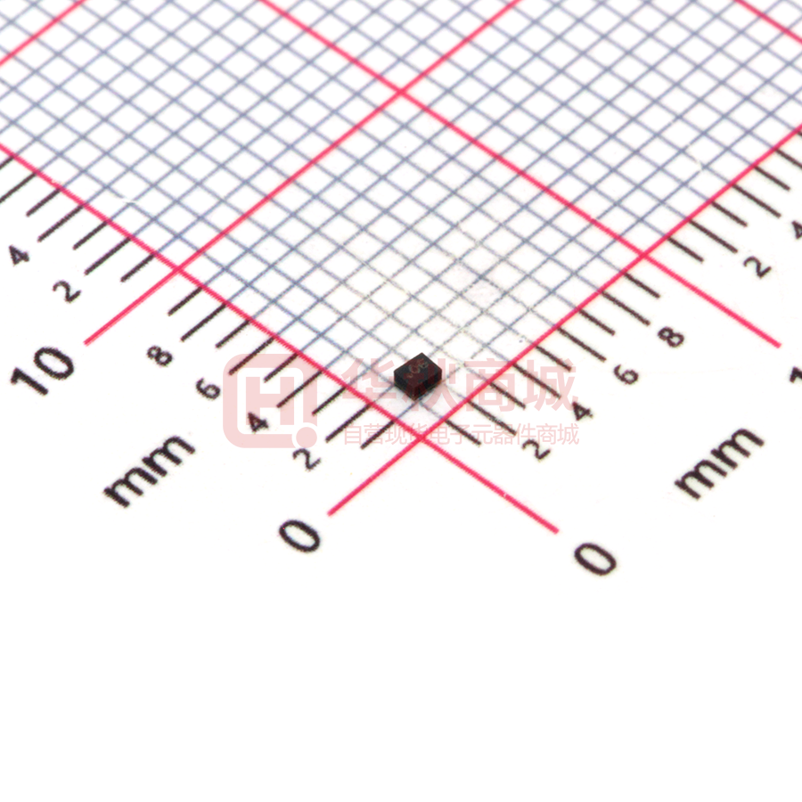

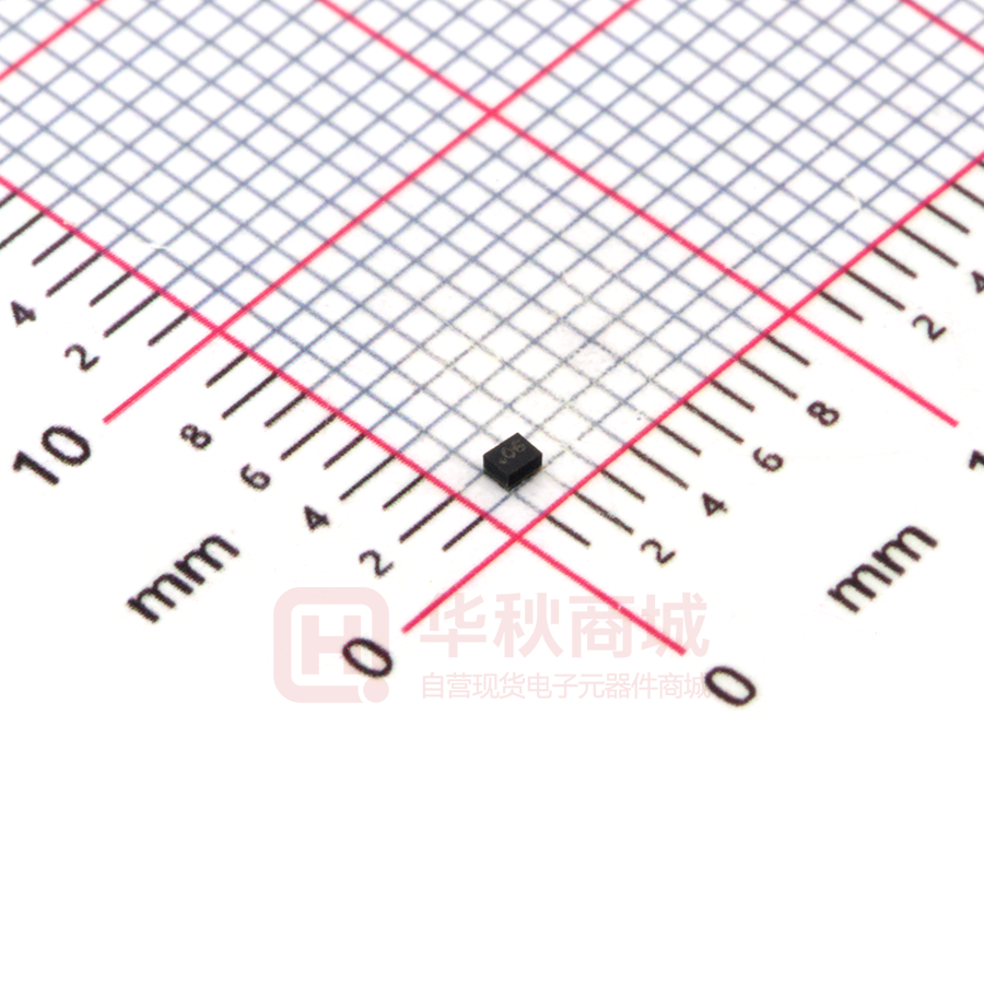

YTLP2316E LTE Band 40 Filter (2300~2400MHz) Description YTLP2316E is a high-performance, miniature filter designed for mobile equipment with LTE B40 band. It is designed with Film Bulk Acoustic Resonator (FBAR) technology, which can provide low insertion loss and steep skirt. So that this product enables coexistence of Wi-Fi signals within the same device or in close proximity to one another. For general performance, the YTLP2316E typical insertion loss in the pass band is 0.9dB, and max insertion loss is within 1.9dB over -20~+85°C, while the typical rejection at the Wi-Fi and LTE41 band are more than 35dB. For the chip package, the YTLP2316E uses advanced module packing techniques to achieve the industry standard 1.1x0.9x0.6mm footprint, include bumping and flip chip. Functional Block Diagram Features ● ● ● ● ● ● ● ● For Wi-Fi - LTE coexistence application Plastic Chip Scale Package(CSP) Miniature Size: 1.1mm x 0.9 mm x 0.6 mm High Rejection at Wi-Fi and LTE B41 bands. Low Temperature Coefficient of Frequency Storage temperature range: -40 to +150 ℃ Excellent ESD protection ability: Class 1C Moisture Sensitivity : MSL3 Environmental ● ● Pin Connection No. Function 1 Input 4 Output 2,3,5 Ground Full implement with RoHS compliant Lead Free (Pb free) Electrical Specifications 1/6 YTLP2316E LTE Band 40 Filter (2300~2400MHz) Parameter(Operable Temperature:-20 to +85°C) Min Typ(1) Max(2) Unit Insertion Loss (2300 ~ 2400 MHz) \ 0.9 1.9 dB Ripple (2300 ~ 2400 MHz) \ 0.4 1.0 dB VSWR Input (2300 ~ 2400 MHz) \ 1.2 1.4 VSWR Output (2300 ~ 2400 MHz) \ 1.2 1.4 10 ~ 1574 MHz -23 -35 \ dB 1574 ~ 1577 MHz -23 -25 \ dB 1577 ~ 1680 MHz -22 -25 \ dB 1845 ~ 1880 MHz -22 -24 \ dB 2110 ~ 2170 MHz -26 -30 \ dB 2421 ~ 2443 MHz (ch05,18MHz-BW) -25 -55 \ dB 2421 ~ 2443 MHz (ch05,18MHz-BW,+25~+85°C) -40 -60 \ dB 2426 ~ 2448 MHz (ch06,18MHz-BW) -55 -60 \ dB 2431 ~ 2483 MHz (ch07-13,18MHz-BW) -40 -50 \ dB 4600 ~ 4800 MHz -45 -48 \ dB 6900 ~ 7200 MHz -31 -32 \ dB Absolute Attenuation RF Input Power(3)(2300 ~ 2400 MHz) 30 dBm (1) Typ Data is the integrated value of the linear S-parameter over indicated band at +25°C. (2) Min/Max Data is being specified over -20 to +85°C. (3) Input power applied for a minimum of 5,000 hrs at 55°C in the specified frequency band.       2/6 YTLP2316E LTE Band 40 Filter (2300~2400MHz) Typical Performance at Tc=25˚C Figure.2 Narrowband Insertion Loss VSWR2 VSWR1 Figure.1 Wideband Insertion Loss -0 .5 -5.0 -1.0 .0 -2 10 20 5.0 2.0 1.0 -0.2 -1.0 10 20 .0 -2 -10 -20 -0 .5 0.5 S(2,2) 10 20 5.0 2.0 0.5 1.0 0.2 S(1,1) 5.0 -5.0 10 20 0.2 -0.2 2.0 5 0. 5.0 -10 -20 5 0. 2.0 1.0 Figure.4 Output VSWR S22 1.0 Figure.3 Input VSWR S11 freq (2.300GHz to 2.400GHz) freq (2.300GHz to 2.400GHz) Figure.5 Input Smith Chart S11 Figure.6 Output Smith Chart S22 3/6 YTLP2316E LTE Band 40 Filter (2300~2400MHz) Package Outline Drawing 0.395 0.59±0.06 1.10±0.05 0.395 5x0.25x0.20 0.075 0.055 0.500 0.90±0.05 06 PIN1 Mark 0.075 0.055 Notes: 1. Dimension: mm 2. Dimensions nominal unless otherwise noted 3. Contact area are gold plated 4. Pad(1) to (5) are same size 5. XX is ROFS inside code Pin Connection: 1 Input 4 Output 2.3.5 Ground Test Circuit 5 50ohm Input 4 1 L1=6.8nH   50ohm Output L2=6.8nH 2 3 Notes: 1. Matching component values shown are ROFS evaluation board results, please adjust component values by the actual use environment. Top View PCB Footprint   Notes: 1. Black indicates metalized area. 2. This footprint represents a recommendation only, some modification may be necessary to suit end user assembly materials and processes. 3. For solder pad recommendation see mechanical information. 4. Dimensions shown are nominal in millimeters. 4/6 YTLP2316E LTE Band 40 Filter (2300~2400MHz) Packing 1. Tape Dimension 2. Reel Dimension 5000Pcs/Reel 5/6 YTLP2316E LTE Band 40 Filter (2300~2400MHz) Recommended IR Reflow Profile Order Information Part Number Qty Per Reel Container YTLP2316E 5000 7 inch Reel 6/6
YTLP2316E
YTLP2316E 是一款专为LTE B40频段设计的高性能、小型化滤波器,使用FBAR技术,可提供低插入损耗和陡峭的滤波器边缘。
该产品允许在同一设备或靠近的设备内Wi-Fi信号的共存。
在通过频带中,典型插入损耗为0.9dB,最大插入损耗在-20至+85°C下不超过1.9dB,Wi-Fi和LTE41频带的典型抑制超过35dB。
引脚分配如下:
- 1号引脚:输入 - 4号引脚:输出 - 2号、3号、5号引脚:地线
产品特点包括: - 适用于Wi-Fi-LTE共存应用的塑料芯片级封装(CSP) - 微型尺寸:1.1mm x 0.9mm x 0.6mm - 在Wi-Fi和LTE B41频带具有高抑制 - 低温度系数 - 存储温度范围:-40至+150℃ - 出色的ESD保护能力:1C级 - 湿度敏感度:MSL3 - 完全符合RoHS标准的无铅(Pb free)
环境标准: - 完全符合RoHS标准,无铅
电性能规格在-20至+85°C的工作温度范围内,包括插入损耗、波纹、输入和输出的电压驻波比(VSWR)、绝对衰减等参数。
封装信息提供了详细的尺寸和测试电路图,包括匹配组件的值和PCB焊盘推荐。
应用信息包括推荐的红外(Reflow)焊接曲线和订单信息,例如每个卷的数量和容器规格。
物料型号为YTLP2316E,由YATELIAN制造,是一款LTE Band 40滤波器,工作频率范围是2300~2400MHz。
