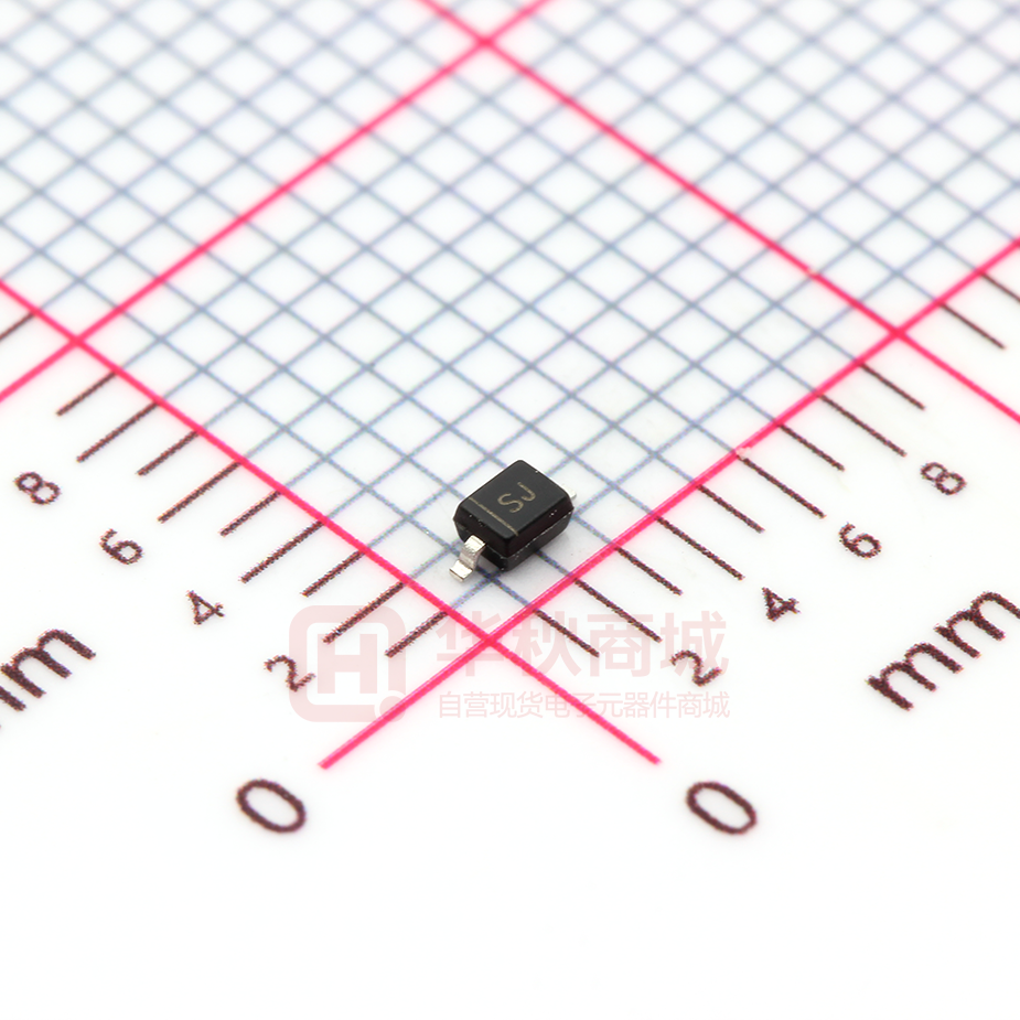

    VR=20V IF=1A VF=0.45V IR=1000uA
B5817WS 数据手册
B5817WS-B5819WS Schottky Barrier Diode FEATURES z z Extremely low VF Low stored change,majority carrier conduction z Low power loss/high efficient Pb Lead-free APPLICATIONS z z For Use In Low Voltage, High Frequency Inverters Free Wheeling, And Polarity Protection Applications SOD-323 ORDERING INFORMATION Type No. Marking Package Code B5817WS B5818WS B5819WS SJ SK SL SOD-323 SOD-323 SOD-323 MAXIMUM RATING @ Ta=25℃ unless otherwise specified Parameter symbol B5817WS B5818WS B5819WS Unit Non-Repetitive Peak reverse voltage VRM 20 30 40 V Peak repetitive Peak reverse voltage Working Peak Reverse voltage DC Reverse Voltage VRRM VRWM VR 20 30 40 V RMS Reverse Voltage VR(RMS) 14 21 28 V Average Rectified output Current Io 1 A Peak forward surge current@=8.3ms IFSM 20 A Power Dissipation Pd 235 mW Thermal Resistance Junction to Ambient RθJA 426 ℃/W Storage temperature TSTG -55 to +150 ℃ 2014-03 01版 http://www.microdiode.com B5817WS-B5819WS Schottky Barrier Diode ELECTRICAL CHARACTERISTICS @ Ta=25℃ unless otherwise specified Parameter Symbol Test Condition MIN MAX UNIT IR=1mA Reverse breakdown voltage Reverse voltage leakage current Forward voltage Diode capacitance B5817WS B5818WS B5819WS V(BR) IR VF CD 20 30 40 V VR=20V VR=30V VR=40V B5817WS B5818WS B5819WS B5817WS IF=1A IF=3A 0.45 0.75 B5818WS IF=1A IF=3A 0.55 0.875 B5819WS IF=1A IF=3A 0.6 0.9 1 VR=4V,f=1MHz 120 mA V pF TYPICAL CHARACTERISTICS @ Ta=25℃ unless otherwise specified 2014-03 01版 http://www.microdiode.com B5817WS-B5819WS Schottky Barrier Diode PACKAGE OUTLINE Plastic surface mounted package SOD-323 K SOD-323 C A B D H E J Dim Min Max A 1.60 1.80 B 1.20 1.40 C 0.9 Max D 0.30 Typical E 0.22 0.42 H 0.02 0.1 J K 0.1 Typical 2.55 2.75 All Dimensions in mm 2014-03 01版 http://www.microdiode.com B5817WS-B5819WS Schottky Barrier Diode SOLDERING FOOTPRINT 0.63 0.83 1.60 2.85 Unit :mm PACKAGE INFORMATION Device Package Shipping B5817WS-B5819WS SOD-323 3000/Tape&Reel 2014-03 01版 http://www.microdiode.com
