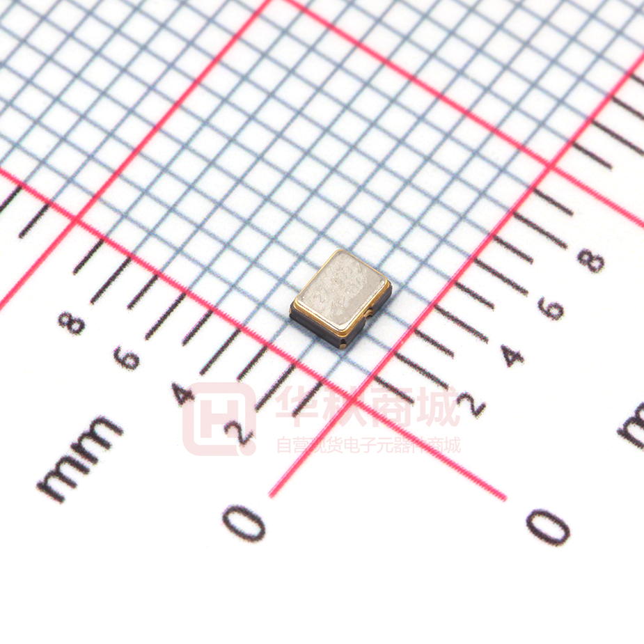

    有源晶振 27MHz 1.8V ±30ppm SMD2520_4P
OYKTELJANF-27MHZ 数据手册
OY Type 2.5 x 2.0 mm SMD Crystal Oscillator Actual Size FEATURE - Typical 2.5 x 2.0 x 0.81mm Ceramic SMD Package - Tight Symmetry (45 to 55%) Available - Operation Voltage: 1.8V, 2.5V, 3.3V - Tri-State Enable/Disable TYPICAL APPLICATION - WLAN/WiMAX - Mobile Phone - DSC, Set-Top Box, HDTV DIMENSION (mm) SOLDER PAD L AYOUT (mm) 0.1 μF [ B O T T O M V IE W ] [ TO P VIEW ] 1.625 ± 0.10 #1 #1 0.675 ± 0.10 0.675 Pin# 0.81 ± 0.15 0.29 1 2 3 4 1.225 #4 #2 #2 [ S ID E V IE W ] #3 0.80 1.225 ± 0.10 #3 0.57 ± 0.10 2.50 ± 0.20 2.00 ± 0.20 #4 RoHS Compliant OY_PY 1.625 Function 0.90 Tri-state GND Output VDD Might cause malfunction if do not To ensure optimal oscillator place a by-pass capacitor of 0.1μF followperformance, the recommendation. as close to the part as possible between Vdd and GND pads. ELECTRICAL SPECIFICATION 3.3V Parameter Supply Voltage Variation (VDD) Frequency Range 2.5V Min. Max. Min. Max. VDD-5% VDD+5% VDD-5% VDD+5% VDD-5% VDD+5% V 1.25 125 1.25 125 1.25 125 MHz - 15 - 10 - 7 mA - 1.5 - 1.5 - 1.2 mA mA 24, 26, 30, 40 At 15pF Load Fo < 10MHz No Load Condition, 1.25MHz Current Unit Max. Standard Frequency Supply 1.8V Min. MHz No Load Condition, 10MHz Fo < 20MHz - 2 - 2 - 1.5 No Load Condition, 20MHz Fo < 80MHz - 3 - 2.5 - 1.5 mA No Load Condition, 80MHz Fo < 125MHz - 8 - 7 - 5 mA Duty Cycle Output Level 45 55 45 55 45 55 % Output High 2.97 - 2.25 - 1.62 - V Output Low - 0.33 - 0.25 - 0.18 V - 3 - 4 - 5 nSec Fo < 10MHz 1.25MHz Transition Time: 10MHz Fo < 20MHz - 3 - 3 - 4 nSec Rise / Fall Time+ 20MHz Fo < 80MHz - 3 - 3 - 4 nSec 80MHz Fo < 125MHz - 3 - 3 - 4 nSec - 2 - 2 - 2 mSec 2.31 - 1.75 - 1.26 - V - 0.99 - 0.75 - 0.54 Startup Time Tri-State Enable (High Voltage or Floating) (Input to Pin 1) Disable (Low Voltage or GND) Output Loading 15 15 V 15 pF Stand by Current (@-40oC to 85oC) - 10 - 10 - 10 Stand by Current (@-40oC to 125oC) - 20 - 20 - 20 Period Jitter (Pk-Pk) - 40 - 40 - 40 pSec RMS Phase Jitter (12kHz to 20MHz) - 1 - 1 - 1 pSec Aging (@ 25oC, 1st Year) - 3 - 3 - 3 ppm -55 +125 -55 +125 -55 +125 Storage Temp. Range A A o C Standard frequencies are frequencies which the crystal has been designed and does not imply a stock position +Transition times are measured between 10% and 90% of VDD,withan output load of 15pF FREQ. STABILITY vs. TEMP. RANGE ppm Temp.( oC) ±20 25 50 -10~+60 -20~+70 -40~+85 -40~+125 * O: Available △:Conditional X: Not available *Inclusive of calibration @ 25℃, operating temperature range, input voltage variation, load variation, aging (1st year), shock, and vibration load variation Note: not all combination of options are available. Other specifications may be available upon request. 32 Specifications subject to change without notice. www.taitien.com sales@taitien.com.tw Rev(13)02/2020
OYKTELJANF-27MHZ
物料型号:OY Type 2.5 x 2.0 mm SMD Crystal Oscillator
器件简介:这是一款小型的表面贴装晶体振荡器,具有2.5 x 2.0 x 0.81mm的典型尺寸,适用于WLAN/WiMAX、手机、DSC、机顶盒和HDTV等应用。
引脚分配: - 引脚1:三态控制 - 引脚2:地(GND) - 引脚3:输出 - 引脚4:电源(VDD)
参数特性: - 工作电压:1.8V、2.5V、3.3V - 频率范围:1.25MHz至125MHz - 标准频率:24、26、30、40MHz等 - 负载电容:15pF - 工作电流:在1.25MHz时,小于10mA - 占空比:45%至55% - 输出电平:高电平2.97V,低电平0.33V - 上升/下降时间:在1.25MHz时,5ns - 启动时间:2ms - 三态使能电压:2.31V - 三态禁用电压:0.54V - 输出负载:15pF
功能详解:该振荡器具有三态使能/禁用功能,可以通过引脚1控制。为了确保最佳性能,建议在VDD和GND焊盘之间尽可能靠近器件放置0.1μF的旁路电容。
应用信息:适用于需要小型化和高性能的应用,如无线通信设备和高清电视。
封装信息:采用2.5 x 2.0mm的陶瓷SMD封装,尺寸紧凑,符合RoHS标准。
