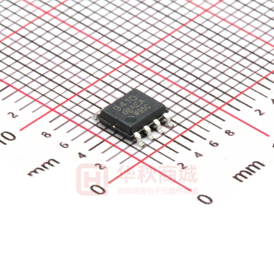

    MOS管 N-Channel VDS=20V VGS=±16V ID=10A RDS(ON)=15mΩ@4.5V SOIC8_150MIL
VBZA9410 数据手册
VBZA9410 www.VBsemi.com N-Channel 20V (D-S) MOSFET FEATURES PRODUCT SUMMARY RDS(on) (Ω) ID (A)a 0.012 at VGS = 10 V 12 0.015 at VGS = 4.5 V 9 VDS (V) 20 Qg (Typ.) 6.1 nC • Halogen-free • Trench Power MOSFET • Optimized for High-Side Synchronous Rectifier Operation • 100 % Rg Tested • 100 % UIS Tested APPLICATIONS • Notebook CPU Core - High-Side Switch SO-8 D S 1 8 D S 2 7 D S 3 6 D G 4 5 D G Top View S N-Channel MOSFET ABSOLUTE MAXIMUM RATINGS TA = 25 °C, unless otherwise noted Parameter Drain-Source Voltage Gate-Source Voltage Continuous Drain Current (TJ = 150 °C) Symbol VDS VGS TC = 25 °C TC = 70 °C TA = 25 °C TA = 70 °C ID IDM Pulsed Drain Current TC = 25 °C TA = 25 °C IS Single Pulse Avalanche Current Avalanche Energy L = 0.1 mH IAS EAS Maximum Power Dissipation TC = 25 °C TC = 70 °C TA = 25 °C TA = 70 °C PD Continuous Source-Drain Diode Current Limit 20 ± 16 12 9 TJ, Tstg Operating Junction and Storage Temperature Range Unit V 10b, c 8b, c 50 3.7 A 2.0b, c 20 21 4.1 2.5 mJ 2.2b, c 1.3b, c - 55 to 150 W °C THERMAL RESISTANCE RATINGS Parameter Maximum Junction-to-Ambientb, d Maximum Junction-to-Foot (Drain) t ≤ 10 s Steady State Symbol RthJA RthJF Typical 39 25 Maximum 55 29 Unit °C/W Notes: a. Base on TC = 25 °C. b. Surface Mounted on 1" x 1" FR4 board. c. t = 10 s. d. Maximum under Steady State conditions is 85 °C/W. 服务热线:400-655-8788 1 VBZA9410 www.VBsemi.com SPECIFICATIONS TJ = 25 °C, unless otherwise noted Parameter Symbol Test Conditions Min. VDS VGS = 0 V, ID = 250 µA 20 Typ. Max. Unit Static Drain-Source Breakdown Voltage VDS Temperature Coefficient ΔVDS/TJ VGS(th) Temperature Coefficient ΔVGS(th)/TJ Gate-Source Threshold Voltage ID = 250 µA VGS(th) VDS = VGS, ID = 250 µA Gate-Source Leakage IGSS VDS = 0 V, VGS = ± 20 V Zero Gate Voltage Drain Current IDSS On-State Drain Currenta ID(on) Drain-Source On-State Resistancea Forward Transconductancea RDS(on) gfs V 26 mV/°C -6 1.0 3.0 V ± 100 nA VDS = 20 V, VGS = 0 V 1 VDS =20V , VGS = 0 V, TJ = 55 °C 10 VDS ≥ 5 V, VGS = 10 V 20 µA A VGS = 10 V, ID = 10 A 0.012 VGS = 4.5 V, ID = 9 A 0.015 VDS = 10 V, ID = 10 A 50 Ω S Dynamicb Input Capacitance Ciss Output Capacitance Coss Reverse Transfer Capacitance Crss Total Gate Charge Qg Gate-Source Charge Qgs Gate-Drain Charge Qgd Gate Resistance Rg 800 VDS = 10 V, VGS = 0 V, f = 1 MHz Fall Time Turn-On Delay Time 23 12 16 16 22 tf 10 18 td(on) 8 16 10 20 td(off) Turn-Off Delay Time f = 1 MHz VDD = 10 V, RL = 1.4 Ω ID ≅ 9 A, VGEN = 4.5 V, Rg = 1 Ω VDD = 10 V, RL = 1.4 Ω ID ≅ 9 A, VGEN = 10 V, Rg = 1 Ω tf Fall Time nC 2.3 16 tr Rise Time 2.5 VDS = 10 V, VGS = 5 V, ID = 10 A 3.6 td(off) Turn-Off Delay Time 15 6.8 1.8 tr Rise Time pF 73 VDS = 10 V, VGS = 10 V, ID = 10 A td(on) Turn-On Delay Time 165 0.36 16 22 8 15 Ω ns Drain-Source Body Diode Characteristics Continuous Source-Drain Diode Current Pulse Diode Forward Currenta Body Diode Voltage IS 10 TC = 25 °C ISM VSD 50 IS = 9 A 0.8 1.2 A V Body Diode Reverse Recovery Time trr 15 30 ns Body Diode Reverse Recovery Charge Qrr 6 12 nC Reverse Recovery Fall Time ta Reverse Recovery Rise Time tb IF = 9 A, dI/dt = 100 A/µs, TJ = 25 °C 8 7 ns Notes: a. Pulse test; pulse width ≤ 300 µs, duty cycle ≤ 2 %. b. Guaranteed by design, not subject to production testing. Stresses beyond those listed under “Absolute Maximum Ratings” may cause permanent damage to the device. These are stress ratings only, and functional operation of the device at these or any other conditions beyond those indicated in the operational sections of the specifications is not implied. Exposure to absolute maximum rating conditions for extended periods may affect device reliability. 服务热线:400-655-8788 2 VBZA9410 www.VBsemi.com TYPICAL CHARACTERISTICS 25 °C, unless otherwise noted 50 5 VGS = 10 thru 6 V 4 I D - Drain Current (A) I D - Drain Current (A) 40 30 20 VGS = 4 V 10 TC = - 55 °C 3 2 TC = 25 °C 1 TC = 125 °C 0 0 2 4 6 8 0 0.0 10 0.5 VDS - Drain-to-Source Voltage (V) 1.0 1.5 2.0 2.5 3.0 VGS - Gate-to-Source Voltage (V) Output Characteristics Transfer Characteristics 1200 0.016 900 C - Capacitance (pF) R DS(on) - On-Resistance (Ω) VGS = 4.5 V 0.014 0.011 VGS = 10 V 0.009 Ciss 600 300 Coss 0.007 Crss 0 0.005 0 10 20 30 40 0 50 6 12 24 30 VDS - Drain-to-Source Voltage (V) ID - Drain Current (A) On-Resistance vs. Drain Current and Gate Voltage Capacitance 1.8 10 ID = 11 A ID = 11 A 8 VDS = 10 V 6 VDS = 15 V 4 1.5 VGS = 10 V (Normalized) R DS(on) - On-Resistance VGS - Gate-to-Source Voltage (V) 18 1.2 VGS = 4.5 V 0.9 2 0 0 4 8 12 Qg - Total Gate Charge (nC) Gate Charge 16 0.6 - 50 - 25 0 25 50 75 100 125 150 TJ - Junction Temperature (°C) On-Resistance vs. Junction Temperature 服务热线:400-655-8788 3 VBZA9410 www.VBsemi.com TYPICAL CHARACTERISTICS 25 °C, unless otherwise noted 0.030 100 0.025 R DS(on) - On-Resistance (Ω) I S - Source Current (A) 10 TJ = 150 °C 1 TJ = 25 °C 0.1 0.01 0.001 0.0 0.020 TJ = 125 °C 0.015 0.010 TJ = 25 °C 0.005 0.000 0.2 0.4 0.8 0.6 1.0 1.2 0 2 VSD - Source-to-Drain Voltage (V) 4 6 8 10 VGS - Gate-to-Source Voltage (V) Source-Drain Diode Forward Voltage On-Resistance vs. Gate-to-Source Voltage 2.2 50 2.0 40 Power (W) VGS(th) (V) 1.8 ID = 250 µA 1.6 30 20 1.4 10 1.2 1.0 - 50 - 25 0 25 50 75 100 125 0 10- 3 150 10- 2 10- 1 TJ - Temperature (°C) 1 10 100 600 Time (s) Threshold Voltage Single Pulse Power, Junction-to-Ambient 100 Limited by RDS(on)* 100 µA I D - Drain Current (A) 10 1 ms 10 ms 1 100 ms 1s 10 s 0.1 TA = 25 °C Single Pulse DC BVDSS Limited 0.01 0.1 1 10 100 VDS - Drain-to-Source Voltage (V) * VGS > minimum VGS at which RDS(on) is specified Safe Operating Area, Junction-to-Ambient 服务热线:400-655-8788 4 VBZA9410 www.VBsemi.com TYPICAL CHARACTERISTICS 25 °C, unless otherwise noted 18 I D - Drain Current (A) 15 12 9 6 3 0 0 25 50 75 100 125 150 TC - Case Temperature (°C) Current Derating* 6 2.0 5 1.5 Power (W) Power (W) 4 3 1.0 2 0.5 1 0 0 25 50 75 100 125 150 0.0 0 25 50 75 100 125 TC - Case Temperature (°C) TA - Ambient Temperature (°C) Power Derating, Junction-to-Foot Power Derating, Junction-to-Ambient 150 * The power dissipation PD is based on TJ(max) = 150 °C, using junction-to-case thermal resistance, and is more useful in settling the upper dissipation limit for cases where additional heatsinking is used. It is used to determine the current rating, when this rating falls below the package limit. 服务热线:400-655-8788 5 VBZA9410 www.VBsemi.com TYPICAL CHARACTERISTICS 25 °C, unless otherwise noted 2 Normalized Effective Transient Thermal Impedance 1 Duty Cycle = 0.5 0.2 Notes: 0.1 PDM 0.1 0.05 t1 t2 1. Duty Cycle, D = 0.02 t1 t2 2. Per Unit Base = R thJA = 70 °C/W 3. T JM - TA = PDMZthJA(t) 4. Surface Mounted Single Pulse 0.01 10 -4 10 -3 10 -2 10 -1 1 Square Wave Pulse Duration (s) 10 100 600 Normalized Thermal Transient Impedance, Junction-to-Ambient 2 Normalized Effective Transient Thermal Impedance 1 Duty Cycle = 0.5 0.2 0.1 0.1 0.05 0.02 Single Pulse 0.01 10-4 10-3 10-2 10-1 Square Wave Pulse Duration (s) 1 10 Normalized Thermal Transient Impedance, Junction-to-Foot 服务热线:400-655-8788 6 VBZA9410 www.VBsemi.com SOIC (NARROW): 8-LEAD 8 6 7 5 E 1 3 2 H 4 S h x 45 D C 0.25 mm (Gage Plane) A e B All Leads q A1 L 0.004" MILLIMETERS INCHES DIM Min Max Min Max A 1.35 1.75 0.053 0.069 A1 0.10 0.20 0.004 0.008 B 0.35 0.51 0.014 0.020 C 0.19 0.25 0.0075 0.010 D 4.80 5.00 0.189 0.196 E 3.80 4.00 0.150 e 0.101 mm 1.27 BSC 0.157 0.050 BSC H 5.80 6.20 0.228 0.244 h 0.25 0.50 0.010 0.020 L 0.50 0.93 0.020 0.037 q 0° 8° 0° 8° S 0.44 0.64 0.018 0.026 ECN: C-06527-Rev. I, 11-Sep-06 DWG: 5498 服务热线:400-655-8788 7 VBZA9410 www.VBsemi.com RECOMMENDED MINIMUM PADS FOR SO-8 0.172 (4.369) 0.028 0.022 0.050 (0.559) (1.270) 0.152 (3.861) 0.047 (1.194) 0.246 (6.248) (0.711) Recommended Minimum Pads Dimensions in Inches/(mm) 服务热线:400-655-8788 8 VBZA9410 www.VBsemi.com Disclaimer All products due to improve reliability, function or design or for other reasons, product specifications and data are subject to change without notice. Taiwan VBsemi Electronics Co., Ltd., branches, agents, employees, and all persons acting on its or their representatives (collectively, the "Taiwan VBsemi"), assumes no responsibility for any errors, inaccuracies or incomplete data contained in the table or any other any disclosure of any information related to the product.(www.VBsemi.com) Taiwan VBsemi makes no guarantee, representation or warranty on the product for any particular purpose of any goods or continuous production. To the maximum extent permitted by applicable law on Taiwan VBsemi relinquished: (1) any application and all liability arising out of or use of any products; (2) any and all liability, including but not limited to special, consequential damages or incidental ; (3) any and all implied warranties, including a particular purpose, non-infringement and merchantability guarantee. Statement on certain types of applications are based on knowledge of the product is often used in a typical application of the general product VBsemi Taiwan demand that the Taiwan VBsemi of. Statement on whether the product is suitable for a particular application is non-binding. It is the customer's responsibility to verify specific product features in the products described in the specification is appropriate for use in a particular application. Parameter data sheets and technical specifications can be provided may vary depending on the application and performance over time. All operating parameters, including typical parameters must be made by customer's technical experts validated for each customer application. Product specifications do not expand or modify Taiwan VBsemi purchasing terms and conditions, including but not limited to warranty herein. Unless expressly stated in writing, Taiwan VBsemi products are not intended for use in medical, life saving, or life sustaining applications or any other application. Wherein VBsemi product failure could lead to personal injury or death, use or sale of products used in Taiwan VBsemi such applications using client did not express their own risk. Contact your authorized Taiwan VBsemi people who are related to product design applications and other terms and conditions in writing. The information provided in this document and the company's products without a license, express or implied, by estoppel or otherwise, to any intellectual property rights granted to the VBsemi act or document. Product names and trademarks referred to herein are trademarks of their respective representatives will be all. Material Category Policy Taiwan VBsemi Electronics Co., Ltd., hereby certify that all of the products are determined to be RoHS compliant and meets the definition of restrictions under Directive of the European Parliament 2011/65 / EU, 2011 Nian. 6. 8 Ri Yue restrict the use of certain hazardous substances in electrical and electronic equipment (EEE) - modification, unless otherwise specified as inconsistent.(www.VBsemi.com) Please note that some documents may still refer to Taiwan VBsemi RoHS Directive 2002/95 / EC. We confirm that all products identified as consistent with the Directive 2002/95 / EC European Directive 2011/65 /. Taiwan VBsemi Electronics Co., Ltd. hereby certify that all of its products comply identified as halogen-free halogen-free standards required by the JEDEC JS709A. Please note that some Taiwanese VBsemi documents still refer to the definition of IEC 61249-2-21, and we are sure that all products conform to confirm compliance with IEC 61249-2-21 standard level JS709A.
